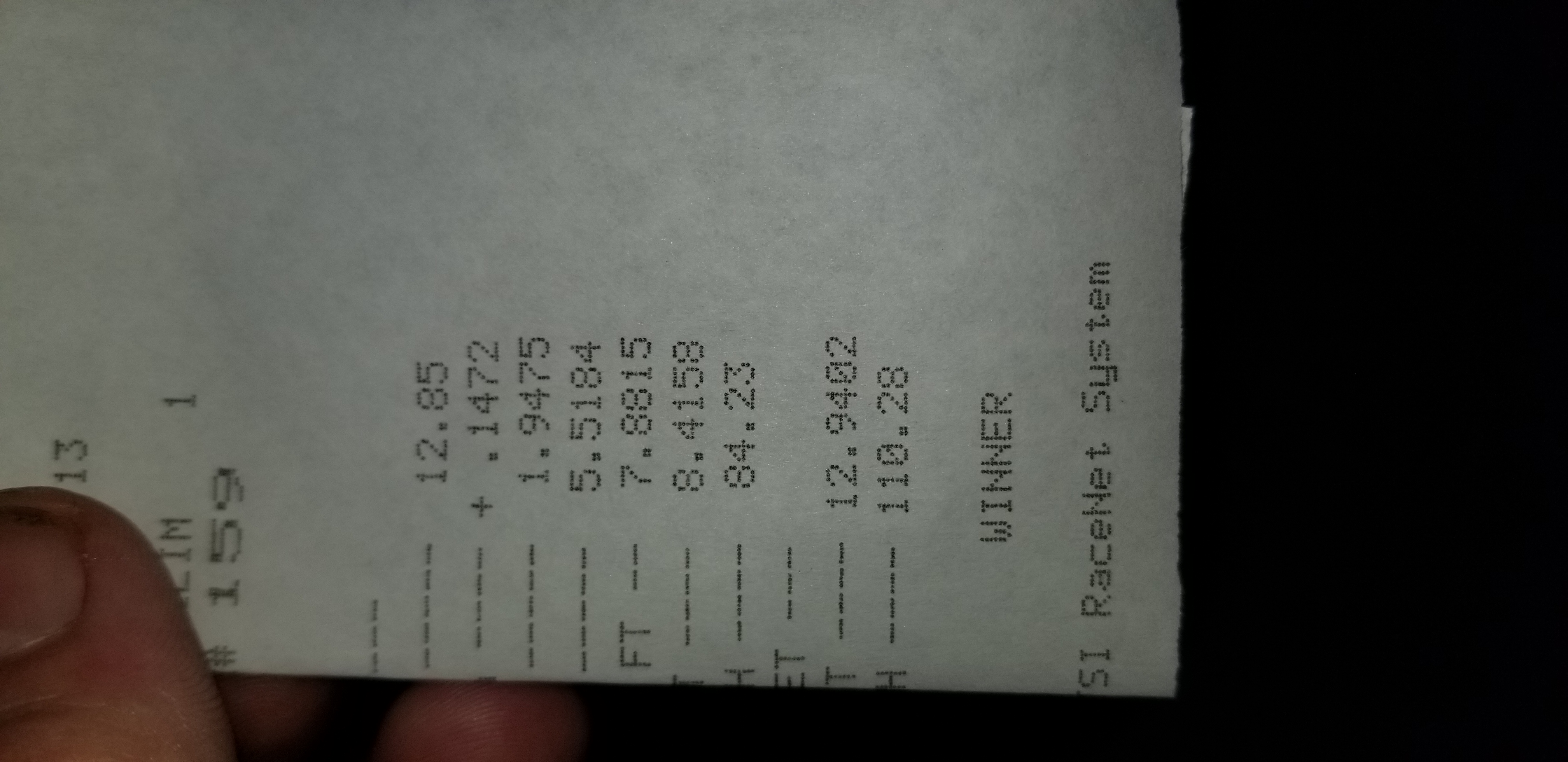

Took the Vette out to Thompson tonight and met Paul out there. I got there late and there were a ton of cars, so I only got 1 time run, but it was worth the drive:
My tach still doesnt work, so I'm just totally launching & shifting it by ear/feel. Staging/launching a stick car is still new-ish to me. Hell, doing burnouts in a rwd/stick are sorta new (but well practiced during vacation with the mustang!) My last time run, after eliminations, I cut .00x green, but I spun terrible, and missed a shift. My other runs I had kinda bogged it a bit. I lost in the 2nd round to a 10sec 67 Nova that shouldn't have been in stock -- open headers for sure, and prob slicks.

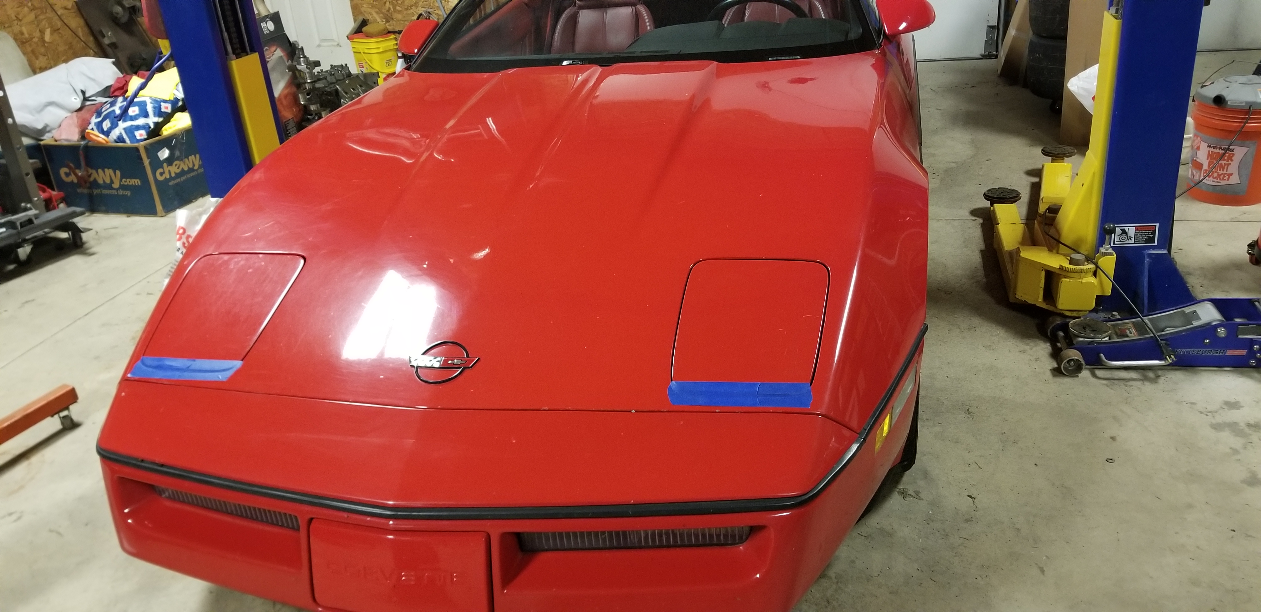

Drove home with just the fog lights. The one headlight motor seems to be stripped out, wont stay open or closed, so I just taped it shut. I put a matching piece of tape on the other side for symmetry. Apparently blue painters tape is good for 110MPH :-)

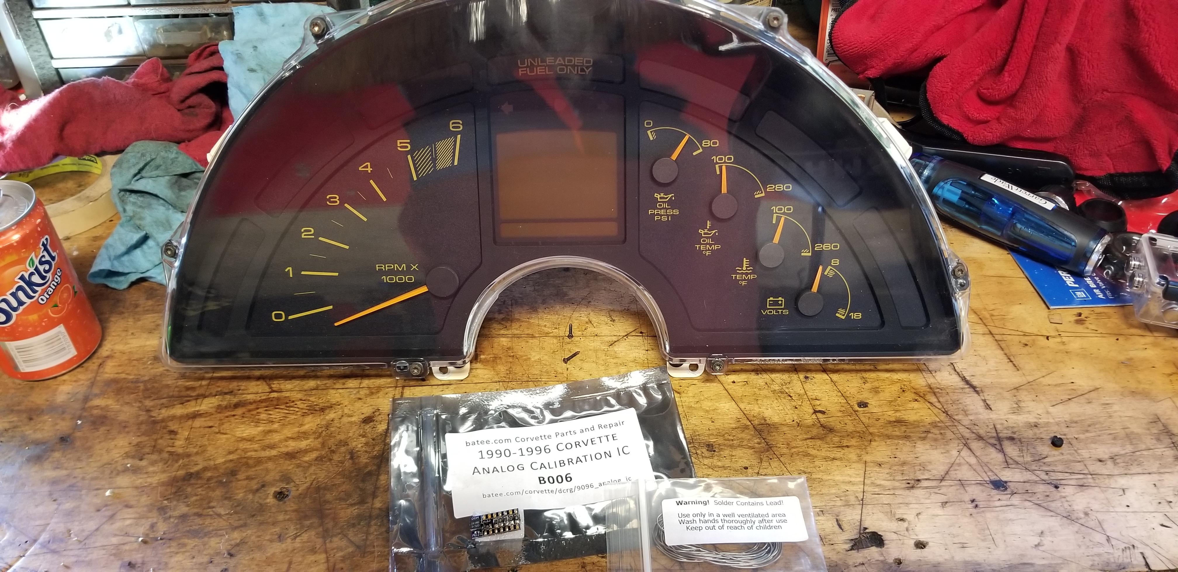

I ordered the 90-96 Tach repair IC from batee.com to hopefully resolve the tach issue.
https://batee.com/collections/1990-1996 ... or-6k-tach
Getting the dash cluster out doesn't look too bad. But then I have to un-solder/re-solder a 14 leg IC. They have pretty good videos detailing the process.
It should be a little more interesting to drive, seeing the actual RPM instead of just listening/feeling, Niki Lauda style.

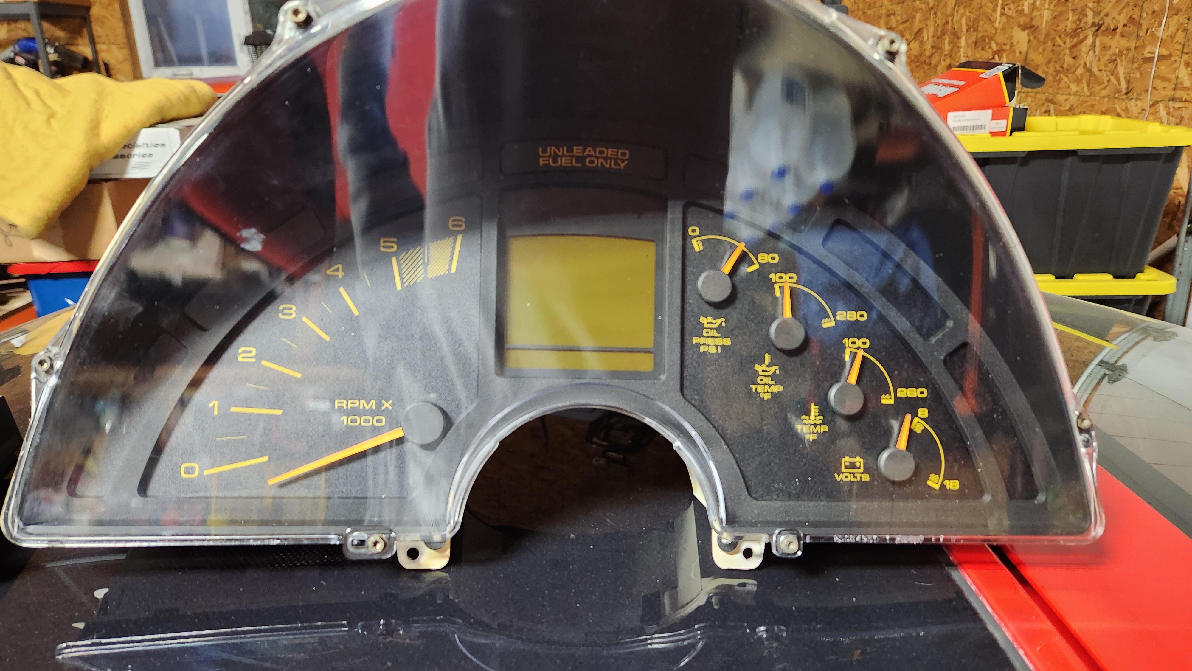

Well, with a week in between the Champcar race at Mid-Ohio with Band of Brothers in their 944, and track day at Mid-Ohio tomorrow, I decided to tackle my non-functioning tach. I bought the replacement chip from batee.com but when I got in there, it looked like someone had already replaced, but it was upside side according to the batee.com instruction video. I removed the chip and installed my new one, properly oriented. I'm not the great solder-er, and the solder just wasn't flowing well when I tried putting the new one in. The board contacts look a little suspect to me too.
The shorter version is I tried soldering it 3 times, the final time with my own solder instead of the stuff included in the kit, and no dice. I can get a replacement cluster for $250, although I think I really only need the circuit board in back.

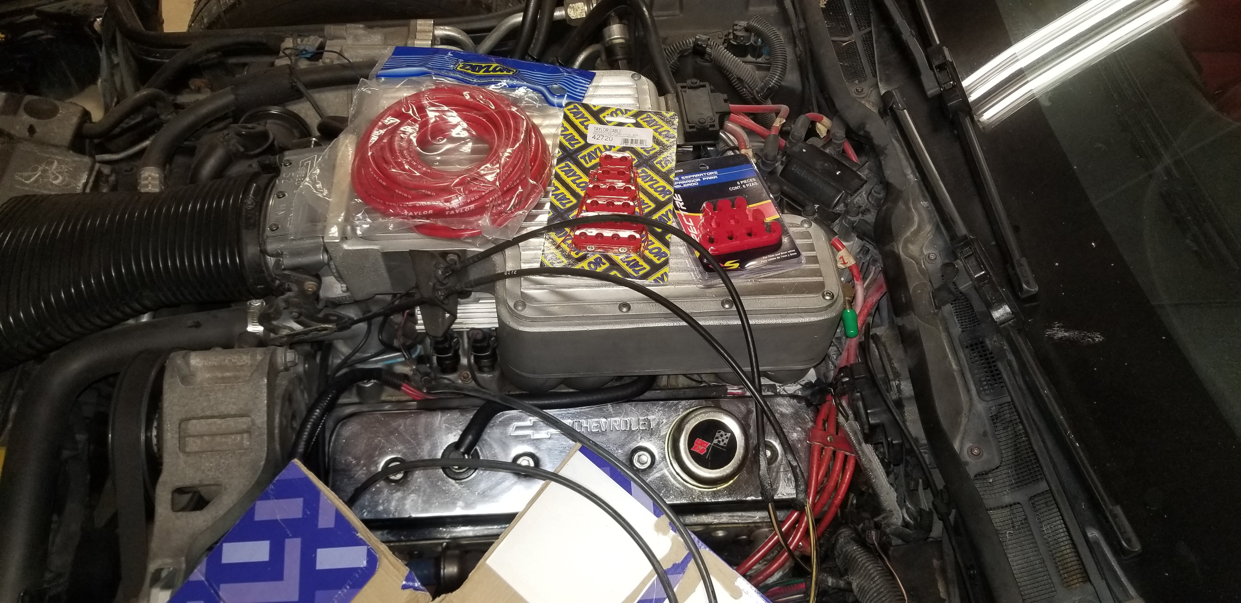

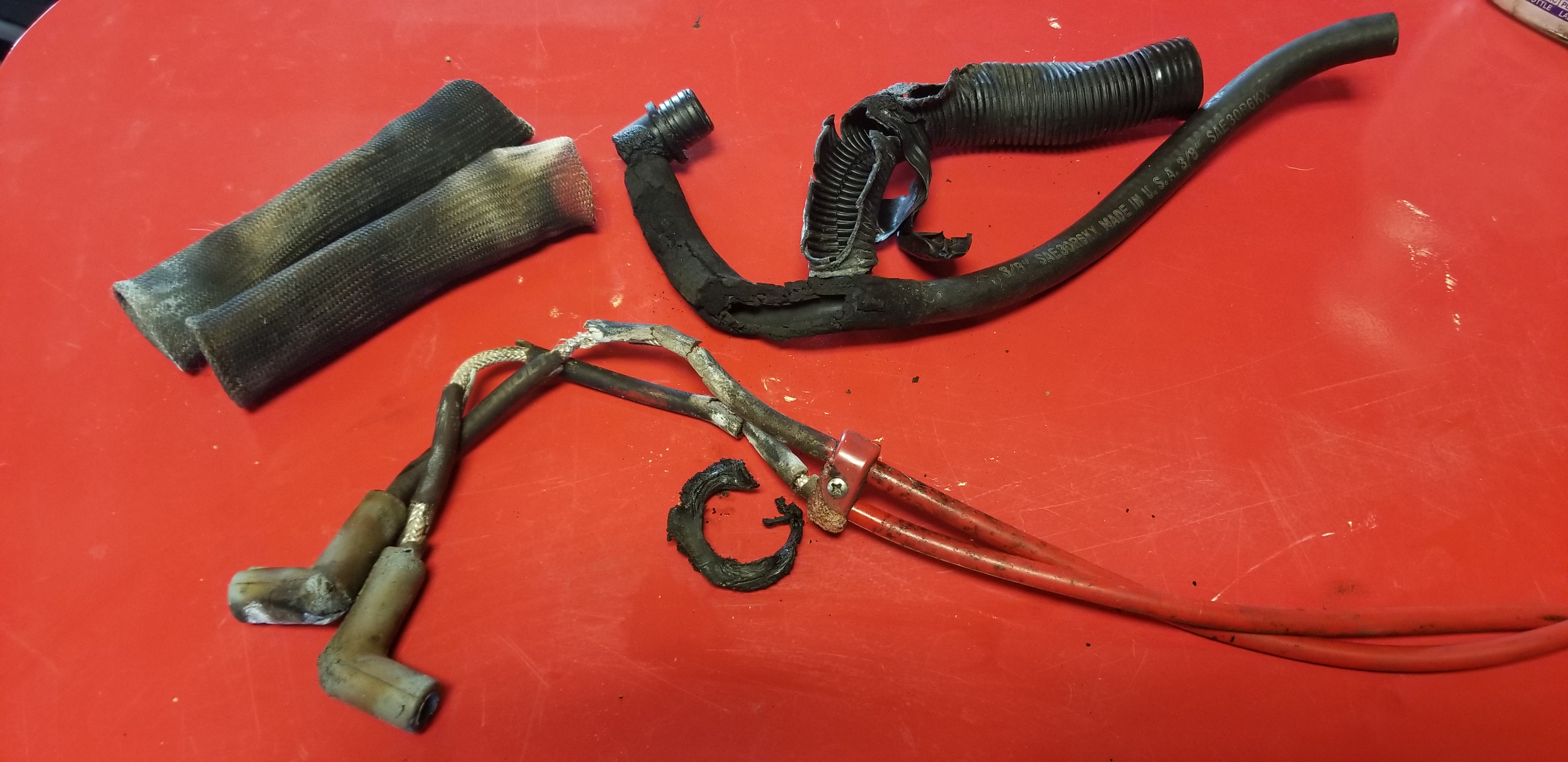

Everyone else is posting their C4 updates, so here's mine. After the small engine fire at the Mid Ohio track day last weekend, I've acquired my repair parts. Throttle & cruise cable, spark plug wire (boots/terminals in inventory), plug wire separators, and a power brake booster check valve. The Superram makes a real nice parts shelf!
Posts: 2638
Re: 1990 Corvette Z51

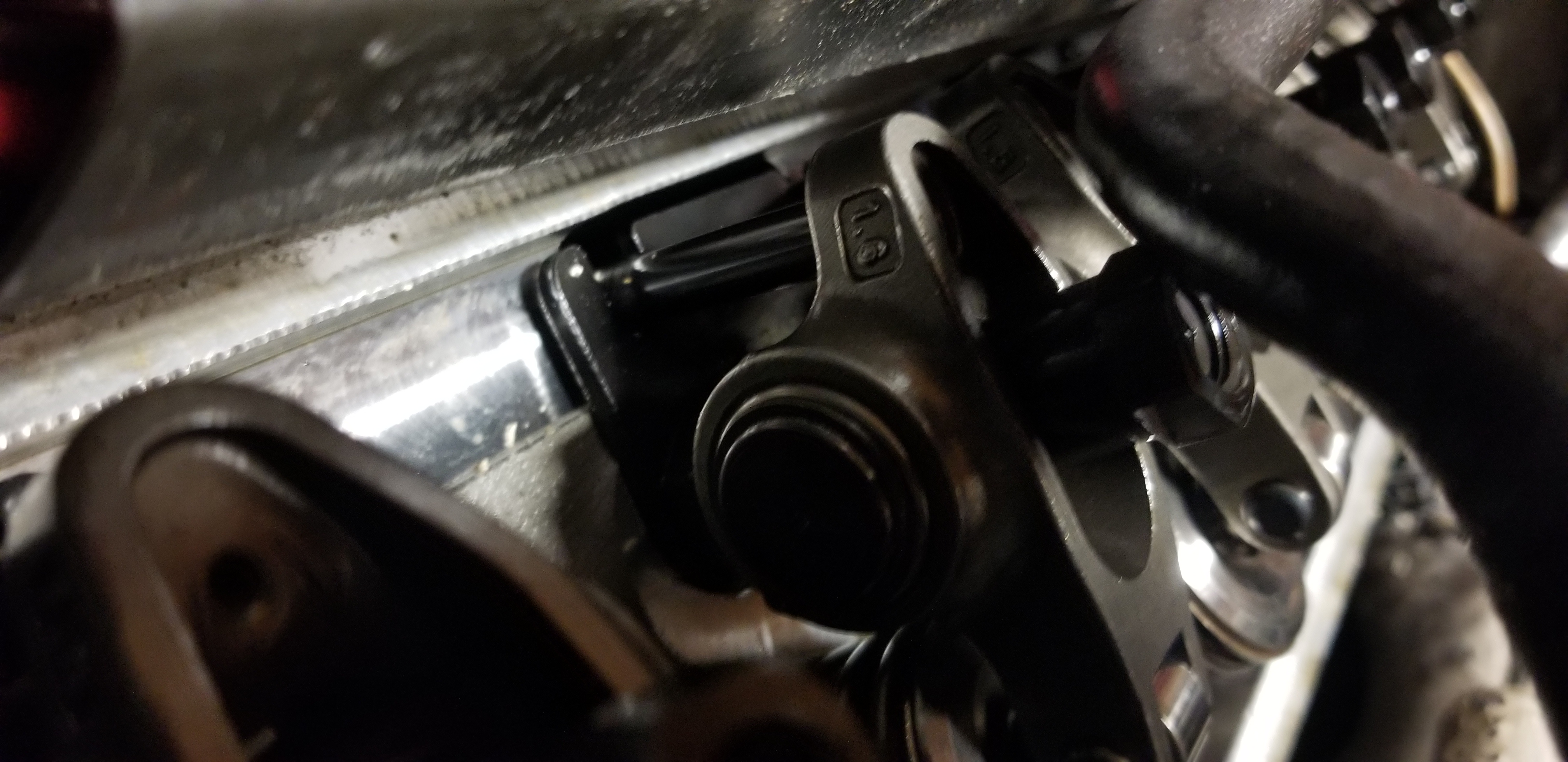

Here are the damaged parts I pulled off. Two spark plug wires + boots, power brake hose, split-tubing from around the engine harness wiring. I still need to replace the throttle cable and cruise cable. Havent figured out how to remove the throttle cable from the pedal yet. I did pop the valve cover off to clean it up and saw it has 1.6 rockers.

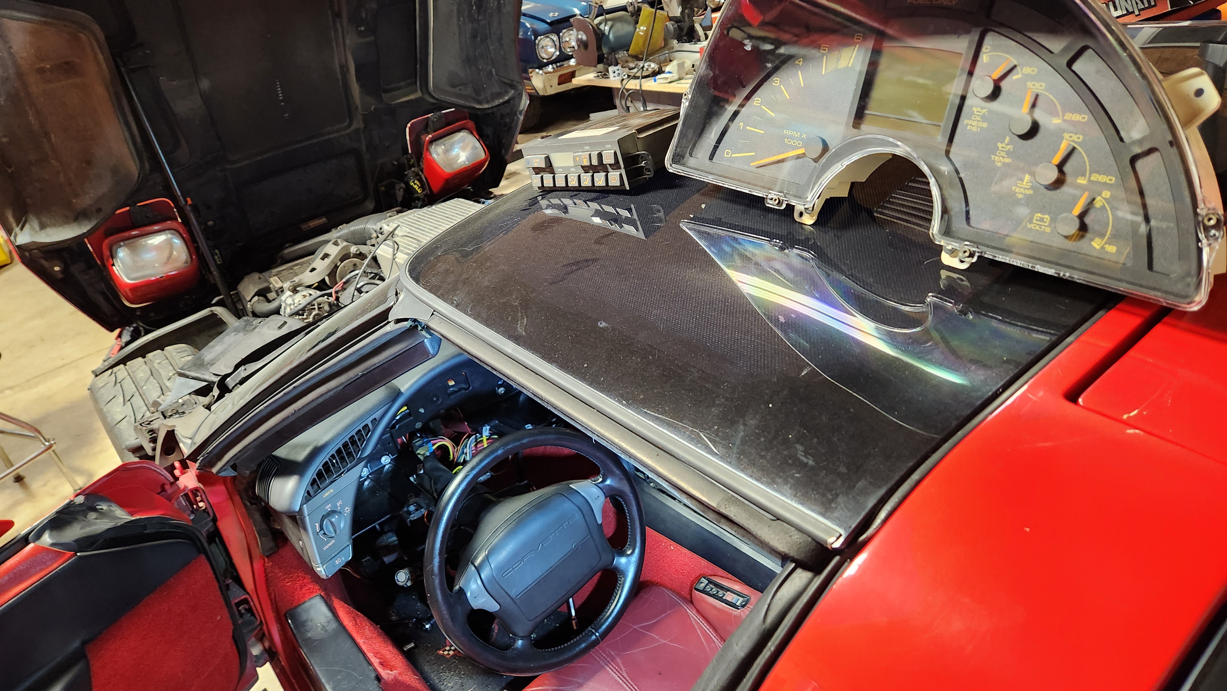

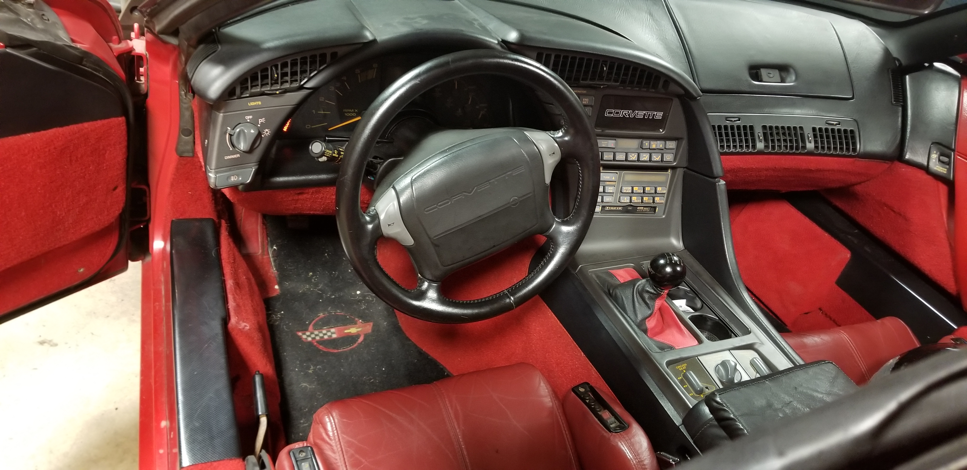

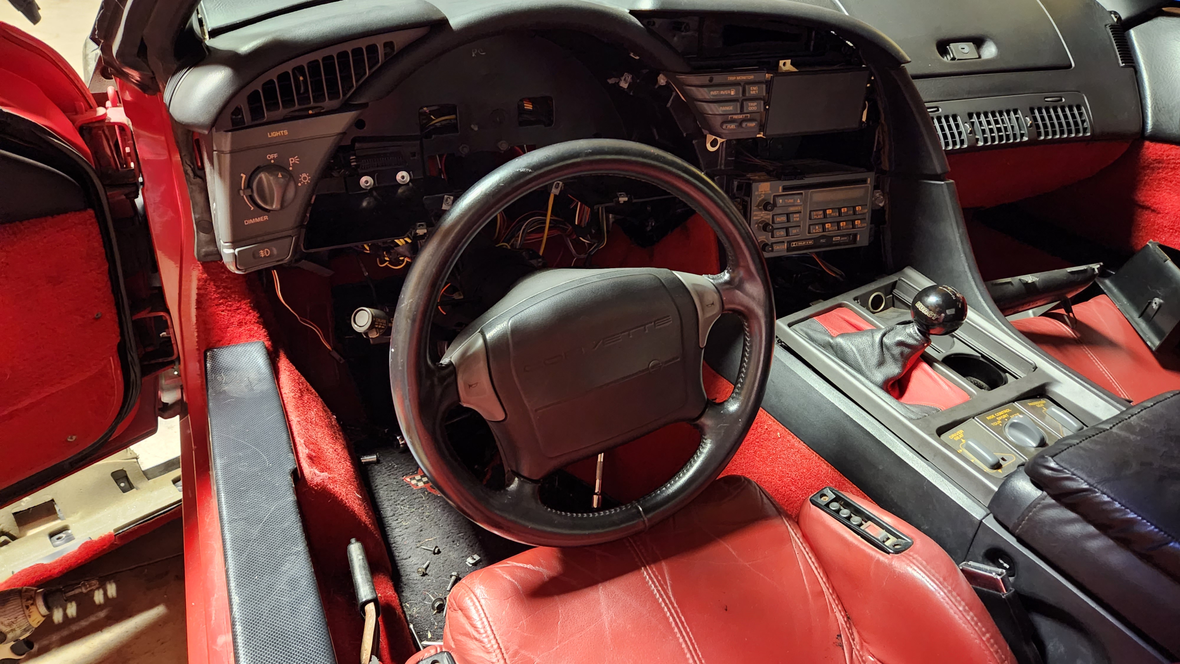

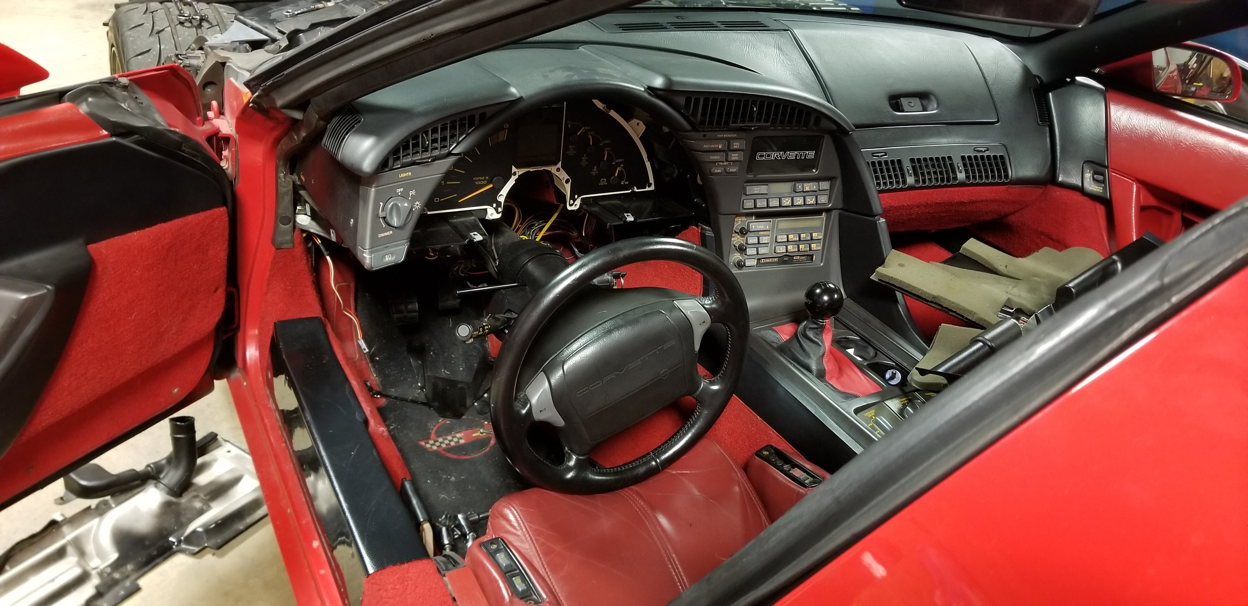

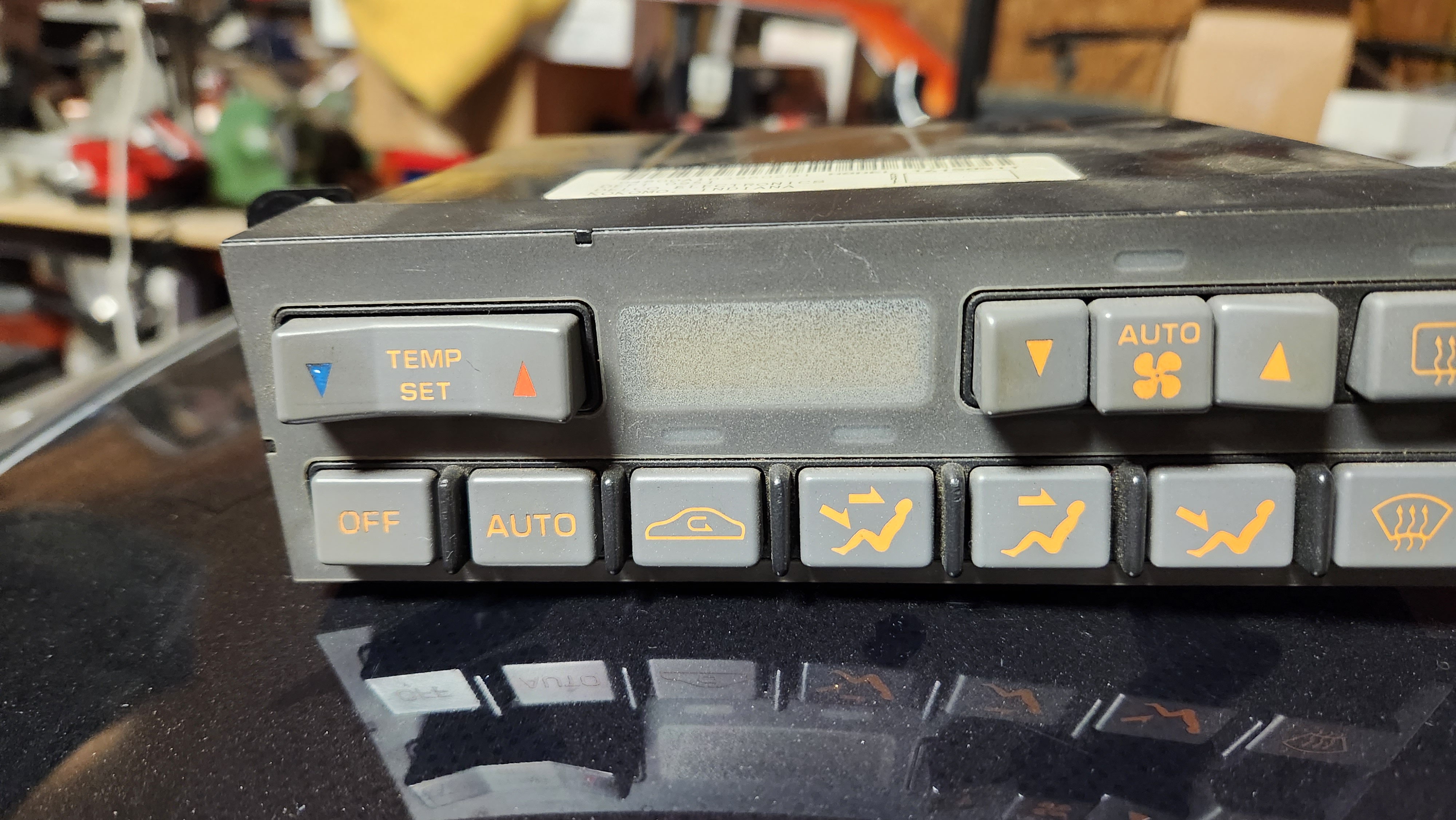

Everyone was having fun with their Corvettes, so I decided to get back to mine. The non-functioning tach needs to be resolved, and while I have the dash half apart, I pulled the A/C controls too. A while back, I had the car at Velotta auto repair, and they told me the A/C system worked if he manually engaged the system, jumpering something.
Batee.com fixes both of these things. I tried a DIY repair on the tach once and failed. I've got them boxed up and ready to ship out tomorrow.
