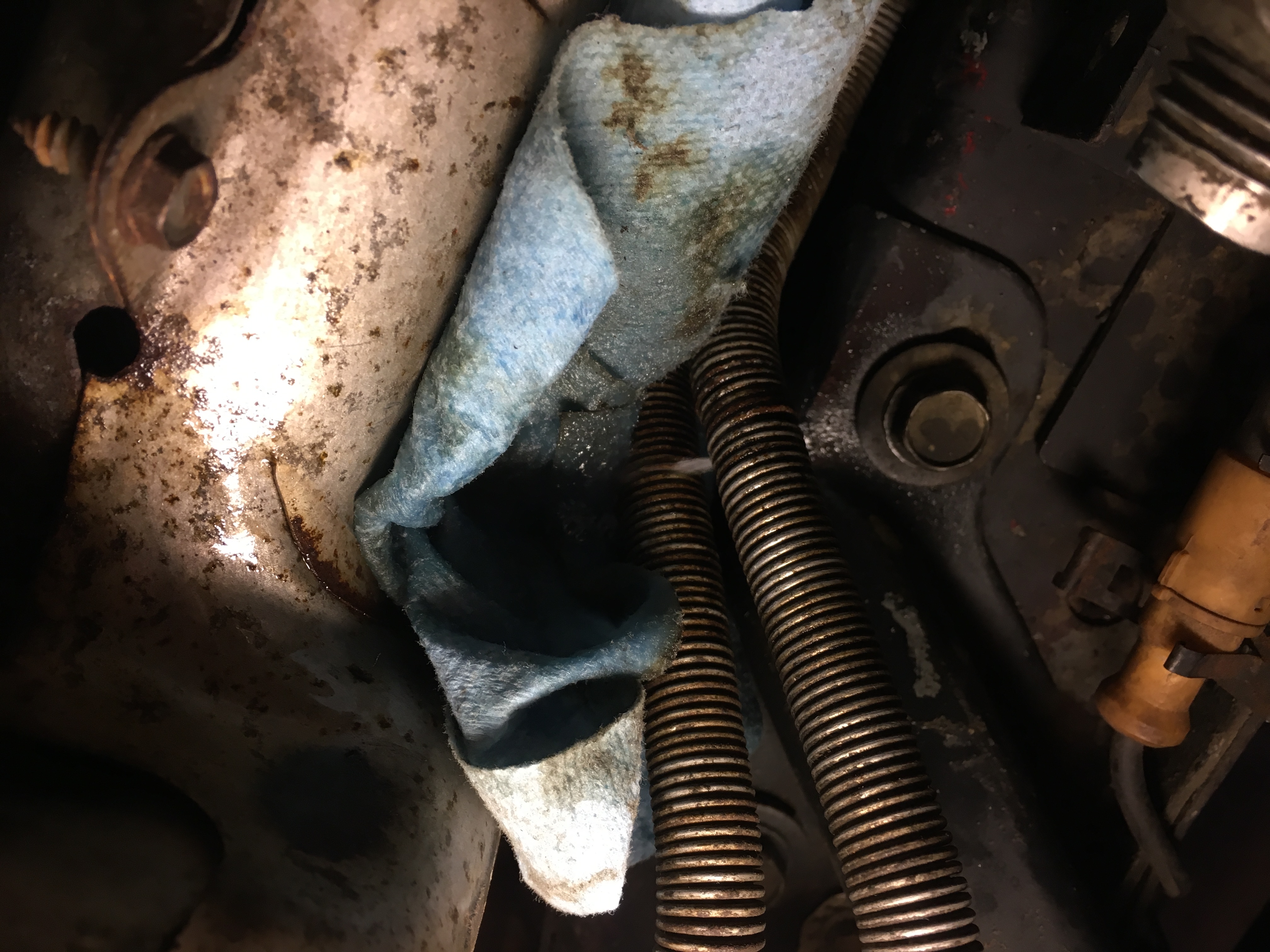

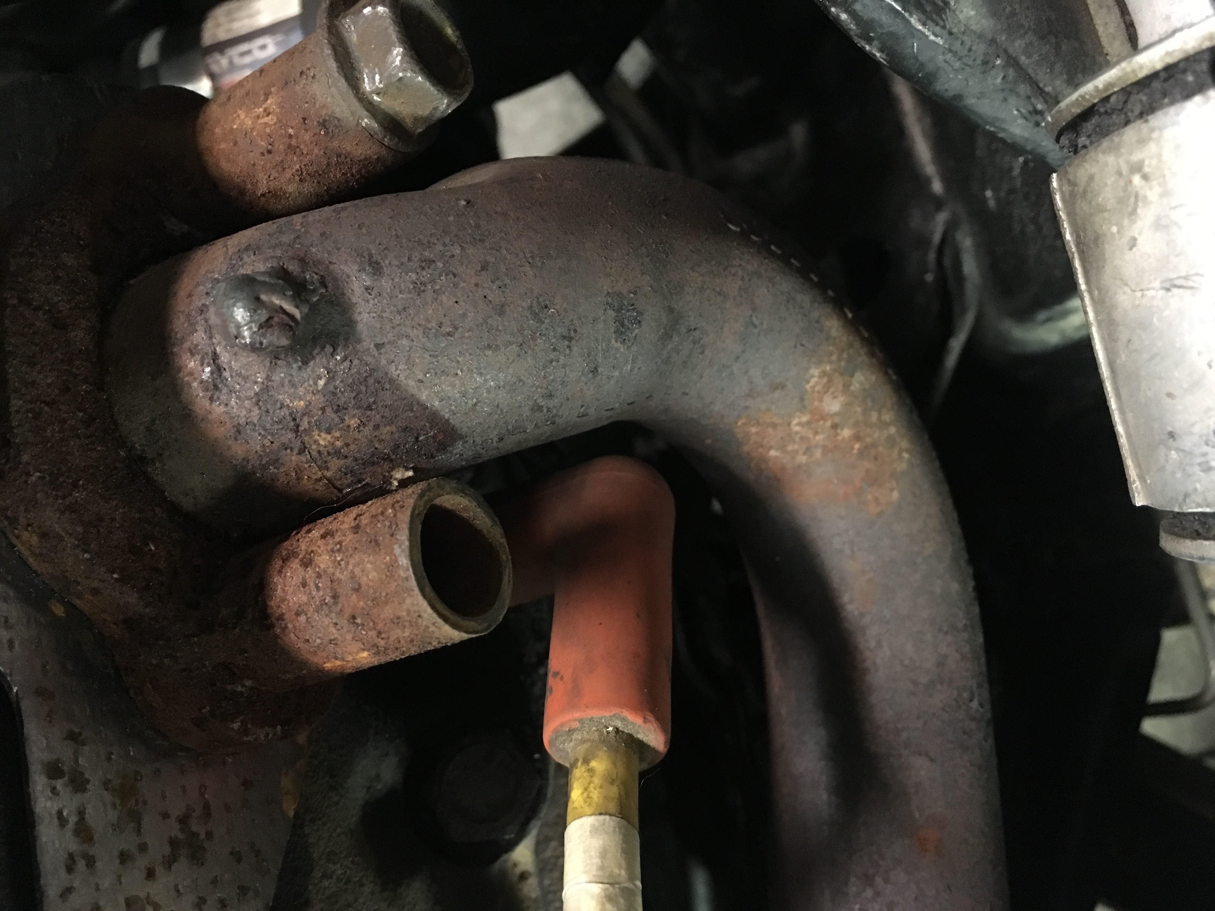

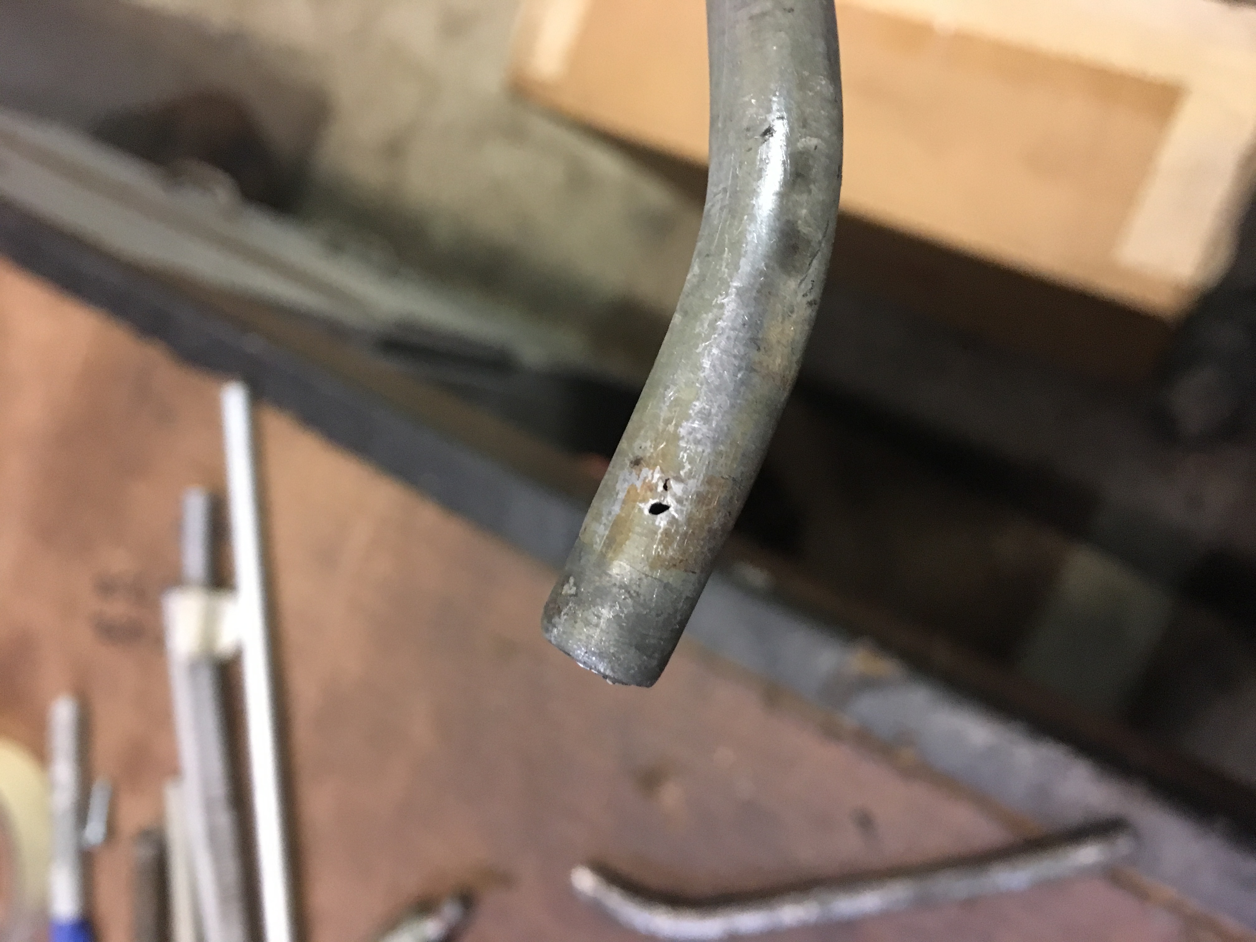

The fuel line rusted out from the inside

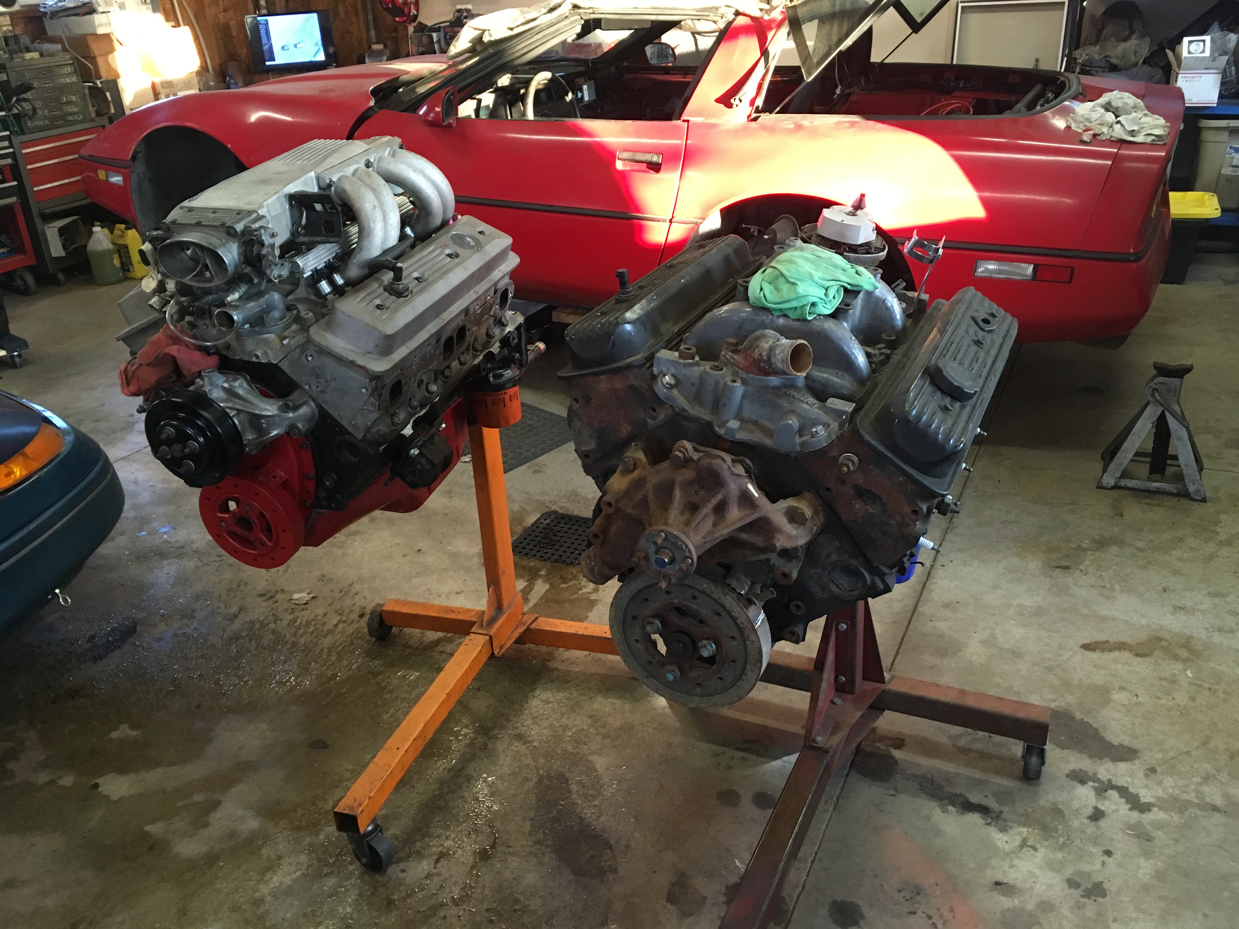

Once again Fred32v came by. This time we put the backup engine on a stand, then were able to start the car and confirm the transmission will go through all the gears. We then proceeded to remove the wounded engine from the car. We managed to spill some oil draining the spare engine other than that this was a fairly clean job.

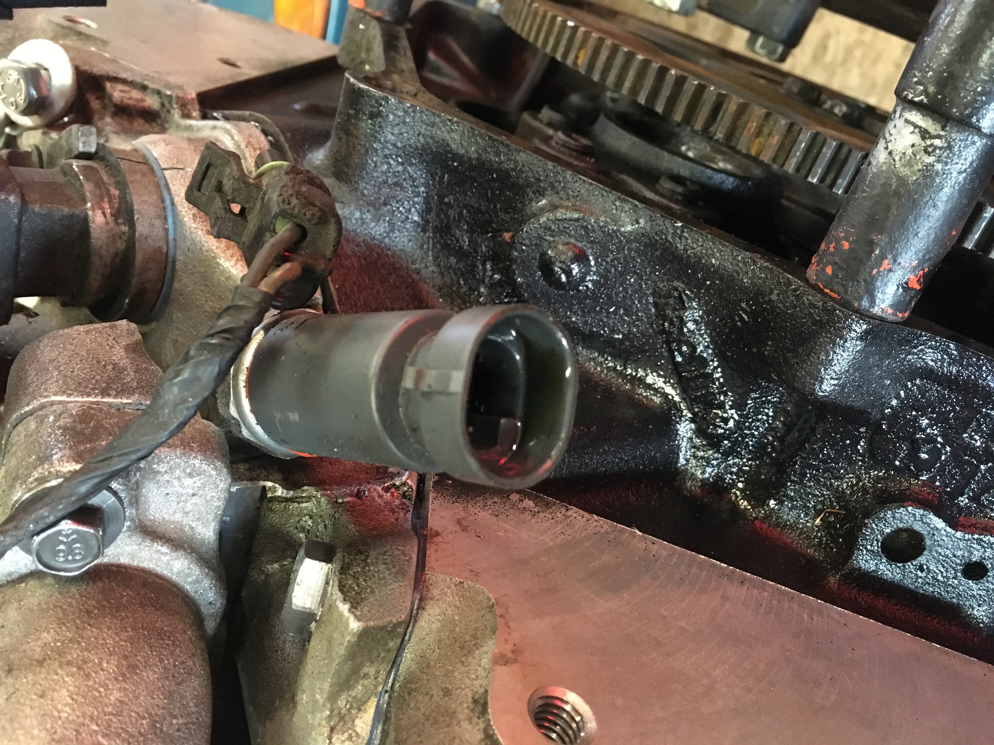

We also got to the bottom of the oil pressure sensor leak - it appears to be an internal leak of the sensor itself my guess it trauma from prior owner rebuild attempts.

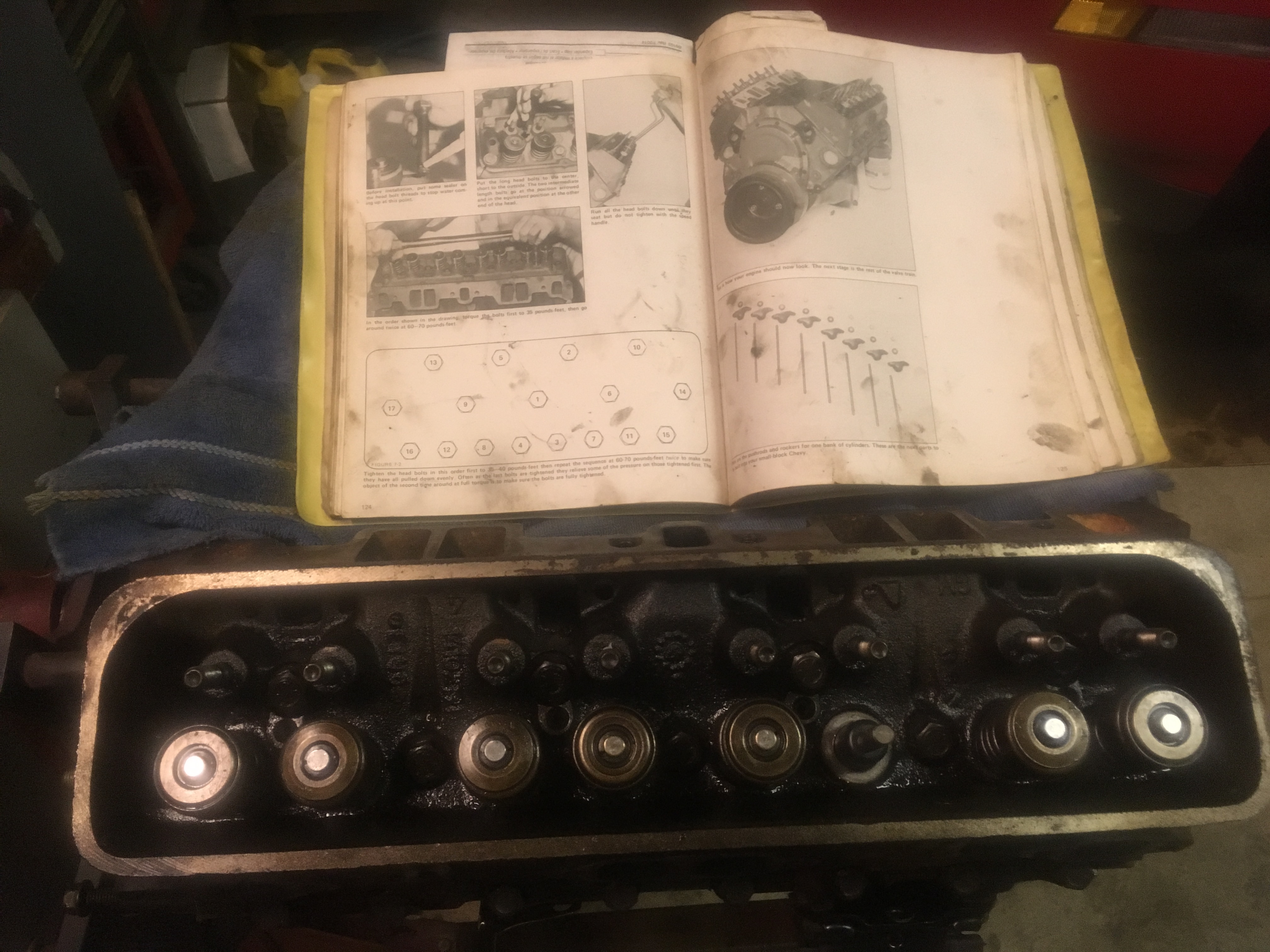

After some deliberation I decided to put Loren's engine in the car without a rebuild. So we started down that path. That engine is a 4-bolt main so my newly created windage tray will not work without additional fabrication. Nonetheless we can use the factory windage tray. This engine used to have one and it still has the factory bolts. While apart we looked at the bearings. Mains are .030 under and rods are .010 under. We're thinking this was rebuilt once before. Beside the bearings the windage tray bolts are in the wrong place and the #4 intake valve seat was machined incorrectly.

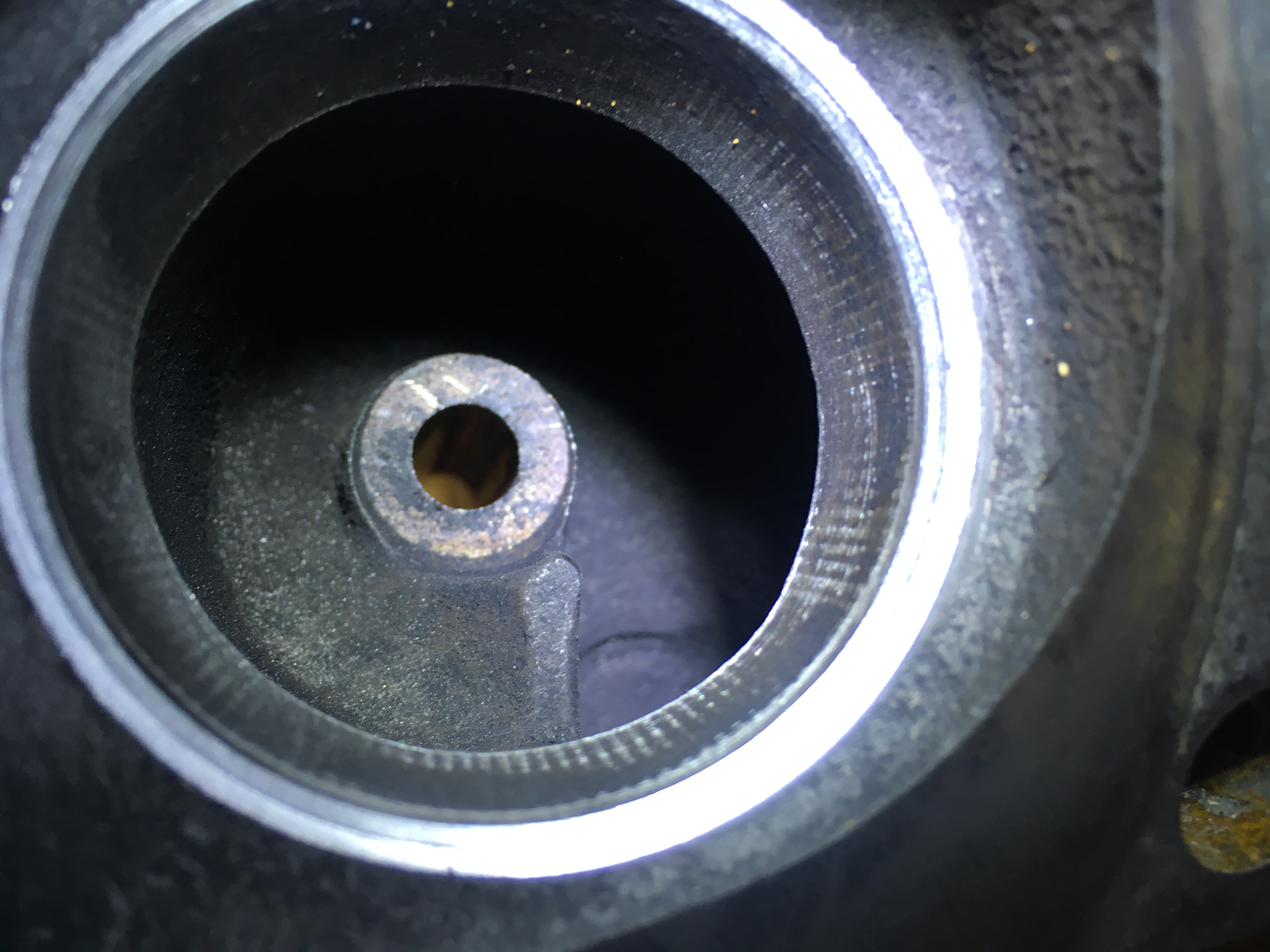

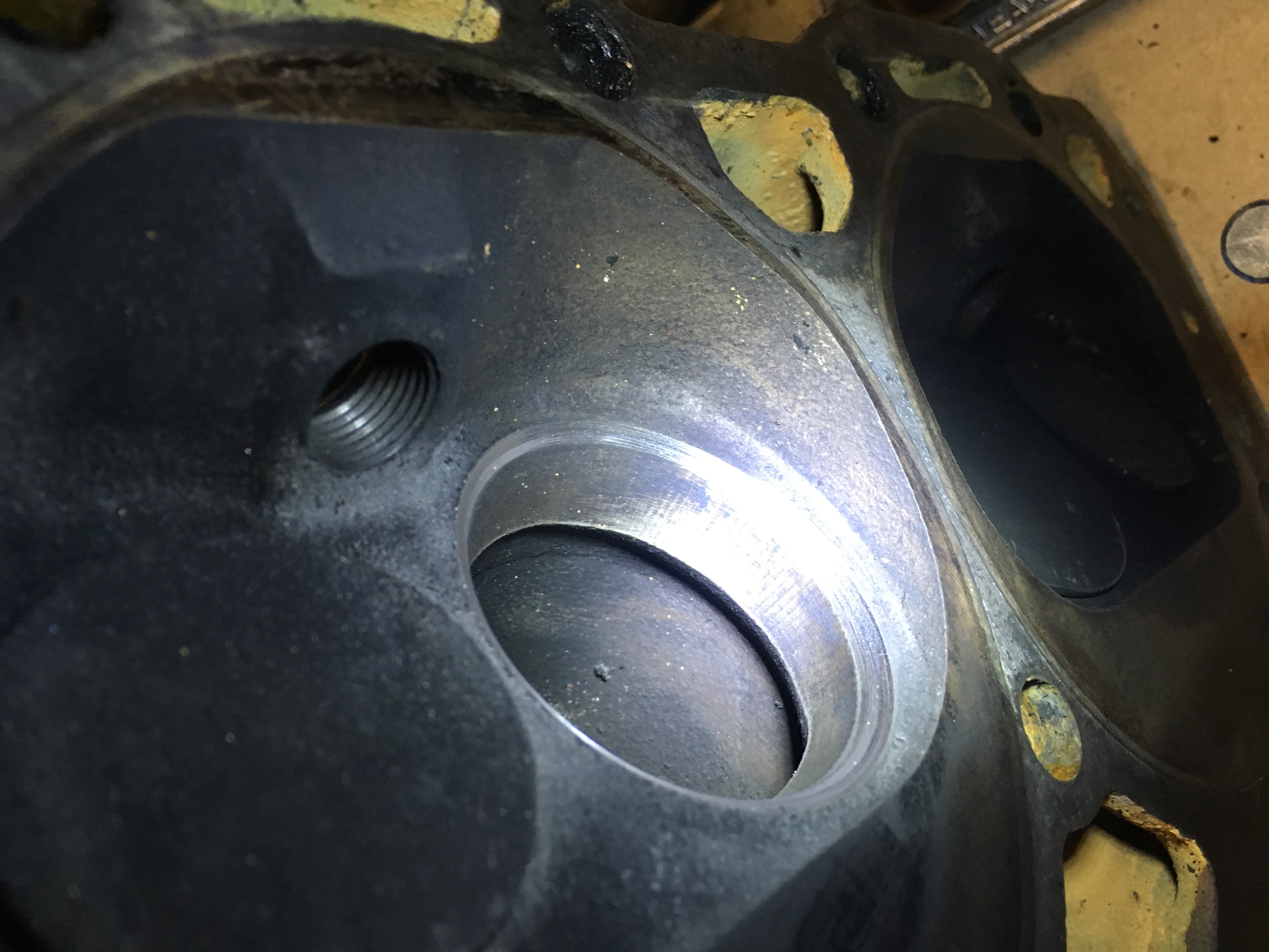

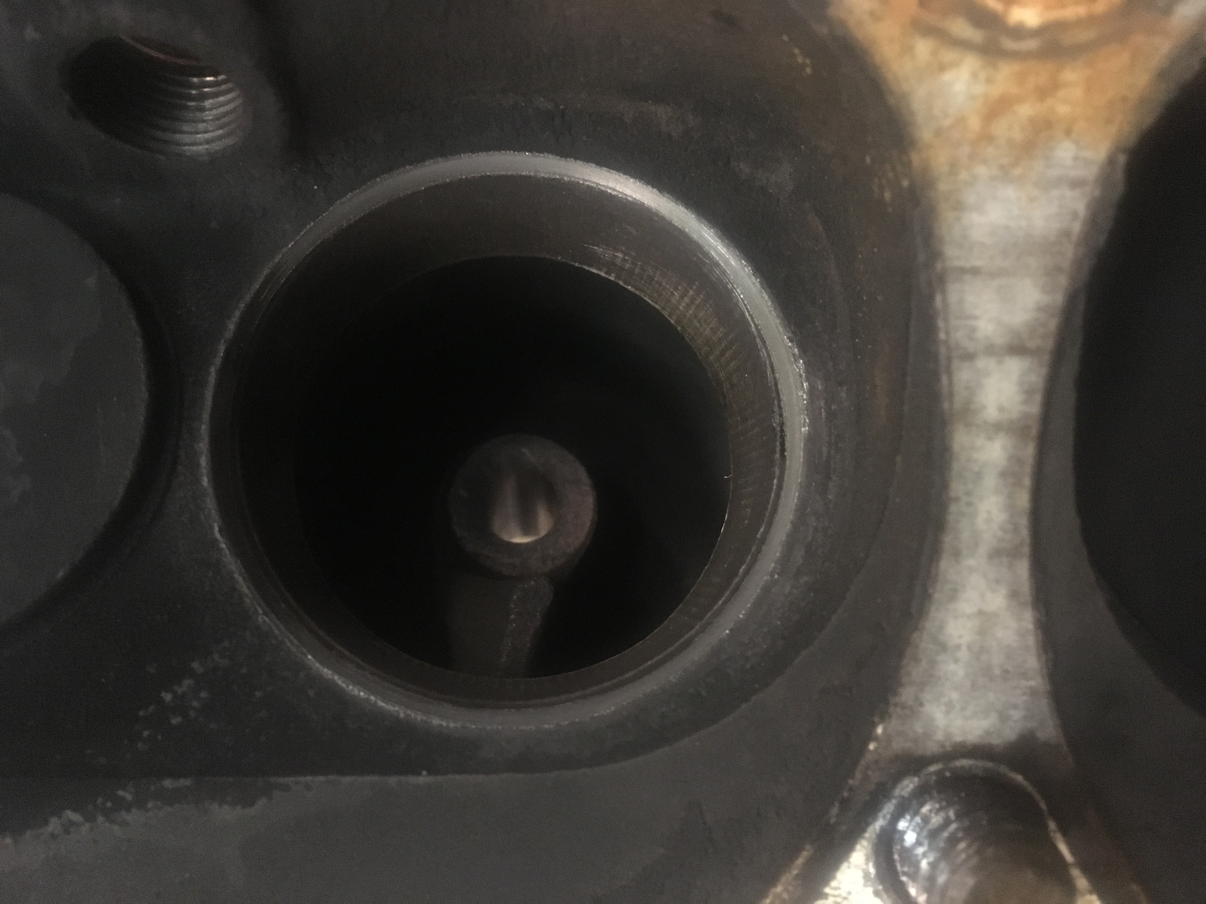

While changing the valve seals today we used air to keep the valves up and noticed the #4 intake valve leaking. This required removing the head where we discovered the valve seat problem. I plan to send this to a machine shop to get this one seat corrected.
The bores look good and the valve seat I checked looked very good.

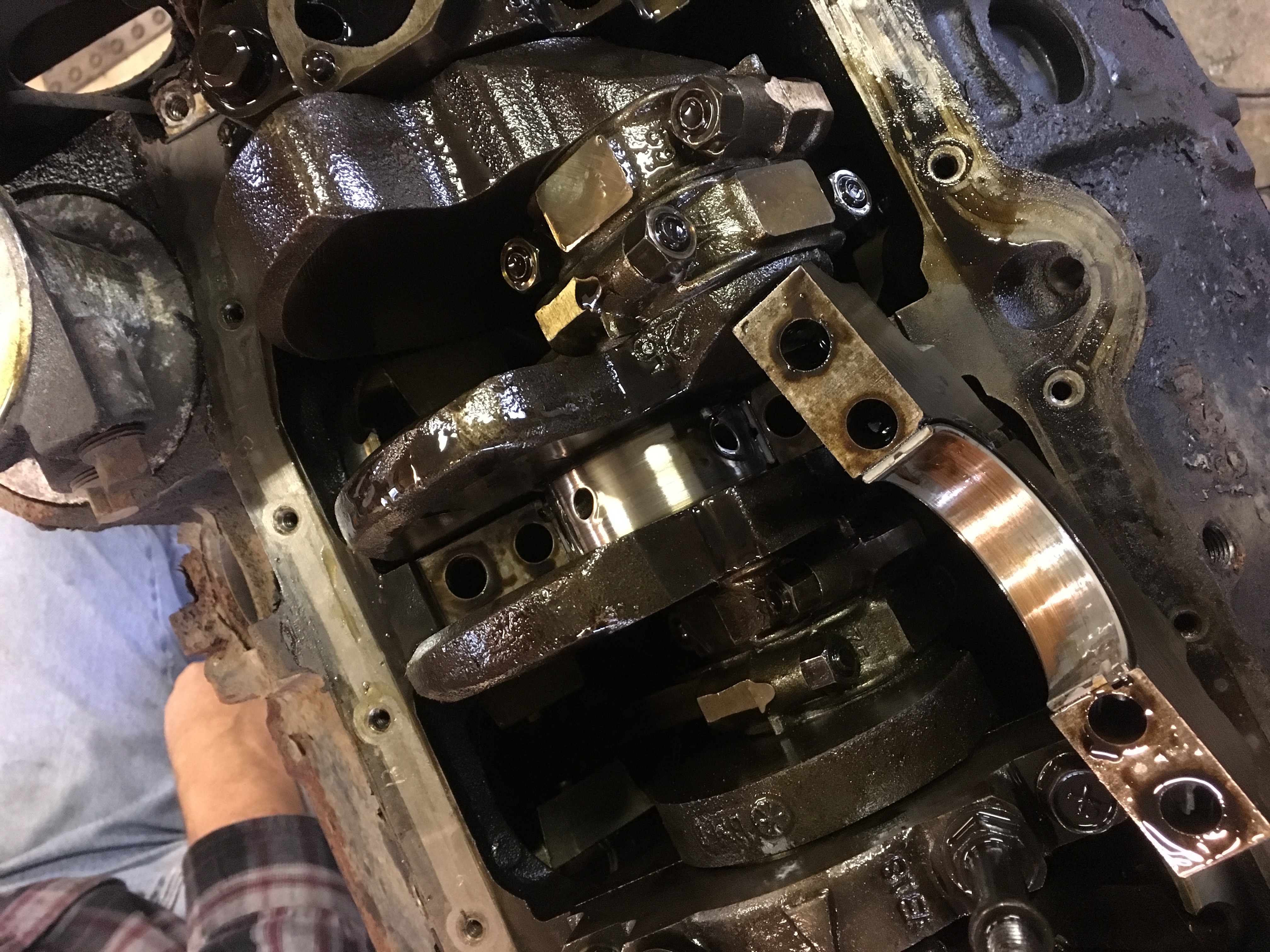

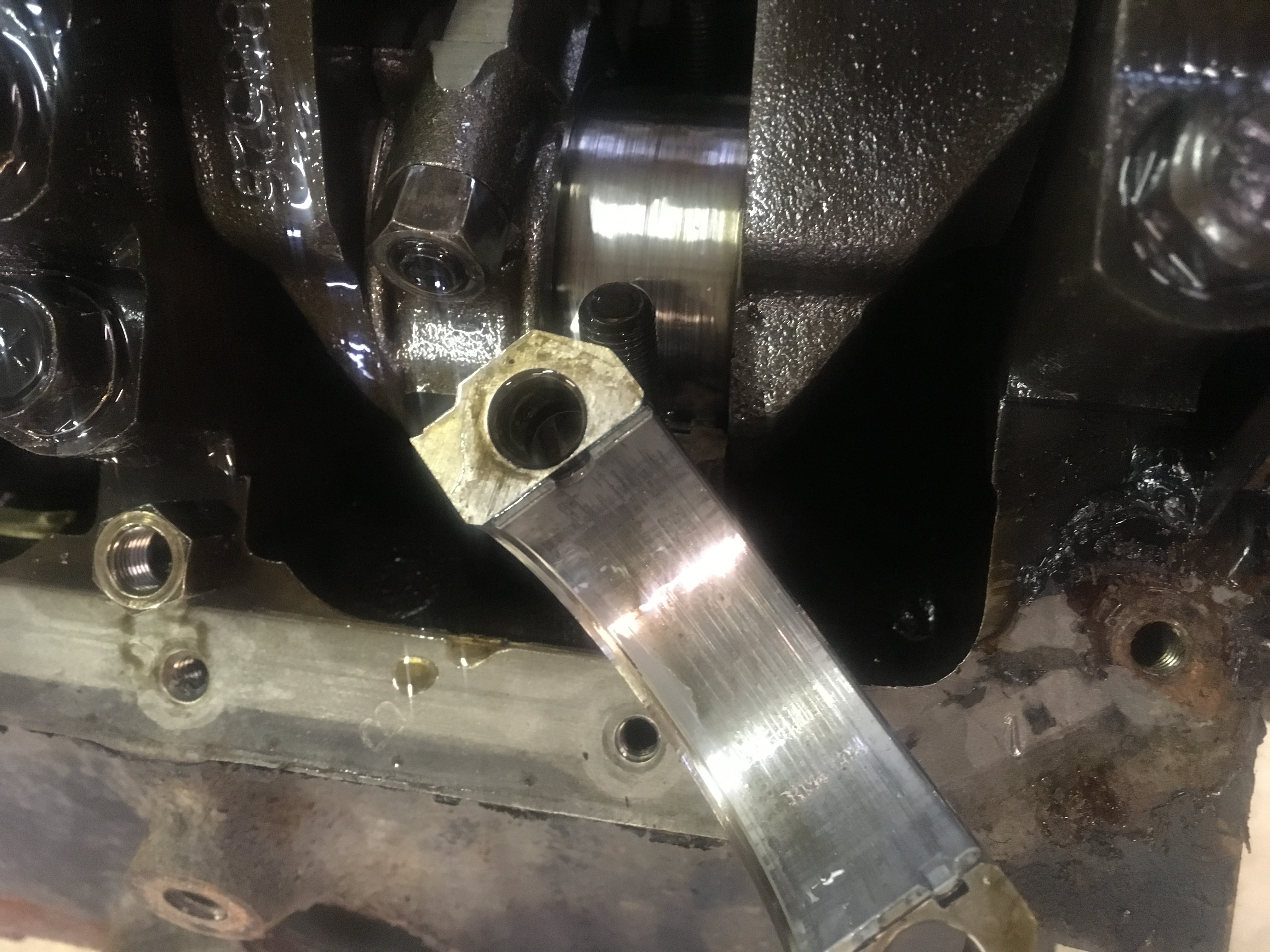

The mains we checked showed some copper which I was willing to live with til I started thinking about it more. With the valve problem I will spend the extra time and $40 to change out the bearings.
Also learned that the truck balancer pulley has the wrong depth, the truck flexplate is larger diameter than the Vette, the truck harmonic balancer is larger diameter than the Vette, and the truck oil pan is smaller than the Vette pan. Unfortunately the reduces the # of spares I can get from the truck engines.

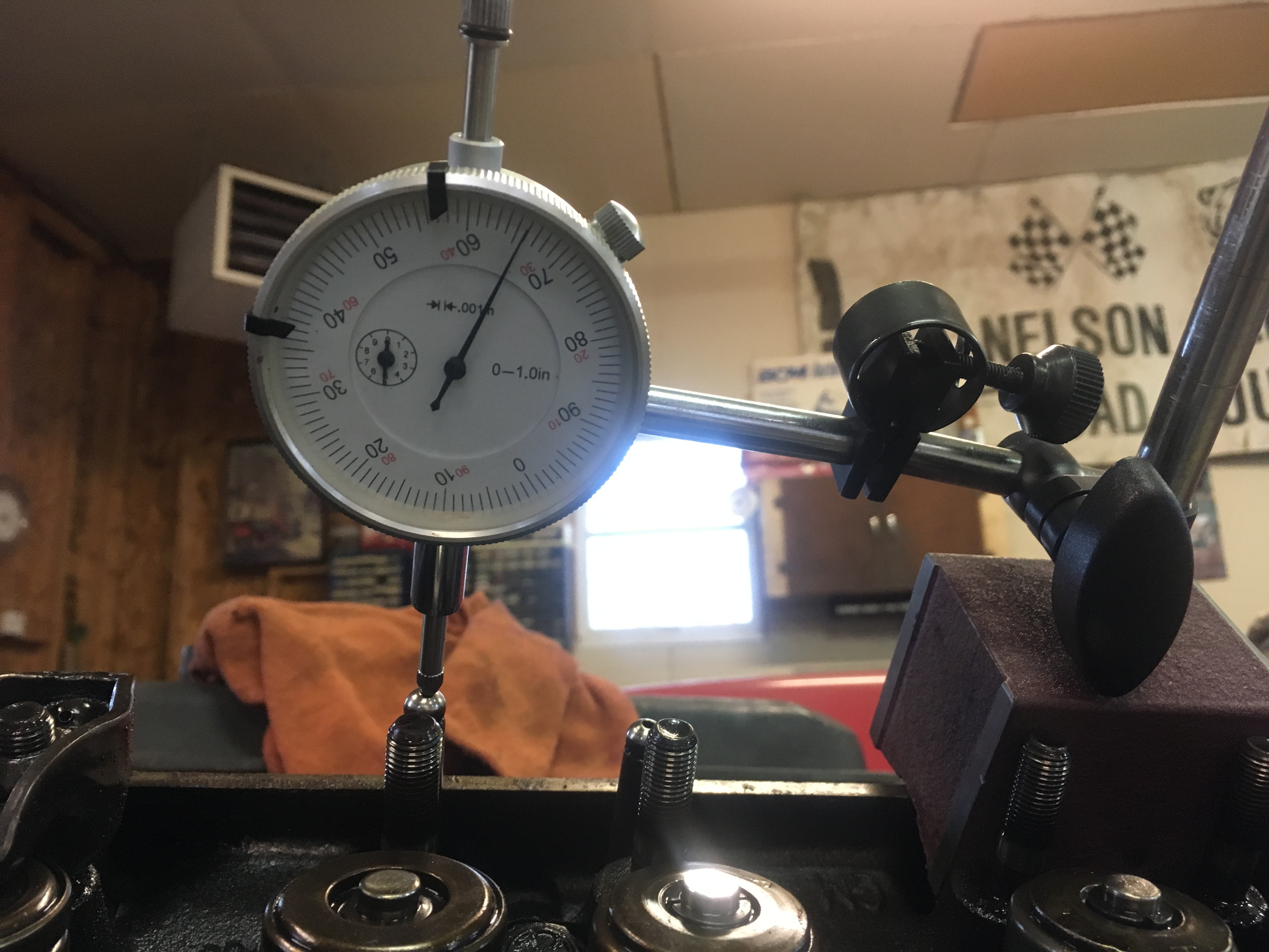

I confirmed the lift with the dial indicator

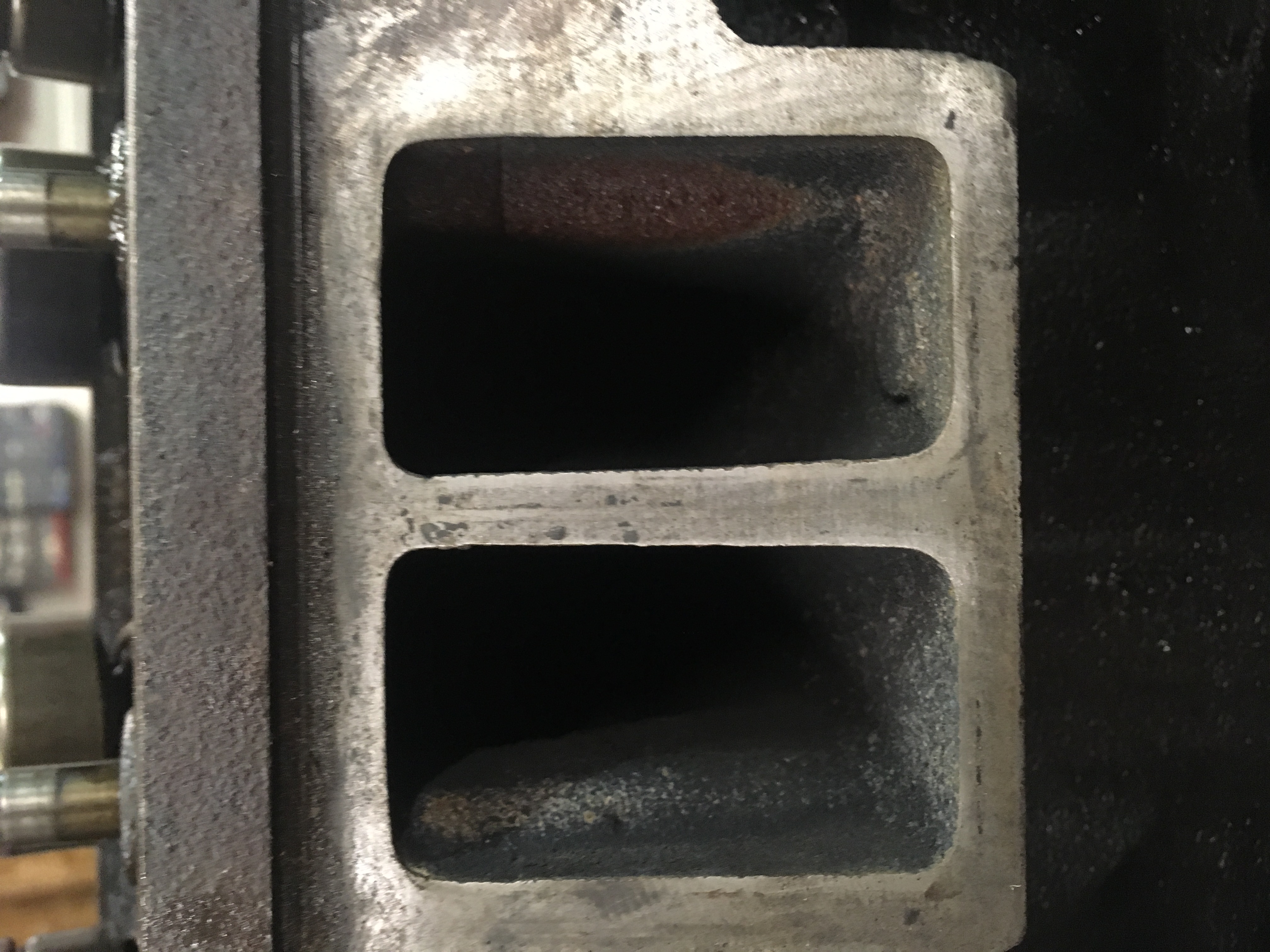

So the head went back on and the valvetrain. These ports on the truck heads are odd and I think they stink but I resisted spending a lot of time redoing them I want this thing running.

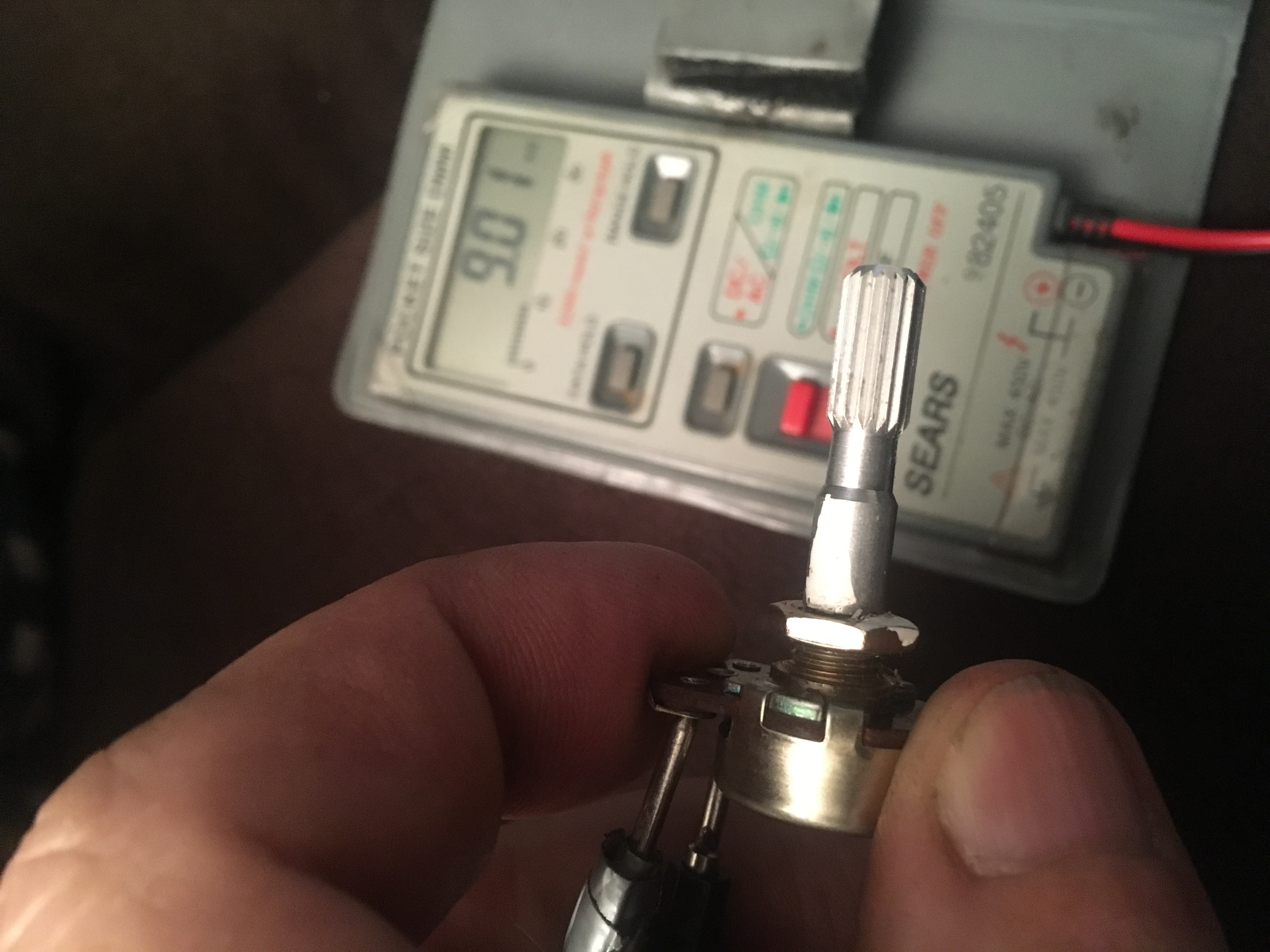

The other obvious problem is the engine temp sensor. This gives high resistance when cold. I had already tested resistance of the sensor it looked OK so I just disconnected it for good measure - no luck.

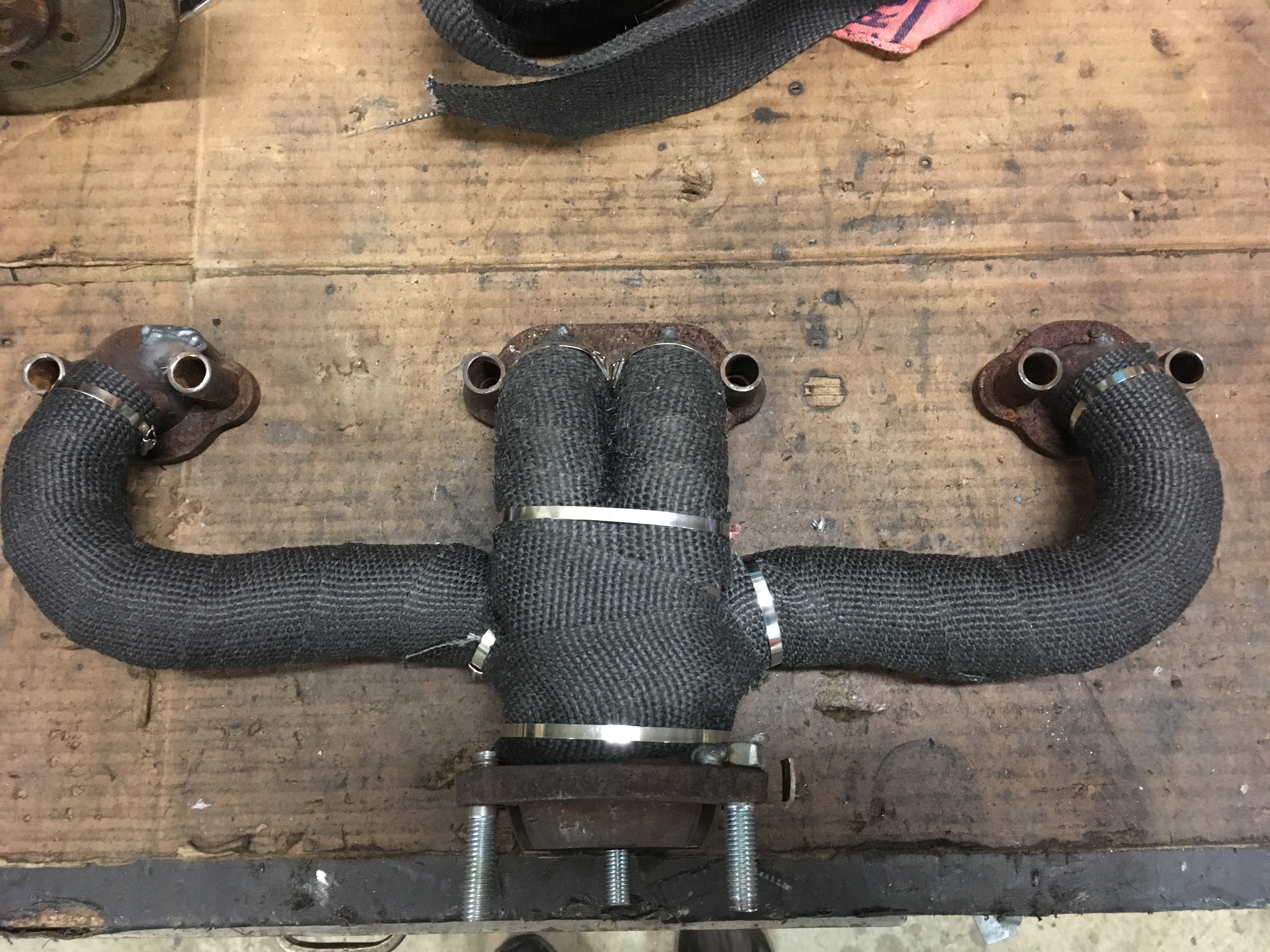

Confirmed the 84 Vette had straight plug configuration so the 84 headers should work with the truck heads on the backup engine.
