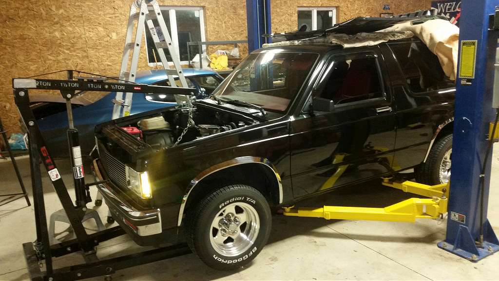

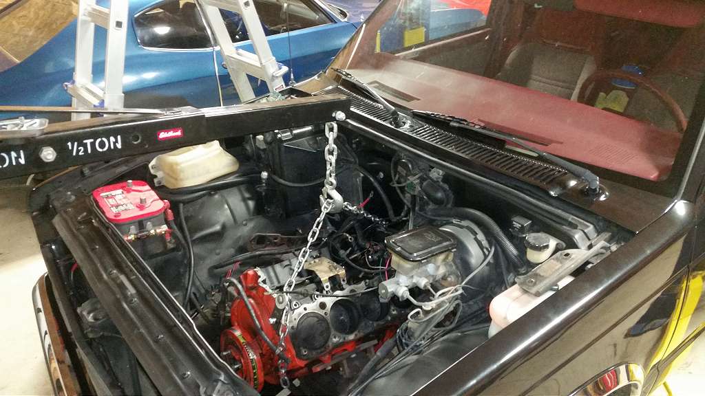

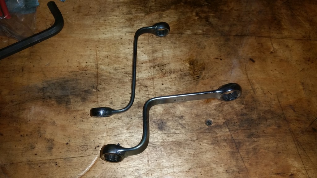

Made a lot of progress on the Blazer today. The engine and trans are ready to come out. I bought a wrench set at Turney's the other day, it was a collection of box end wrenches. There was 1/2-916 combo, and 9/16-5/8 combo, so for $15 I had 2 chances to bend a good wrench. I heated them up till glowing red and used channel locks to bend them. Worked really good, but ultimately, still can't get the bolt loose.
I txted Chris to see if he wanted to come over later afternoon and pull the engine. I thought I was almost ready to pull it out, and that the remaining tasks wouldn't take very long. Well they took longer than expected, so by the time he had to leave, it wasn't quite ready. After dinner, I was able to get the last little bit done, and the engine is now connected to the hoist, and just needs to be lifted/maneuvered out.

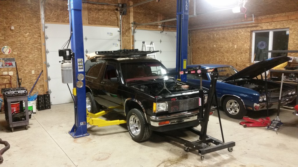

One small problem, was that the legs of my hoist hit the suspension, so I have to have it up either on the lift/jackstands, whatever. But right now, it's backwards on the lift (front pointing out) and there's probably not enough concrete floor to roll the hoist back when removing it. So, I need to set it down, and get the truck turned around in the garage before I can go further.

So my custom wrenches turned out pretty good, but ultimately, I couldn't get that bellhousing bolt un-done.
Last night's project was getting the truck turned around.

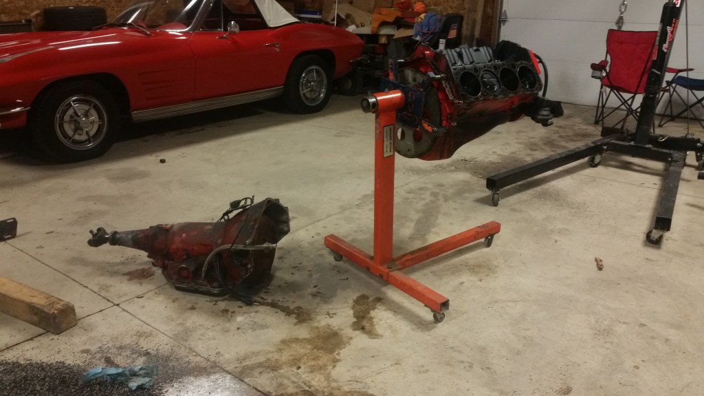

Tonight, Chris came over again, and we got it out. Not without spilling a ton of trans fluid in the process, but otherwise fairly easy. We did get it out as a unit and then split them on the garage floor. Time to clean some parts.

I know that these are really pictures of Dave's garage, but, the two
classic cars in the background, coupled with an engine block on a stand,
a trans on the floor and cylinder heads by the garage door make me
think this is kind of how "The Basement" looks!! NICE!!!

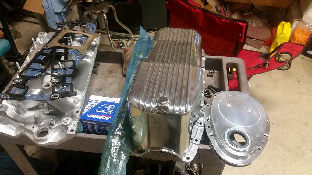

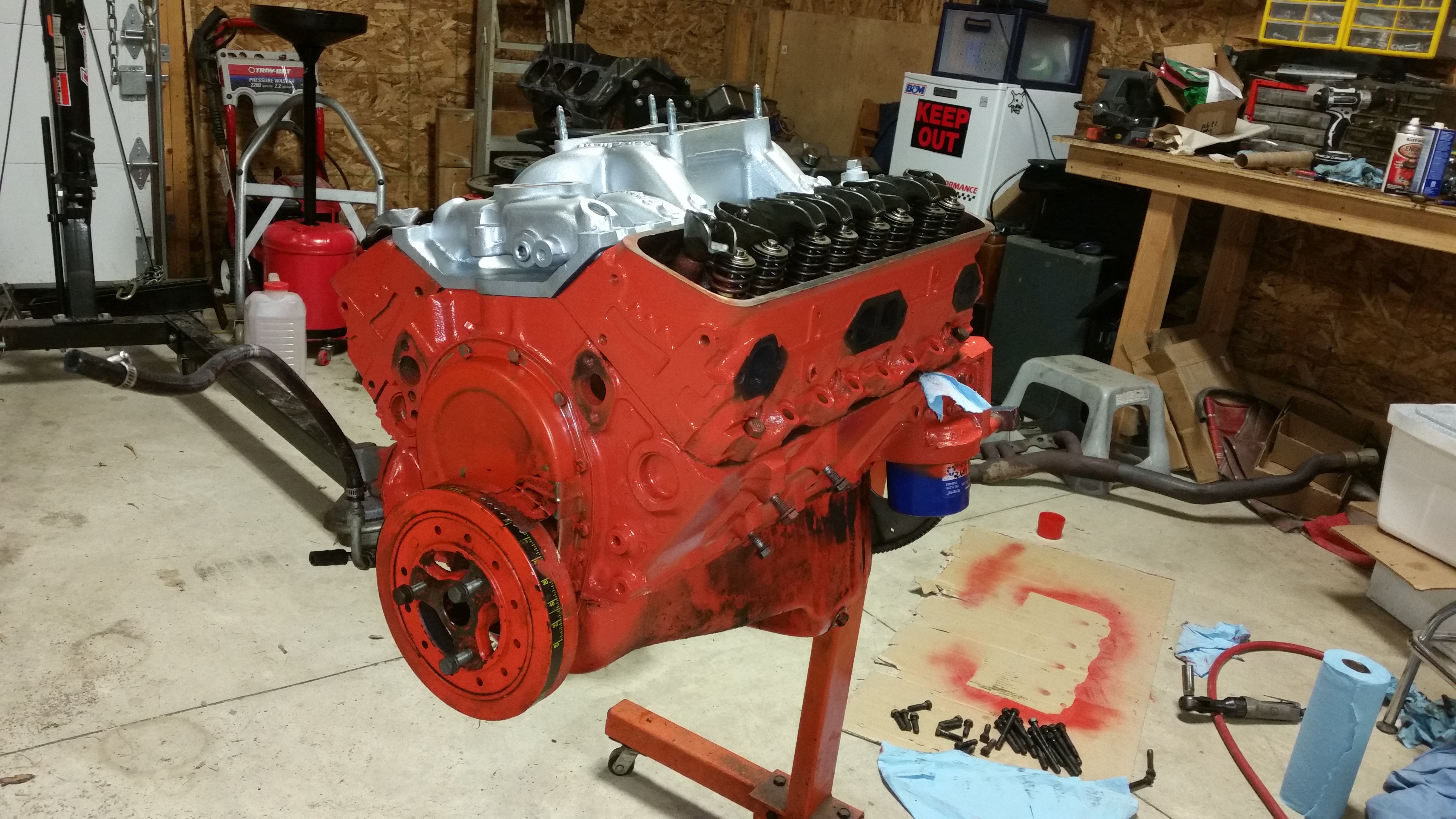

So, lots of progress recently. I got the engine fully torn down to the short block, removed the old cam and installed the new cam. Everything is scraped, ran a thread chaser threw all the head-bolts holes, and all the exhaust/end-mounting holes on the cylinder heads. I have a coat of paint on the block and heads, and even a little polishing on the cast aluminum oil and and timing cover that I previously had on the Chevelle's 406. I also pulled my Weiand aluminum water pump off the shelf. This thing should look pretty nice.

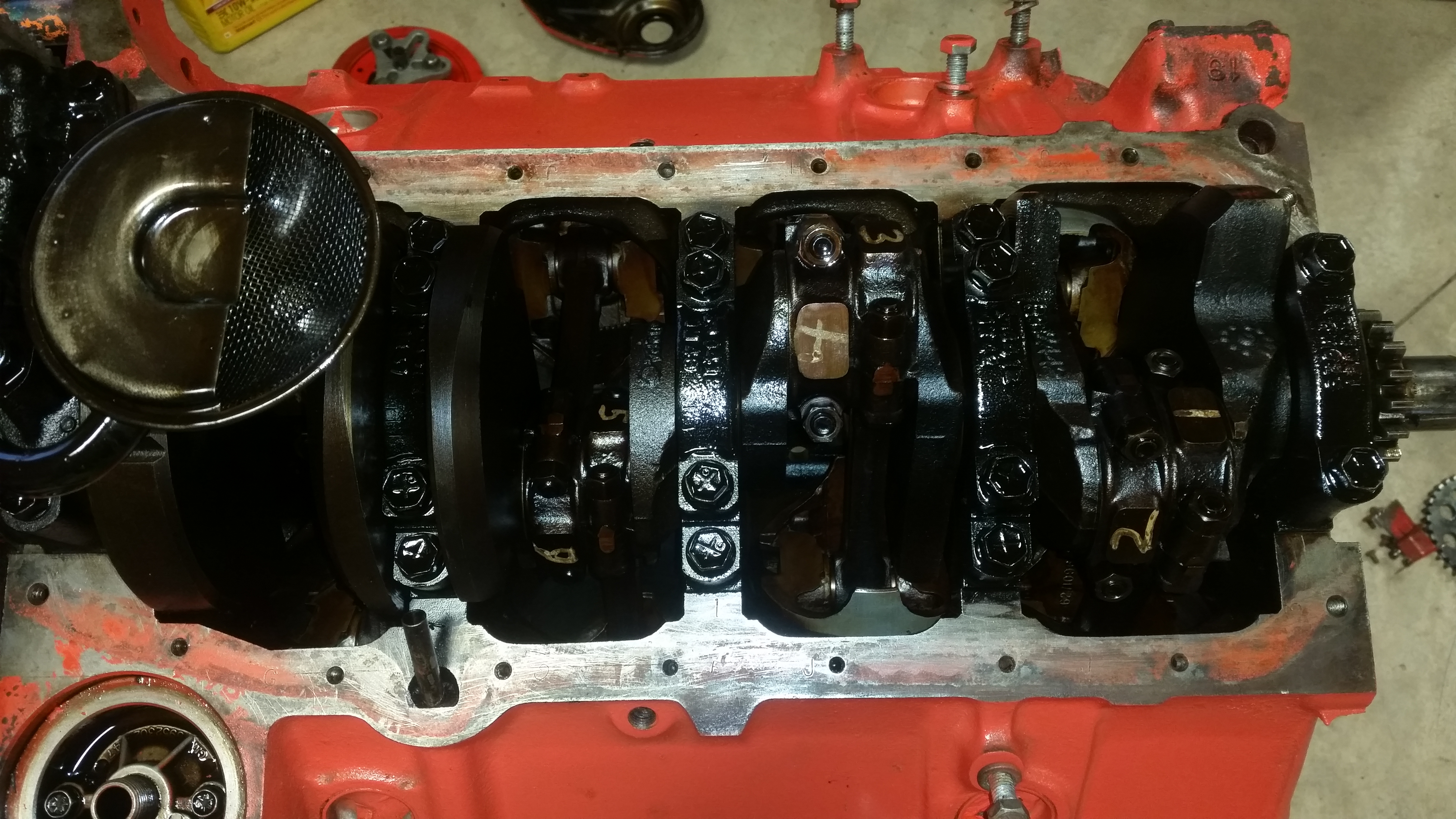

So the good news is, it's a 4 bolt block. That's nice, I guess, if un-needed. The other news is thing was rebuilt by someone else. I had my suspicions when I found paint coming off of the chrome timing cover. But the writing on the rod caps spells it out. I still think this is a solid short block.

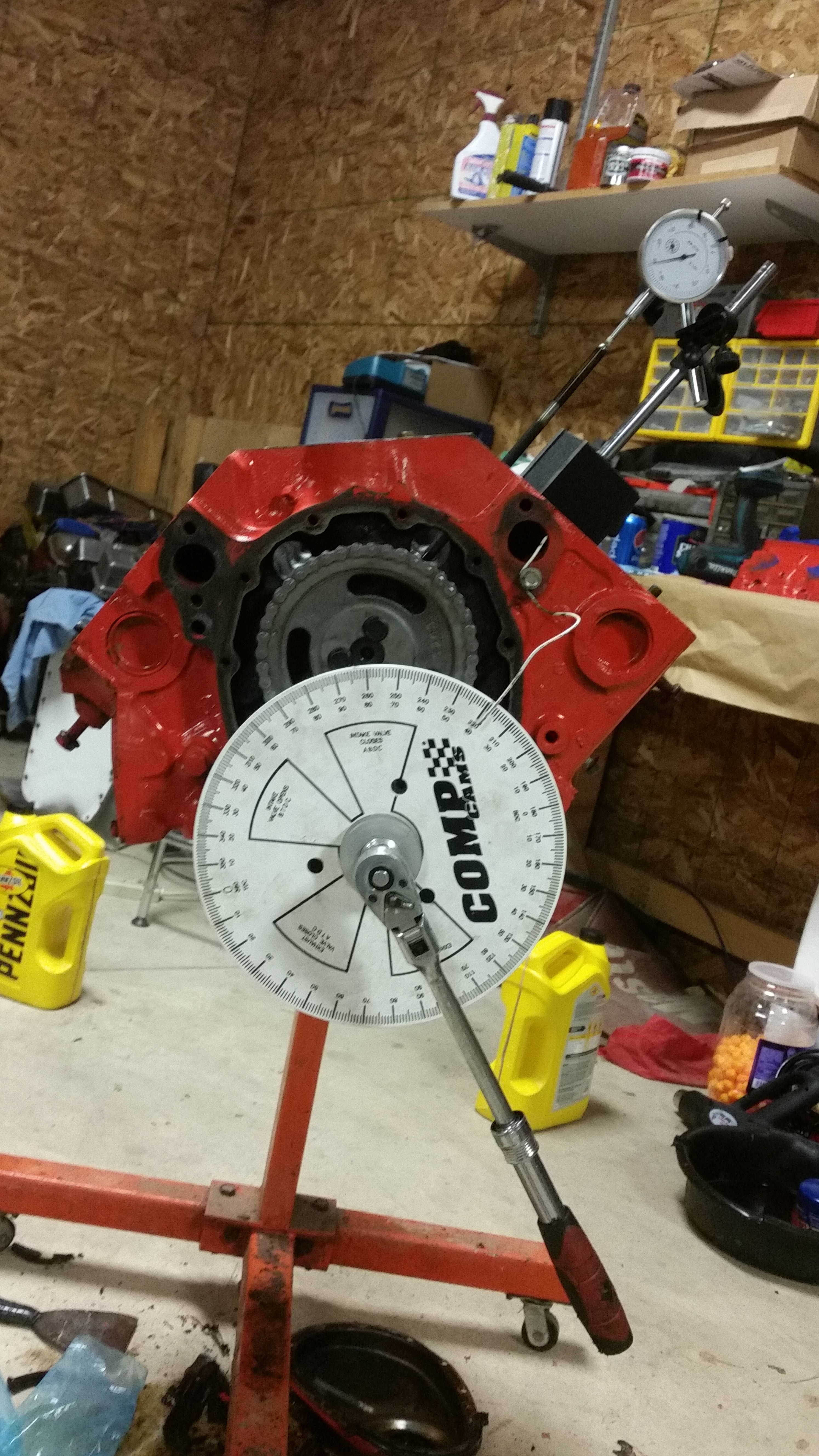

I bought a Lunati HFT 219/227 468/489 lift cam -- basically the HFT version of the cam in Tony's car. It cost more than Summit cam I was planning on buying, but I think it will run pretty well. I also bought a set of springs for the Vortec heads. I went to degree the cam and I'm getting some incorrect numbers. Intake valve opening 4 degrees too late, and max lift is off by a bit. Not sure what to do there yet. I'll measure a couple other lobes first and see how they stack up. I may swap the cam at Summit for another if that's what it takes.

Is the timing gear setup adjustable? I know sometimes you can advance or retard them 4 deg. I've run into issues like this in the past, but it's been so long, I can't remember the solution. That thing should run real sweet when it's done though. I think you'll be so much happier driving it now and happy you went through the effort.

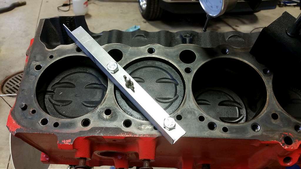

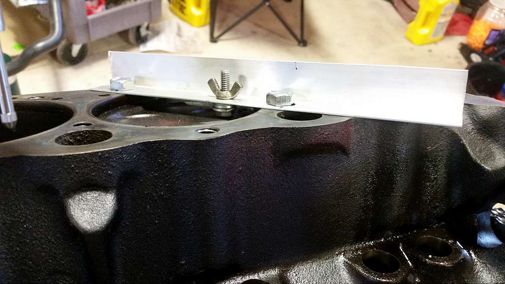

So, after making a proper piston stop for re-setting TDC using cylinder number 3, I got the correct opening and closing numbers for the cam. The lift numbers are a little short (.303 vs expected .312), but it was consistent on between #1 and #3. I'm calling it good and moving on.
Next step will be putting on the timing cover and oil pan. I have some nice polished aluminum pieces from inventory that I'm gonna throw on, plus I grabbed my aluminum water pump off the shelf.
