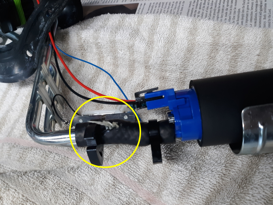

The FP wasn't the problem
We pulled out the fuel sending assembly to replace the fuel pump and noticed a blown out hose that attaches the fuel pump to the rest of the fuel system. What a surprise! This explains the 5 psi on the fuel pressure gauge. Too bad I already bad-mouthed the Delphi fuel pump. It was doing it's best to pump fuel through that hole in the hose. The hose was part of the kit that is included in the pump installation kit from Delphi, so Delphi was indirectly at fault for this problem. I found a piece of hose in my hose drawer and a couple of clamps and repaired the connection.
When we pulled out the fuel sending unit assembly we also saw the reason for the fuel gauge malfunction. The float arm was missing!! Obviously it was floating somewhere in the tank, but we couldn't see it. So I took a long piece of coat hanger wire and went fishing. As I did this, the float came floating by the access hole as I disturbed the gas in the tank. We fished it out and saw that it had just come undone from the fuel sending unit. It just clips in like carb linkage. To prevent this from happening again, Fred suggest using a very thin zip tie to fasten it more securely. This worked great.
Next we reinstalled the whole unit, adjusted the fuel pressure and went for a test drive. It ran well, but, alas, it still had the cough/bog issue but the fuel gauge is registering correctly. Back at the garage, we took a look at the fuel pressure gauge and it looked good, but I noticed that the vacuum was not attached to the FP regulator. My BAD! This fixed, we went out again to see the results. Problem solved! It now ran like it should (again). Next, I wanted to set the FP back to stock to see how it would run there. It is running well and happy for now (with the Delphi FP).
