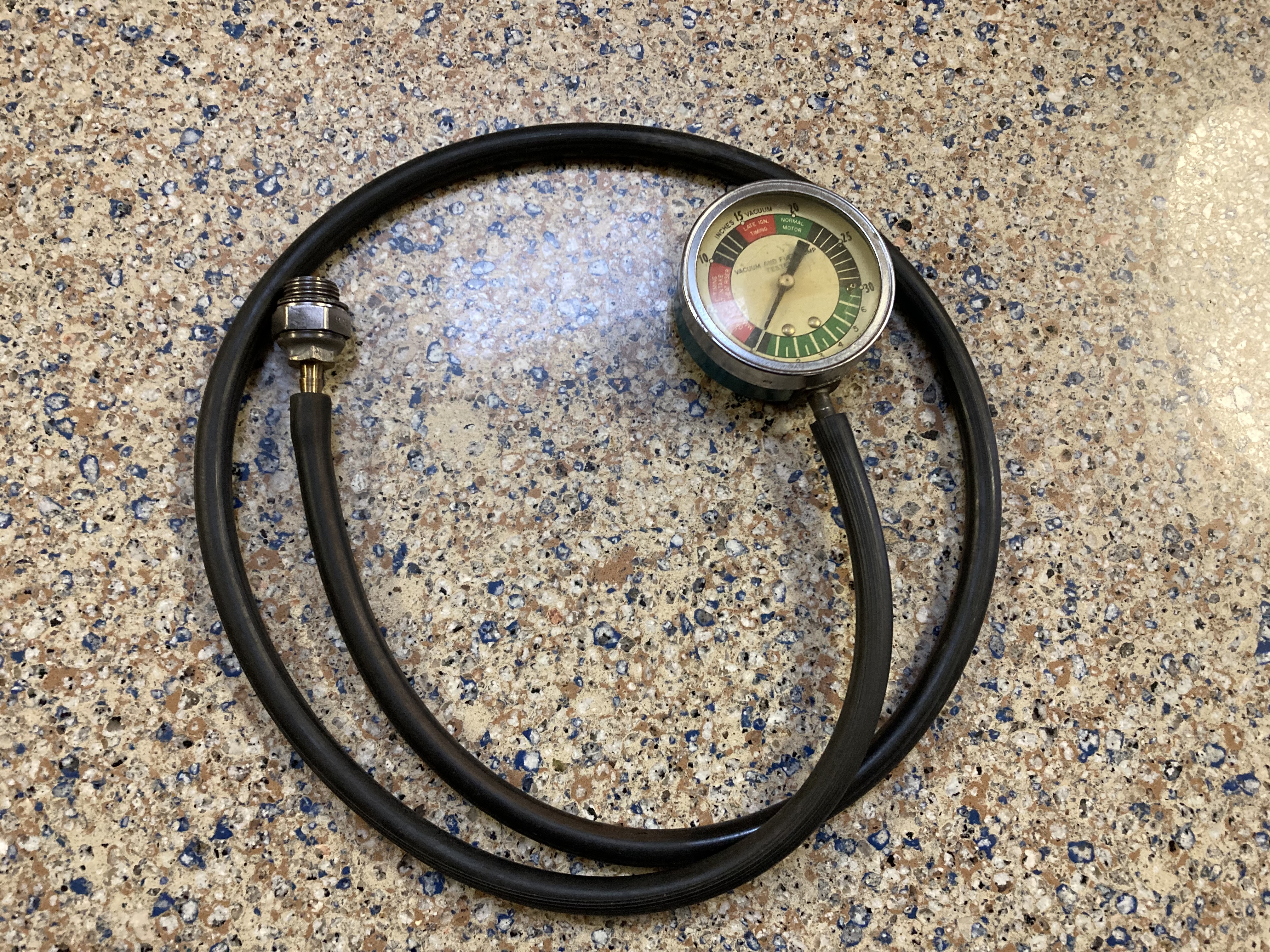

Maverick sent me a link to a tool on Amazon that measures exhaust system pressure. It simply threads into an O2 sensor bung and is connected by a hose to a pressure gauge. The Amazon ad states that 1 psi at idle and <3psi @ 2500 rpm is good.

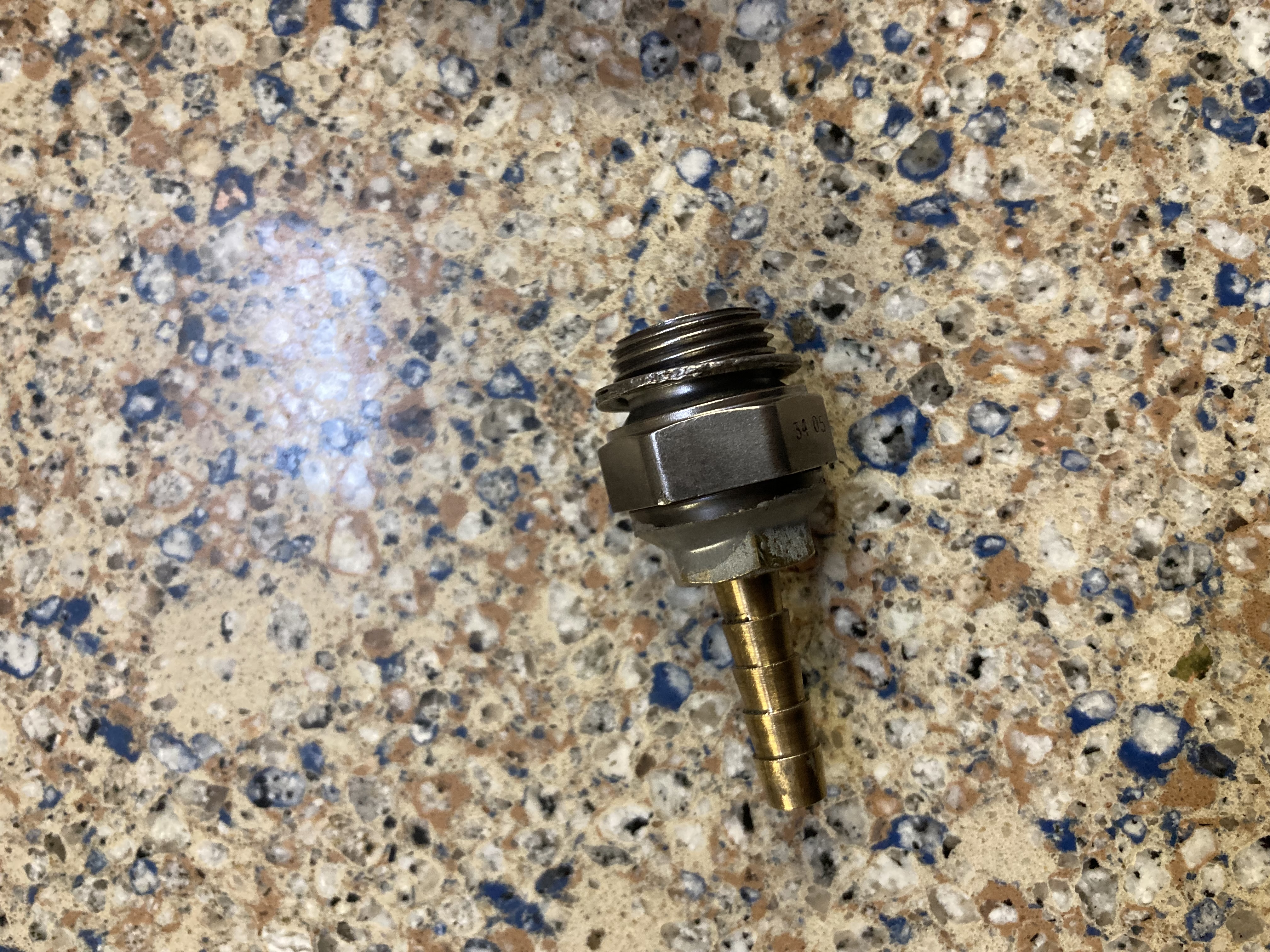

I decided to make my own. I cut off the top and bottom of an old O2 sensor and JB welded in a brass barb fitting and had this: Then I commenced to begin the testing process. I installed the tool in the O2 sensor bung nearest the engine so that I could get my initial reading of the whole exhaust system. The readings I got amazed me. They were .5 psi @ idle and .5 psi @ 2500 rpm on each side through the cats and mufflers! Great news (for a change). Now I know the whole system flows extremely well. Next step is to get the exhaust system out of there. I started the process yesterday and found that all my impact socket sets do not provide a 15mm socket! I was stopped in my tracks. They won't arrive from Amazon until next week. Oh well

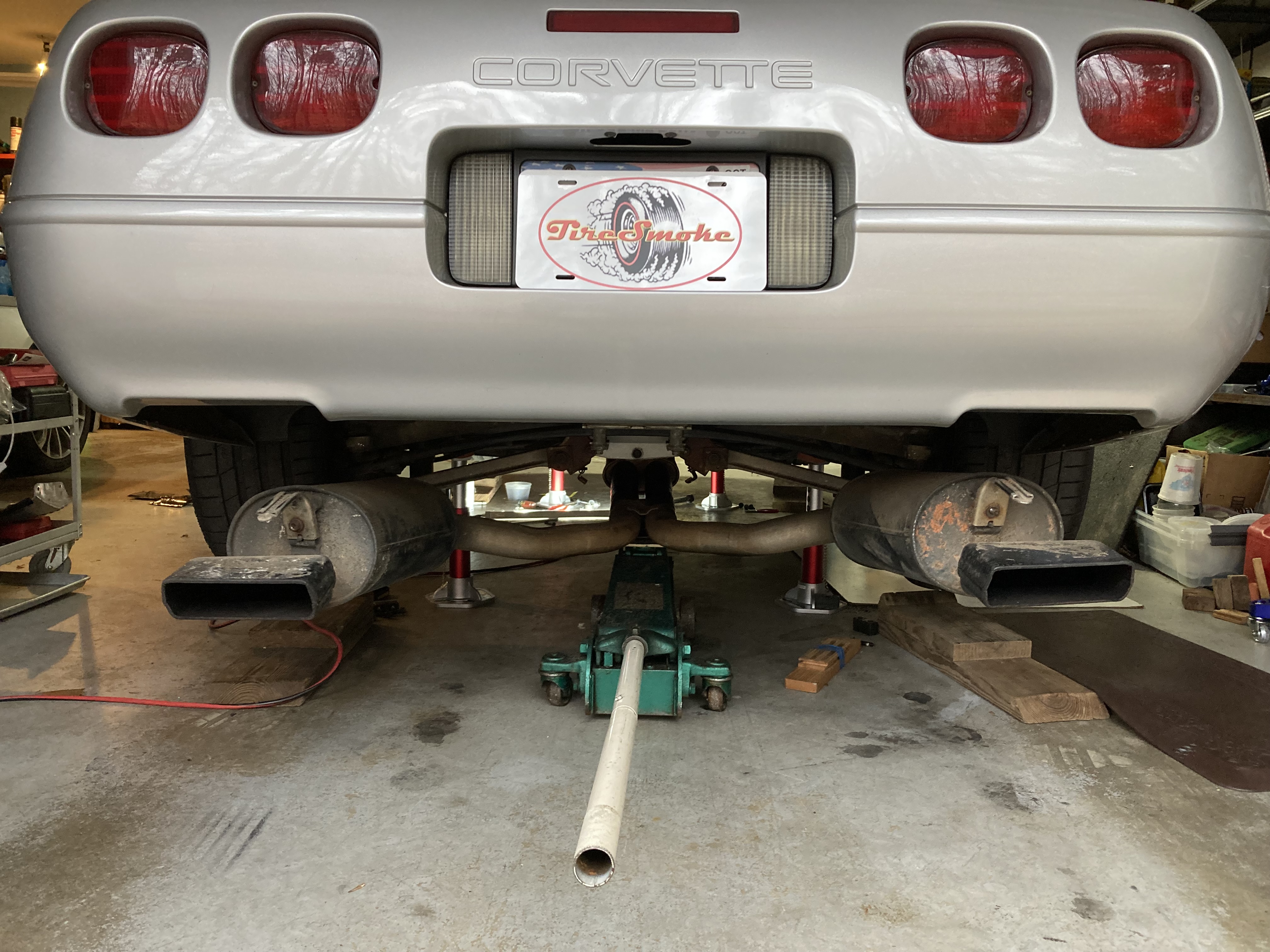

The correct 15mm impact sockets had arrived from Amazon and were waiting for just the right day to use them to remove Silvia's exhaust system. I was not looking forward to this job, but today I thought I'd get started and loosen as many nuts and bolts as I could. Never expecting much success, I was surprised when they all came loose without breakage. I was sure it would be a struggle to get the exhaust separated from the right side cat, so I squirted some Deep Creep into the joint and hoped for the best. I positioned a jack under the exhaust at the balance point and started rocking it back and forth from the rear and suddenly the whole thing just came loose. Easy peazy! I should be able to easily roll the entire system out from under the car but it is raining today and I need to figure a way to get it from the garage into my basement for storage until I get the rear end leak solved. For a change, Silvia gave me a break.
Maverick came over and helped me move the exhaust system into temporary storage in my basement. Now I turn my attention to the "C beam". It is an aluminum beam structure with a "C" cross section which solidly bolts the transmission and differential together. It's likely that I will have to remove it to get sufficient access to change the pinion seal. In researching to get familiar with this area, I read about one fella who had cracks that appeared on his C-beam where the mounting bolts go through it. In response to his issue, several posts pointed to a place in Arizona that sells a set of plates to reinforce the mounting of the C-beam. https://www.corvetteactioncenter.com/pr ... eam-plates . It seemed like a good idea to me, so I ordered a set. With the exhaust out of the car, this is a good time to do this, otherwise it's not really easy to add the plates because the exhaust system needs to be removed to get access to the C beam.

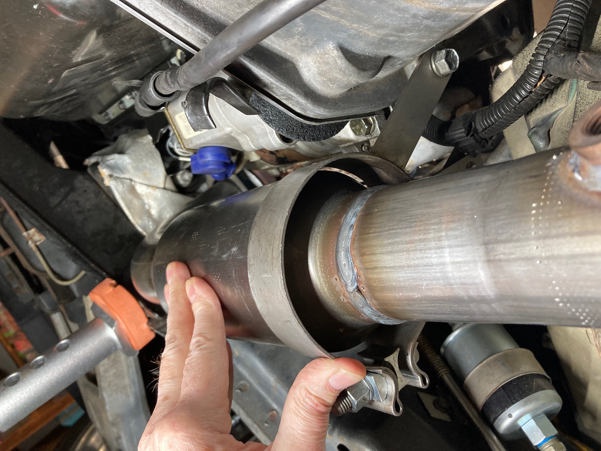

Today I did a test fitting of the new MagnaFlow "Direct Fit" cats. I started with the passenger side and ran into this:The hanger is designed to slip over the body of the cat (where my hand is), then attach to the stock bolt location. The vertical bracket in the photo is bolted in the stock mounting bracket location and the front end of the cat is bolted loosely in place on the exhaust manifold outlet to locate the assembly correctly. With the way this hanger is made, it seems to me that it can't work. I've opened up a trouble ticket with Magnaflow and sent them the picture you see.

If those were cheap replacements, I could see, but Magnaflow I'm sure charges a boat load for those things and thus makes it inexcusable IMO. Frustrating for sure.
I trust that by rotating that hanger 180 degrees the loop is still in the same place.
That hanger has to work on some model. Part of me wonders what changed on that transmission between years on the C4 to create this situation.
Yes, I thought of that, but the vertical bracket is welded in the center of the loop, so it makes no difference which way it is slipped on. If you look closely at the photo, this hanger has an additional bracket welded to the loop. It is a bit shorter and is entirely superfluous and makes no sense, at least in this application. I can't see how this thing could ever work.MostMint wrote: Fri Feb 10, 2023 10:05 am I trust that by rotating that hanger 180 degrees the loop is still in the same place
Ok. Could not tell for sure if it was center welded from the pic.
Where it bolts to the transmission- does the hole for that bolt go all the way through? Like if you put a longer bolt in there would it stick out the other side so you could hang the bracket on that side and put a nut on to hold it?
I’m improvising and not necessarily advocating this route, but if it work it could move the project forward faster.
No. The mounting bolt goes into a blind hole.

I'm with Paul, that's frustrating on higher priced stuff like that. Seems like you have some sort of semi-universal hanger. Hopefully they can just send you a correct bracket.
