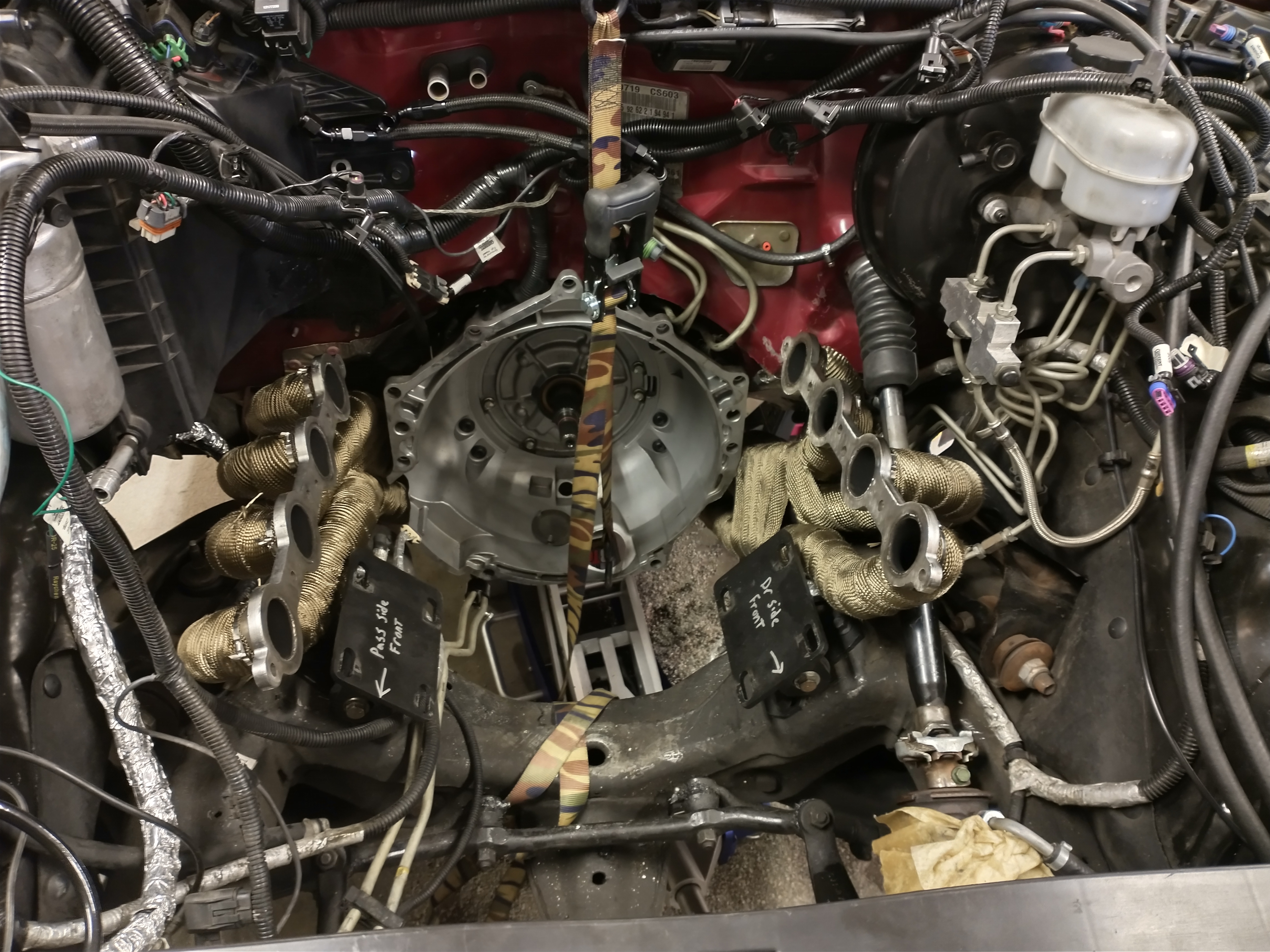

Wrapped headers and bellhousing back in place. Waiting on the motor now.

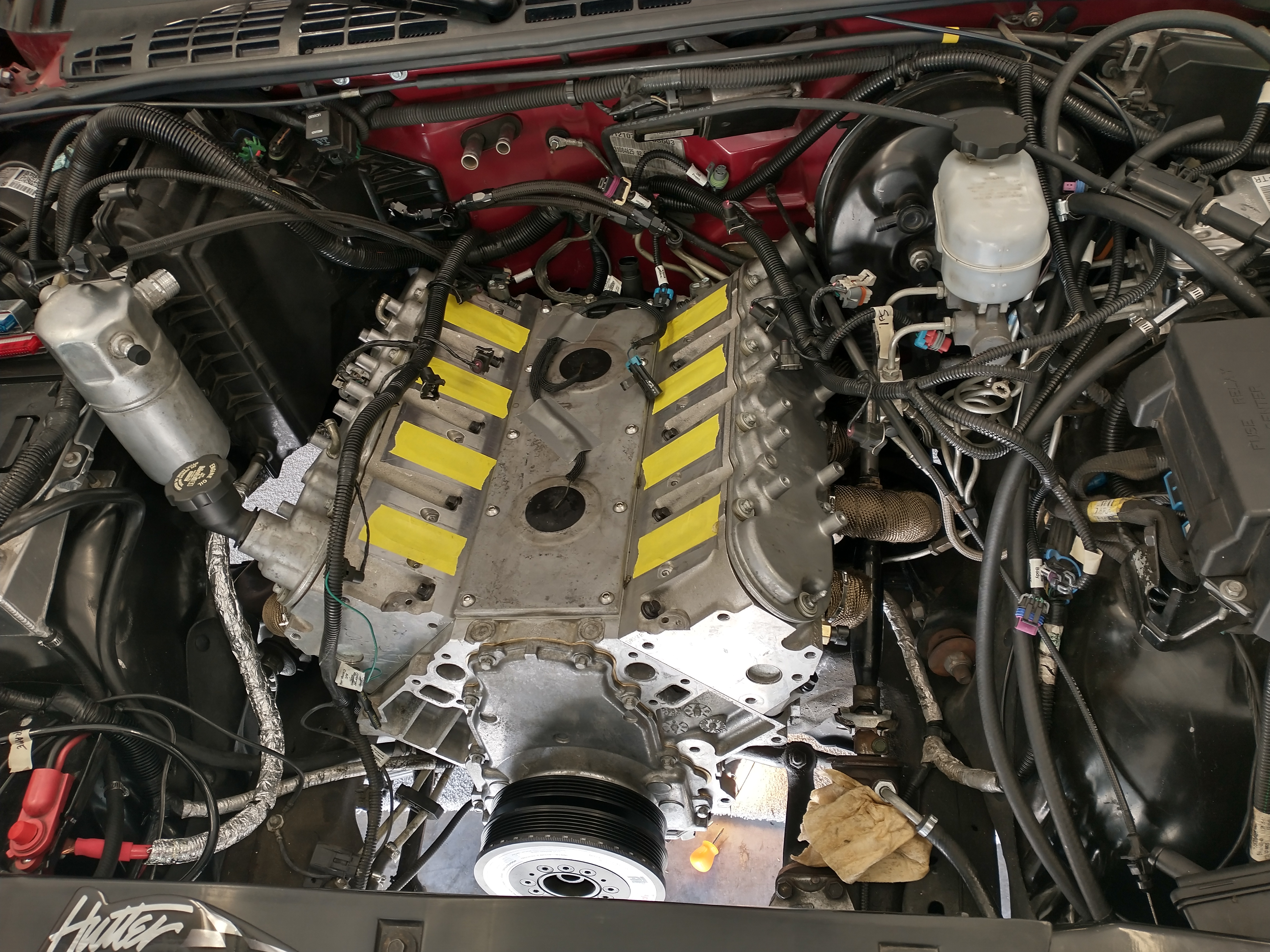

This weekend I put in about 10 hours getting the engine back in place. Fred helped me on Saturday for about 6 hours muscling the motor and trans together. The rest of the time today was just putting the rest of the bellhousing bolts in, getting the torque converter bolted up, and installing the starter.
Next up will be getting the headers and spark plugs installed. That should be another 6 hours or so. It's amazing how each little thing takes forever on this. Just remind me the next time I want to put a big motor in a small vehicle, what a pain it is. Sometimes I forget...

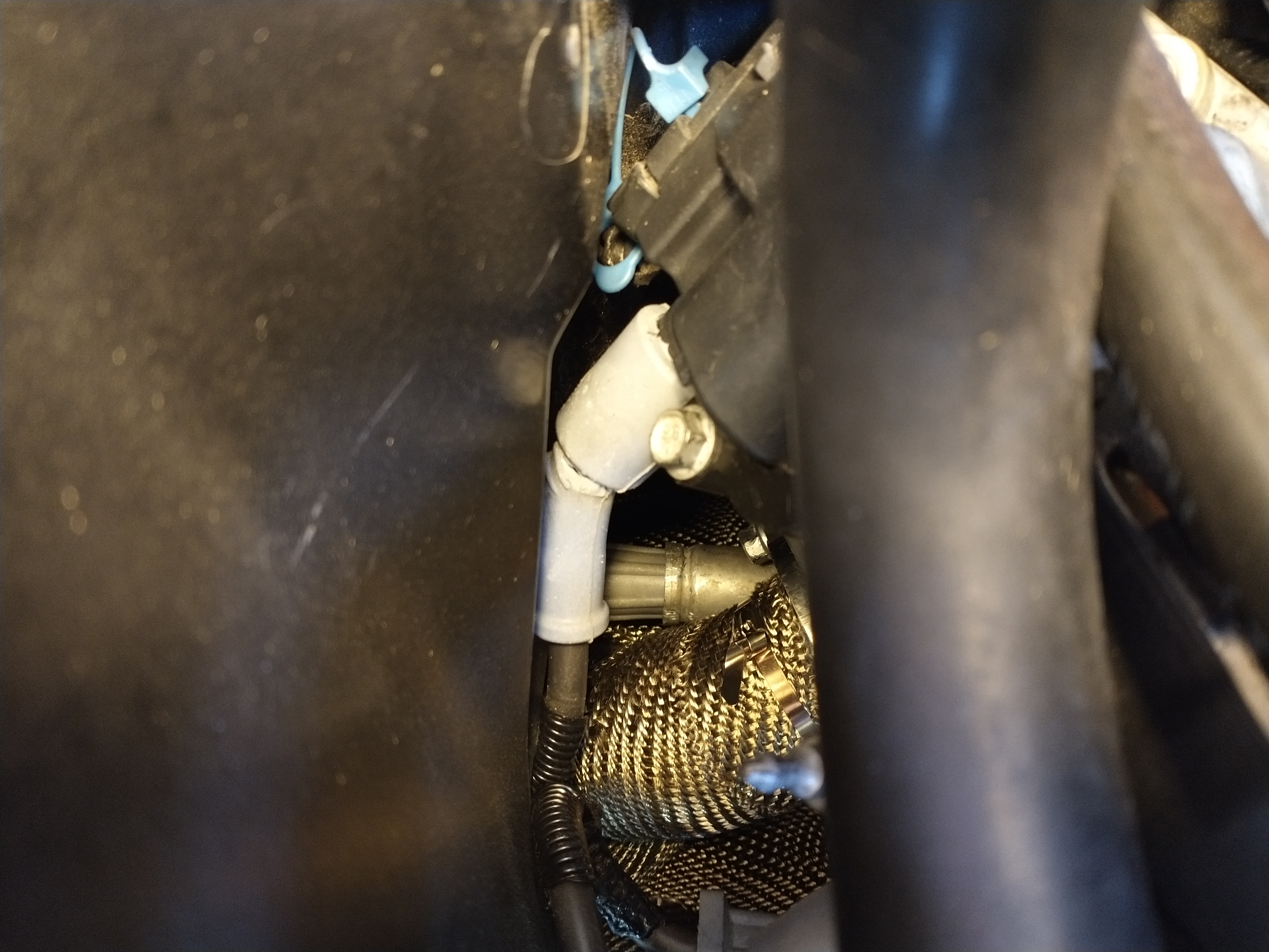

I spent some time most evenings this week, all day Saturday, and a few hours today, but the S10 is alive again! The only issues I had were a leaking tranny line at the radiator, and a plastic conduit around a plug wire that was touching the header that melted. Everything else was just a part of the process.

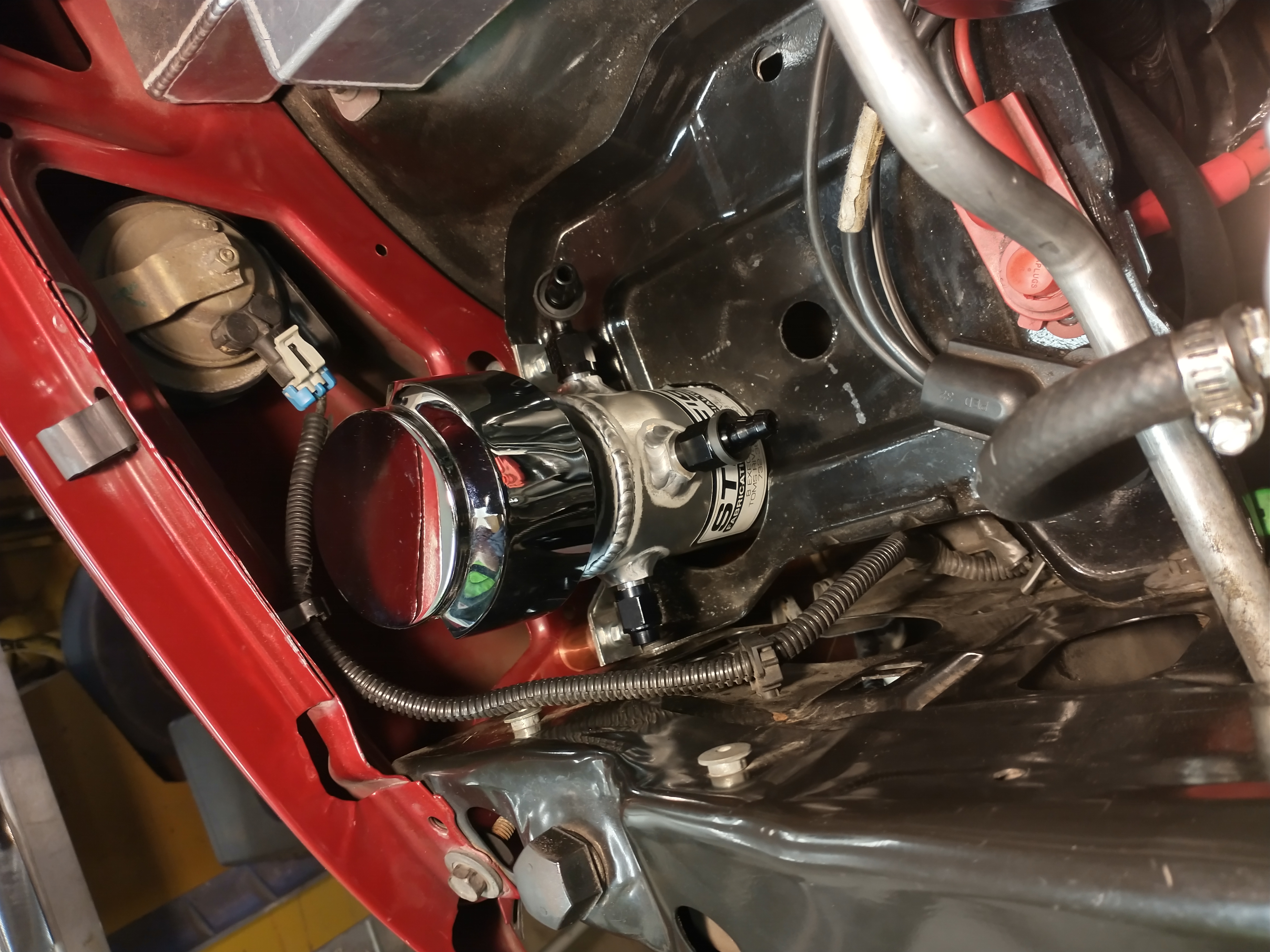

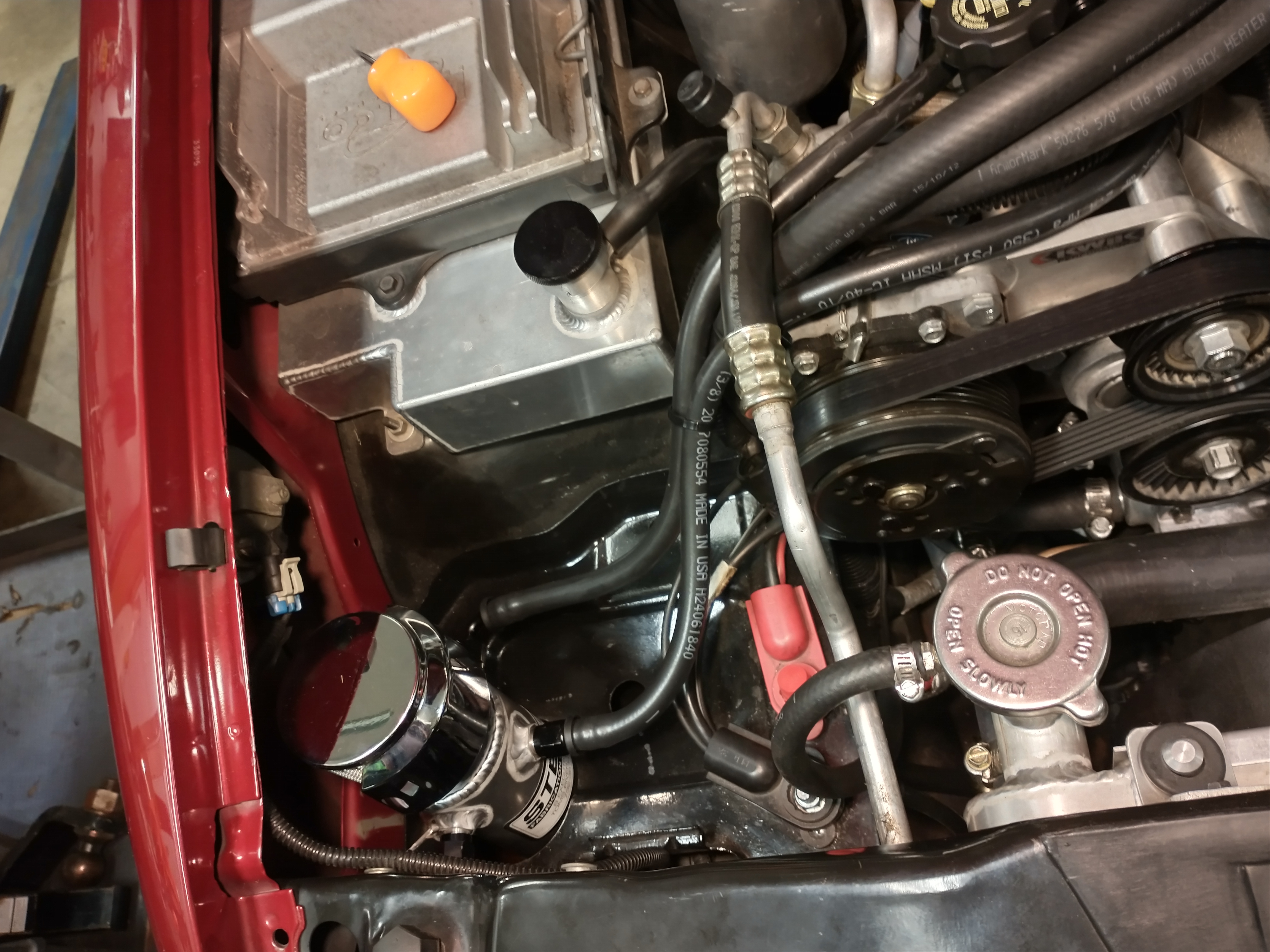

Yesterday I spent a bunch of time installing this exhaust gas collection device. Drilling the big hole was the hardest part. Since the surface of the old battery tray was unlevel and pretty thick, I killed almost two hole saws before I gave up and finished with a die grinder.
I had one hole to drill on the inner fender, and then rerun my hoses I had venting to the driver's side inner fender well. I did this upgrade because the old method made a mess of my inner fender and it was stinky inside the truck.

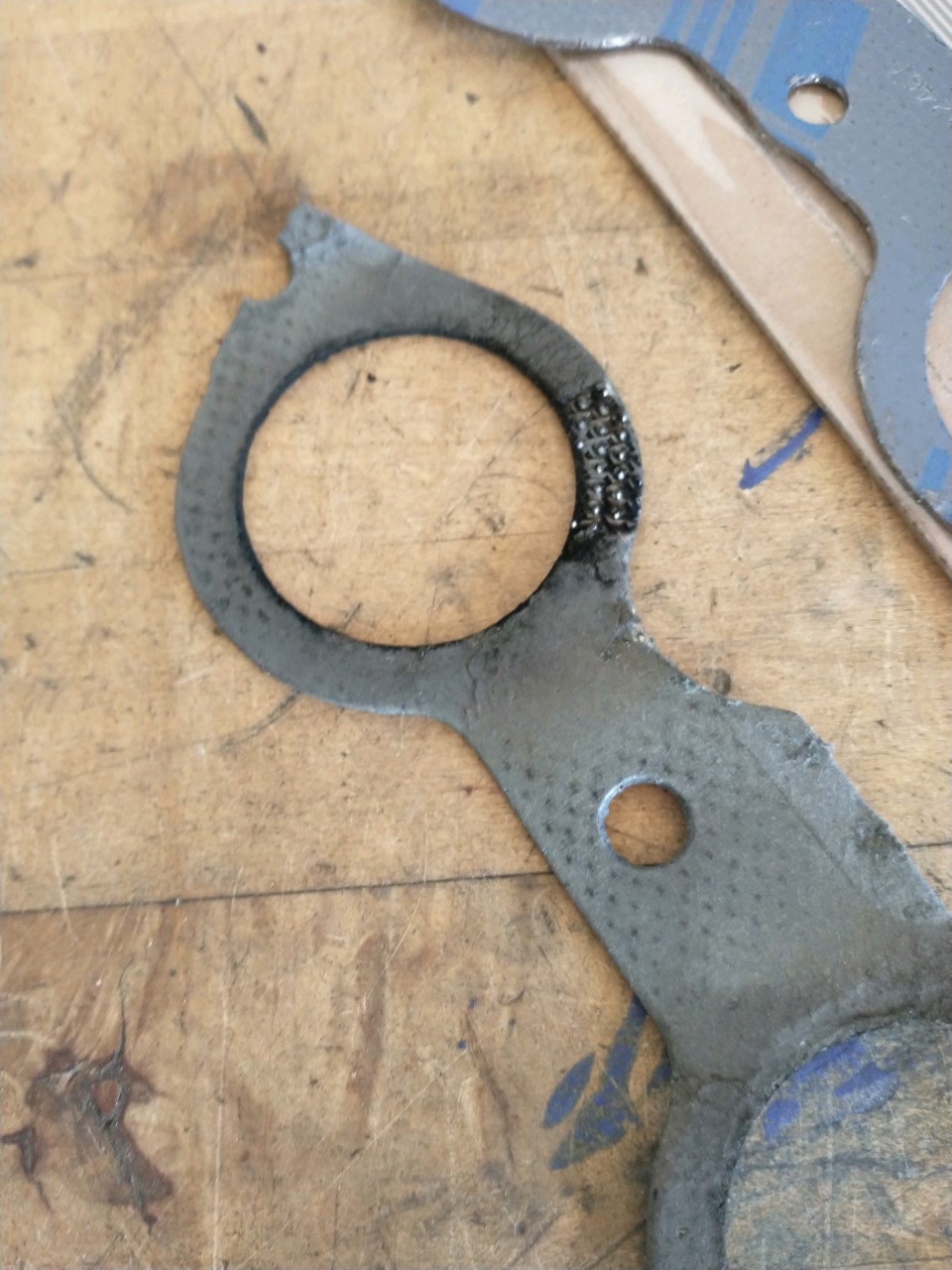

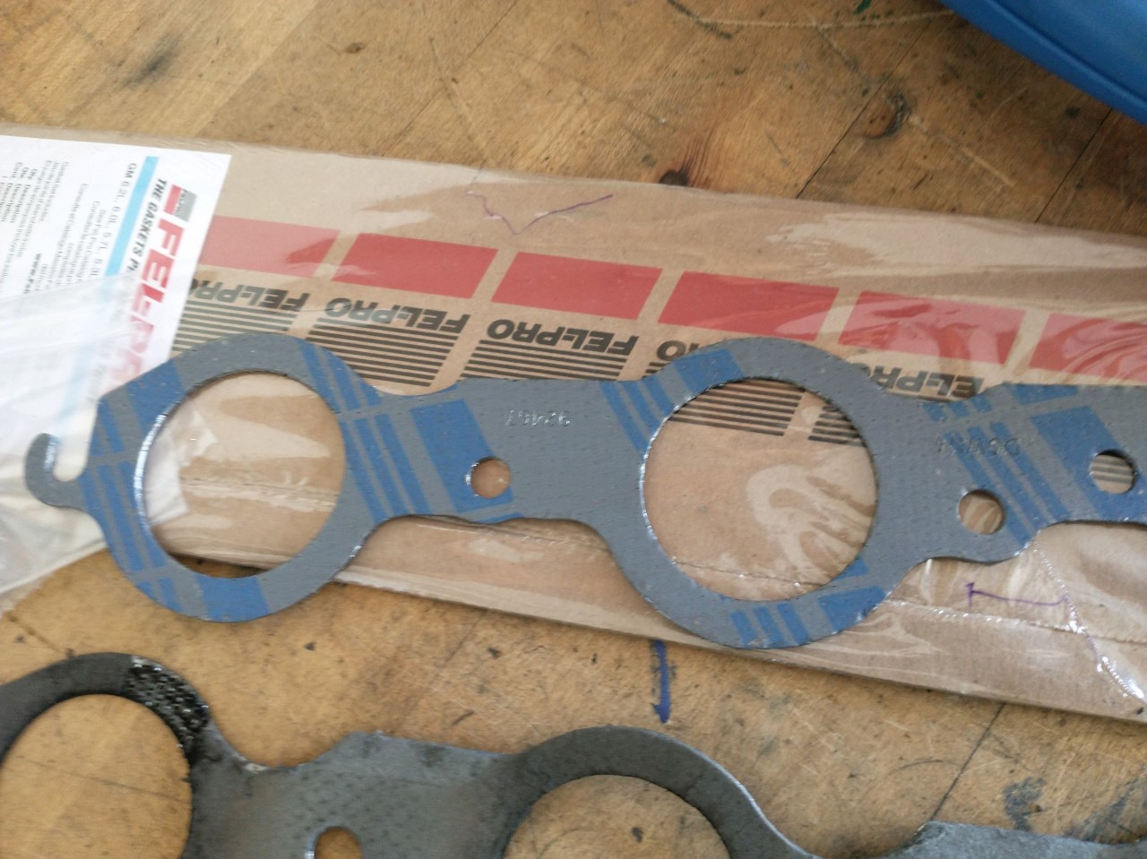

After the Renegade race, I noticed a small exhaust ticking coming from up front. That's never good on this configuration. It didn't take me too long to figure out it was the header gasket on the passenger's side and with a mirror I confirmed it was the last cylinder blowing out the top. I spent a solid 1-1/2 hours attempting to tighten up the header bolts (on both sides), but unfortunately it made it only mildly less annoying. I did find several loose bolts on the driver's side though, so at least I avoided blowing out a gasket there also.
Knowing this was going to take awhile, I started on Thursday evening. I was able to finish late on Friday night working evenings only. I had a total of about 4.5hrs in this. Everything is so tight, and to be able to pull the header from the block, I had to go as far back as removing the muffler that I just put on, and use a ratchet strap to pull the header away from the block so I could slip the new gasket in. This also included removed a couple coil bolts, several plug wires (the hardest ones), and a dipstick tube bolt, but I have to be very careful NOT to accidentally pull the dipstick out of the block as this creates it's own nightmare.
But I'm back on the road and "quiet" again. I will go back and retighten these bolts in about a month or so. I also installed a Fel-Pro gasket this time, so hopefully even if a little loose, it won't burn through like the old one.
