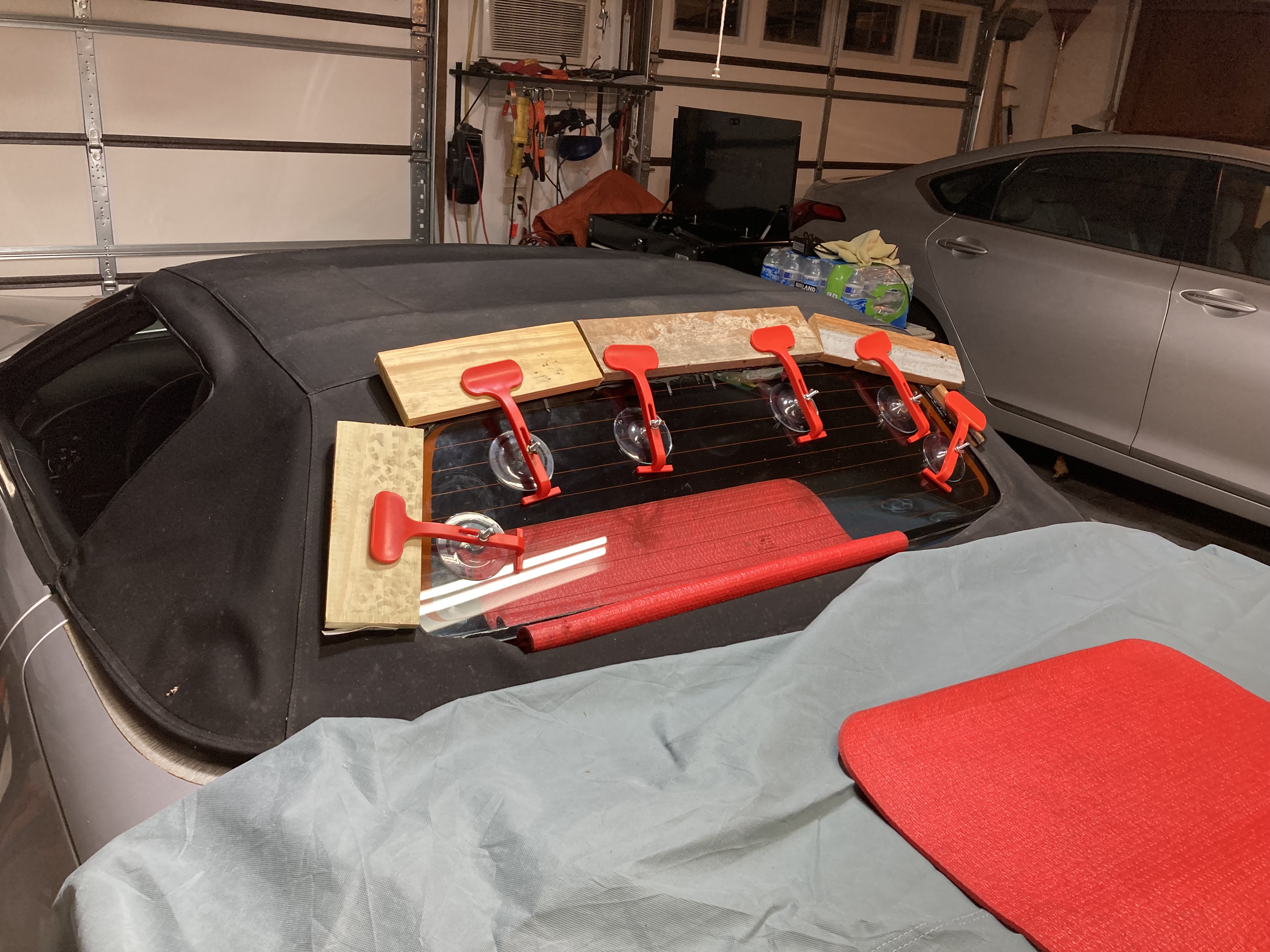

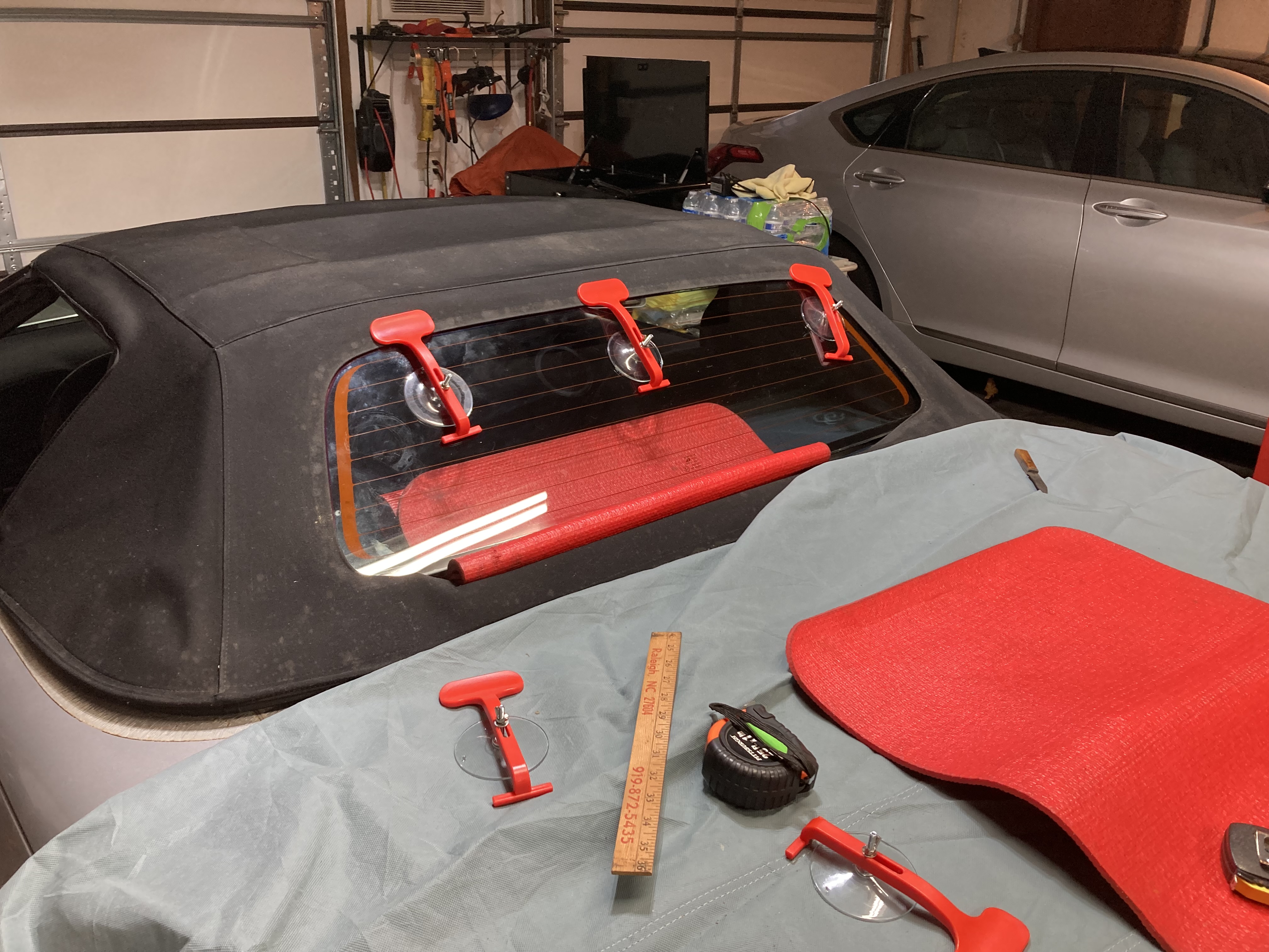

Since the LT4 is running like it should, I'm branching out to other things that need my attention. The back window fell out last Spring when I was on my way to the tuner guy and fixing it has been a priority. But, since the car was not running, it didn't matter. Now I want to go out and enjoy the warm Fall weather so I started the job of re-installing the glass rear window of the convertible top. I plan to do the job in two stages because I only bought 6 clamps. When the adhesive cures tomorrow, I will work on the bottom of the glass. Once that is complete, I need to work on the HVAC controls. Most of the buttons are non-functional and I would like some heat when the temperatures go down.

Two things. The convertible back window reattachment came out quite well. It looks like a solid installation and should keep the water out. I believe it's the original 25 year old roof and this will keep it going for a few more years. I still have a few details to finish, but I'm pleased with it so far.

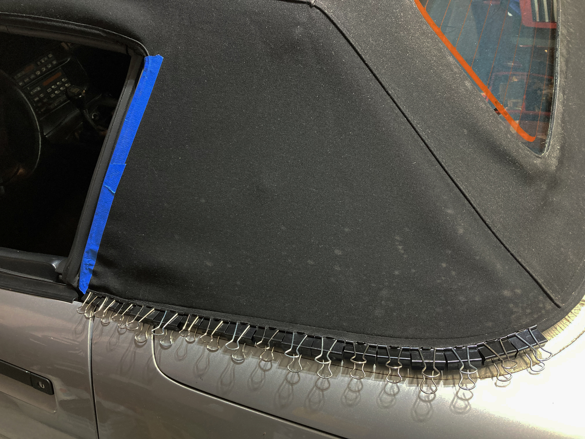

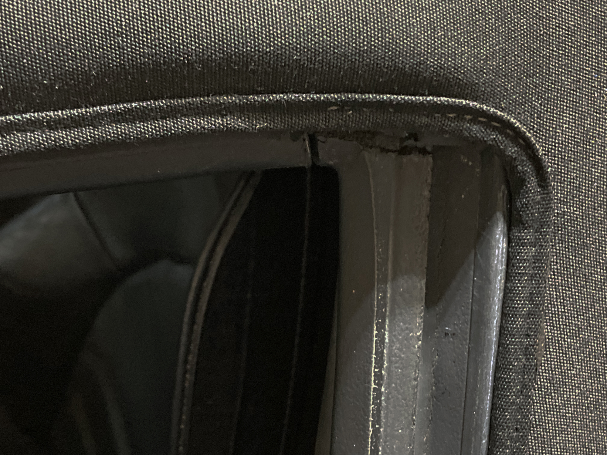

I have finished reattaching all the edge bindings on the roof where the stitching had come apart. My first thought was to stitch them myself, but after I used the 3M Window Weld urethane to reattach the back window and I saw how strong the bond was, I decided to try it instead. So far I'm pleased with the results, but time will tell. In the mean time, the roof badly needs a cleaning. I'm waiting for a reasonably warm day to get that done.

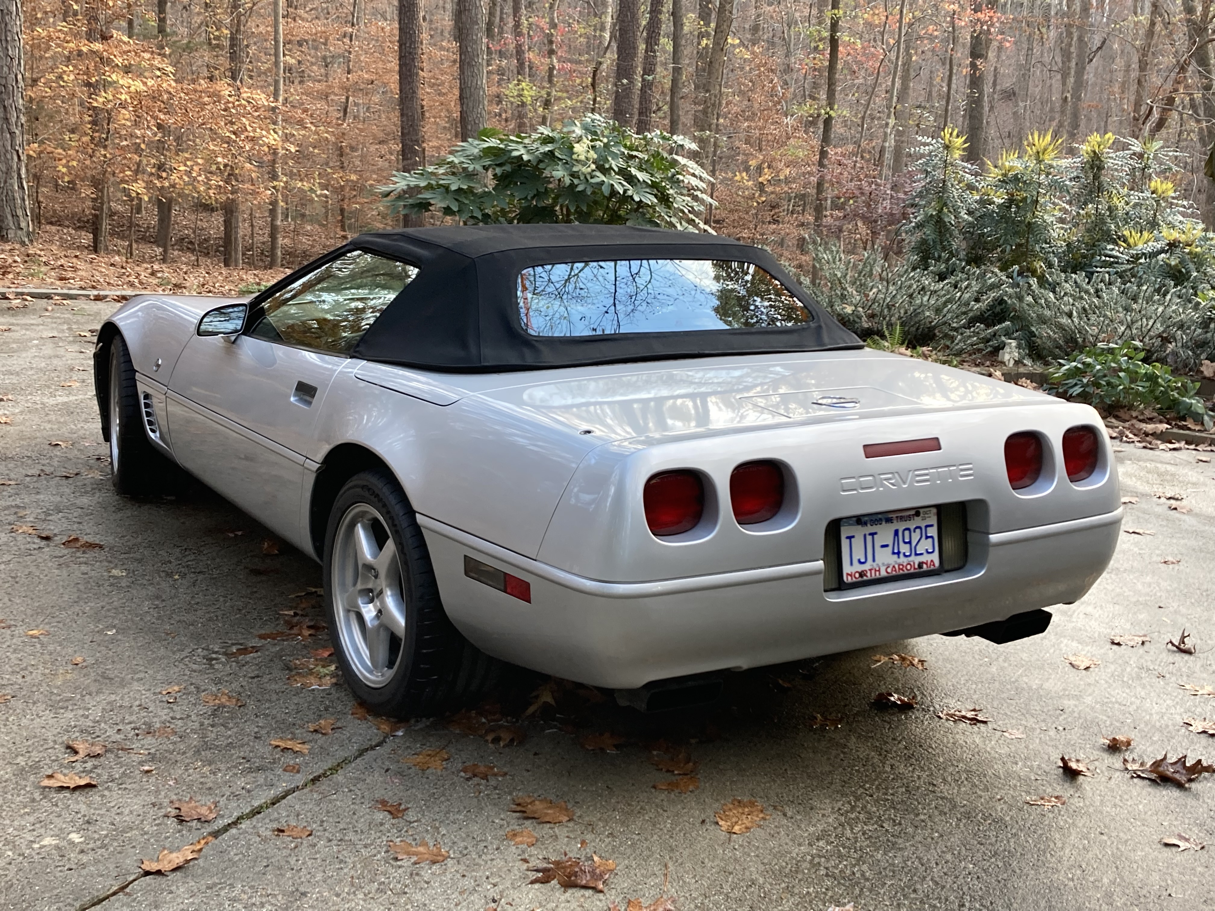

Silvia is treating me well these days. I used Meguiars convertible top cleaner and it did an outstanding job of bringing the top back to like-new appearance. Rinsing it off using a heavy stream of water proved that the top now can keep me relatively dry in the rain. I saw only a couple of drops of water inside, so my rejuvenation job was very successful. I've been racking up some fun miles driving around Raleigh and I've been lowering the fuel pressure a little at a time to see how low I can go and still have good drivability. So far so good at 48psi. I recently discovered that the hesitation/bog is not consistent, though. Sometimes it will rear it's ugly head under various conditions. I plan to keep driving it to learn through experience what she likes best. I learned today that the rev limiter is set at 6400 rpm and that it significantly lowers gas mileage.

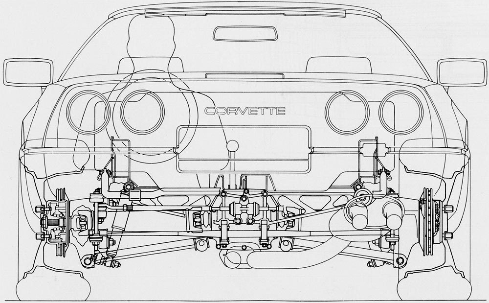

While I haven't crawled under the car yet to identify the source of the diff leak, I have started the research to familiarize myself with the area. I stumbled upon this diagram which I found fascinating.

That is pretty cool. Not sure why they found it necessary to put a human outline in there though. Bummer about your leaky rear. Hopefully it's something ridiculously simple.

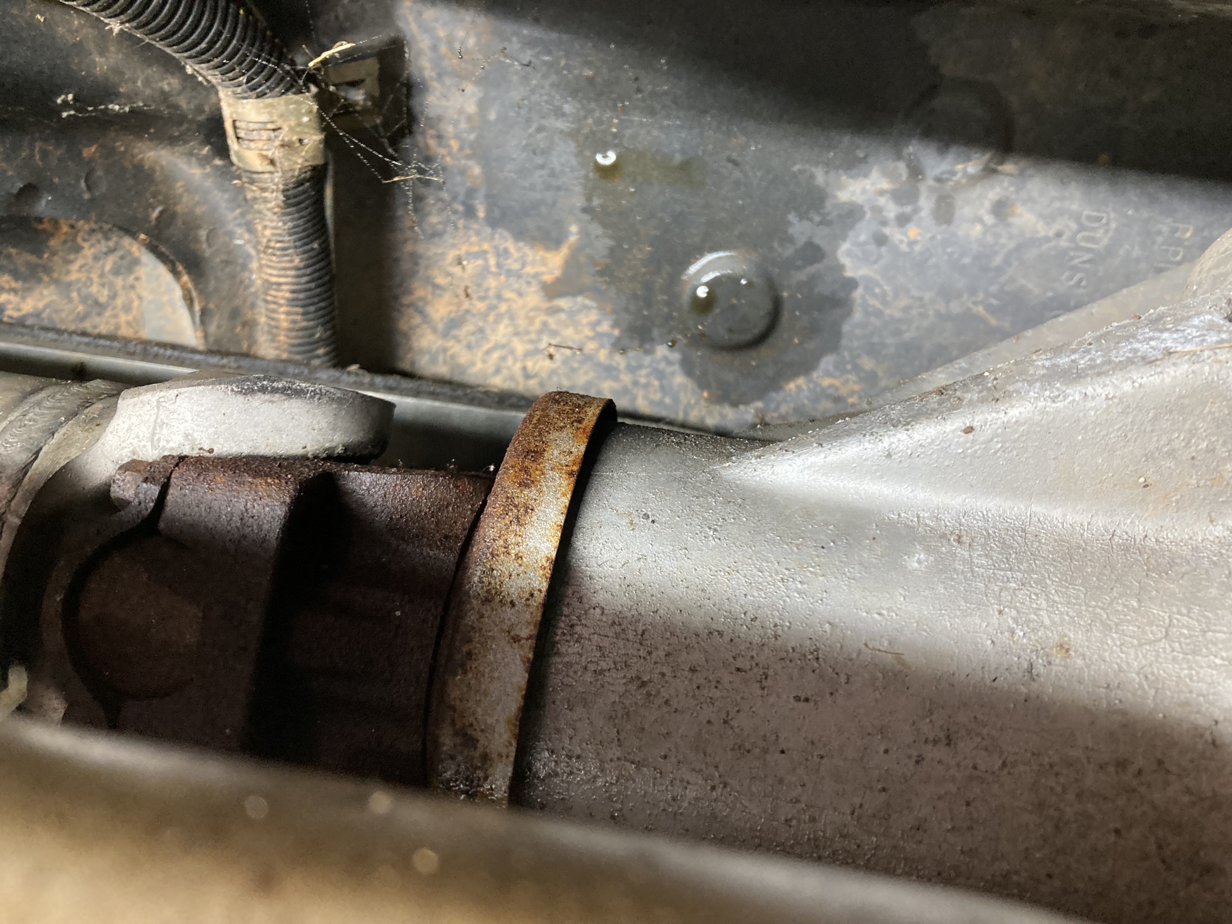

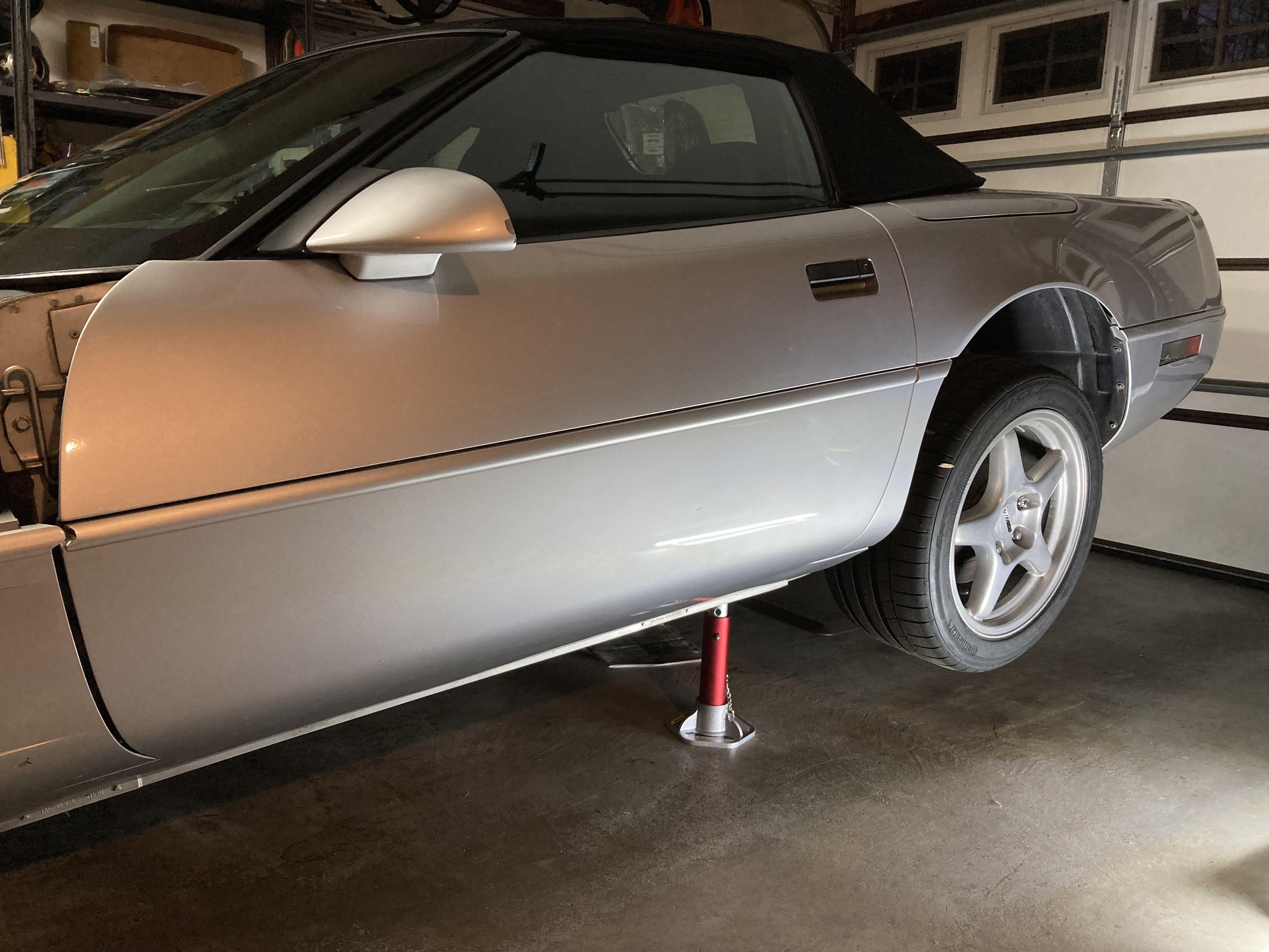

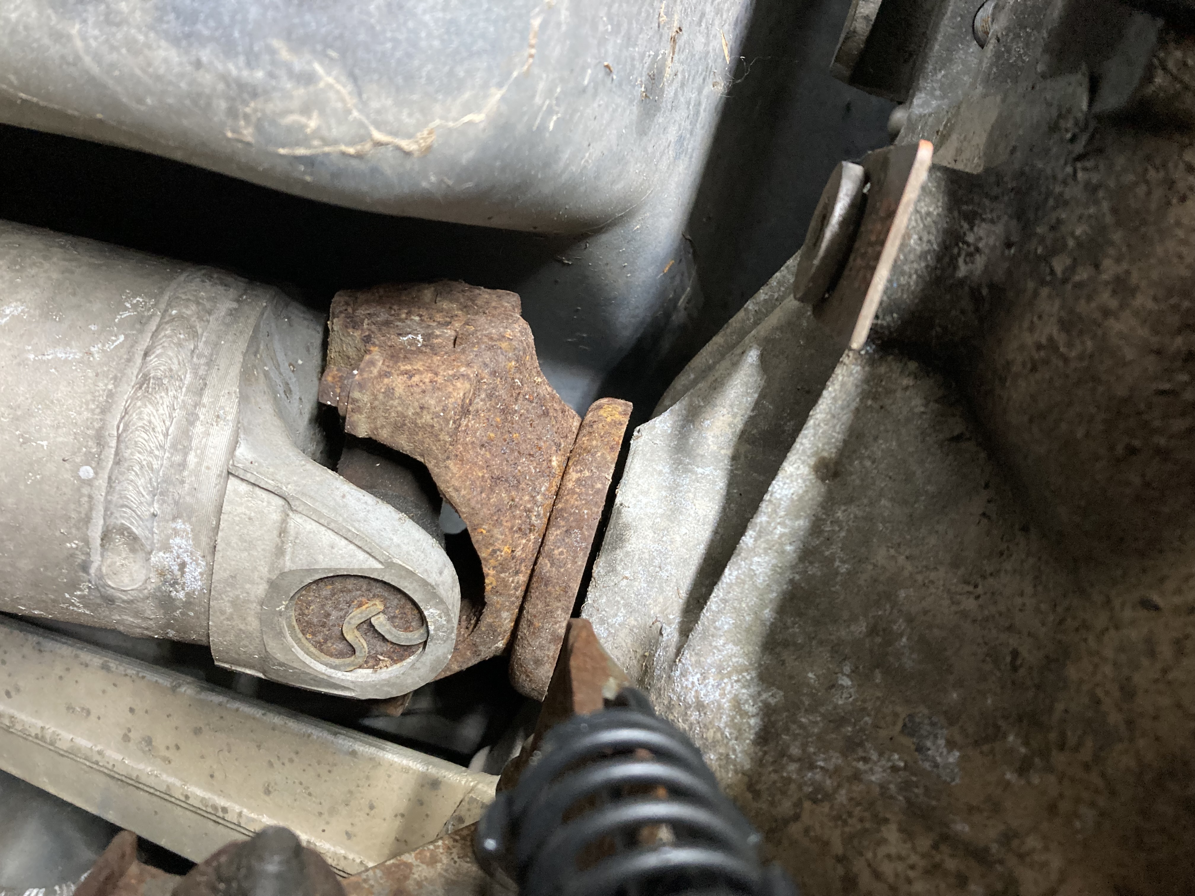

I put Silvia up on jack stands and took a look underneath. Evidence points to a pinion seal leak. Both axle seals are dry.It will be very tight working up in there. The service manual states a torque of 200 lbs-feet for the pinion nut. I'm not sure how in the world I'm going to manage that. I only weigh 165 pounds!

He agrees that the pinion seal needs to be replaced. I guess it could be a lot worse.
You may want to check the tolerance for free play in the pinion and then measure yours to confirm this is just an old seal wearing out and not an old bearing wearing out causing a seal to fail.
Yep. That occurred to me. Pinion seals don't usually fail like this. That was Maverick's thought, too. Have you ever checked this tolerance? Is it just an up and down push/pull to see if movement is detected?
