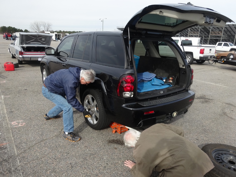

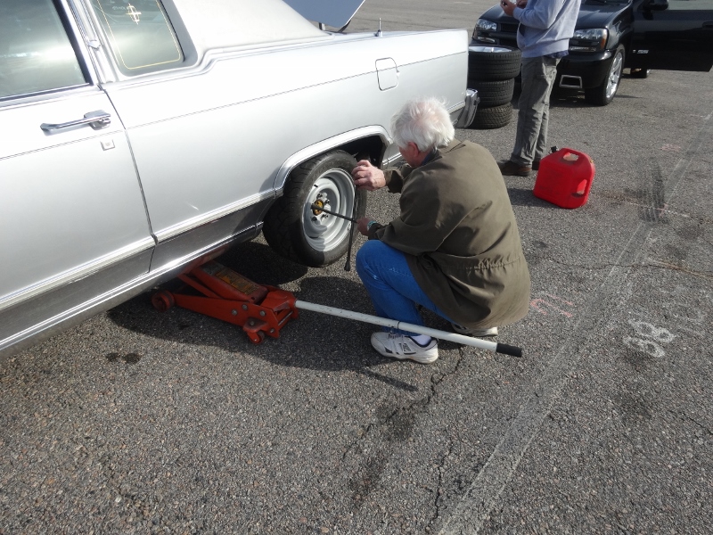

WXO hauled his and my drag radials and my floor jack in the TB SS. Changed the tires at the track. I'll edit in some images when I figure out how.

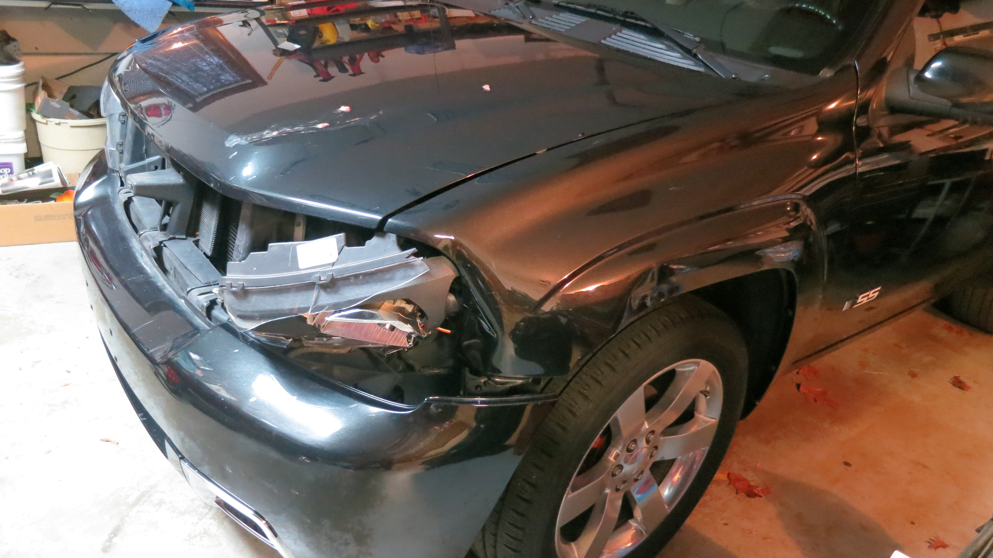

The really bad news happened to WXO on NC 15 coming home. He hit a deer square in the front. Destroyed the grille, smashed the left front lights and fender, spread guts over the hood, windshield and roof.
That's the second accident for him on that road. First one totaled his Camaro. Think we'll take a different route next time.

Sorry WXO, to see the damage to your TB. Good thing though, you're OK. Deer impacts can go south real quick. Get her fixed up and ready for Spring racing action.
A sad ending to an awesome day.

I MUST be getting old!! Last week at the airport a young woman insisted on helping me get a suitcase off the carousal. Saturday at the track, a guy wanted to know if I needed help changing the wheels.
When I see these pictures I guess I understand it.
