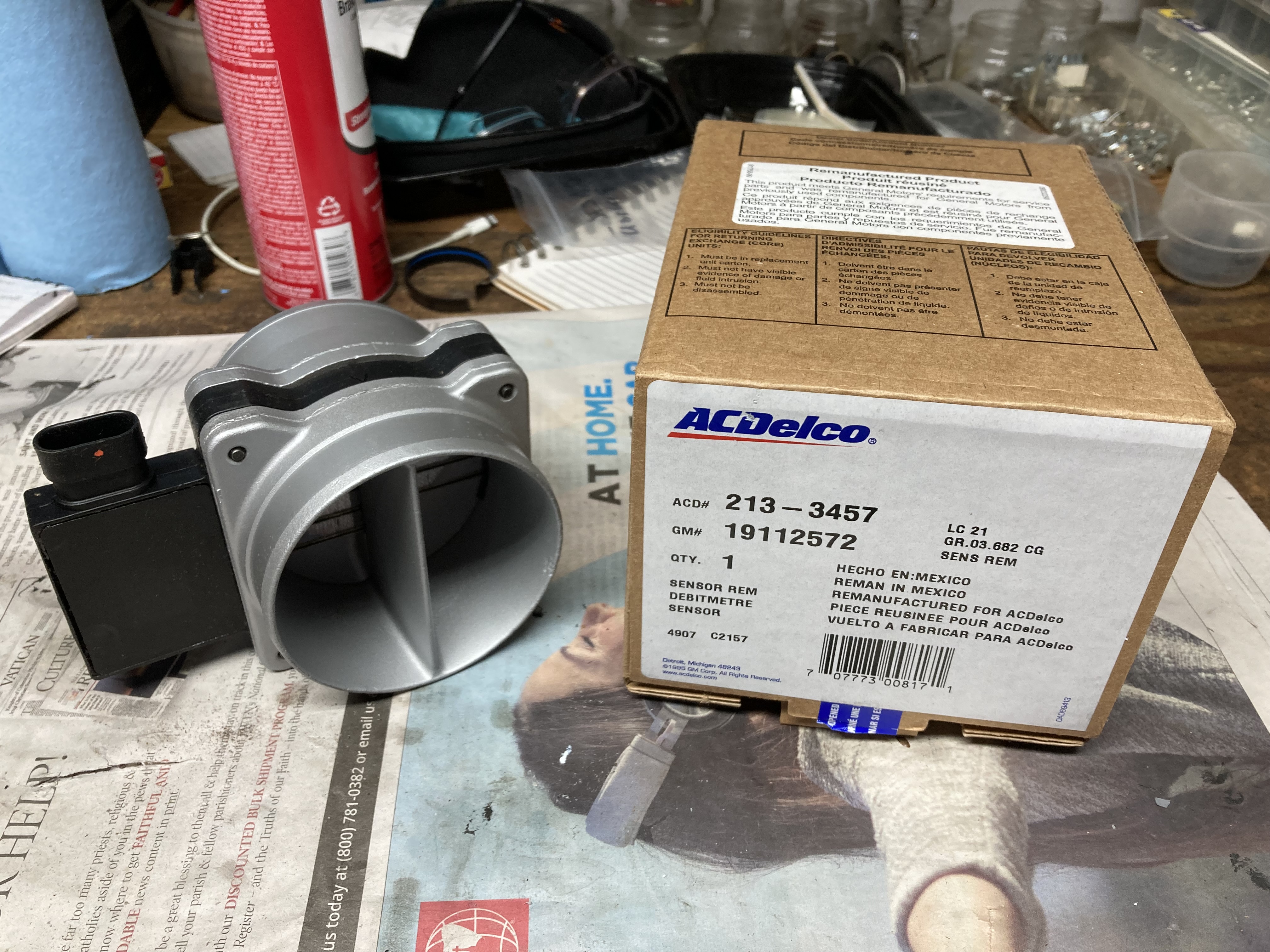

I've been going over the basics of engine management and there is one obvious thing that could cause this. The mass airflow sensor. The LT4 runs great at high speed, but what if the MAF is not correctly metering the low speed incoming air. If I dial down the fuel pressure to stock specs, the engine will run very poorly. The MAF on this car looks to be original, so before I do anything else, I think it would be prudent to replace the MAF. The engine needs to have an accurate measurement of incoming air to calculate the fuel required. There's an ACDelco reman unit on Amazon with one day shipping. I believe I'll go for it.

The new Mass Airflow Sensor arrived Thursday evening.

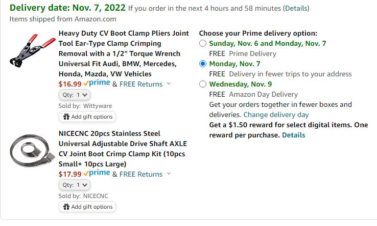

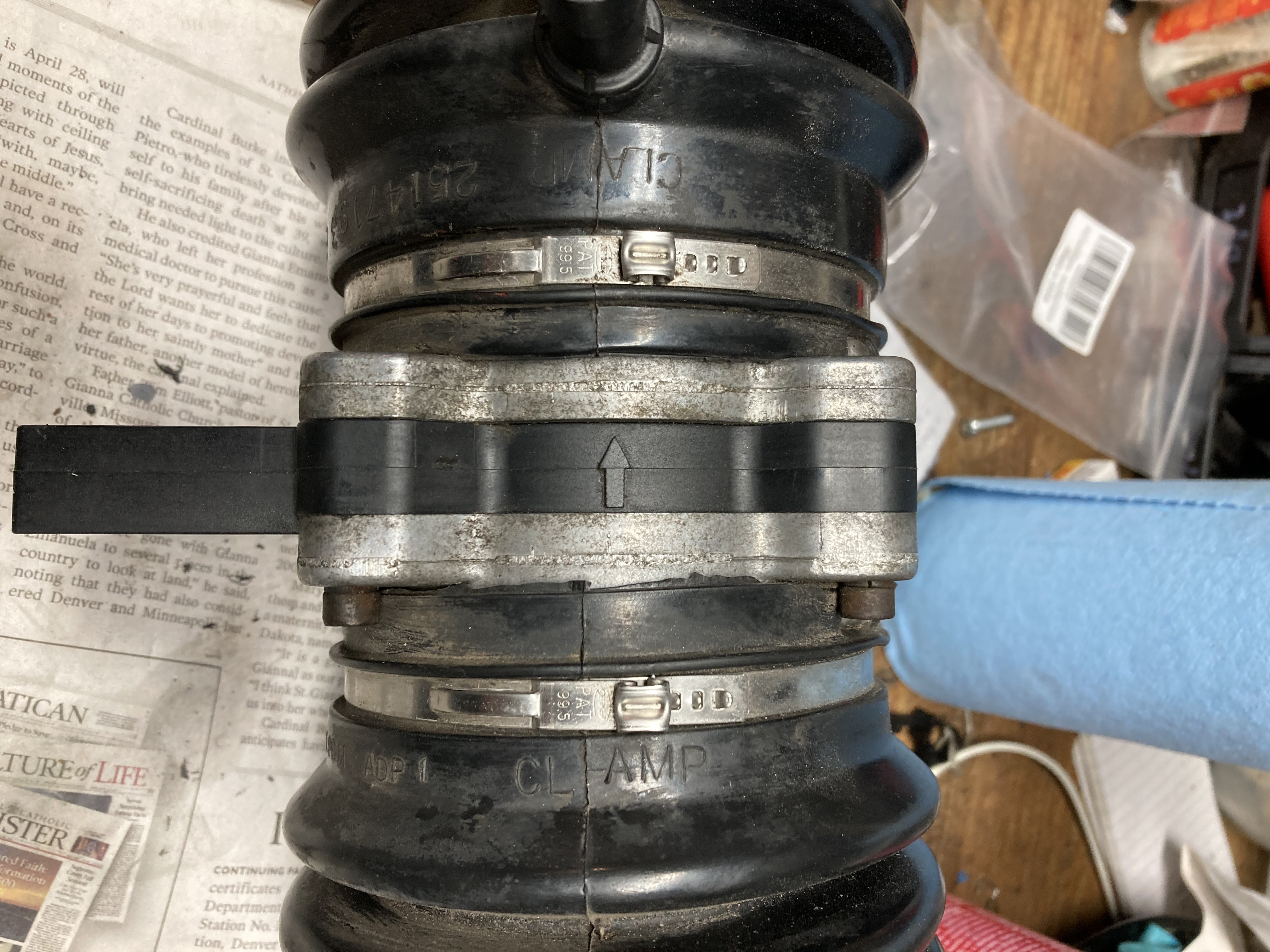

I discovered a problem right away. The MAF is affixed to the throttle body ducting with semi-permanent Oetiker bands.
These are 1/4" wide and about 3.75 inches in diameter. It took a lot of searching but I finally found the correct dimensions in the CV boot category. They will be here Monday.

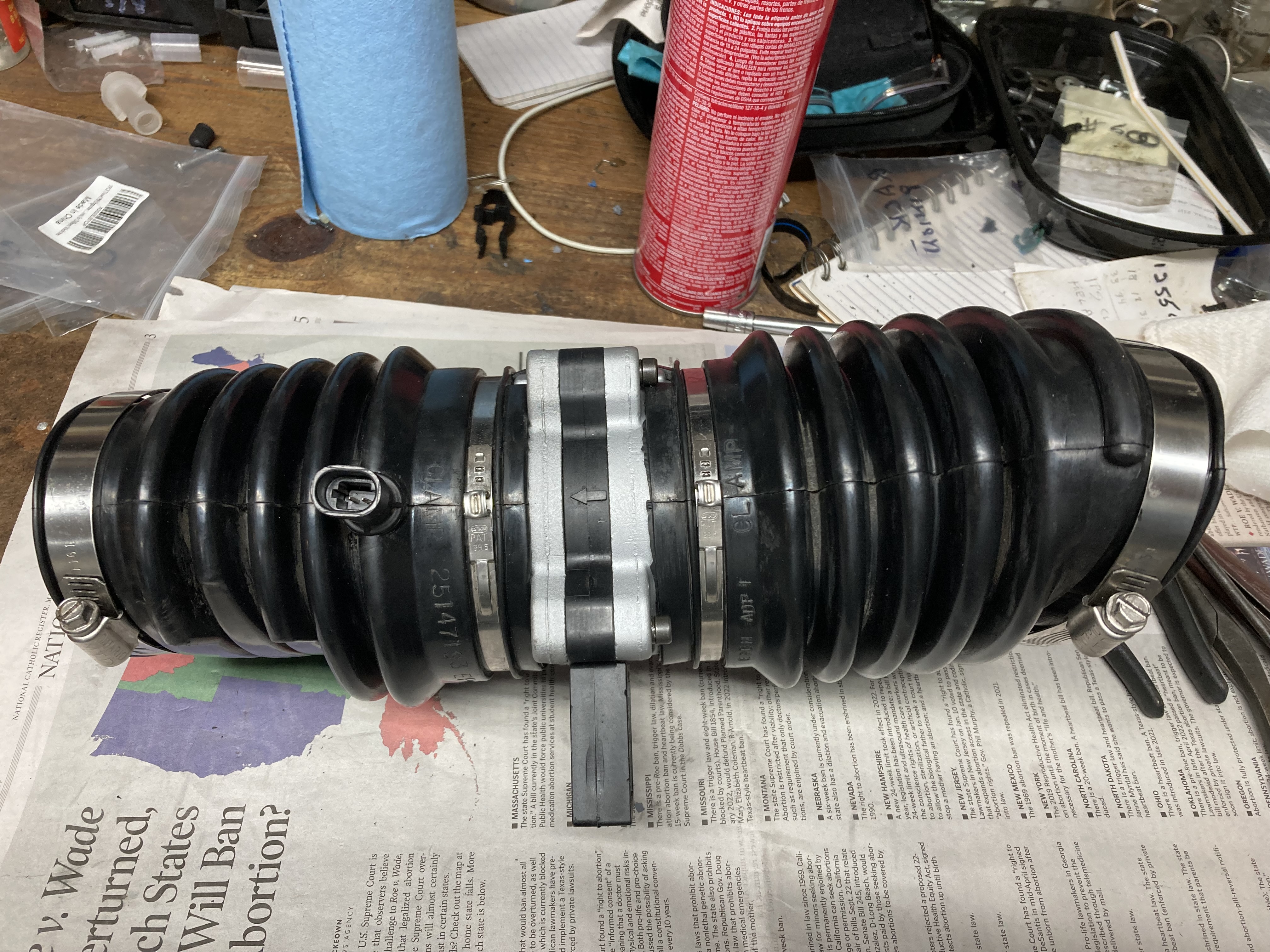

I decided to explore the Oetiker bands securing the MAF sensor. I was able to use a screwdriver to open up the ears enough to undo the oem bands. They came off easily and without much damage so I believe they can be reused. When I get the tool on Monday I'm hoping I can reform the ears to tighten the bands just like stock. While I had everything apart, I took the time to clean up the ducting before installing the new MAF.
Now that's what I'm talkin' about!!!
WOW!! The new MAF did the trick. On the first test run, I had the fuel pressure set at 43psi and I could feel that the drivability had improved substantially. Just for the fun of it, I bumped it up to 45psi and went out again. Another Wow! It finally feels just like it should. What fun!! I gave that gearbox quite a workout. No hesitation at all.
