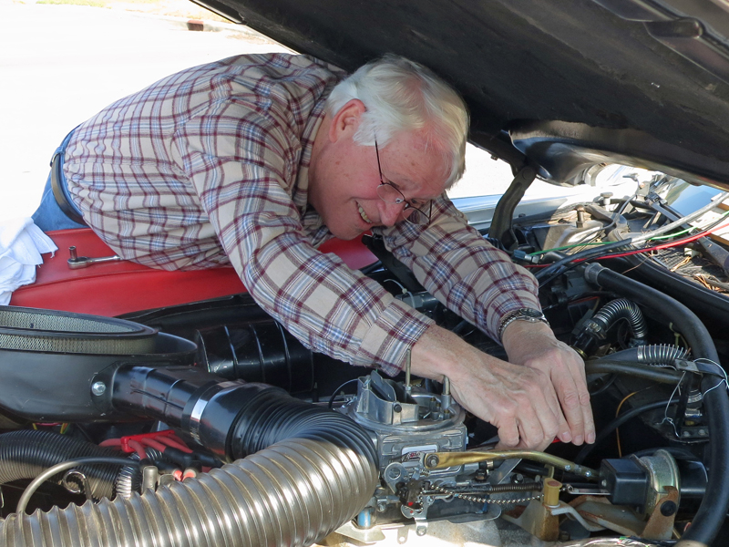

Mad Scientist #1
Just thought I'd post a picture of our head mad scientist at work.
