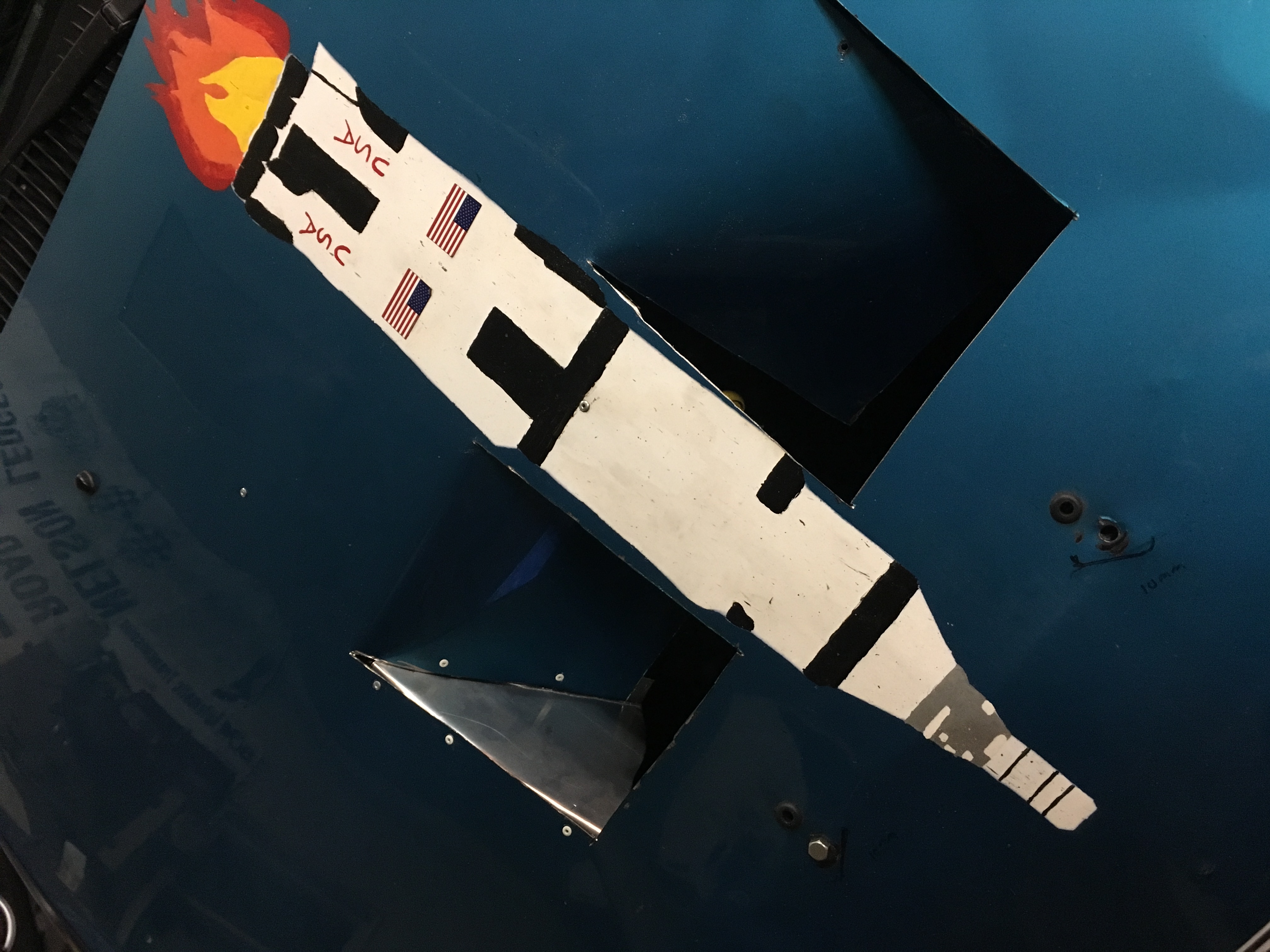

Seems to me that if you want to experiment you could try driving it with the hood off to see if that gets the temps down.
In the race car we opened up the hood (mostly to relieve the pressure that builds up under there from airflow through the radiator) but it has the effect of letting hot air from the radiator out.
If the purpose of the new headers is better performance (and not cosmetic) you might consider wrapping those pipes. That should help the underhood temps quite a bit as well.
In the pic, the hood vents are under construction so the one on the left is done

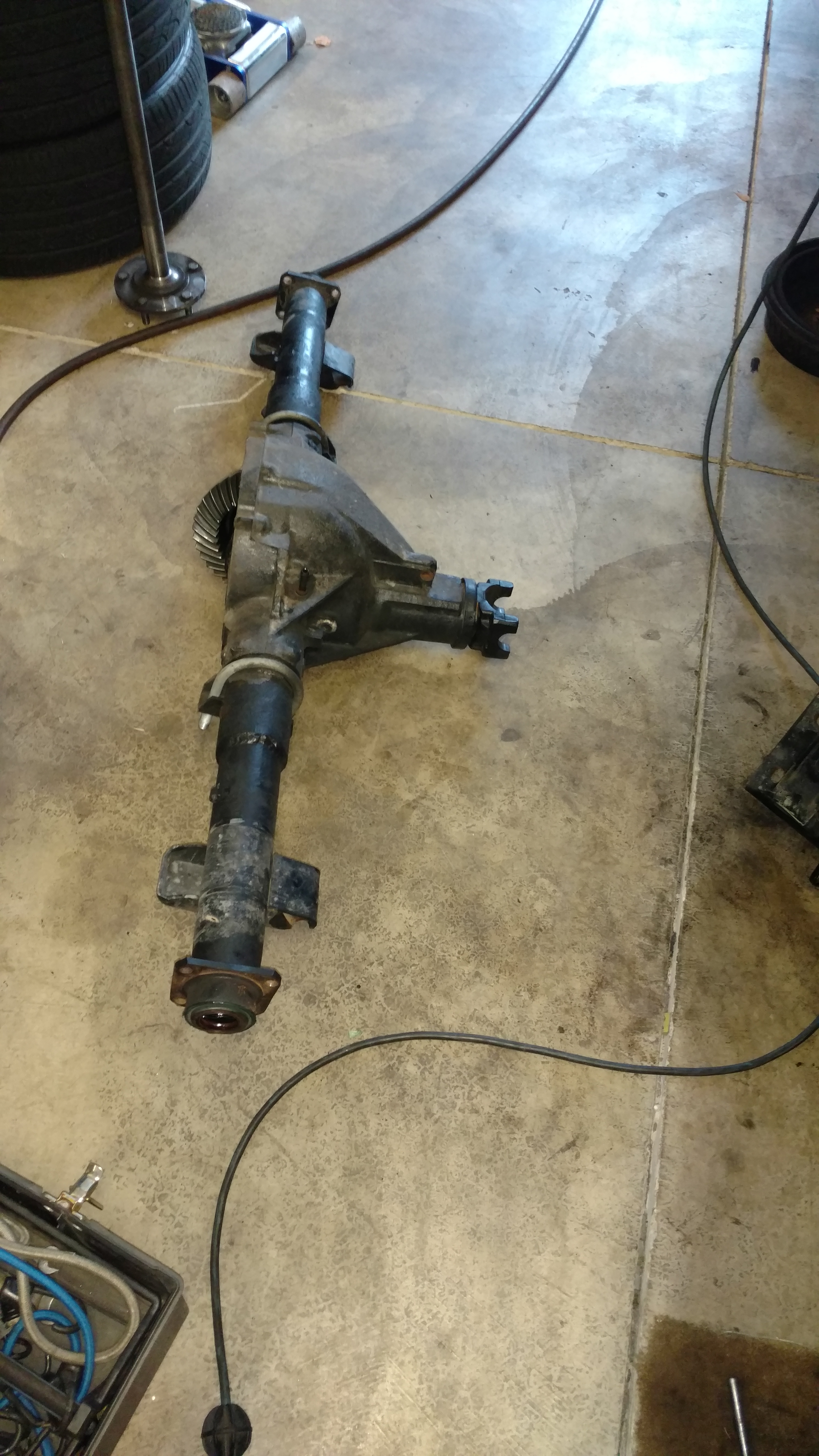

I talked today to Jim at JD Race about doing a gear swap for the S-10. Looks like I'm in for around $400 if I bring him the rearend. Seems more than reasonable. There's a good chance I'll pull it out this weekend and run it down to his place after work early in the week with hopes to have it back by next weekend. I would be going from 3.73 to 4.10 with hopes to get a couple tenths and help make up for my torque deficit. I love my motor, but it really is weak down low...
- Posts: 3676
Re: 2003 S-10

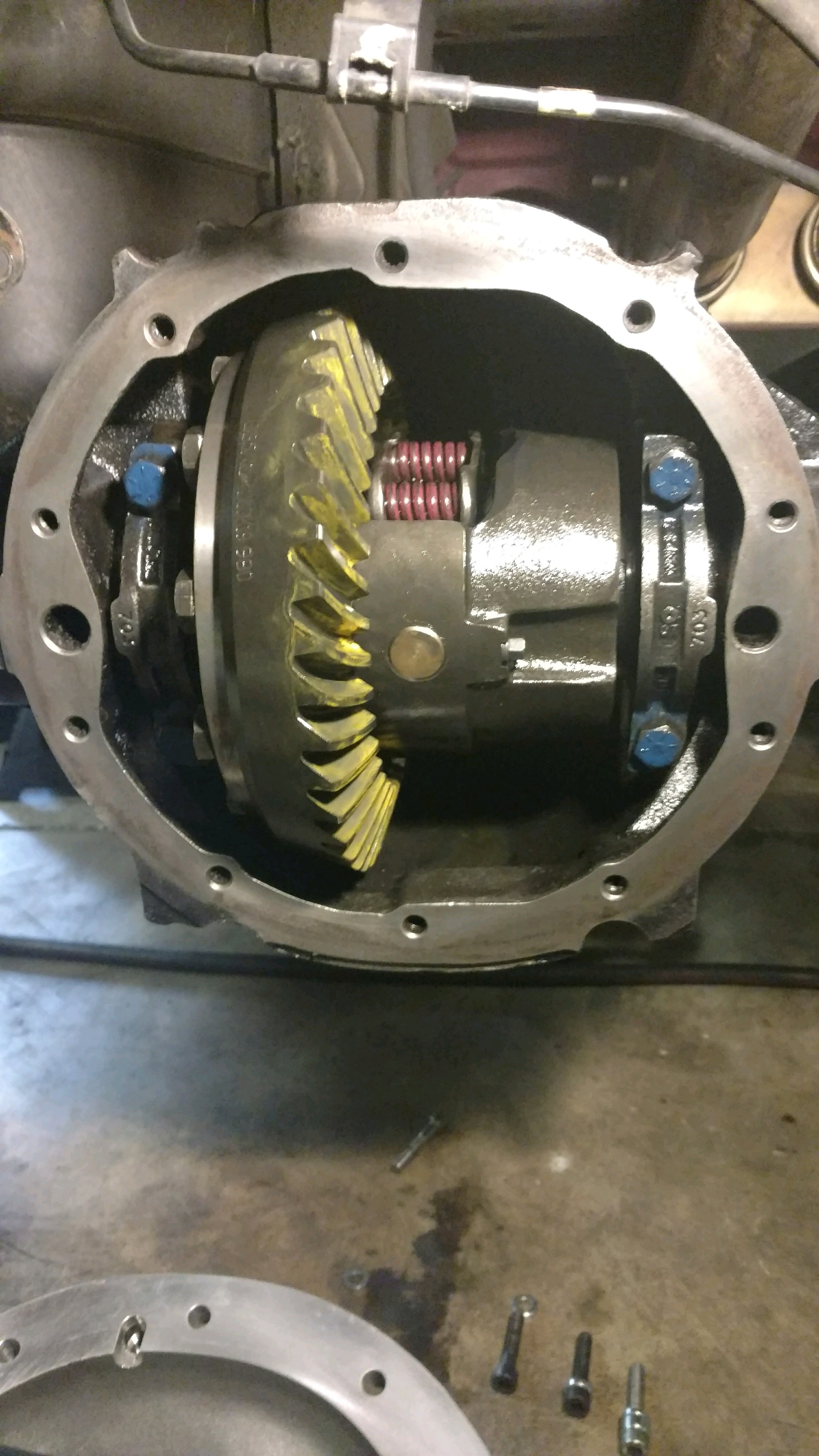

No big surprises and about 3 hour on Saturday afternoon, and it's out and ready to go. Everything looked like new inside, so I shouldn't be looking at any extra repairs. Hopefully I can drop it off Monday after work.
- Posts: 3676
Re: 2003 S-10
I was able to pick up the rearend on Saturday about 10am. $385 later and I have 4.10 gears. Another 3.5hrs and it was up and running. The break in period is a little tedious, but by this afternoon I should be able to get to putting some power down. The good thing is that all went smoothly and there's no weird noises or funny business. Hopefully the weather will hold and I can make a few passes on Wed.

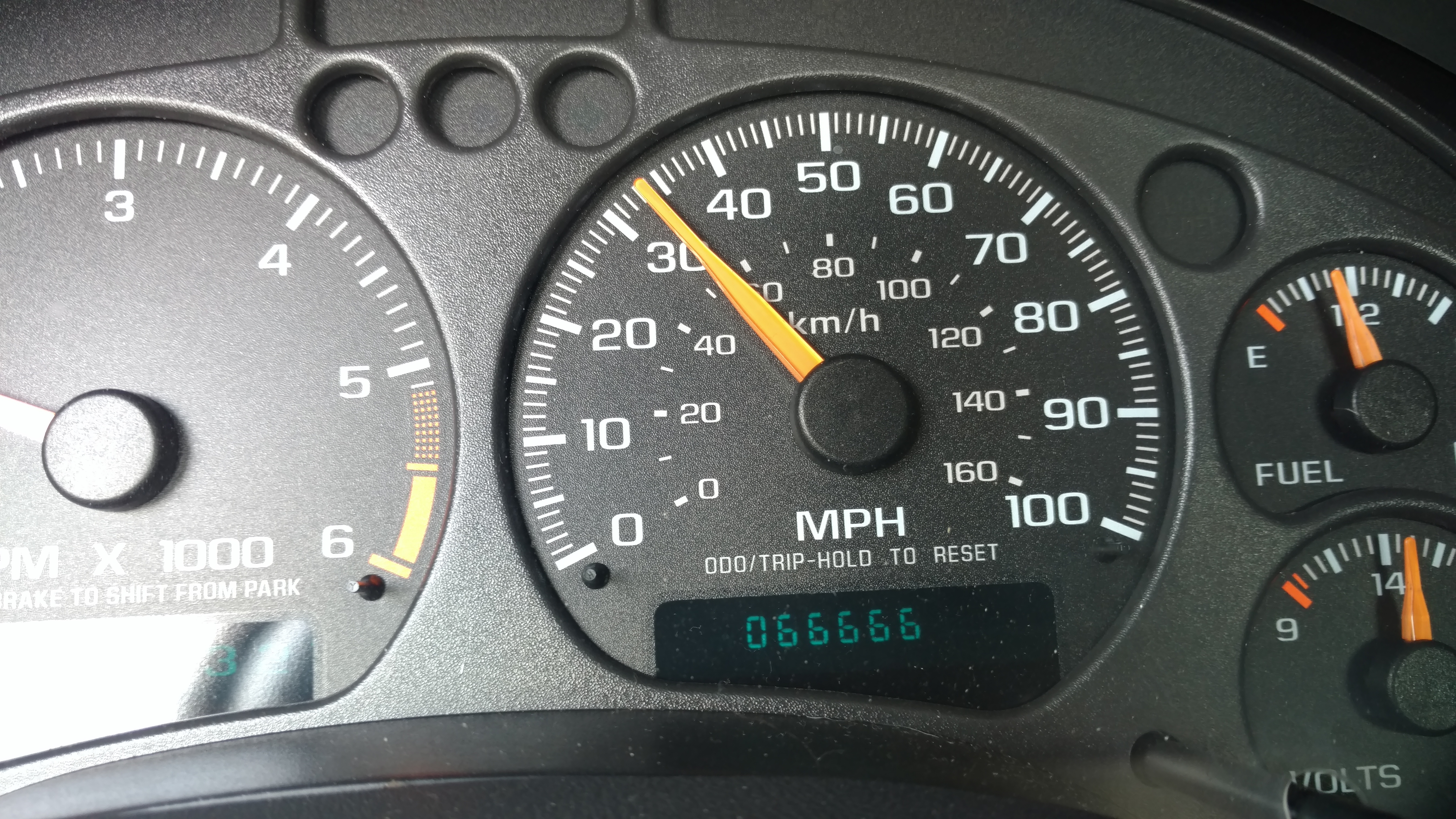

Last night I swung by Hutter Performance to see Trevor to correct my speedometer after the gear change. After a few minutes, we were good to go. So the only thing I really have left to do is get the A/C recharged and run mid 11s.

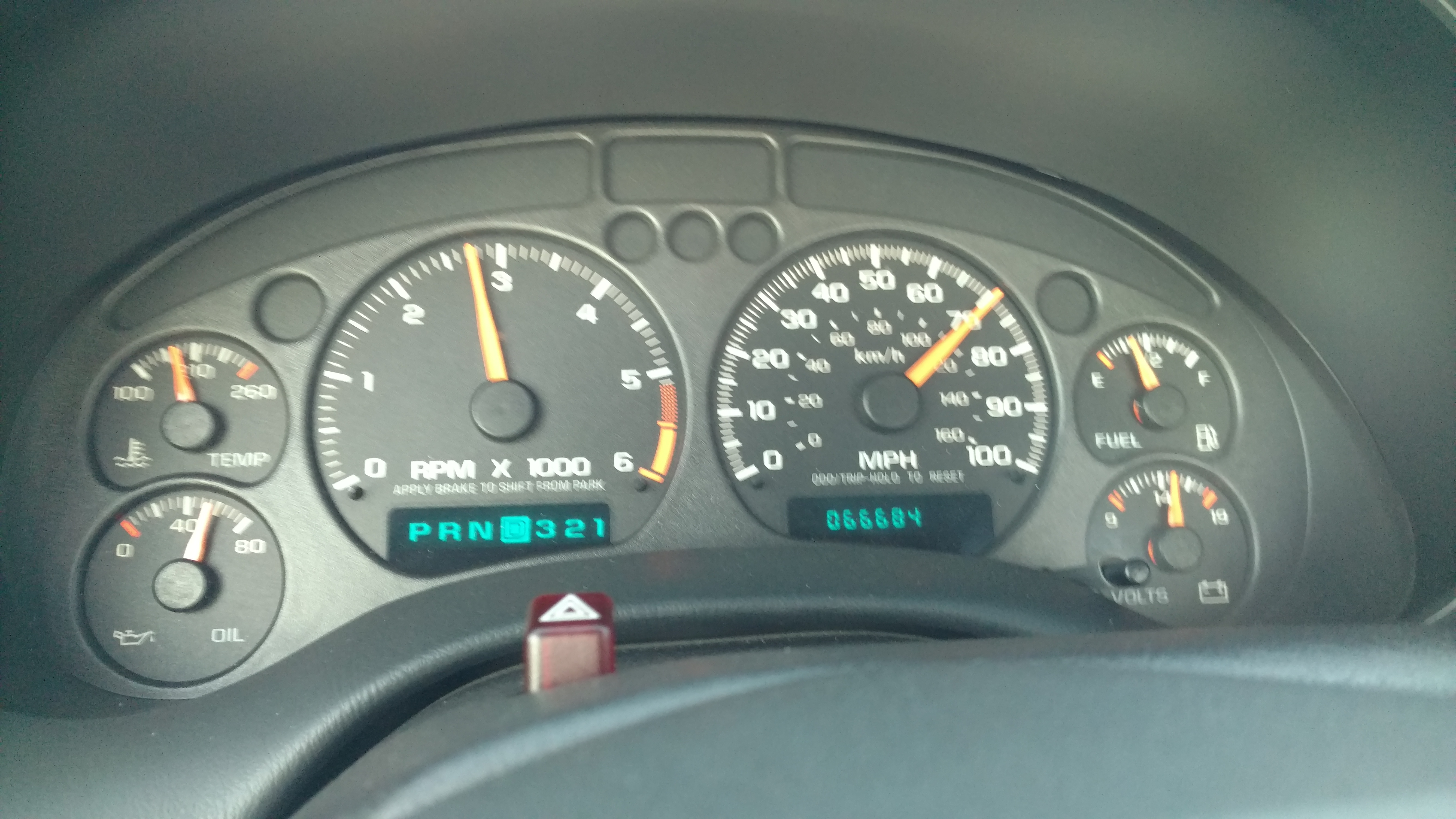

Re: 2003 S-10
Finally got to drive on the freeway with my corrected speedo. Turns out it's exactly what I thought it would be at 70mph: 2700rpm. In a motor that goes almost to 7000, that's a good cruising number. Pretty sure my mileage has gotten worse though (says Captain Obvious).
