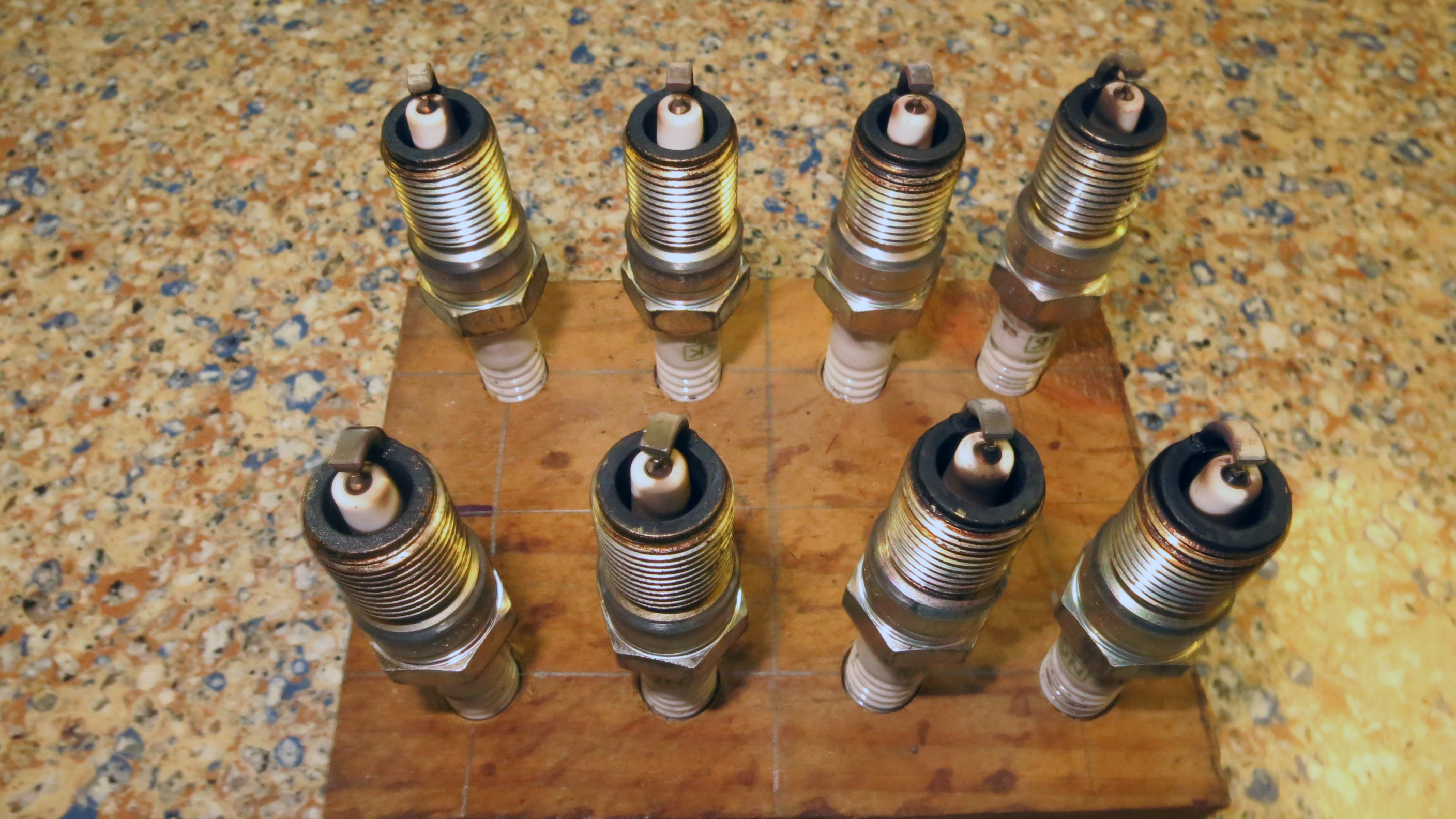

In anticipation of a third foray into Silvia's timing case, Maverick came by and we removed all the spark plugs to allow the starter to more freely spin the LT4. Maverick encouraged me to post a photo of the plugs as they are now.
Keep in mind that the condition of the plugs reflects the tune done by Jeff Creech in February of this year.

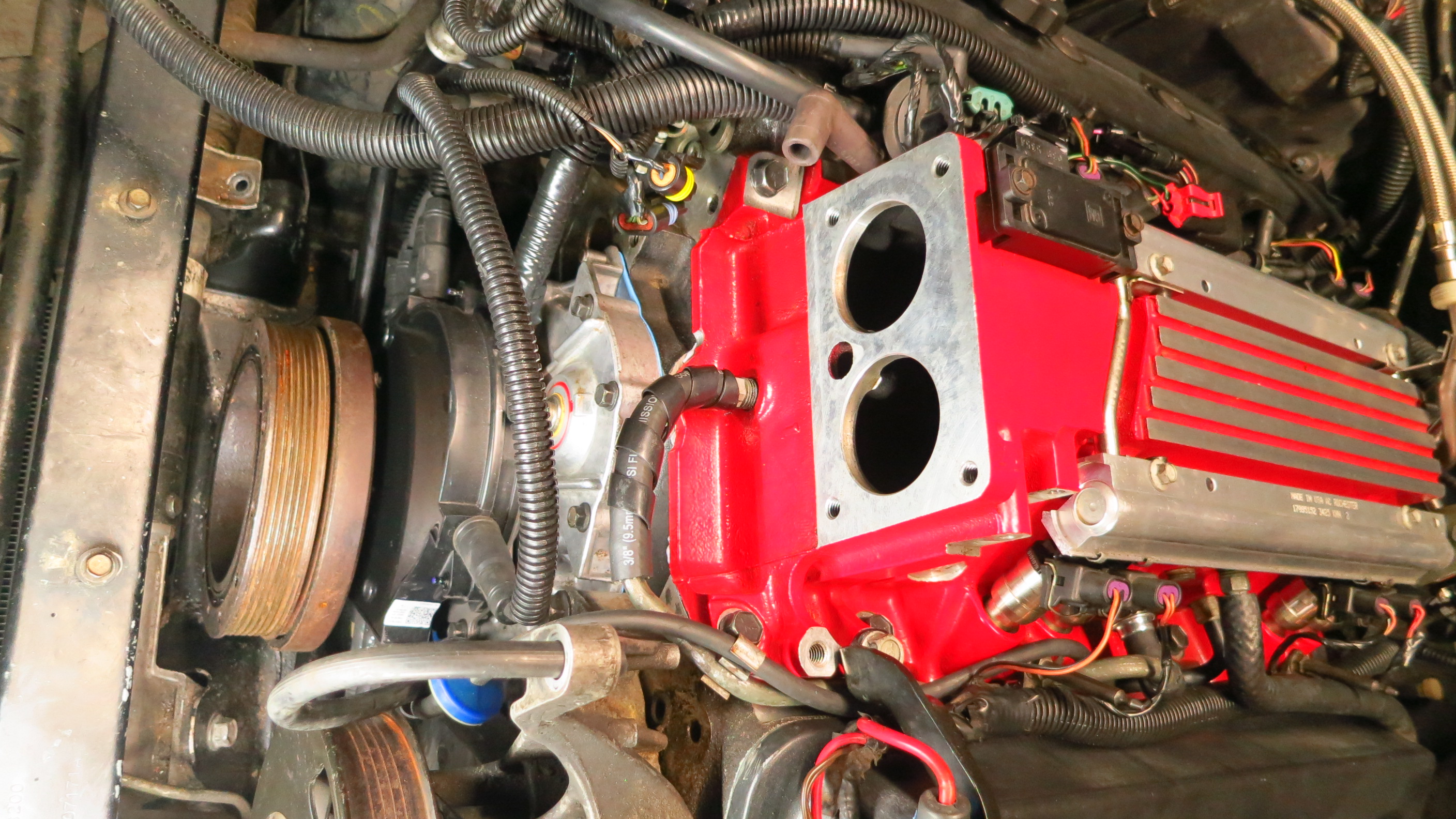

I had a good day in the garage today. I took my time cleaning all the gasket surfaces and installed the intake and hooked up most of the do-dads. I'll finish up the intake do-dads tomorrow and start with installing those pesky spark plugs. If all goes well, we should have another startup soon. :D
I got a late start to my work on Silvia today, but I got all the vacuum hoses and connectors routed and connected and started on the spark plugs. I decided to install the worse one first, #8. Standing with my back to the engine I reached down with my right hand holding the plug. I had a small piece of hose on it to help screw it in when it is in place. I was having difficulty moving it around with the few fingers that would work in the tight space and, wouldn't you know it, I dropped it! Worse yet, it didn't make it to the floor. You may remember the last time this happened and I had to remove the starter to get to it. That's what I'm facing again. I decided to install and torque all the rest of the plugs and leave the starter removal and #8 for Monday. This is a bit disappointing, but so be it. Maybe I'll start it on Monday.

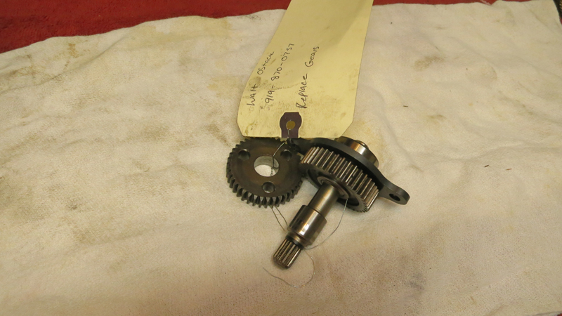

Today, Maverick and I studied, under magnification, both gears that drive the water pump drive shaft. The large gear on the back of the cam sprocket showed an abnormal wear pattern. The wear was only about 50% across each tooth indicating an alignment problem between the two gears. This could explain the gear whine I mentioned in my previous post. The original noise, different from the whine, was also evident on the last test run, but I've seen nothing that can satisfactorily explain it's source. A damaged bearing on the WP drive shaft would explain it, but that's not the case this time. The bearing feels smooth and tight. So, now what? I looked at the old cam sprocket gear just to get some perspective. It has a nice, full tooth wear pattern on each tooth as it should. This is more evidence that there is something wrong with this timing set from Cloyes. It also tells me to go back to the original timing set in hopes that it will fix all this.
I have completed the first step toward my objective of starting the LT4 without the water pump. The old timing set is installed. The first thing I had to do was to go back and exchange the Cloyes gear on the water pump drive shaft for the original gear.
This time I did not send it out to the machine shop. I used my bench vise. It was very difficult to move the gear on the shaft using the vise, but with some effort I was able to remove the Cloyes gear and get the original gear back in place. I wasn't sure exactly where to position the gear on the shaft because there is no locating shoulder. I looked at some pictures online to get a sense of what a brand new assembly looks like. Next, I pressed the shaft in place and then installed the sprockets and chain. Looking over my handywork, I noticed that the gear on the drive shaft was not centered on the cam sprocket drive gear. I had to take everything apart again and press the gear on the shaft a little more. Putting everything back together again, I see that the two gears are positioned exactly where I want them. Step one done. Next, I'm waiting for new timing case gasket coming Friday. I also ordered some magnets for the oil filter as extra insurance to help keep any metal particles out of the engine.
