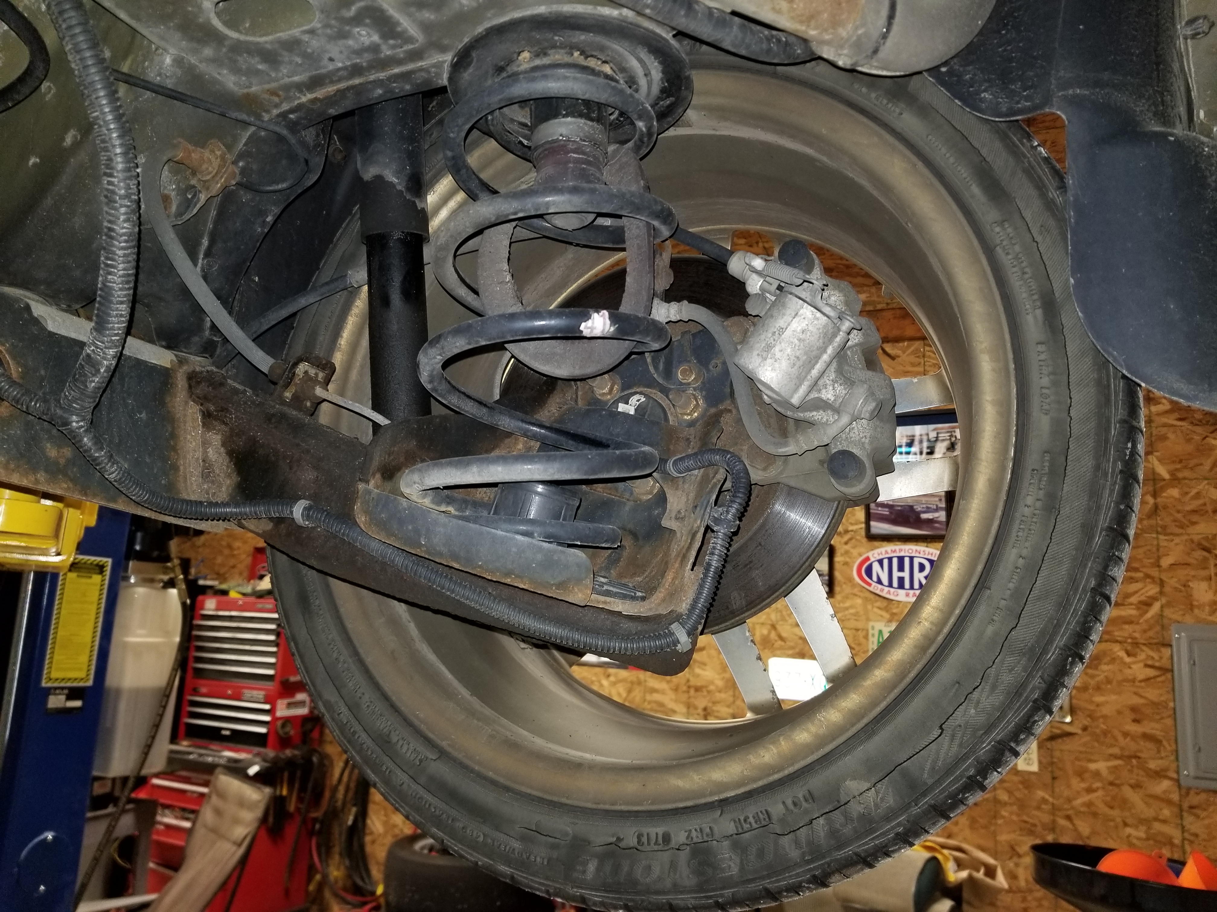

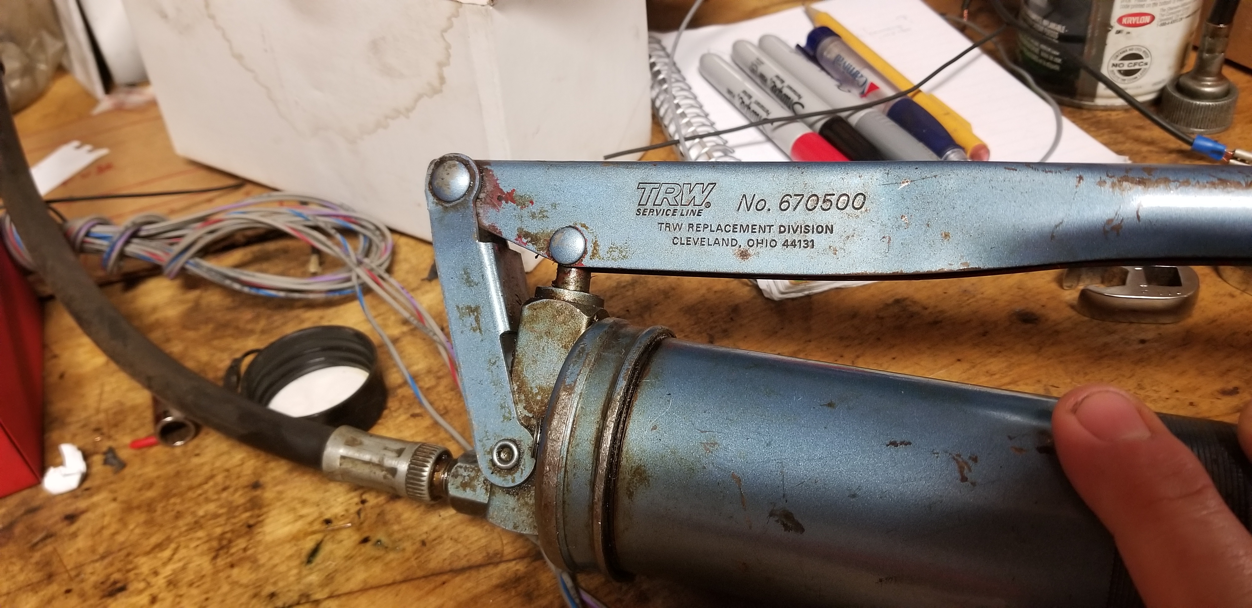

I've passed 130K miles and did a little more maintenance. Another Mobil 1 5W30 oil change/air filter/cabin filter/tire-rotation.. wow, must've been a while since I changed the cabin filter, it was a bit nasty. I also replaced both sway bar end-links, as a rattling had developed in the front end. They're like a double-sided tie-rod, which a ballish-joint on each end, non-greasable.
The replacements ARE greasable, which I found very surprising. It took me several tries to find a working grease gun. I've never had good luck with these things, it seems they are ALWAYS out of grease, bad seal, something.. this was no different. But, I did find something neat: This was the one I inherited from my dad, but I will take a little extra care to make sure this one stays operable.
