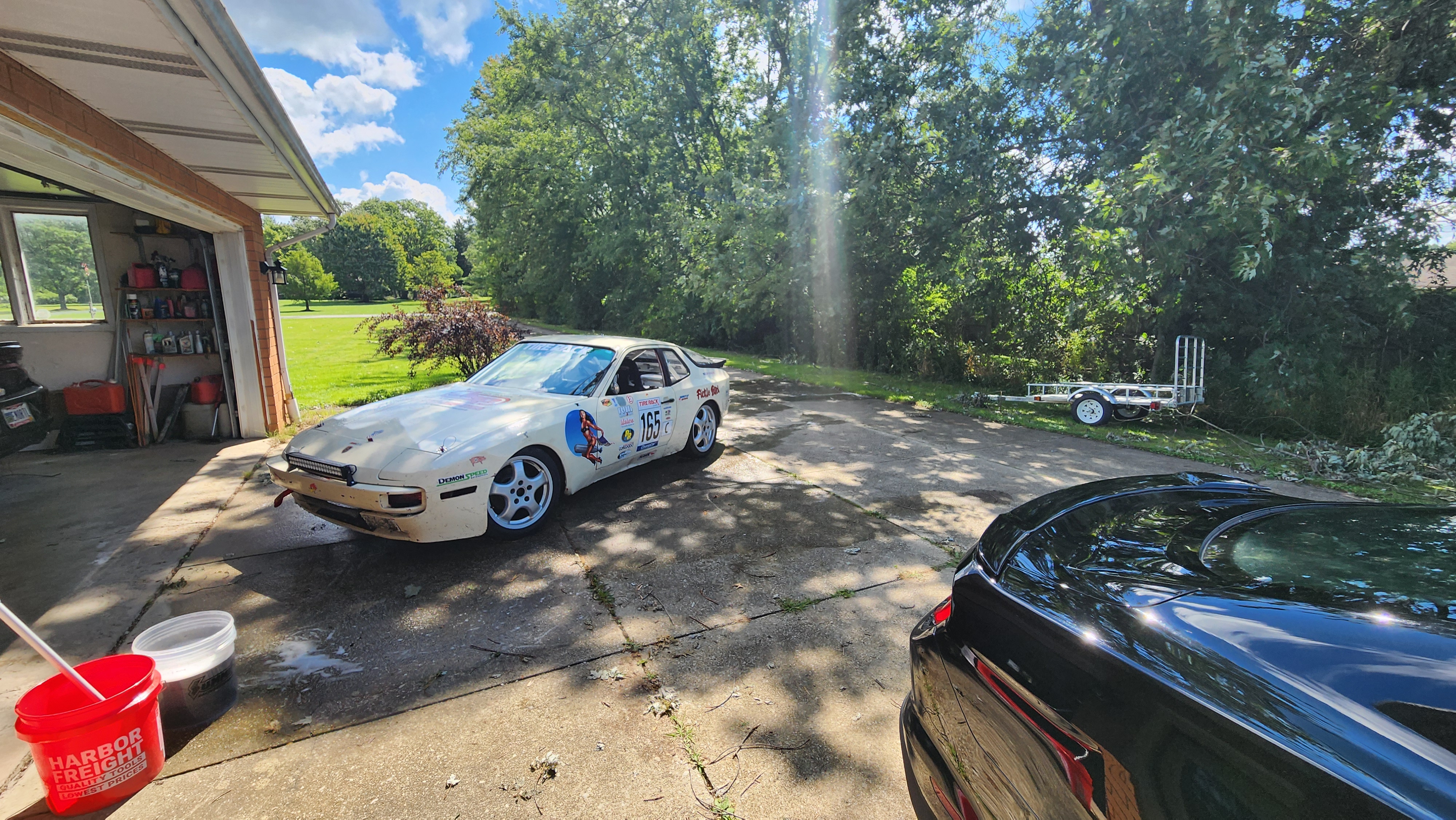

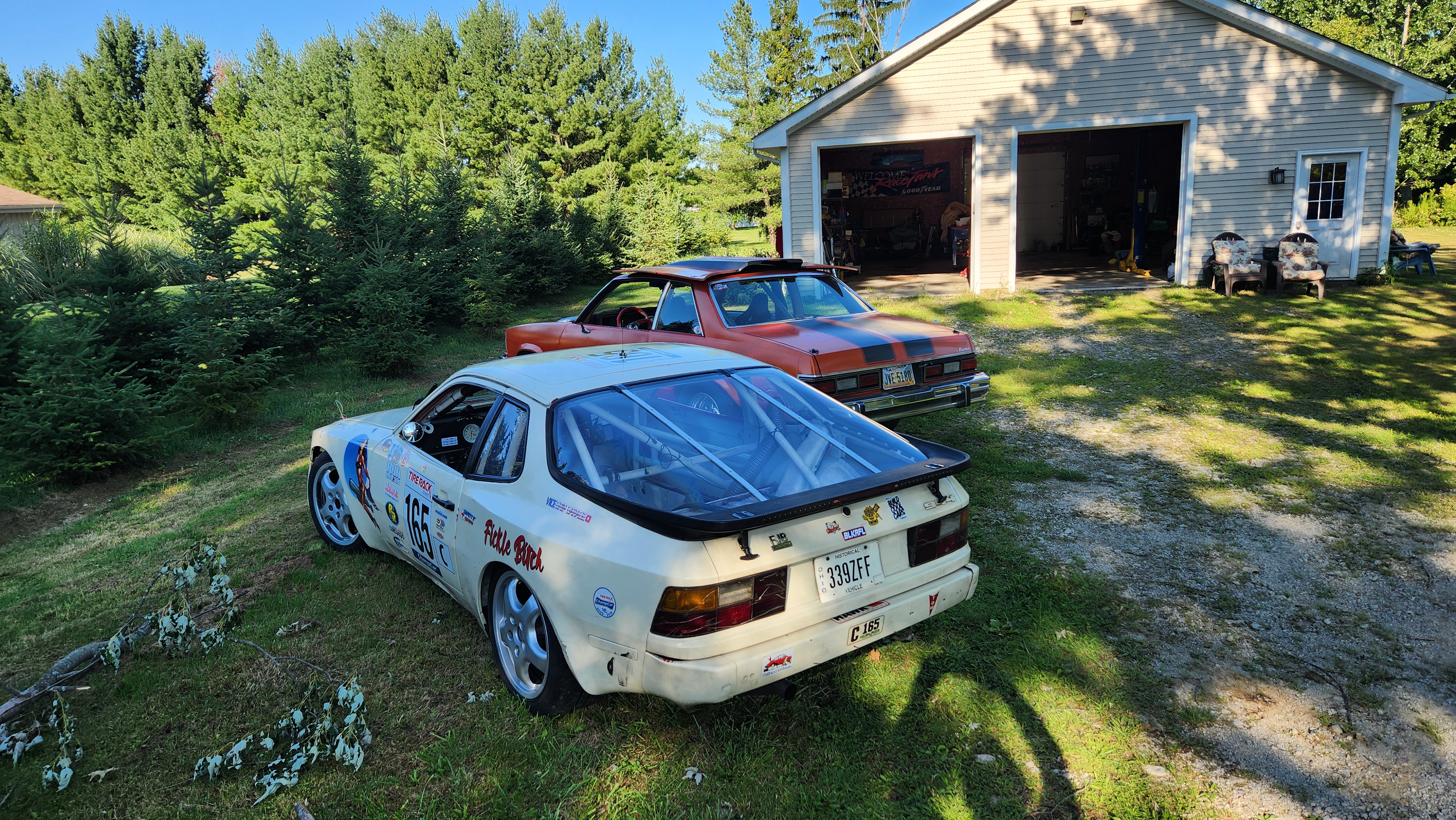

I drove it up and down Wilson Mills a few times, making 4 log/VEAnalyze iterations... i've been told this produces a better result than the live-timing. I even gave it a quick wash.
He picked the car up this past Thurs (8/15). We are racing it at Mid-Ohio on Sept 7-8.
