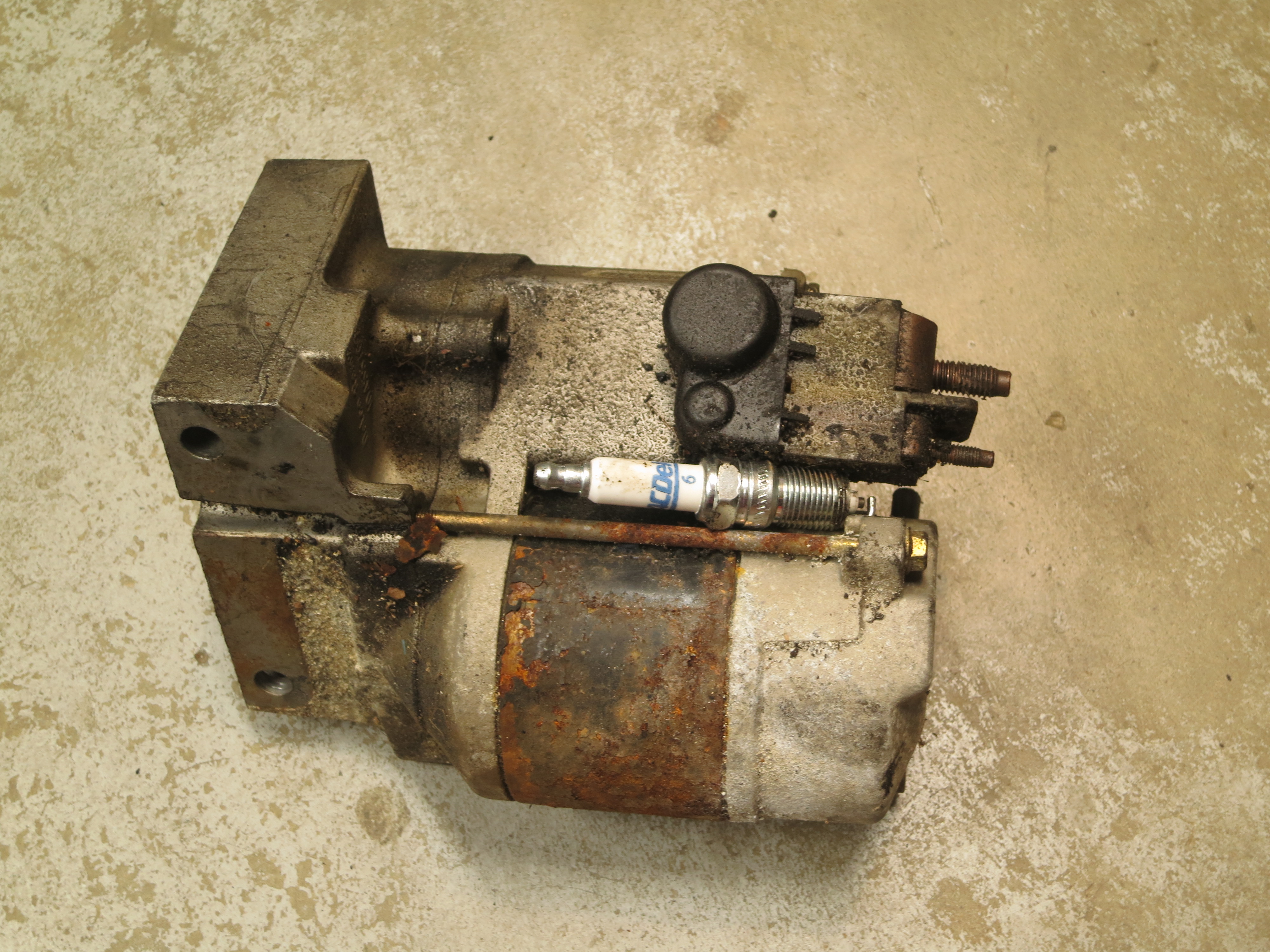

Today's work was tough. I started by installing the other 7 spark plugs while considering my plan for retrieving the one I dropped. The first obstacle I faced was removing the starter. One of the two bolts was buried behind the catalytic converter with no room to get a socket and extension on it. I tried various wrenches from the sides, but nothing would work. Finally, I ended up using a small bar to wedge a dent in the converter shield to allow access with a socket. Once past that, the starter was out. Turns out it is a remanufactured unit. My guess about the location of the plug was correct:

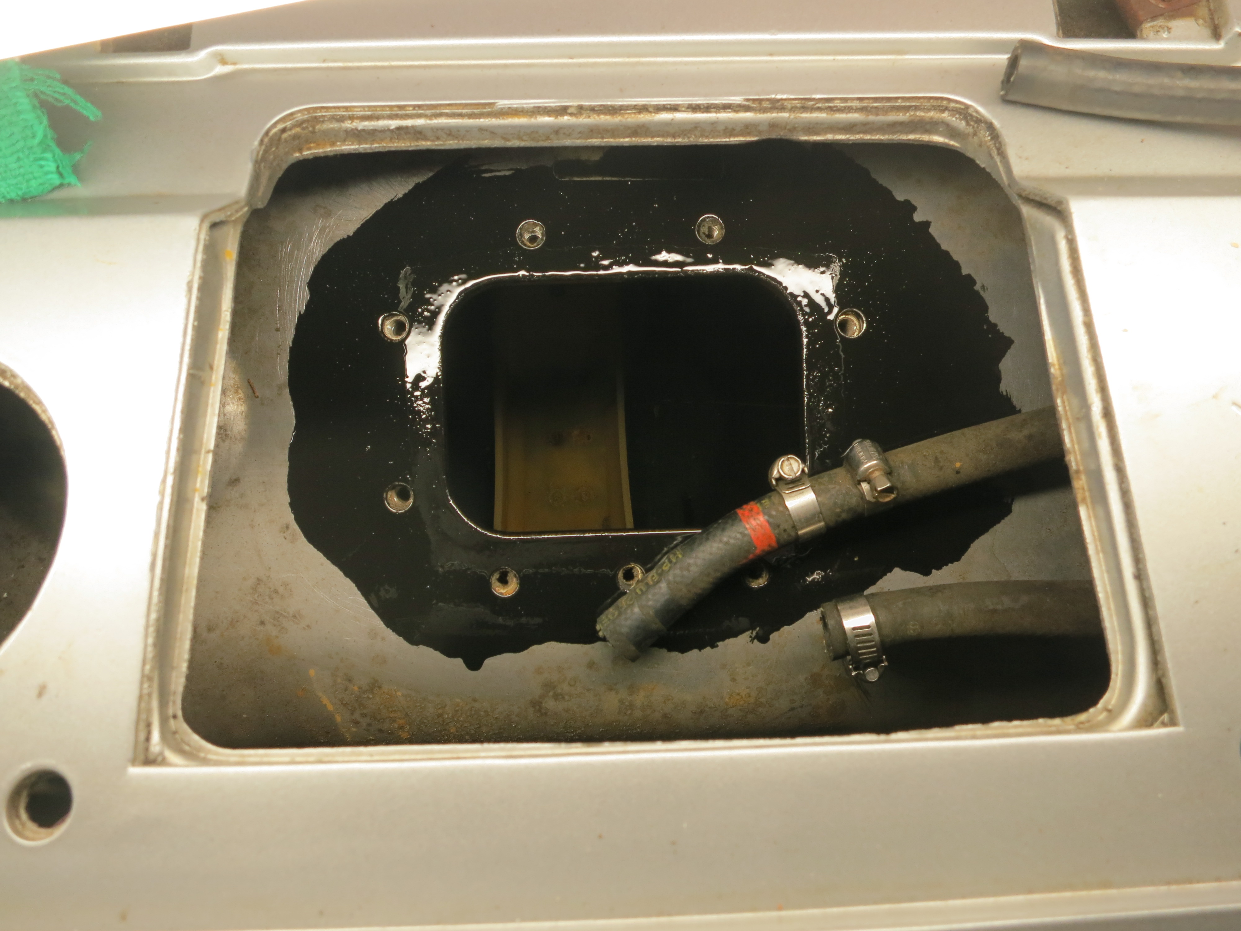

In preparation for installing the new fuel pump hanger assembly, I cleaned off the rust around the tank opening and applied POR15. Then, I will give the tank another cleaning before buttoning it up with the fuel pump hanger assembly. I need to work on cleaning and assembling the fuel rail next.

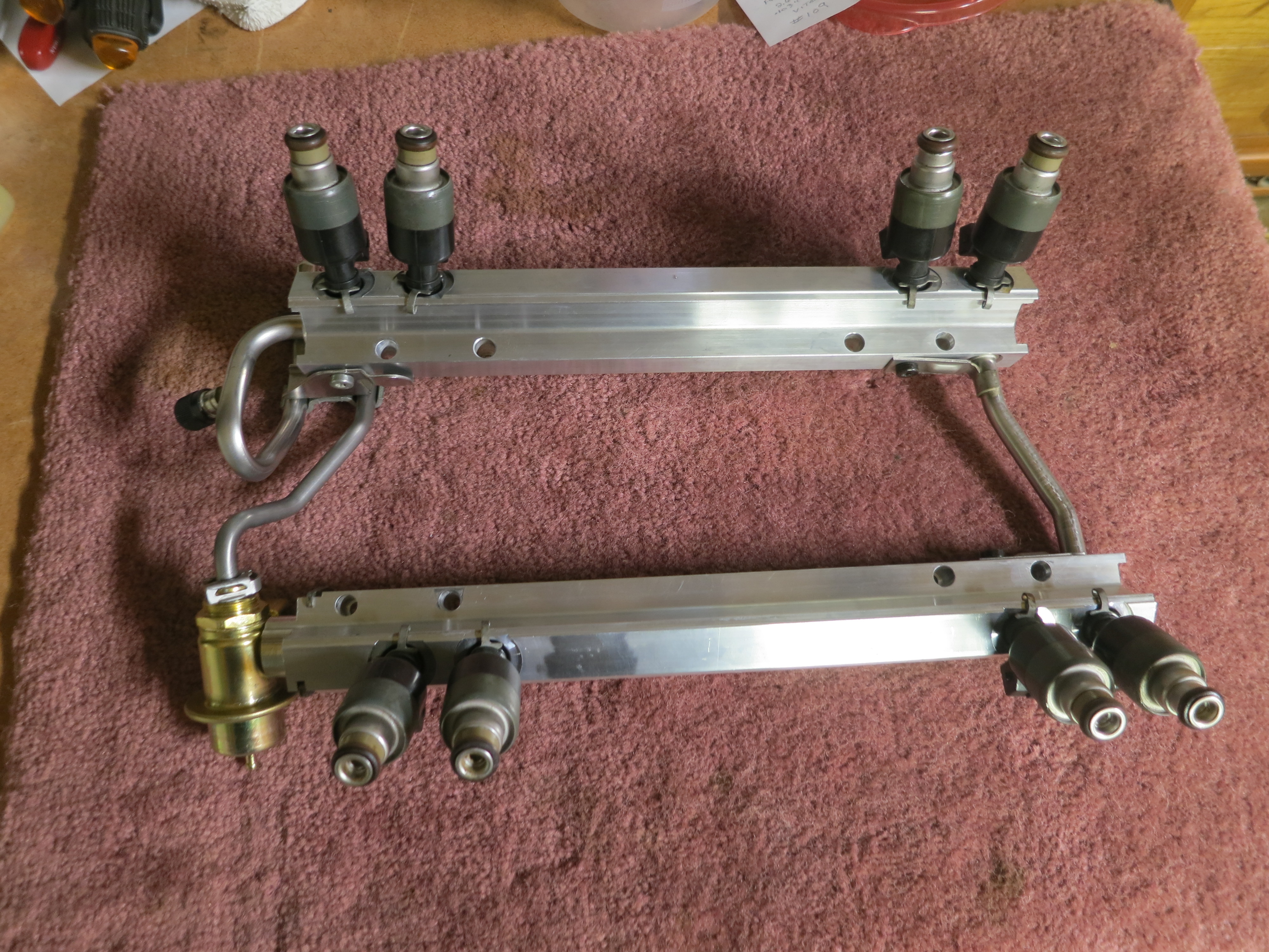

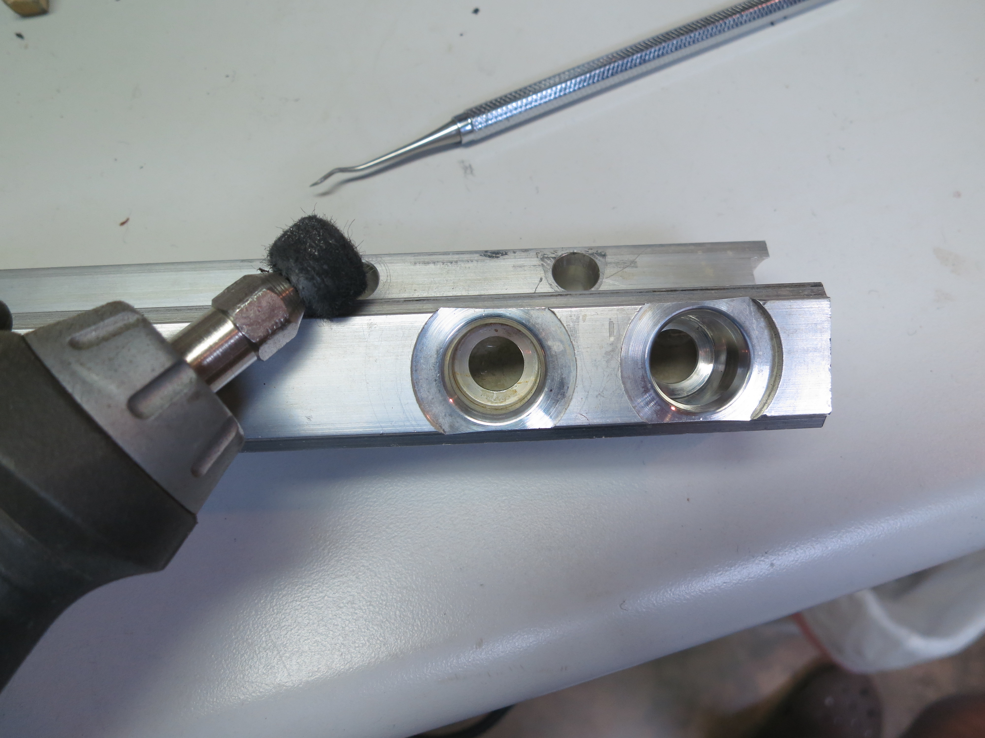

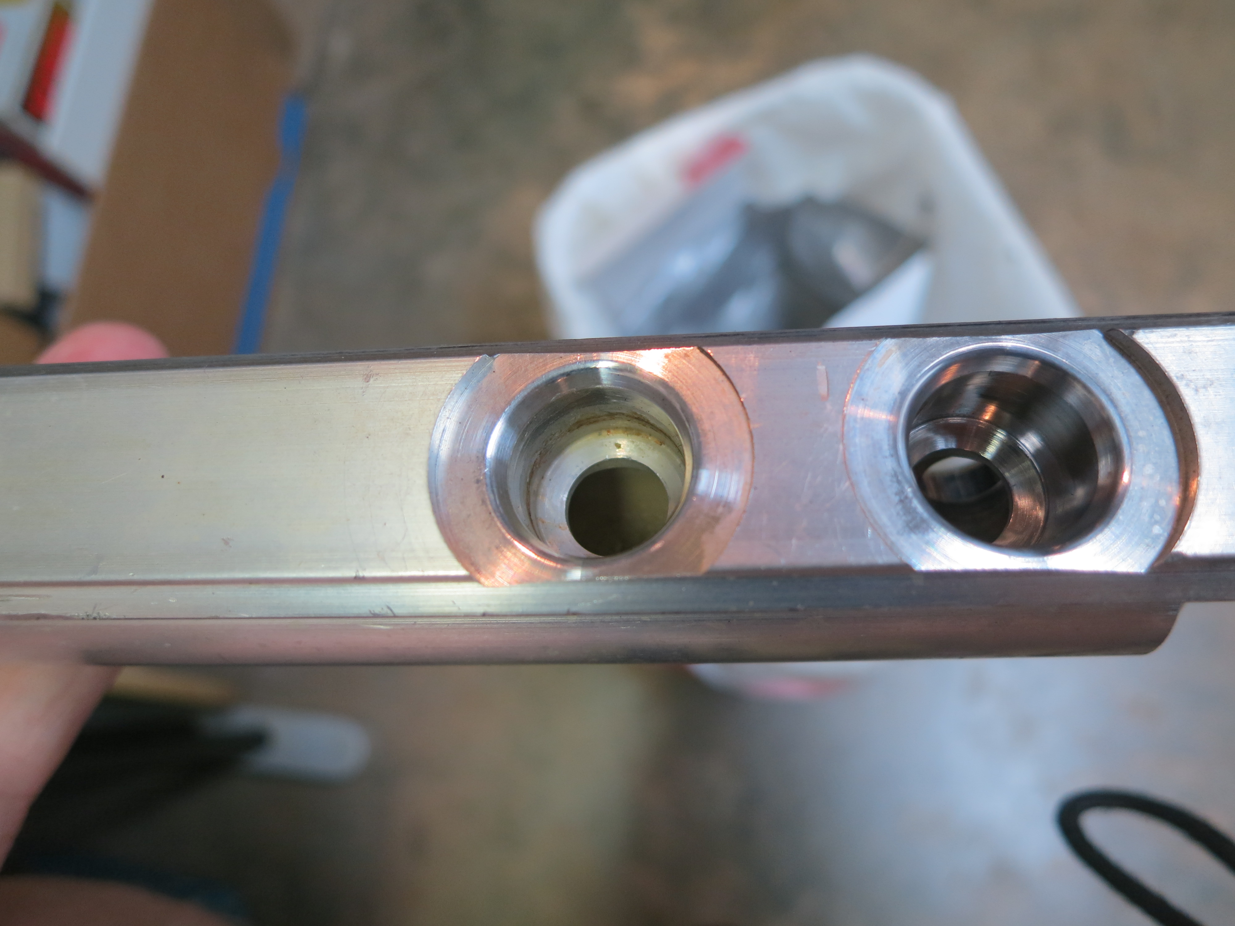

Today was fuel rail day. Each of the injector bores on both rails had a bathtub ring of deposits that were left untouched by any and all solvents I tested on them, even Evapo-Rust. Finally, I pulled out my dental hygienist's scaler and found that it was able to remove a lot of the built-up deposit. Then I used my dremel tool with buffing compound to remove the remainder and shine up the bores.

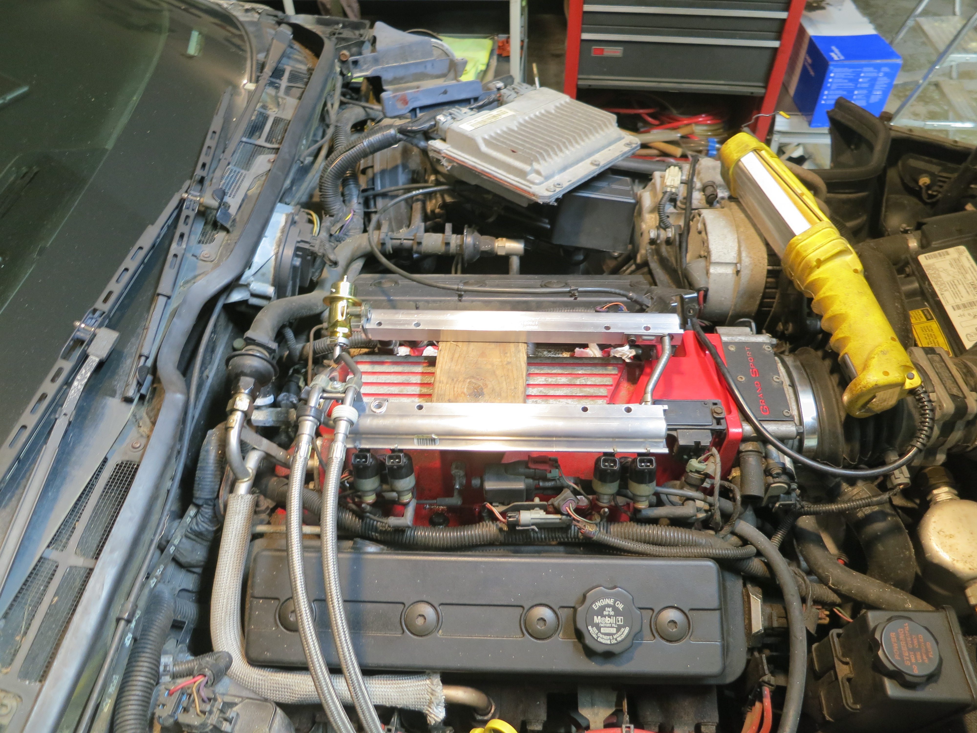

It was tedious and time consuming, but I'm happy with the results. I assembled the parts with the old injectors because I plan to run some clean fuel through the whole system exiting through the return line to flush out any remaining loose debris that might still be in there. Maybe tomorrow.
Here's the rail in it's temporary hookup for the flushing.
