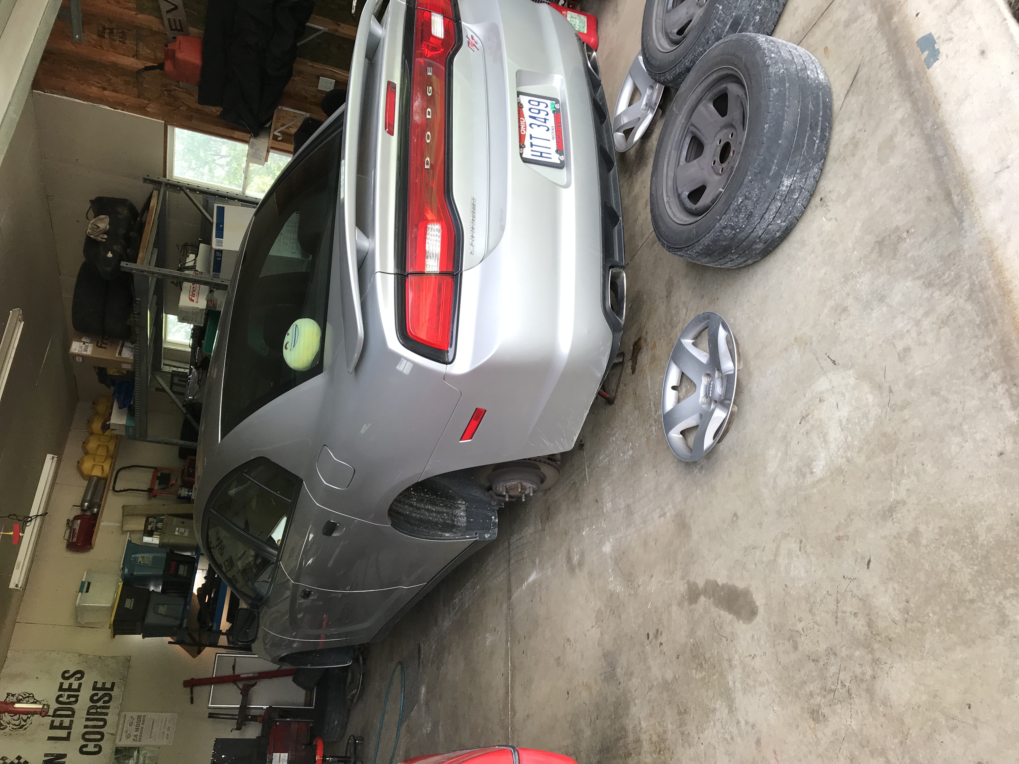

* chased down the rattle up front. Several plastic body panels were loose-ish so I replaced the factory plastic rivets with bolt fasteners, but the real problem ended up being the top strut bolts had loosened. I double nutted them as the nylock no longer appeared to be doing the job.
* replaced the Moog inner tie rod I had replaced about 18 months back. These parts are serious junk - bought a Napa replacement.
* since the Firehawk GT Pursuit tires were worn out I installed the Eagle RSA tires that came on the second set of rims she bought for snow tires. Bummer though one of them had a bulge in the side and that one was replaced with a Firehawk AS. (snow tires were on from mid-November to Jan 3 but they were not going to Texas!)
* The LR had worn out faster than the other tires - I figured it was out of alignment - which it was. This turned out to be an easy adjustment as the frame end of the toe link has an center offset washer that allows you to rotate the bolt and make the adjustment.
