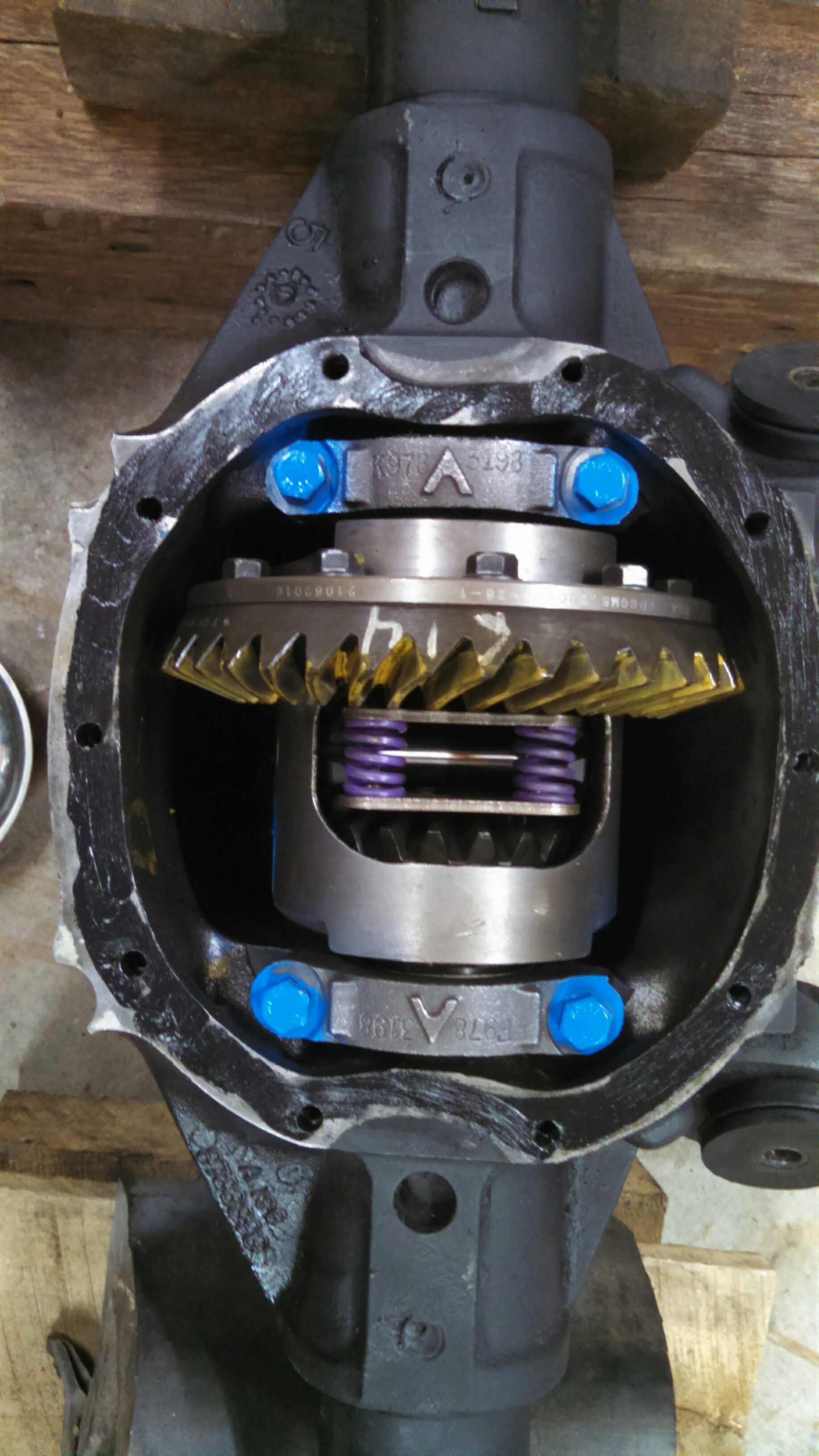

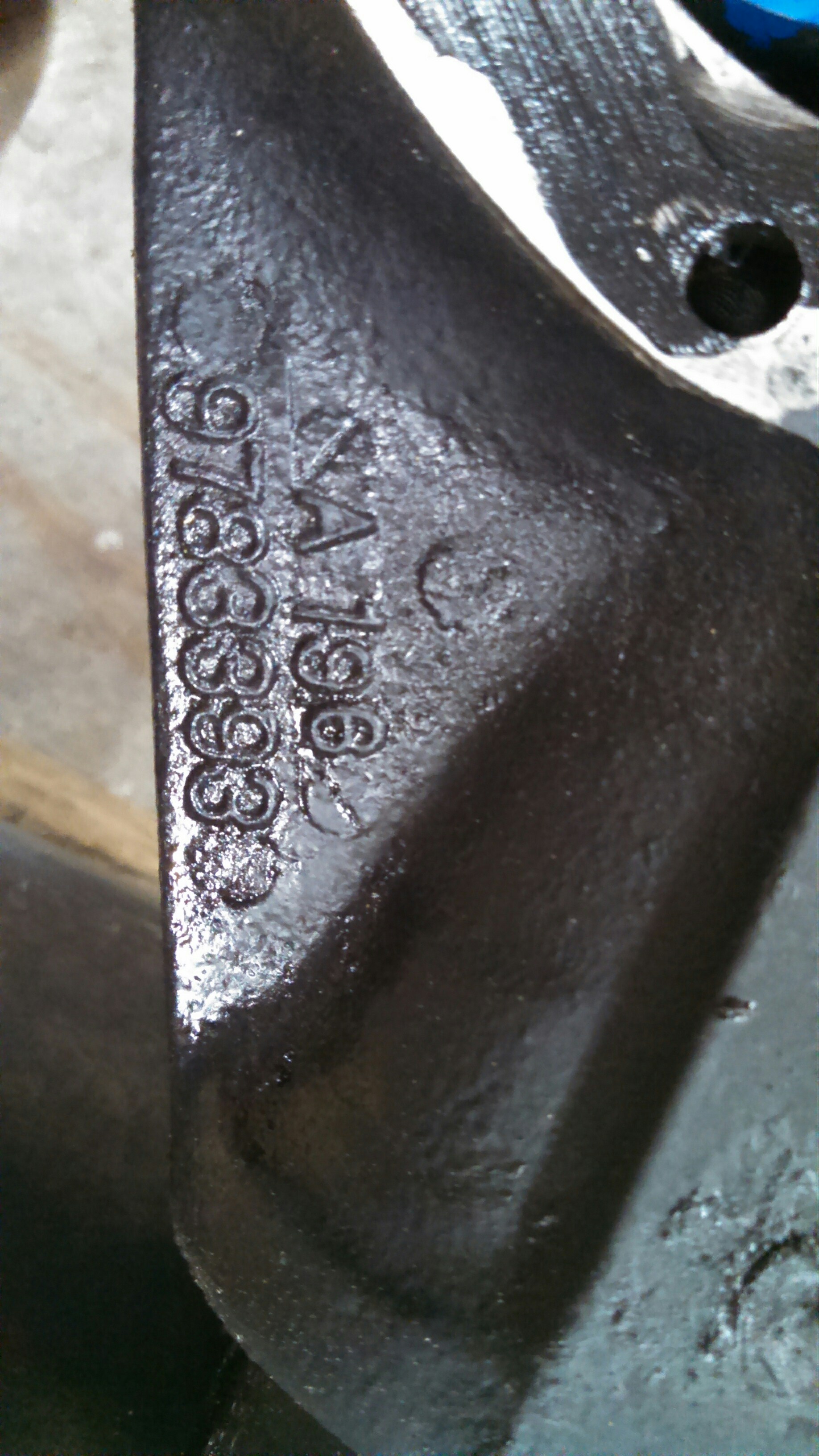

Ok! So the rear end guy kept his promise and got my axle rebuilt in one day. He also confirmed to me that
the rear end (based on the numbers in the picture below ) is of correct vintage for the vehicle and the
gear set matched the code on the axle. We brought it home on Thursday and installed it in Friday. We
installed an Eaton posi carrier and Yukon 3.36:1 gears. The install went better than expected and didn't
take us two hours. We filled the carrier with the required 3 pts. of gear lube ( 7 ounces of that was posi lube )
and slapped it up in the chassis. While the wheels were off, I tested my spare tire ( which I mounted with tire
irons on the floor the other day -- waiting to be balanced ) on the car and it fit perfectly, and is a great match
to the others on the car. After all of that stuff was done, I took the speedo gear out of the trans. I'm starting
to research which gear to get. From the preliminary research, it looks like I will have to change the drive gear
on the main shaft of the trans, but more to come on that. More steps forward!!
