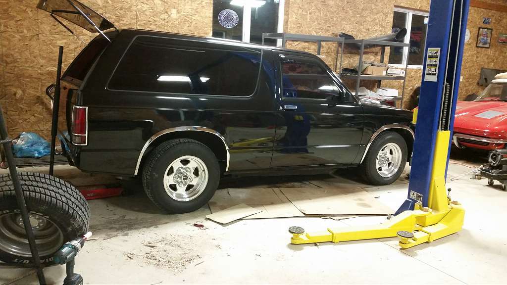

Tonight, I decided to see what different wheels look like on it. The set of Centerlines that I bought for the Chevelle in summer 2015 was a 5-wheel set, with an extra front. So, I grabbed that and one of the rear wheels off the Chevelle and bolted them on. Looks tons better than those smoothies. Its interesting to see how what a big difference there is from 215-65-15 to 215-70-15. They're almost an inch taller and help to reduce the rake.
I cant wait to get rid of those smoothies and put either these or ZQ8 wheels on it.
Posts: 3682
Re: 1985 V8-S10 Blazer
Those do look sweet. Does it already have lowering springs in the back? I think if the back were dropped another inch / inch and a half, it would sit perfect. That taller tire helps a bunch in the front.
Posts: 2645
The rear already has some lowering blocks installed. I really think before this is all over, I'm gonna end up changing out the 2" drop spindles up front for 1" drop spindles.

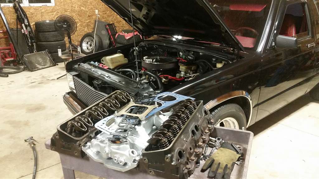

So I ran some pretty terrible times at the dragstrip in this thing earlier in the summer. I left it together, but knew that once the season wound down, I'd have to address the lack of power. By the times posted today, Kurt's 187k 3.5 V6 would solidly beat me. The Saturn would crush me. I've got 5.7L compared to 3.5 and 1.9! I'd really like this thing to trap at 100+ MPH.

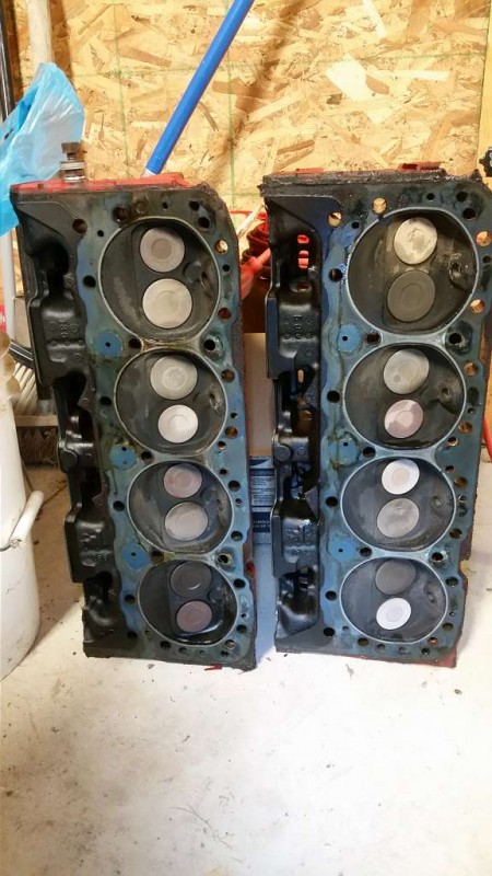

Going through the Tiresmoke parts bin, I have a pair of stock Vortec heads, a Performer RPM intake, and all the associated gaskets and even a set of head bolts from Mostmint's acquired inventory. I already cleaned the set of head bolts, so that they are ready to bolt on once I got the old heads off.

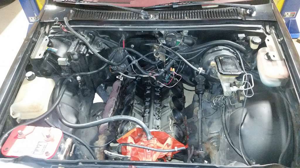

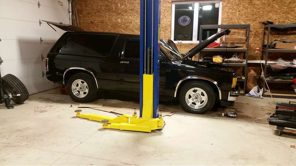

I had removed the top of the engine and the intake sometime back in September. I pulled the radiator and un-used AC condenser too, so I can start engineering a solution that will allow me to run an electric puller fan(s). The plastic flex fan, is just unacceptable. It's less than adequate in true stop-n-go traffic, makes too much noise, and it surely costing me power at higher engine speeds. Recall that it doesnt really rev over 4500 rpm.

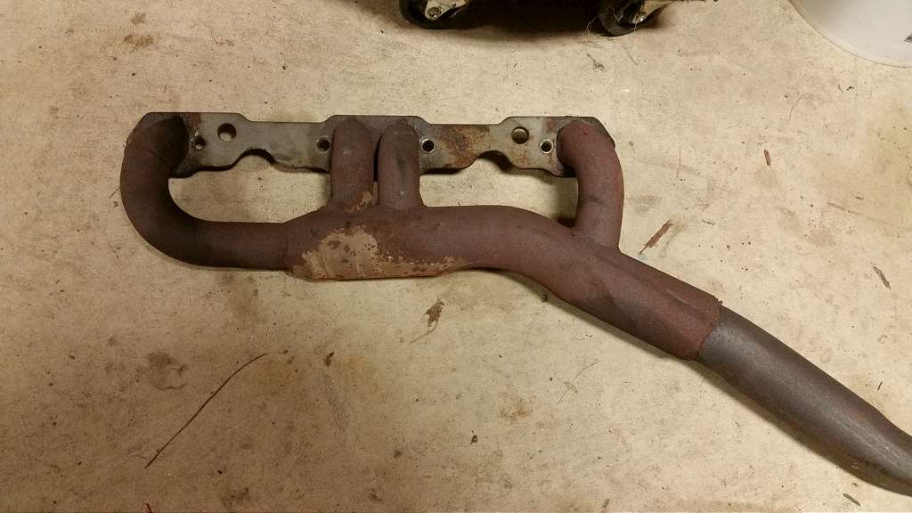

I couldn't get the heads off then because the exhaust was in the way, and to get that out, I had to cut exhaust under the car. This was near the end of September, while in October two weekends were occupied with Chumpcar races. (an abysmal weekend in Pittsburgh, followed a couple weeks later by a great weekend of two podium finishes at Road America.
Today, I got under there and cut the exhaust so I could get it out of the way of the headbolts. My co-worker Tony recently gave me a Ryobi sawzall (barely used) & Black/Decker jig saw (brand new) because he was never going to use them again! The sawzall cut the exhaust like butter. Chris was over with assist today.

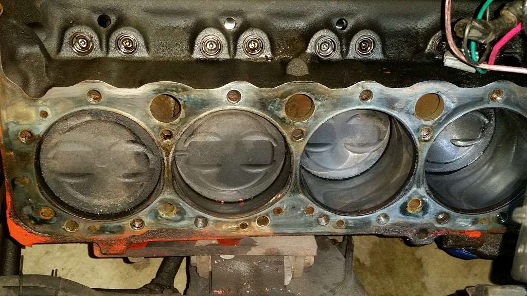

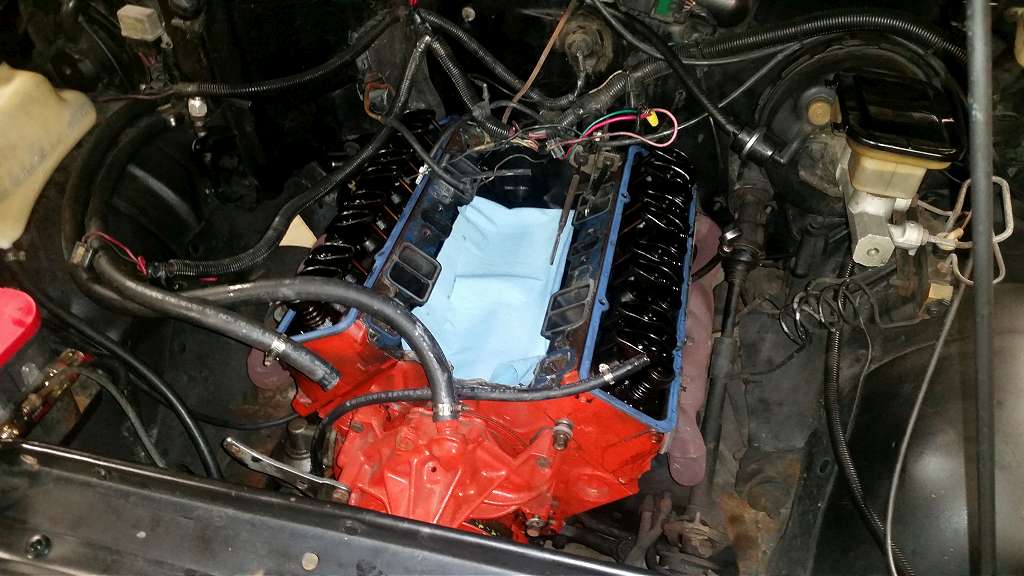

I got the heads off without any real difficulty. 991 castings, which are truck heads with 1.72 intake valves. The Vortec heads have a smaller, superior combustion chamber, which will gain me almost a point of compression. The intake port is way better too. Head swap alone could be 30-40hp, possibly more since I had small valve heads. I could do just the head swap and not spend a dime. I have everything.
The dilemma is the cam. The engine has to come out to do a cam swap. A cam swap, along with the heads would really wake this thing up. But to get the engine out, the driver's side top bellhousing bolt is really tough to get at too. I bought a couple sacrificial wrenches tonight that I can maybe custom bend to get this bolt out.
The other issue with a cam swap, is what will the current exhaust system support? Looks like 2 1/4 at best. Full length headers (installation issues unknown) would require significant exhaust re-do. The more common mid-length swap headers appear to be unpopular because they're barely better than manifolds, and getting collectors bolted up is a PIA. The gains aren't worth the hassle, allegedly. I currently have a set of 'swap manifolds', not sure what you'd call them.

Posts: 1313
Dave....
How hard is the transmission bolt to access when the cylinder heads are off?
Maybe you could get the block out, cam it, and re-install the heads afterward?
Perhaps you could drill a hole (the size of the socket required) in the firewall
just behind the bolt, to act as an access port and then plug it up when the install
is done. You have until April to get the truck back on the road (assuming that
you don't want to drive it at all in the winter). You will kick yourself if you do
all of this work and THEN decide that it needs a cam, but that could always be
next winter's project! The real question is -- Why will it only rev 4500 rpm? Is
the cam the real reason, or is restriction of exhaust, crappy heads, maybe a
timing chain that is installed on the wrong ( +2, -2, or 0 ) way is causing that
as well. Just some input!!
Posts: 3040
I was thinking two things:
1) why not pull the engine and trans together
2) u can change a cam without changing heads. If you want to make this a bigger project you certainly can but if you just put on the new heads and intake it will run a lot better and you won't have to go to the next level. It really just depends on where you want to spend your free time. Also - do you have a cam or are you buying one? The Chevelle is already fast this is a secondary utility cruiser so do you want to throw a few more C notes at it?
