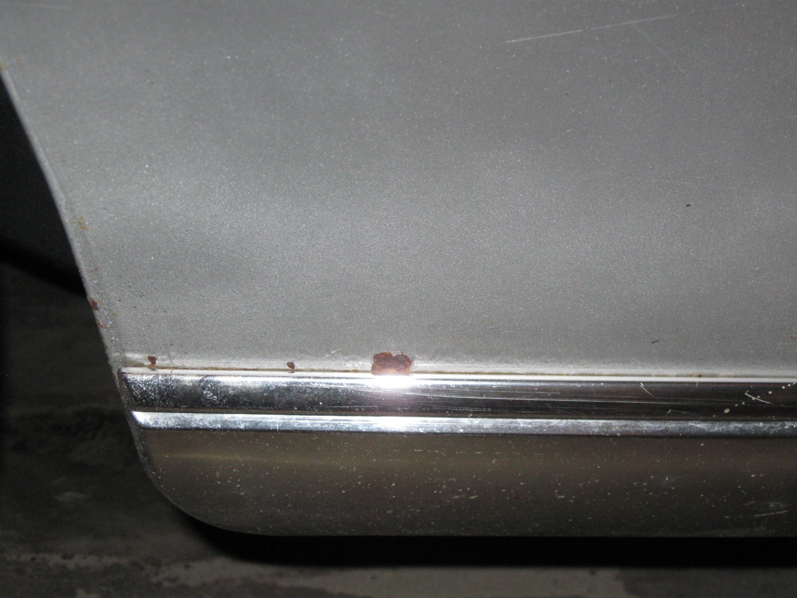

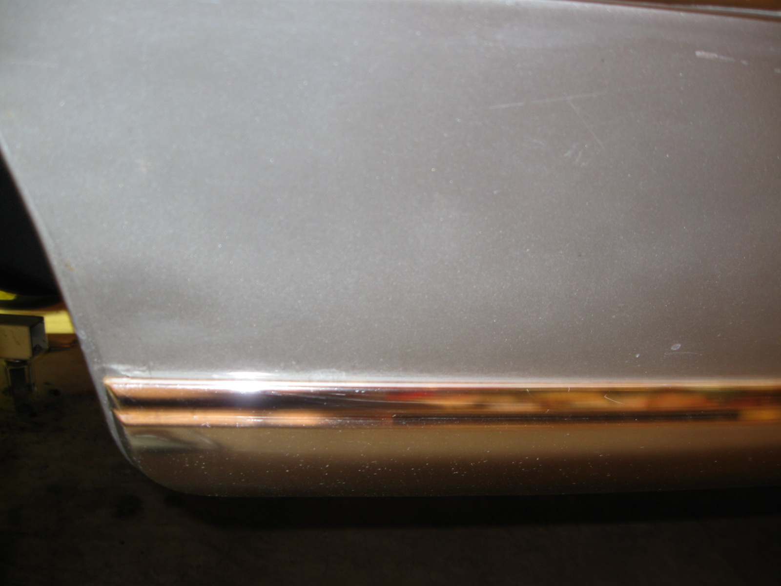

Recall the 1/2" spot on the left fender above the rocker panel with bubbled paint and surface rust.
As posted before, the trim was pulled from the rockers and the surface rust was treated with OSPHO, wire brushed, and painted with POR 15 and touchup paint. The result isn't perfect but the imperfections won't be noticeable unless the car in on a lift.
