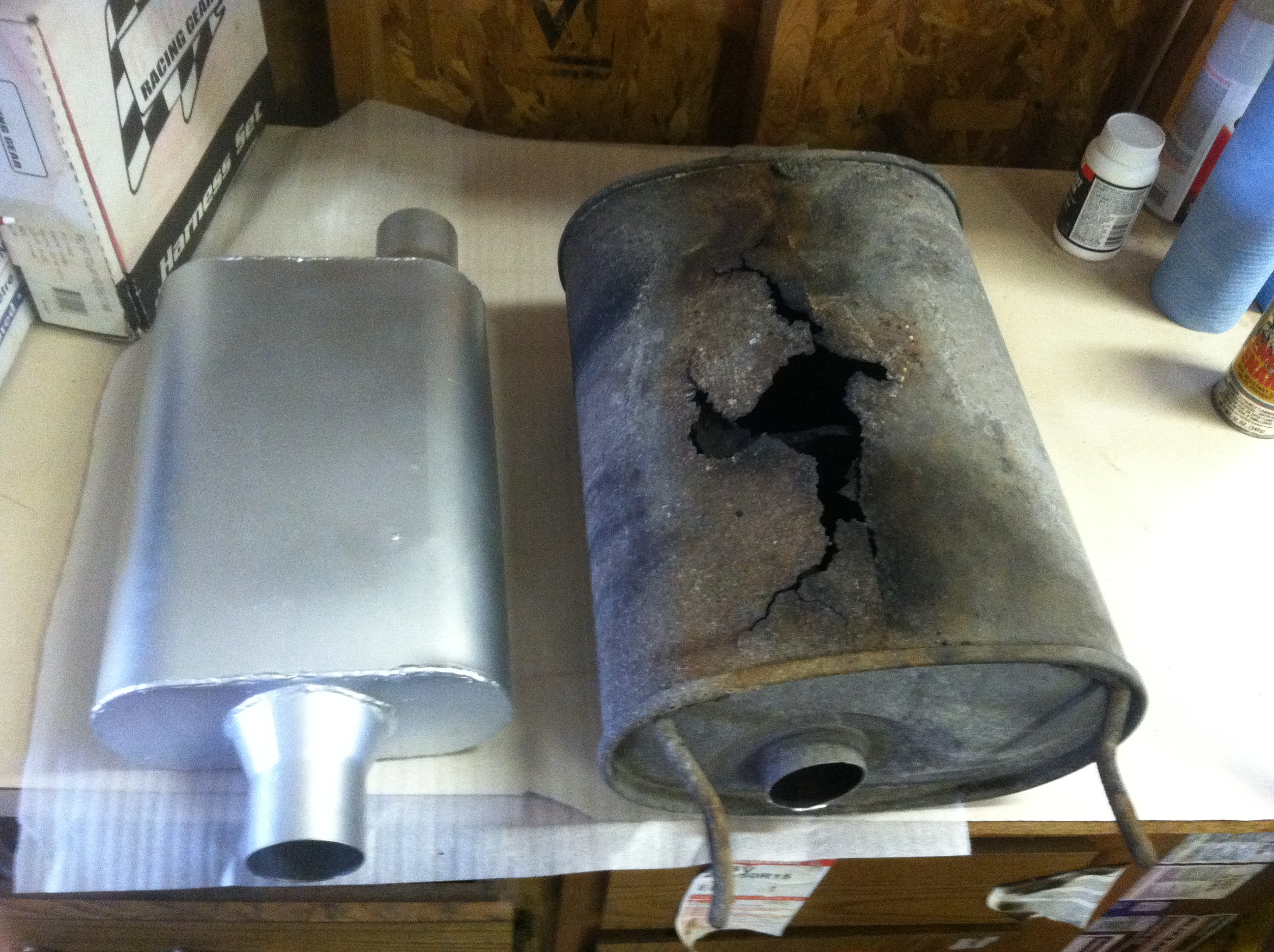

4) Also the car got loud a couple months back. The LR muffler had a dent in it and apparently the inners broke free. Sounds trashy probably going to put the SS OEM mufflers on it.

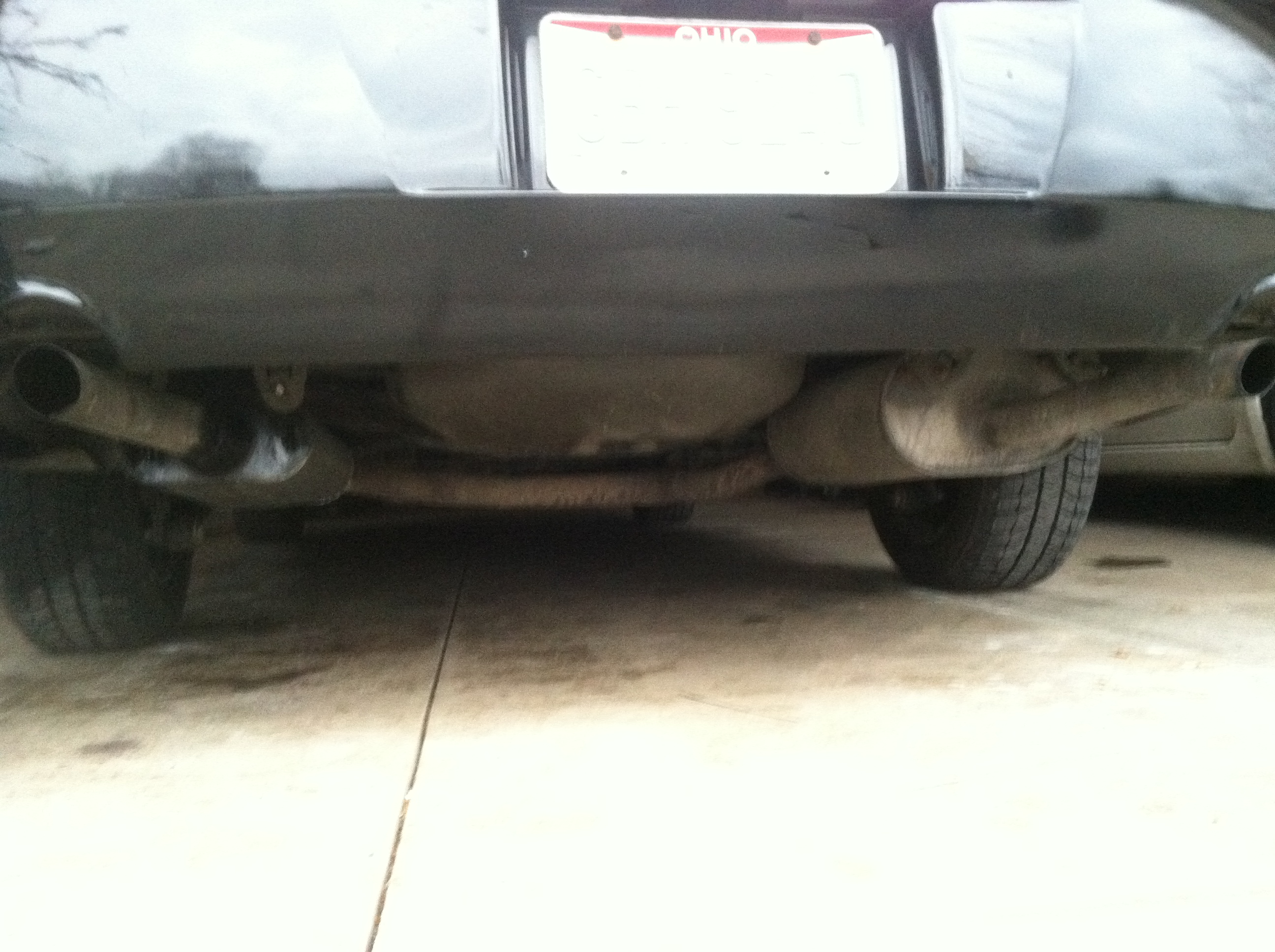

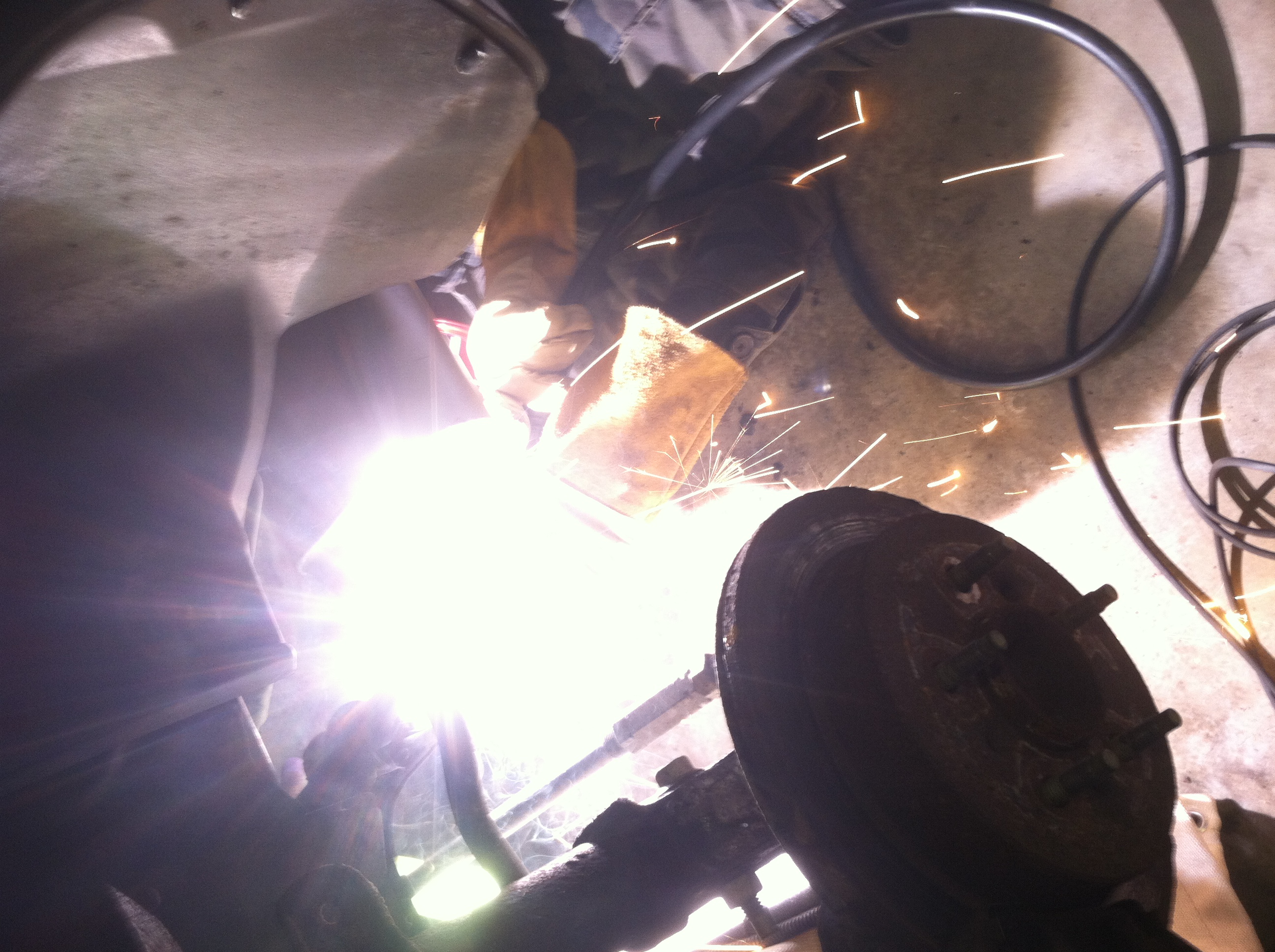

Was planning to put the SS muffler on the car but Rachel said that would be too quiet. So we found a Flowmaster knockoff at Summit. I think I picked the quieter version but still better than stock.

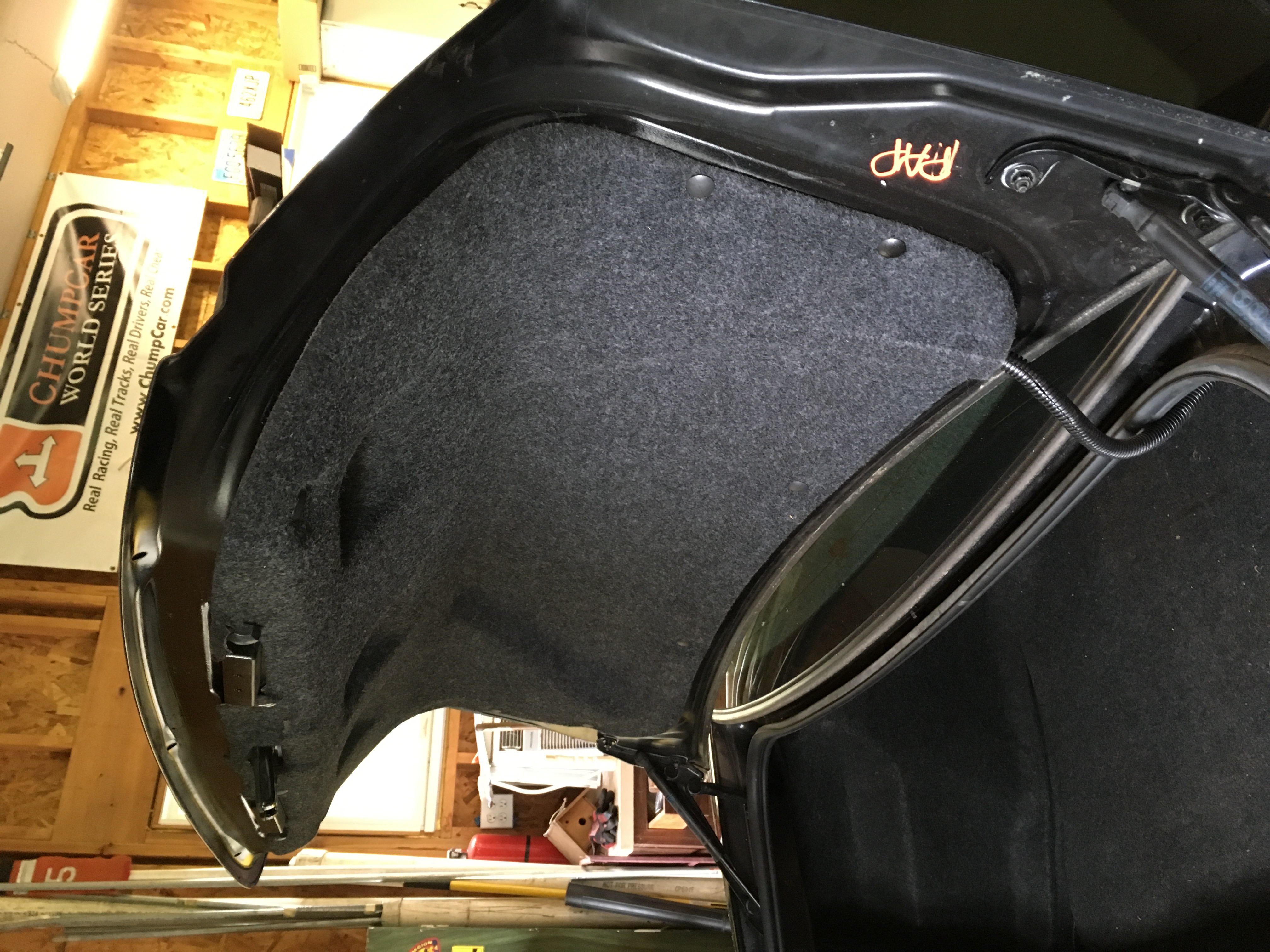

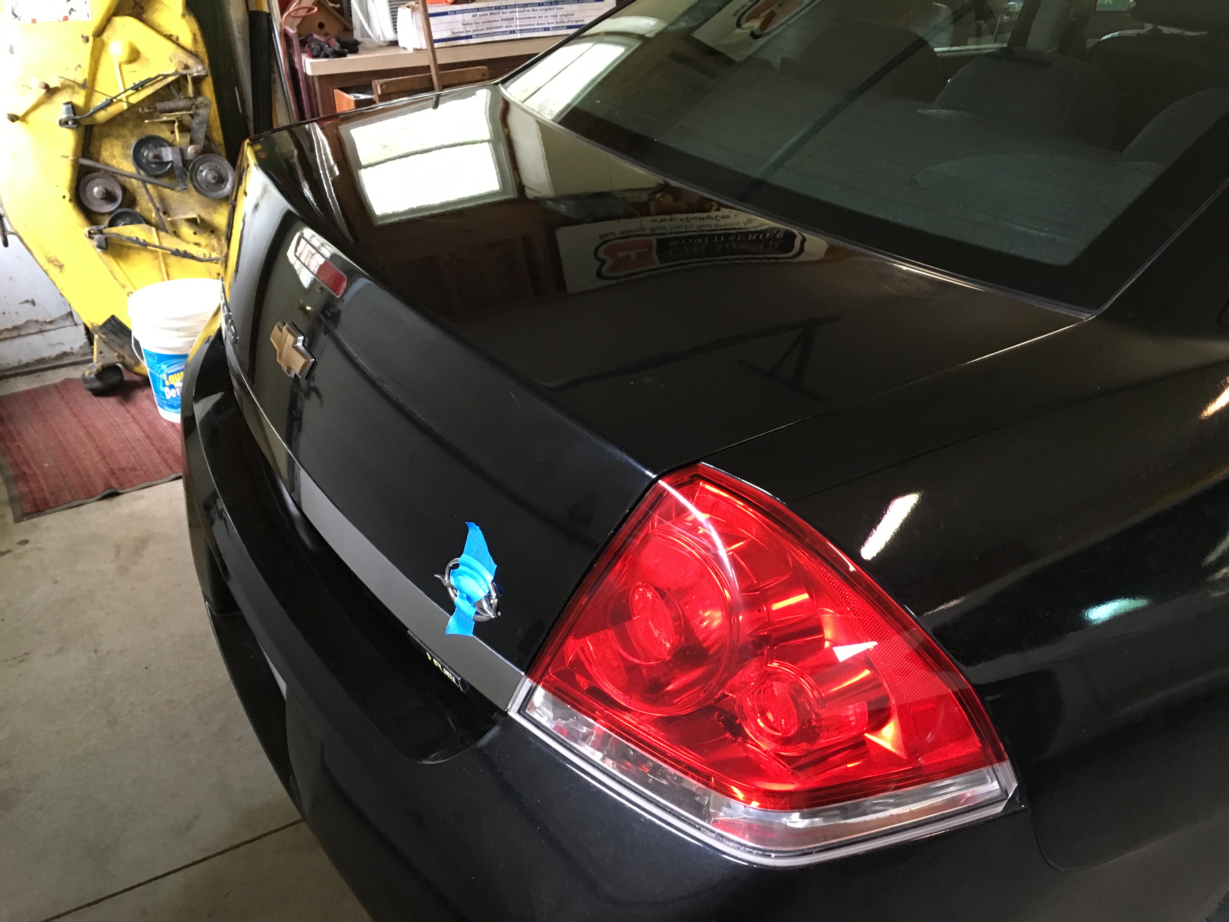

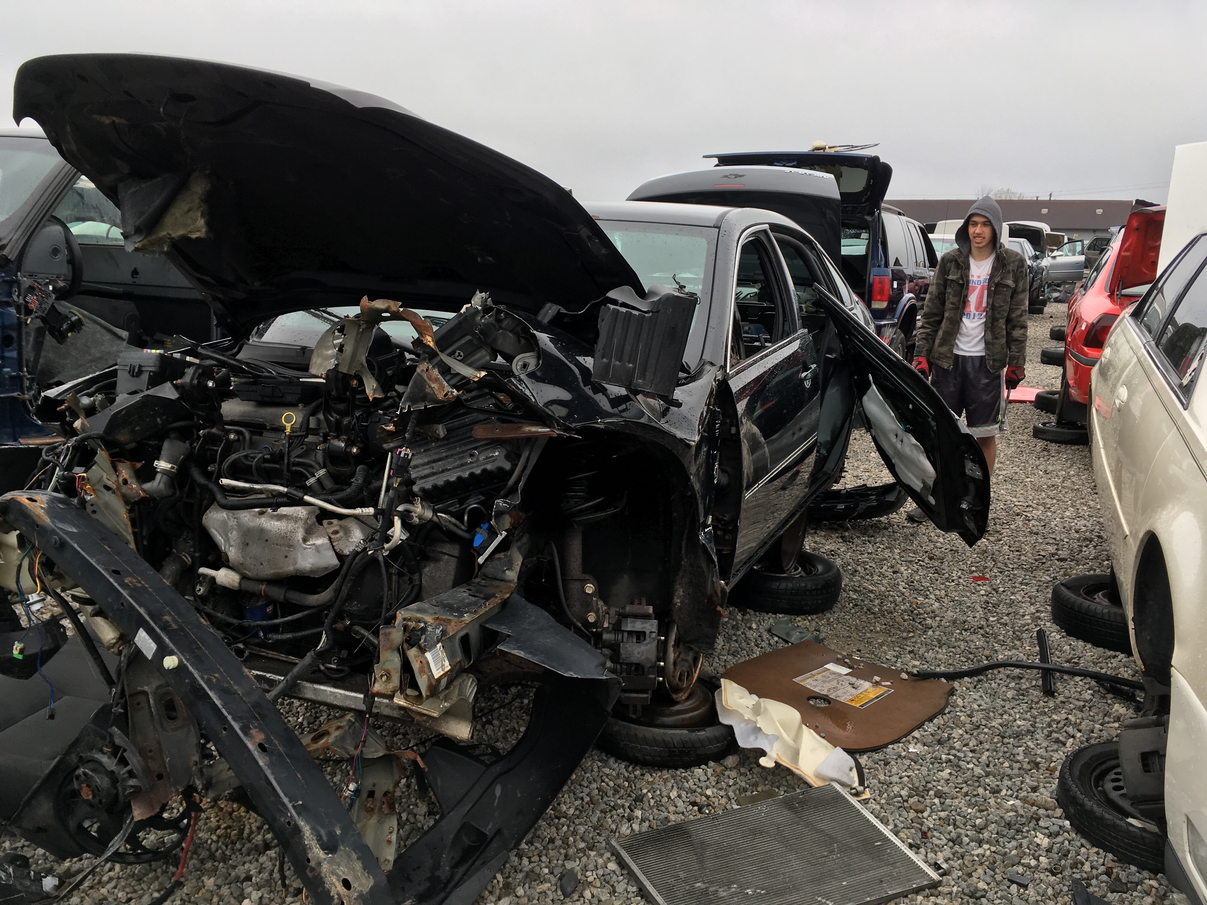

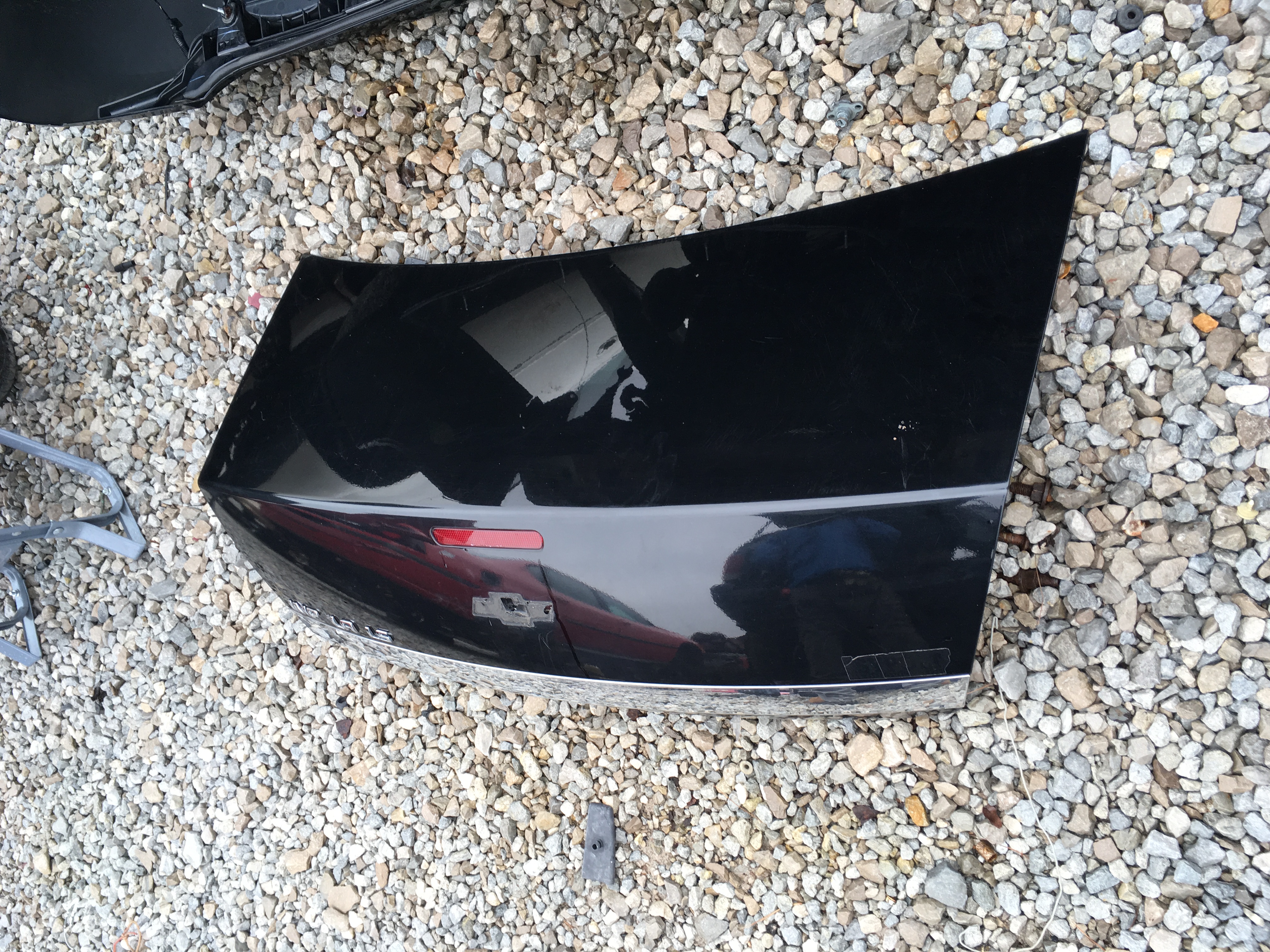

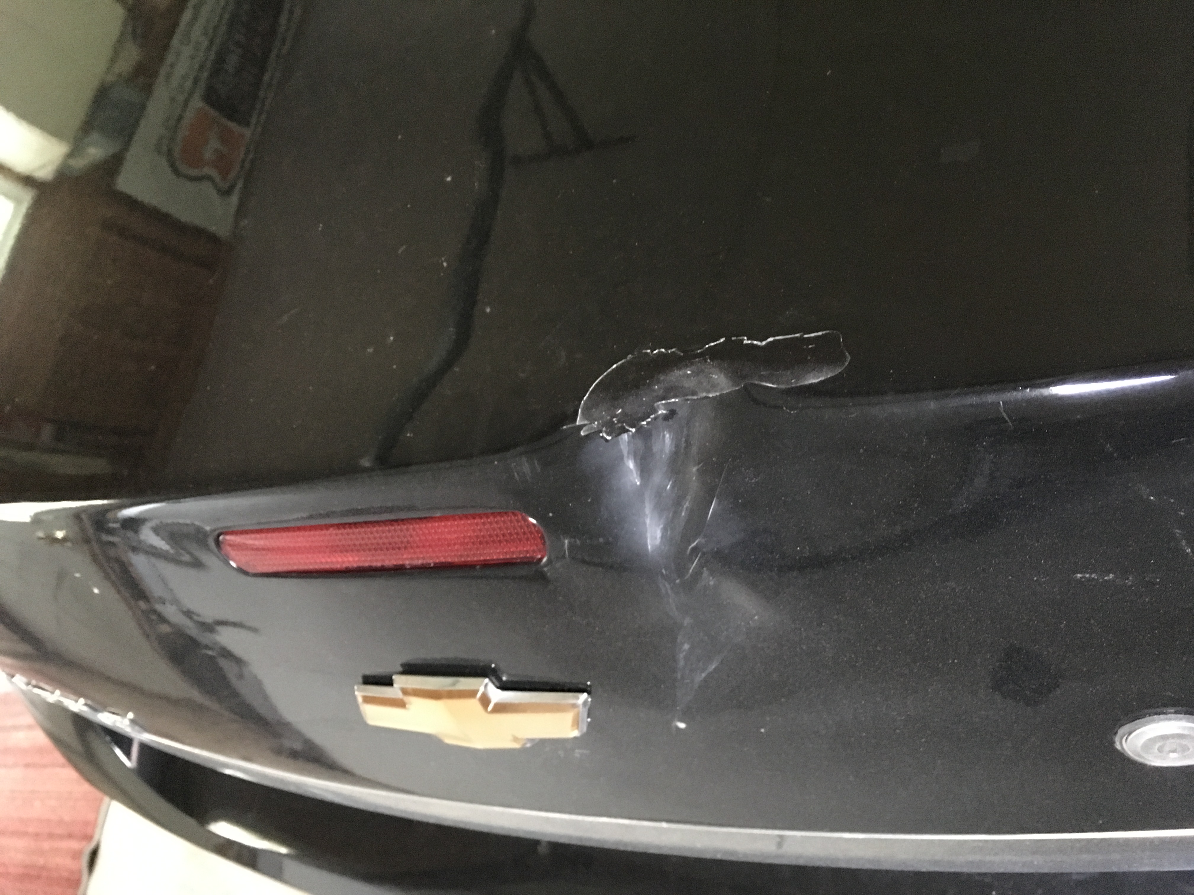

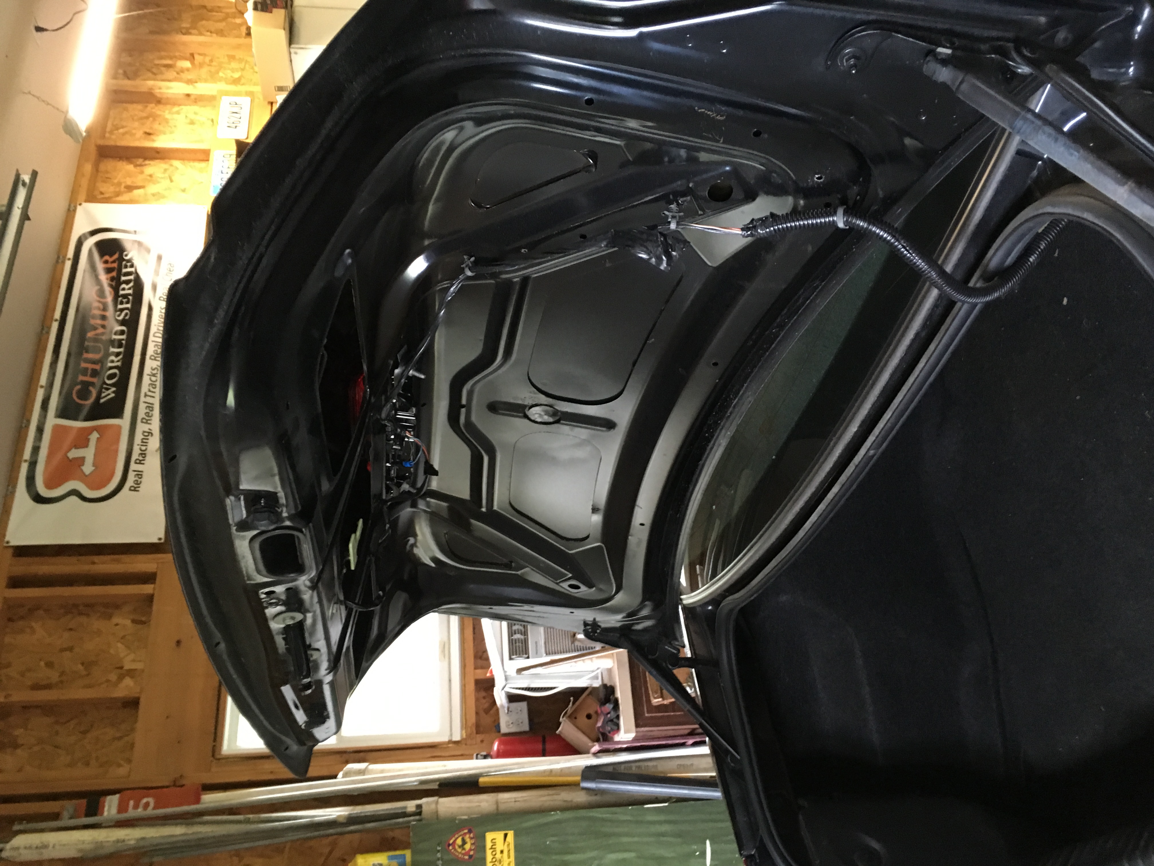

Rachel backed into a mailbox and dented up the trunk in March. The first pic is after I pounded out the dent and touched it up. I am not locating the pic of it "as crashed". A trip to pull a part for a color matching replacement and the car is is back together.
The donor car: Bonus cover on inside of trunk, and not the "PAP" signature The finished product
