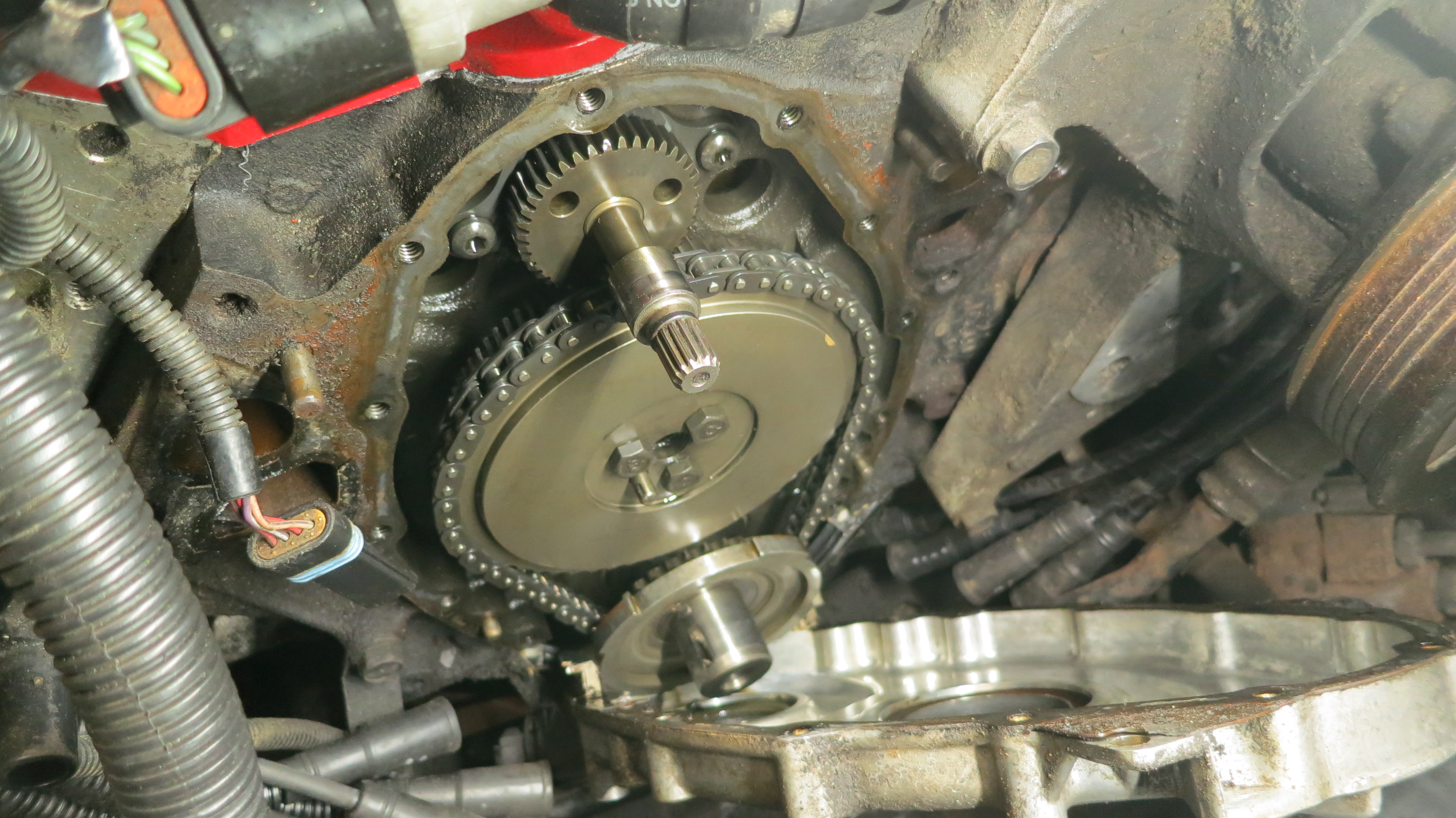

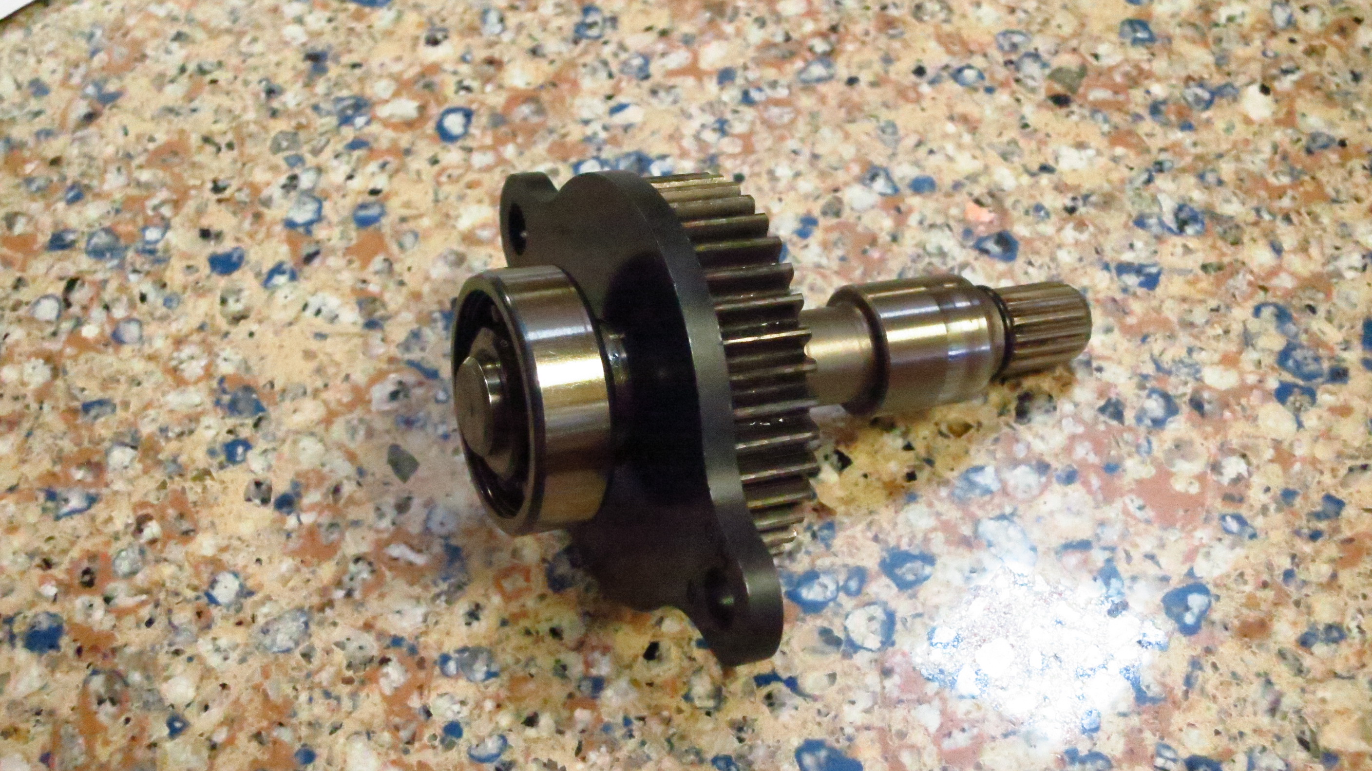

My decision to replace the timing chain on this motor had potential pitfalls and I believe I've hit every one of them. The new timing set would have been a slam dunk if it had not been for the requirement to change the gear on the water pump driveshaft. To change the gear, a bearing on the end of it needs to come off first. The bearing on that driveshaft has been a nightmare and I've learned a ton dealing with it. The bearing is pressed onto the driveshaft and the outer race is pressed into the block. If not done correctly either or both of the pressing operations can destroy the bearing. In my case, I believe this caused the startup noise and filings in the oil pan.
The water pump driveshaft is driven off teeth on the back side of the cam sprocket so the relationship between the two are critical. The location of the bearing on the shaft determines the spacing between the water pump gear and the timing sprocket and chain.
Well, with Maverick's help yesterday we learned that, on the second (and last) trip to the machine shop, he did not press on the replacement bearing on the right place on the shaft. There is a ledge built into the shaft and this appears to be the right location for the bearing on the shaft. The new bearing was not pressed all the way to the ledge. This resulted in a water pump drive gear on the shaft to be positioned too far out toward the front of the engine. Then when I assembled the timing set, the timing chain/cam sprocket was jammed big time against the water pump gear. It requires at least .020 inch between the two.
So Maverick and I decided verify our observations. We used my shop vise to press the now damaged bearing all the way to the shoulder and then pressed it into the block to check the clearance. Then we bolted on the cam sprocket and chain to check the clearance. It looked right this time. So, now I have another new bearing on order and my plan is to press it on myself with my shop vise so that I know it will be right. Then, theoretically, I should be on my way again.
I corrected an error in my May 7th post.

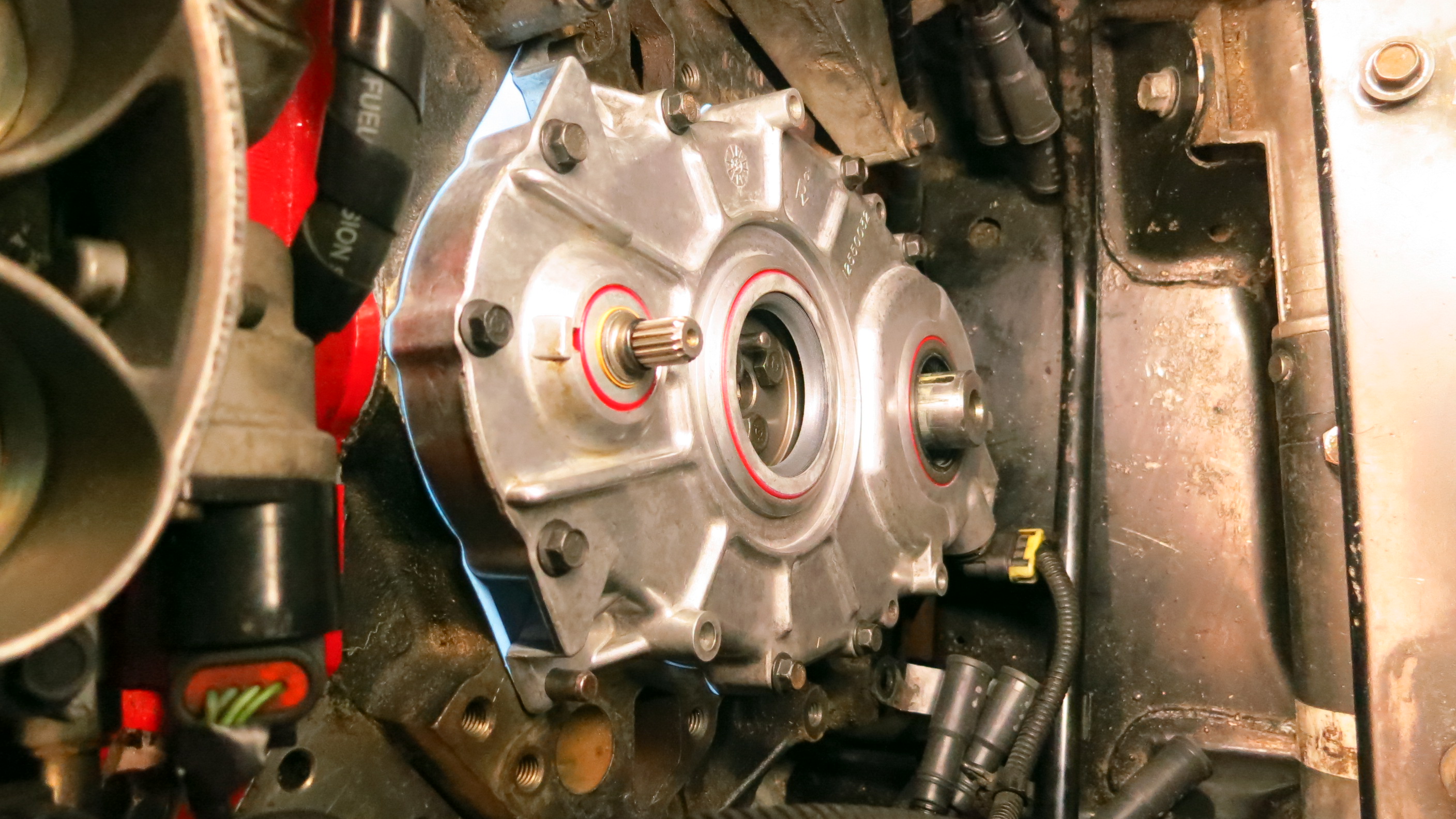

I now have a new bearing on the water pump driveshaft and the driveshaft installed into the block. All is looking good for moving forward now. Maverick came over yesterday and we struggled a bit, but got the timing chain and sprockets on and positioned correctly. The timing cover is on and I'm back to the point where, several months ago, I first looked at the timing cover and thought "I'm in this deep, I may as well pull the cover and see what's inside". :cry:
The next order of business is to get the oil pan back on. After that, the next milestone I'm working toward is to start the LT4 without water pump or coolant to verify that it still runs and the noise is fixed. By the way, I'm convinced now that the bearing was originally damaged by removing the driveshaft from the block. The outer race of the bearing is pressed into the block face. The only way to remove it is to pull it out by the shaft which means pulling it by the inner race which is attached to the shaft. I can't see how a bearing can withstand this without some damage. The practical result of this is that any time the shaft is removed, the bearing must be replaced. It was a hard lesson to learn.

Started up the engine this afternoon. It is still noisy. :( As I see it, I have only one option at this point and that's to bolt on the water pump and fill it with antifreeze . My hope is that the empty water jacket and missing water pump may be funneling normal engine noise out the front of the engine.
I installed the water pump and filled the system with antifreeze, but I didn't install the fans yet. At the startup, the noise was the same, very loud, but it wasn't long before it abated. It looked to me like the noise quieted as the oil circulated around to whatever is causing it. I would say the noise is 75% less than it was at startup, but still there. I suspect the timing chain is making the noise. Also, for some reason it threw two codes, P0100 (MAF sensor) and P0336 (crank sensor). I pulled each of the connectors and reseated them, but the codes continued. I have no idea what that is about.

The screeching noise as I mentioned before is still there. There are definitely steel particles in the oil pan. The new news as of this afternoon is that I'm backing off on my statement about aluminum particles being in there, too. With a very close examination, I can't definitely identify aluminum particles. Cutting open the oil filter showed slightly more particles than before, but still remarkably few. Apparently most of the larger, visible particles did not get sucked up into the oil pump. I ran a small magnet in between the folds of the filter and it picked up very small amounts of minute steel particles. It looks like so far, the engine is being protected by the oil filter.
I called Cloyes tech support again this afternoon and spoke to the head support tech. He was willing to discuss the problem, but in the end, he wanted me to get back to him with the details on what I find when I take the dive back in to inspect the timing chain for the third time. Since I was able to run the engine longer, perhaps there will be more visible witness marks inside the timing cover this time.
This last foray inside the timing cover did have one benefit. I found a definite problem with the water pump driveshaft bearing that may have been overlooked if this problem had not occurred. Stay tuned...
