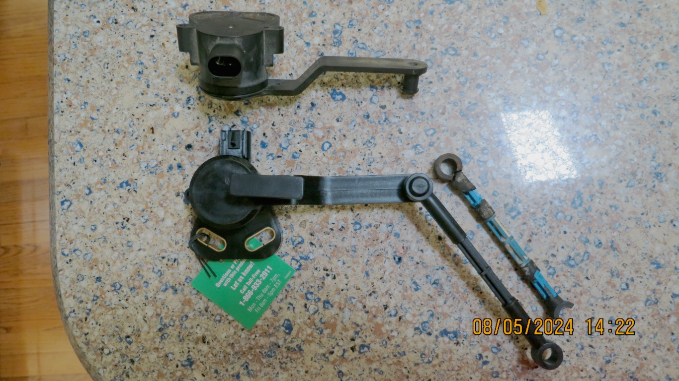

Re: 2008 Trailblazer SS
The sensor arrived, but it is not a match. There are two differences. The link is about 1/2" too long and the resistance measurement is about 3 ohms different from part to part. Furthermore, there is an obstacle to making one myself. The rubber ends of the link are designed to be stretched over the retaining knob on the end of each post to which they are attached.
So if I want to change to another way to attach the link to the posts, I introduce another complexity to the solution. Whatever I do has to easily rotate at each attaching point and not slide off (i.e. a heim joint). In addition, the RH side is probably deteriorated also, so I need to do some more ruminatin' on this problem. I'm out of ideas.
