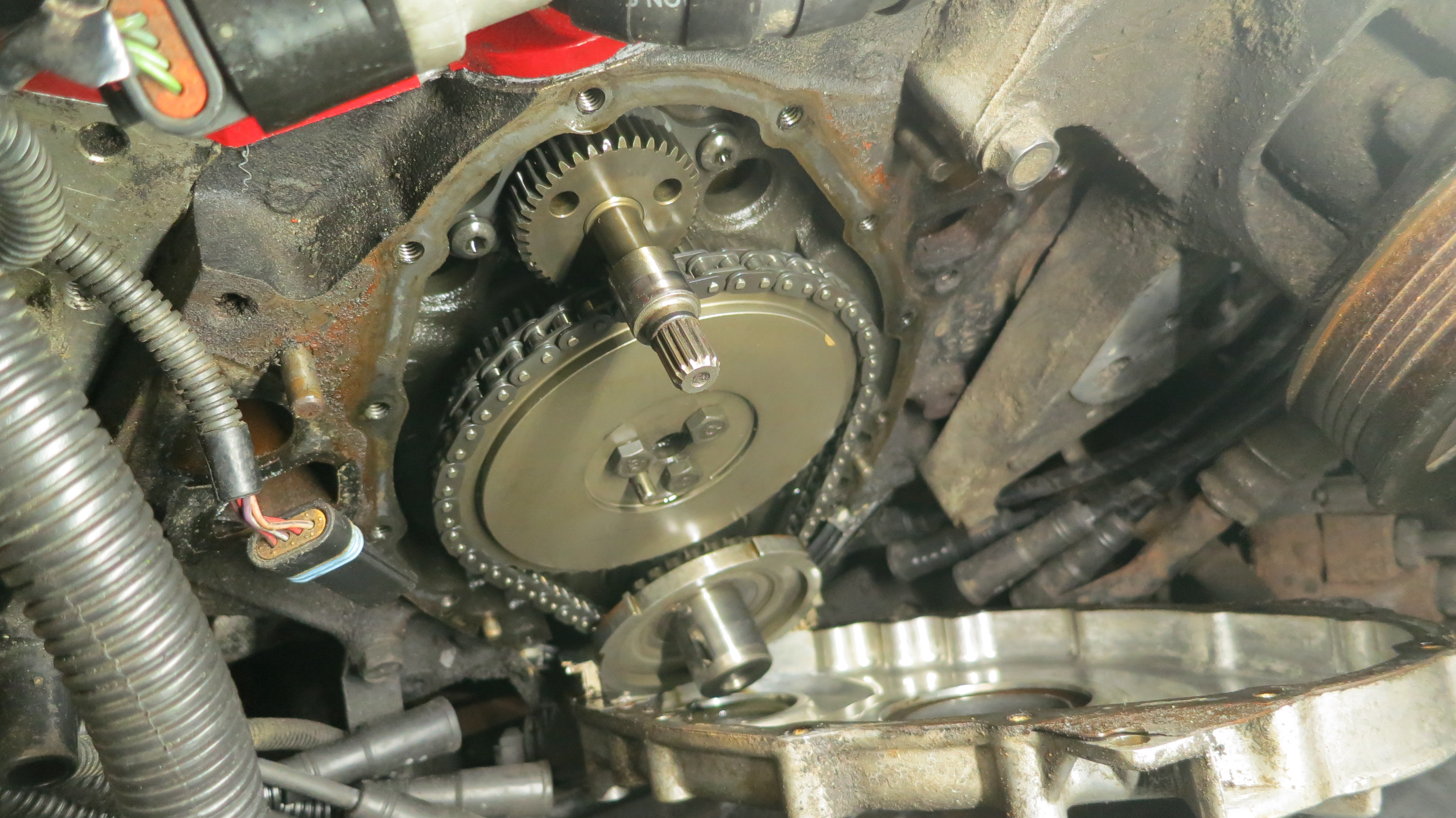

I'm back at it again. Right now my objective is to get the oil pan off to clean out all the metal debris from whatever is causing it. I've been picking at it for the last couple of days and it's about ready to come down. If I have time tomorrow, I will get the engine hoist out of storage and lift the engine to remove the pan. One good thing about working under there this time is that everything is clean and dry. With the oil pan off, I can pull the balancer hub and this will allow the timing cover to be removed. I can't wait to take a peek inside.

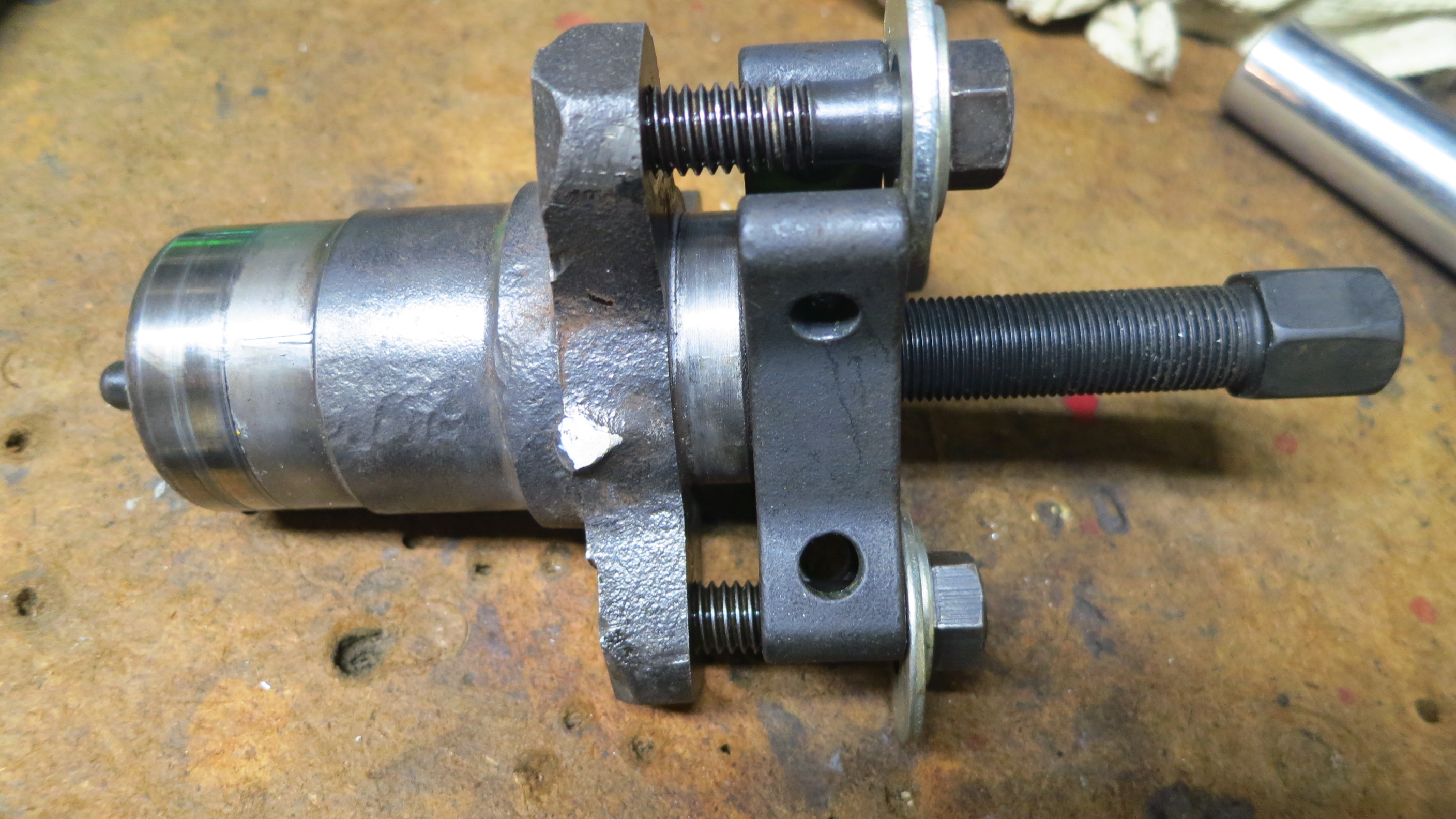

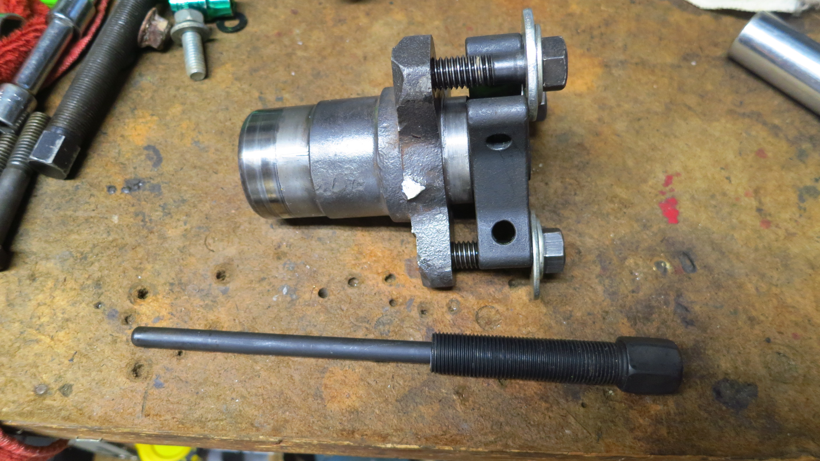

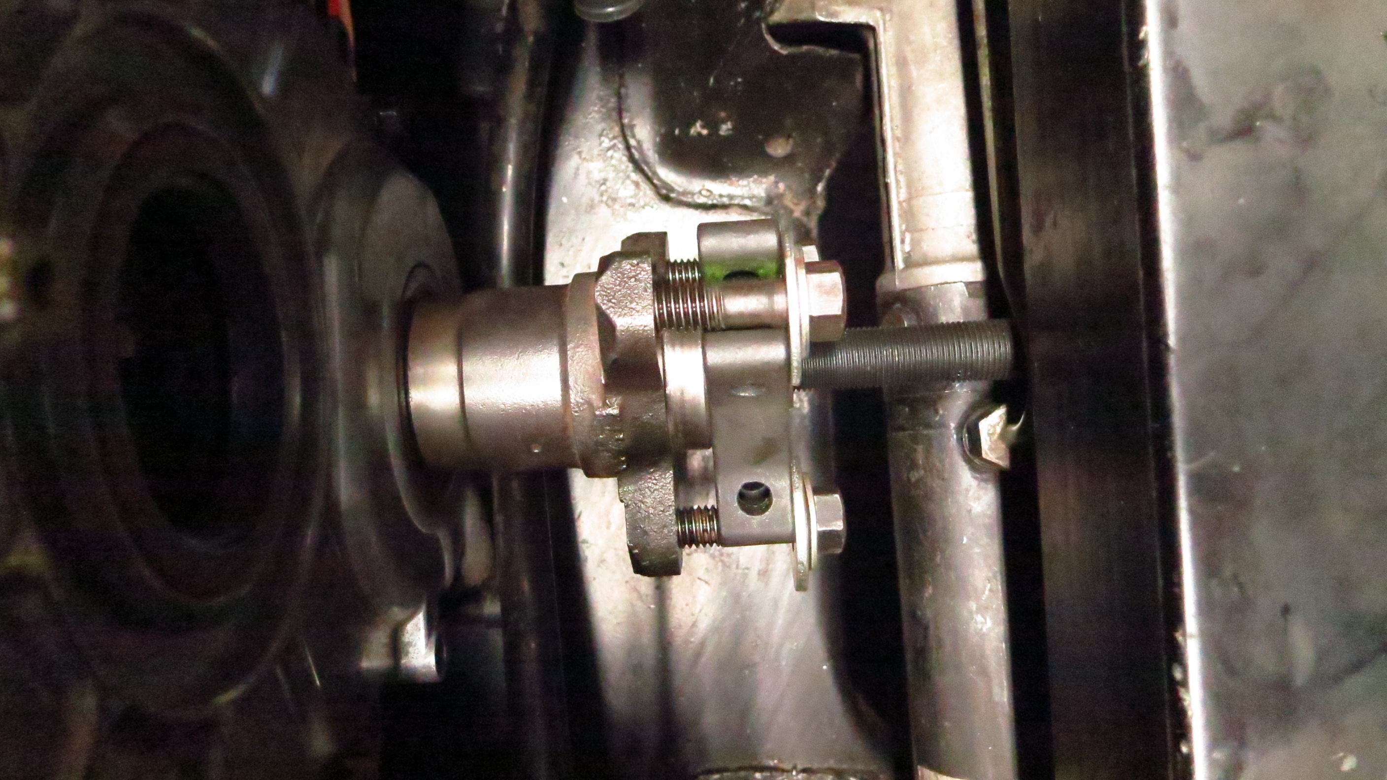

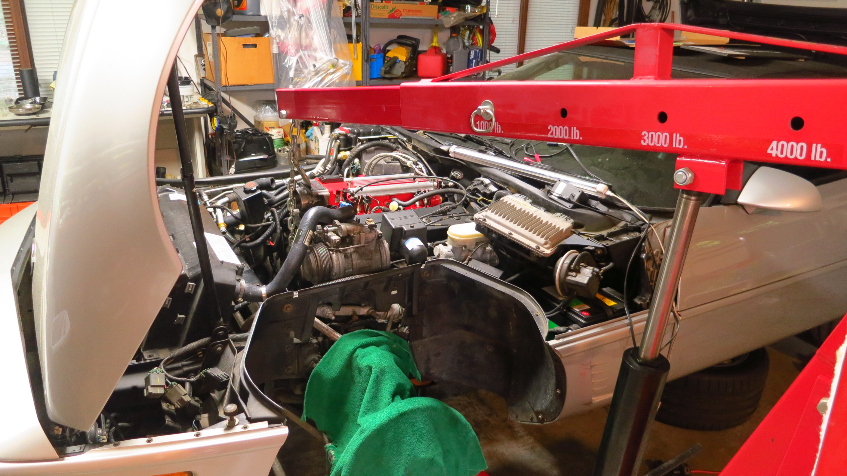

Moving ahead, I decided to remove the balancer hub this afternoon when I realized that I had broken the puller that I used the last time I did this. So I had to engineer a puller from what I had available. I tried a one idea and spent a couple of hours on it before I decided that it wouldn't work. I scratched my head a bit more and came up with this.I used a few parts from the other puller I had bought to get the balancer off. It has a good design and worked great. Next I got the engine hoist out of storage and set it up to lift the engine for the removal of the oil pan. Once that's done it's time to unbolt the timing cover to see what's going on under there.Maybe Monday.

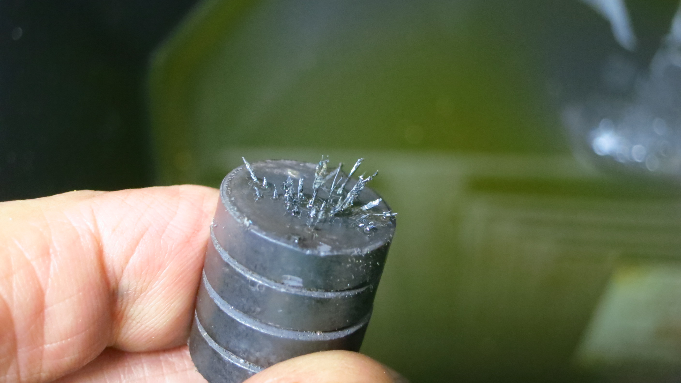

As promised, I was able to get the timing cover off this afternoon. I saw no evidence of rubbing or scraping or even steel shavings in the bottom of the cover. I guess you would call that the good news. When I removed the oil filter, these steel shavings were in the bottom of the catch container Remember that there was nothing like this in the filter when I cut it apart. Well, they had to come from somewhere. I just have to find the source.

It has to be from something you changed. Is there any signs of rubbing/grinding from the optispark? I know it spun free when it was out, but if it's a hair too long or big around somewhere, it may be rubbing when it's in the motor. Just guessing at stuff...
Thanks for offering your thoughts, BP. You are right. Logic would point to something I touched.
The Opti-Spark is bolted to the outside of the timing cover and is pinned to and driven by the cam sprocket through a hole in the timing cover. I didn't see any evidence of steel chip or shavings on the Opti-Spark shaft when I removed it. I would also expect to see these shavings on the very bottom lip of the timing cover if they were coming from anything inside the timing cover. There was just a very small amount of black, very fine residue on the bottom lip of the timing cover. There is no evidence of metal chips on or around the chain and sprockets or stuck to the block behind them.
Based on what I'm seeing, I'm not inclined to remove the chain and sprockets, but I might have to do it just to be thorough in this investigation. Maybe my second set of eyes (Maverick) can make it over here to have a look before I do anything else. He might notice something I missed.

WXO,
Can you see the back of the timing chain? How do the gears look?
GM, I can't see the back of the sprockets unless I remove them and it seems inevitable that I will be doing that.
May have found the problem
Yesterday afternoon, a few minutes before Maverick was due to arrive, I was staring down at the timing set before me and just by chance I grabbed the oil pump drive gear shaft and wiggled it. When I did, I heard a scritching sound very similar to that which we heard when the engine was running and in the same area of the sound. Since the bearing is pressed into the block, I was surprised to feel some movement of the shaft. Remember that this was the shaft that went to the machine shop to have the bearing and the gear pressed off and the gear replaced with the one that matches the new timing set. When Maverick arrived, we pulled the water pump drive shaft from the block and checked out the bearing. Although it had some wiggle to it, It felt smooth and quiet.
