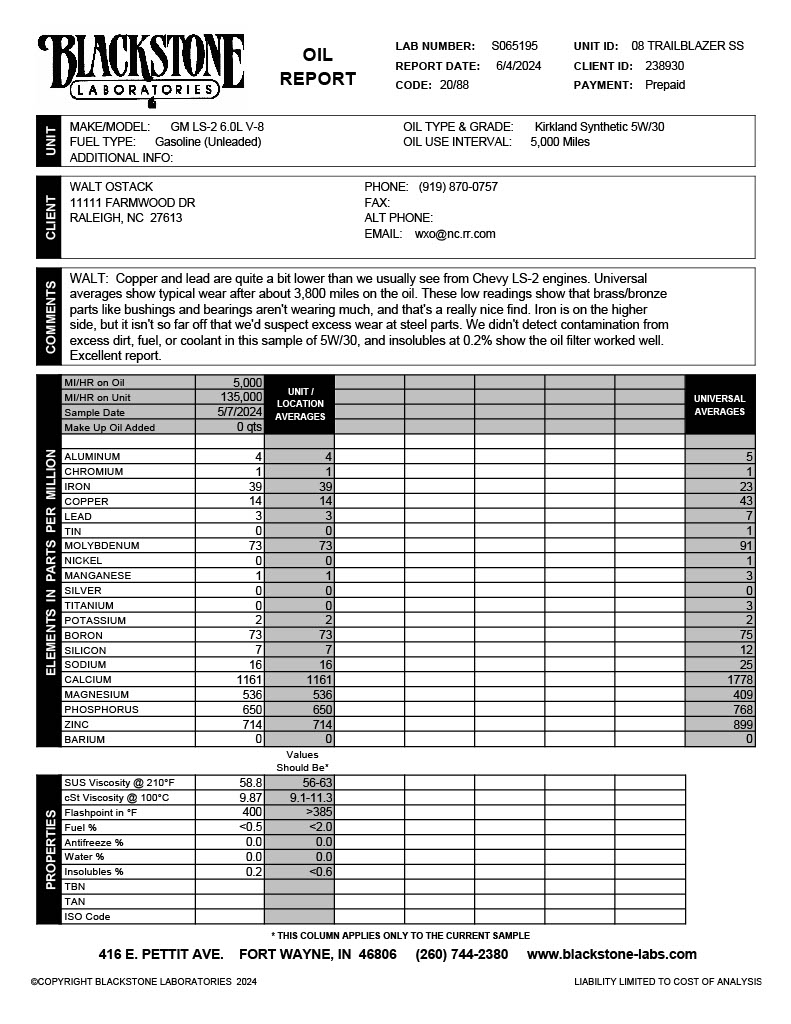

The last time I changed the oil (135k miles) I sent a sample to Blackstone Labs for analysis. Got a good report back:

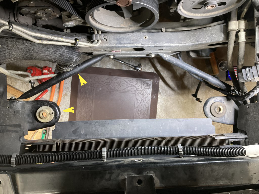

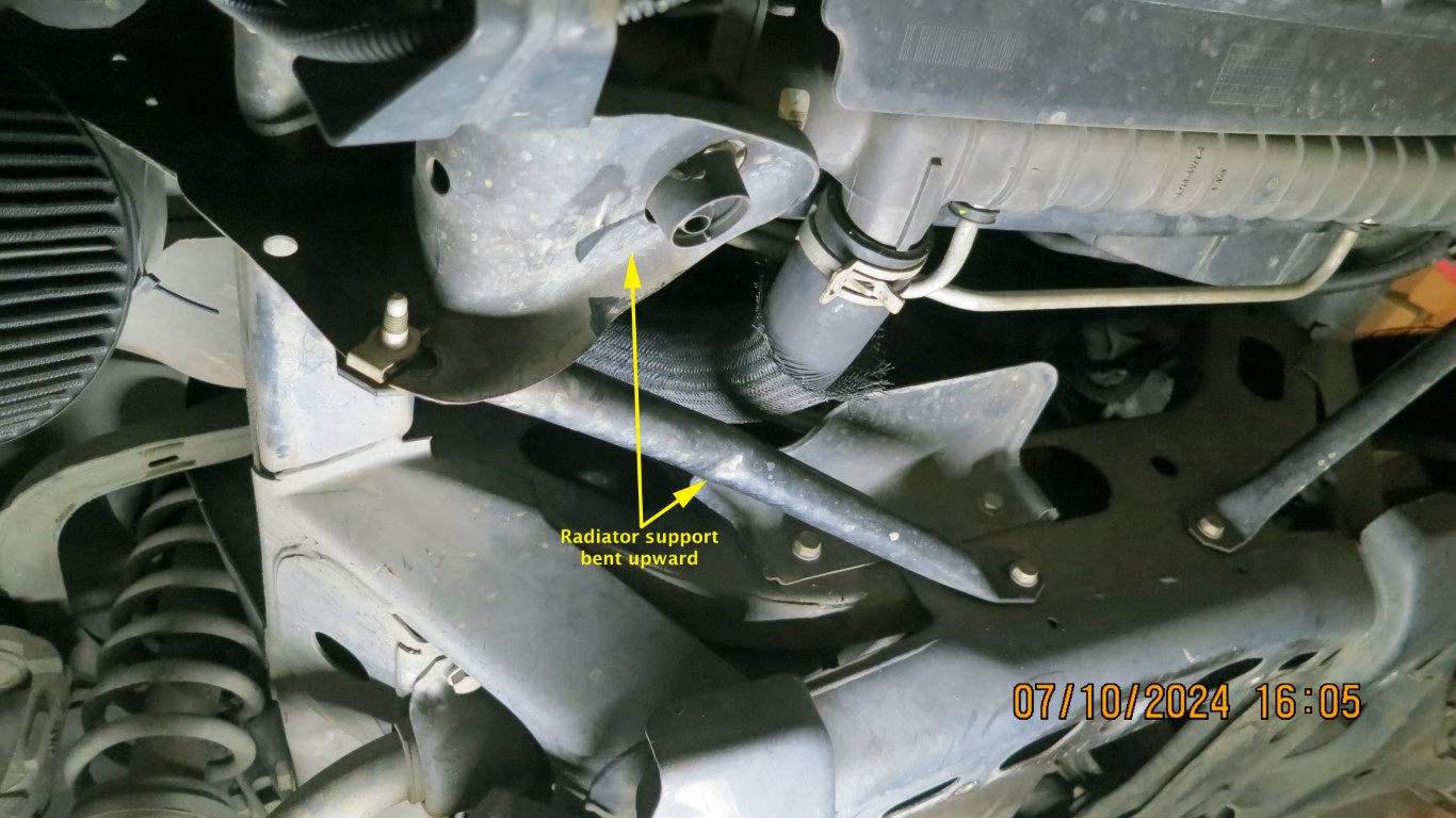

Time to attempt a repair of the RH radiator support bracket. This happened when the truck slipped off a poorly placed floor jack several moons ago.
After studying the situation, I decided that getting a porta power kit might be the best option for urging the bent bracket back into position. So today my porta power kit arrived. Seventy eight bucks for a 4 ton unit from Amazon warehouse. Full price is $99. After a short initial test, it looks like it works. Now I decided to head over to YouTube University to see what I can learn about using a porta power and it's various attachments. This guy does a great job in showing the use of this thing plus he adds some tips and tricks to using the attachments.https://www.youtube.com/watch?v=vE7VK7mFuSg So tomorrow, my faithful buddy Maverick is coming over and together we will try to make some headway here. Stay tuned...

The first problem I see is finding something to push against. I can't see anything above this bracket to use.
Re: 2008 Trailblazer SS
If that tube will unbolt (looks like it does) you can straighten that off the vehicle.
The main radiator support - from the outside of the car I would insert a pry bar into the hole then push up to bend the bracket down.
If you need the porta power you may be able to put a chain around the frame rails and push down against that, though there may be a lot of disassembly to get to that point. If the core support on either side of the radiator is metal you may be able to fabricate a metal bracket or something to attach to each side and push against that.

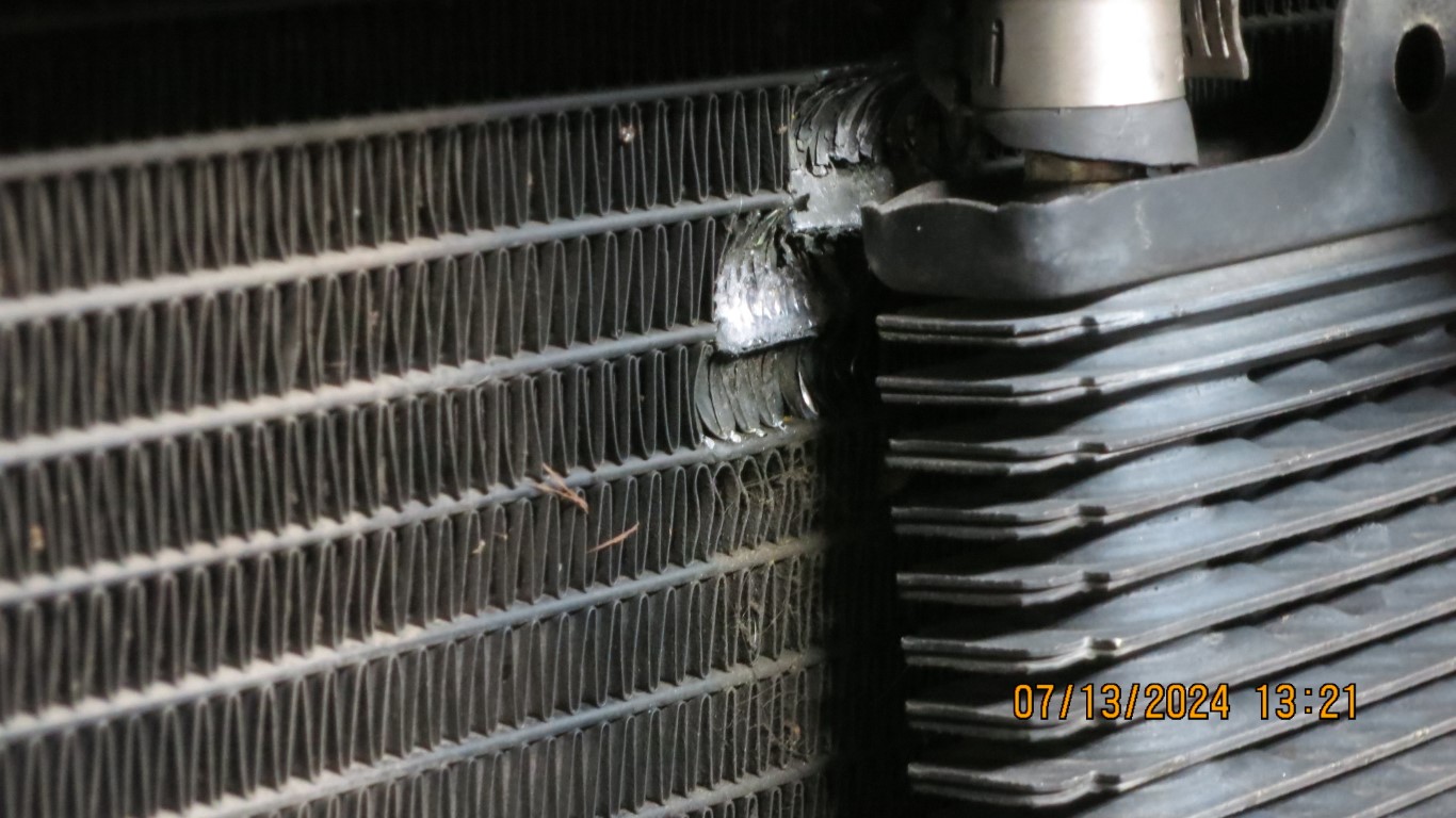

This seemed a difficult problem to start with, but after using a 5+ foot, 1 1/4" dia. steel digging bar to move the bracket somewhere near where it should be, I was forced to unbolt the radiator from it's mounting points. From there I was able to see more damage. The radiator support bracket being moved out of place also moved the radiator and condenser into contact with the trans cooler causing damage to the condenser. The condenser appears to be currently holding pressure, though. To do this job right, all these have to come out, repaired and put back together correctly. As it turns out, my decision to work on this, was a good one, because future headaches were just lurking ahead.
It also turns out that the porta power was not useful at all in this particular situation. Rather than sending it back to Amazon, I might keep it. It seems handy to have on hand, although it is another big item that needs to be stored somewhere in my crowded garage. I'll mull over that decision until the return date is nearly expired. I might change my mind.

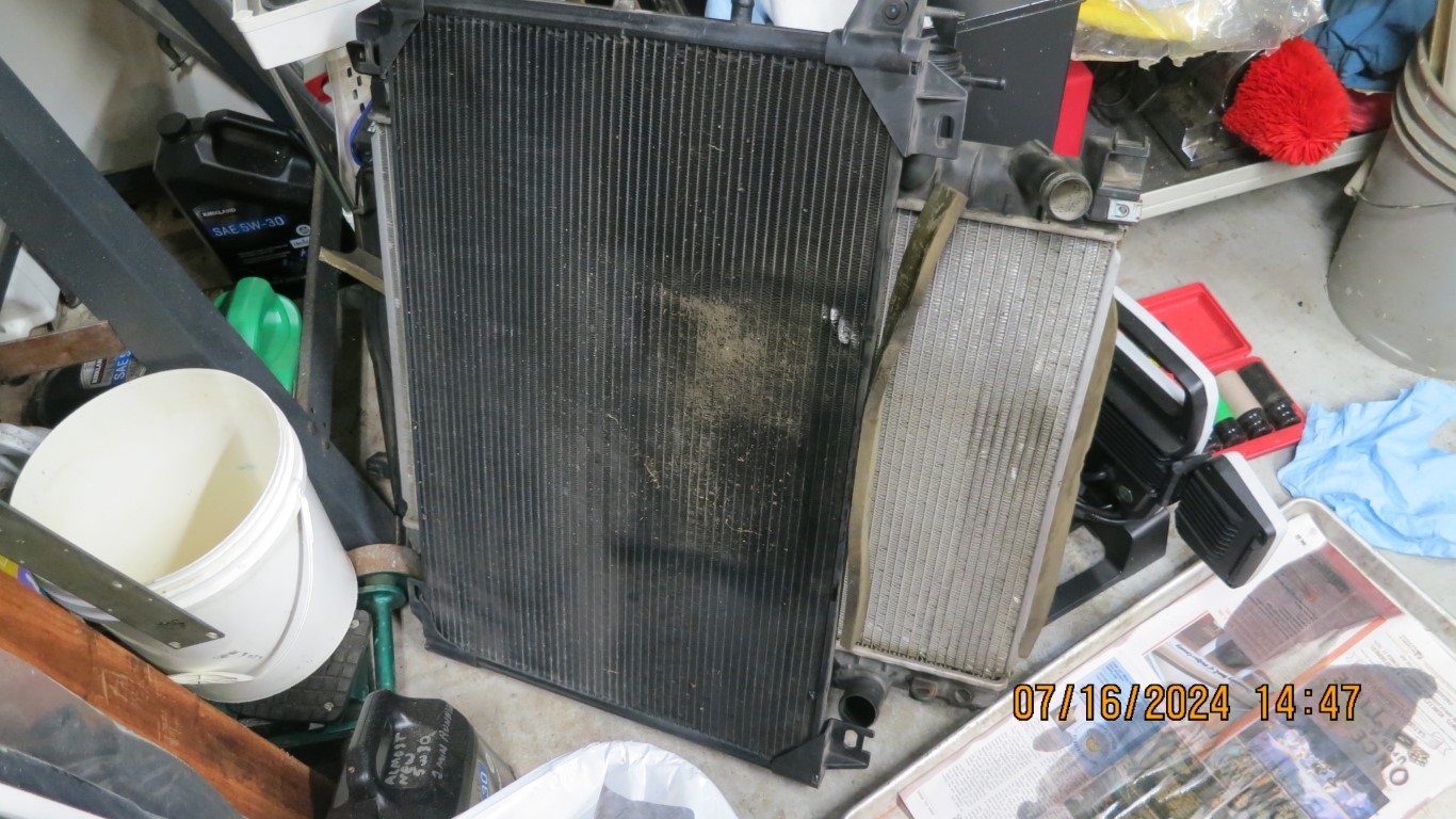

Today I finished the removal of the radiator and the condenser, and after 16 years and 135K miles, I decided to treat this trusty ride to all new parts.They are expected in a couple of days from NAPA. I've been working on the bent radiator support bracket and I've got it near where is should be. I will fine tune the location when I get the new rad. Before I removed the condenser today, I gave Mostmint a call to discuss his R134a refrigerant recovery technique. I was able to reclaim about 30psi worth into my portable air tank. Before I start the assembly process, I have a piece of cracked plastic to repair and quite a bit of cleanup work since I have access.

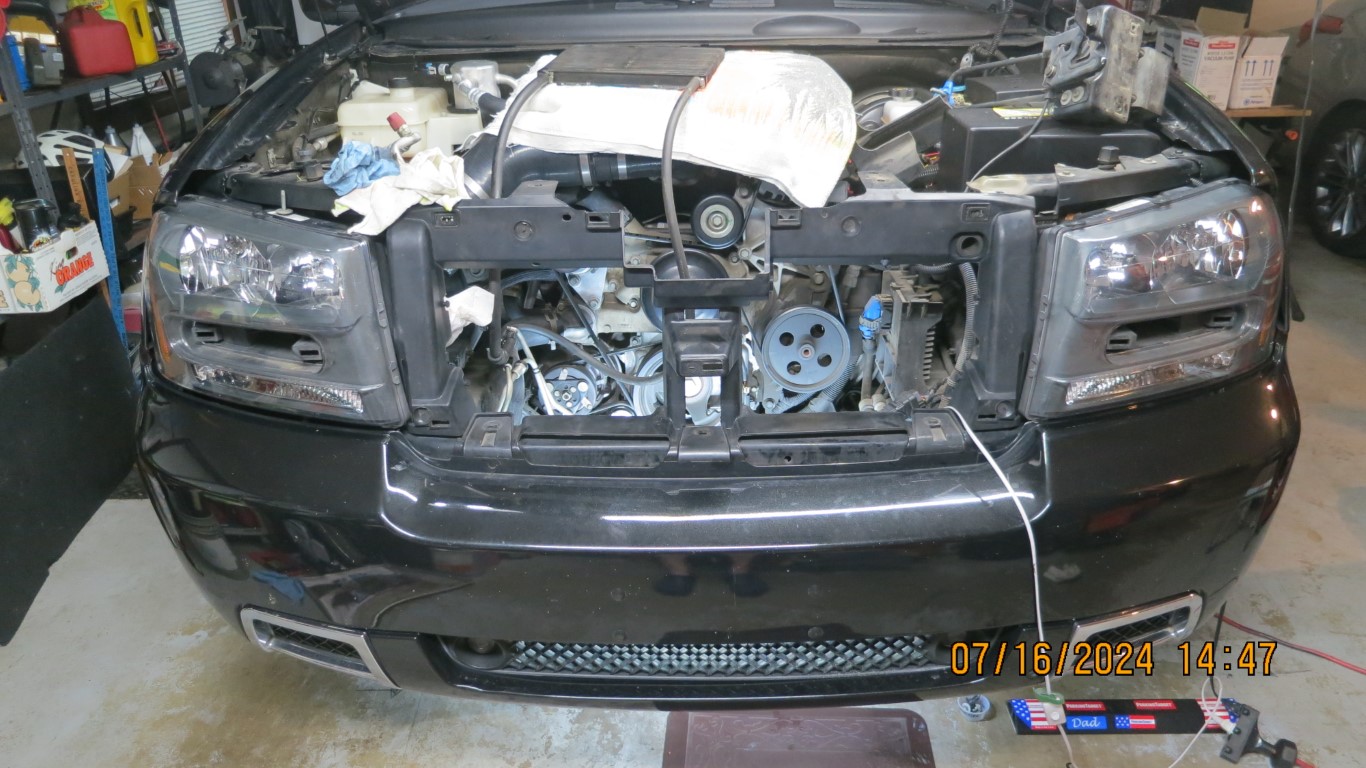

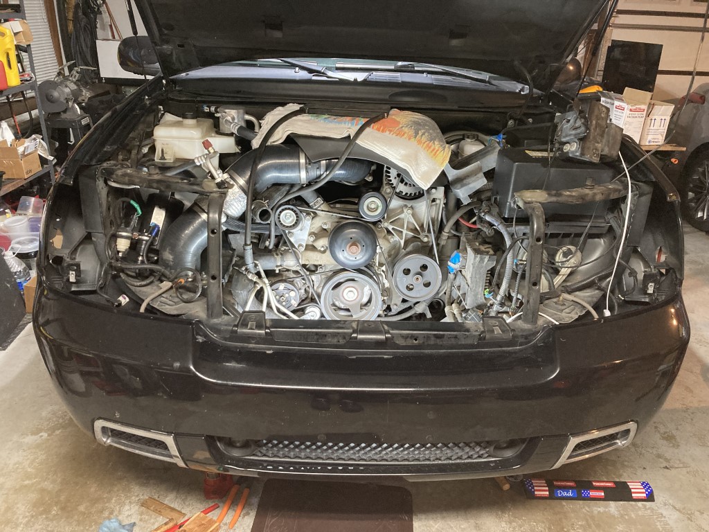

I decided to dig deeper today to make the work easier, so I removed the headlights and the big plastic frame that extends all the way across the truck. I'm running out of places to keep parts. I've resorted to the TBSS back seat. Now I have full access.Then I worked to get the RH radiator support bracket closer to where it needs to be (arrow). It's not quite there, but tomorrow's another day.I took the bent support bracket to NAPA machine shop and they straightened it for a measly $10. Looks good now (arrow).
