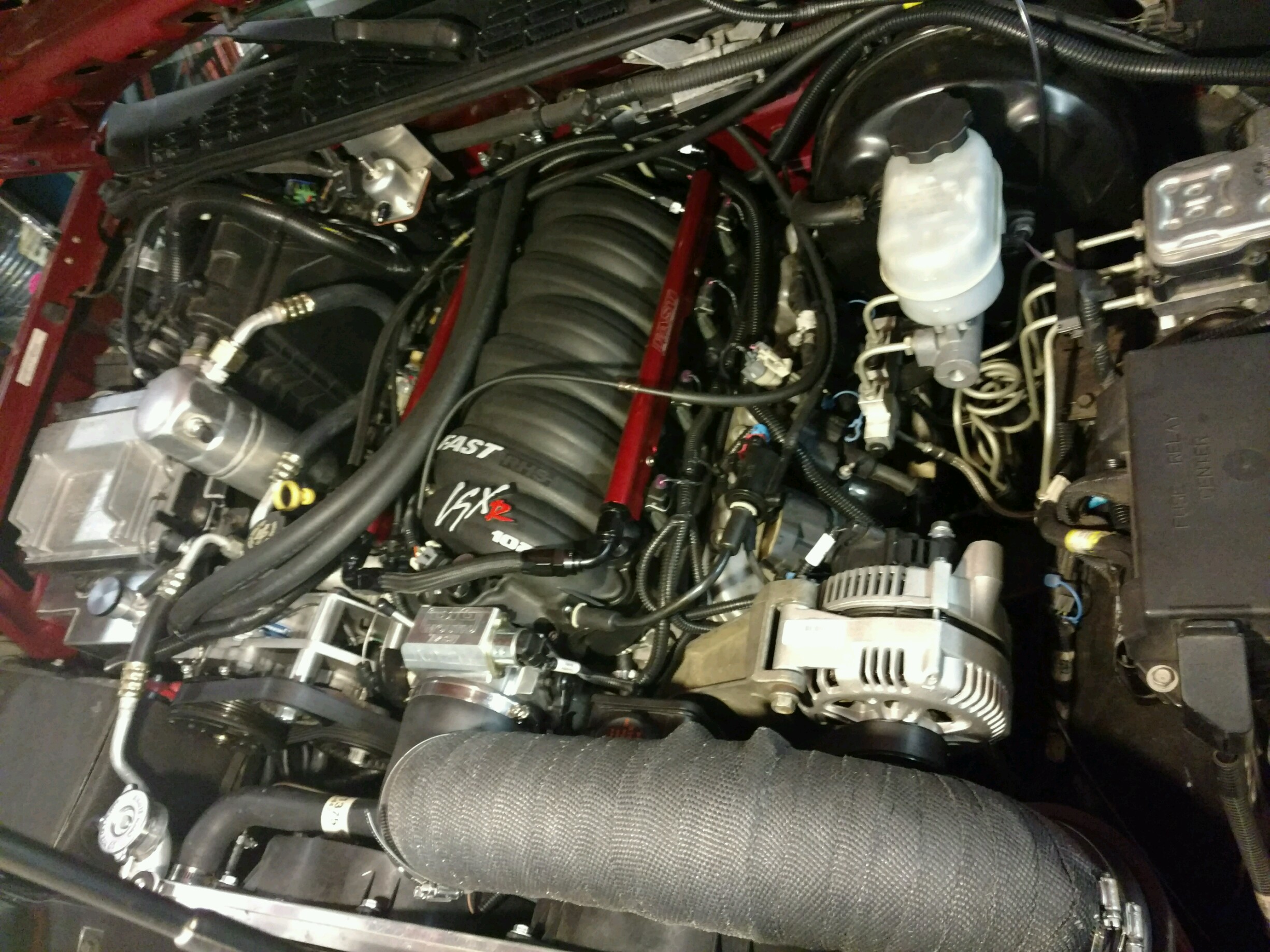

I realized that I never posted a final picture of the motor install, so here it is.
Funny, as I was taking this picture, I couldn't believe I actually got this project together in something just over a year, and "complete" within a year and a half. This time last year we were just fitting the engine. Hard to believe that it's done, and that I've already driven it over 1000miles. I can't wait until this Spring to just drive it, race it, and use it. With this coming year most likely leading to my business going full time, I won't have much time to work on projects like this so getting it done came at a good time.

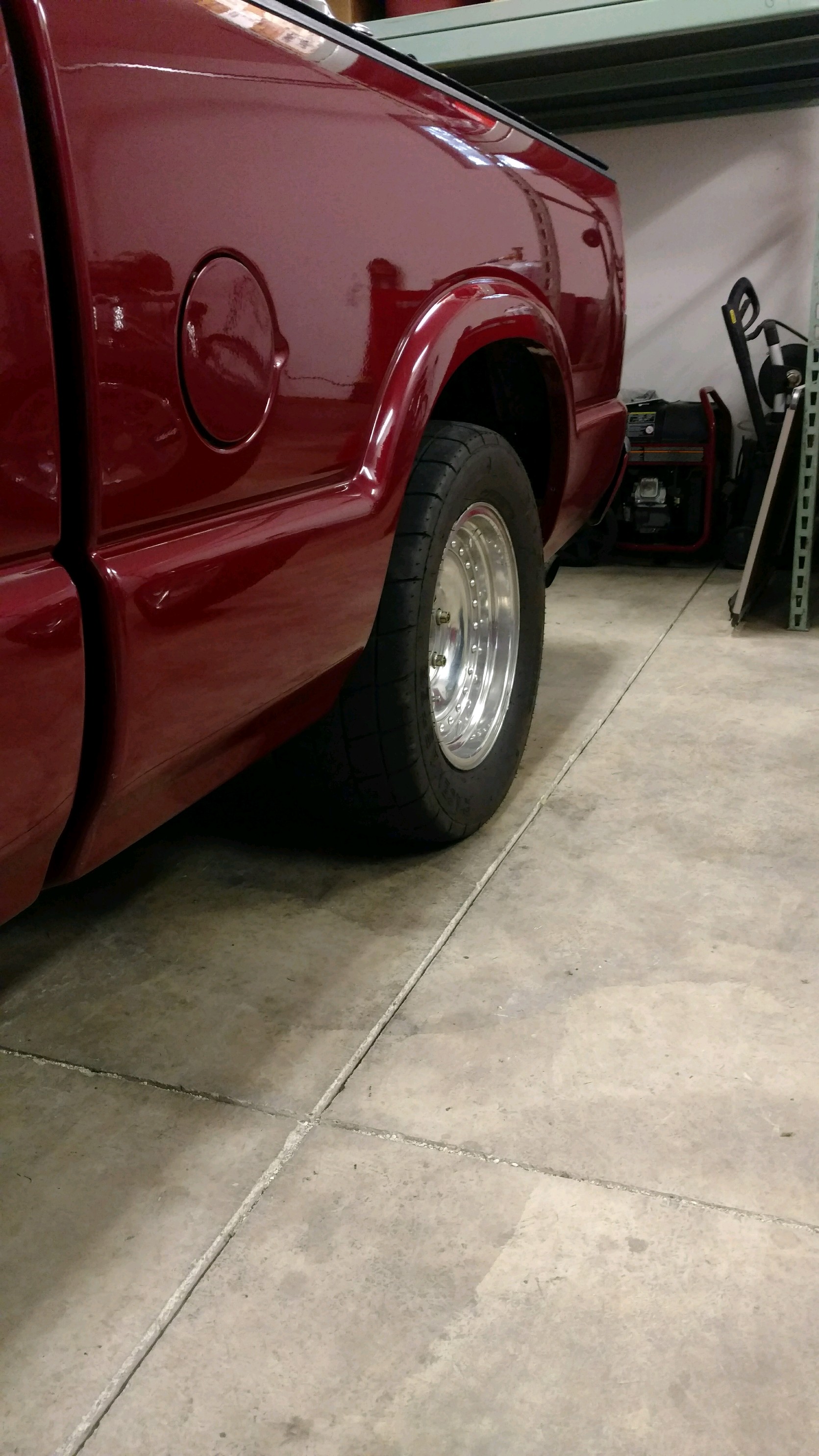

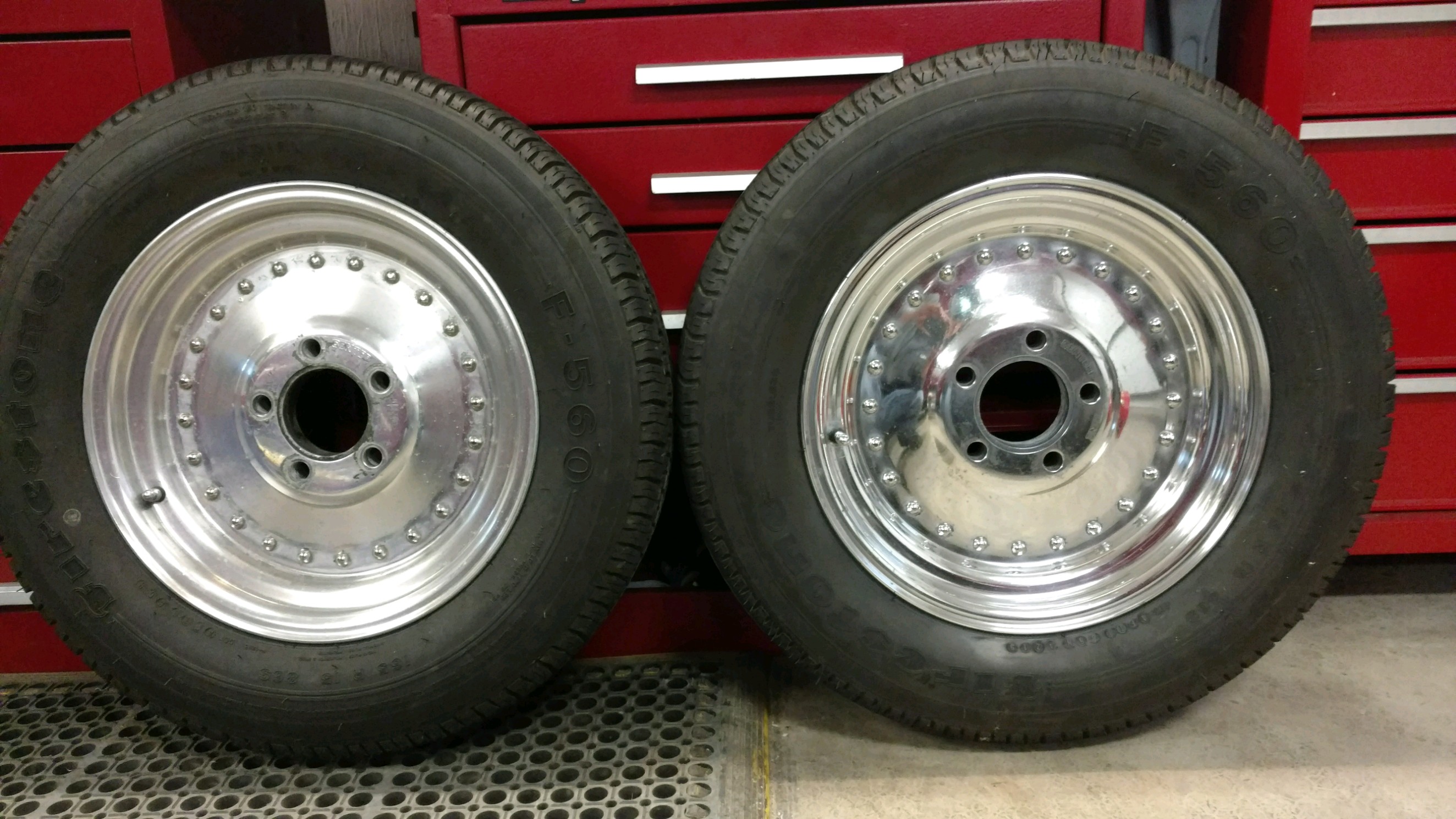

Not sure how I haven't posted since January on this. Anyway, I've been driving the heck out of it getting ready to race. Hopefully the weather will cooperate on Wednesday. In the meantime, in my quest to go faster, I bought the wheels below yesterday. They're old wheels, but as you can see, one cleaned up pretty well. They're 10 footers, but all the tires were basically brand new (M&H RACEMASTER drag radials) and less than 2 years old. They do fit perfectly and should make the truck noticeably faster.
After some discussion with Smoker yesterday, I got the scale out and weighed them. The Centerlines rears are 41lbs and the stock wheels are 45lbs. The centerline fronts are 28lbs. This saves me about 42lbs of rolling weight and front tire friction. I'm thinking that has to be worth a tenth, but won't know right away. I'm going to run it first with the stock wheels to get an idea of how much the rearend and cal-tracs helped. Plus I need to buy lugs for the rear wheels and get center caps for them too.

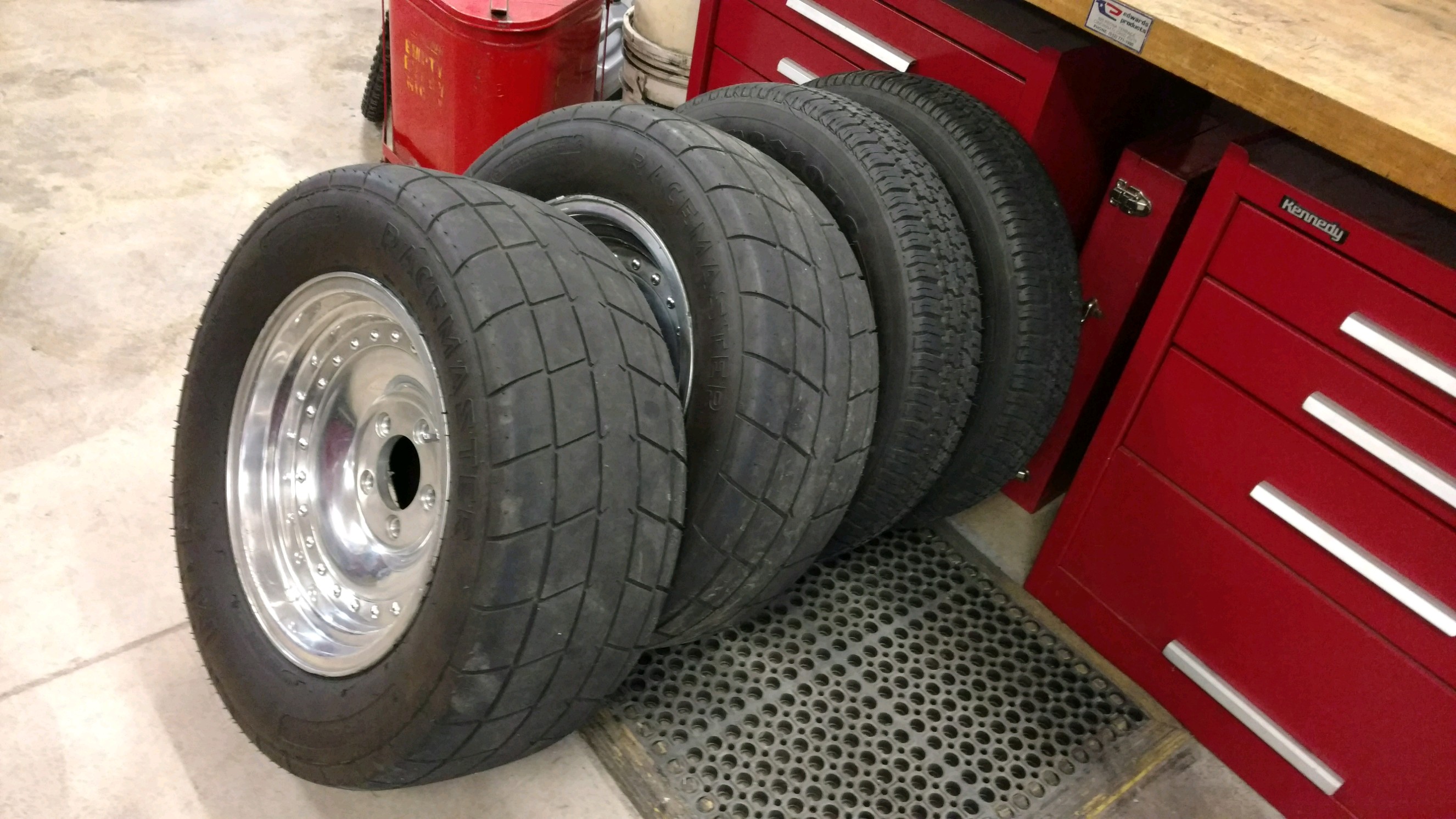

More to come on this, but in the meantime, I'm going racing tomorrow night with the "race wheel" package. We'll see if this helps, hurts, or does nothing. I don't necessarily like the look, but am looking for a low ET at this point.

Last nights trip to TRP got me a few more hundredths and a little more MPH. Traction was better for me with the new tires, but the air and temp weren't perfect by any means. I was able to coax a 12.16 @ 112.6 with a best 60' for the night of 1.777. Except for getting better air, I don't think my 60' could get better. I'm thinking in the fall that I should have no problem getting solidly into the 11's without modification.

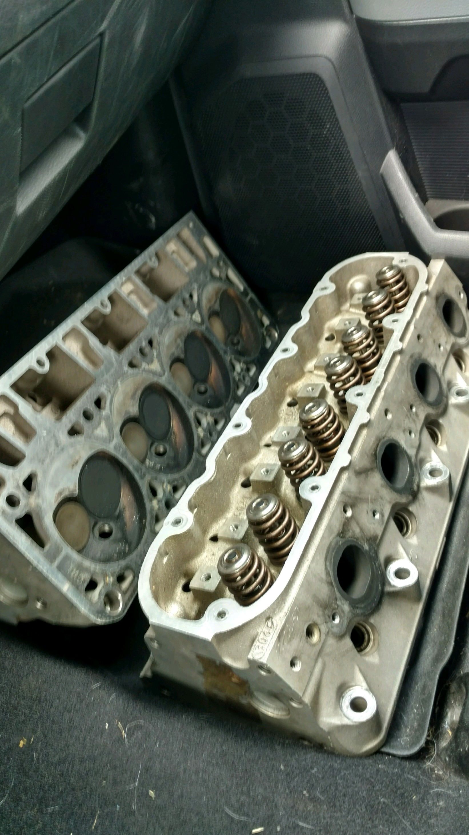

So I bought another set of cylinder heads. They are 806's which is exactly what's on my truck now so I can maintain my "perimeter" valve cover mounting which is a bastard to '97-98 LS1 motors. By doing this, I can keep my existing coil set up. I plan to get these hopped up at some point and hopefully have them on by Spring of next year. I've made a lot of passes in this truck so far and am happy to be in the low-mid 12's all the time for now, but would love to run 12 flat always. This will be a step in the right direction, and probably the most cost effective for now.

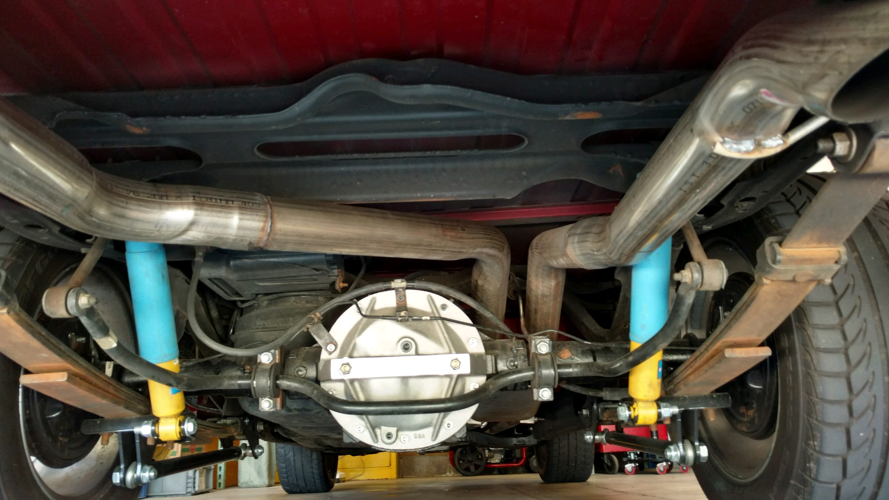

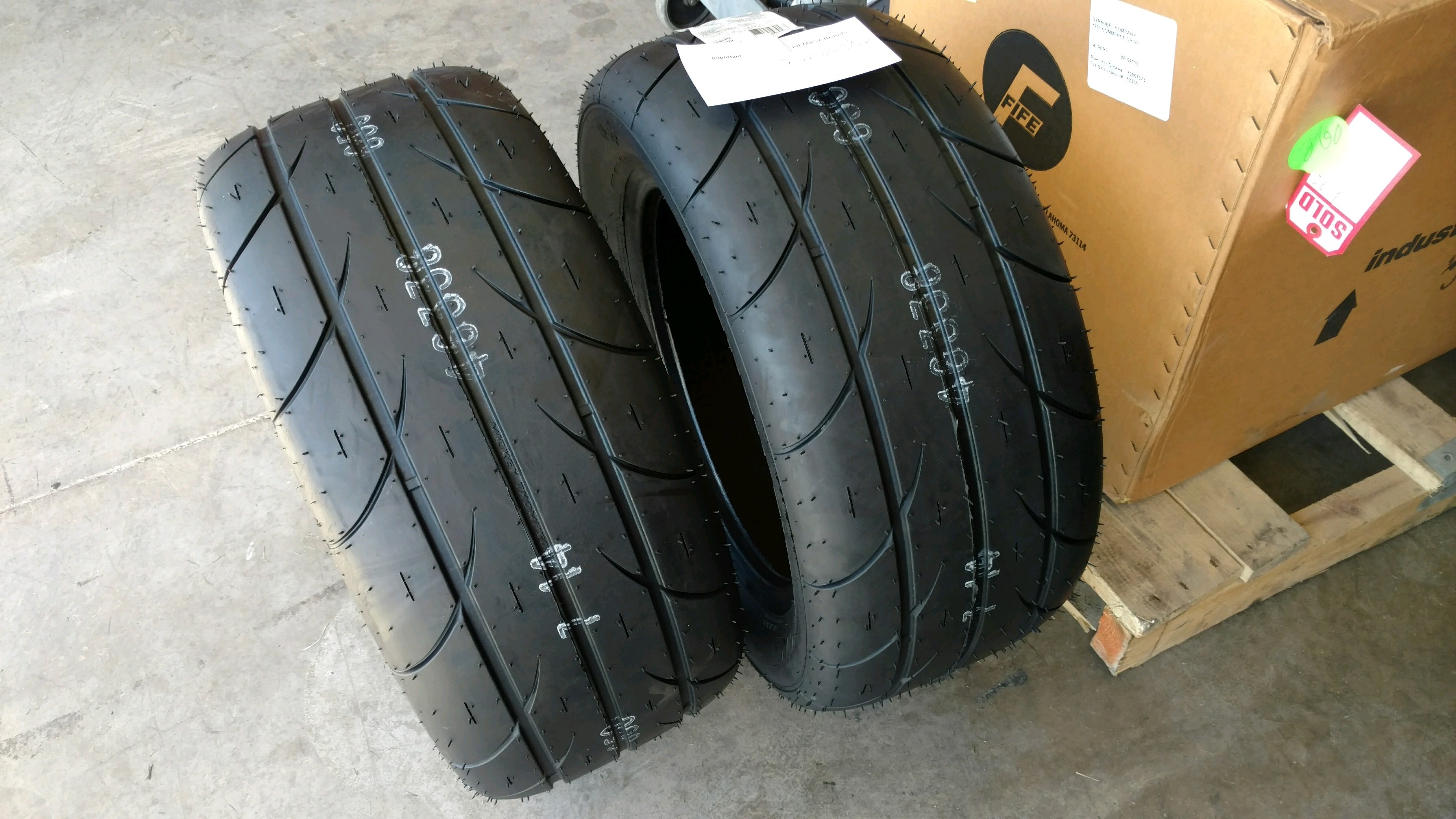

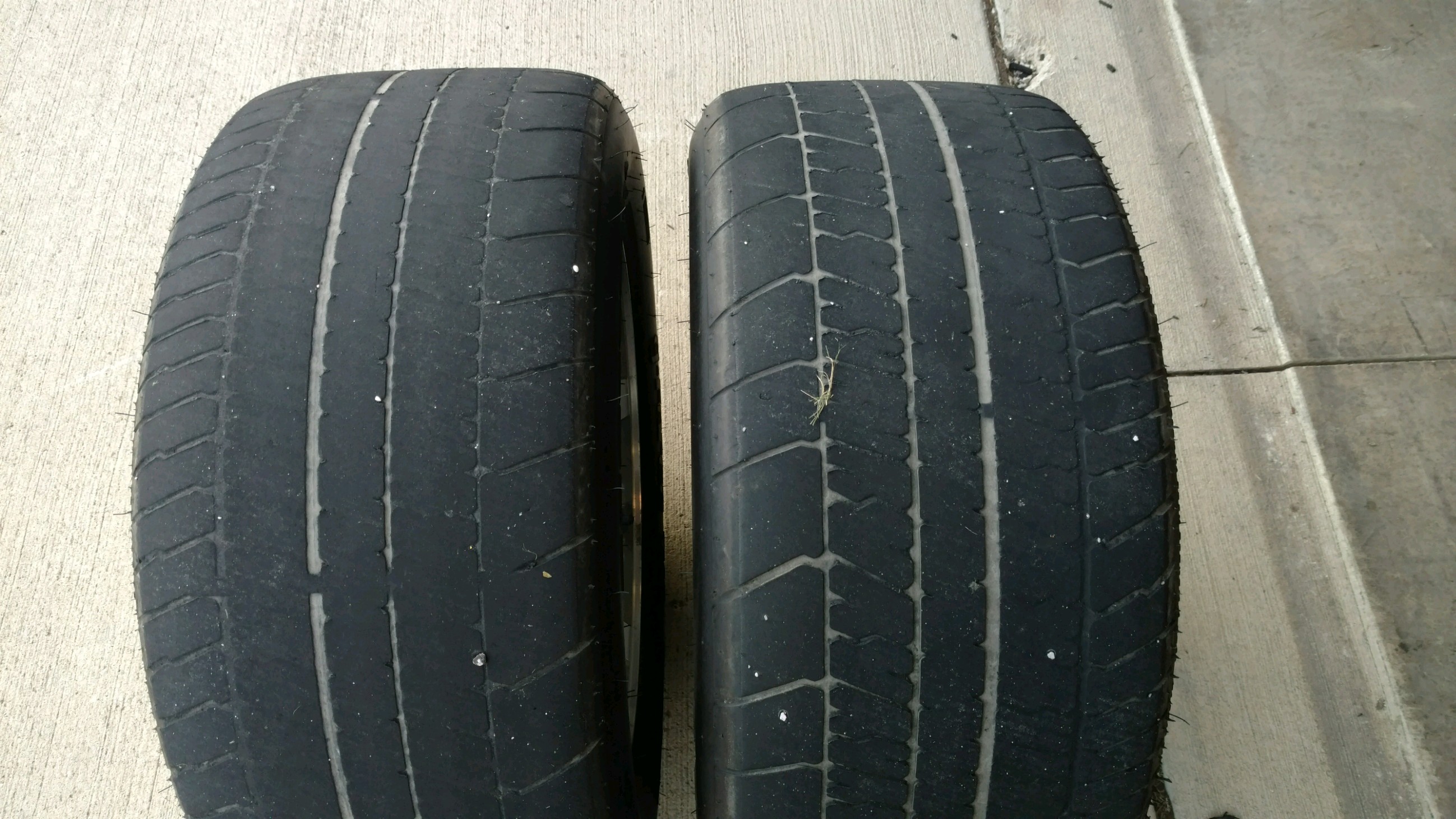

I'm a little behind, but nothing too major has happened since my last post. I've put lots of miles on it and you've seen some of the racing fun. I just bought new drag radials for my stock wheels (255-50-16) as my old ones are about one race away from completion. The only company I found that makes that size anymore is M&H. BFG used to, but they got out of the drag radial business all together.

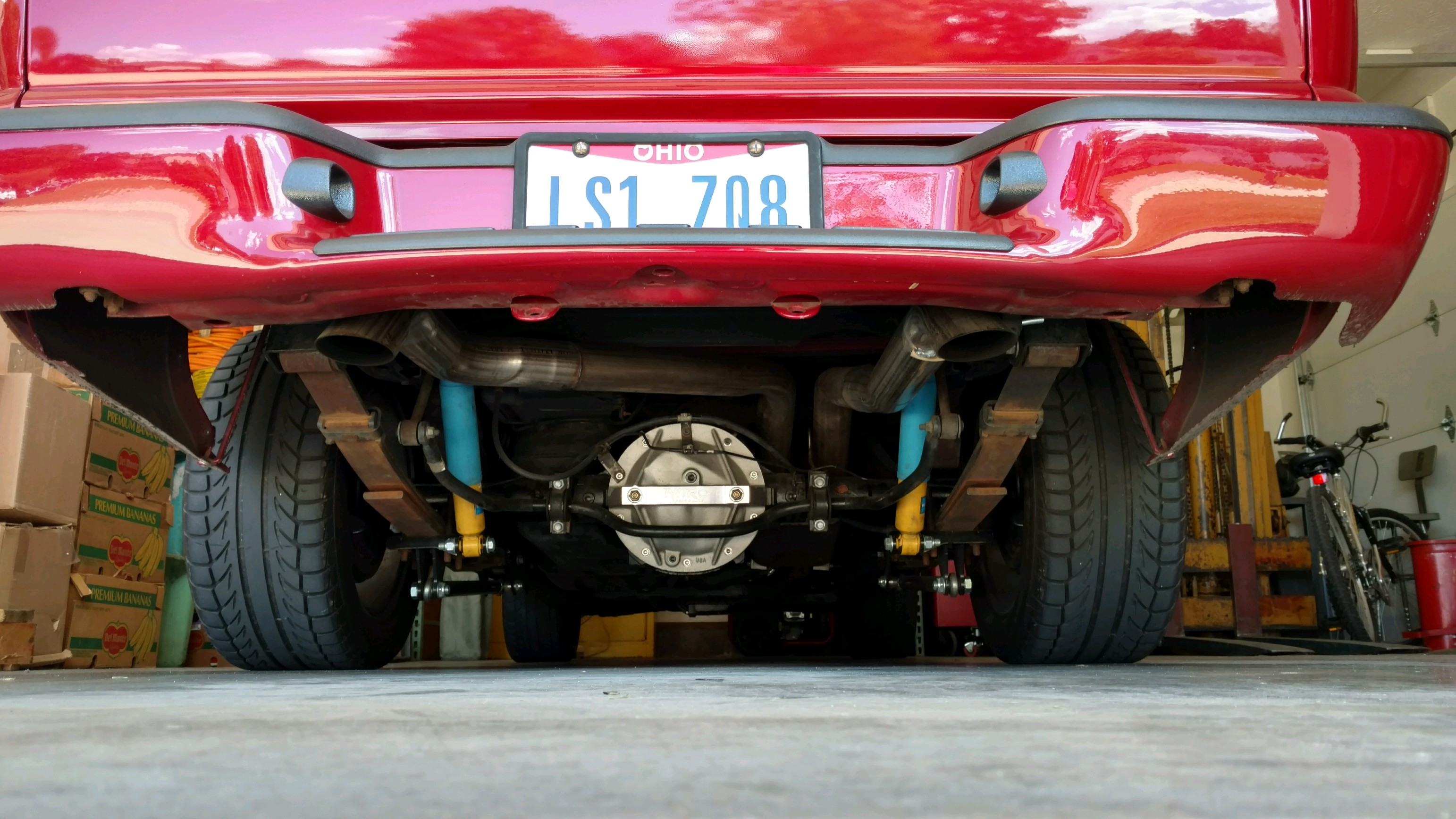

A couple weeks ago I also had Paul Carson move the tailpipes from behind the wheel to straight out the back, stealth style, not West Virginia style. I did this because it adds to the sleeper image, but more important is that it helps keep some of the exhaust from blowing back into the cab at stops and also quiets it down in the cabin under cruising. Behind the truck, you can't see them at all.
