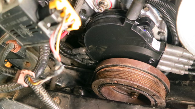

Our trip out West was phenomenal. Now that I have all the unpacking done, I started putzing in the garage. Before you know it, I had the new GM Opti-Spark installed and all hooked up. Then the balancer went on without much trouble. The front of the LT4 is starting to fill in.I have a few things to check before I try to start it to see if the Opti works. Probably tomorrow.
When I got up this morning, I couldn't wait. I had to know. Now I do. The new Opti-Spark works!!! She runs! Whew! I was a bit apprehensive after all I had apart. I am a bit mystified about the amount of mechanical noise coming from the engine. It isn't scary loud, just different. I have good oil pressure. I hope it's the fact that there is no coolant in the engine. I think I'll start it again later and listen more closely to see if I can learn more. Have any of you run an engine empty of coolant?

Maverick just stopped by and we listened to the engine running again. The noise is not normal. It is coming from the timing chain cover/Opti-Spark area. Rats!!
- Posts: 3631
You sure it's not that big chain making more noise than the stock little chain?
I agree, pretty loud and not normal. Sounds like metal scraping on metal.
I'm not sure of anything right now, but a couple of weeks ago, we turned the engine over using the starter with one spark plug out. It spun pretty fast. I remember thinking that I didn't hear any noise coming from the timing chain area. Packing that big chain and sprockets in that space resulted in some close tolerances. We called the Cloyes tech and he said .020" was all we needed. We checked and had at least that much space. I guess I'll go back to digging until I find the cause.Basement Paul wrote: Sat Jun 04, 2022 12:46 pm You sure it's not that big chain making more noise than the stock little chain?
I went out to the garage today to regroup, study the situation and come up with well considered plan to figure out what is causing this apparent grinding/metal-to-metal rubbing noise. Looking around with a light, I saw that I had forgotten to attach the connector to the crank position sensor on the bottom of the timing cover. I'm surprised that it started and ran. There must be a fail safe system to keep it running. I'm faced with a dilemma. I hesitate to start it again to try to zero in on the location of the noise if it is metal on metal rubbing. I don't want additional metal shavings in the oil. The Opti hides the timing cover, so that it is impossible to run the engine and listen and pinpoint noises emanating from there. I'm thinking of going back and removing the new Opti-Spark. It can be done without a large amount of work. It's remotely possible that the new/rebuilt Opti might have come with a bad bearing. But if I remove the Opti, I can't run the engine to recreate the problem until I reinstall it. I thought of chucking the Opti drive shaft in a drill and spinning it. That should give me a reasonable test of the bearing. Anyway, that's the extent of my thoughts for now.
