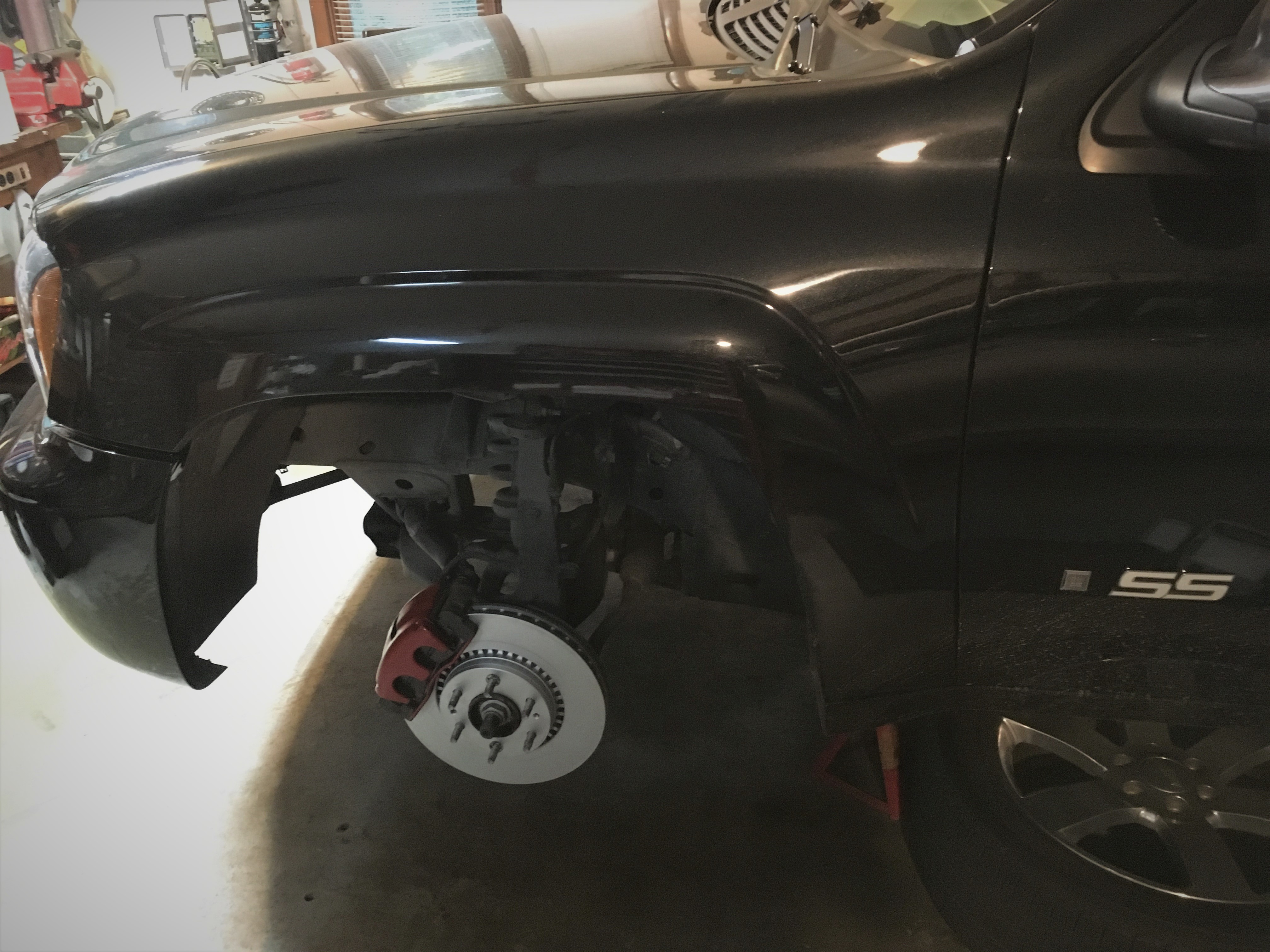

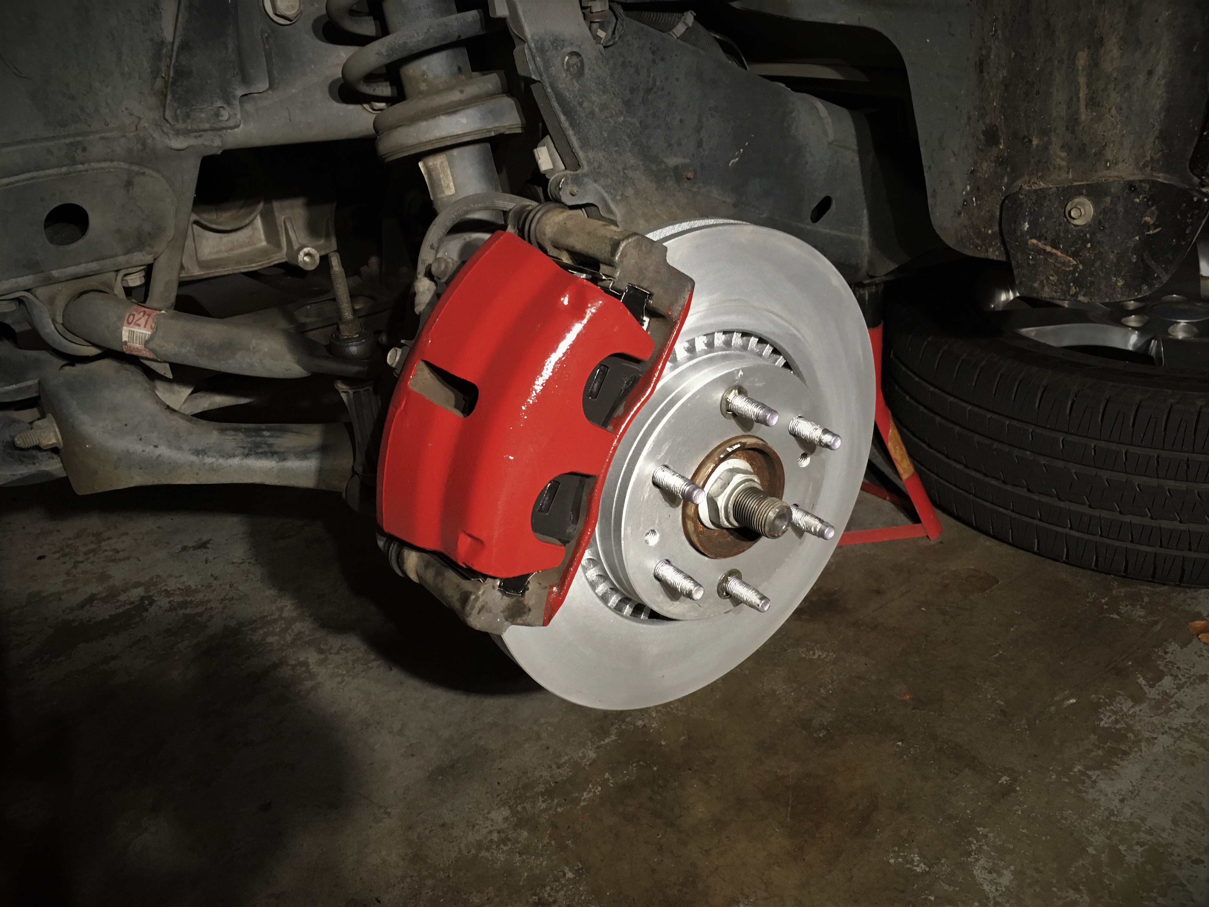

I had started to detect a slight shudder when braking, so I decided to take a close look at the brakes. It had been 56K miles and 7 years since they were last serviced. The pads, both front and rear were down to 1/4 inch thickness. I decided that this was a good time to tackle the job. I measured the thickness of the front rotors since they had been resurfaced before and saw that It was too thin to remove more metal safely. I was surprised that the front rotors on this truck have the Bosch brand cast into them and was able find replacement Bosch QuietCast units at O'Reilly's. Since the pads I had used on the last brake job did so well, I ordered the same Raybestos ATD1169C Advanced Technology Ceramic Disc Brake Pad Set from Amazon. I also noticed that my front sway bar end links were worn out. I found some MOOG end links from Amazon Warehouse for half price.
So now the front brakes are new and the rear brakes have been cleaned and lubed (they still have at least another 20K miles on them) and the brake fluid has been changed. The Moog end links have just arrived so a few more hours and I will be done. 122k Miles and still going strong! :mrgreen:

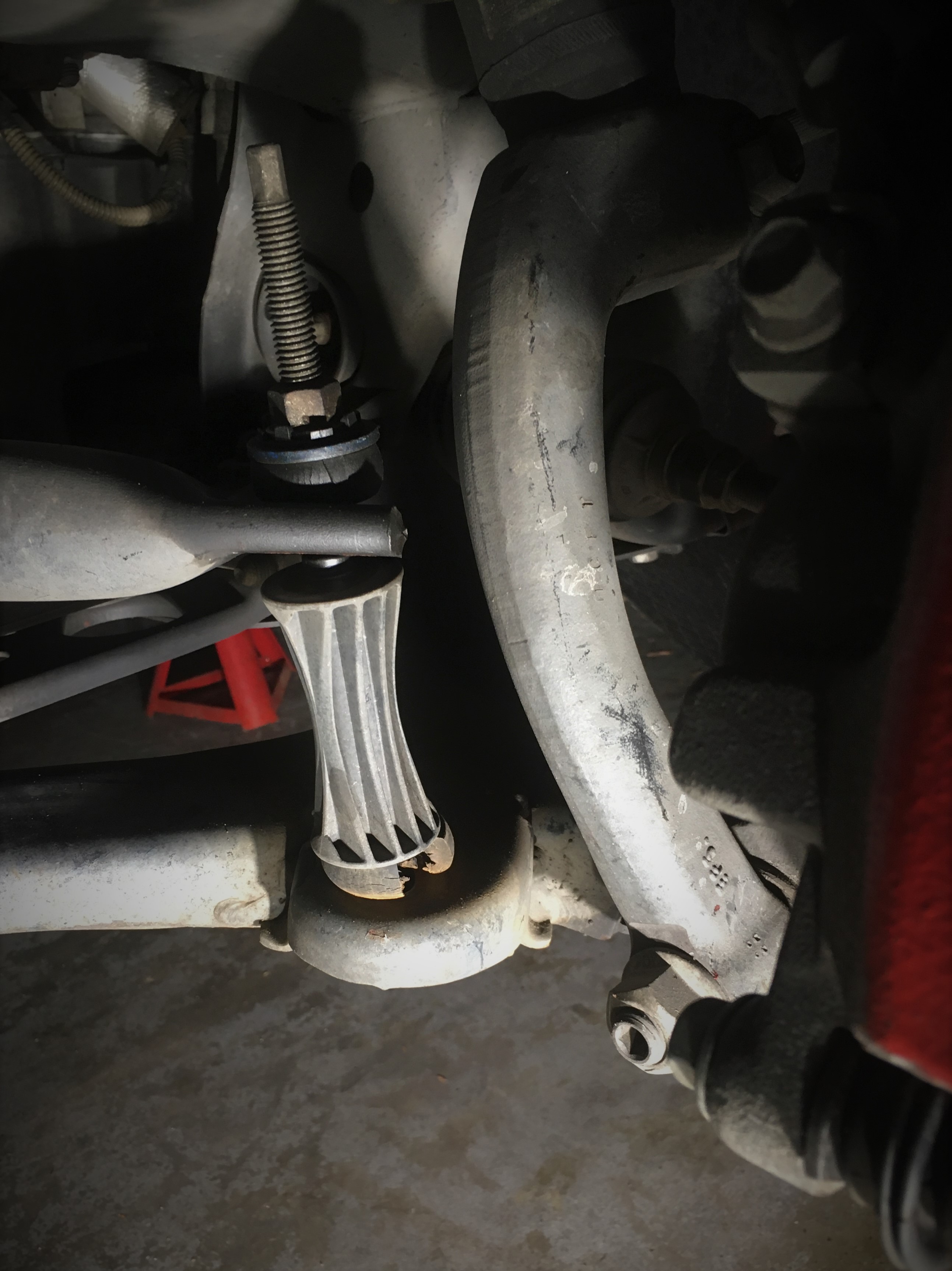

Those end links are crazy looking.
Re: 2008 Trailblazer SS
Are you referring to the spacer?
Posts: 3050
looks like they are finned for cooling, but really probably for rigidity
I didn't realize they were remarkable. I've been looking at them for about 9 years now. They are sturdy plastic and provide good support to the link assembly.

The new front sway bar link bushings made a noticeable difference in cornering. I didn't realize how bad they had gotten. The brakes are now perfect again, too. It's like driving a new truck! :D
