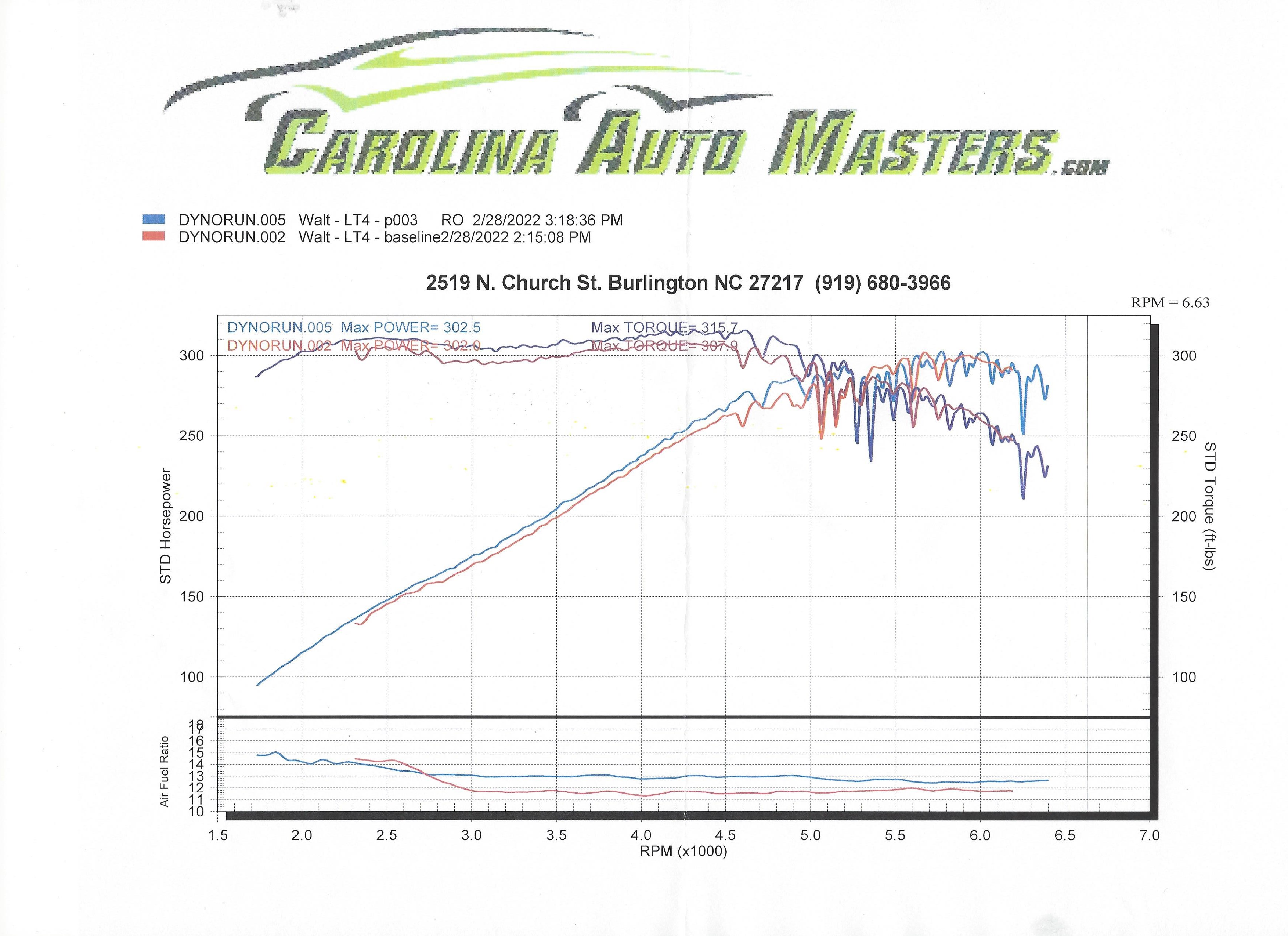

103485 The dyno session today ended with mixed results. The first run showed severe missing starting at 4500 rpm and getting progressively worse all the way up to 6400. After a couple of more runs and changes to the ECM, the miss was marginally better, but still there. Finally, it was decided that the opti-spark ignition was at fault and I needed to get a new cap and rotor and have it cleaned and rebuilt because of oil that had seeped into it. I wasn't surprised. So that's my homework.
In addition, the programming was changed to turn on the fans at a lower temperature. When they came on, they raised a big ruckus. Obviously the bearings had sat idle for too many years. More homework. The ambient temperature today was in the mid-50's so the hour's drive home was not ruined by noisy fans and Silvia ran fine on the interstate. Also, the 1to 4th gear interlock nonsense was disabled with the changes so another annoyance was removed.
Love that torque curve. Now that you have a likely culprit I am interested to see how it behaves after your address the opti spark issue.

I believe the optispark solves all your odd problems. And 300hp to the wheels is impressive already. Super solid numbers with nowhere to go but up.

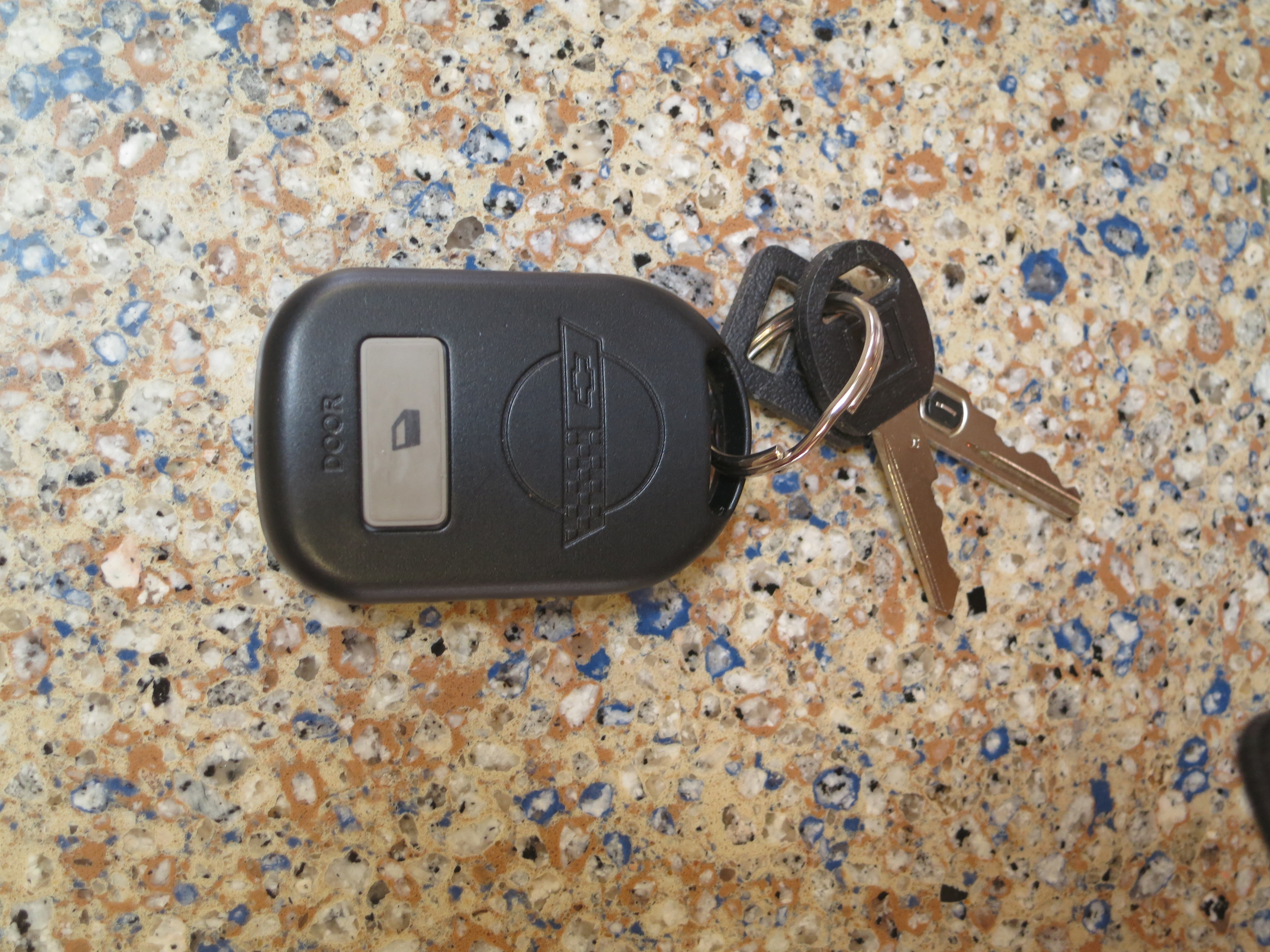

I was able to acquire a very rare PKE (Passive Key Entry) fob for a convertible. Initially, I was assuming it was just a remote for opening the doors via push button, but no, it's much more than that and after 25 years all the electronics still work. Here's what it does:
Operation
You don't have to do anything for PKE to work when
the passive feature is on. Just move toward your
vehicle with the PKE transmitter, and the system will
automatically disarm your theft-deterrent system and
unlock the doors. If it's dark enough outside, your
interior lamps will come on.
If you move out of range, the PKE system will:
1. Lock the doors after five seconds.
2. Arm the theft-deterrent system.
3. Sound the horn to let you know the doors are locked.
4. Turn off the interior lamps.

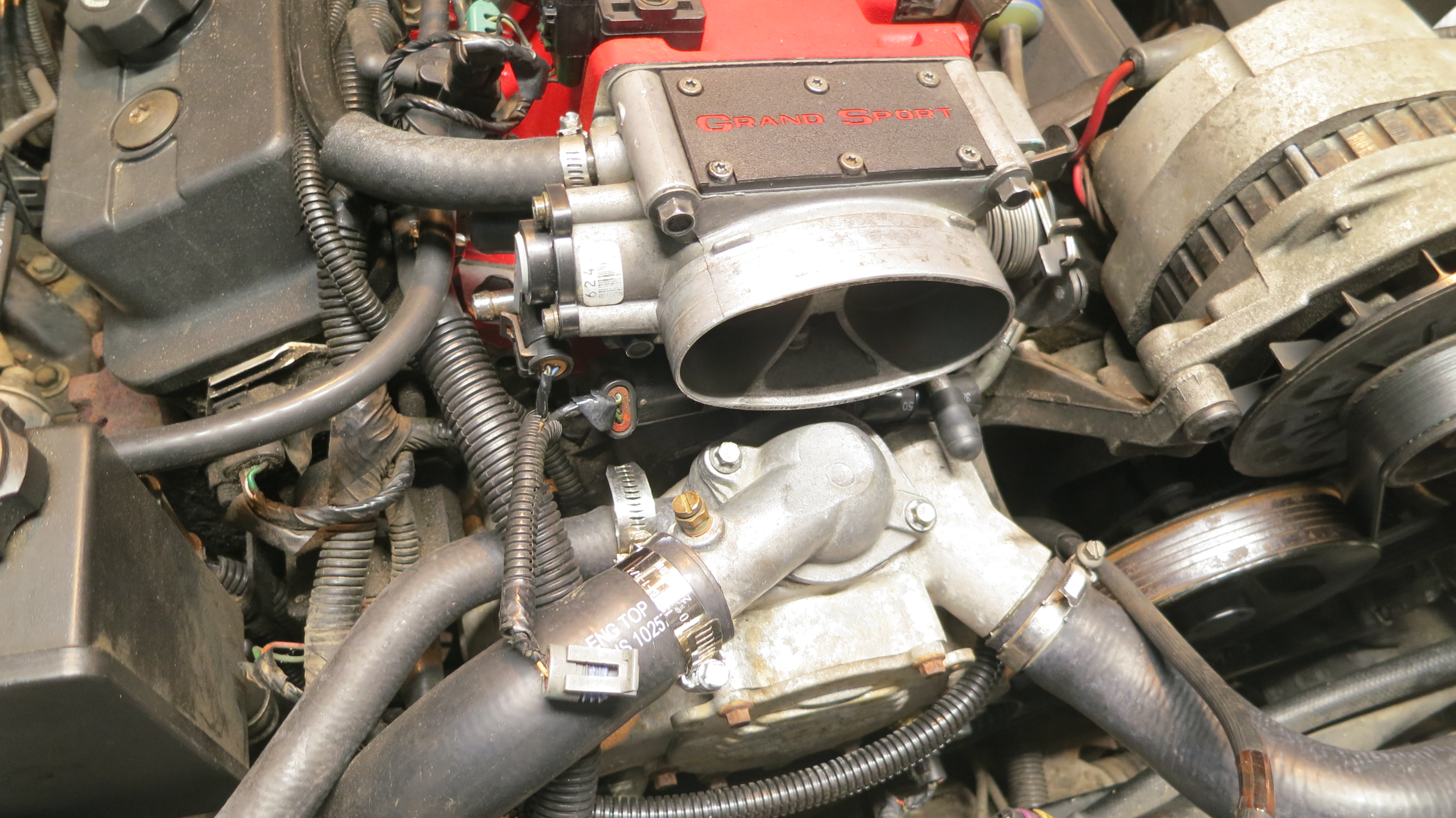

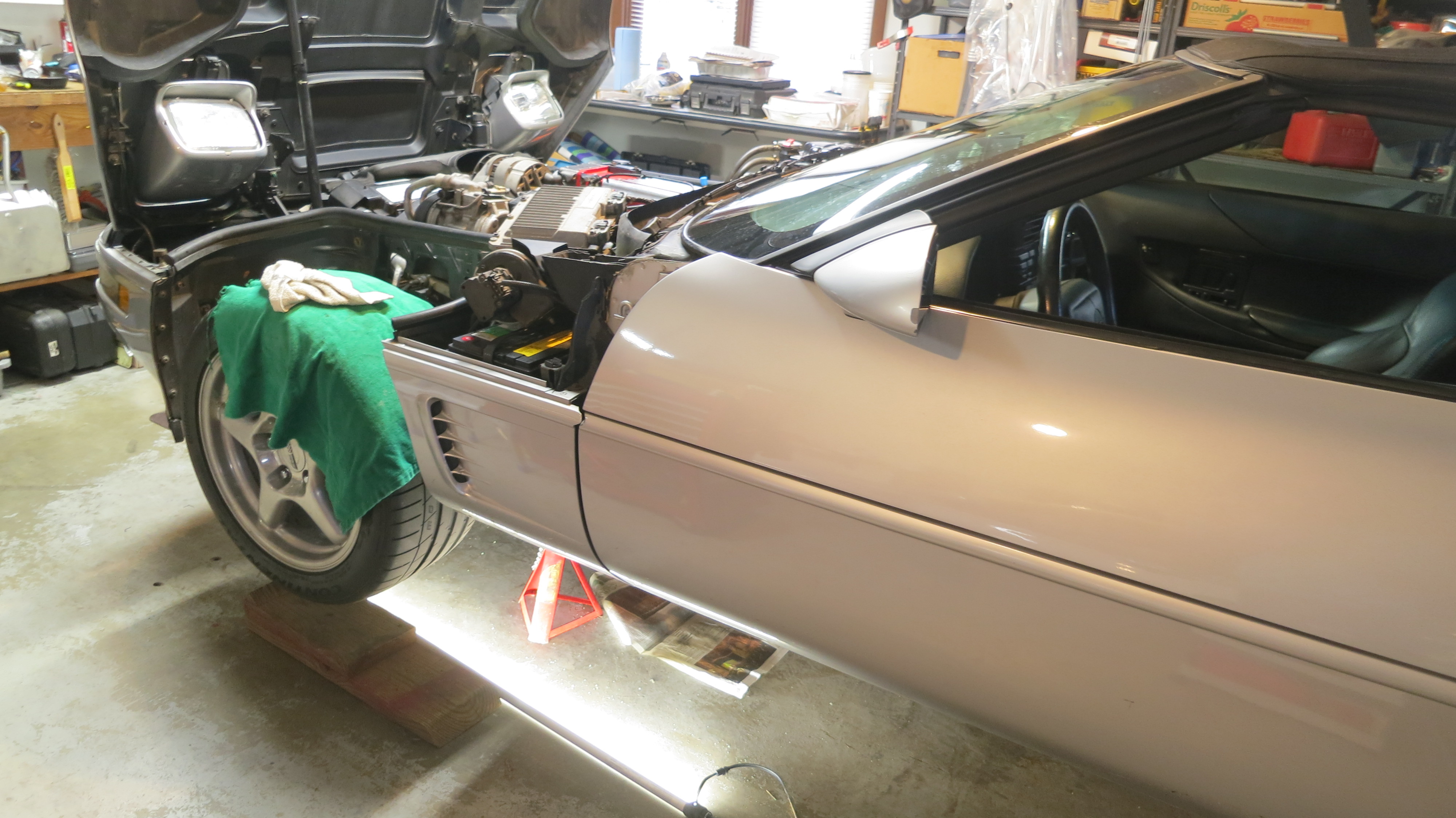

Well, here we go again. Silvia is up on jack stands and the Opti-Spark adventure begins.

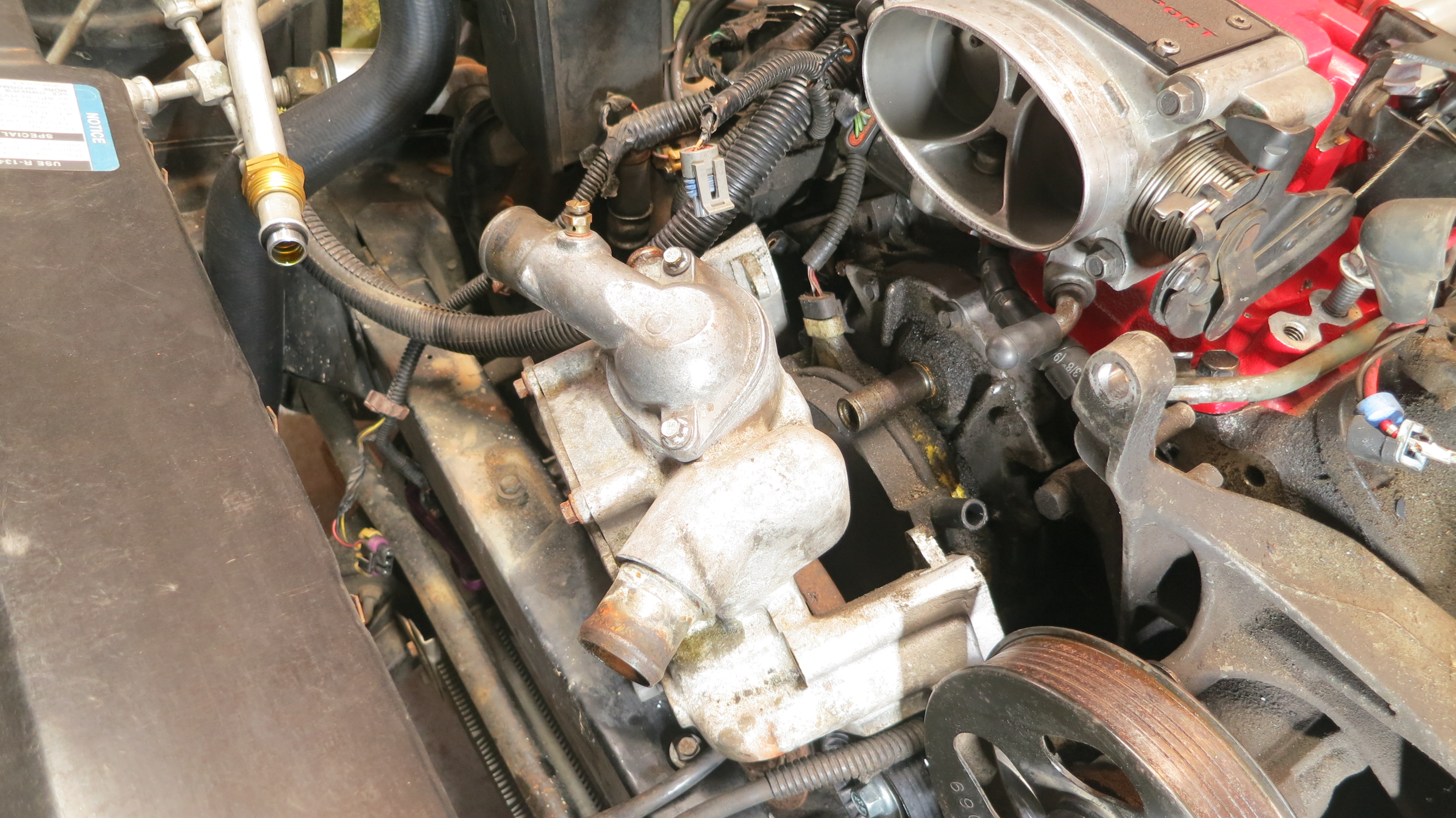

The Opti-Spark is behind the water pump which just under the throttle body there in the photo. I predict there will be many issues to find and correct in this adventure in wrenching.Re: 1996 Collector Edition Corvette

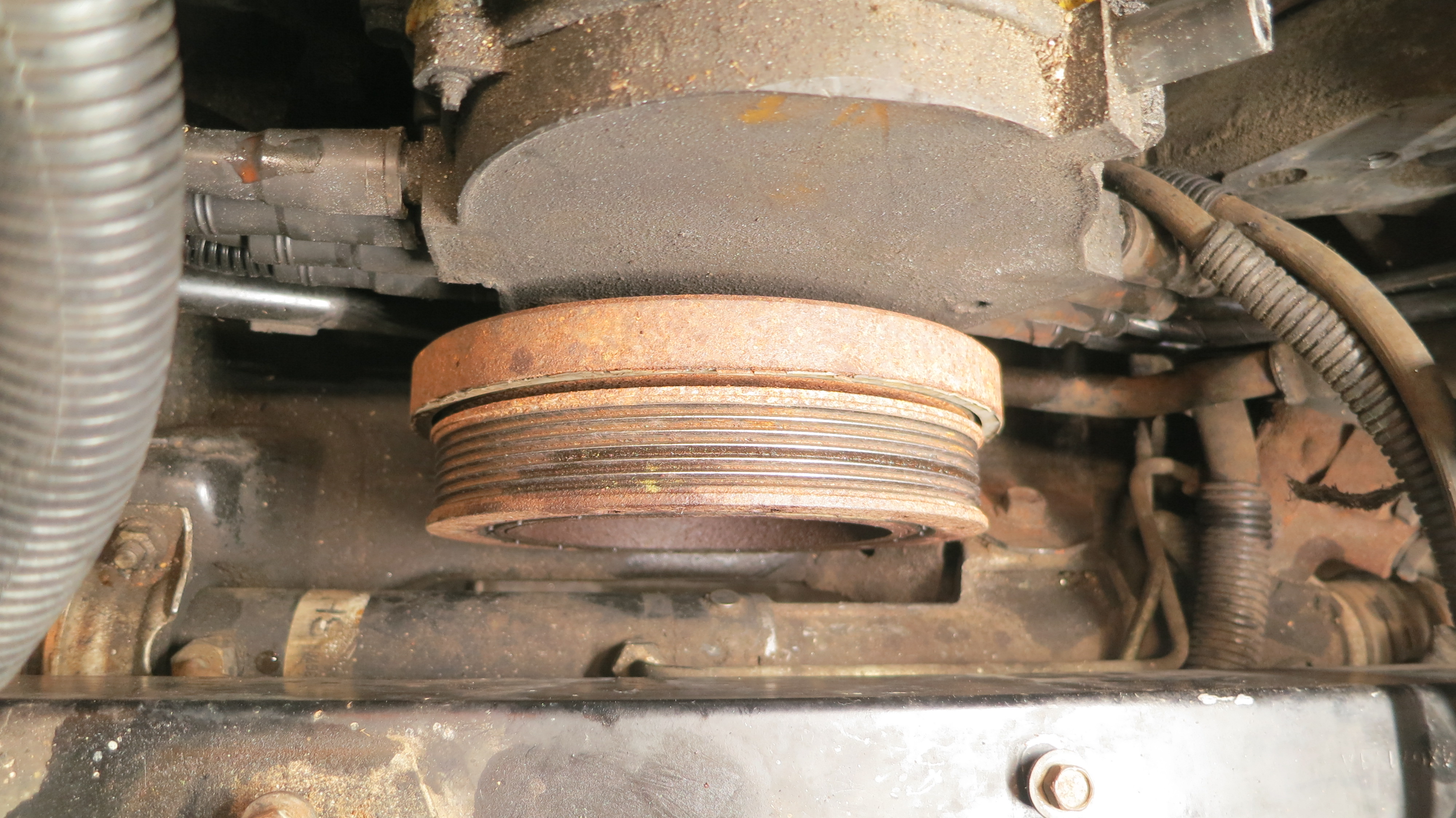

Well, I almost made it to the Opti-Spark today. I'm stopped and stumped at the damper pulley. It is fastened to a hub on the crank snout with three bolts. I was able to remove the three bolts, but it is rusted onto the hub. It looks like an impossible job because there is a frame member just 1.75 inches in front of the pulley. I was able to wiggle a small three inch puller into the damper pulley cavity and hook it on, but it wasn't up to the task. The damper wouldn't budge. There is no room for any of the other pullers that I have in addition to a box full of pullers that Maverick gave me. Right now I've doused it with Deep Creep and will try again another day.
Water pump unbolted and pulled away showing the WP drive coupling from the cam and Opti-Spark unit just under it.
Here's the Opti-Spark unit hemmed in by the damper pulley which is hemmed in by the frame member.Re: 1996 Collector Edition Corvette
Can the front of the engine be raised enough to get a puller on the pulley bolts? Would that be very difficult?
