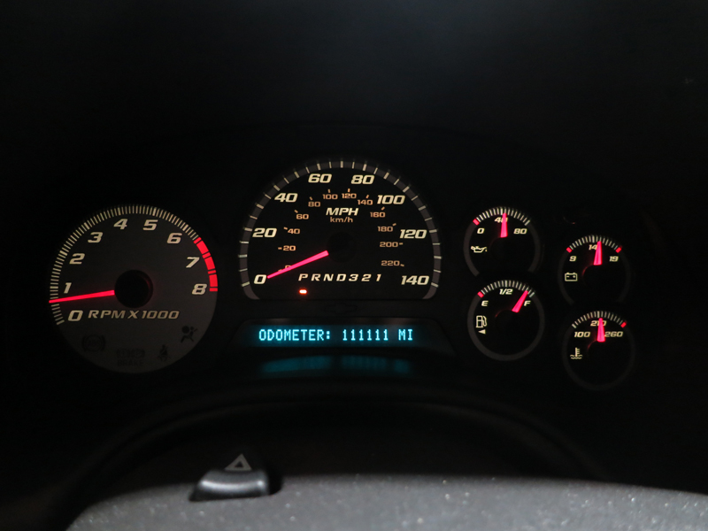

Look what just turned up:
I arrived home last night with 111110 on the clock so I only had to go less than a mile before it turned over for the photo shoot.

Goes well with the address on your mail box. 8)

I JUST missed the 111111 on my Ranger last weekend. I saw it at 111114... too late. 222222 can't come soon enough. Life's little amusements!

121212 and 123321 will come lots sooner
