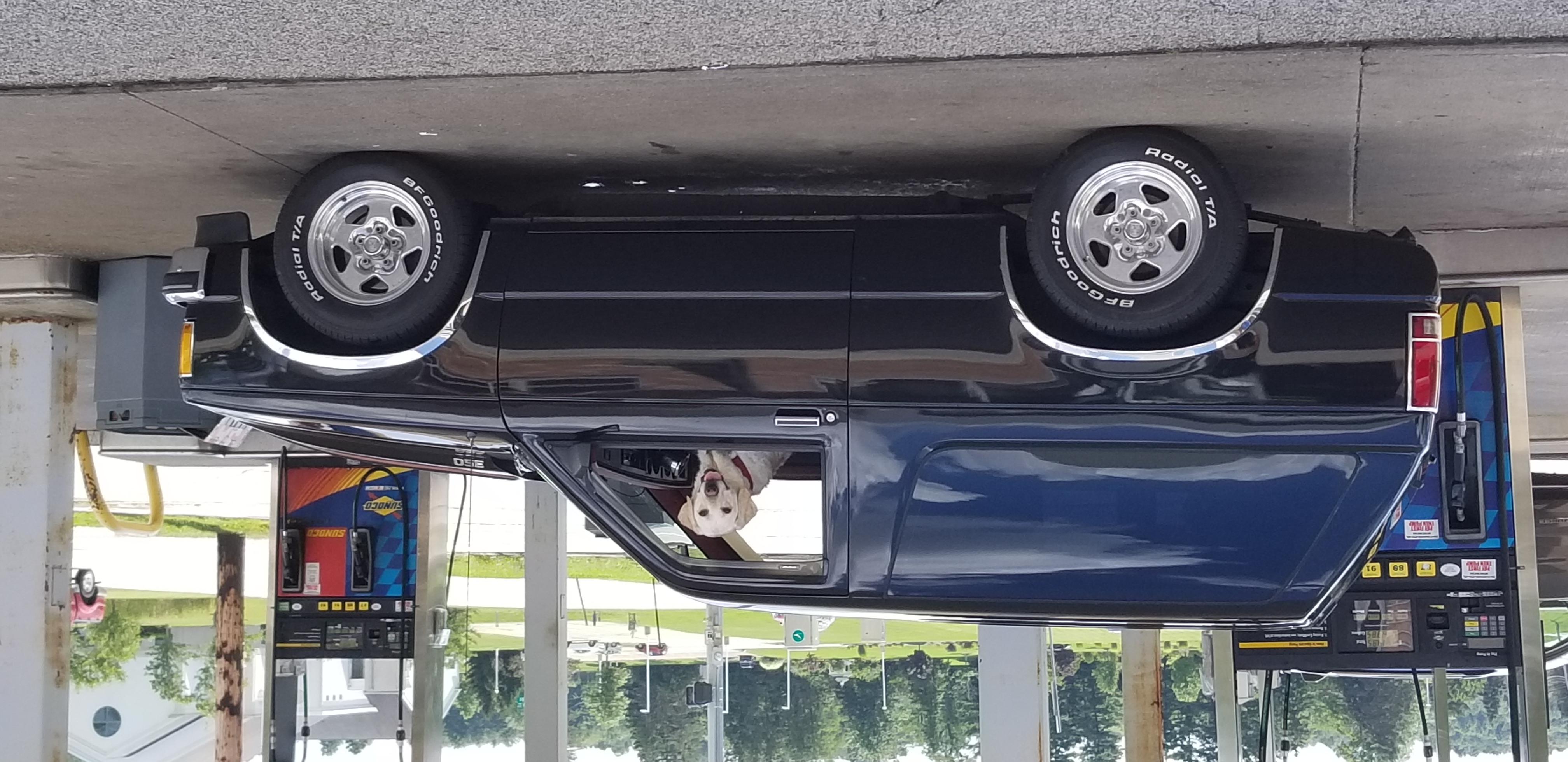

Getting gas this weekend..
-Dave- Blue_69_malibu
- Posts: 389
Re: 1985 V8-S10 Blazer
Was the entire gas station upside down or just your car?
I come from the land down under...Blue_69_malibu wrote:Was the entire gas station upside down or just your car?
