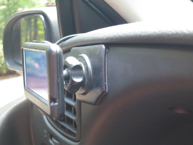

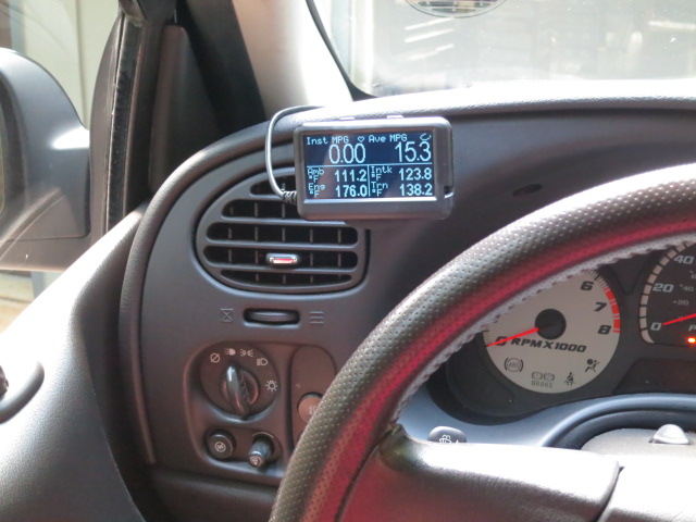

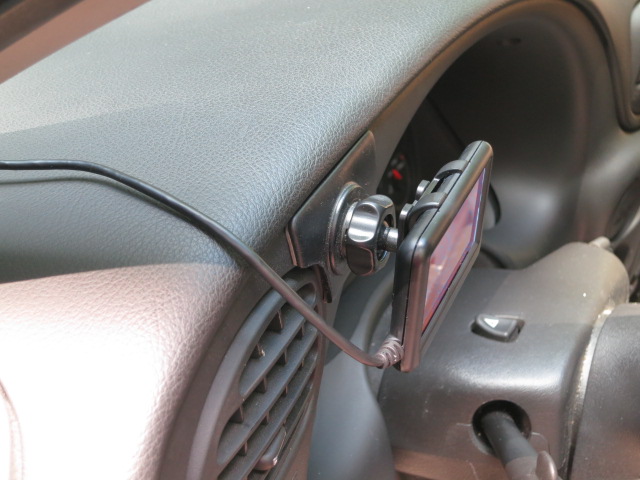

UltraGauge mounting
Following are some images of my UltraGauge mounting location.
IMG_0858.JPG[/attachment [attachment=0]IMG_0859.JPG
I like the location for easy viewing and it has the additional benefit of keeping the unit out of the hot sun and getting cold air from the A/C vent. The visible wire is not ideal, but I couldn't think of a better way.

Re: 2008 Trailblazer SS
Any way to run that cable into the air vent and poke a hole down low to let it out?
The large OBD2 connector on the end of the cable limits where you can go with it. But you did give me an idea. I'm going to explore pulling out the dash to see if there is any way to slip it through there.
