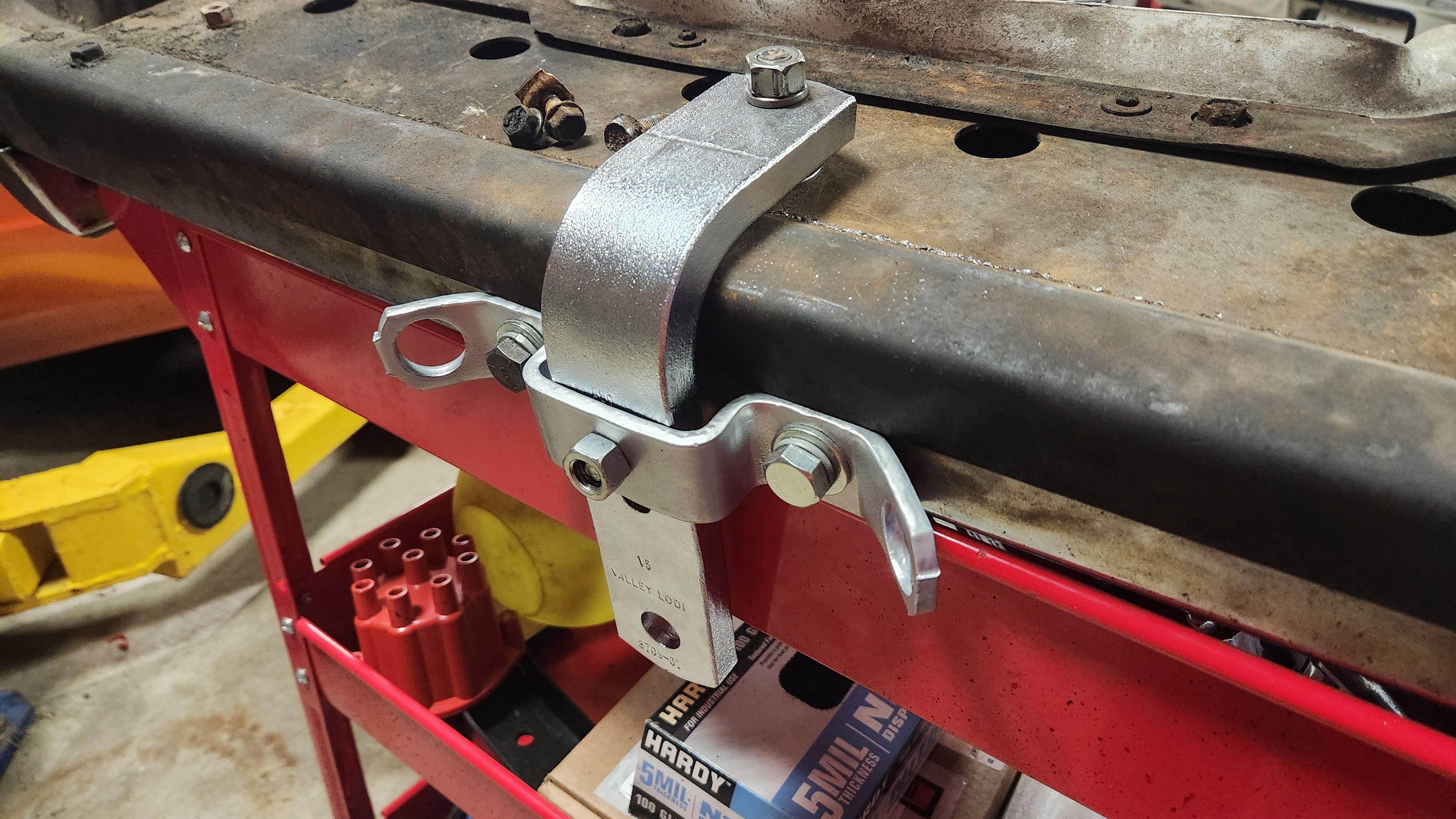

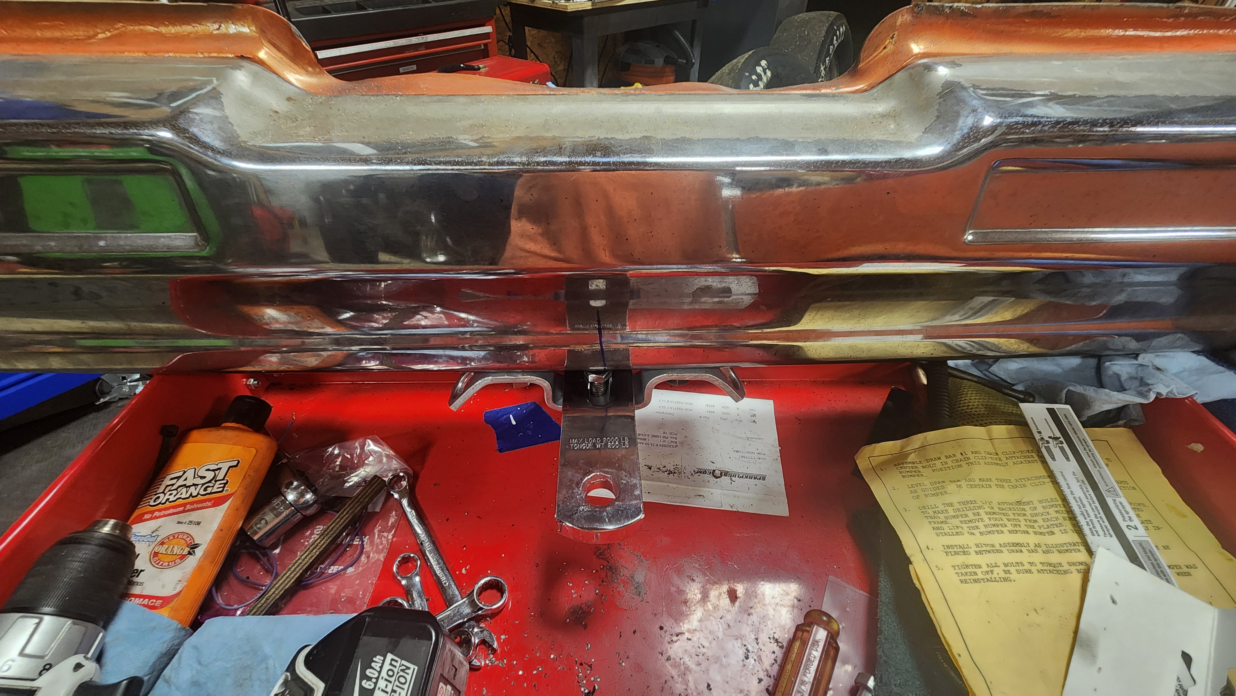

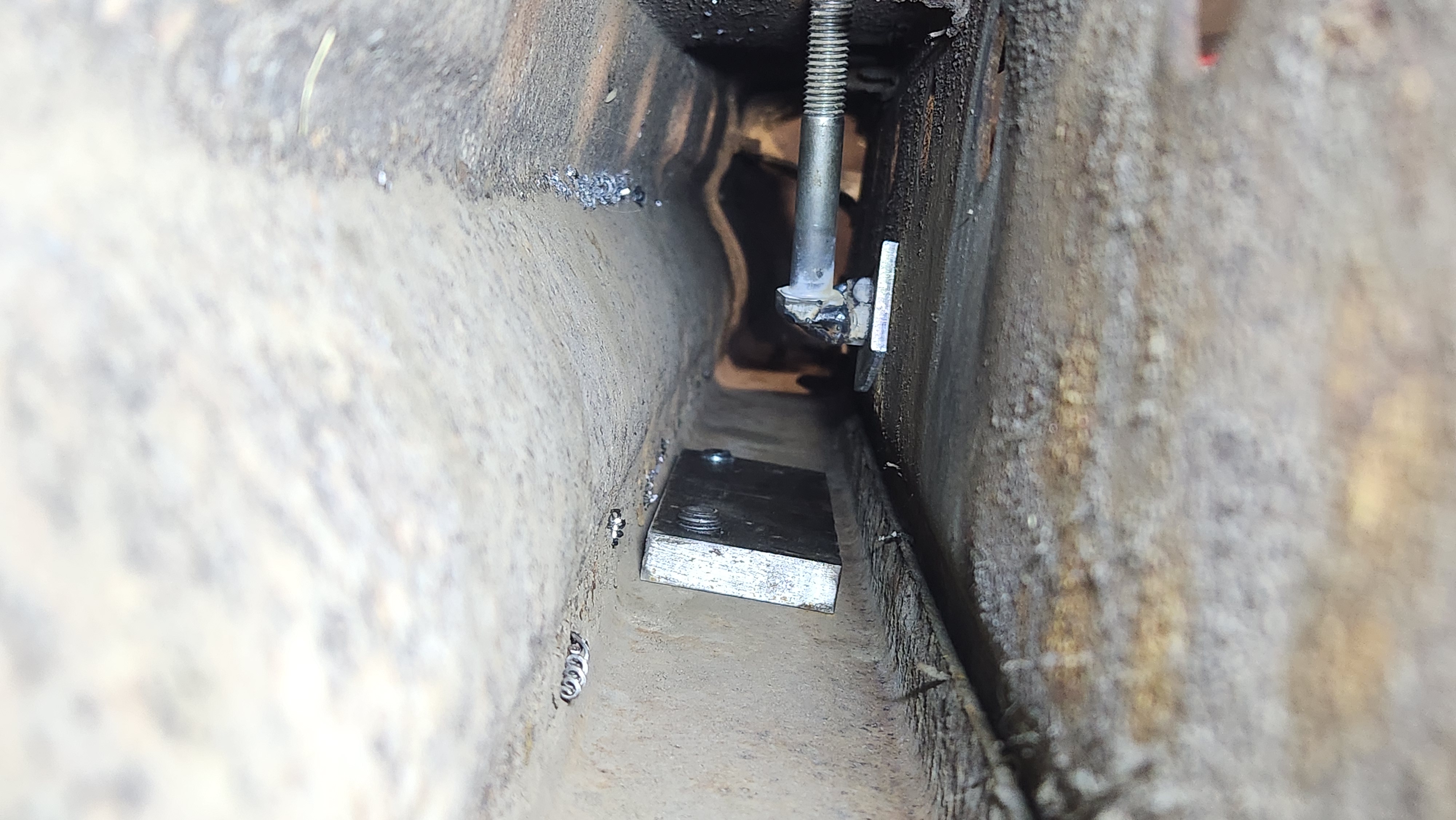

Big progress yesterday with the install of the trailer hitch. Paul found me this super vintage setup for $50 on ebay. Speece brought me a piece of 1/2" (?)flat stock, and a custom bolt-welded-to-a-bolt, both of which would prevent us from needing a wrench on the back side of the bumper to tighten it down. Tapping the holes in the flat stock took a little more effort than planned, but that kind of stuff is his wheelhouse.

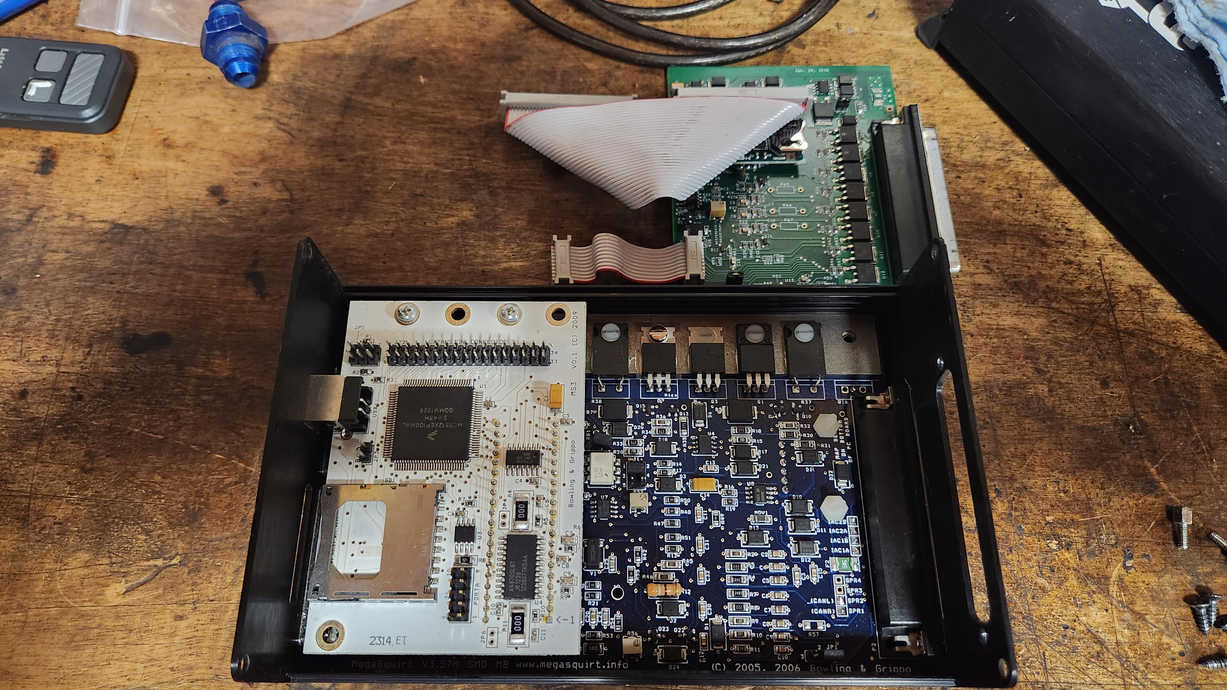

When I got home, everything was checking out good. In test mode, I could hear all the injectors and coils firing. I pulled the return line on the fuel cell and there was a good amount of fuel being pumped. It sounded ok when I was cranking it and it'd briefly catch. I finally decided to swap the Megasquirt for a spare I had, and it fired right up.
But all wasn't well. The spare is a unit I bought from FB Marketplace a while ago. I tried this same unit in the Chevelle just a week or two ago and the car wouldn't even run with it. That was a bit unexpected. While it would start Maliboost and idle, it wouldn't really run over 1500 rpm. RPM signal would go to 0. The RPM circuit is on the main board, and all the injector and coil drivers are on the add-in 3X board. I swapped the 3X board from the spare into my car's Megasquirt and it now runs to at least 3500 rpm. I didn't try any higher. But I feel like this combo will work for now. It should be a good spare, as I ordered a brand-new unit too.
MS 3.57 main board (blue board, machine soldered)
MS3 processor (white board)
MS3X add-in (green board)
