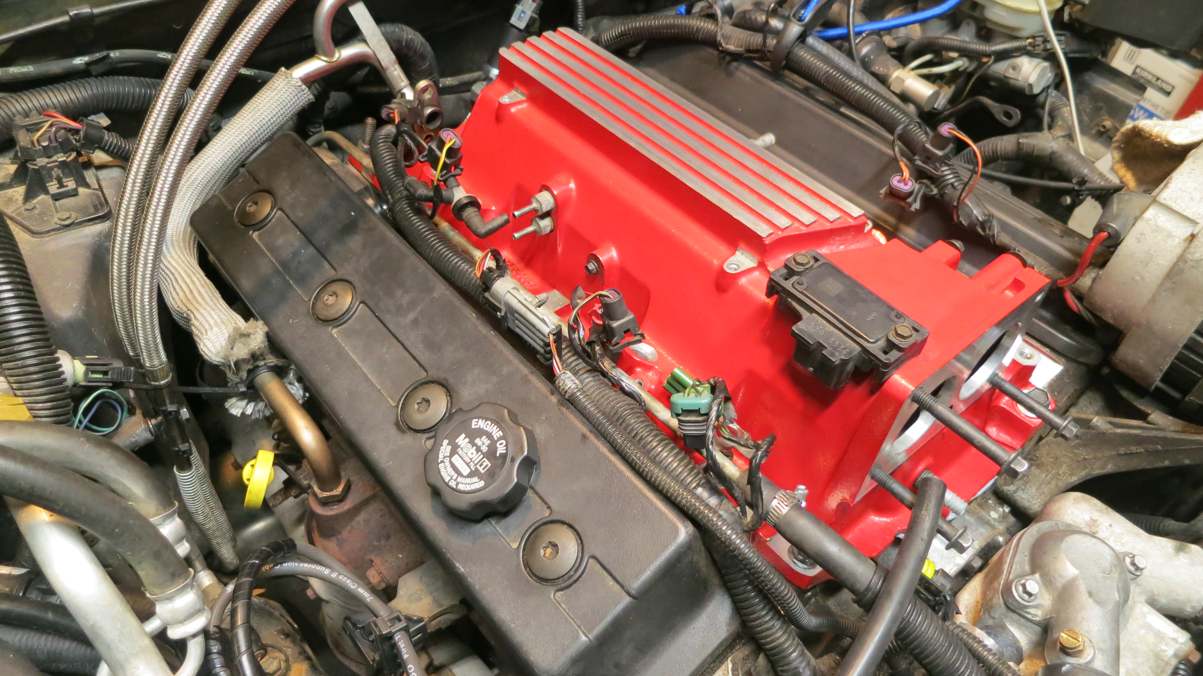

From my last update, the Fel-Pro intake gaskets didn't fit, so I ordered some Edelbrock 7244's for the LT4. They were better, but still not good enough to use. Finally, I ordered some GM 12367777's and they fit perfectly. They were of very high quality gasket material with locating pins that placed the gasket precisely on the head and held it there. Now, finally, I am ready to move in a positive direction again on this project. This morning, I spun the engine with the starter to circulate the oil and mix it with any residual gasoline in the engine internals. Then I changed to fresh oil.
Finally, I installed and torqued the intake.

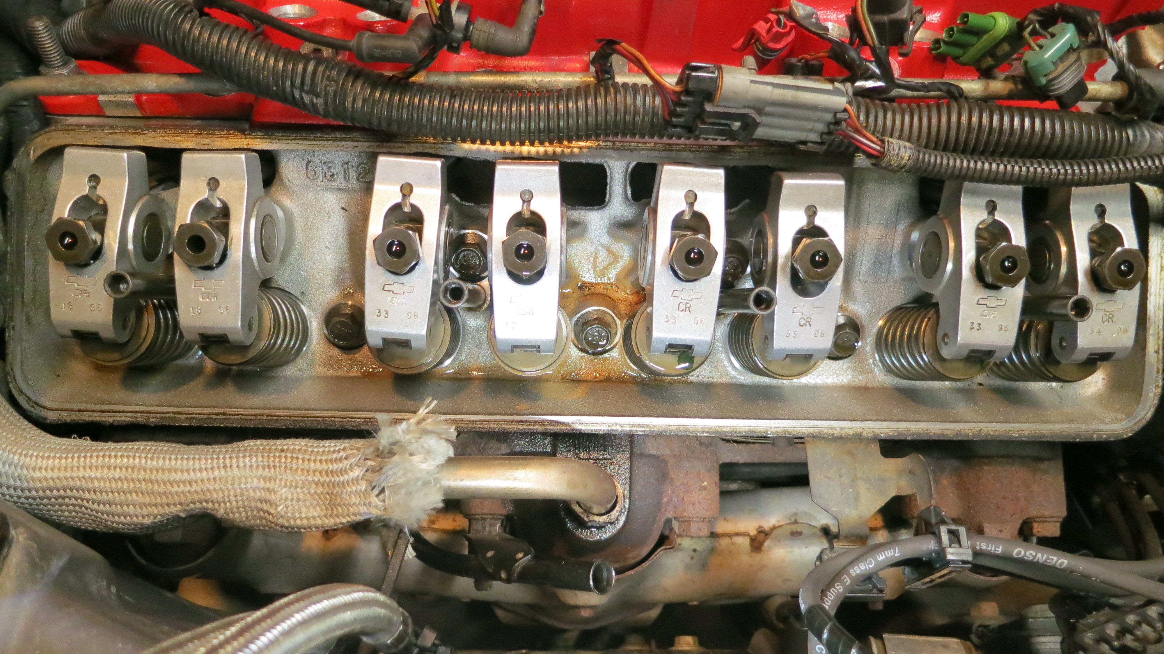

Well, I'm trying to move on, but still curious about this recall issue, so I removed the right side rocker cover to see if I could put the issue to bed once and for all by finding a part number on one of the rocker arms. There are numbers visible on the top of rockers, but nowhere else. The numbers just deepen the mystery, though. They are not all the same. From left to right they are:
18-96 18-96 33-96 12-96 33-96 33-96 33-96 34-96
Posts: 3684
I'm just guessing here, but I'm thinking those are date codes stamped on there (week/year). Using that logic, if they are older than the date the car was manufactured, you're probably good. Or, I'm totally full of crap, which is possible.

Build date
Silvia's build date on the door sticker is 1/96.
And, BP, a guy on the CorvetteForum agrees with you about the numbers being week/year markings.

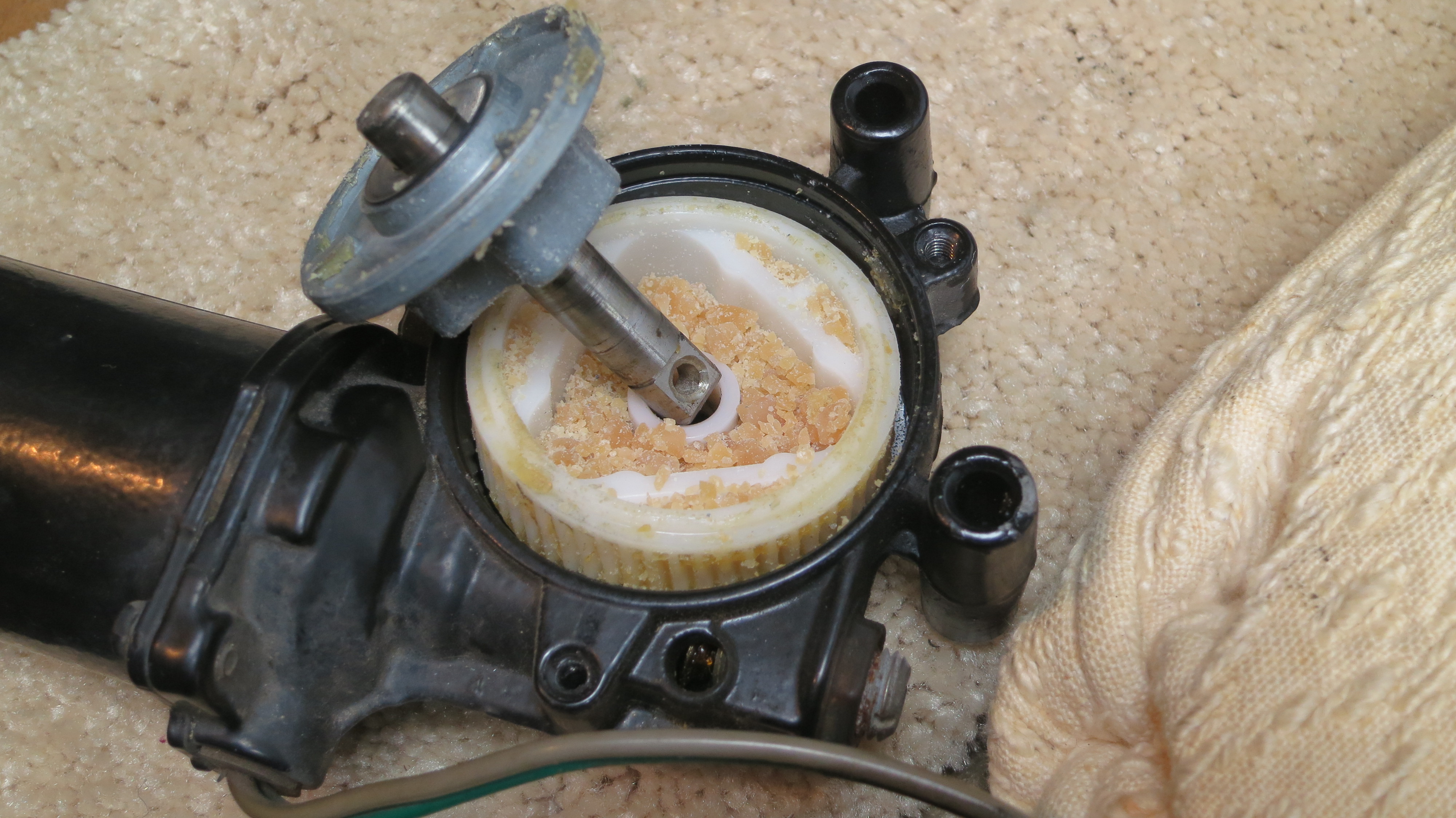

The headlight motors on this car have been disconnected since I brought it home. In my spare time, of course, I search YouTube for solutions to future problems. One of the videos I found was this one https://youtu.be/RBCrYvslp_o?t=616. It describes a cheap fix for a very common problem with C4 headlight motors, so I decided it would be a good bet to remove a headlight and tear it apart to see what it looks like inside the motor housing. Here's what I saw >>>
It's just as the video described. The fix is to get a piece of Delrin plastic rod and cut three small sections to replace those that had disintegrated inside the housing. The Delrin rod is coming next week from eBay. I can't wait to make the repair, get it back in the car and watch it flip.
