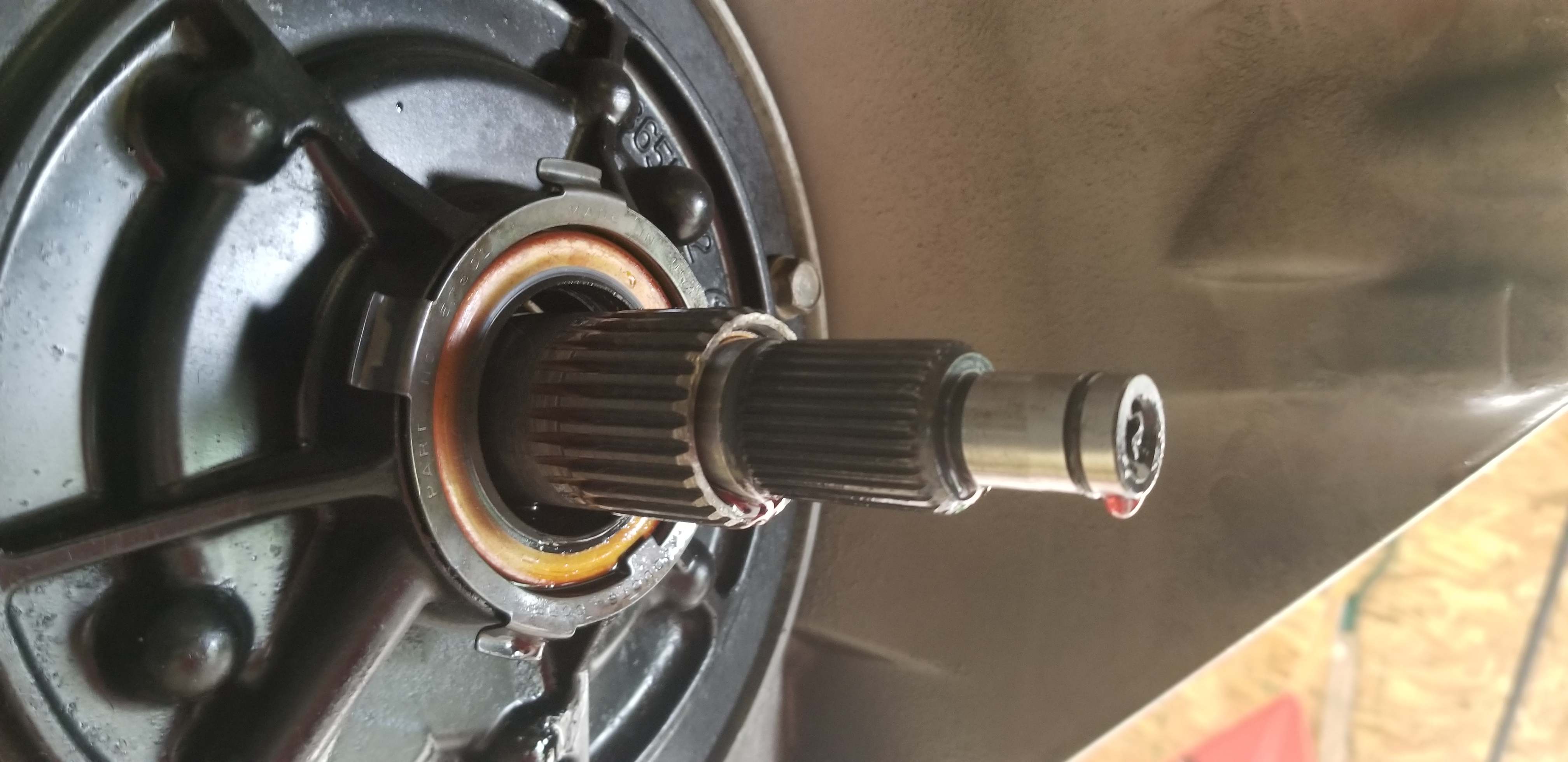

Once we got it out, we made quick work of the converter swap. I took a picture of the input shaft, as I believe the o-ring at the end is vital for the lockup to work. So, I have a picture, it's there. Lockup never worked on the Summit converter. After the converter swap, I made a governor change, from #2/#3 weights to #1/#2 weights to lower the shiftpoints a little.
