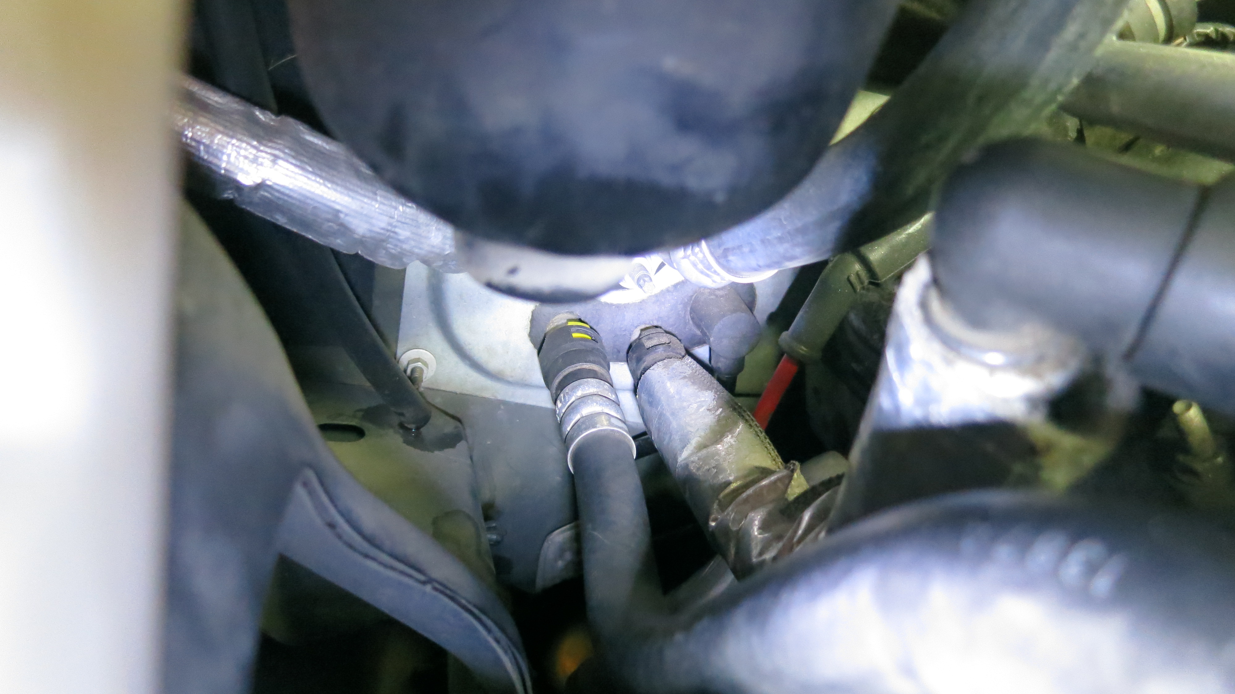

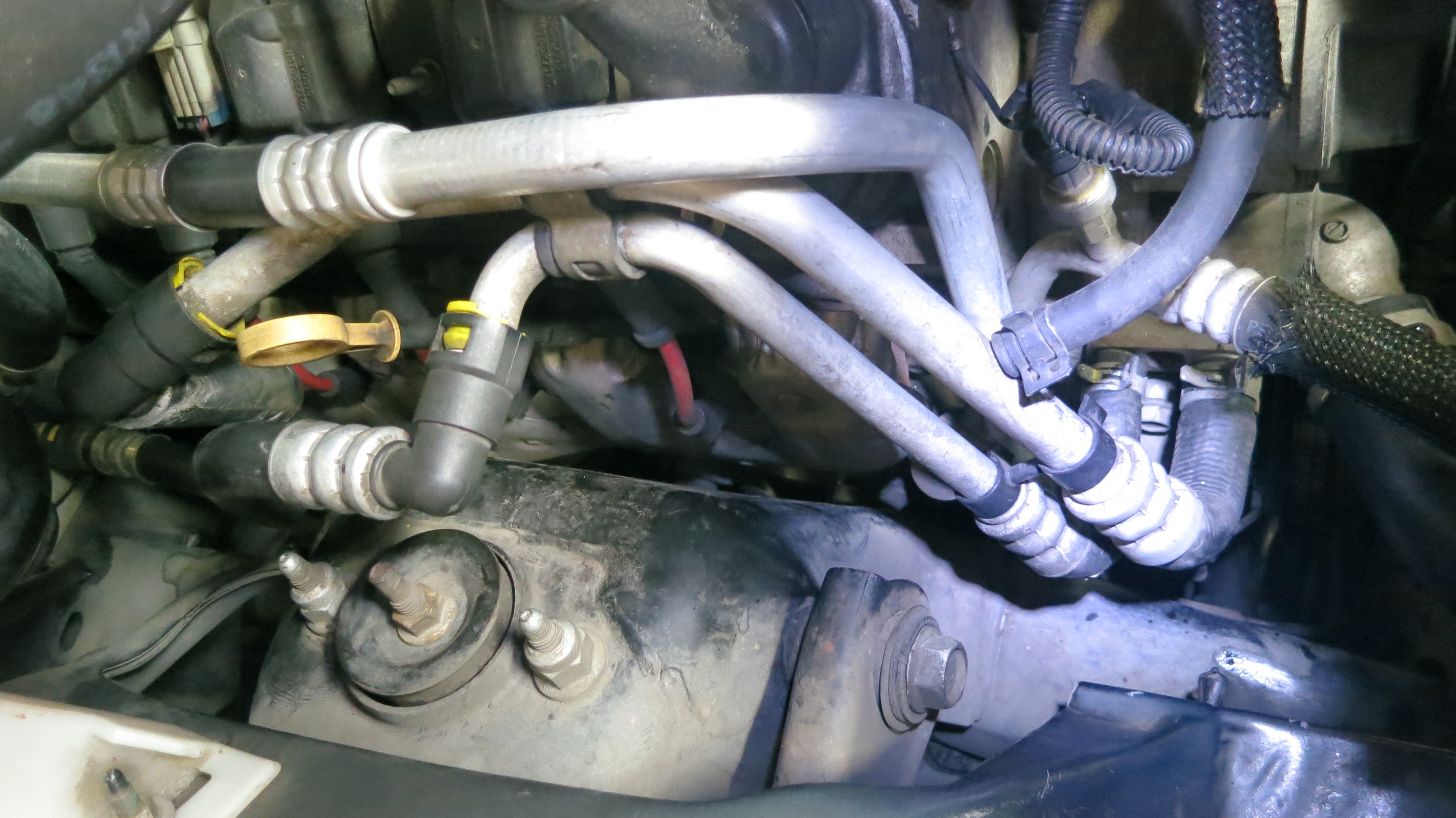

I completed the cooling system flush & refill today. What a struggle! My truck has a heater hose assembly of hoses and metal tubing to get the water from the engine to the heater core. It attaches to the heater core with quick disconnect fittings. It looks like this:
This assembly is not available any more. My plan was to reproduce it with fittings and heater hose, but that plan fell apart when the Dorman connectors I bought would not fit. After many hours of work, I decided to punt and use the original assembly. I'll have to watch it for deterioration of the rubber hose parts and come up with another plan at a later date. I spent all day today on this project. I had to Jerry-Rig the Prestone back flushing kit to flush out all the old coolant. The good part of all this is that the radiator and all the parts that I could see are in excellent condition. It looked so good that I decided that there was no point in using a quick flush agent on it. I think I still have some air in the system because the temperature reading is not as low and as constant as I would expect with the 160 degree thermostat. I will let it cool and keep checking and adding coolant as needed over the next few days.

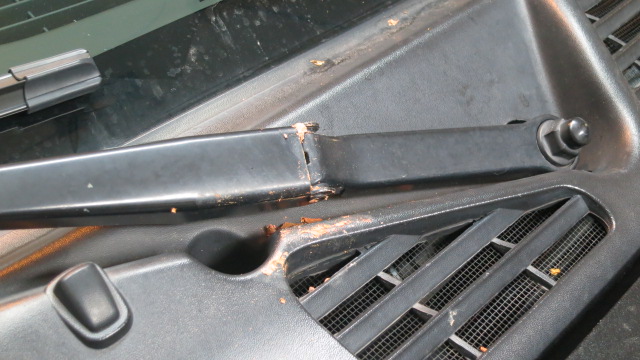

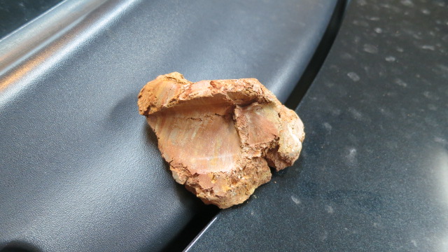

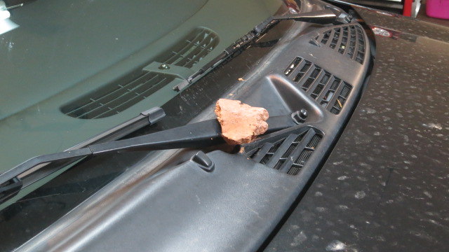

We were close to home on our trip back from Jasper Georgia on Monday. A large dump truck ended up in front of me for the last 10 miles. Since debris was falling off the truck, I stayed a safe distance back as we traveled the 55 MPH two-lane. Near the point where I was getting ready to turn off, we heard a loud bang as something hit the truck. I didn't see it coming. Sitting on the cowling in front of me was a large rock. I scanned the windshield and saw no cracks and a quick look at the hood from the driver's seat revealed nothing. I assumed it had hit the roof, so we stopped to take a look. Amazingly there was no damage to the roof, hood or windshield, but there sat the rock in the cowling near the windshield wipers. Upon closer examination, I saw marks that indicated that the strike was directly on the RH wiper pivot. I also saw that the "rock" was actually a large piece of semi-solid mud. It even molded itself to the wiper arm. I tested the wipers and on the first pass, the RH blade fell off. I reattached it and they seem to be working normally. State Farm just narrowly missed another claim.

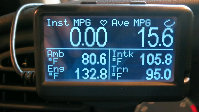

Got my Transmission Fluid Temperature display working
Since I've been towing lately, it rekindled my interest in monitoring my transmission fluid temperature. Originally, I thought about installing a sensor and gauge, but lost interest when it got complicated. Then I learned that there is an upgraded model of my UltraGauge which theoretically could display Trans Temp and several other pieces of manufacturer unique data. So I ordered a new UltraGauge MX 1.3 and set out to see my Trans Temp. They have some parameters pre-programmed for this data, but since it is manufacturer and vehicle dependent, it didn't work in my case. I browsed the web for days without success and gave up. I opened a support ticket with UltraGauge and they provided minimal help so I finally told them that that I wanted to return the unit. The next day I got a response with some useful tips. With this I was able to get the thing working. Hooray!
