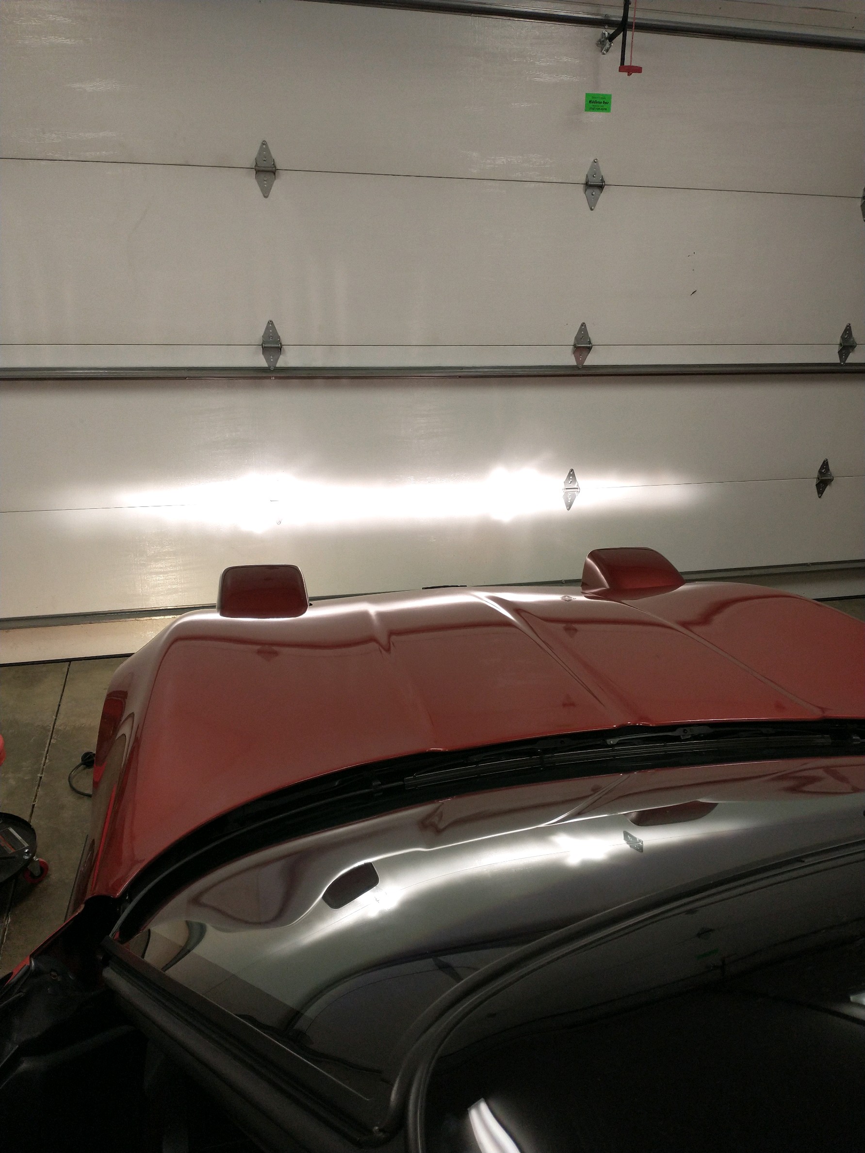

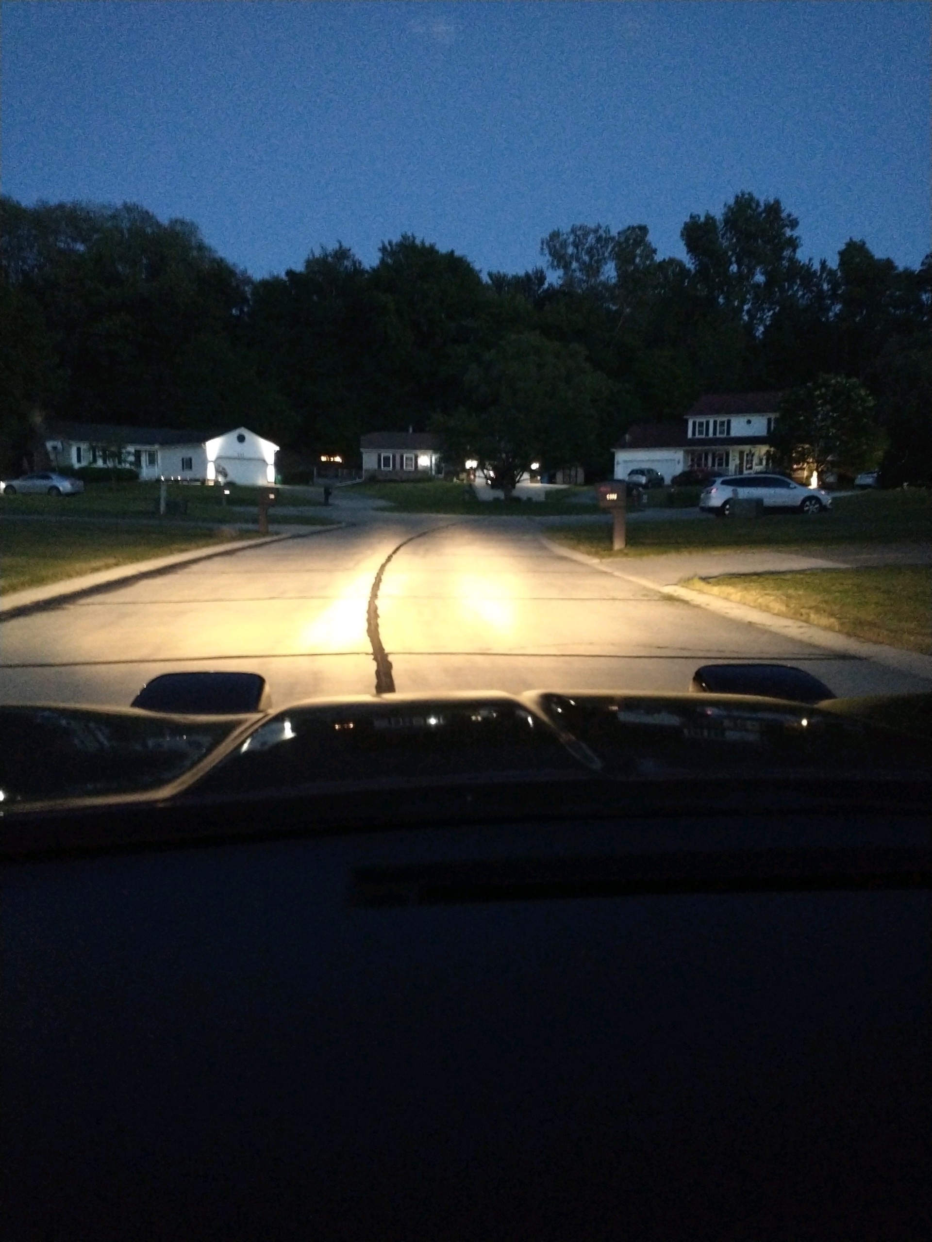

Last night coming home from the track was the first time I've driven at night with the new headlights. They are definitely an improvement, and since it was fresh in my head, and the car was in my garage, I took the chance to adjust them a little better. The right light was pointed forward correctly IMO, but was a little low, so I turned it up just a little bit. The left light was pointing way left and a little low. So I cranked it up and back towards the center more. The next trip in the dark will tell me more. It's pouring rain right now so no night drive tonight. It's super easy to adjust them so I'll stay after it, but I think if they're adjusted right, they'll do a real nice job.
- Posts: 3682
Re: 1987 Corvette Z52
So my headlight adjustment in the garage was pretty unsuccessful in the dark so last night I went out with a screwdriver at dusk and drove around making several adjustments, each one a little better, but I'm pretty happy how they turned out compared to what I had.

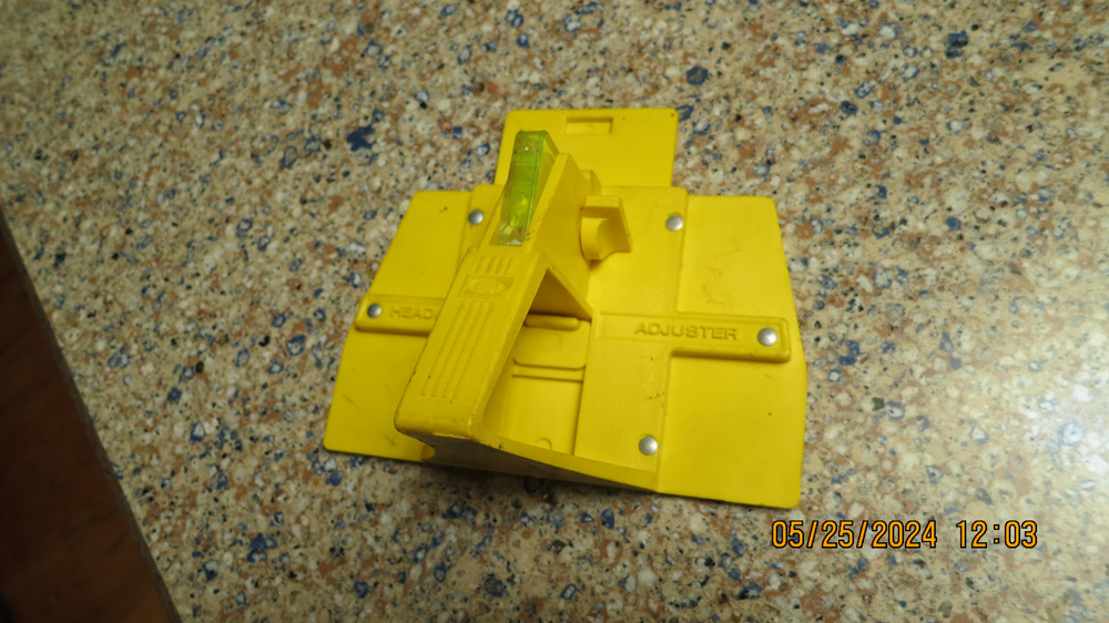

BP, you just inspired me. Your post on C4 headlight aiming triggered a memory. Decades ago, I bought a headlight aiming tool. (actually it only assists in adjusting in the vertical plane) I've been meaning to get Silvia's headlights aimed correctly for a long time now. Your post caused me to dig out this tool and use it. First you calibrate it to the floor at the front wheels, then you set it on the aiming pads of the headlight and adjust to get the bubble within the target area on the tool. Easy peasy! It took all of 10 minutes to get them adjusted. They were way out. Now I have to wait 'til it gets dark to see if there's a noticeable improvement.
BTW: I read a good tip. To turn off the headlights when they are rotated up, just set the switch back to parking position.

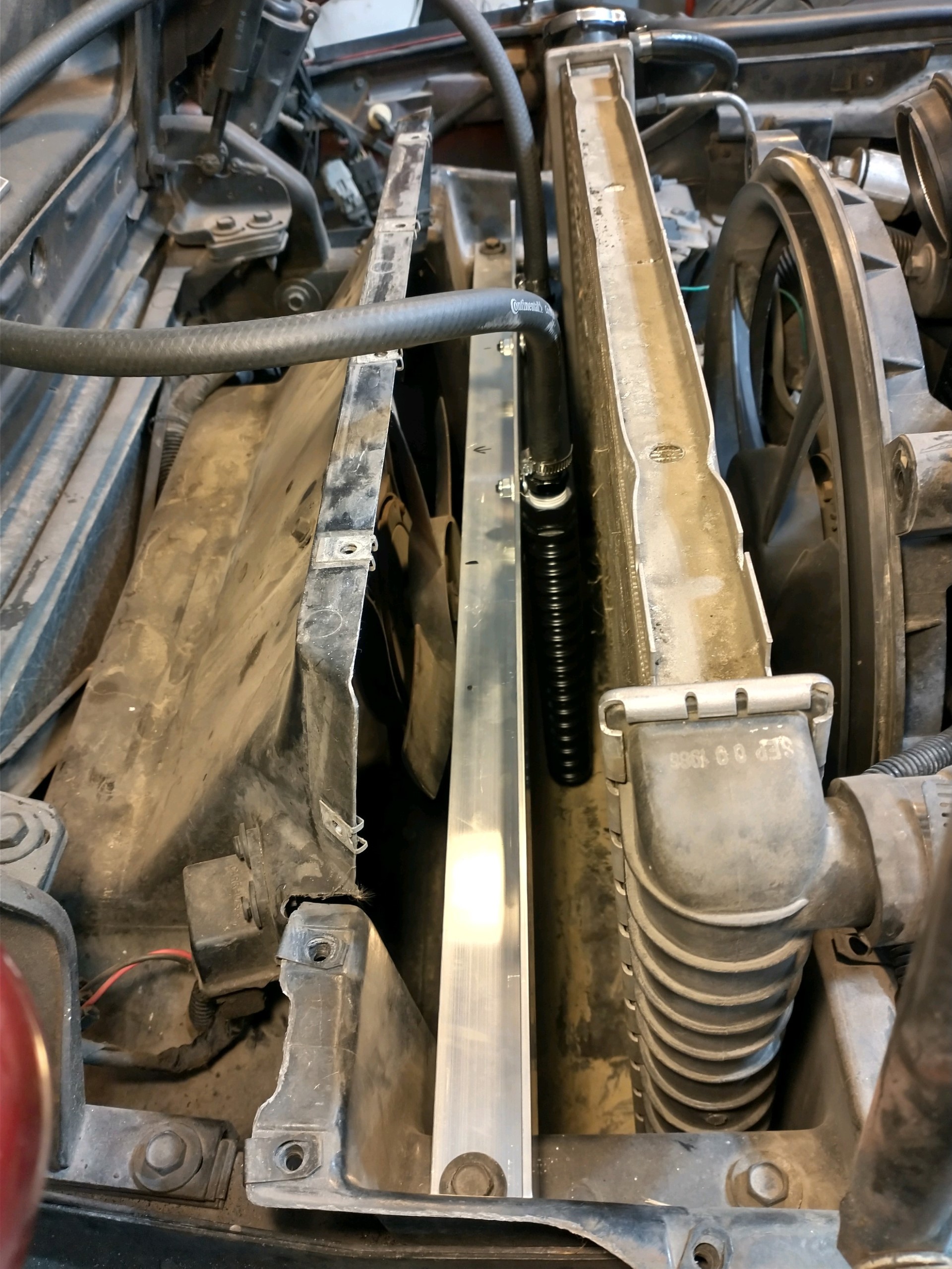

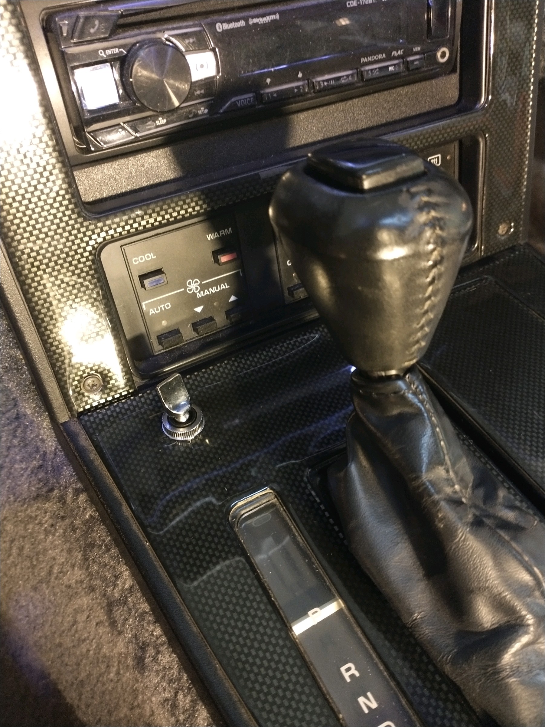

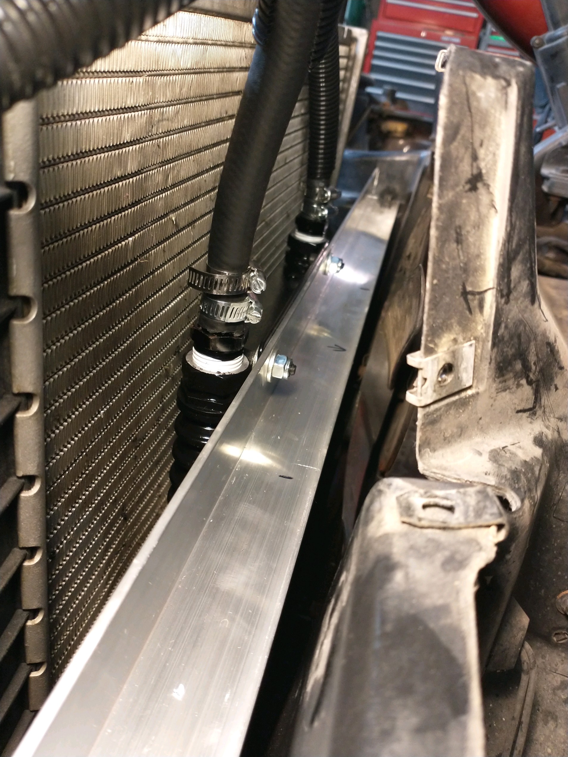

The Z52 package comes with two electric fans. The main fan on the motor side of the radiator that pulls the air through and a secondary fan on the front side of the radiator (see picture from when I was doing the trans cooler). The main fan is supposed to turn on at 225 degrees and the secondary fan when it gets to 230. WTF?? So right now the car has a 160 thermostat and the main fan comes on with the keyswitch, but the secondary fan never came on for obvious reasons. I would be shutting a car off if I saw it get to 230 degrees! The good thing is that the secondary fan has two wires and a plug that are reasonably easy to access on the LF of the car.
This past weekend we first ran a couple jumper wires up to make sure that fan actually worked. After a successful test (and it makes a BUNCH of wind and is quiet) we set out to run power and a switch to it. I'll save the boring details, but I now I have a working backup fan that makes power on demand. I think this might be useful both in towing scenarios, and also potentially during track days and autocross events where cooldown time is a minimum.

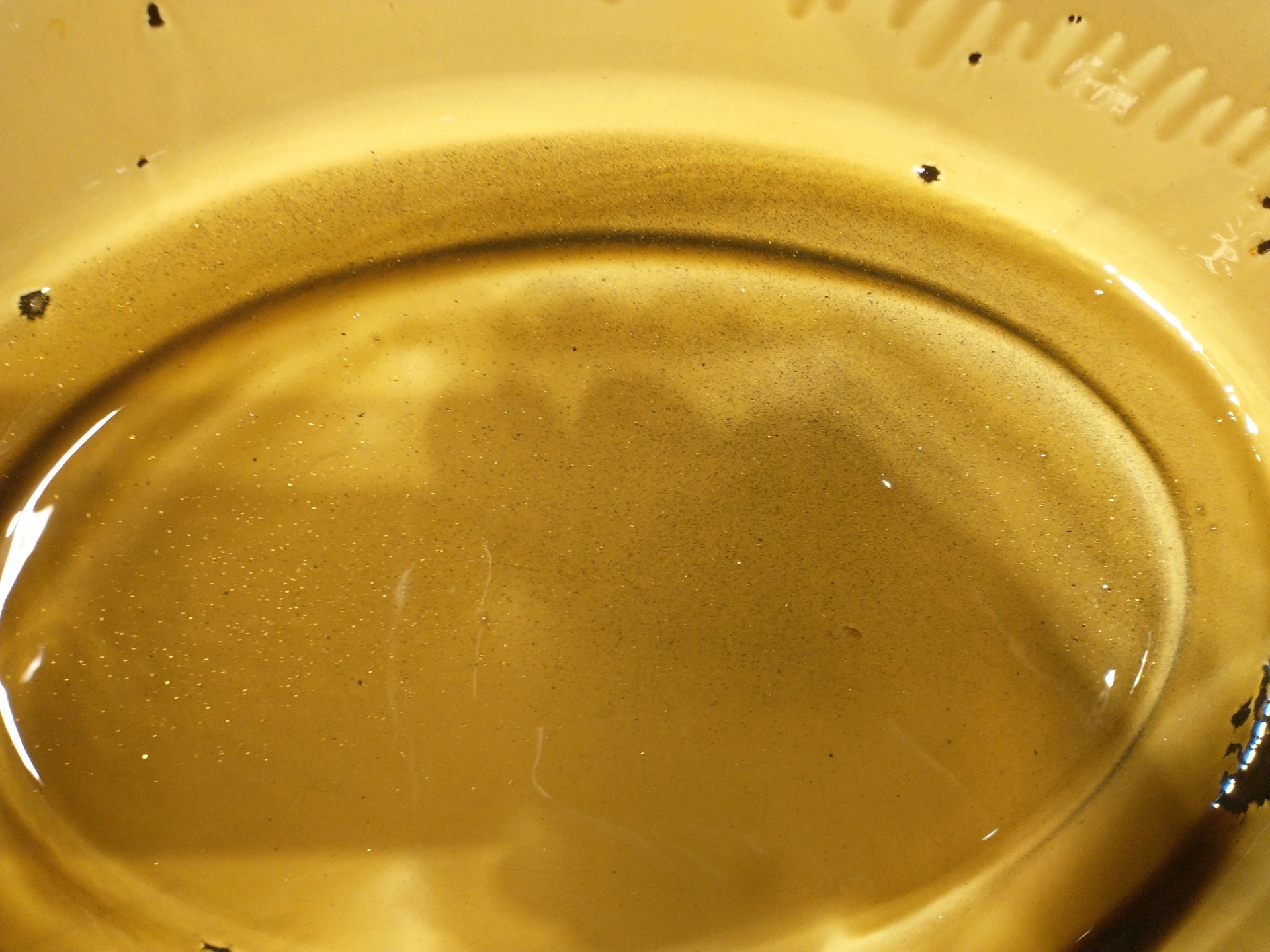

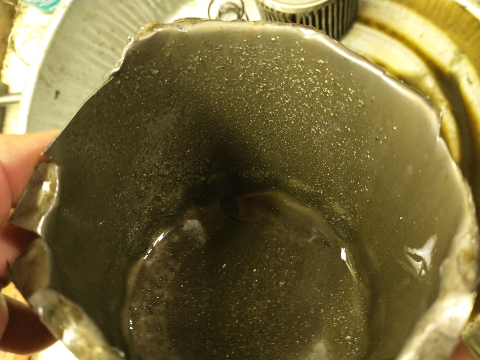

Yesterday I took the Vette to it's first track day at Nelson Ledges. Long story short, I didn't quite finish my first 20 minute session as I lost oil pressure coming out of the carousel and the car began running a little bit rough. The theory at this point is that the stock oil pan was unable to hold the oil in place under the heavy G-load so the pickup could keep sucking successfully and I ran a rod bearing or two dry. The engine temp at this point was at about 220 degrees. I didn't get too worried about this as the factory fans wouldn't normally kick on until about 225. I also was running the oil a quart OVER full to help with this situation. I believe it lasted this far into the session because I was getting more familiar and comfortable with the car and thus going faster through the turns as the session went on. I made it back to the pits running with the oil temp warning saying I was over 300 degrees and oil pressure was at ZERO. After it sat for a long time and cooled down thoroughly I restarted it and it was showing about 14psi with cold oil so I decided to attempt to drive it to dad's which is about 25-30 min tops. It did make it and had varying oil pressure depending on RPM so I tried to not let it go to idle.
Tomorrow I plan to drain the oil and pull the pan to see what I can see. This can be done in the car apparently. Time will tell what we'll find.

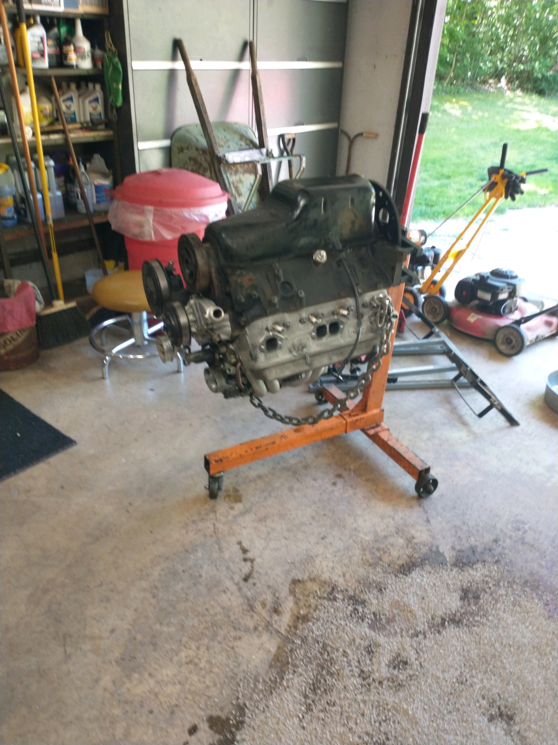

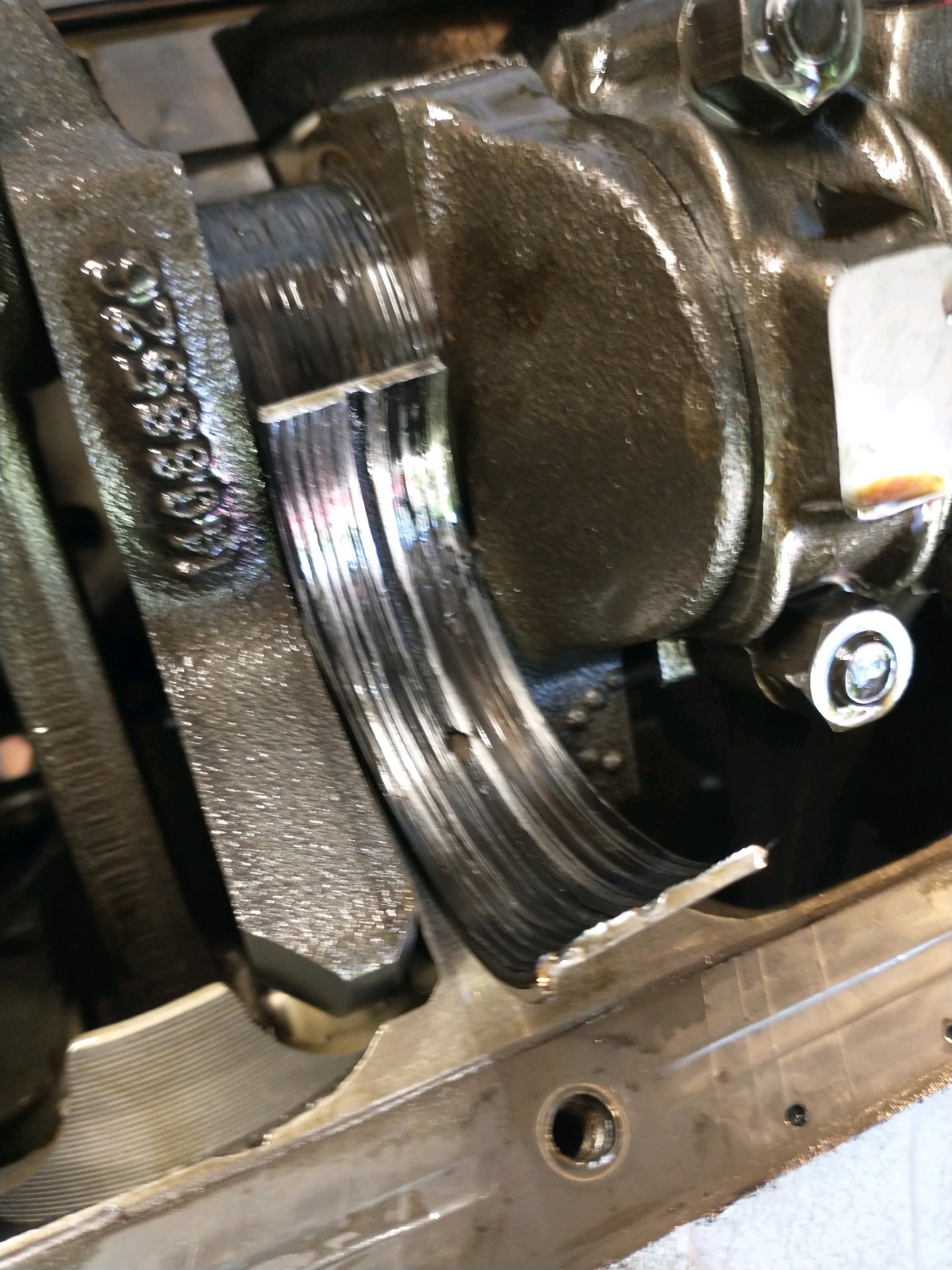

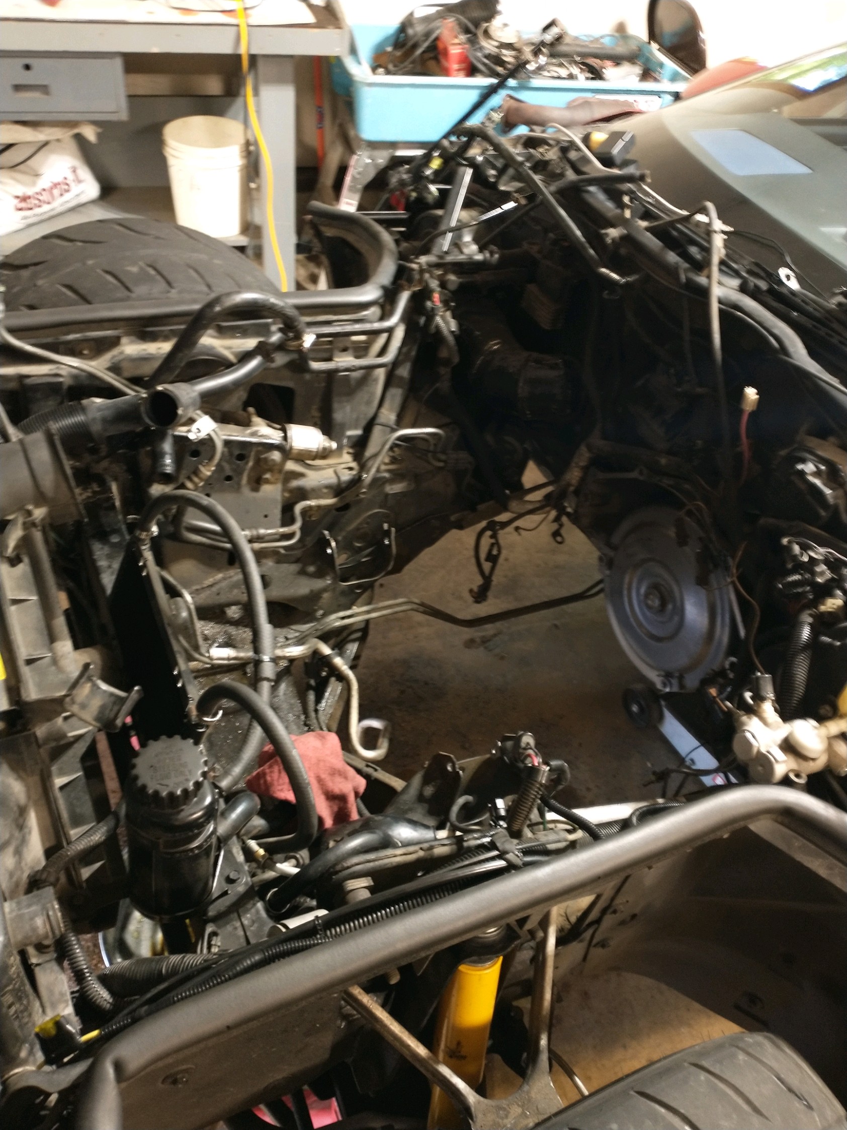

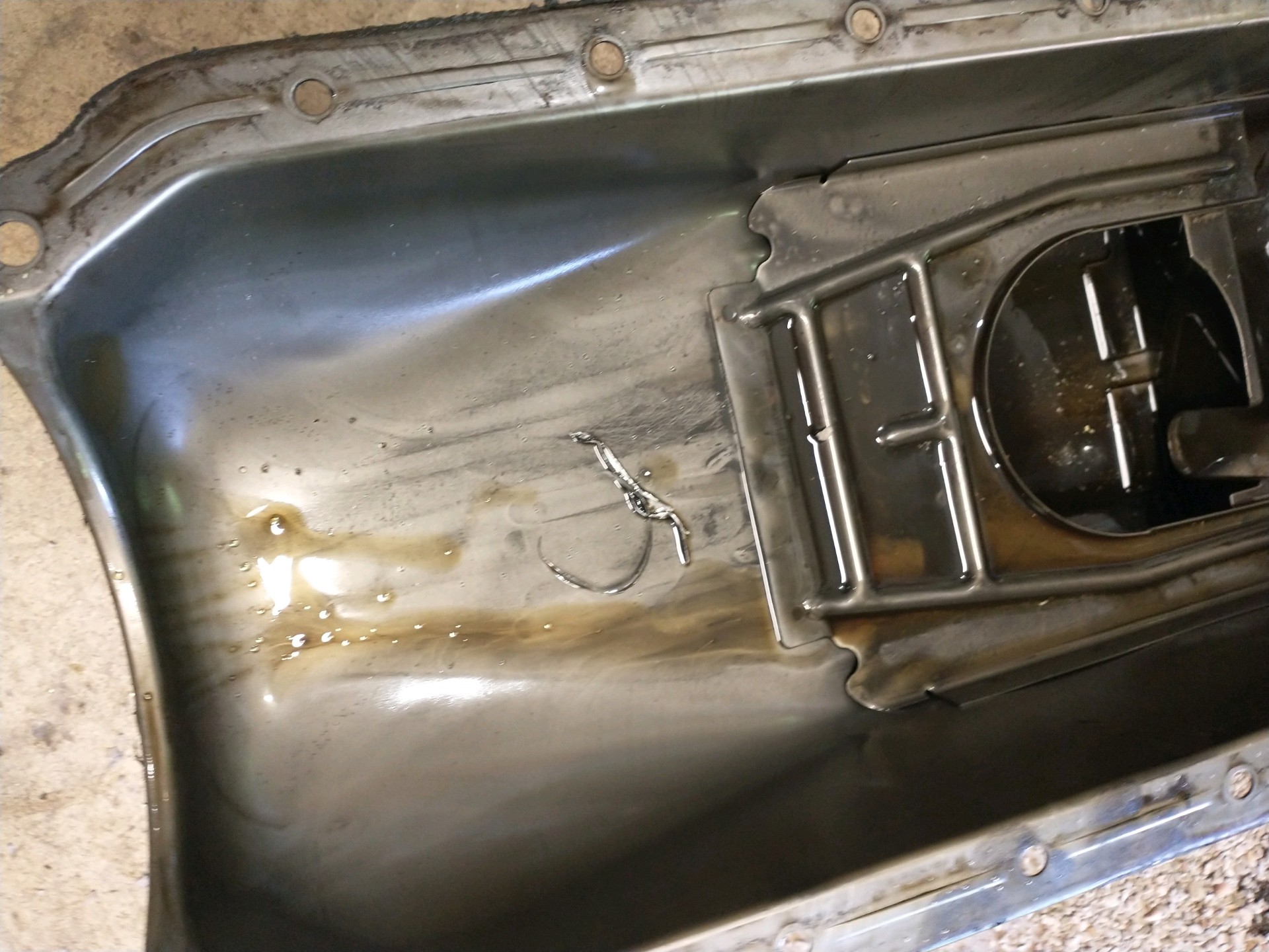

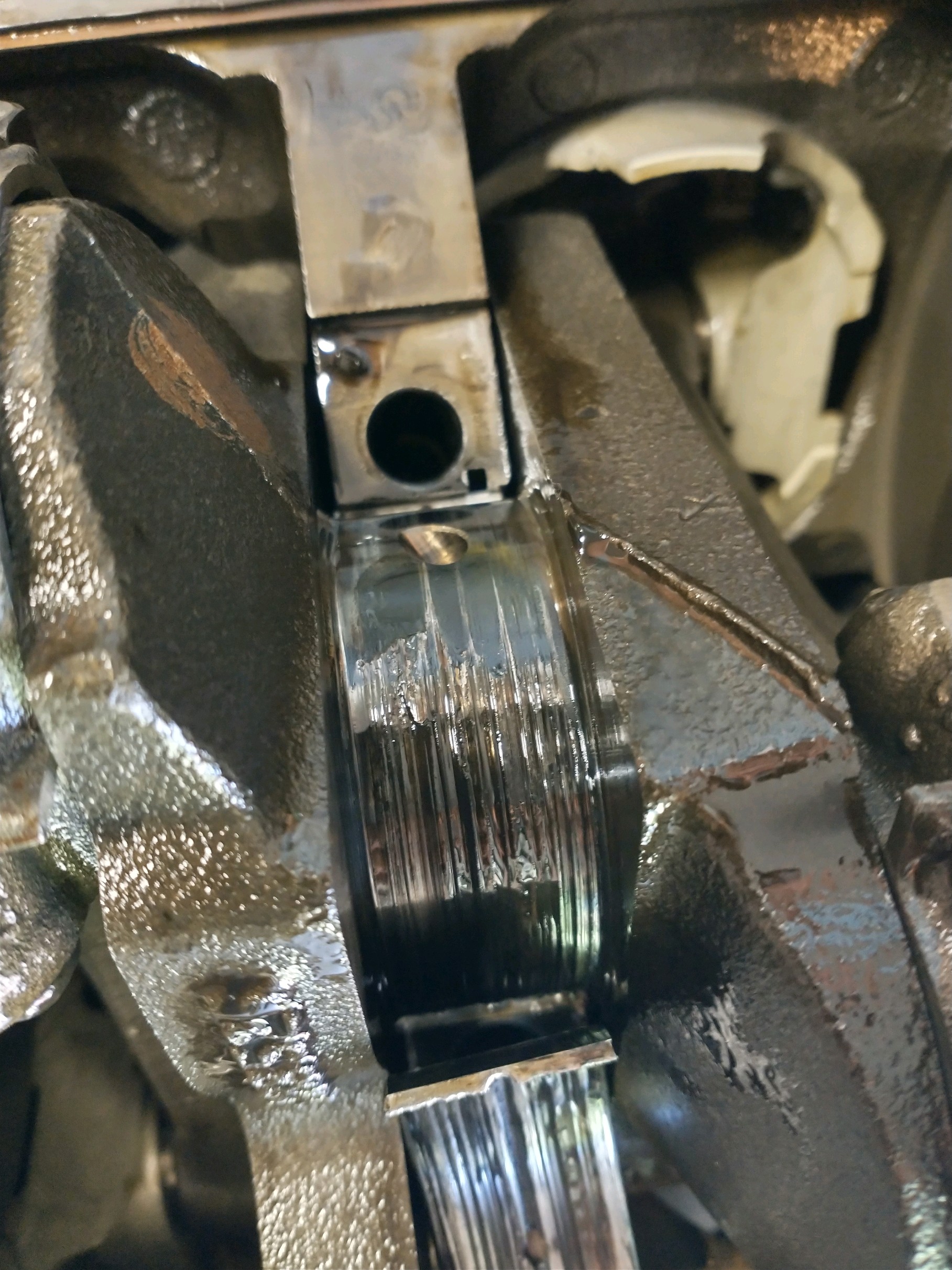

After a few sessions, we got the motor on a stand yesterday. Not a lot of surprises as there were large bits of metal from the main bearings in the pan and in the pickup. The crank is toast for sure. I only pulled one main cap to confirm my suspicions and didn't dig any farther. When I pulled the cap the bearing would spin freely around and around and the crank looks like a topographical map. I'm sure it's not just the one journal either. Not sure about the rod bearings but I suspect they don't look too hot either.
So I'm pretty much getting my head around an LS swap of some sort. Most likely a 5.3. I was leaning towards a 6.0, but those are all in HD trucks and vans, and are too weak for all that work and get beat to shit on a daily basis just hauling themselves around, let alone a big load. A 5.3 is cheaper and usually comes in a 1/2 ton or SUV where it will have had an easier life. AND they're cheaper. They give up around 30hp to the 6.0, but are still about 50hp more than I currently have, so it's an upgrade no matter what.
Side note: While under the car, I figured out why my torque converter wasn't locking. There is a little metal bracket wire loom near the transmission wiring that was not bolted up (my fault I'm sure) and at some point it sliced one of the wires in that harness. I'm sure if I put it back together it will work. Now that I'm changing stuff, I'll probably have to put a manual switch in anyway, but it's nice to know why.
More to come as I start gathering parts.
