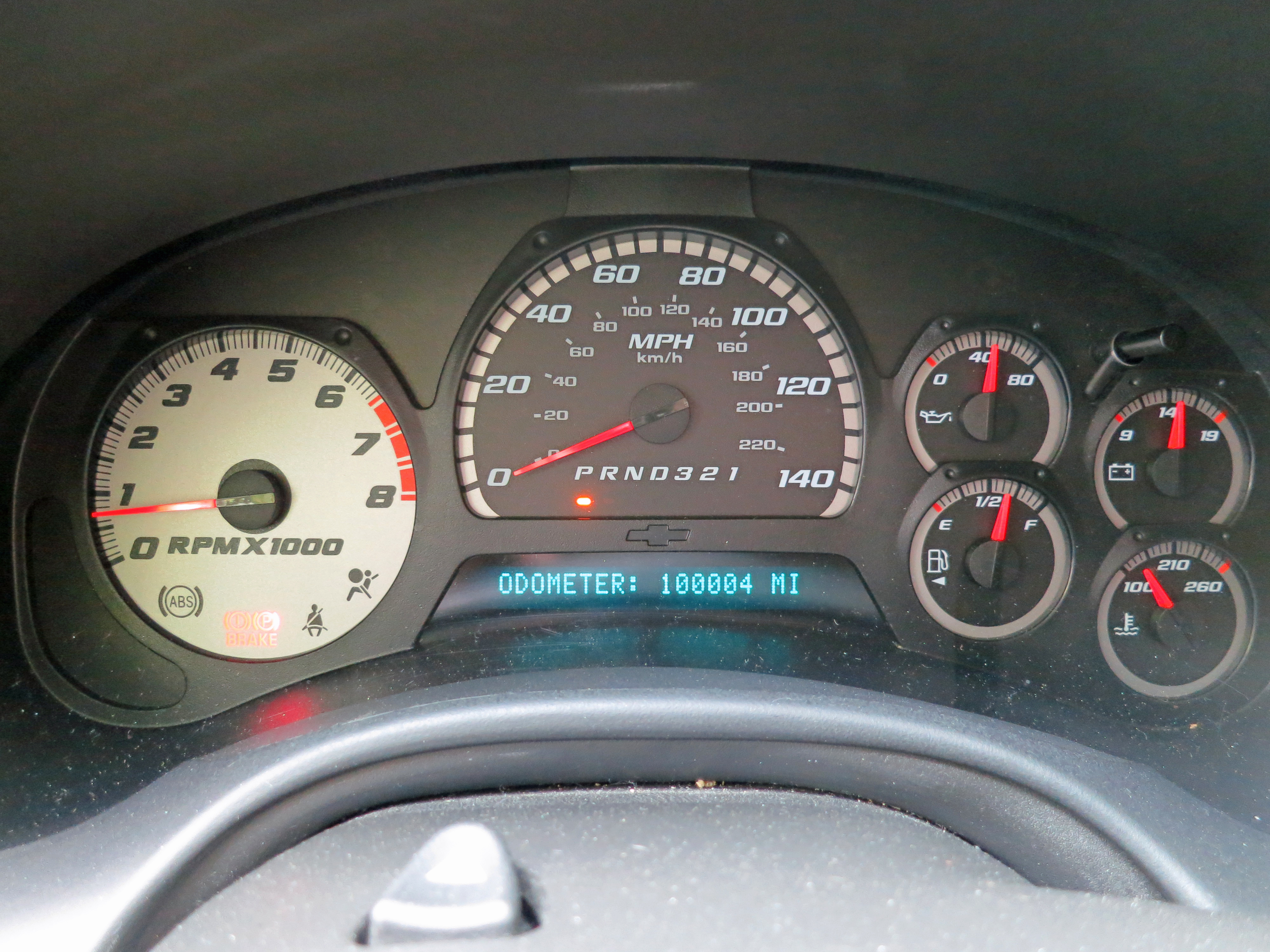

Big event today. I can't remember any of my vehicle crossing the 100K mark, but it happened yesterday.
I drove with it and watched to understand the state of the AFR. It turns out that the current tune has it a bit too lean on wide open throttle and not lean enough on cruise. I'll either have to pay for some dyno time or learn how to adjust it on my own. Right now this is on the back burner for a while. I gave Maverick the AFR display to tune the El Camino carb.
