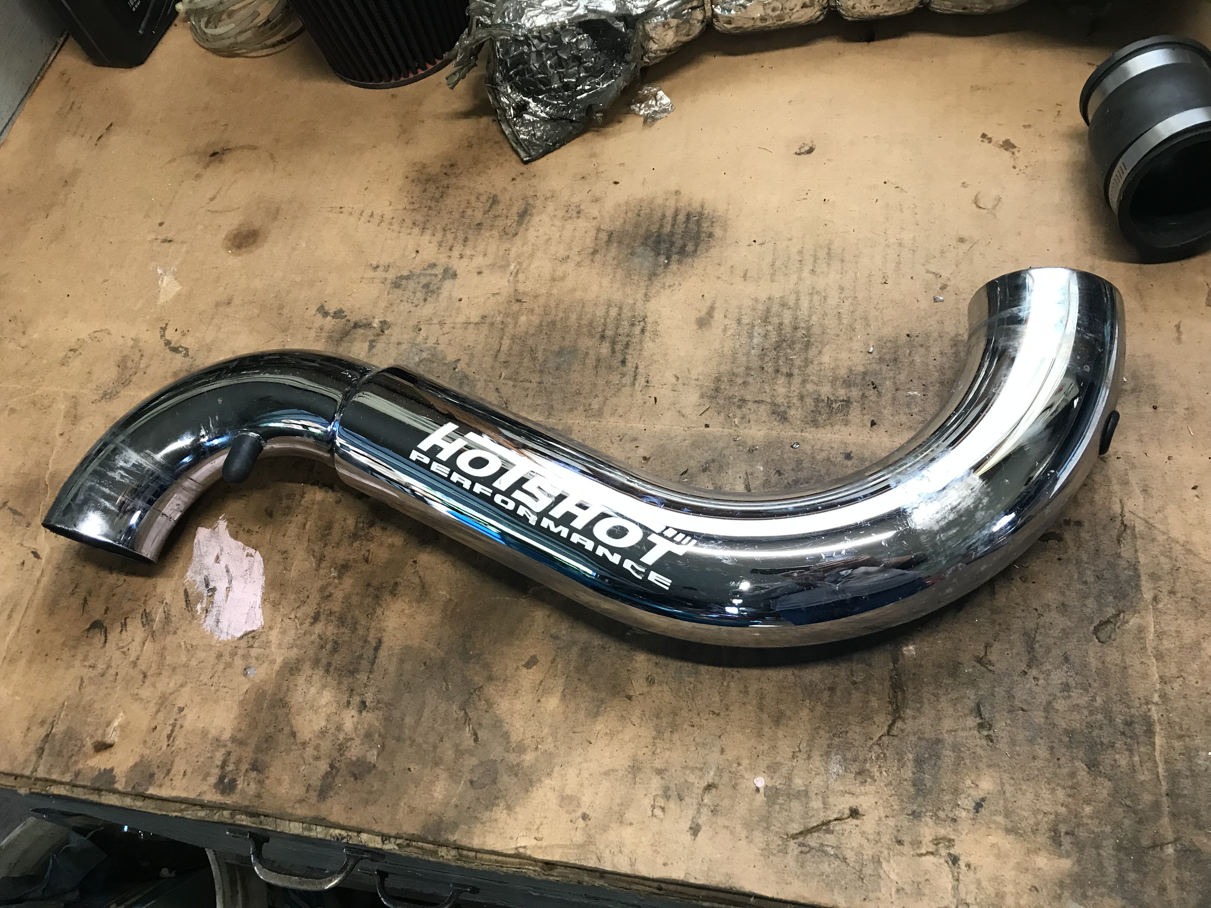

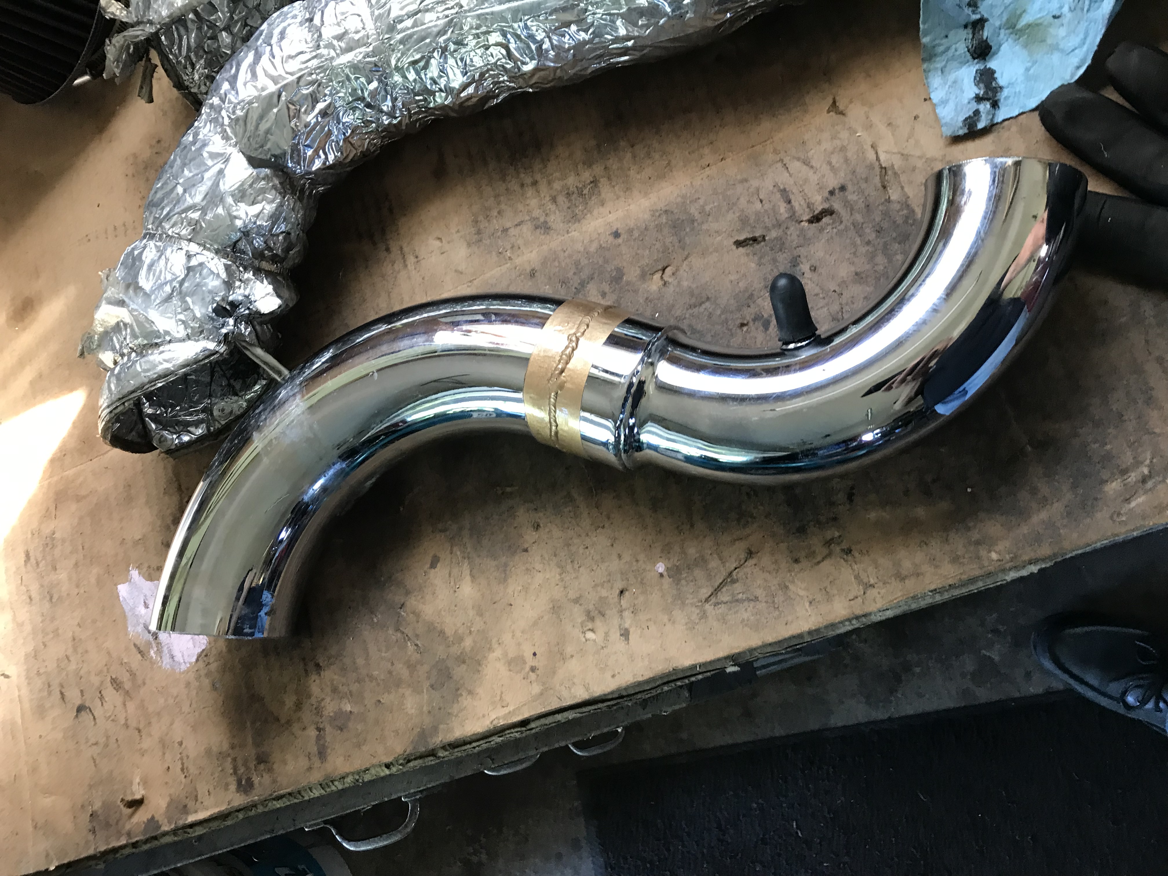

Today I replaced the bracket holding the AFR gauge as the one that came with the gauge was about 1/8” too short. I also got to work shortening the cold air intake. It was designed to fit around the battery which is no longer there and it rubs on the upper radiator hose in two places. Shortening the CAI will fix one and extending the support brace about an inch will fix the other.
Here is a before pic of the cold air intake. Who knew it was chrome plated:

* CAI work is done and it is installed

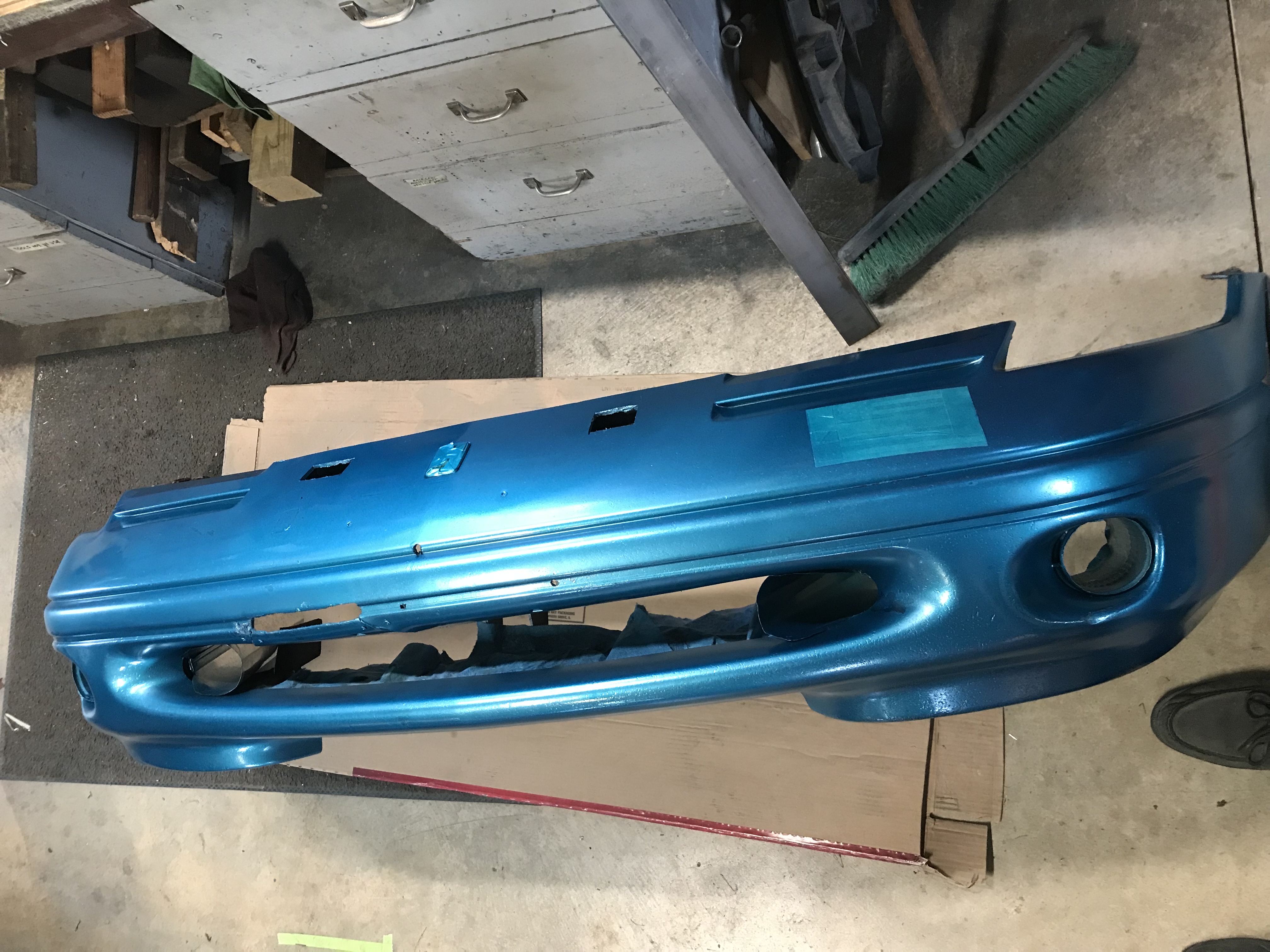

* While the front bumper cover was off I took the opportunity to repaint the front end - lots of chips in the paint and the red base color looks kinda bad showing through.
