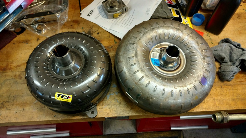

Yesterday I installed the new torque converter. It seemed to measure up and fit as designed without all the ass-ache I had with the C4 in the Mustang. The flexplate I bought off the scratch & dent shelf needed slight modification. The reason it was there is that there were two 1/2" round holes for mounting the torque converter, and one oblong hole that was 1/2" one way and about 3/8" the other way. With some patience and six different size drill bits, I was able to make the hole round again, and still keep the original location in tact.
The new converter is a 10", 3000-3500 stall with lock up, so it should make my launches pretty sweet, and with the smaller diameter, that motor should rev up pretty quick.

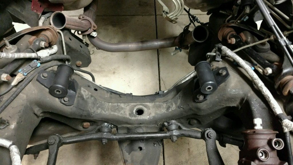

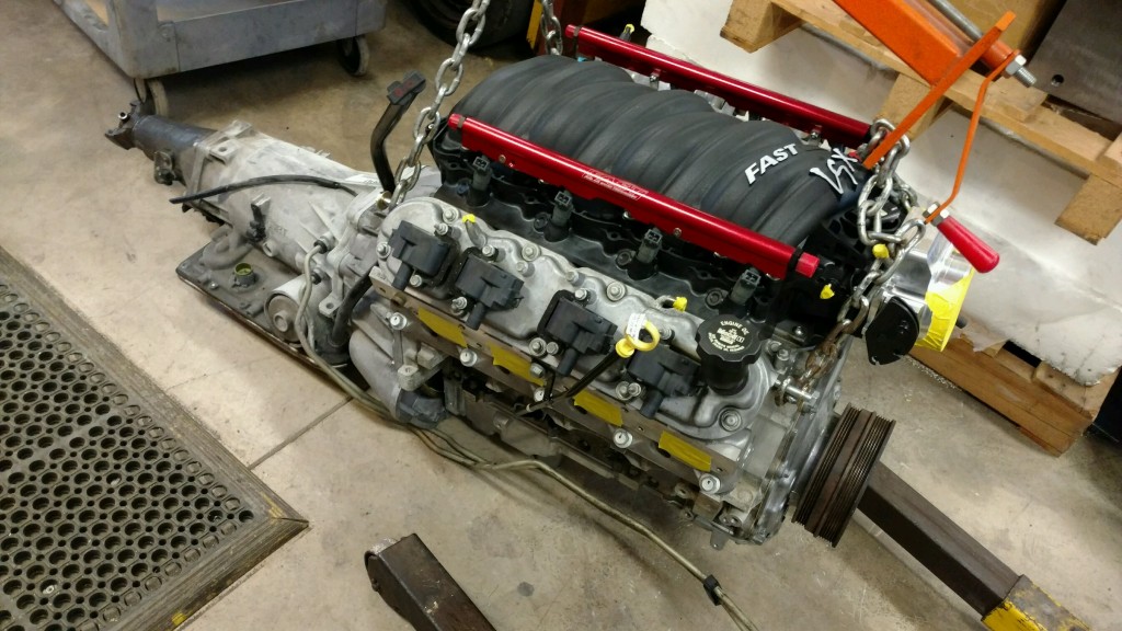

I also got the motor and trans assy back together, installed the new motor mounts both on the motor (left those loose as they are slotted) and in the chassis, and re-gapped the spark plugs to .035 vs .042 factory spec per Trevor's recommendation.
Hopefully next weekend I can drop it in the chassis. I may have to pull the front core support out so the motor will go in more evenly as I think the fuel rails will get in the way if I try to put it in at a crazy angle.
