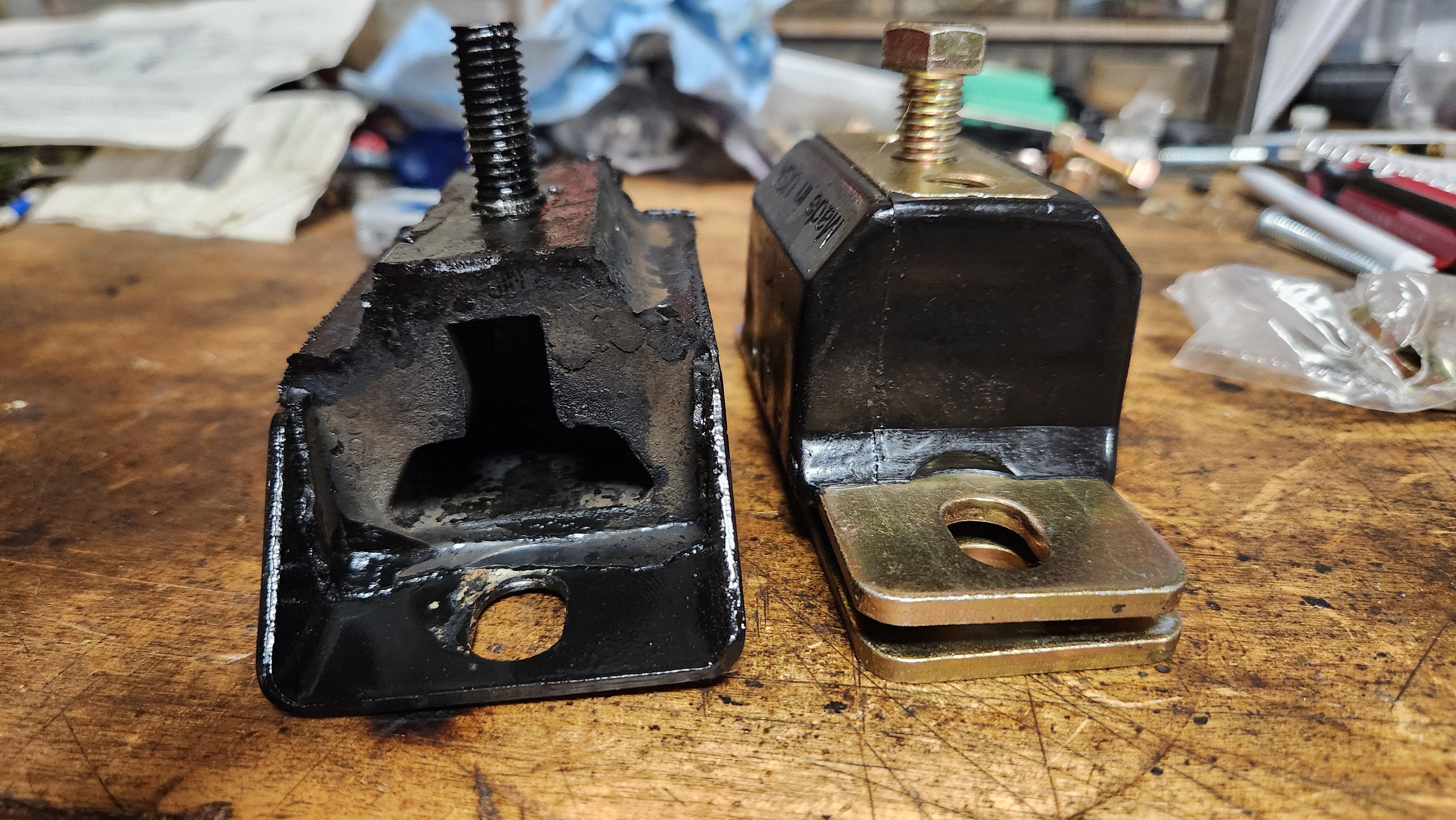

When I was under the car the other day, I looked at the trans mount and didn't like what I saw. The dang thing is basically hollow. There is a thin-something in the very middle, but it seems like it could easily deflect under load and cause the noises I'm hearing on a hard launch.
I picked up a new polyurethane from Autozone. There's a big Made in U.S.A on it, so that's good.
I'll test it sometime tomorrow.
Posts: 2645
Re: 1979 Malibu
Test drive successful! No more noise under hard acceleration!

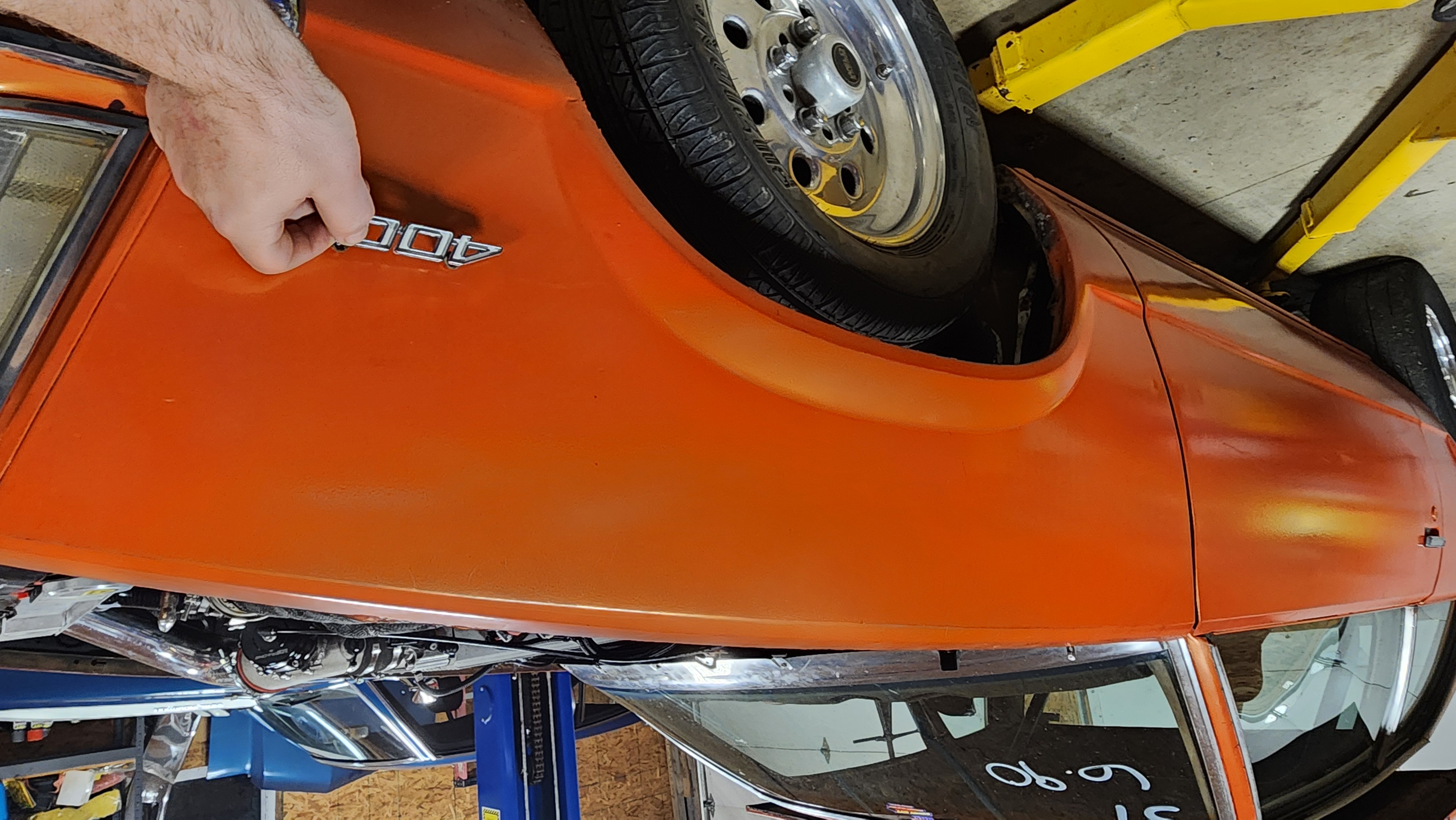

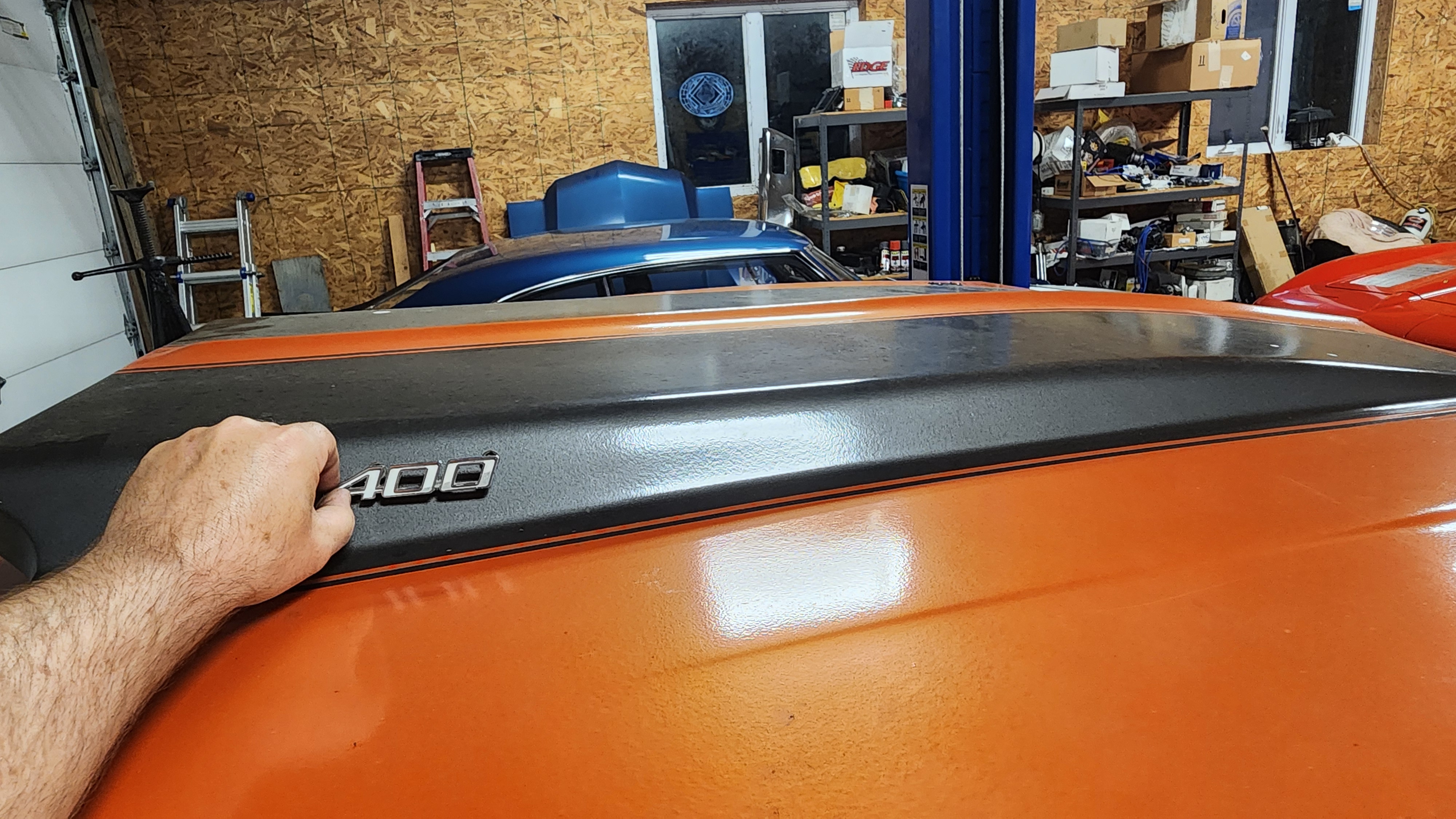

I bought some badges for it. My informal polling so far says to put them on the fenders. What say you?
Posts: 3038
Re: 1979 Malibu
can't go wrong with either of those locations

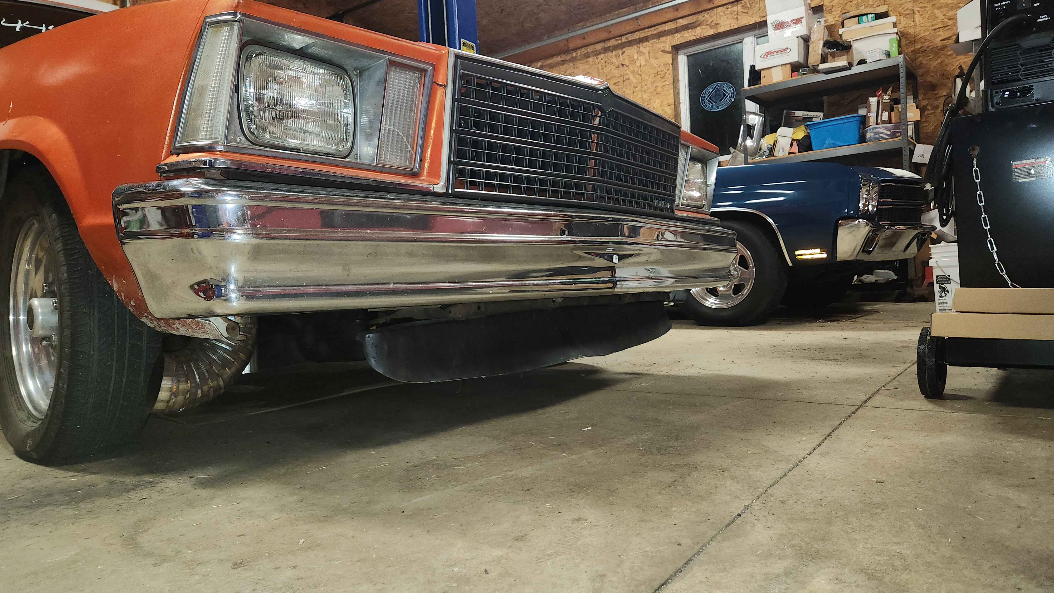

I got the air dam from ebay and installed it tonight, along with adding some Water Wetter to the radiator. I decided to take a drive out to Mike Trimboli's house on Auburn Road, about 6-7 miles. When I got there, we saw an oil leak by the turbo and found one of the mounting bolts loose. Mounting bolts are part of the oil drain, so that made sense. When we put it up on his lift, Mike pointed out I had mounted the air dam too far back. So we fixed that too. All in all, it didn't take much time. When it was done, I took him for a quick blast up Auburn Road towards Rt. 6. I dropped him back off at his house and headed for home.

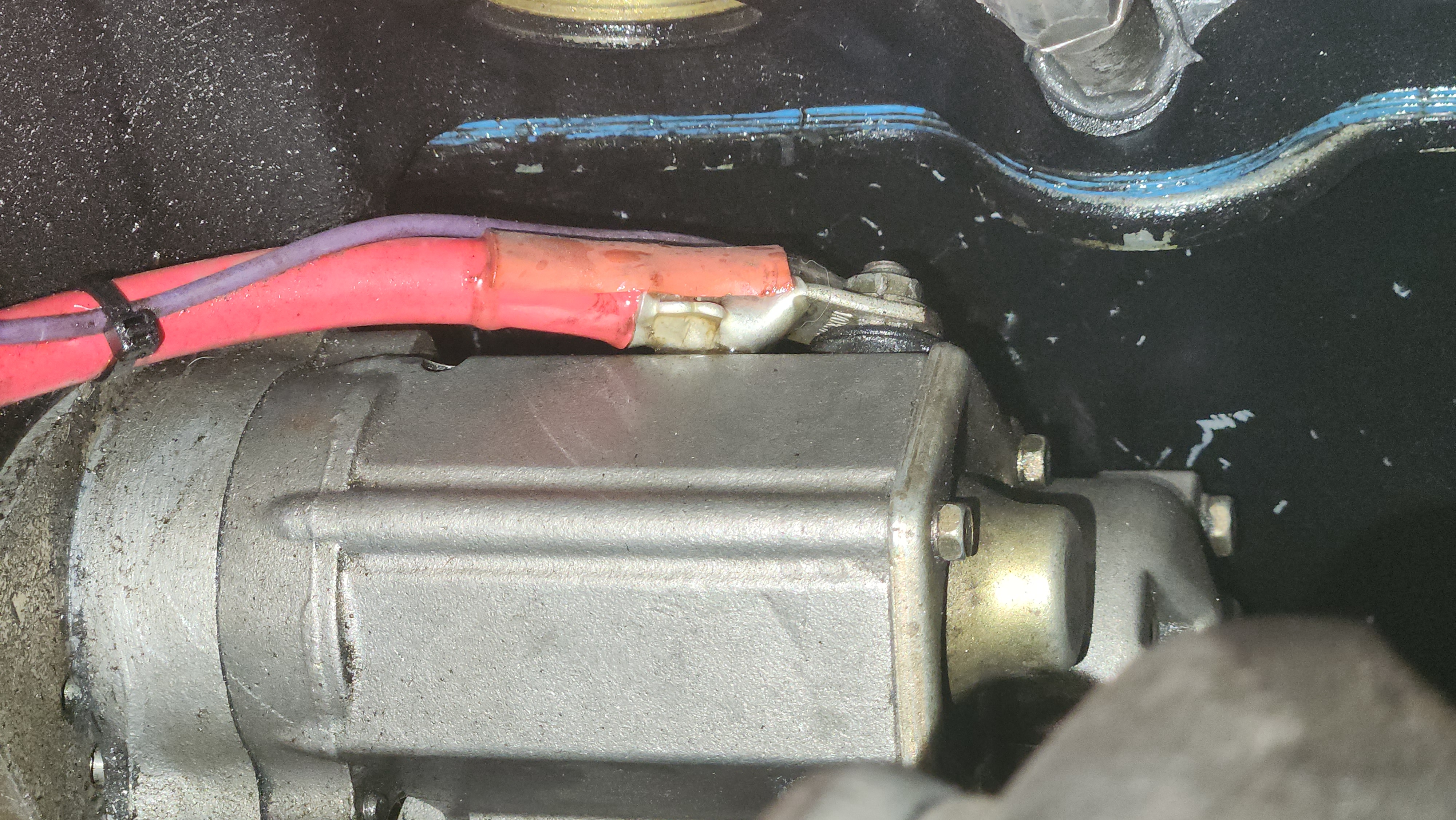

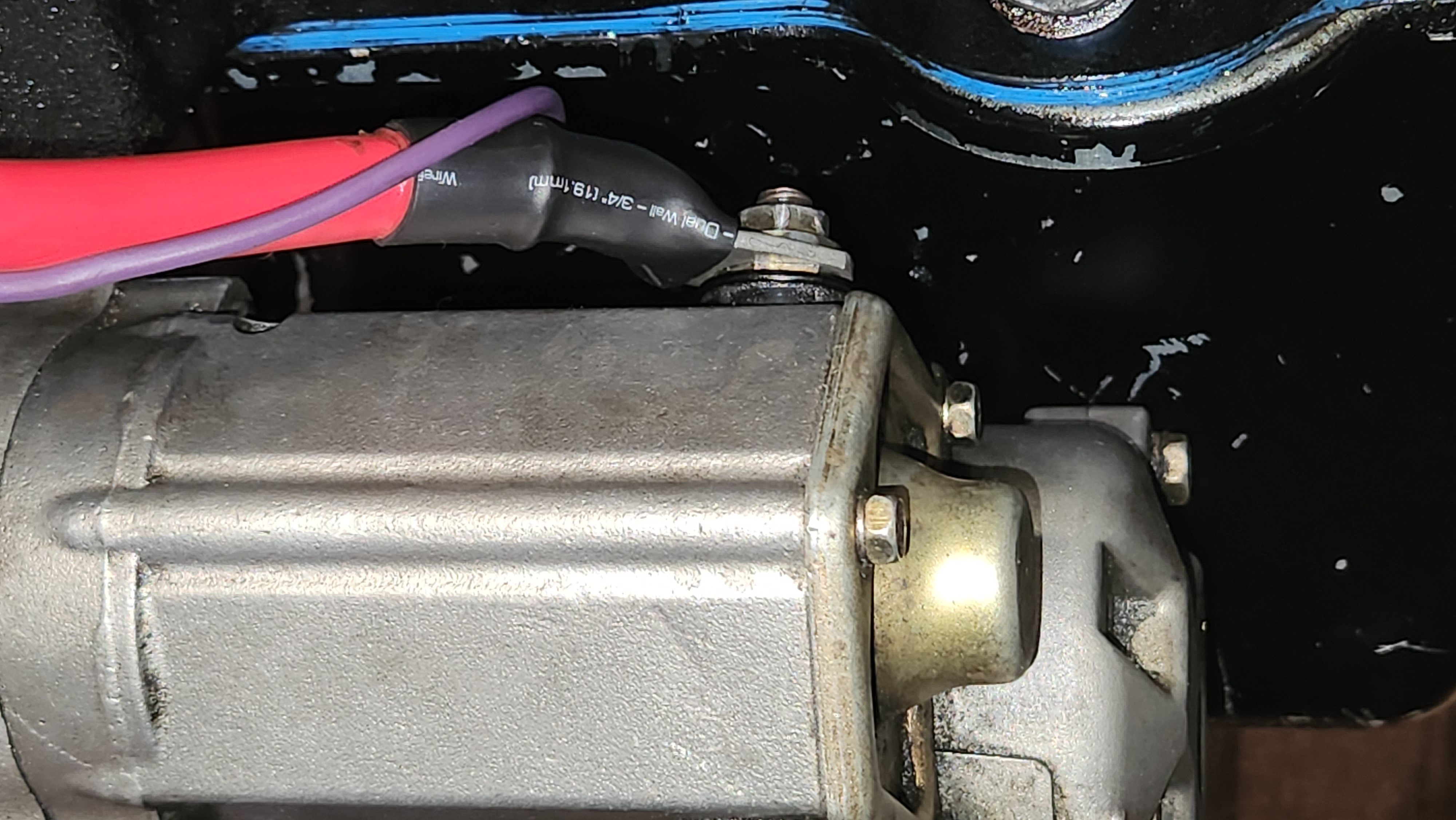

But the real fun started when it completely died on me on Wilson Mills. I was able to coast into Heath Rd, so out of Wilson Mills traffic. It's dark out now. No electrical at all, so I go back to the battery and the terminals are too hot to touch!! I was standing there pondering, then saw some smoke coming off the battery -- turn off the main power switch, idiot!! (battery is right next to my fuel cell too!!) So there's a big short somewhere, I'll hunt that down tomorrow/this weekend.
I called Mason's for a tow. Gwen offered to bring the truck and tow-strap, but i was a little leary about doing that in the dark with no lights at all.
Posts: 3038
Re: 1979 Malibu
gotta figure that one of the main cables rubbed through so hopefully easy to find.
Posts: 2645
Re: 1979 Malibu
Turns out, it was easy to find. Not what I expected, but better. This was an easy fix.
After I hooked everything back up, I turned on main power -- headlights and Megasquirt powered up, just as they were when it quit. Started right up. Whew..
