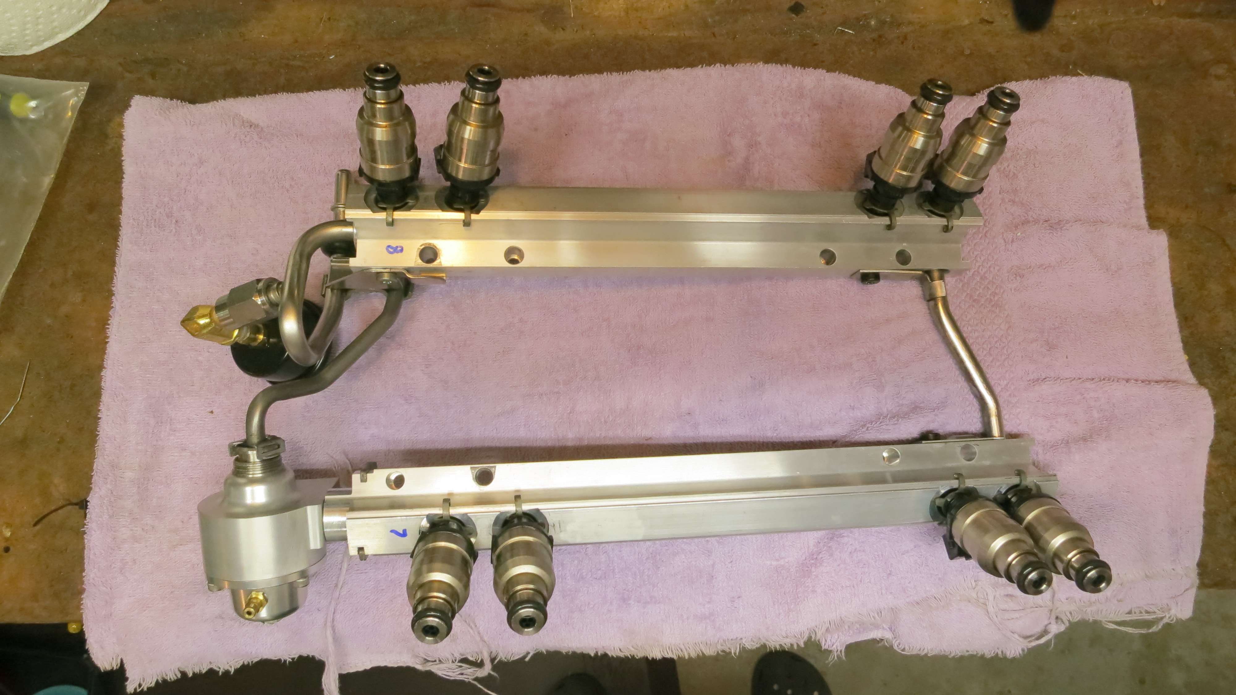

I started working on the fuel system again today. I got the new fuel filter installed and then I cut open the one that was on the car. There was a small amount of debris visible on the input side of the filter, but I could see nothing on the output side. The filter looked like it was doing it's job. I plan to remove the injectors on my next work session and then flush everything from the feed line to the injector ports. Then I'm going to back flush the injectors using this procedure: https://shop.advanceautoparts.com/r/car ... -injectors.

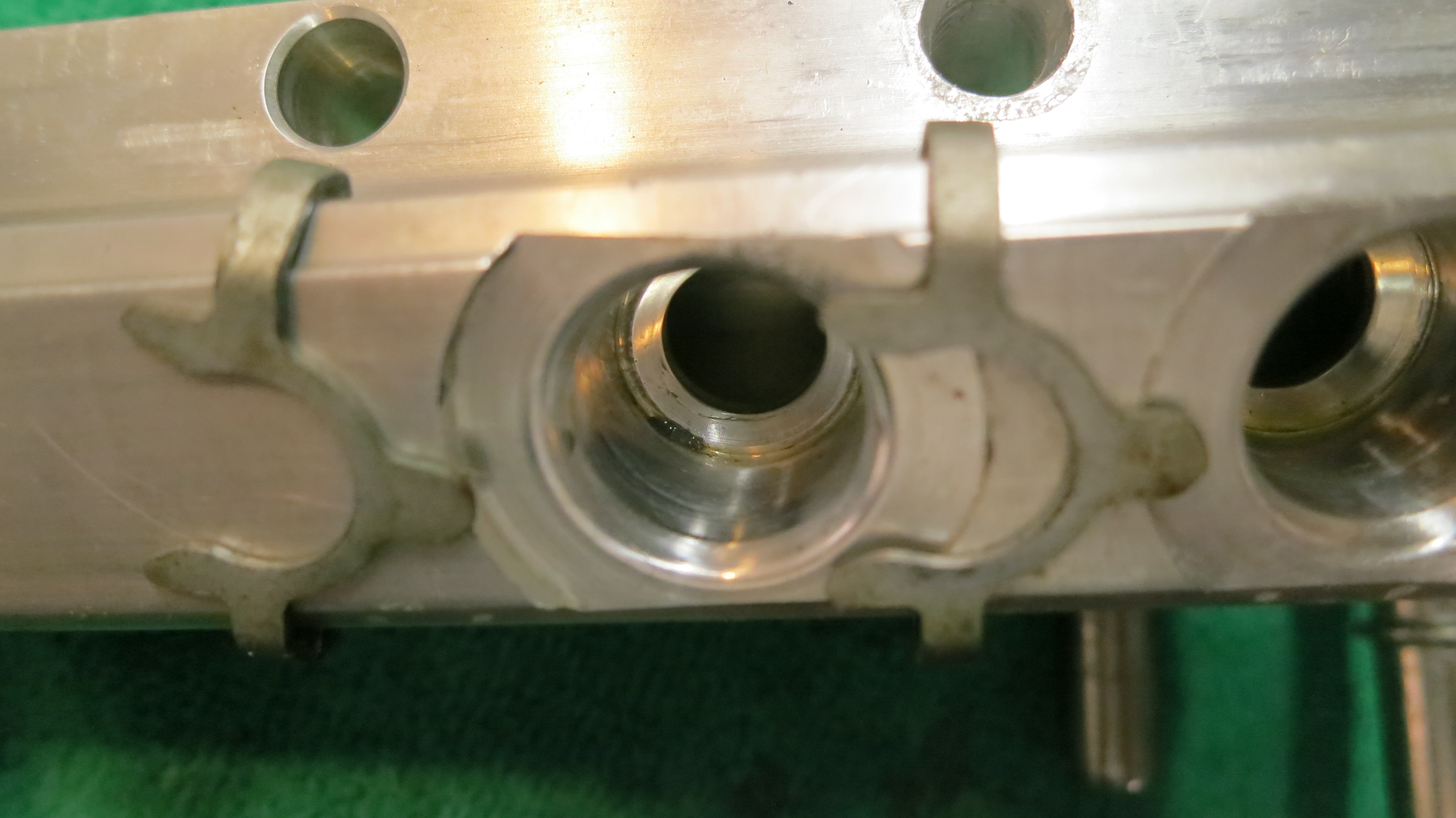

I found the ''smoking gun"
Today, I started back-flushing the injectors to clean out the input screens. I started with #8 and didn't see anything flush out of the screen. Then, on #6, I noticed a few black specs come out. When I looked into the fuel rail port for #6 I saw this: Just as a reminder, #6 was the cylinder that was flooded. I finished all rest of the injectors and saw a couple more that had a few specs of dirt come out of the screens.
It's obvious that Evapo-Rust was not the best choice for the job of cleaning out my fuel rail the first time. I've disassembled it and it is now soaking in Berryman's Chem-Dip. Berryman's did a fabulous job on a mucked up carburetor from a generator I recently worked on, so I'm looking forward to a spanking clean fuel rail. I believe I've found the solid evidence I need to feel confident about putting everything back together and taking a ride.
One last question is still unanswered. How did a piece of debris big enough to hold an injector open get past the input screens?

Smoking Gun...Part II
Yesterday's elation about the "smoking gun" was a bit premature. I found more.
Having cleaned and assembled the fuel rail and injectors, I hooked them to the fuel lines and hit the key to pressurize them to watch for leaks.
I had neglected to hook up the vacuum line to the Holley adjustable fuel pressure regulator and witnessed gasoline pouring out of it! WOW!
This should not happen. I took it apart and found a ruptured diaphragm. I called Holley tech support and they said there were no replacement parts for this regulator. [ I can't help thinking about the failure of the Holley regulator and then I remembered something. While tinkering with the engine some time before all this happened, I noticed one of the screws on the regulator had backed out. There are multiple screws holding the cover on and I tightened them all. This cover traps the edges of the diaphragm and creates the seal. When I removed the cover and had a look, it was torn along the edge. It's likely that these loose screws were the beginning of this whole flooding problem. I guess in hindsight, I should have taken the time to put thread locker on the screws, but I didn't. ] And since I had cheaped out and bought this on eBay, tough luck.
So, I installed a new OEM regulator I had and tested again. No gas pouring out, but the #6 injector was leaking a lot more than it should. I need to decide what to do about that.

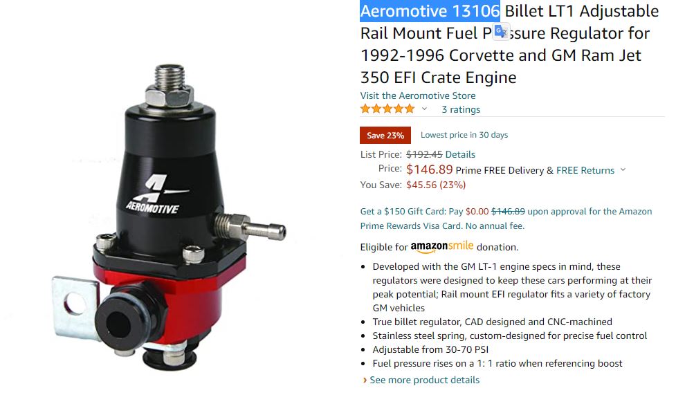

Obviously, I can't stop thinking about this thing. I did some searching today and found what I was looking for, a fuel rail fit, adjustable fuel pressure regulator to replace the faulty Holley that caused this last, sad episode. I found a great price on Amazon to boot.
BTW: I was able to return the Holley regulator to the seller on eBay even though the ad stated "no returns"
