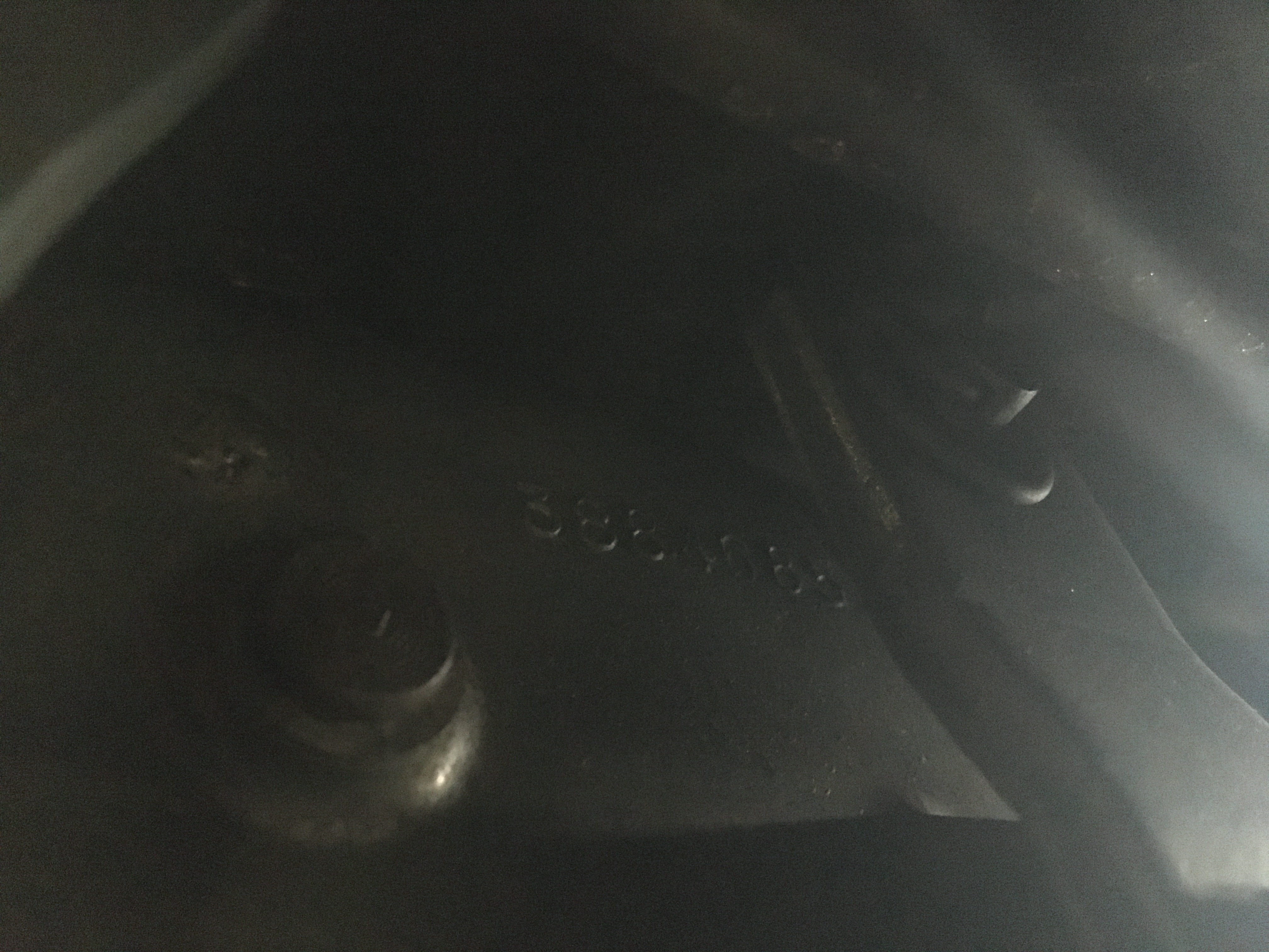

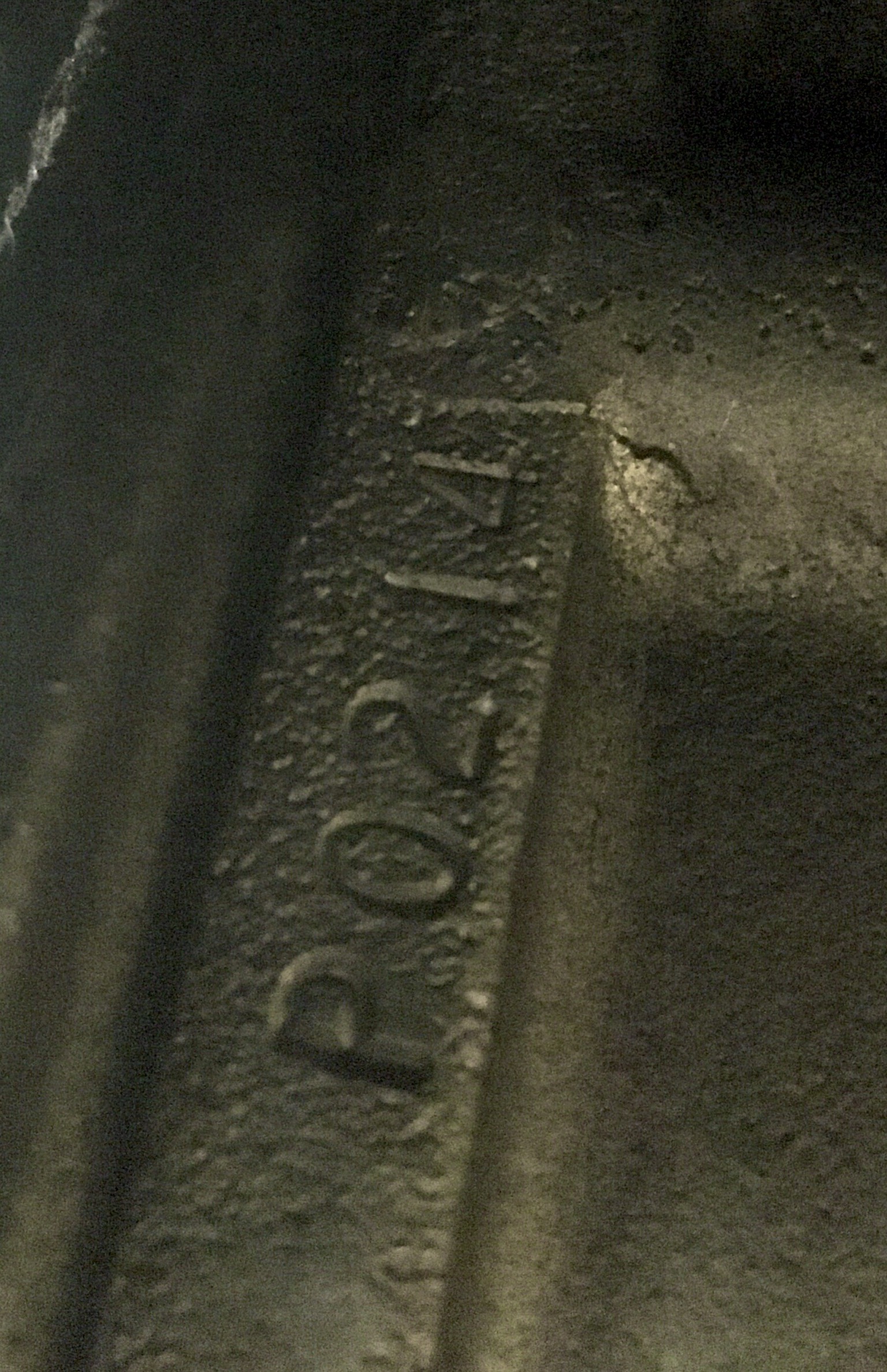

I've gone to the car and researched the Muncie 4 speed that's in the car. From an earlier experiment, (see Nov. 23, 2019 post)
we know this to be a "wide ratio" Muncie. It's an M-20. The main case #3885010 and side cover #3884685
both indicate that the trans is a 1966 Muncie. The date code on the Muncie is PO214, indicating February
14th. February 14th matches the car's 2nd week of February, so that's pretty good evidence that the trans matches the car, but
it is conceivable that somebody put a correct date coded replacement trans in the car. The bellhousing # 9778882 indicates BOP bellhousing. Here's the site I got my numbers from: http://members.tripod.com/camaro_obsession/muncie.htm

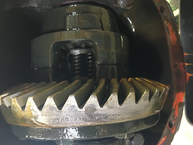

According to this website, vehicles with a 3.90 should have a close ratio trans in the car. Using this logic, either the
trans is wrong to the car, or somebody put in a different rear axle. The speedometer gears are set up for the 3.90,
so perhaps somebody with mechanical understanding did some switching around at sometime. Without a build sheet,
we will never know. The site also indicates that there is a way to match your vin code to the trans, but where they
show the numbers to be on my trans, I can't find the numbers. There may be more to this, but for now, I've got
some solid info that I wanted to document.

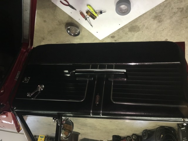

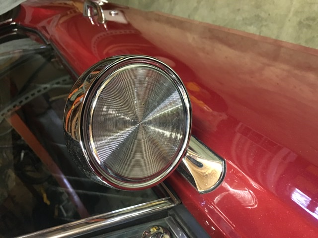

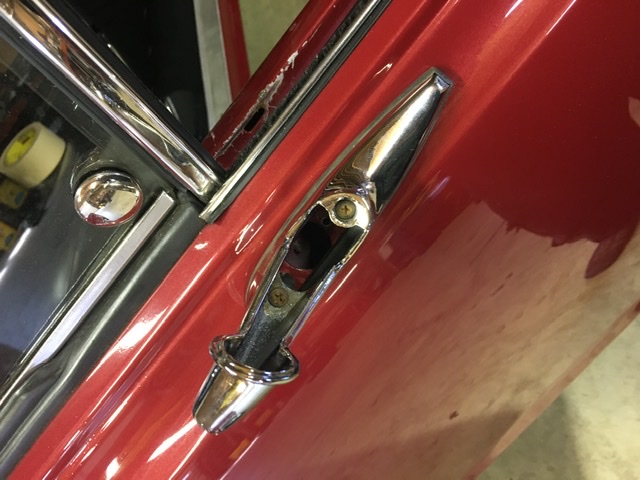

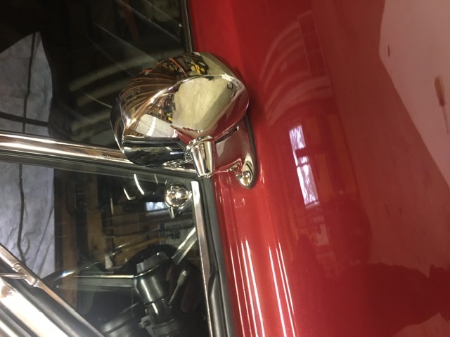

After finding out that the car had a remote mirror as a factory option, I started looking for one. Turns out
the remote mirror for a 66 Cutlass was a one year production run. My luck. If my car was a GTO, I would've
had my choice of 4 on Ebay for $75.00. Not the case. I found one on an Olds forum. The guy who sold it to
me happened to be the guy who sold me my distributor last year. I can't say that it's the best bargain I've
ever found, but it was a 100% complete kit and the mirror was a fresh re-chrome, so it's perfect. It was kind
of cool to "unearth" evidence of the car having the remote option, like the factory hole in the vinyl door skin
and the hole in the door to accept the cable where the mirror mounts. While I had the door skins off, I replaced
the worn out carpet on the bottom of the inside of the door. This part of the project was pretty time consuming,
about two hours per door. I also had about two hours in getting the mirror mounted as I ran into some issues
with one of the holes in the door being stripped out. I also moved the retractable seat belts back to their
correct spots. The previous owner had the right belt on the left and vice versa. I didn't realize it until I was
kneeling down staring at them. It was a full weekend's worth of work, but very rewarding! There's no snow
predicted for the next week, so I'm going to try to drive it this weekend!

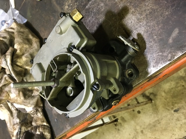

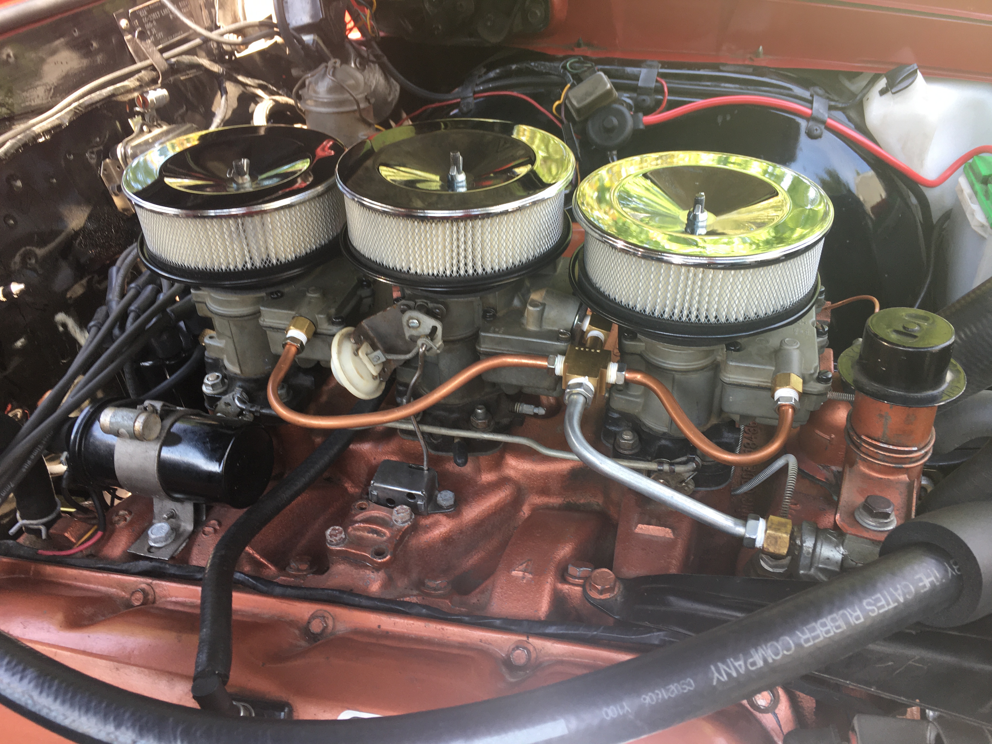

57342 …. I rebuilt the front and rear carbs today. I'm not certain why, but the screws tend
to loosen up on the carbs. The damp fuel collects dirt and the carbs look horrible. I opted to
put new gaskets in the front and rear carbs today. I've rebuilt the middle carb already. The
project wasn't too terrible, but it did take me two tries. The needle and seat assemblies that
came with the new kits didn't work so well. When I started the motor, the fuel bowls filled
up very quickly and fuel came bilging out. I went back to the needle and seat assemblies that
were in the carbs and the issue went away. I did test drive the car and it seems to have a bit
of a stumble when RPM's aren't up. I'm going to make sure that the issue isn't the center carb
acting up the next time I get to work on it. For now, the carbs are dry and looking pretty. I also
put a fuel filter in the glass bowl / water separator where there wasn't one before.

Rebuild Front & Rear Carbs -- Final Repair
Today it was nice enough outside to try to diagnose the stumble when the front and rear carbs
kicked in. A bit of research on the internet had me thinking that the best thing to do was to make
sure that the middle carb was tuned properly. I disconnected the linkage to the front carb (which
activates the rear carb) and took it for a spin. Zero bog with the center carb as the only carb. Super
clean, crisp response, good at cruising speed. Back to the garage. The guys on the net were all saying
to check the accelerator pump. Both the front and the rear got new ones. I tried to test the accelerator
pump on the front carb by moving the linkage by hand. No fuel. I took the carb off, took it to the bench
and worked the linkage several times with no fuel. I tapped the side of the carb with a screw driver
handle and tried one more time and fuel came out nicely. After repeating this action several more
times, I knew I had it right and bolted the carb on. I took the rear carb off and the same issue was
there. This time I wasn't so lucky. I had to take the top of the carb off and free up the accelerator
pump. After re-assembly, the carb was shooting fuel properly. I reconnected all the fuel lines and
linkage and took it for a spin. Bingo! Super clean all the way through the gears. There's a tiny bog
if you slam the gas to the floor, but multiple sites on the net indicated that you have to go a bit
slower with the tri carb set up to allow them to work correctly. It's literally a 95% slam to WOT to
achieve no bog. I can say that the rebuild seems to have helped performance. I'm thinking that the
skirts on the new accelerator pumps swelled up and got stuck in their bore. Before my next ride,
I'll double check that they are working correctly before I assume they're 100% correct. I'm now thinking
that, after I get the exhaust work done, I can bump up the rev limiter a hundred RPM's or so, It's pulling
very strong to 5000 and I think I might be short shifting. More to come.

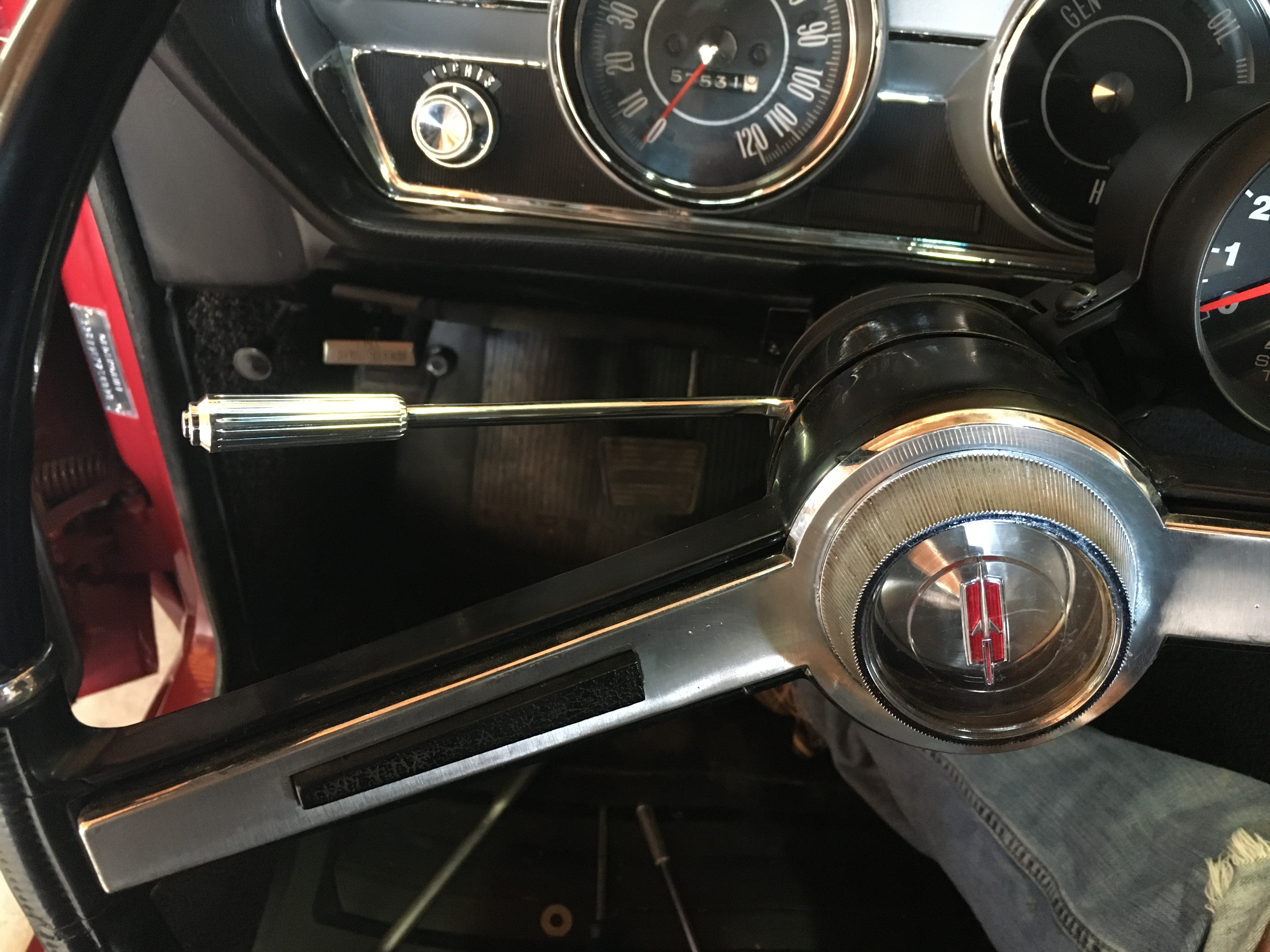

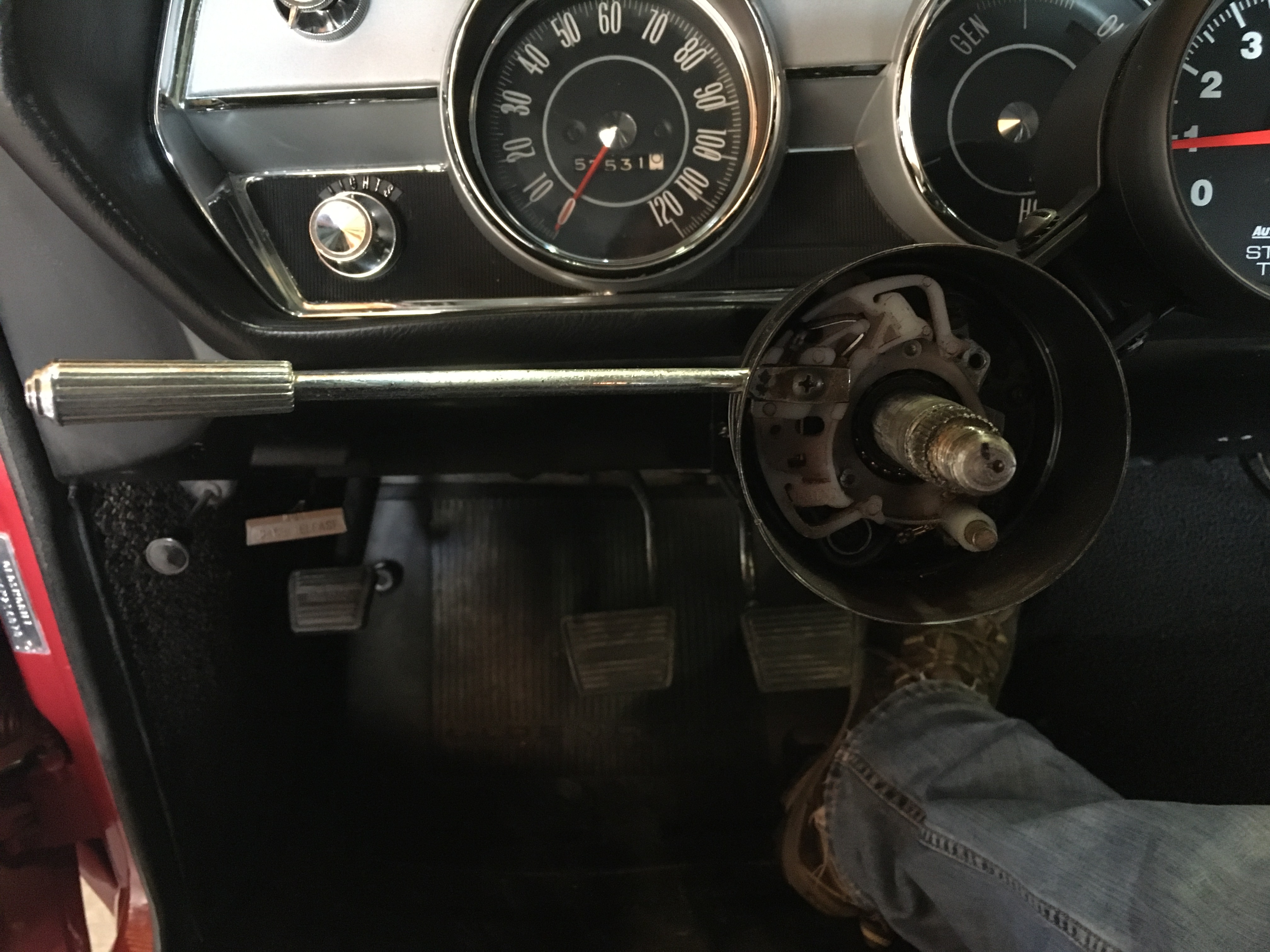

New Directional Lever
442 was obviously an original lever. It was pitted and rough to the touch, and the chrome
was shot. I found out that you can get a repop version that looks 100% correct. I got the
lever as a birthday gift from Fred32V & Mom. The job took about 25 minutes, and most of the
time was spent figuring out where my steering wheel puller was and where the long bolts I needed
were. I was a little concerned initially that the new lever's angle was going to be wrong, but I think
the on that was on the car was bent toward the dash some, as this one seems to be in the perfect
position in relation to the steering wheel. I'm glad I did the job, as the screw holding the old lever
in place was loose, and putting the new lever in allowed me to tighten that up and there's nearly
no slop in the lever anymore. After the install, I had to take the car for a one hour test drive to
make sure my work was satisfactory. All was well when the car was parked.

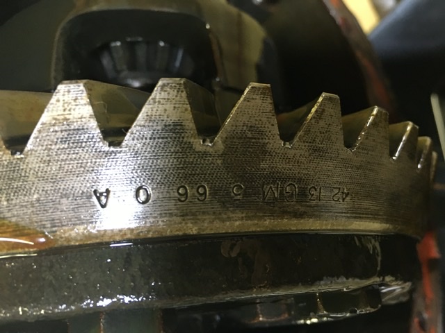

3.23 Axle Install
A few weeks ago, I happened to be looking at Craigslist and stumbled across a pretty rare
piece. What I found was a factory 3.23 rear end complete with axles out of a 1966. When I
was redoing my rear end, I was looking for this exact piece. When I first saw the ad, the guy
had it listed, with 6 or 7 pictures of it, but none of the code on the axle housing. I replied to
his ad and he said he was unable to find the code, but after telling him where the code was,
he went back out to his garage and found it. If the rear end is out of a '66, and is a positraction
carrier, the code should be "SF", which this one is. I went to look at it and got the back story on
it. He had the rear end for 10 years and the original plan was to put it in his '66 El Camino. The
rear end was too wide, so he scrapped the idea and changed the ratio in his current rear end.
He told me that the guy he bought it from had just rebuilt it. I didn't open the rear end at his place
and took his word for it. Last week, I did the prep work on it. I put new gear lube & positraction
additive in it, although the stuff that came out appeared to have never been run as it was clean.
The axle bearings and seals both appear to be new as well. Yesterday, I did the install, mostly by
myself, but on the back end of the job Fred32V and BP came over to finish off the work. I took the
car for a spin yesterday and this morning and it seems perfect. No chatter on corners and super
smooth without vibration up to 80 MPH. I really like the difference in rpm's at cruising, I can get
up to 70 still under 3,000. The next step for the 3.36 rear end (assuming it's not too costly) is to
have the factory 3.90 installed on the posi carrier that's in there. This way I will have two rear
ends. If I end up not using the 3.90 rear that much, it should be a pretty easy sell and I should be
reclaim the majority of my money that I put into it.

It's been a while since I posted last, but progress has been made in the last three weeks. I found out the problem
that caused the fuel issue and eventually the fire. The brass float sunk in the carb closest to the fan. I was relieved to
have found the smoking gun, but this led to a ton of work. To make the long story short, I've taken all of the carbs
apart and made sure they all have neoprene floats in them and I re-set the float heights on them. The middle carb is
set to 21/32nds and the end carbs at 23/32nds. Float drop is set to 1 24/32nds. Per this Pontiac Tri Carb YouTube video:
https://video.search.yahoo.com/search/v ... tion=click
During the process of re-assembly, I ended up with a fuel leak at the brass junction block where all of the fuel lines
connect. I've been thinking about putting new copper lines and fittings on the car because the old lines are all kinked
like someone "adjusted" them with the box end of a wrench. The copper lines were all replaced along with the brass fittings
that connect them to the carburetors. While I was there, I replaced the old home-made carb studs with correct ones and of
course topped off the carbs with new paper filters and air cleaners. I wire wheeled and clear painted the steel linkage for the
center carb and the choke pull off as well. The vacuum line to the distributor now is very neatly run from the back carb ( pulled
the plug off of the base and inserted a brass 90* elbow and shortened the vacuum hose ) instead of sharing vacuum with the
choke pull off on the center carb. As part of the bench clean up, I was able to make a complete set of bases and foam filters
from parts I had leftover from previous work, ( I'm only going to run foam filters for a show or maybe the drag strip because
they burn so easily. ) and I've put that package into storage. I've driven the car a couple of times locally basically testing it
and driving very lightly. After sitting for a couple of weeks, I want to make sure that I can continue enjoying it for the rest of
the summer.
