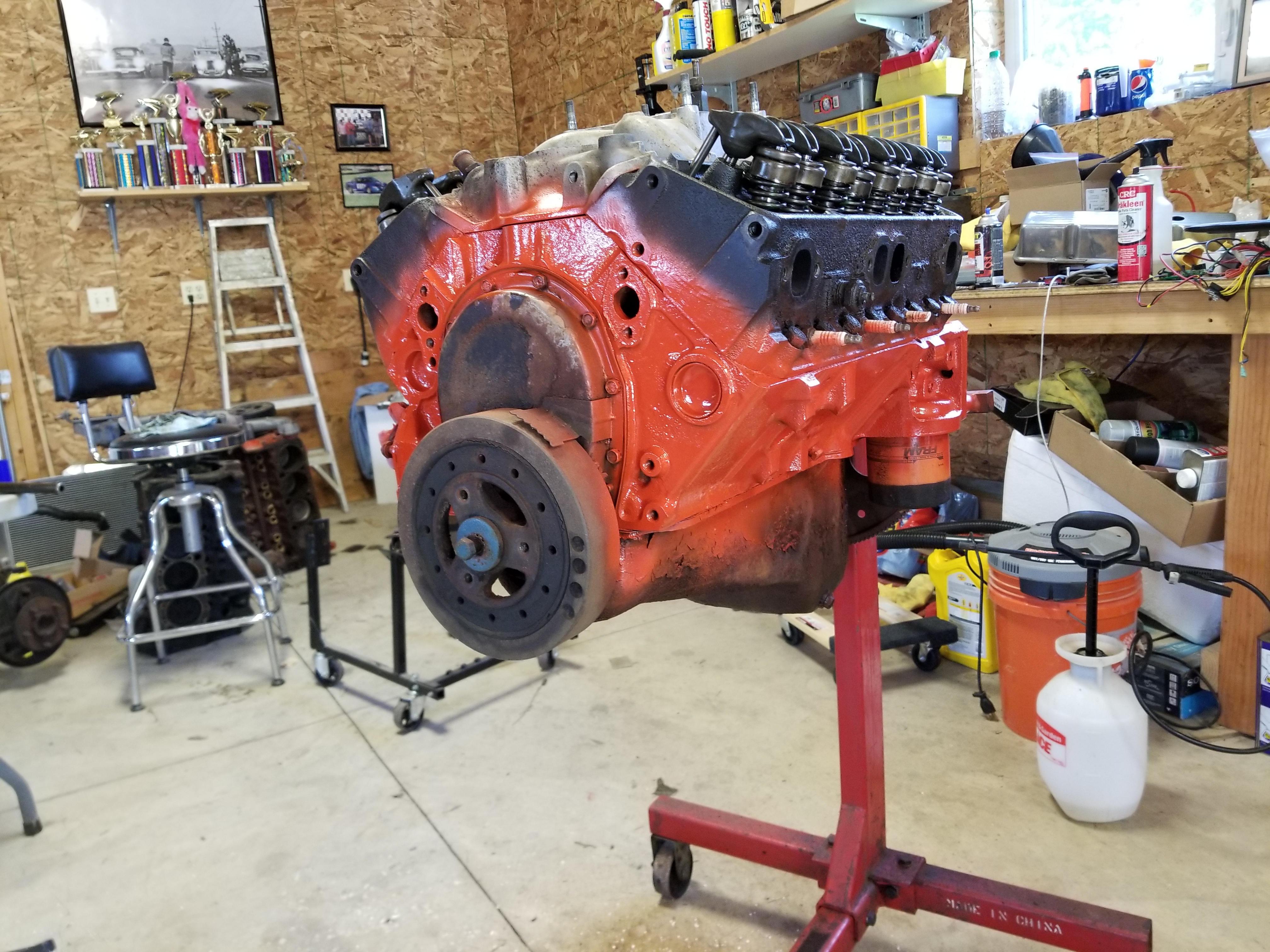

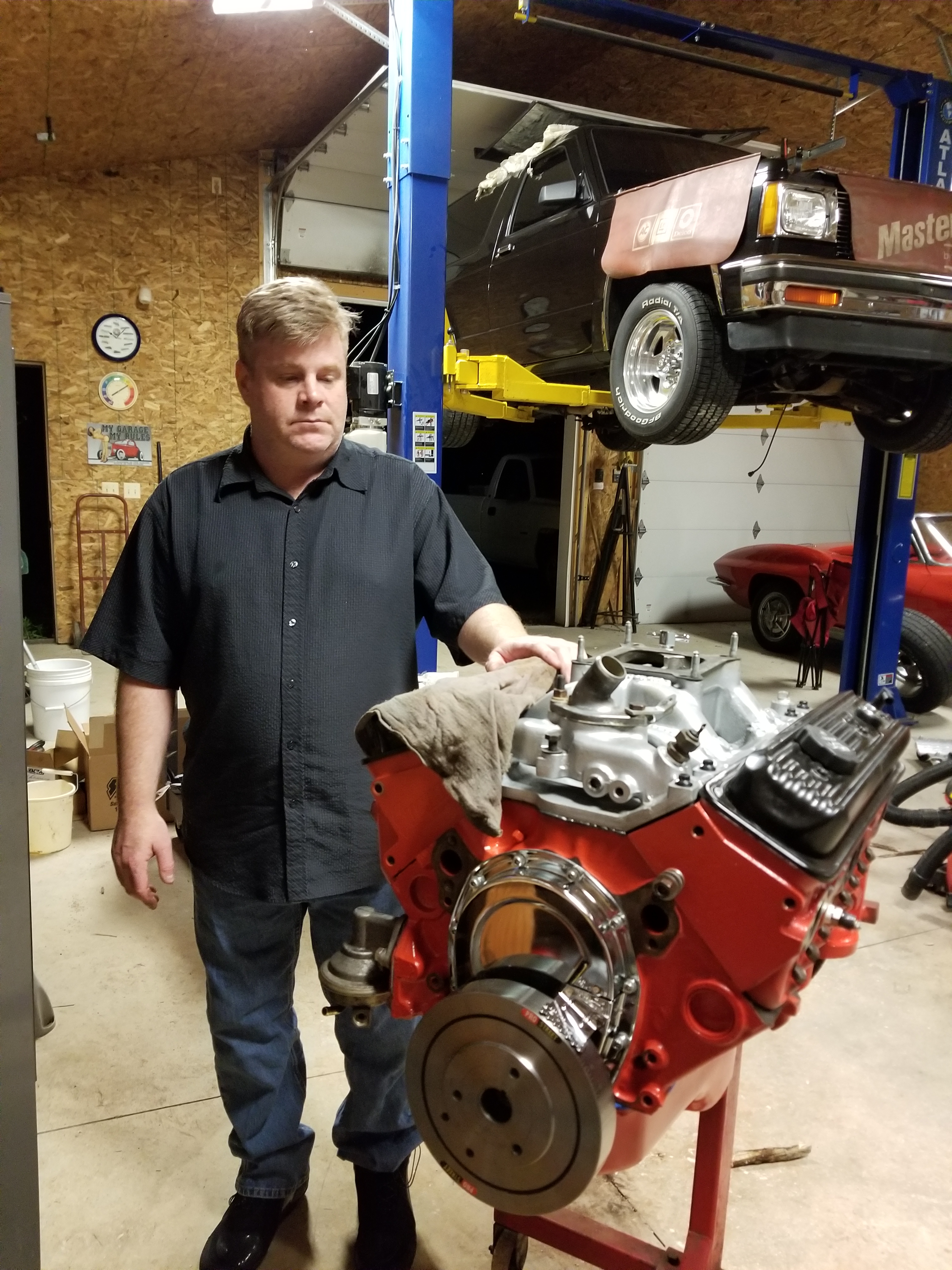

I haven't been posting, but I've been slowly working on this thing. I ended up going with option 2, to pull my uncle's old 350 out of the corner and add my Lunati cam and Summit heads to it. 3 days after my prior post, on July 15th, Uncle Bill passed away after 76 years. He'd be pleased that I was putting his old engine to use.

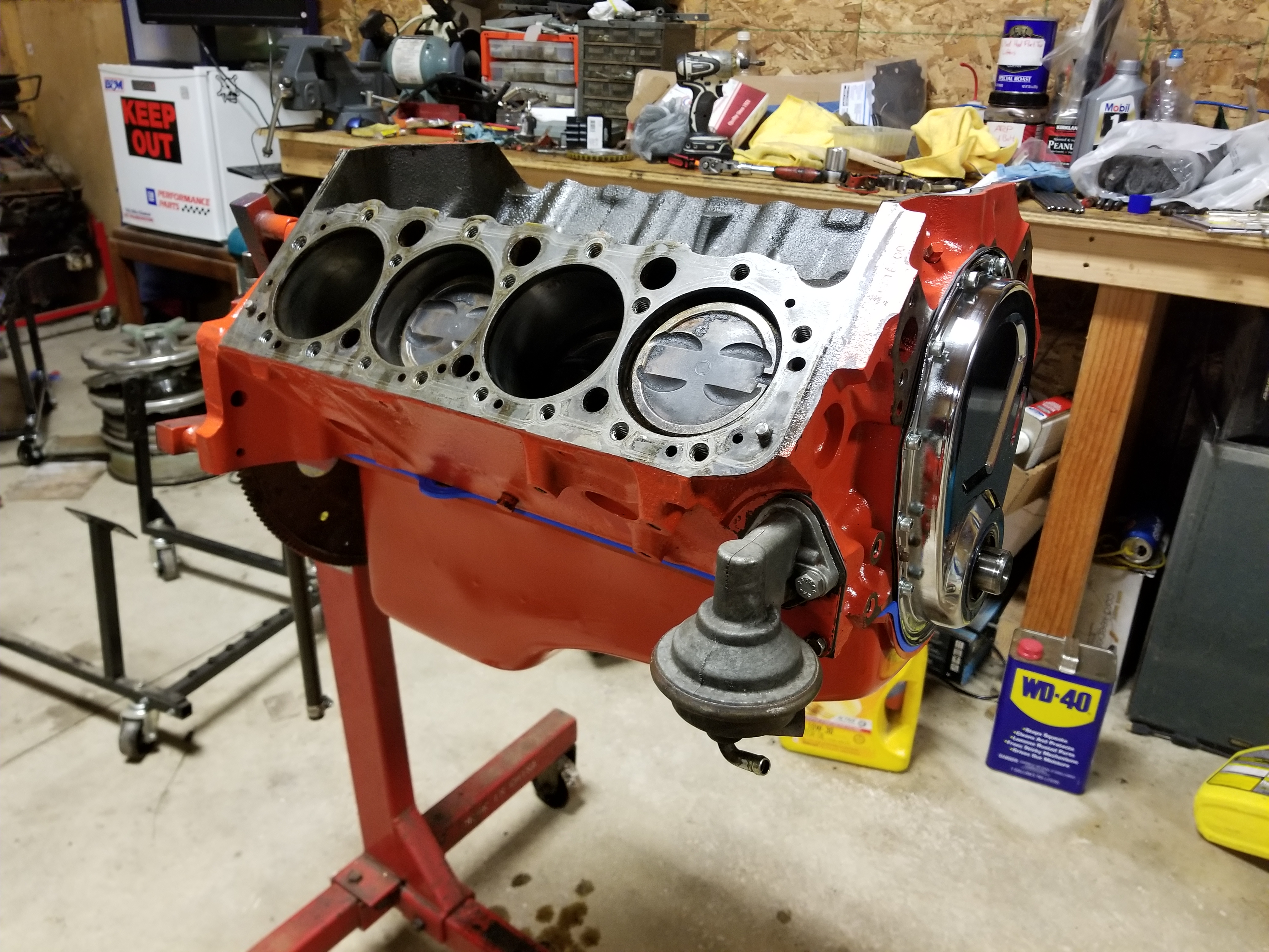

After some degreasing of the block, I sprayed on some traditional Chevy orange paint. The existing heads, timing cover, and balancer were left on to provide some masking.
The story was that he bought this Goodwrench crate motor in the 80s to replace the original engine in his '78 Chevy K10. The truck ended up getting scrapped 20k miles later, but that the engine was pulled before sending it off. It sat in my grandmother's garage in Lyndhurst for 20+ years, and was later moved out to my house. I don't even remember when my cousin and I brought it out here, maybe in 2010? Definitely before Tiresmoke Central was built (2013). I was always a little dubious about the 20k claim, figuring that after such a long time, memories were a little fuzzy.

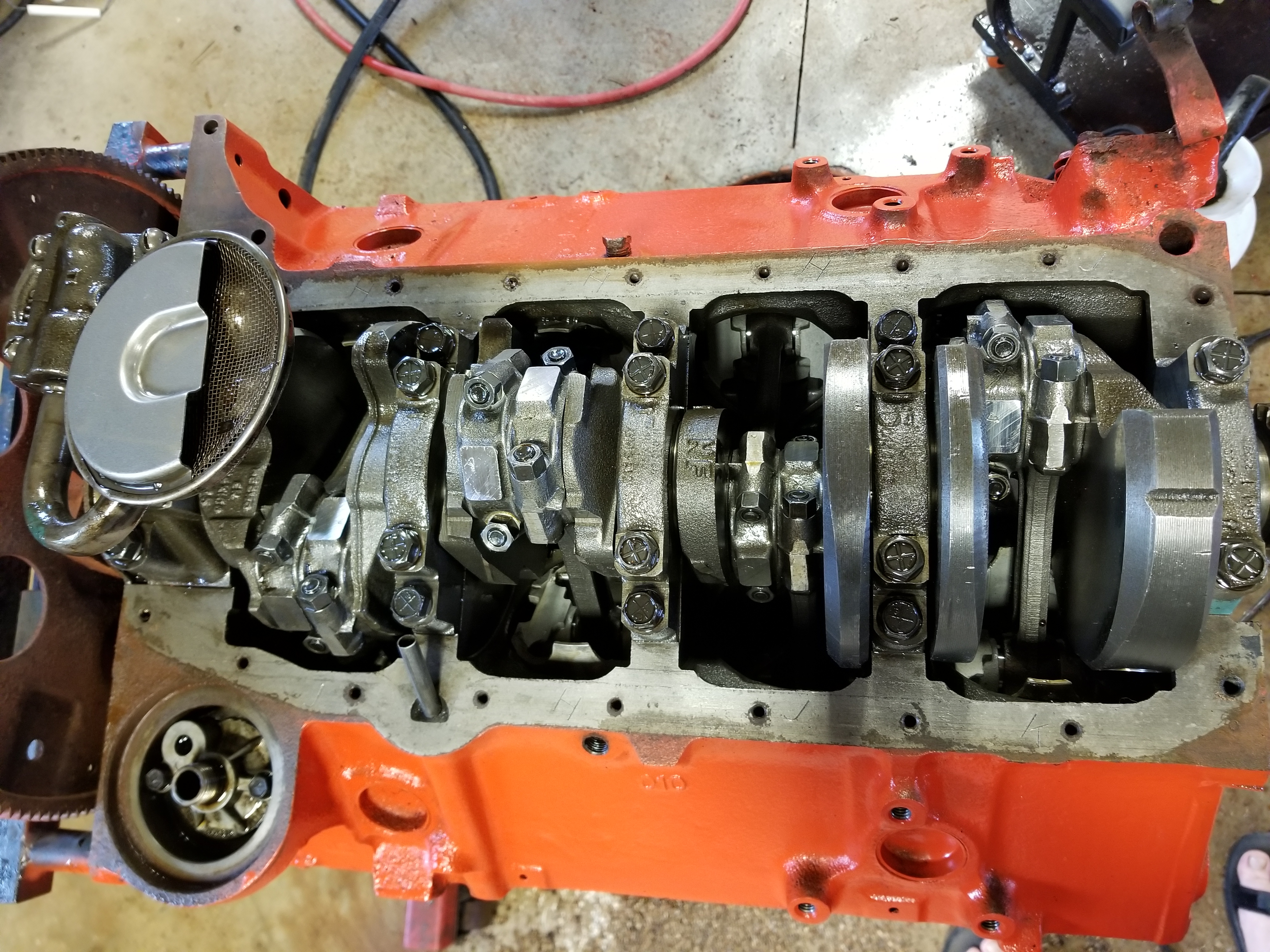

After pulling the pan, I think I can believe it. Everything was very clean, and none of the usual discoloring you normally see on the crankshaft. I was pleasantly surprised that it's a 4-bolt. I did not pull any rod or main bearing caps. I cleaned some carbon crud off the top of the pistons. I bought a new Summit oil pan and timing cover, and transferred my nice balancer over to it.
Tonight, Chris came over and motivated/supervised me putting the balancer on, adjusting the valves, and bolting down the intake. It's now ready to go back in the truck. I'm going racing tomorrow and going to a wake on Thursday for a Penske employee who passed away on Sunday. (eek, too much death in this post!) With a little luck, I'll get it set in place on Friday night.

- Posts: 3629
Re: 1985 V8-S10 Blazer
Chris looks like he's praying over your small block.

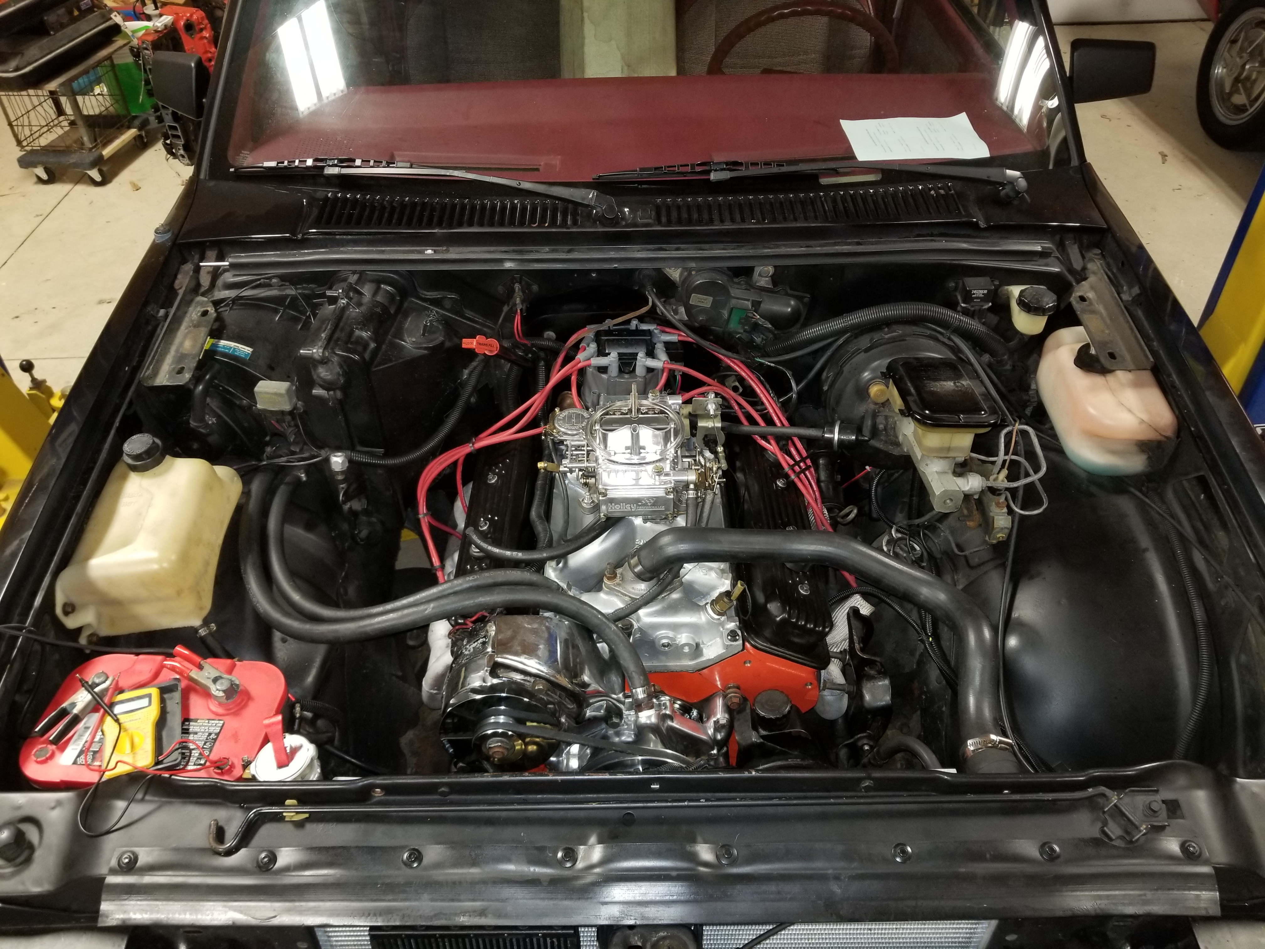

Chris praying over the motor in the previous pics apparently worked! With the freshly charged battery and the float bowls manually filled up, it fired up immediately without any issues! We put the hood back on and let it warm up a bit, and then took it for a pretty good drive. We even took my Holley dolly with us. I'm officially back to where I was in April..
It's running really good, maybe even a little better than it was before. I might still make it Woodward with it in two weeks!

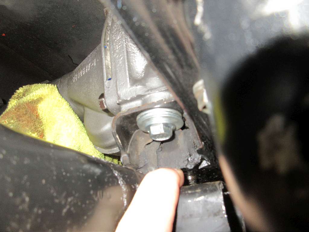

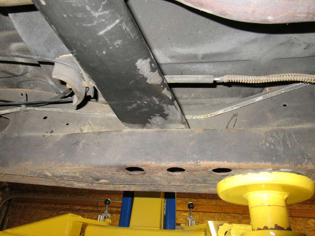

I'd rather modify/change the crossmember. I've been looking on craigslist and ebay to find an extra, but they're hard to find. The Blazer crossmember is different than the S10 truck crossmember. Trans-Dapt sells one that is for a TH400 in the trucks, and it's relatively cheap at $60, but based on the lengths from the bellhousing to the trans-mount listed here, http://www.tciauto.com/tc/trans-dim/ the Trans-Dapt might be too far back. But it might be easier to modify than the stock one. I was going to buy it today from Summit after leaving Andy's, but the work took longer than expected and I needed to get home.
