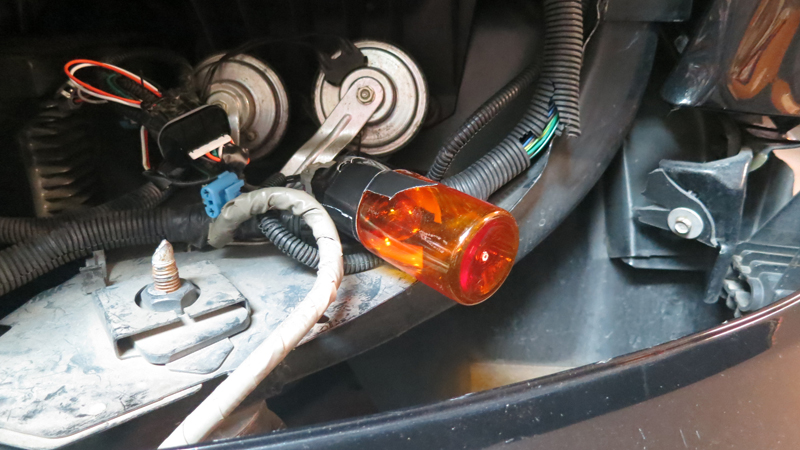

Since I have a two week wait for my turn at the body shop, I thought it would be a good idea if I had a left turn signal after the deer ate it. After removing a thousand pieces of broken left headlight and housing I found a chopped off stub of a turn signal harness and no bulb and socket. Well, I dug around in the two boxes of pieces and found the socket parts and bulb and was able to put them together. The wires had several places where the shards had cut through the insulation so I used heat shrink tubing to repair them and then soldered the socket onto the stub of the wiring harness. I bought a new bulb and now had a working signal but it was open to the elements. In addition it was not as bright as I had hoped, so I looked for a way to protect it from rain water and make it a bit brighter. My answer was in the medicine cabinet. I found an amber pill bottle that just fit over the bulb. I used a little gorilla tape and a couple of zip ties to hold it in place and the new hack worked like a charm.

Looks legal to me. :wink:

I'm laughing for real right now! That's an awesome fix. That Gorilla tape is awesome stuff. We have a turn signal at work on a big truck that has been Gorilla taped down for months now. It's a whole big assembly that sticks out from the top of the fender.

I can feel the ram air effect when running 70 on the interstate. The truck pulls to the left a little.
