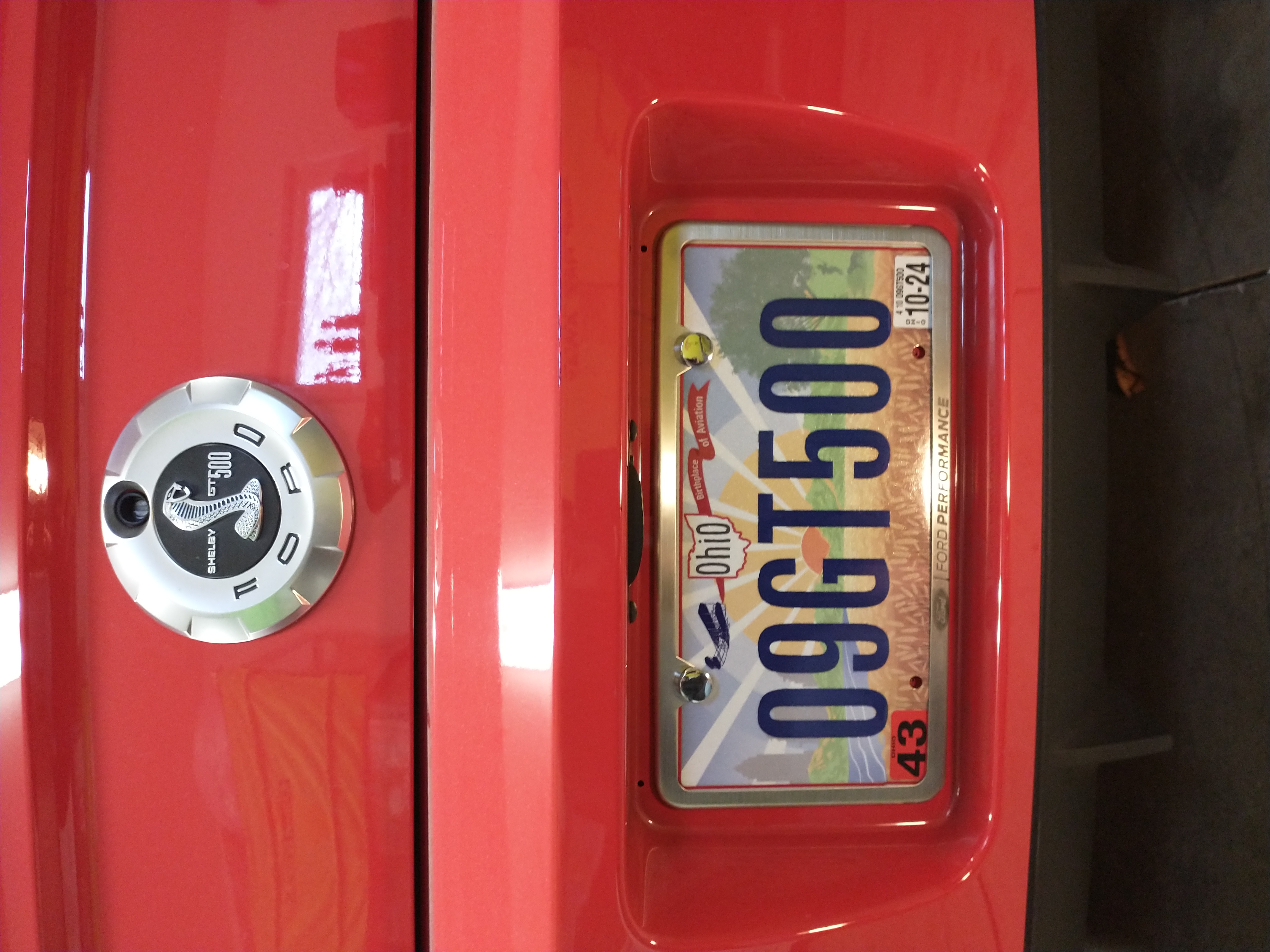

Finally got my plates and frame in and got them installed today. I have new belts, shocks, and rear upper control arm bushings that need installed. I'll have to pick at those. And sooner than later I'm going to order new Michelin Pilot Sport tires for it as I can't bring myself to put the crappy Goodyear OEM spec tires back on it. Nothing but terrible reviews on those.

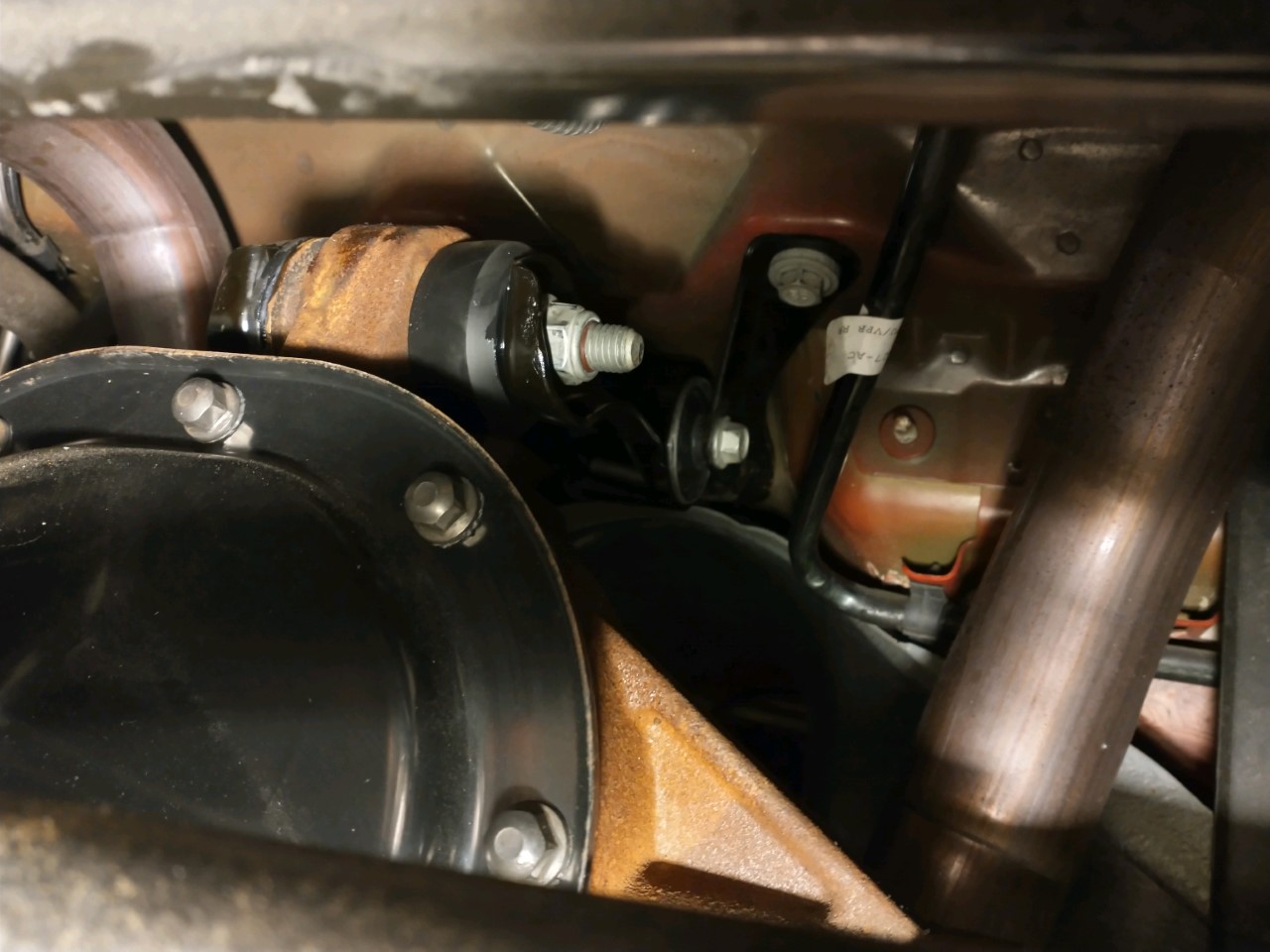

Over the weekend the Shelby got new Michelin Pilot Sport tires in the factory size. While I had them off I decided to tackle the rear wheel hop problem (hopefully). The upper control arm (there's only on) although low mileage, had two bushings that are dry and cracking. Being a convertible and a GT500, this is a tougher job than a stock Mustang, but I was able to get the control arm removed. I attempted to remove the bushing, but gave up after not too long and just decided to get a new control arm with a new bushing already installed.
The bushing on the pumpkin is also press out, but LMR offers a urethane bushing to go in it's place reusing the steel sleeve that the existing bushing is in. You drill out the rubber all around the steel sleeve, then just attack what's left of the rubber with a wire wheel. I believe it's this urethane bushing that will do the most to help fix the wheel hop. I don't want urethane up on the body as I don't want to listen to the clunking. This isn't a race car, it's a cruiser, so quiet and smooth is more important.

A couple evenings last week and late Saturday afternoon, I was able to finally get the new upper control arm and the bushing on the axle housing installed. The one on the axle was really a struggle to get the rubber out and pound the urethane one in. LMR's video just says to "tap" the bushing into the sleeve with a hammer. I pounded on it for almost an hour and a half with a four pound hammer (the biggest I could fit in that area). This doesn't include the time I spent drilling the rubber bushing out, and then burning it down with a tiny wire wheel. But at the end of the day, I win. Everything is back in place and I can happily say, at least on the street, that the wheel hopping is gone and I can actually use first gear under full throttle now. Between the bushings, rear shocks, and the new tires, the car rides SO much better, and is noticeably quieter inside too.
