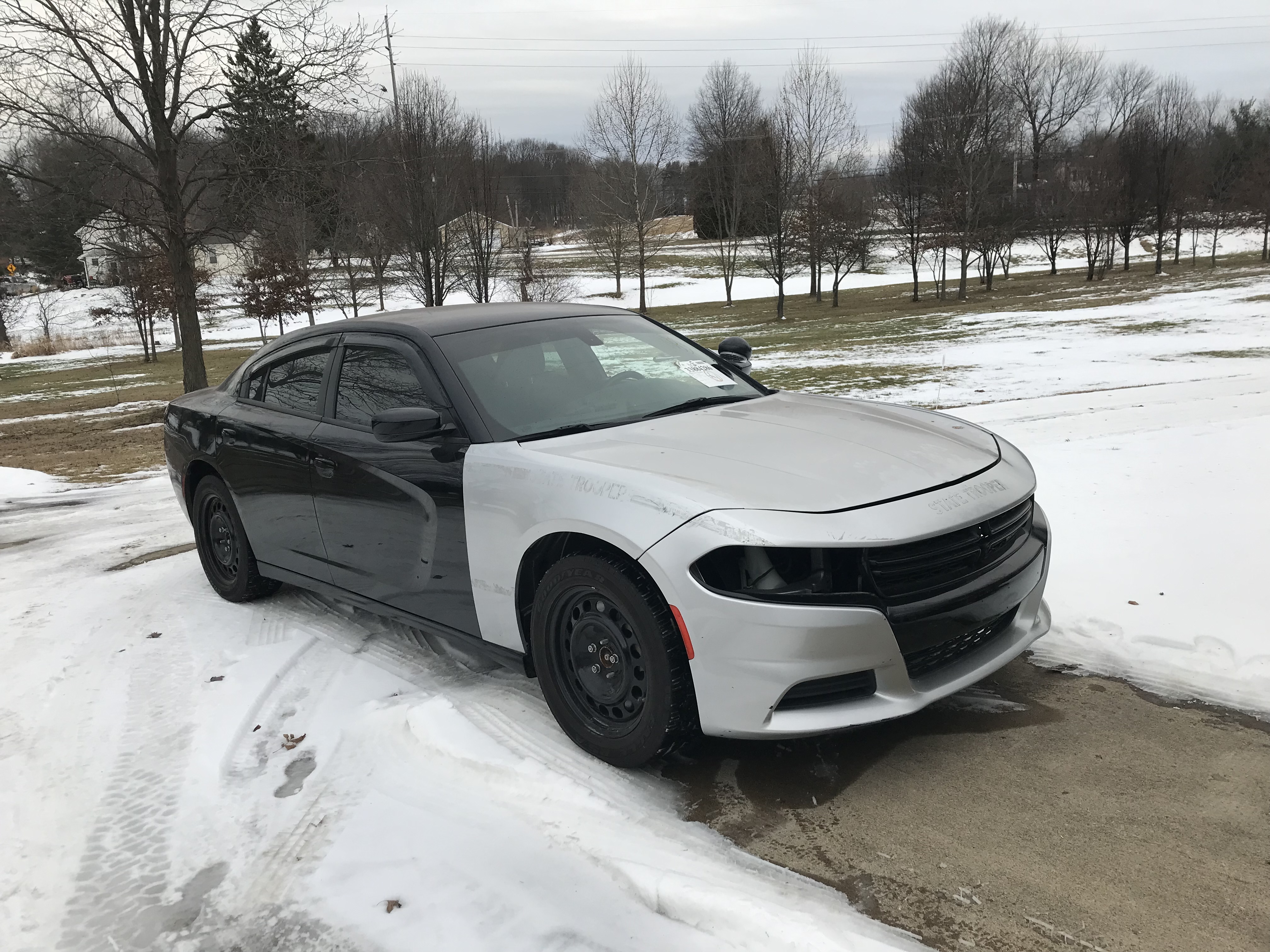

2019 Dodge Charger

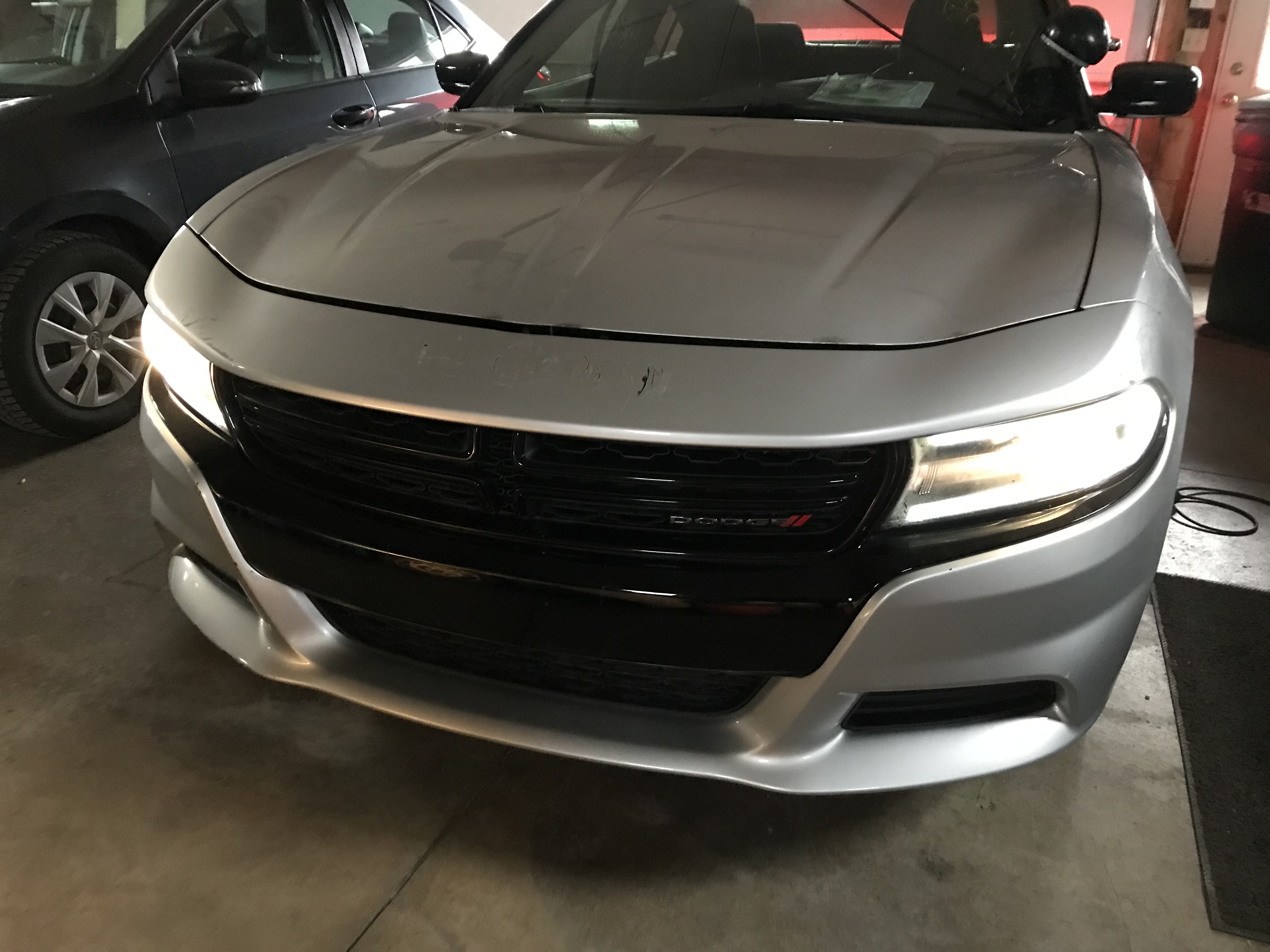

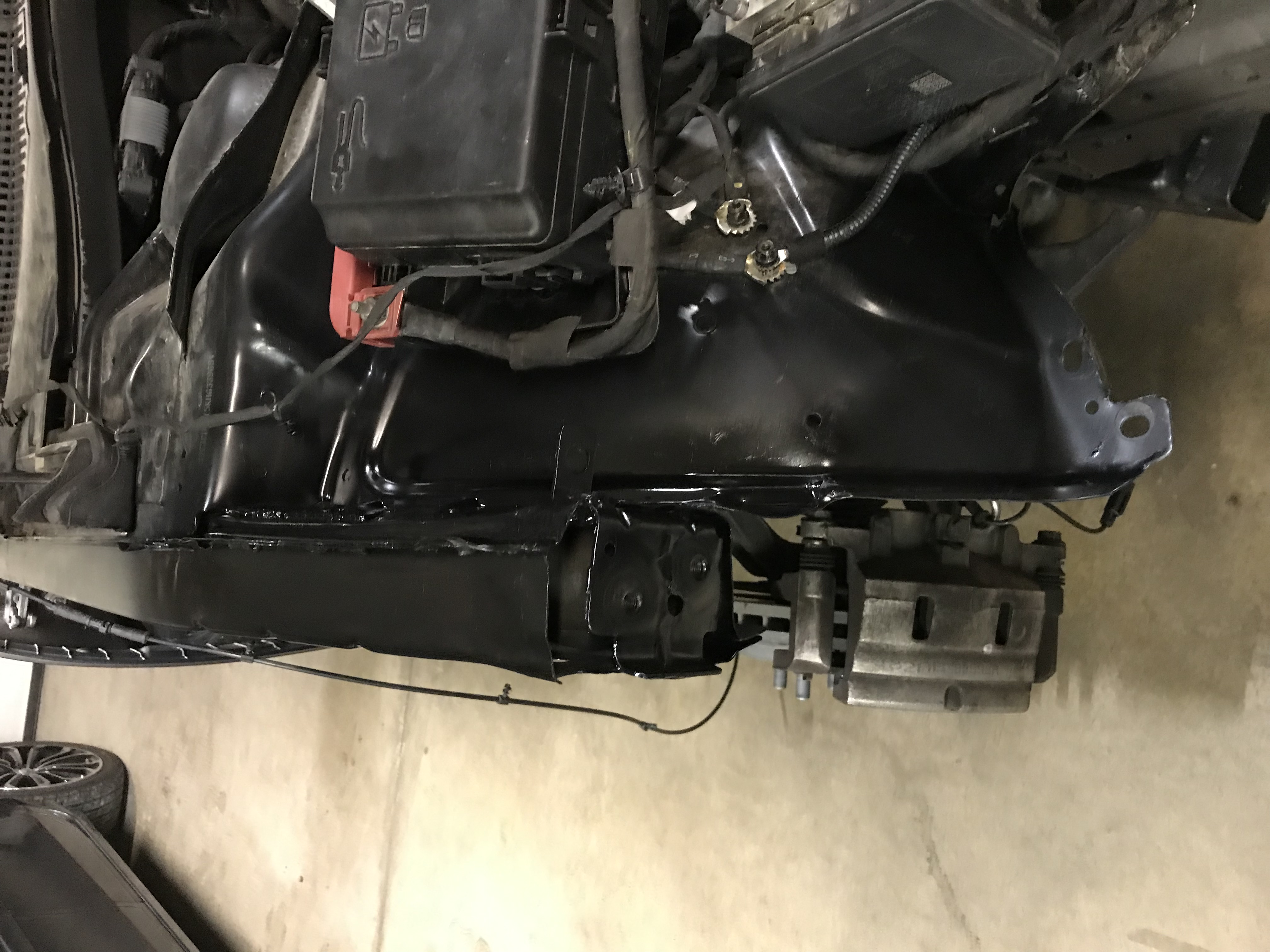

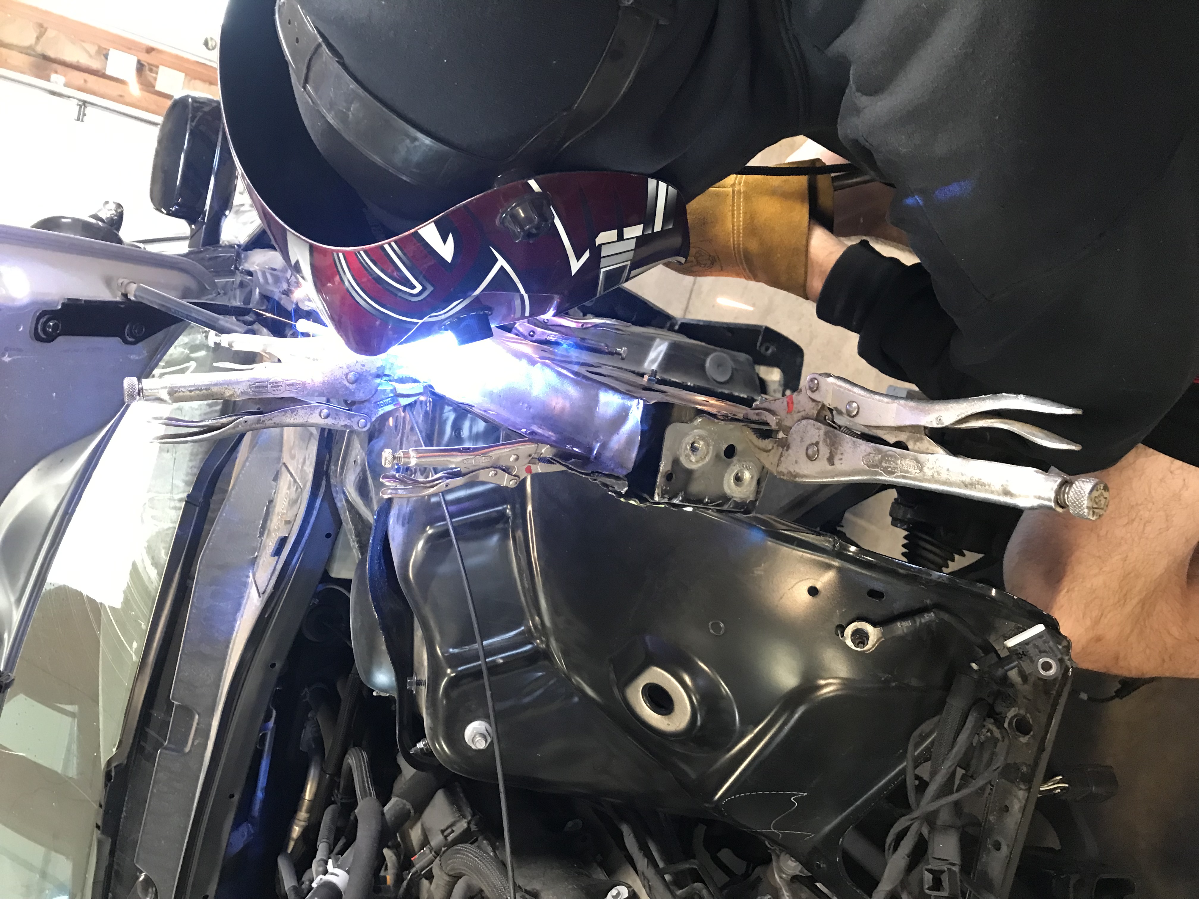

• Removed the front clip, prepped all surfaces, Kurt welded everything up
• Cleaned up welds and painted all the repaired surfaces

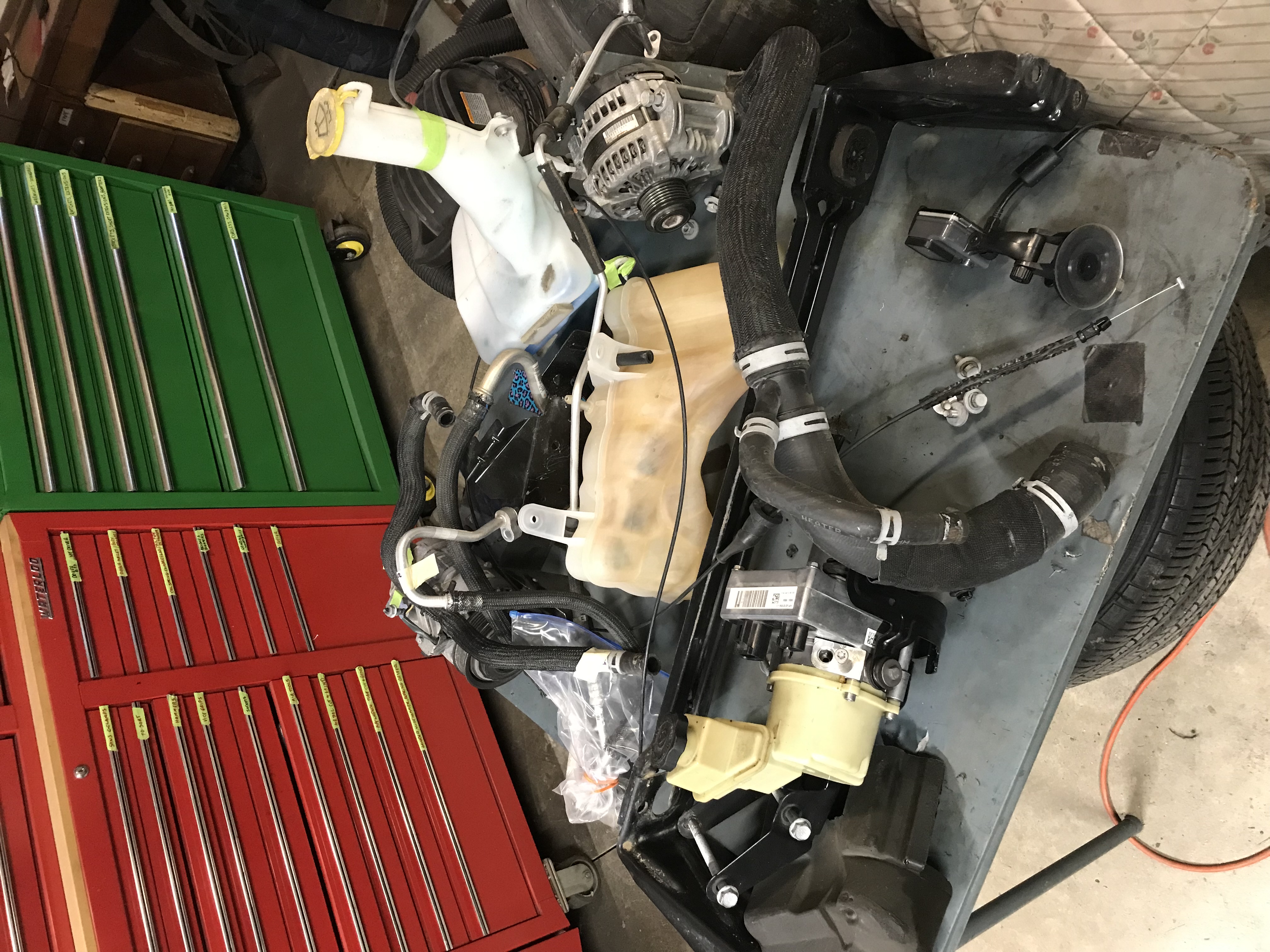

• Installed a lot of parts on the front of the car: power steering, alternator, A/C compressor and lines, lower radiator support, washer bottle, radiator hose, front bumper, hood latch cable, other small misc
• Cleaned the surface rust on the fenders and hood, and treated them with rust inhibitor
• Straightened some minor damage on the RF – put my newfound knowledge with hammer and dolly to work

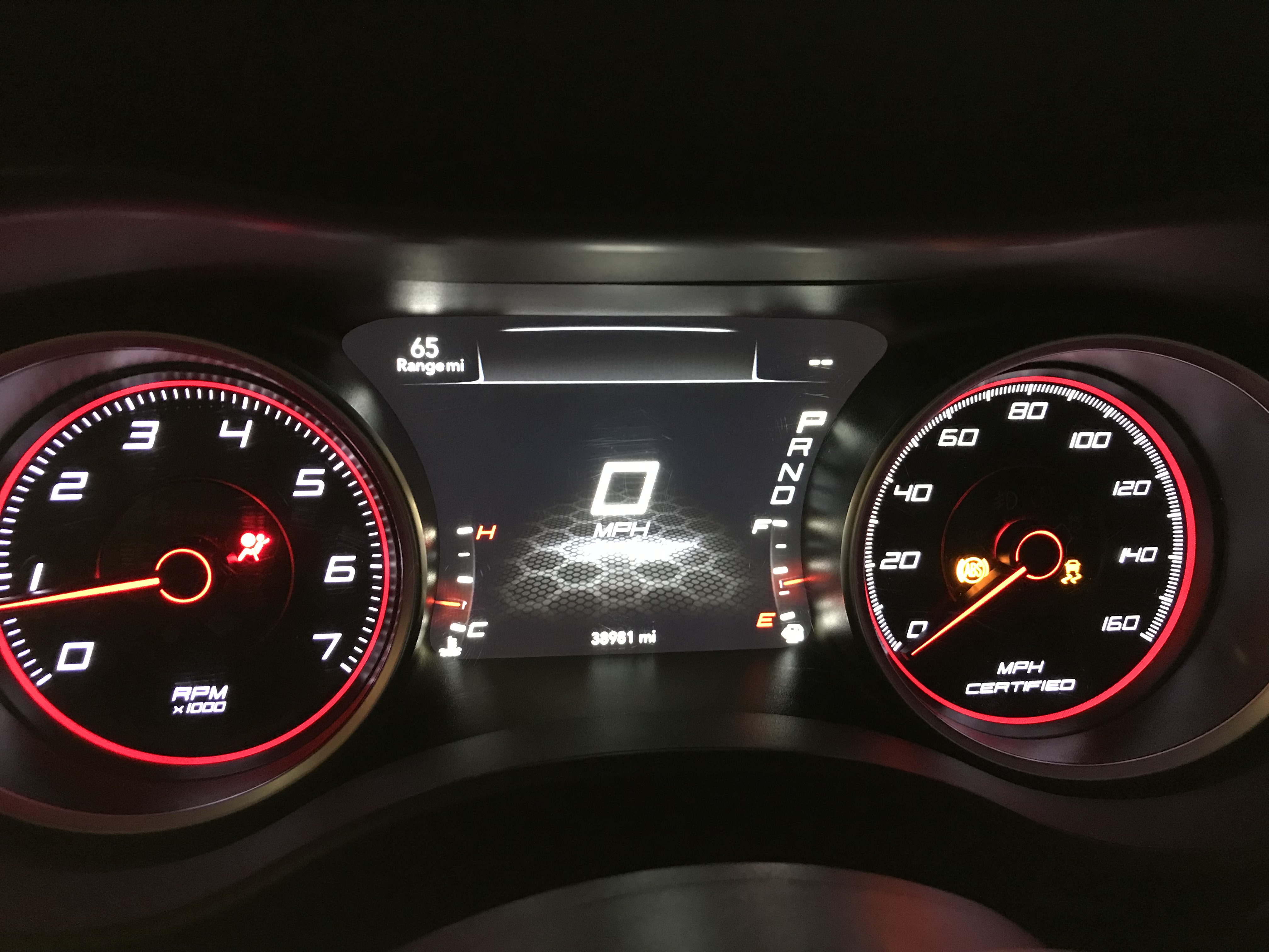

• Pulled codes for ABS and electronic stability control

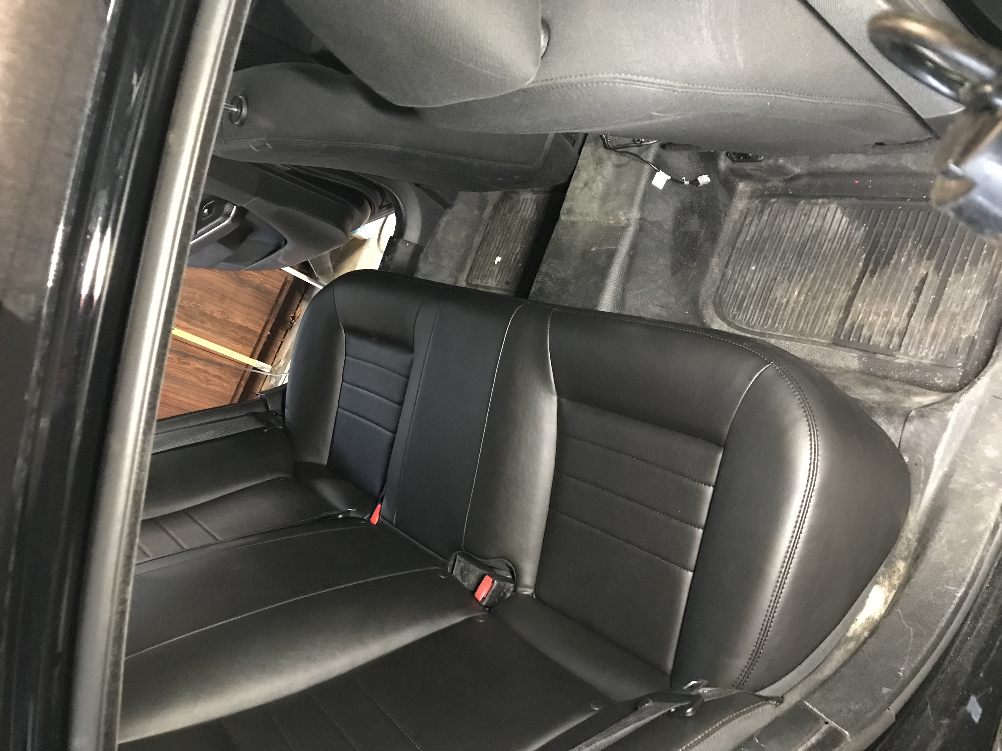

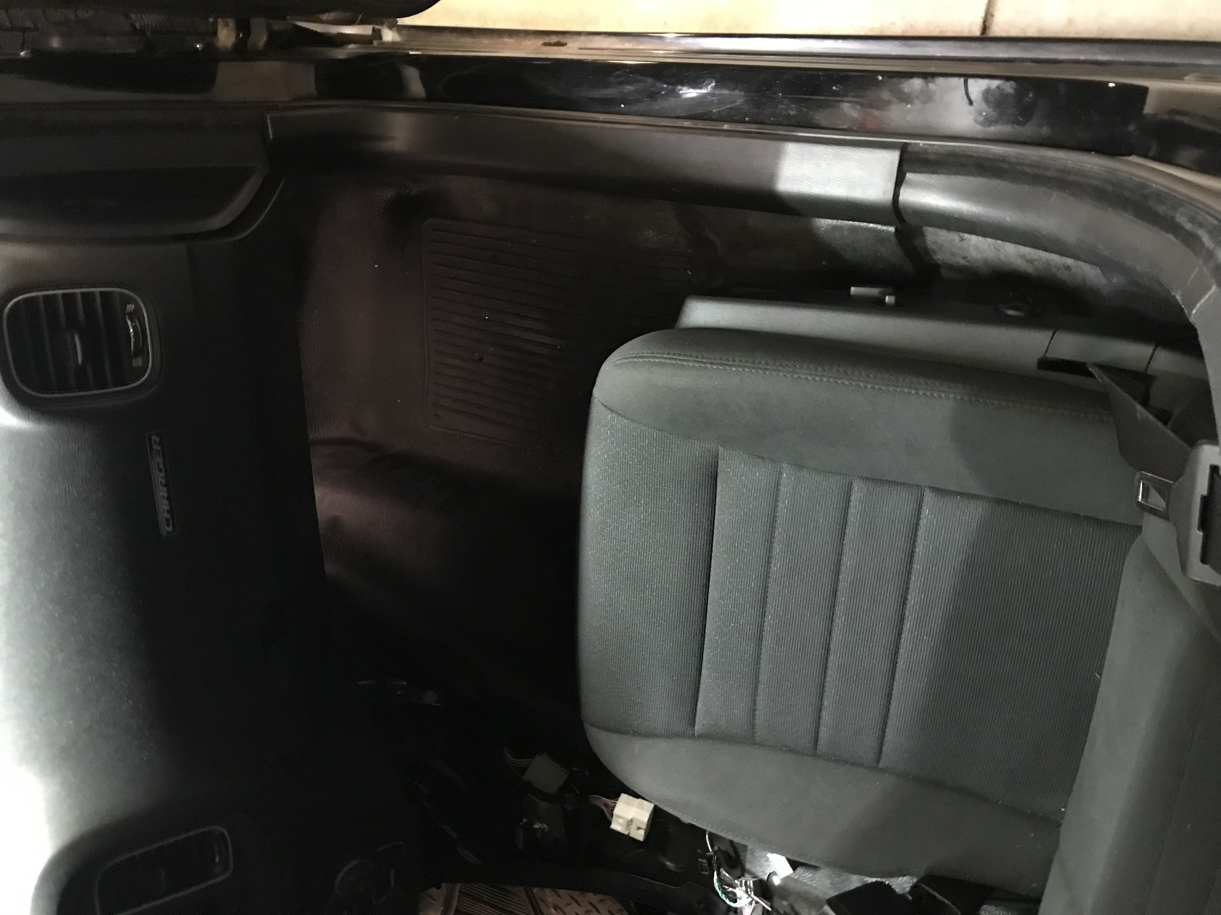

• Fred32v was over today and got the rear plastic seat/belts out and replaced them with the OEM seat and belt

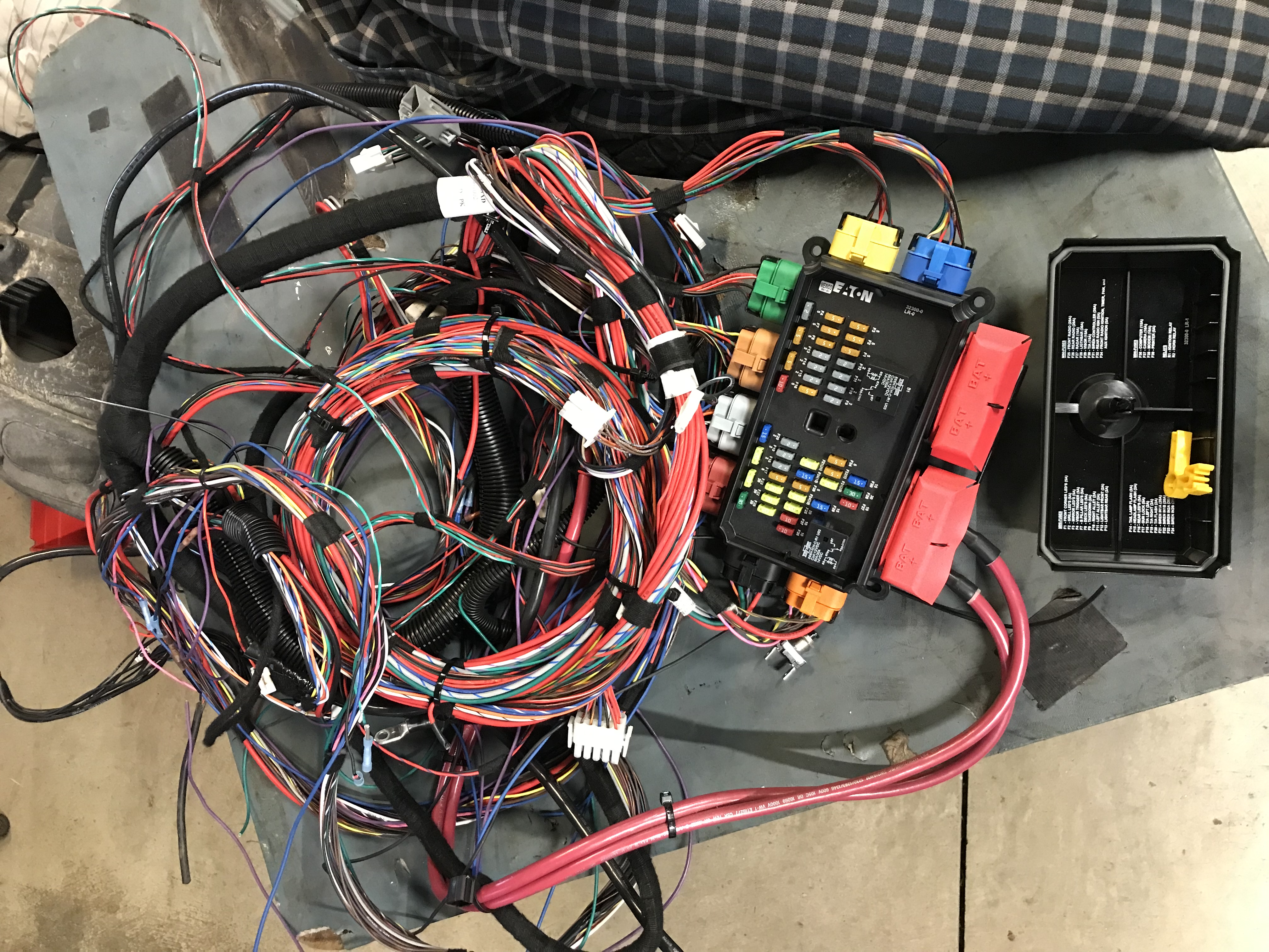

• Removed police wiring harness – this was over 20 lbs of stuff
• Crossed the 100 hour mark on this project

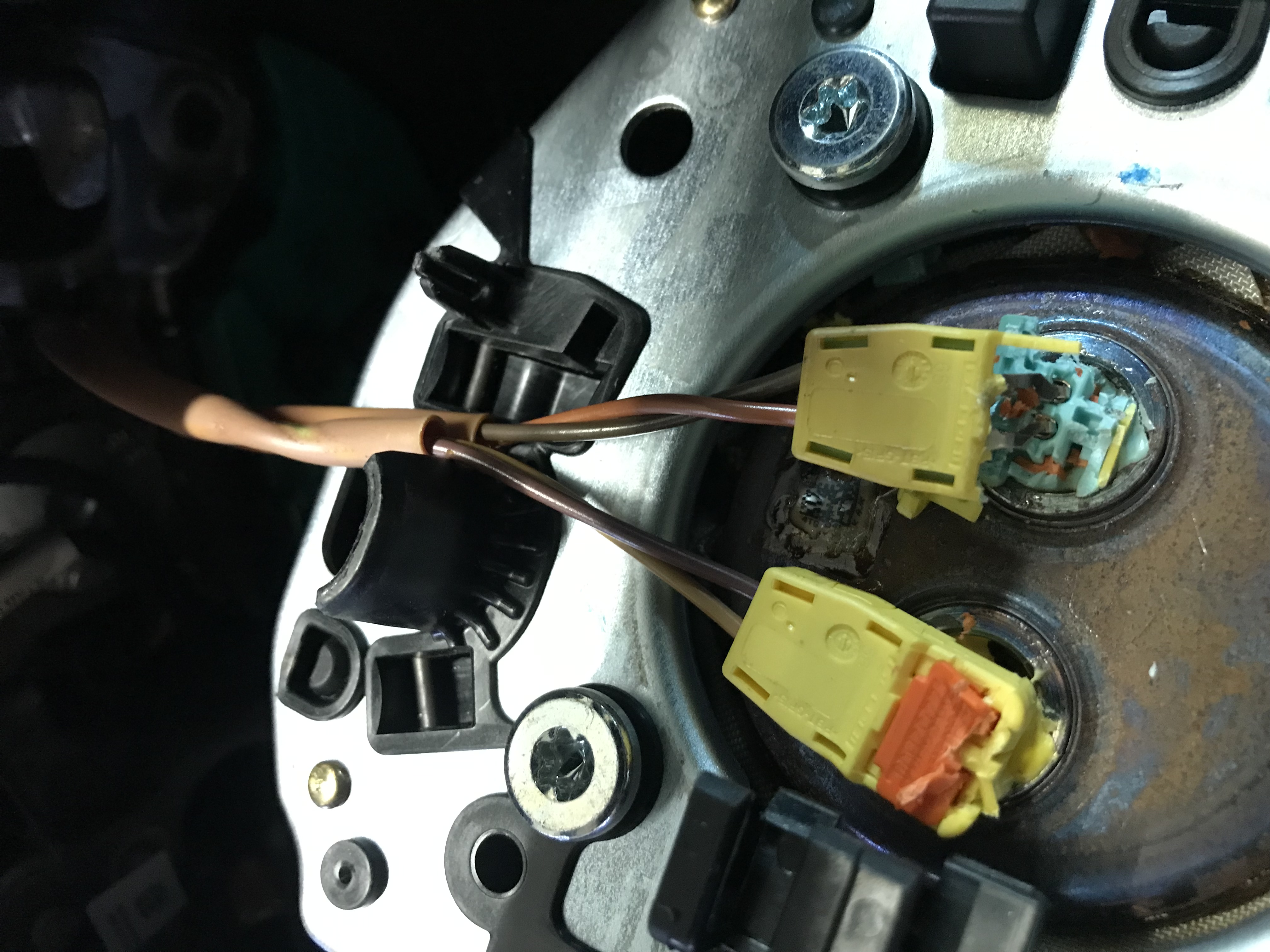

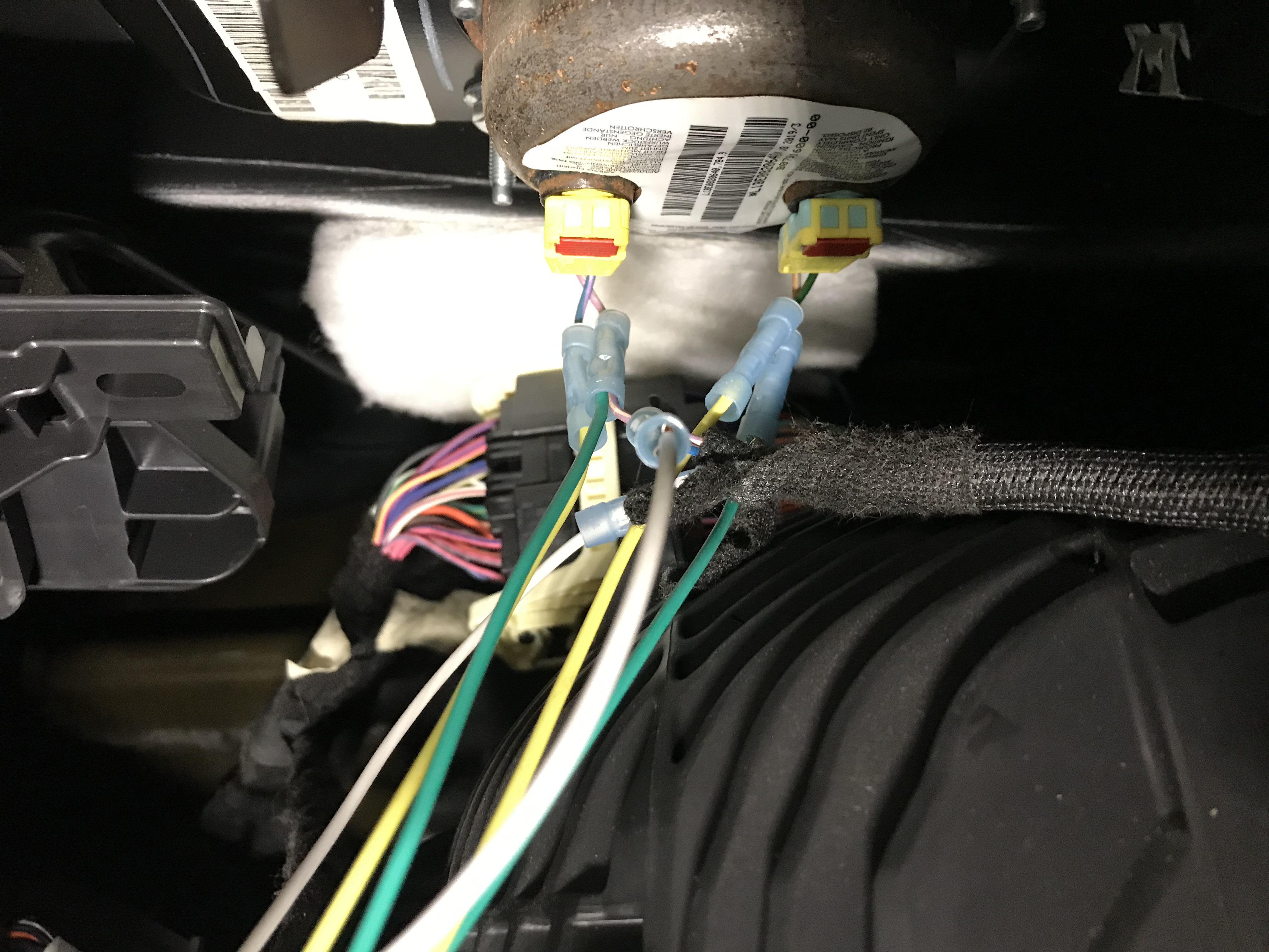

* Removed seat belts and driver air bags from parts car, and installed them. The connections to the steering wheel airbag melt when it deploys so the clock spring has to be replaced. This requires the wheel to be removed, but is actually quite easy just have to take care to keep the orientation of the wheel and clock spring right - again used a part from the donor car.

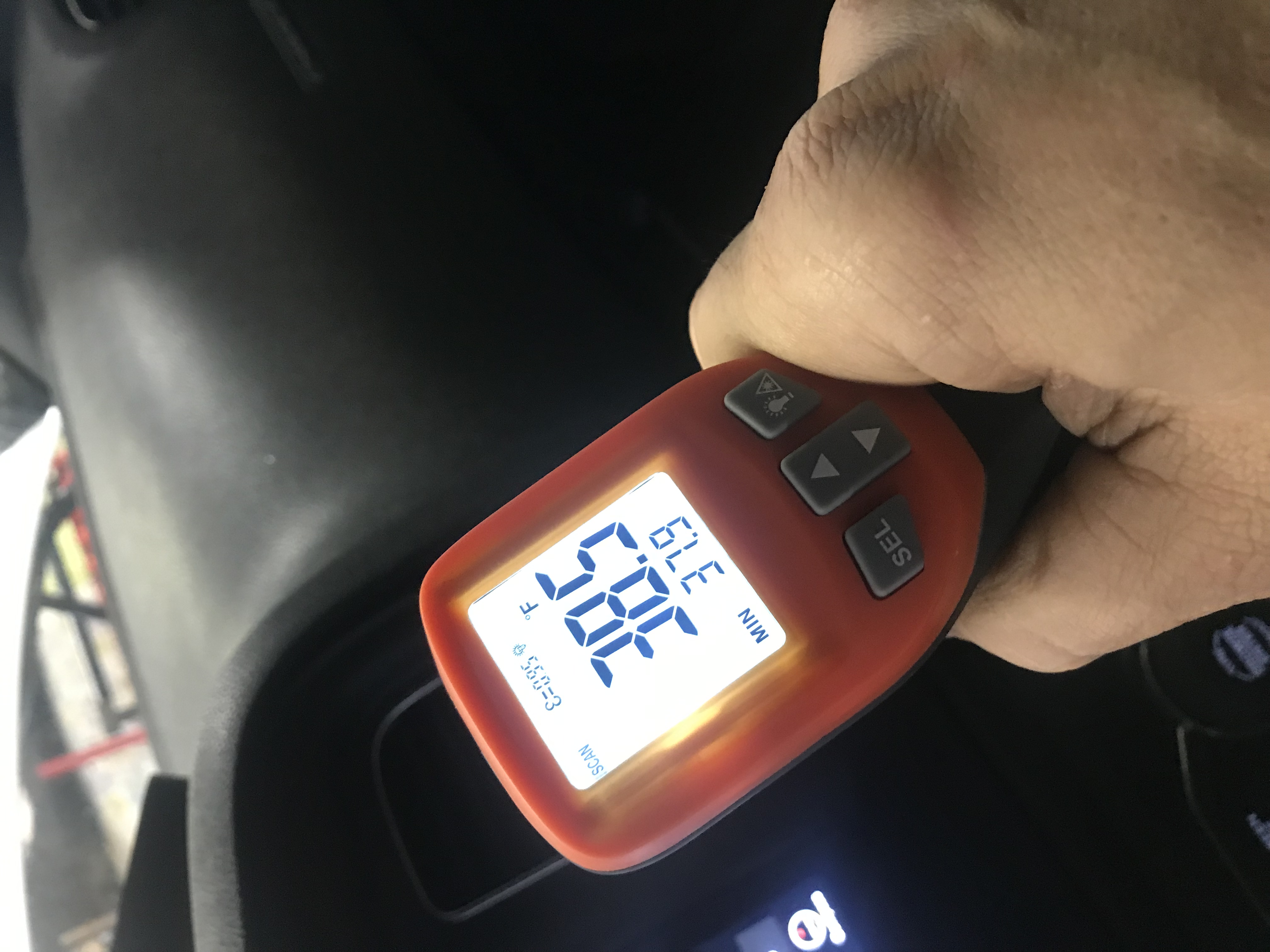

* With the engine running I took the time to let it warm up a little and test things. The trunk release button on the dash does not work, dash lights for ABS, traction control and the airbag system are still on. There is a squeak from I think a pulley on the driver side of the engine.

Bonus pic - on the left is the deployed lower airbag. Note the metal casing is deformed from the deployment!

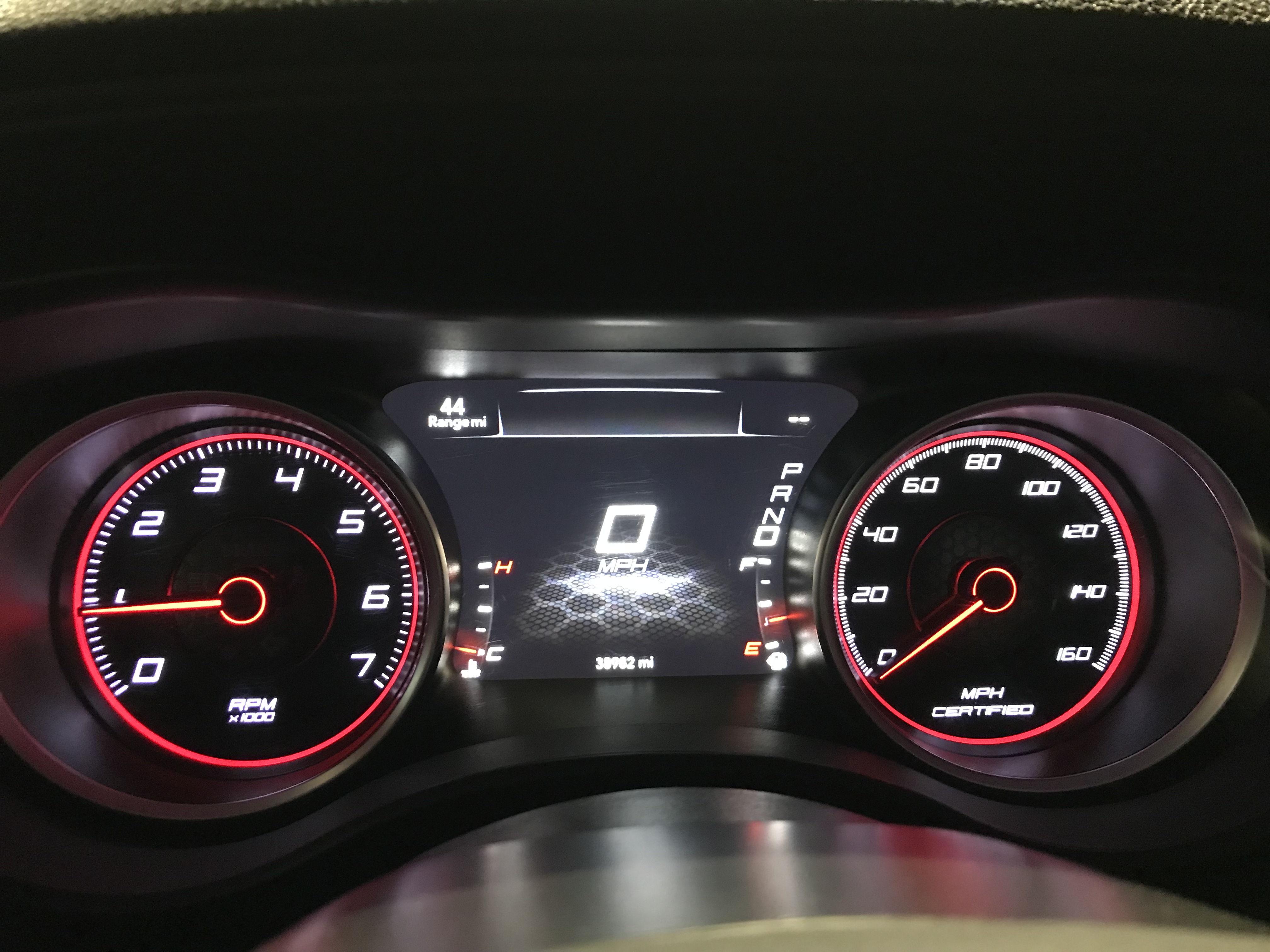

* Driveway test drive cleared up the ABS and stability control codes. It's starting to feel more like a regular car

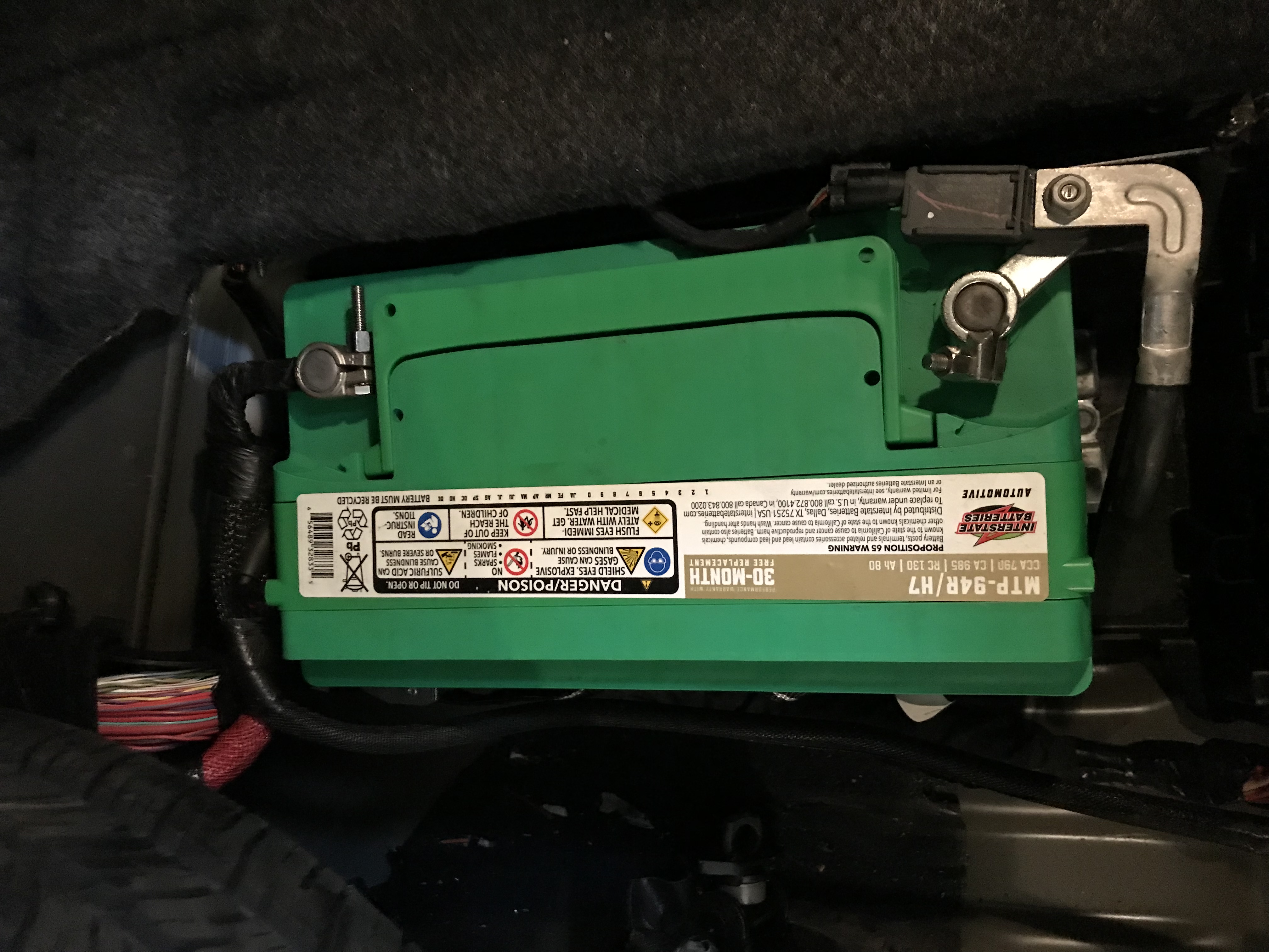

* New battery installed

* Received the airbag module after reset and installed it - now there are no lights in the dash. Oddly enough the horn and seat belt indicators did not work with the airbag module out.

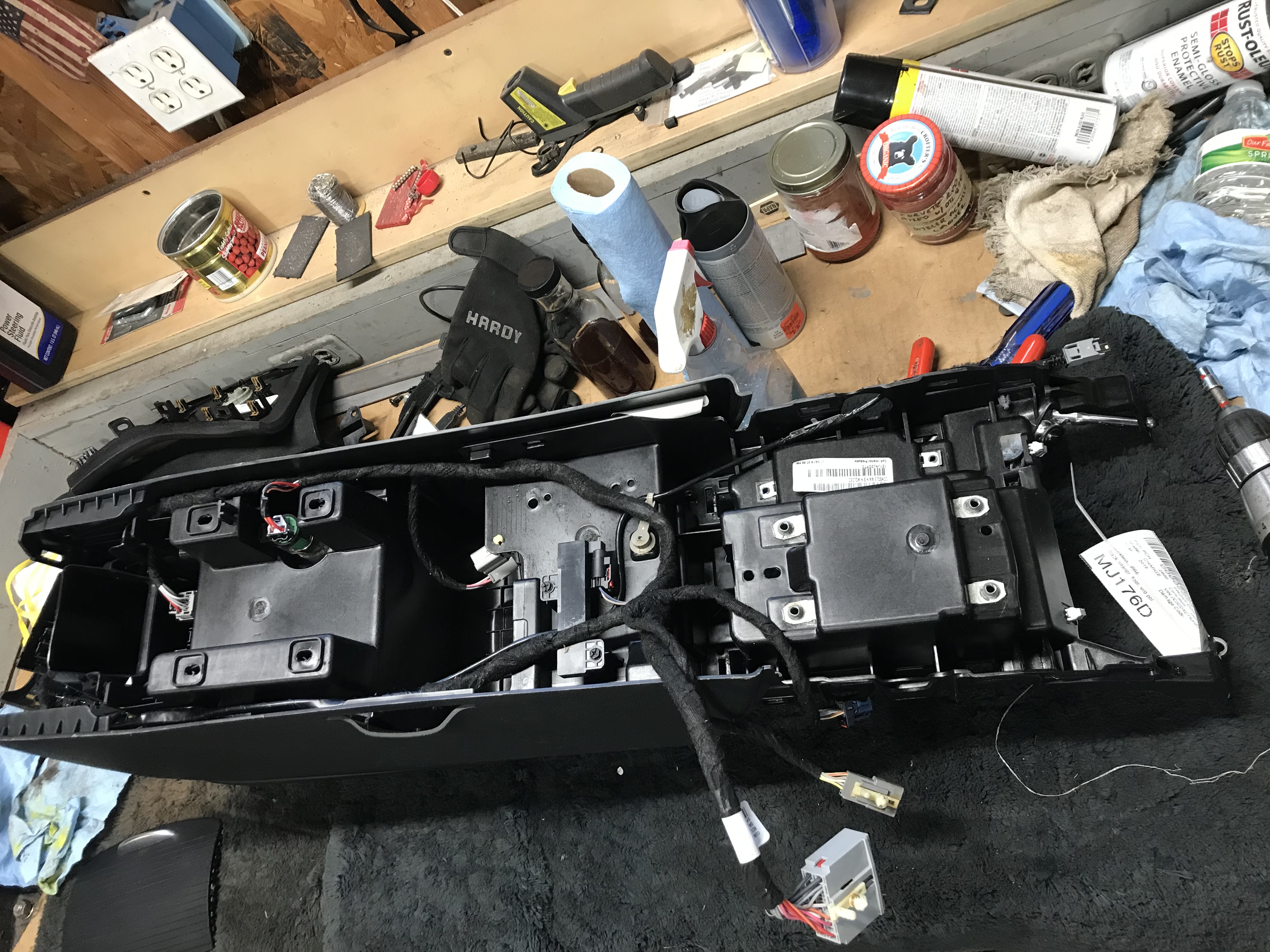

* Center console got a good cleaning. It was a junkyard part but it too suffered from at least one good coffee spill. Pic is of the patient on the operating table lol.

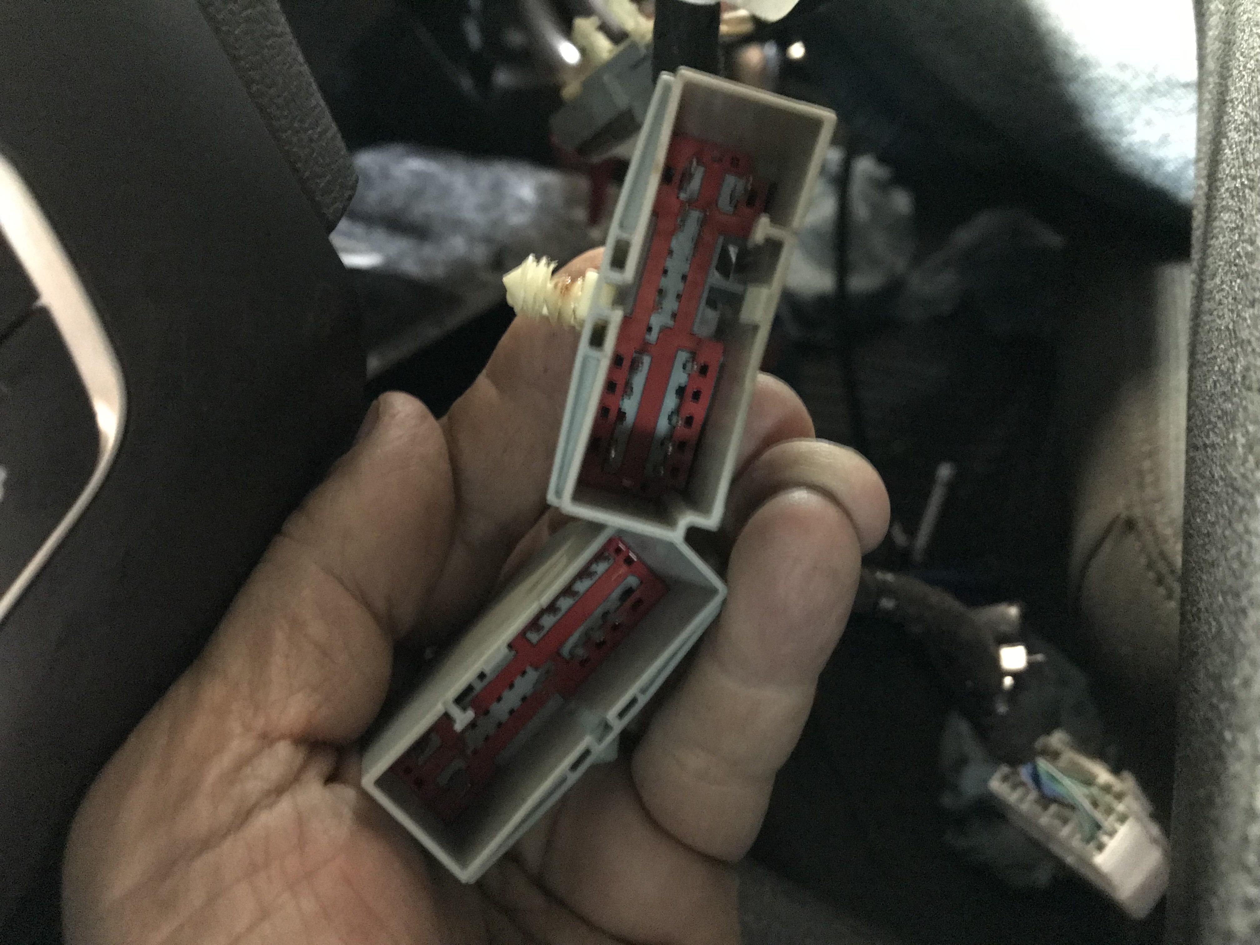

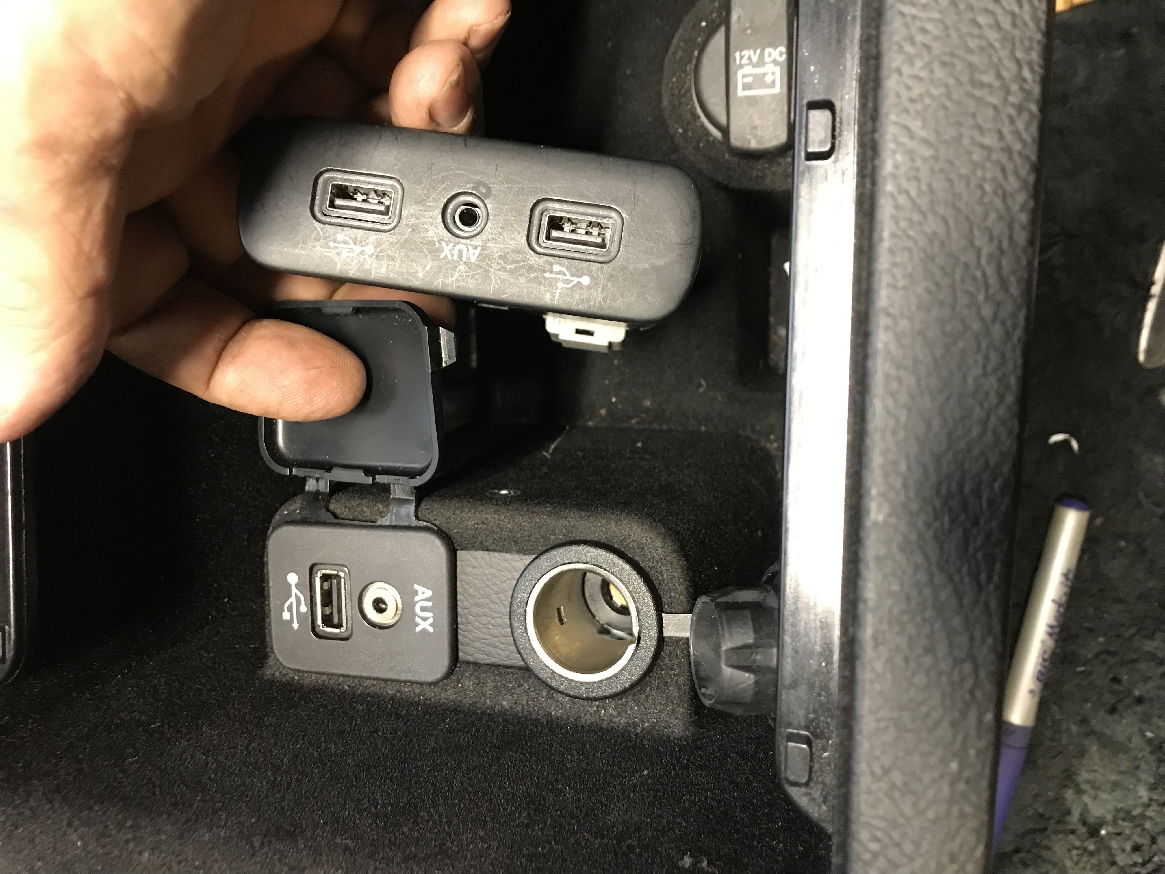

* Center console wiring turned out to be a decent size task. The problem was the wiring harness is not compatible with any of the open plugs in the vicinity of the console. Its from a 2018 - I just can't imagine what the engineers were thinking. So I ended up using the wiring harness from the mini-console that had originally come with the car.
- The USB/aux cord port is different dimensions than the one that came with the console, so that needed fabricated.
- The console has 2 USB charging ports in the back, and while the plug is the same as one on the mini console, when I plugged it in the ports did not work. Rather than guessing I ordered a charging port that will fit in the hole and will wire it in.
- I decided that there should be at least two charging ports in the console, so I ordered a charging port for that as well.
- The cup holders have a light around them that should go on with the dash lights. Problem is in the 30+ wires that are in the three wiring sockets, not one of them is connected to the dash light circuit. I found one wire with keyed power so these lights will go on and off with the key, as will the light for the cigarette lighter in the console storage compartment.
- The USB port that is integrated with the stereo system is too far away from where the USB cord comes out from under the dash. Oh there is a cable with the console but the stupid thing has two male ends and won't plug in - luckily this is easily fixed and an extension cable is on order.
The connector is the same - one of these is from the car wiring harness, the other is from the console. Both female, and apparently not intended to be connected.

Oh yes it has a new battery as well!

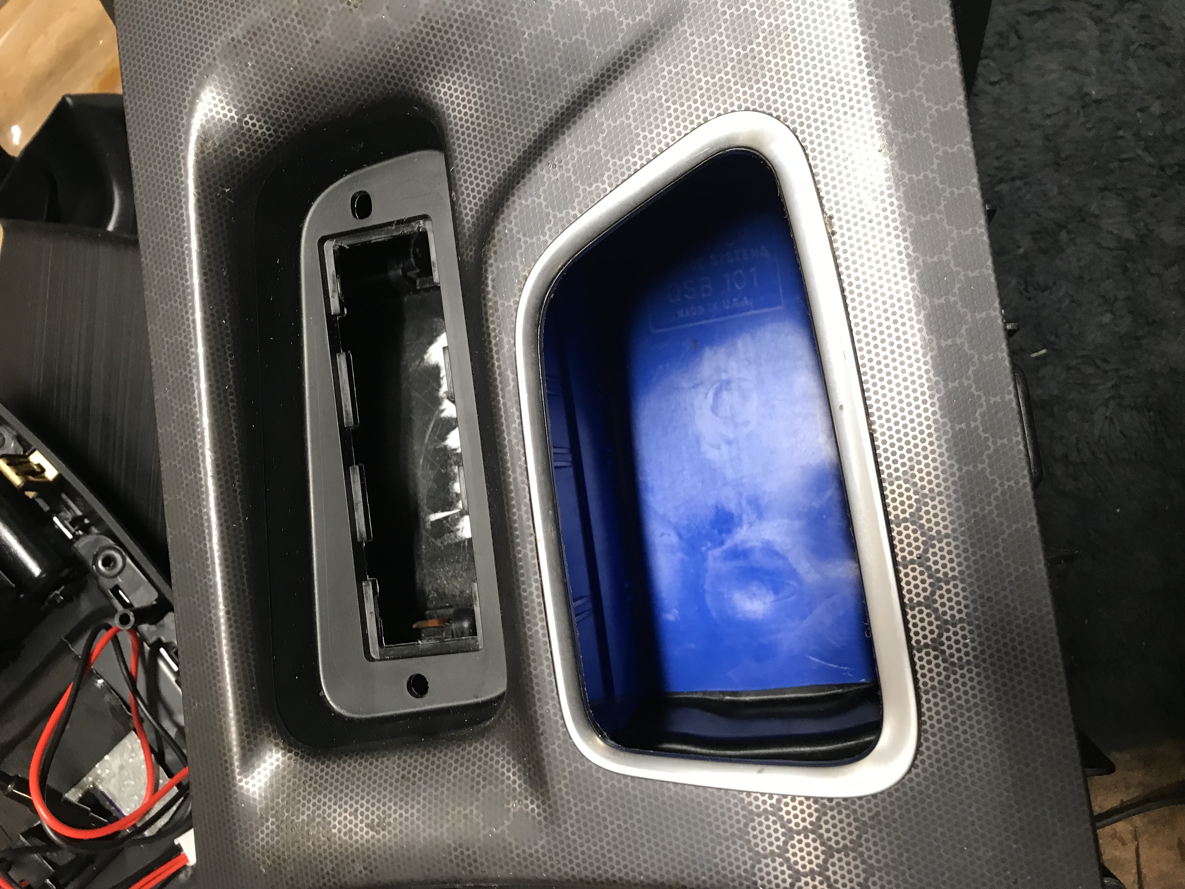

* Center console is done (almost)
Discovered there is a tray with a 12v outlet that I did not get with the console. on eBay this part is like $90! The whole rest of the console was $140
Wired in two USB charging ports - one in the back and one for the little console tray. Each has two USB connections.

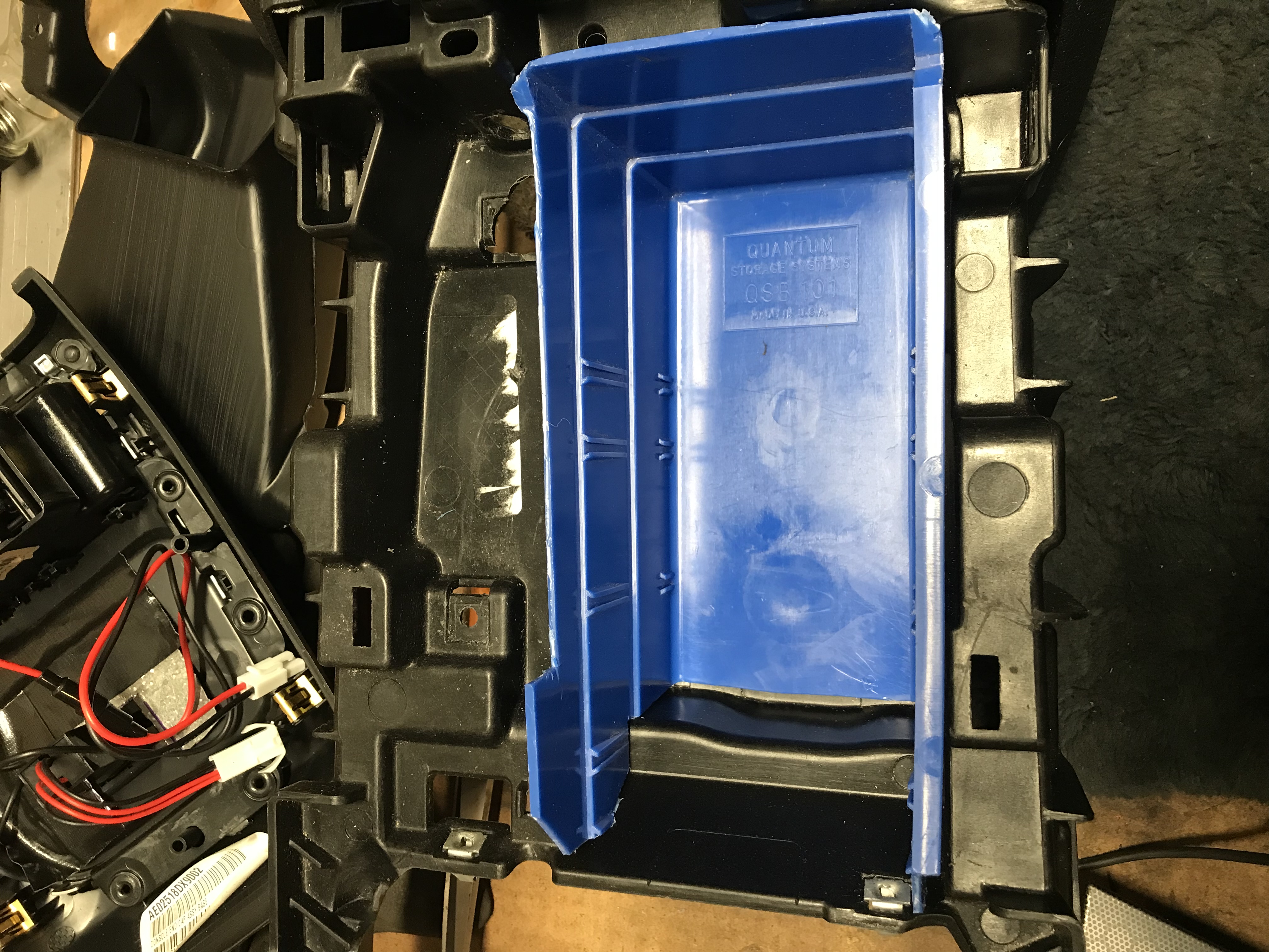

Fabricated a mini storage bin to replace the original shifter location. Used a plastic storage bin from the Dave Bales collection.

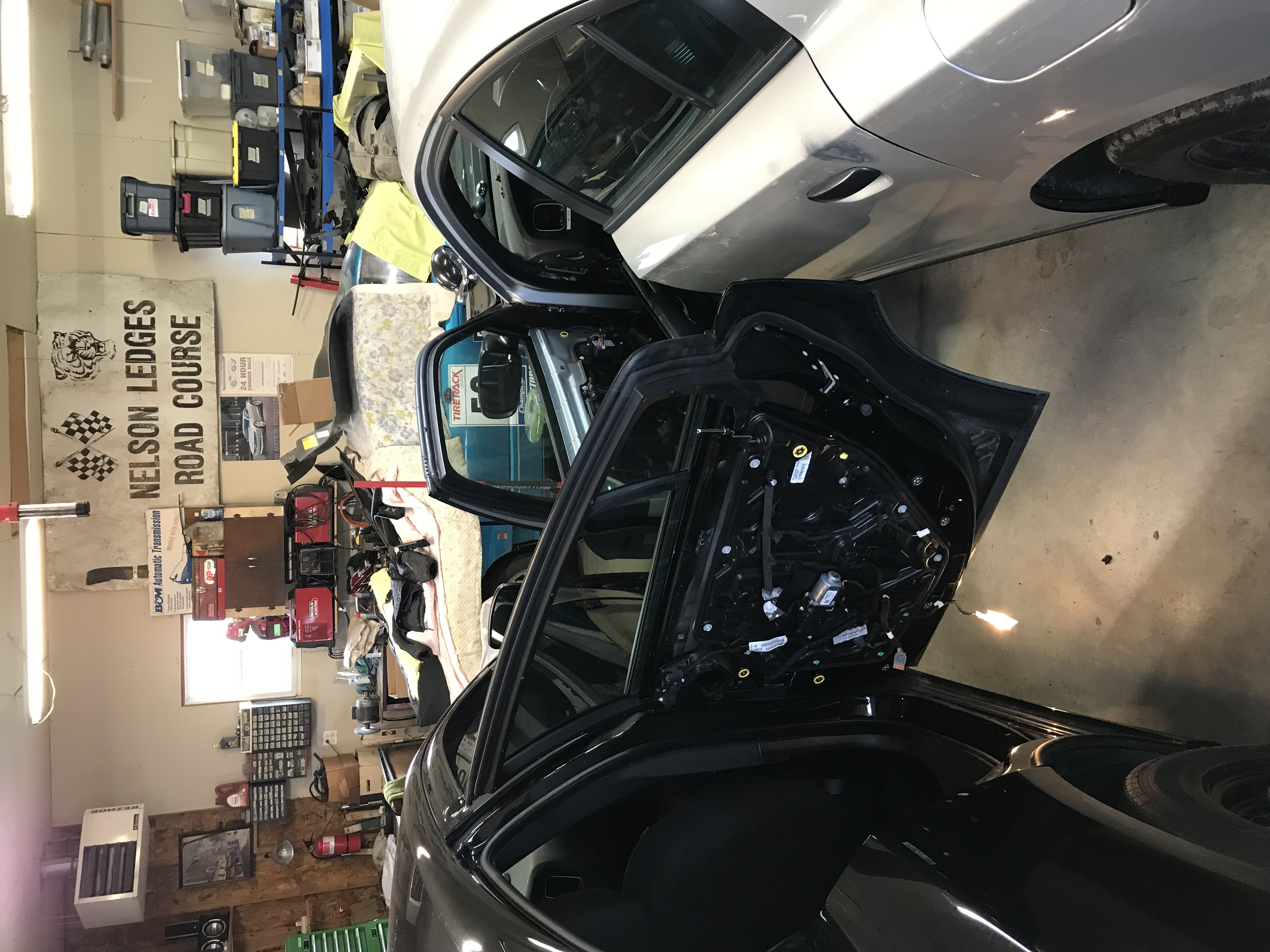

* Rear doors now have functioning handles, locks, window switches (almost)
This car had the door cables and lock mechanisms in the doors, and the door handles in the glove box
Rear door lock buttons were cut, so I fetched the front buttons from the parts car and installed them
Window switches were inoperative. They have circuits in them and the windows will not go down even from the driver door controls unless these are installed. I ordered one and installed it to confirm, and the other is on the way
Rear door handles were quite easy to install.
Once the other rear window switch arrives and is installed this will be done

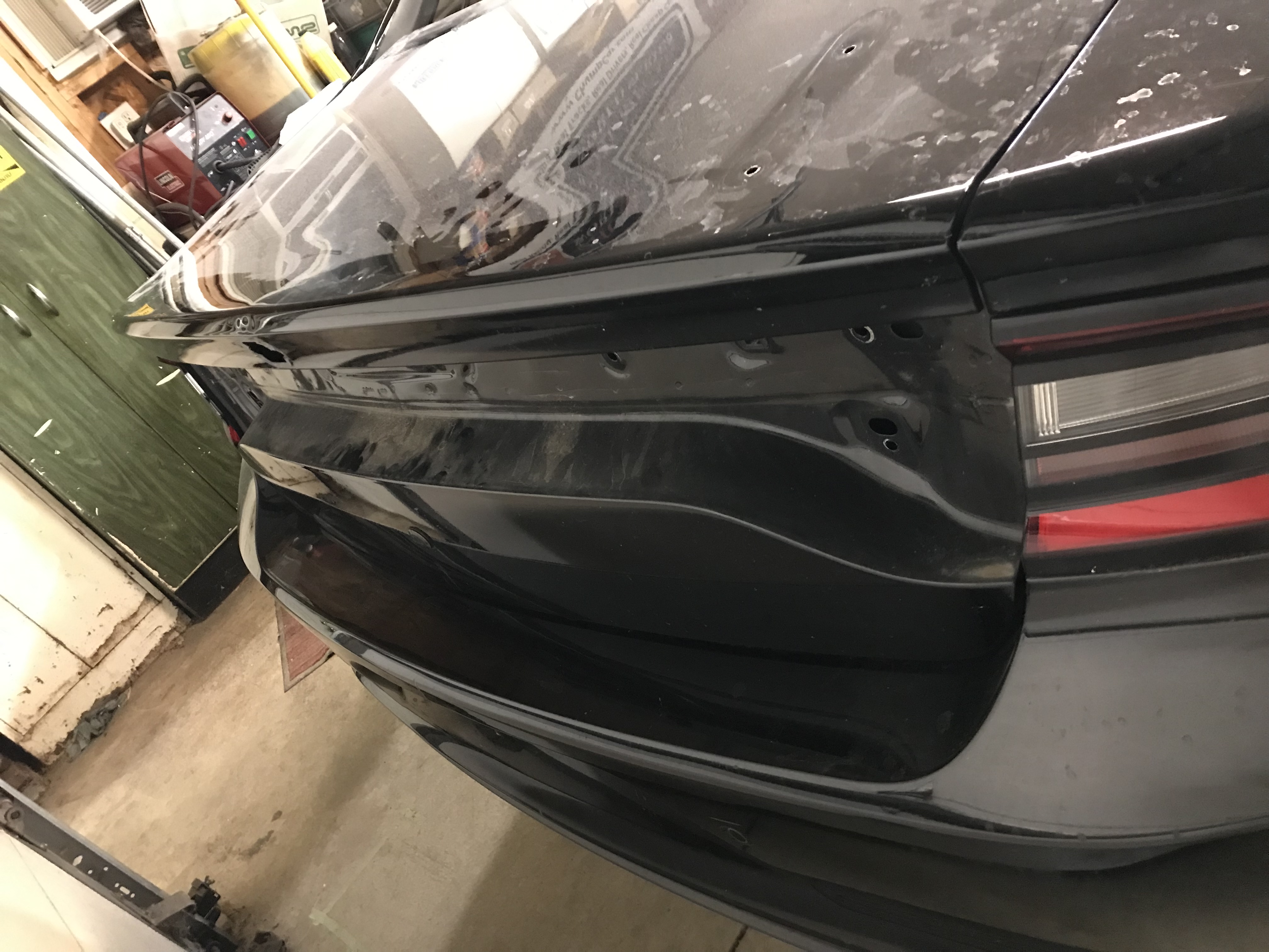

* All the sticker residue from police decals removed
Rachel had removed a lot of the leftovers on the black part of the car, but we missed the roof decal and also the stripe decals went into the doorjambs.
The silver parts had most of their residue remaining so there was some work there to clean those up

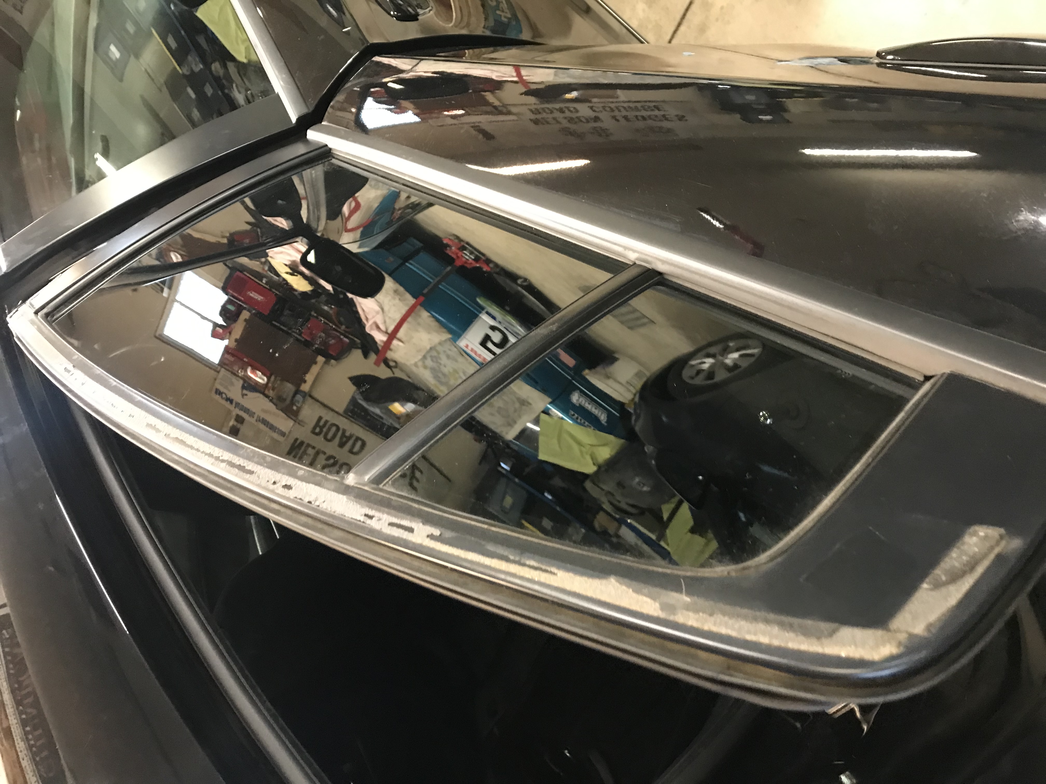

* Removed aftermarket window trim
These parts came off fairly easily, but the two sided tape holding them on took some doing to remove.

Obtained center console tray, remove factory 12v plug and replace with USB charging ports, and connected the courtesy light to come on when the doors are open
Did the final assembly of the console

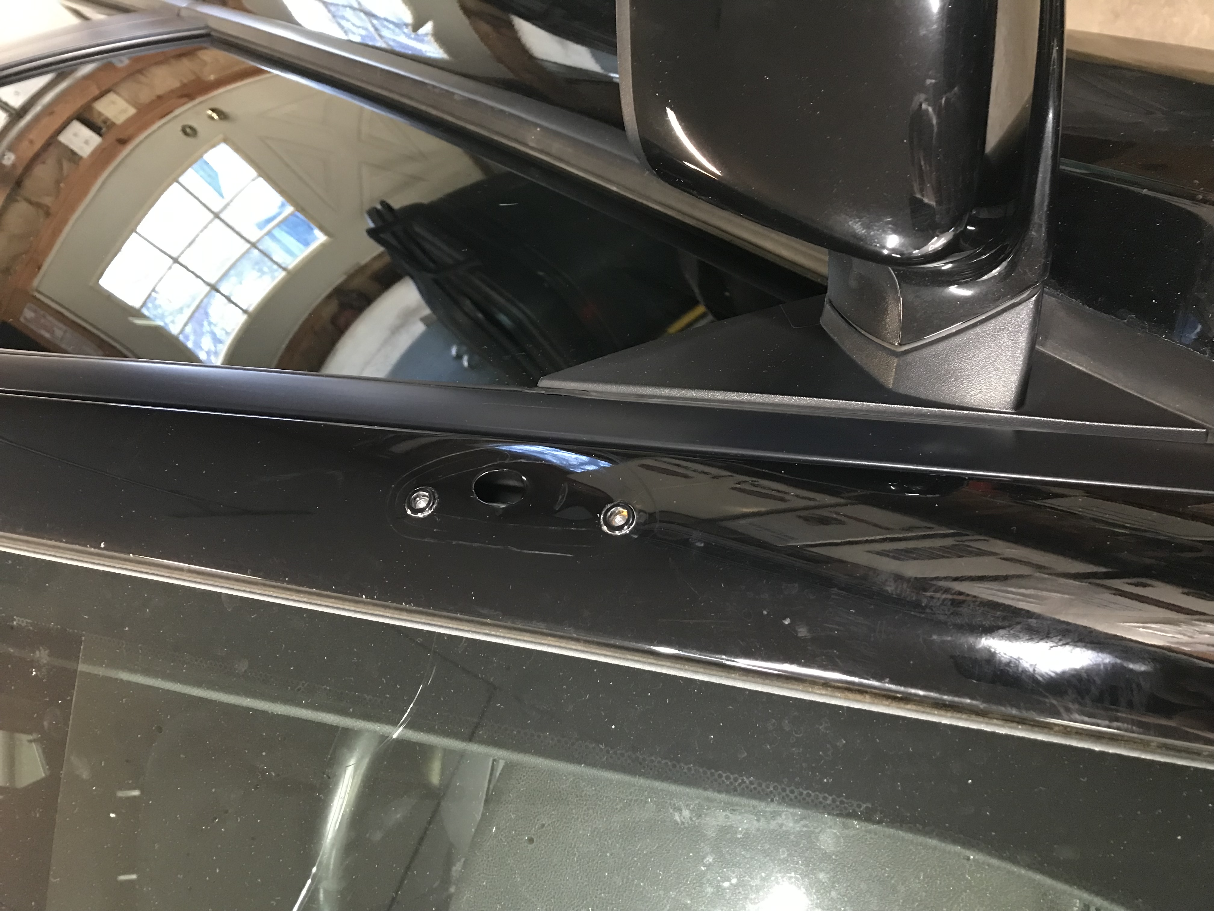

Removed the police spotlight. Obtained replacement A-pillar trim - will install after the A pillar exterior is fixed as I might need to go inside to install patch for exterior

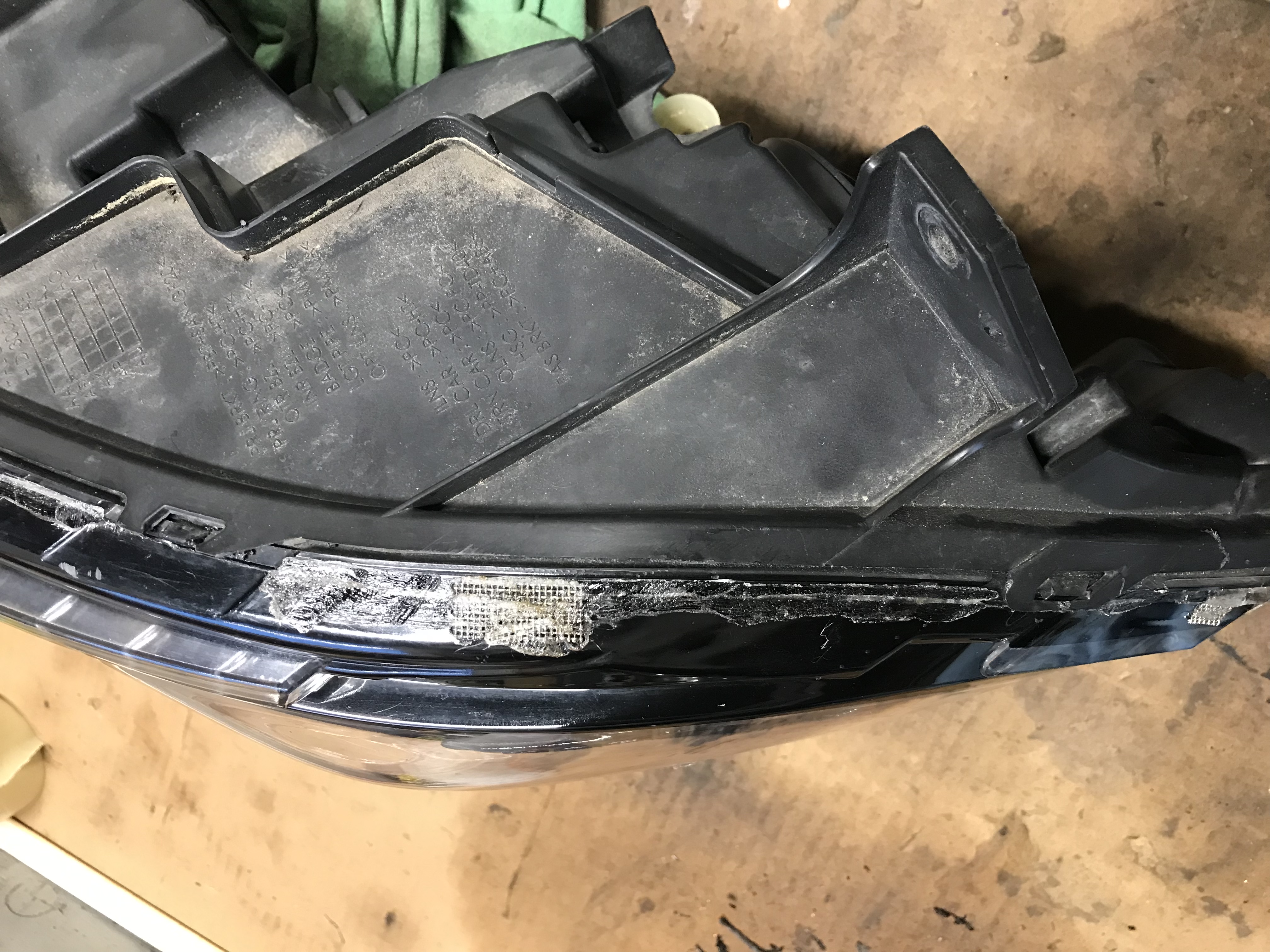

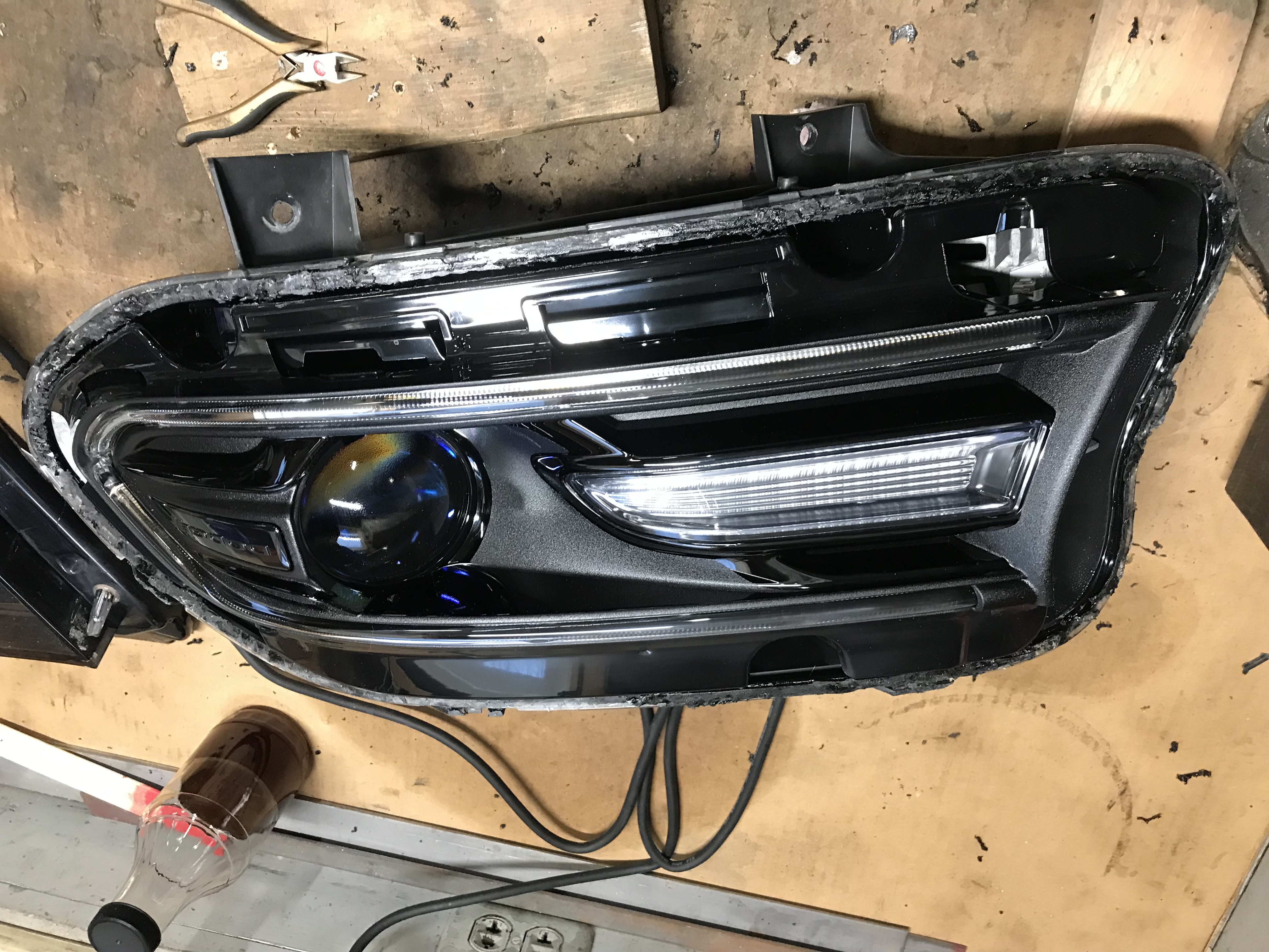

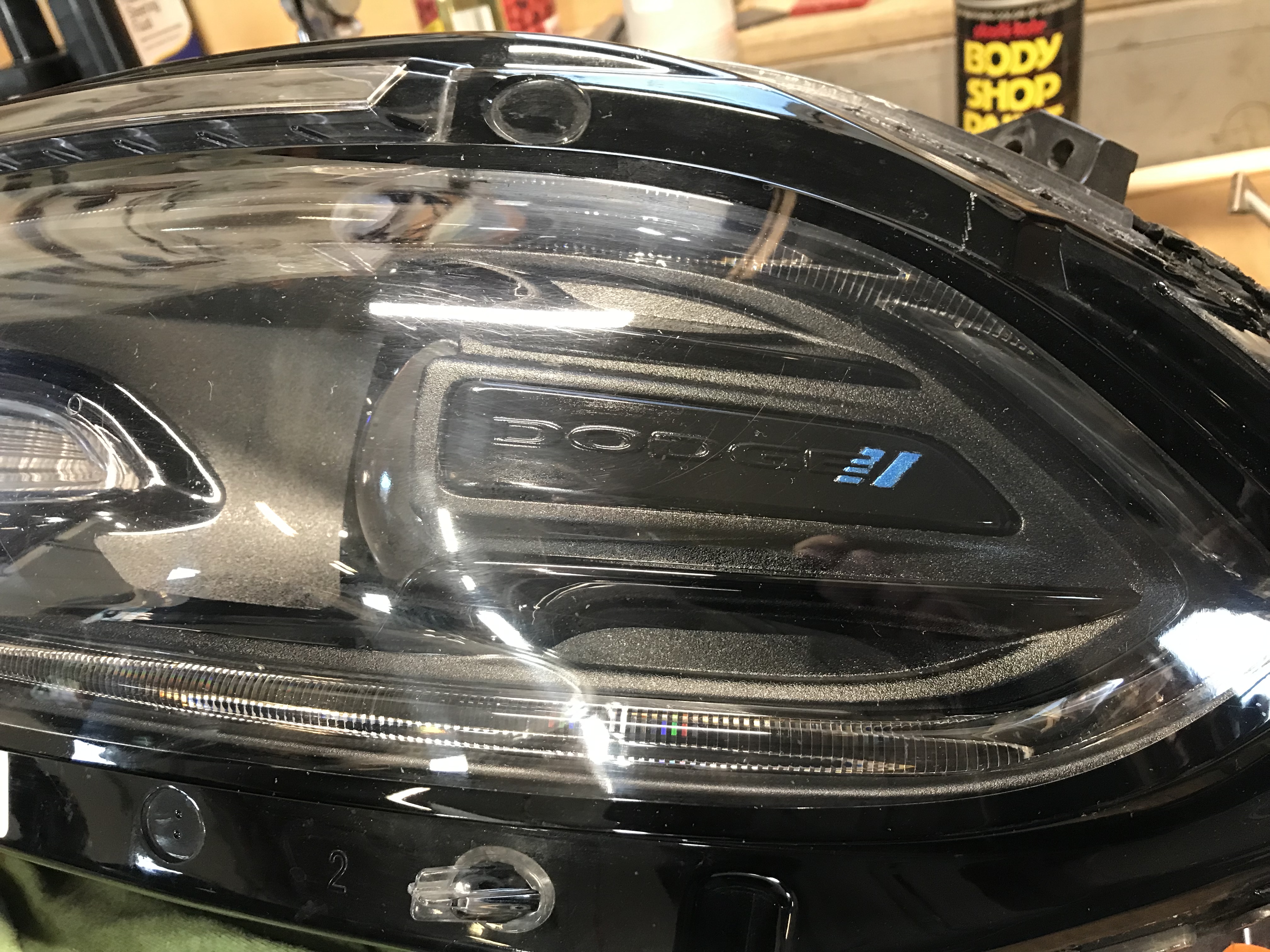

Obtained oscillating cutting tool and cut open the front headlights. The inside of the lens has some type of film on it that has dried up and cracked and fogs up the lenses. I cleaned up one of them.

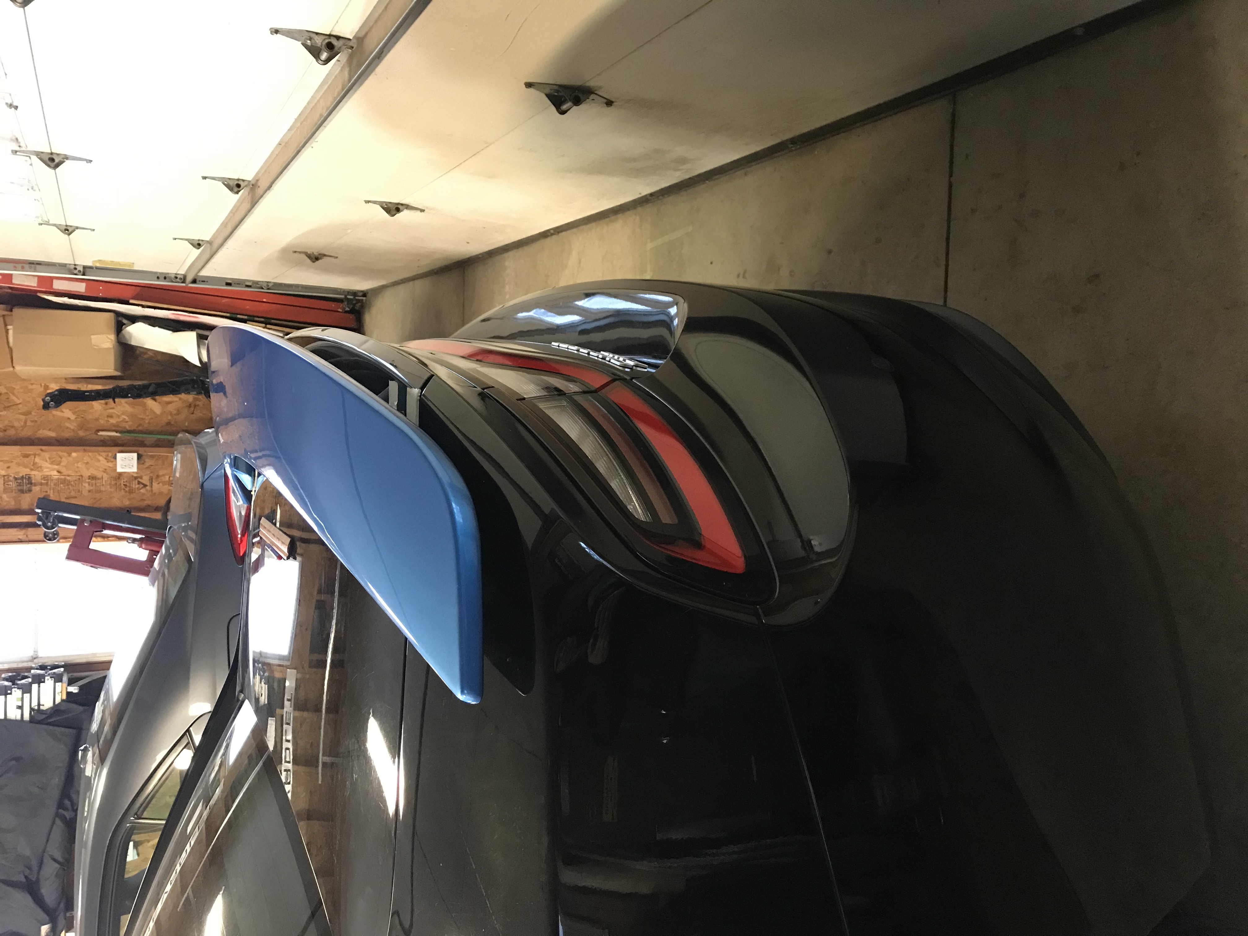

Found a great deal on a new rear wing painted to match ($70). Seller's feedback was not great but it was so cheap I took a chance and it worked out. Rachel liked the wing on the 2013 so this one is the same style.

- Finished cleaning up inside of headlight lenses and reassembled. Used small pieces of wire mesh and newly acquired plastic welding tool (wide end soldering iron) to secure the connection in 5 places, followed up by plastic welding about 2/3 of it for rigidity. Finally followed that up with black silicon to seal it up. This was the last mechanical type thing to do on this car. When it’s done there may be an exhaust upgrade and different rims, but basically from here on in its bodywork.

- Rear wing is fitted and installed – then removed in prep for paint

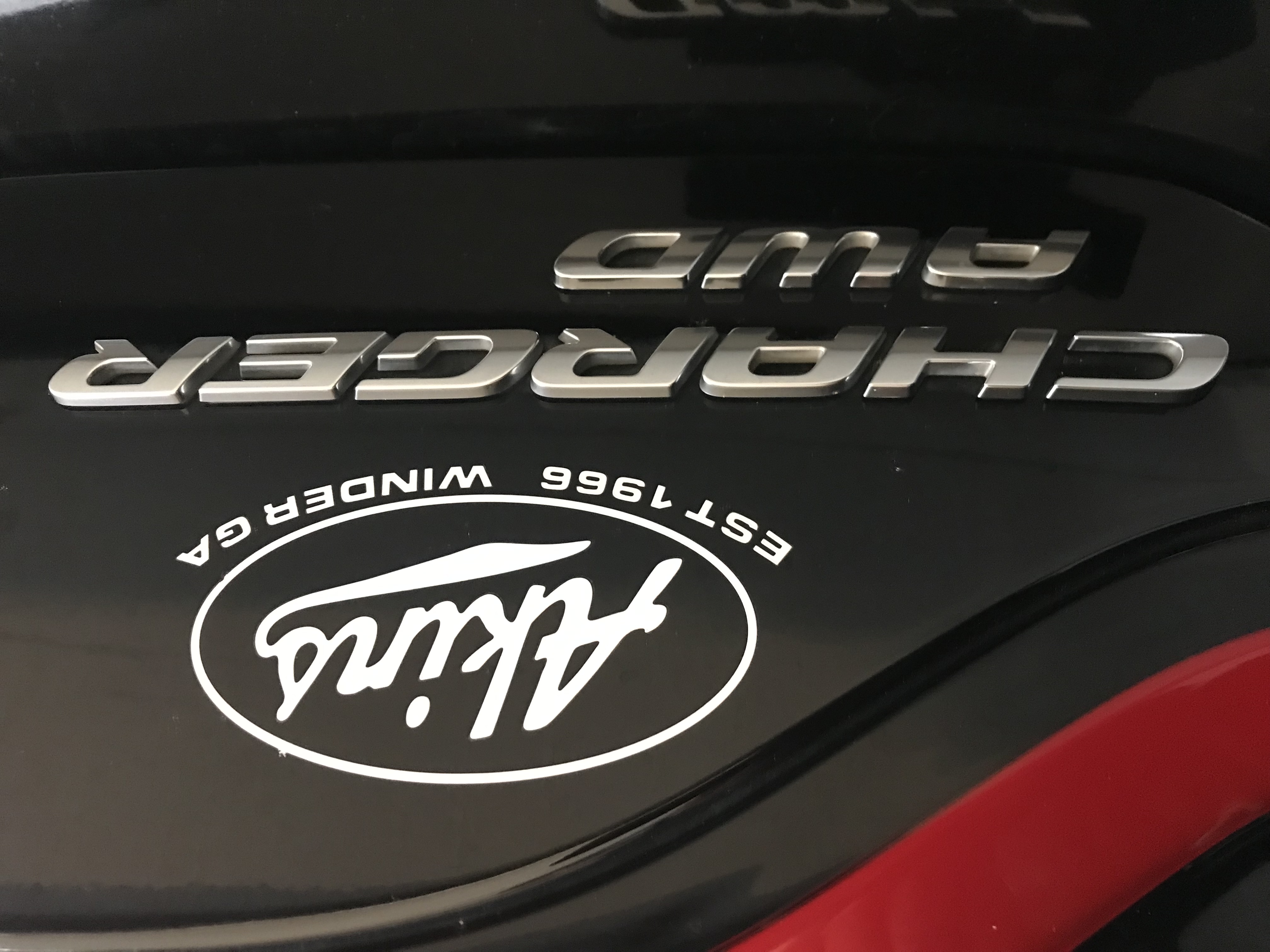

- Remove Charger AWD emblem – made a template for reinstall, also removed the center of the rear lights on the trunk, and the backup camera

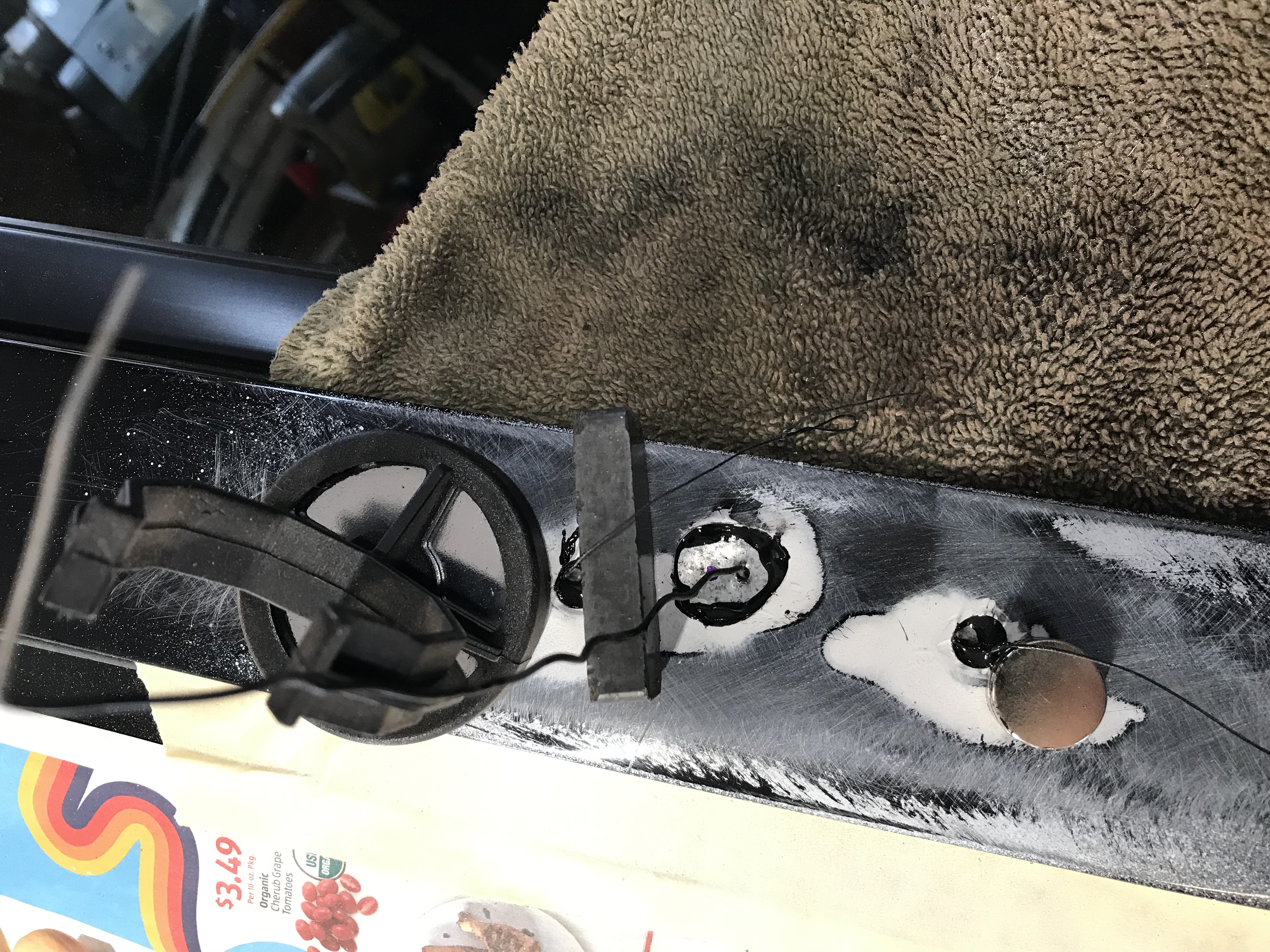

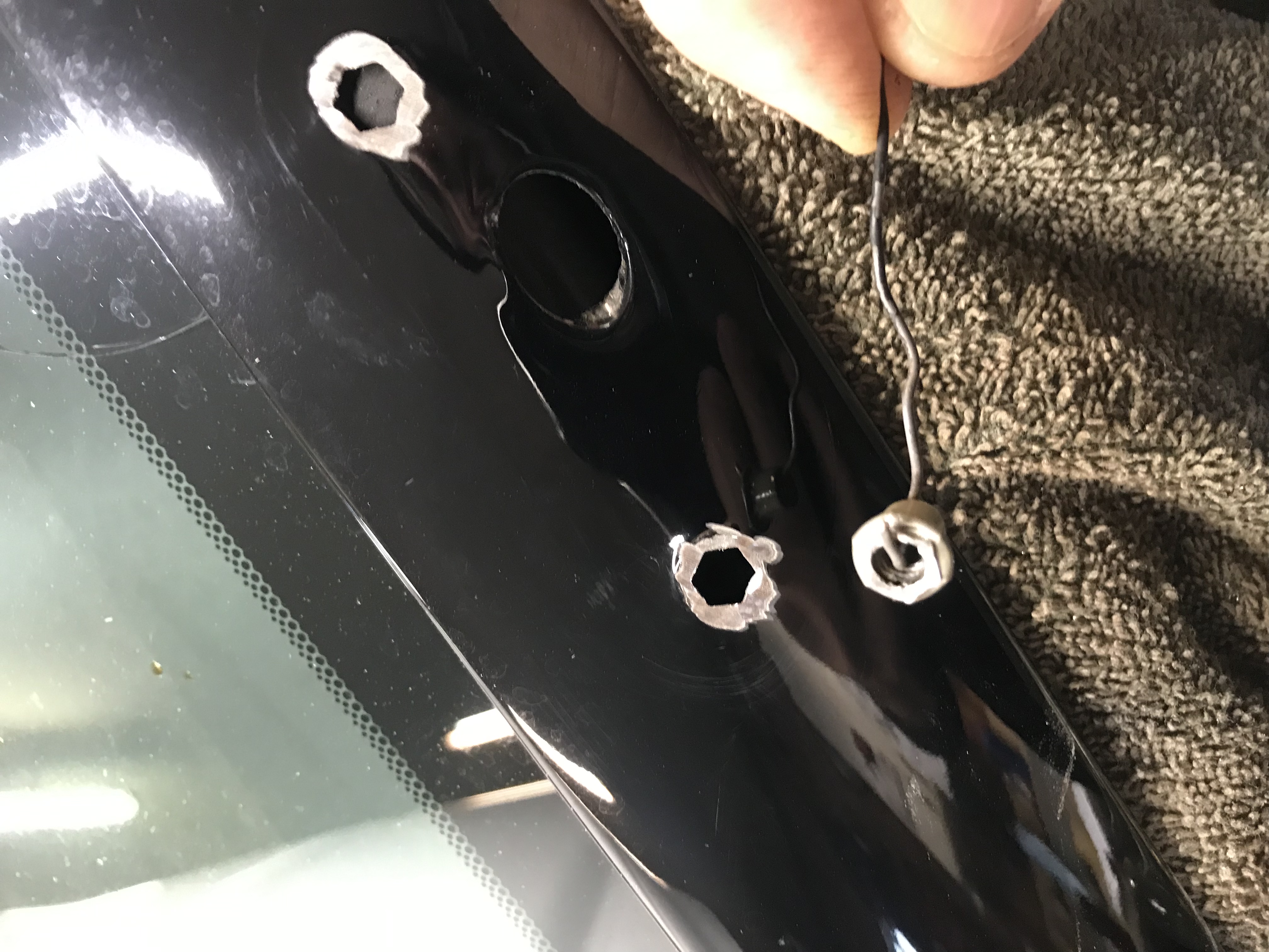

- Fill the holes in the A-pillar from police spotlight. Fabricated some metal pieces, and secured them on the inside of the pillar using metal bonding adhesive. Covered that with fiberglass reinforced body filler. Still need a little more shaping with glazing putty

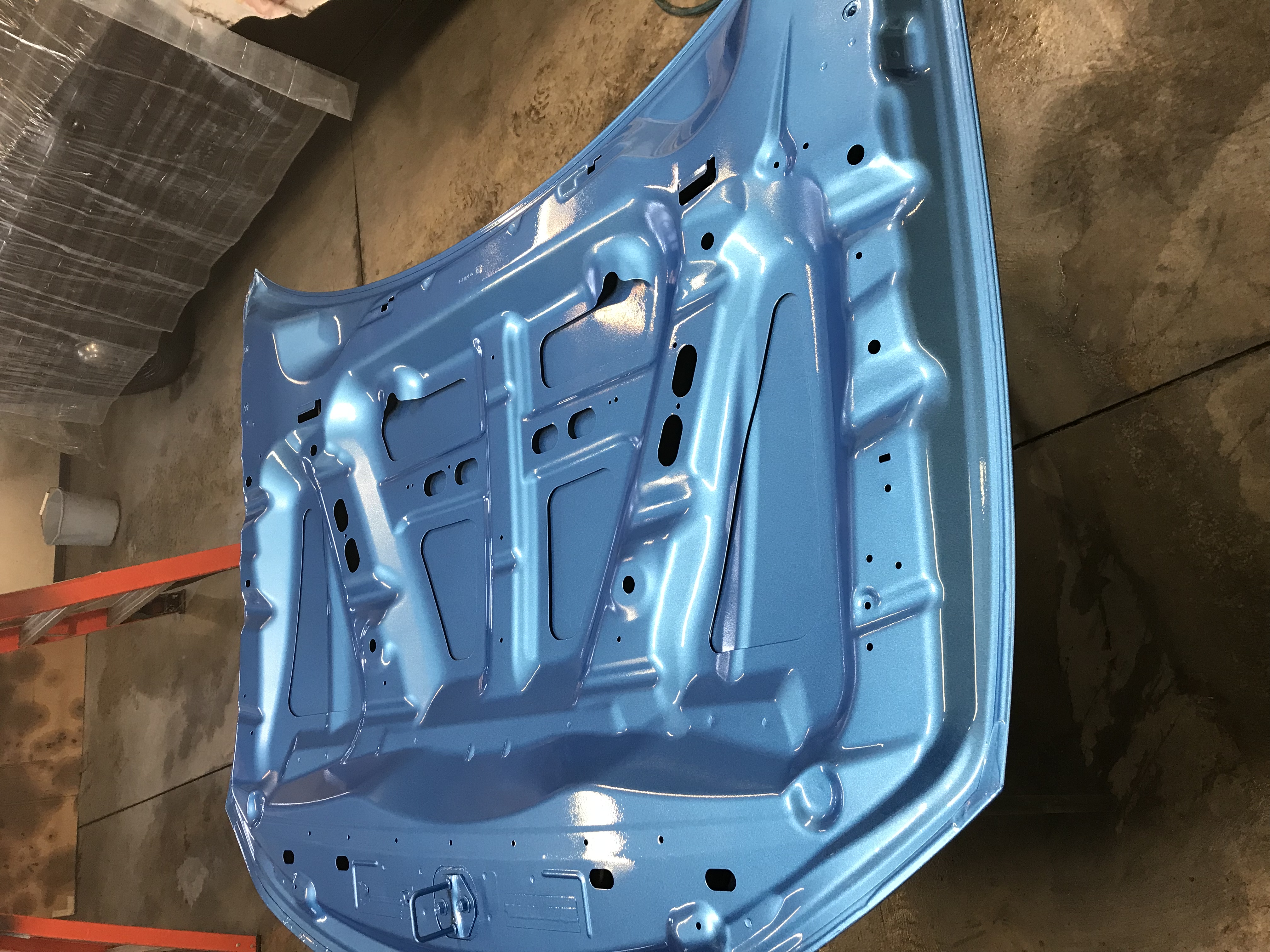

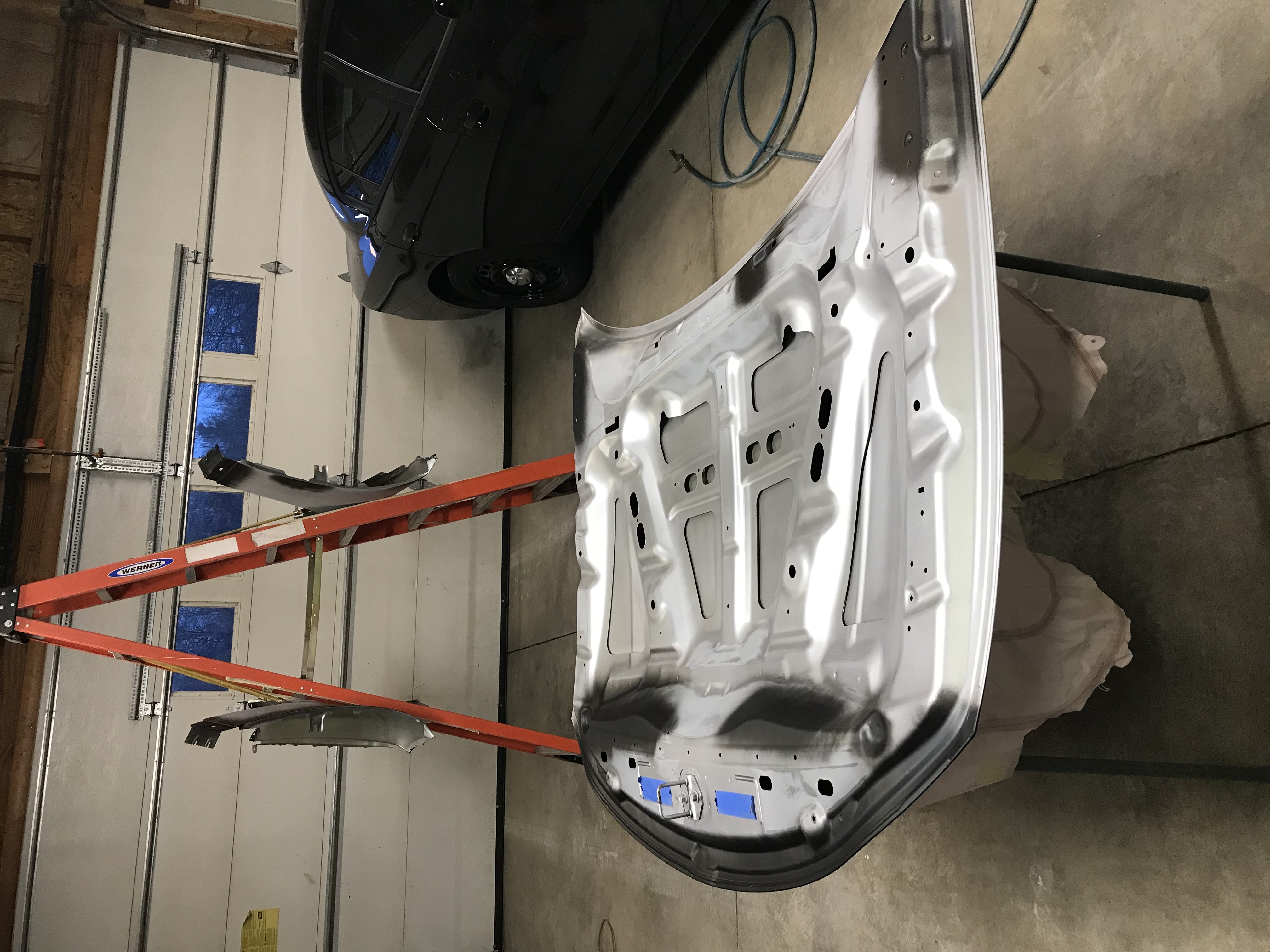

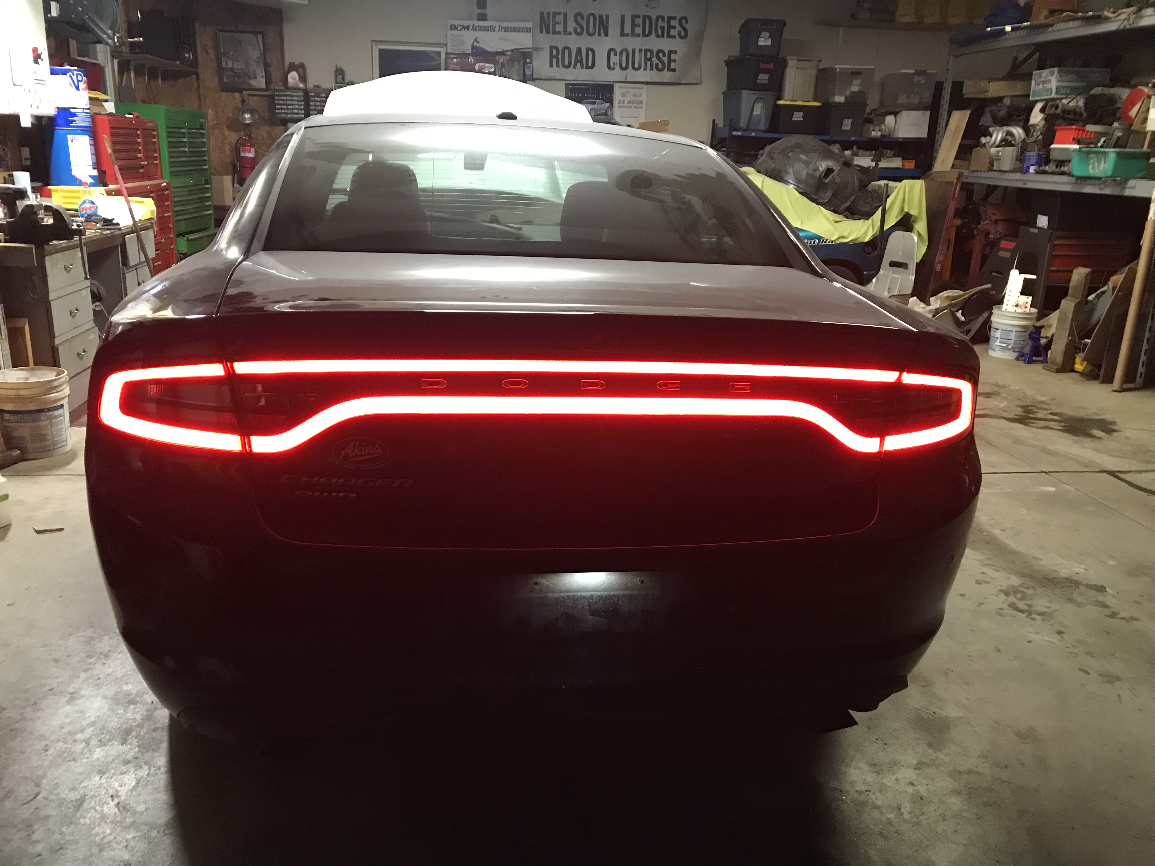

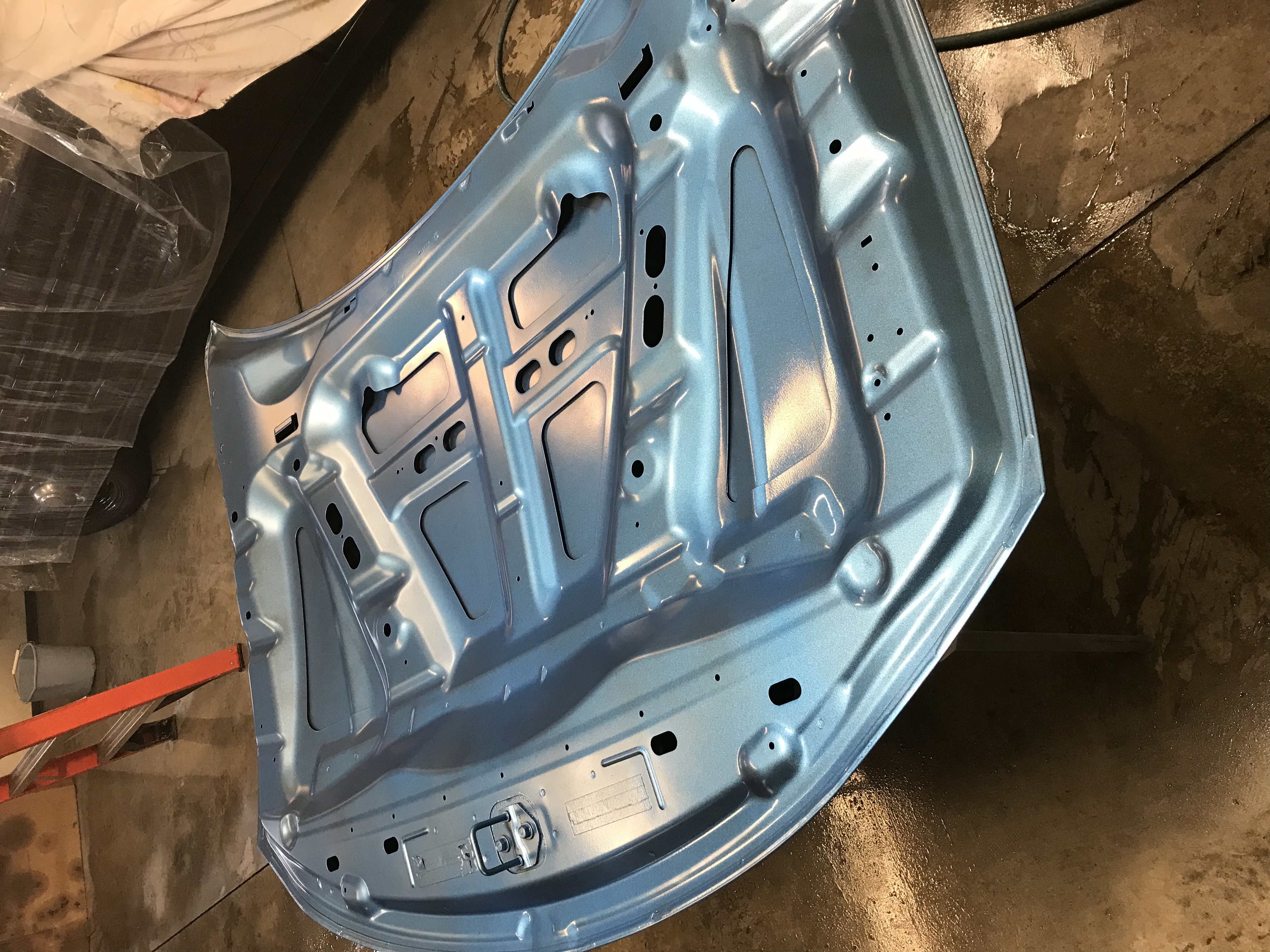

Put some color on the bottom of the hood and inner edges of the front fenders
Posts: 2641
Re: 2019 Dodge Charger
I laughed at the third thumbnail, thinking something was gonna be Saturn Teal. That's B5 Blue?
