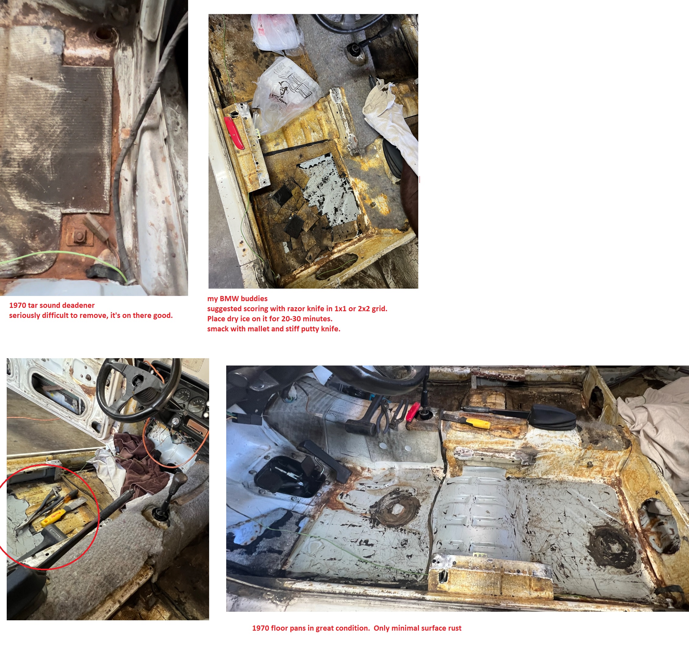

1. I used dry ice to remove all the old floor tar.
score into 1" or 2" squares. Chill with dry ice for 30 minutes. Smack with plastic hammer. Pops right off.

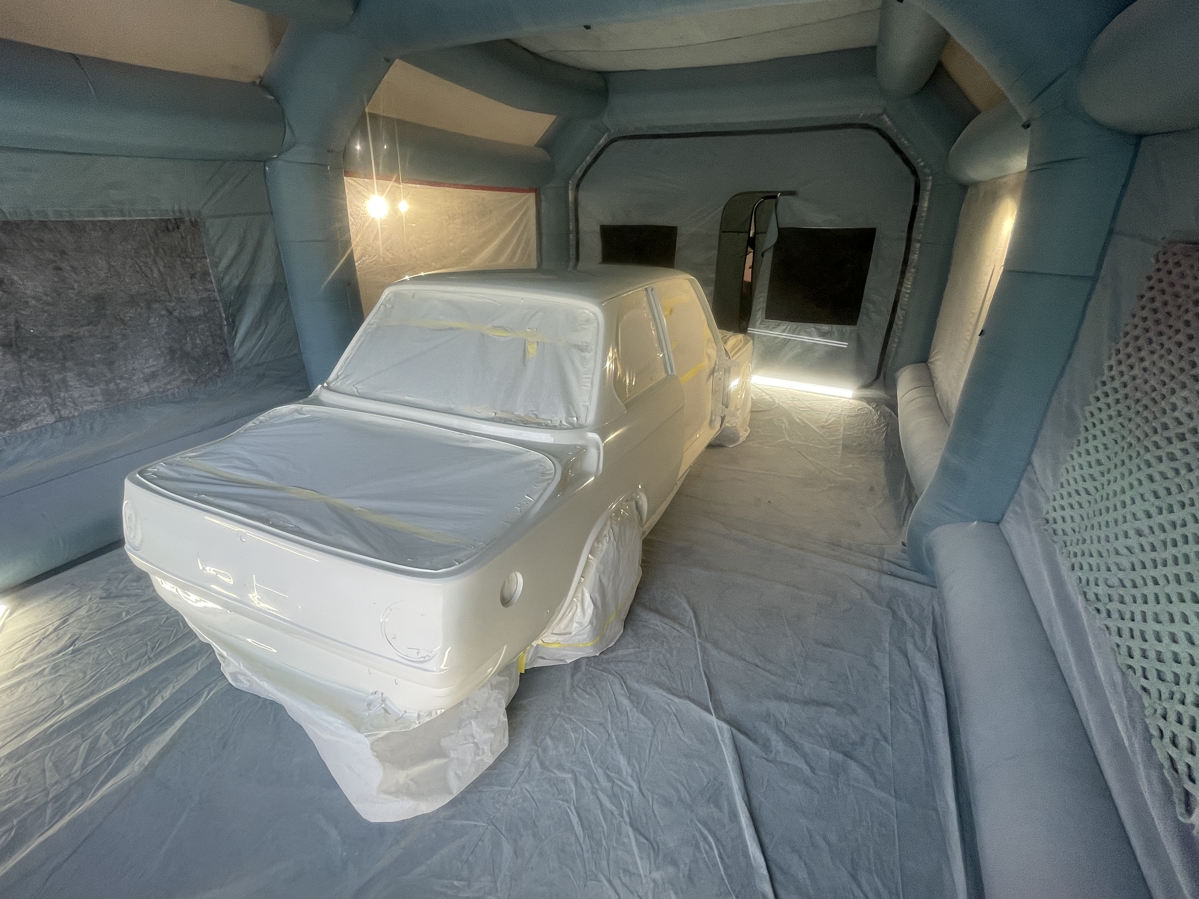

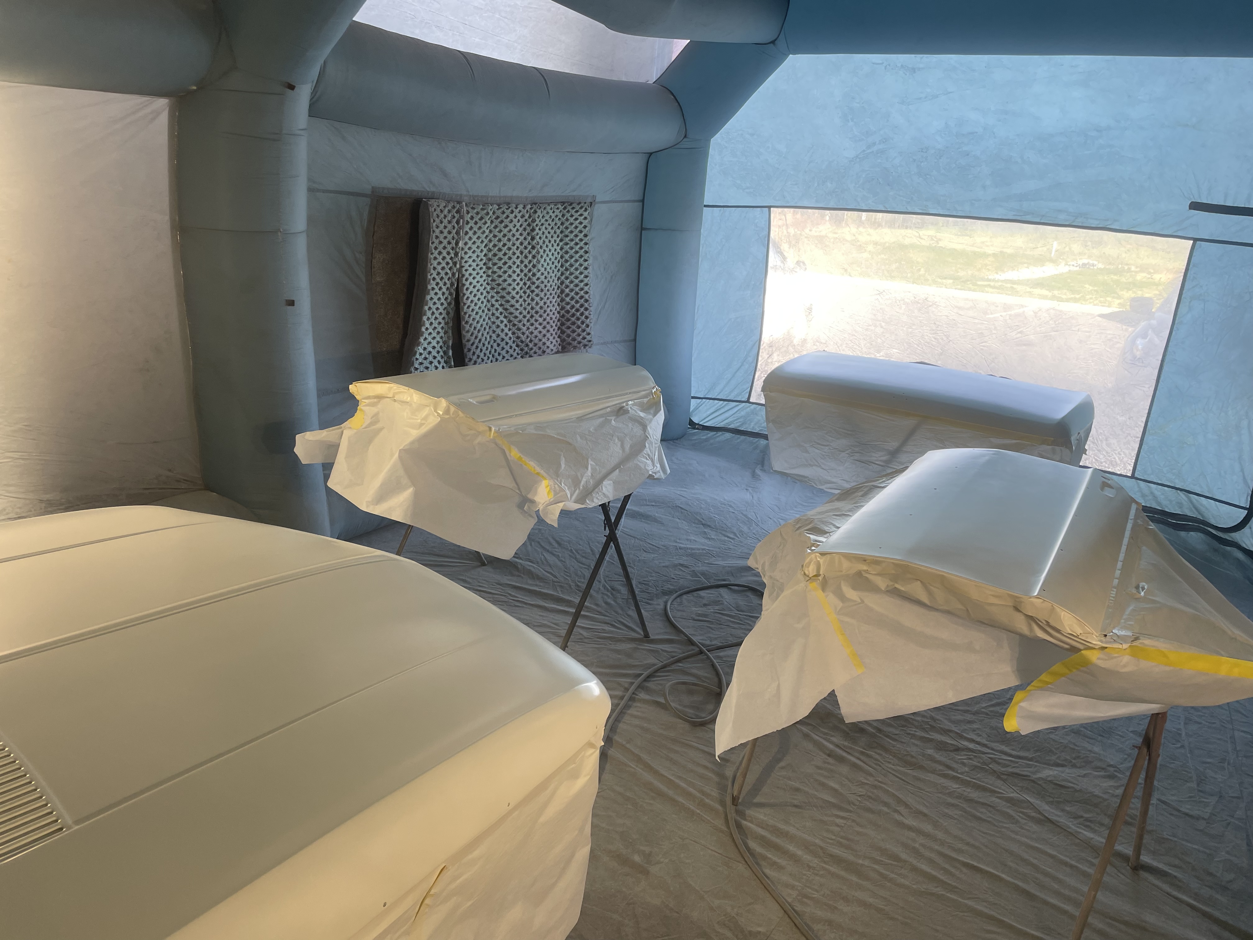

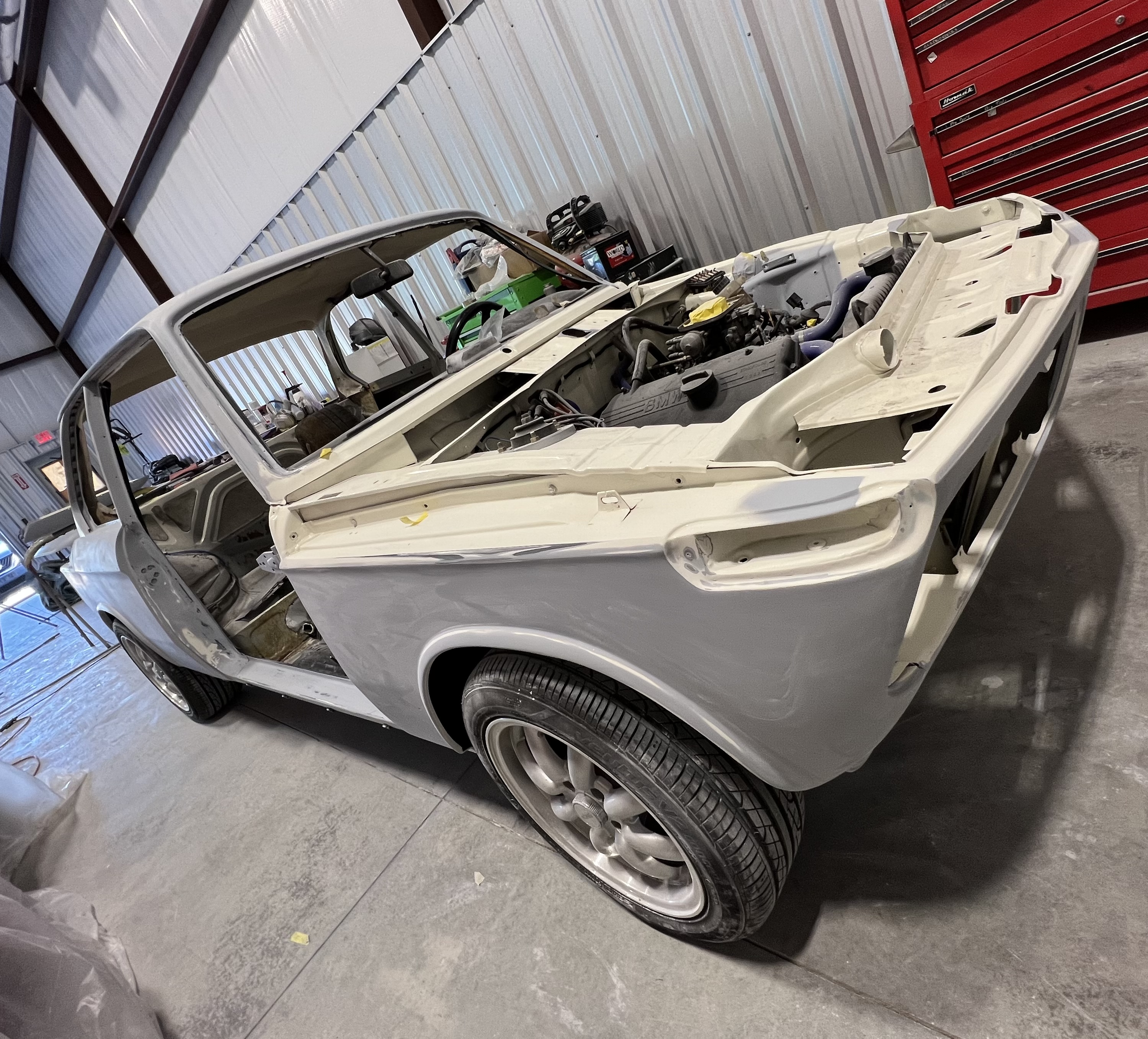

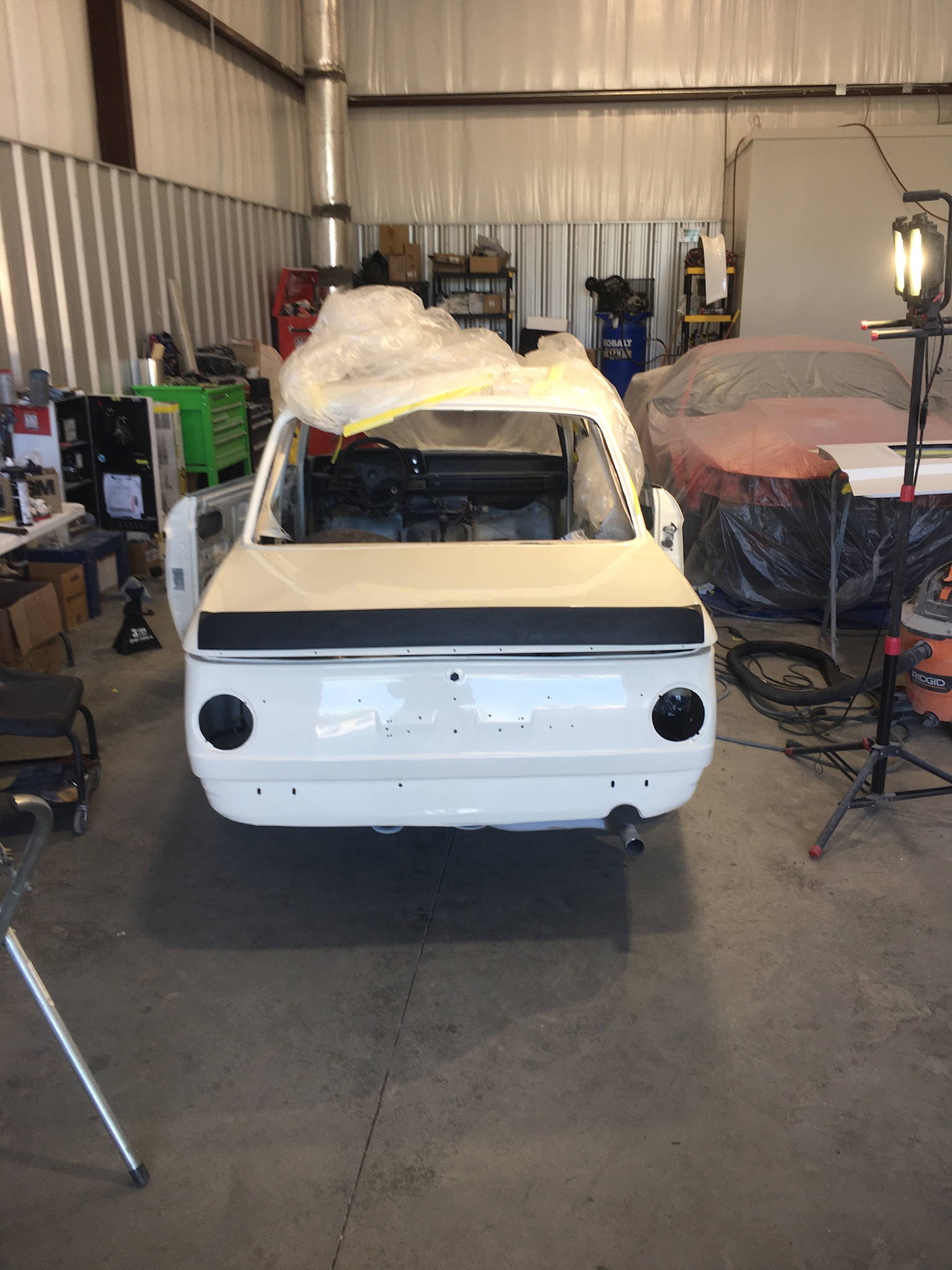

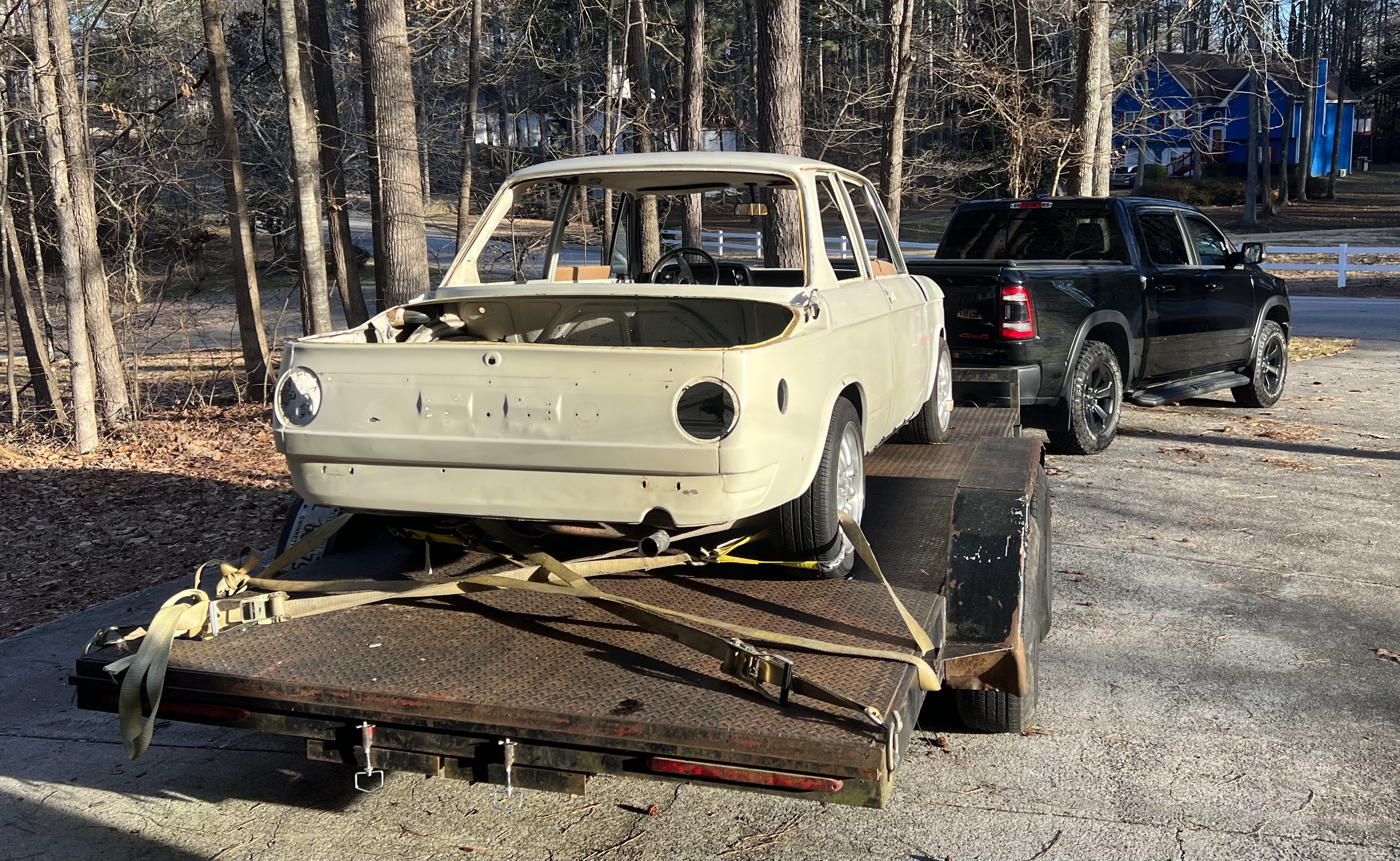

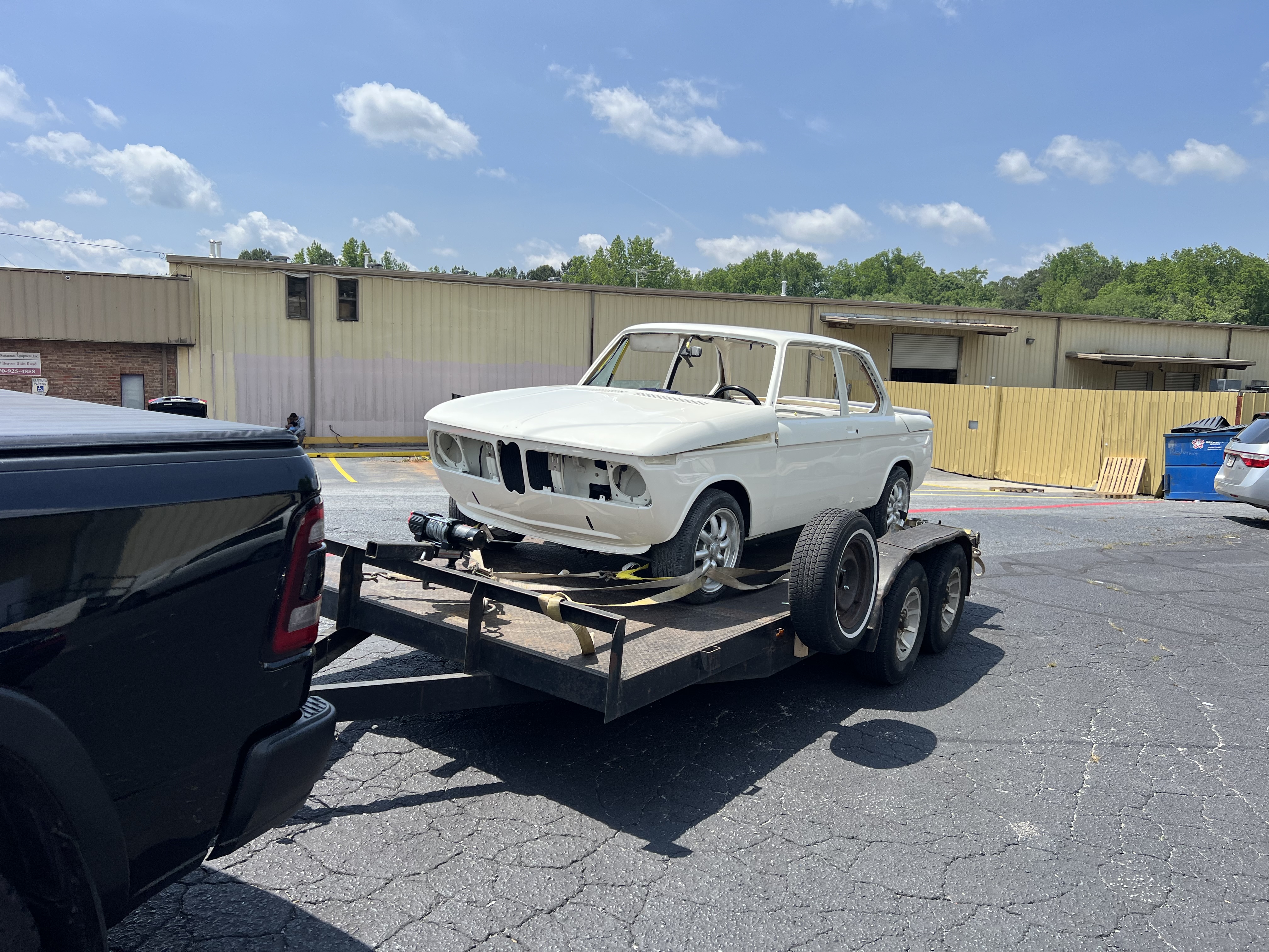

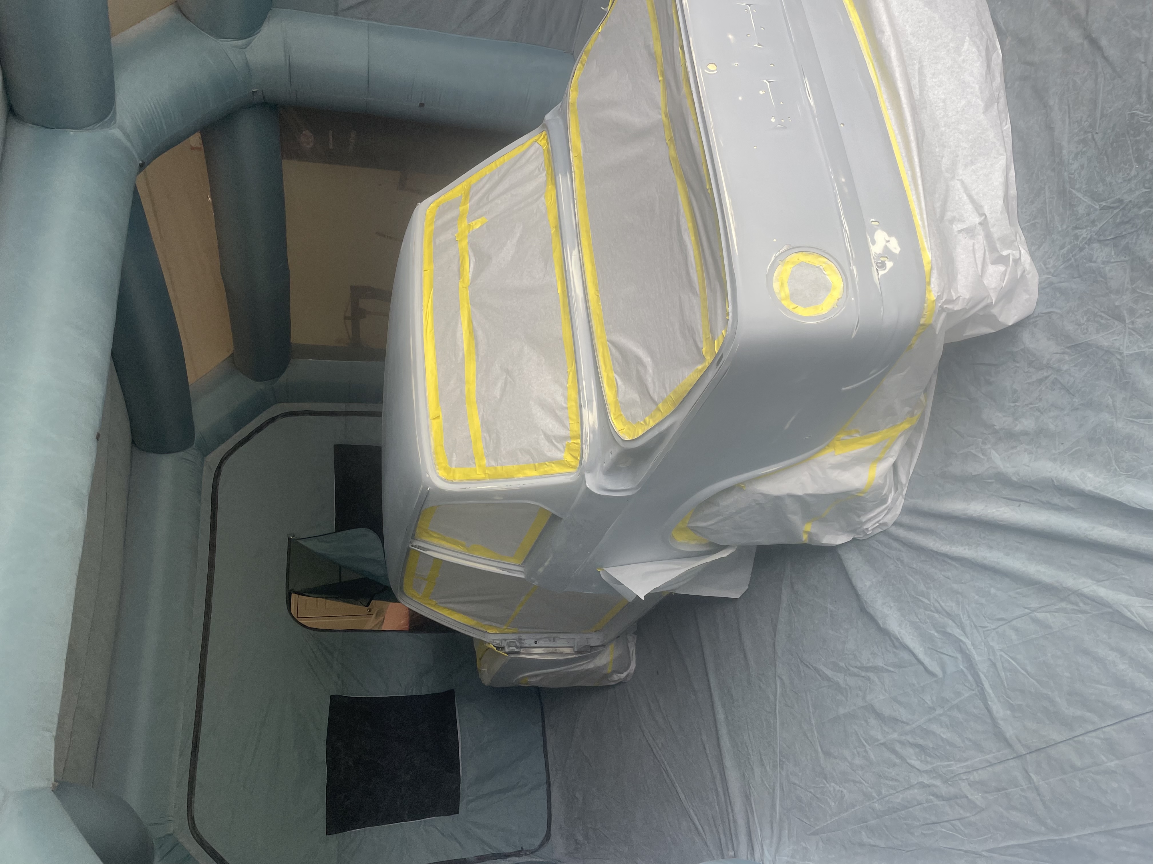

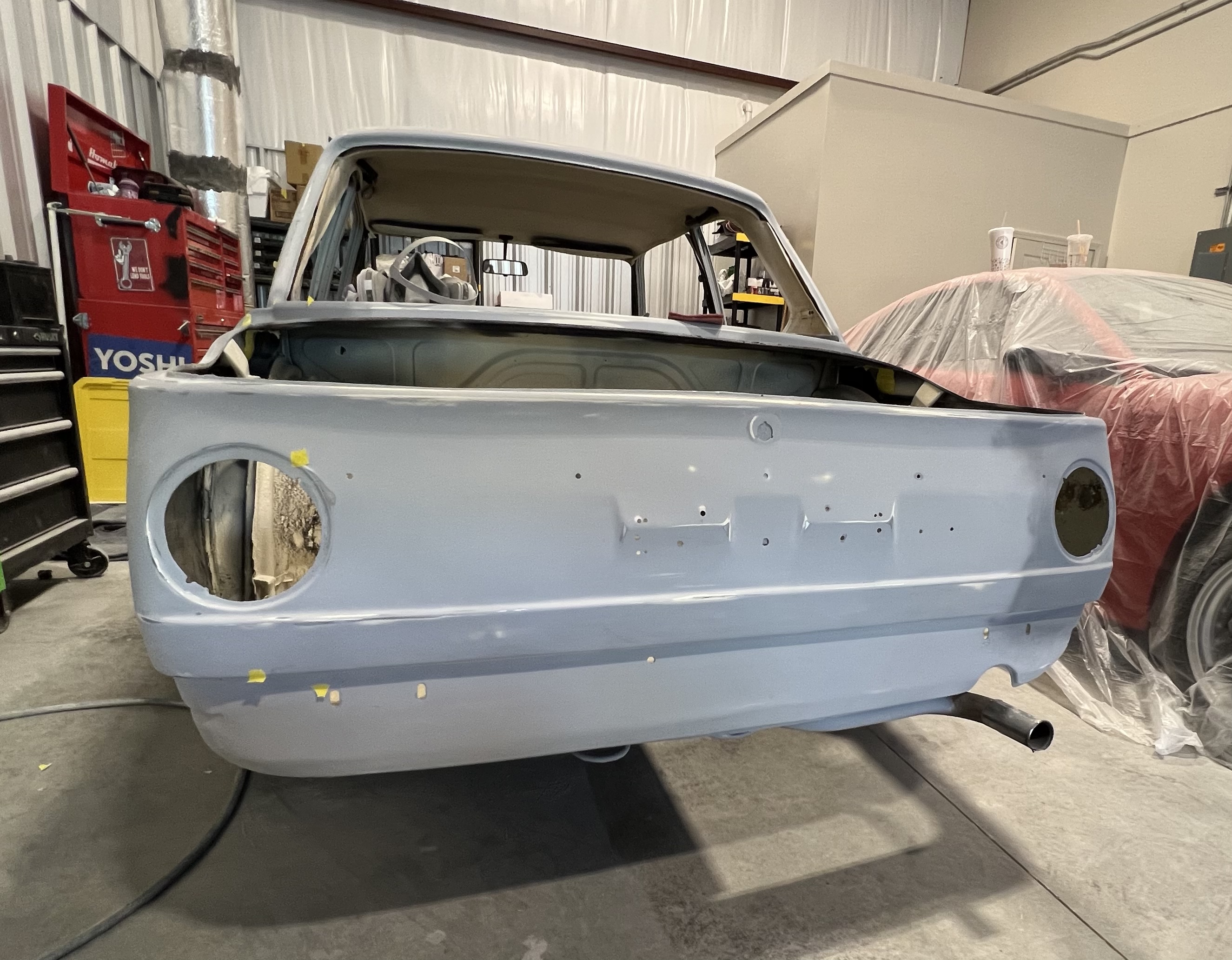

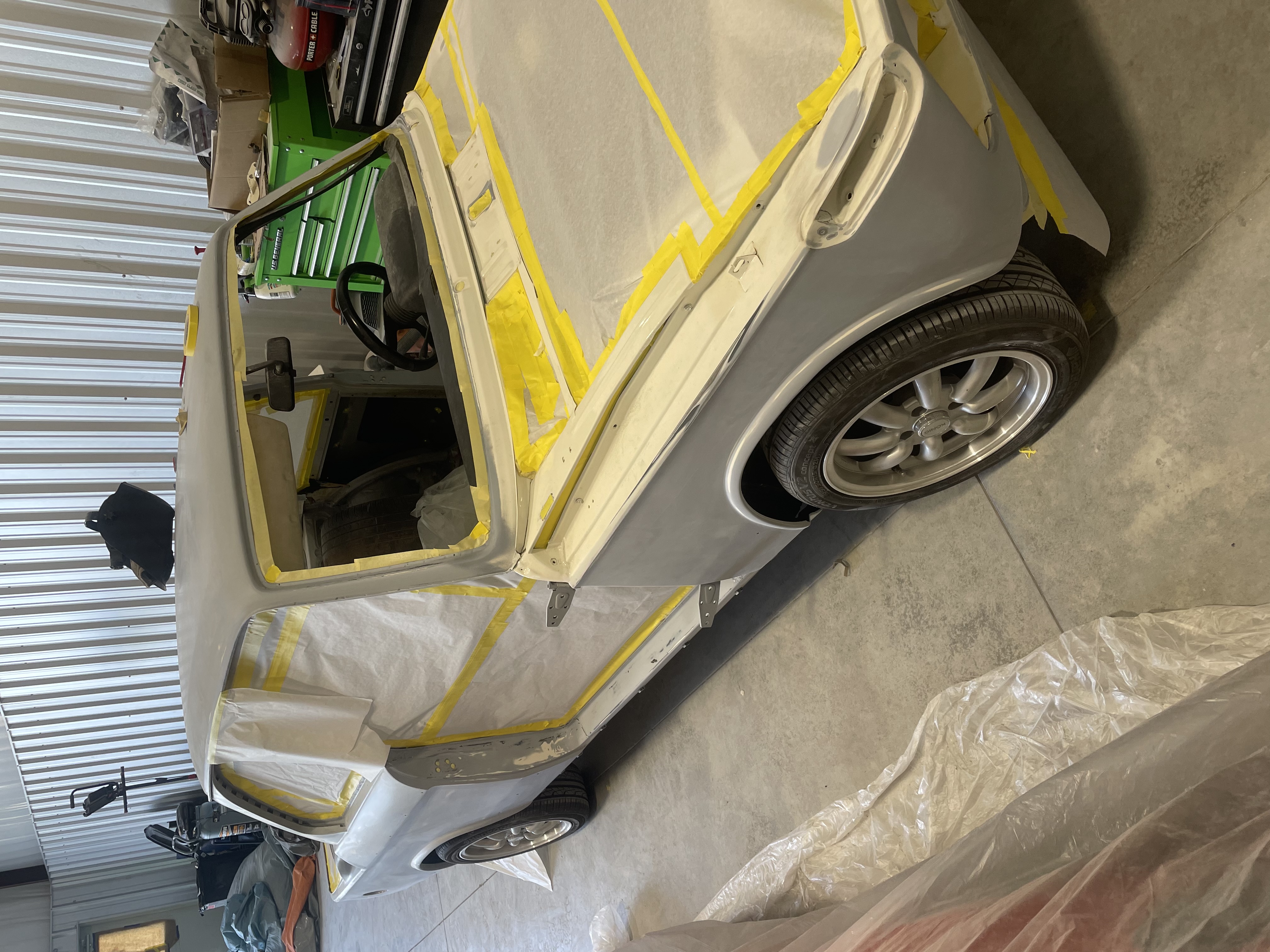

Drop off
Body work
Prep
Paint
Back home.
Home
Home
Off to painter
Off to painter

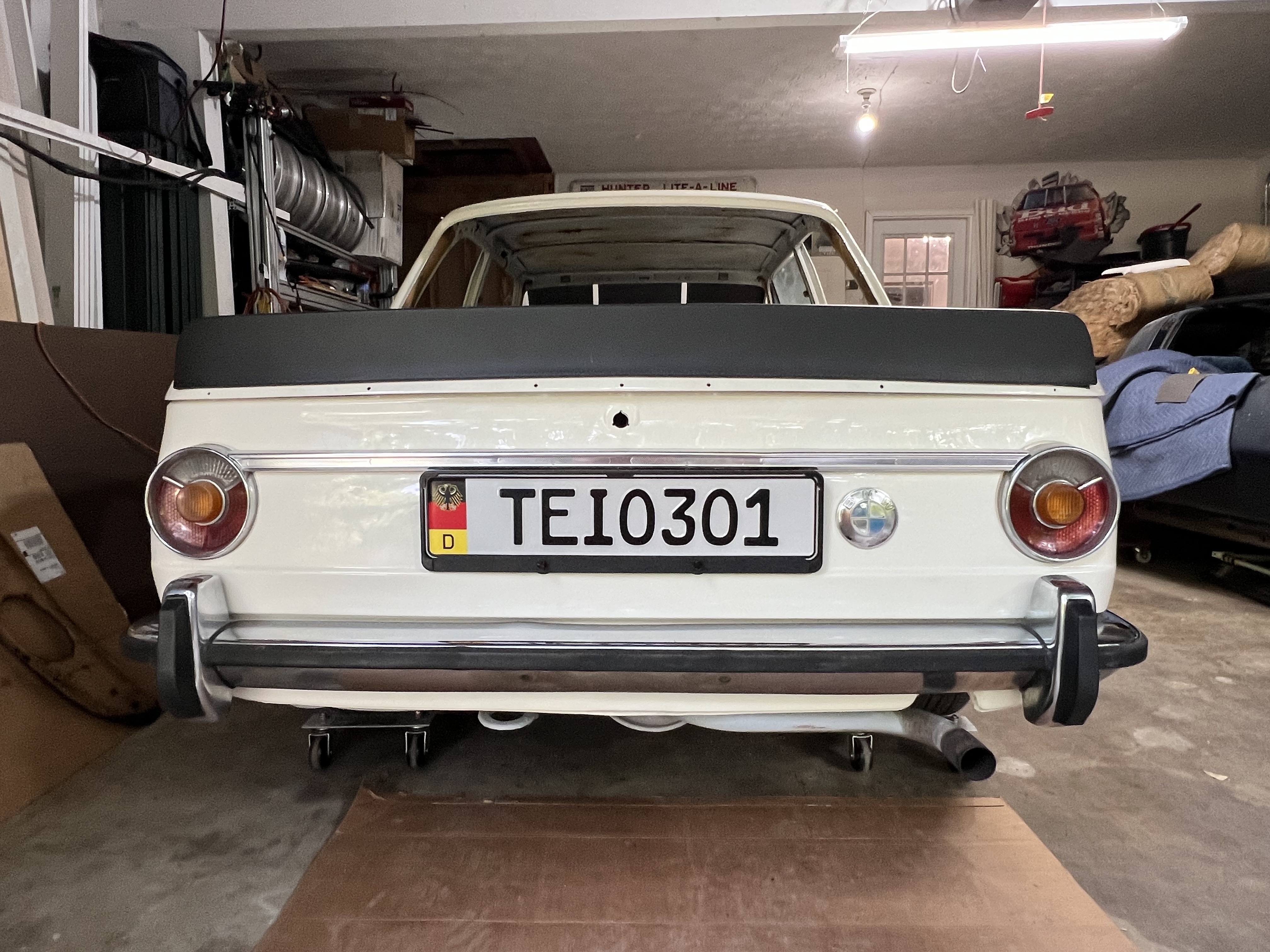

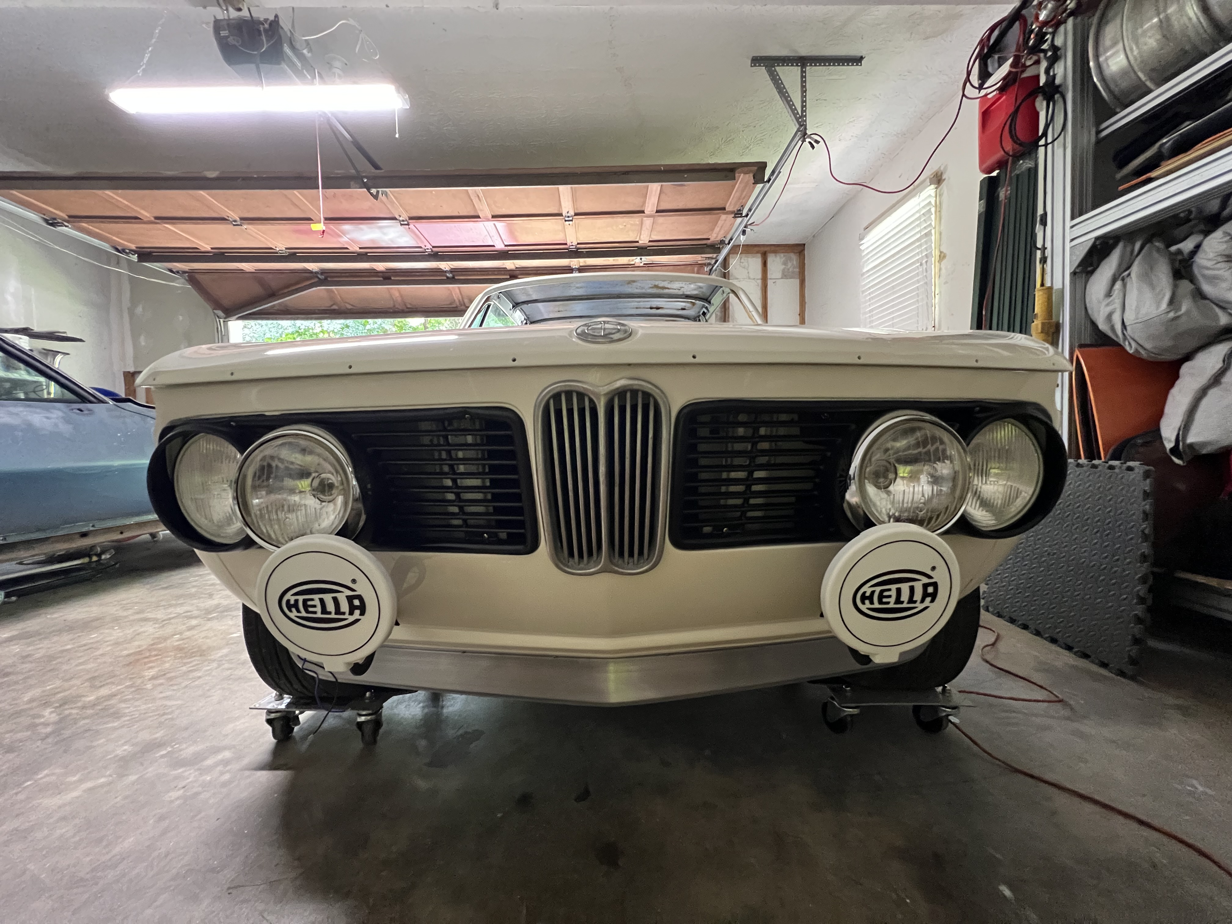

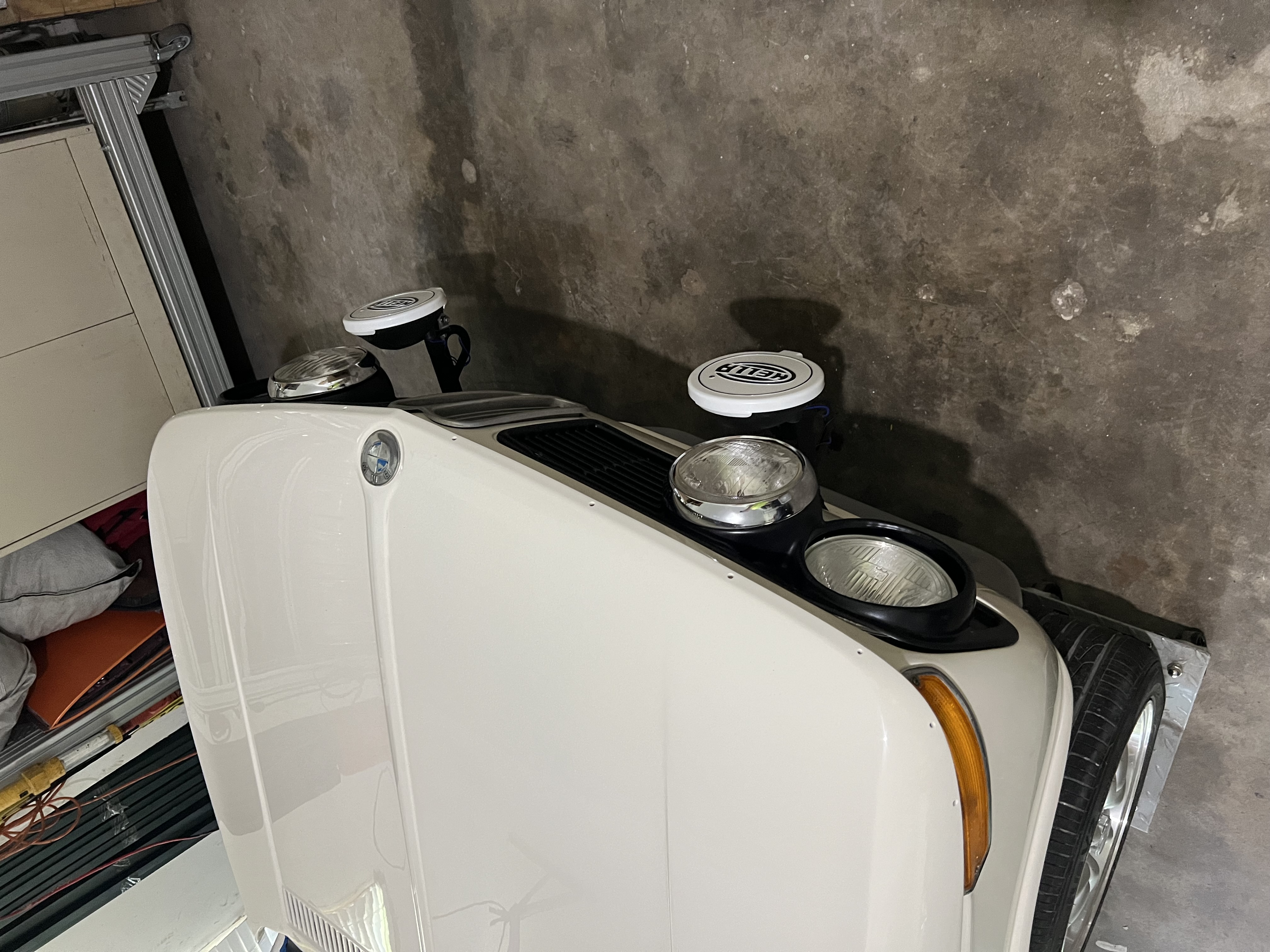

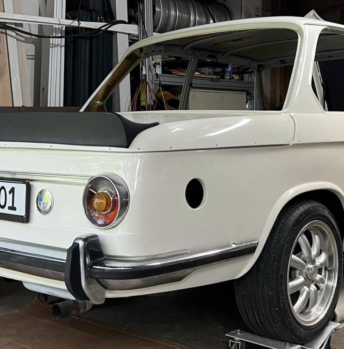

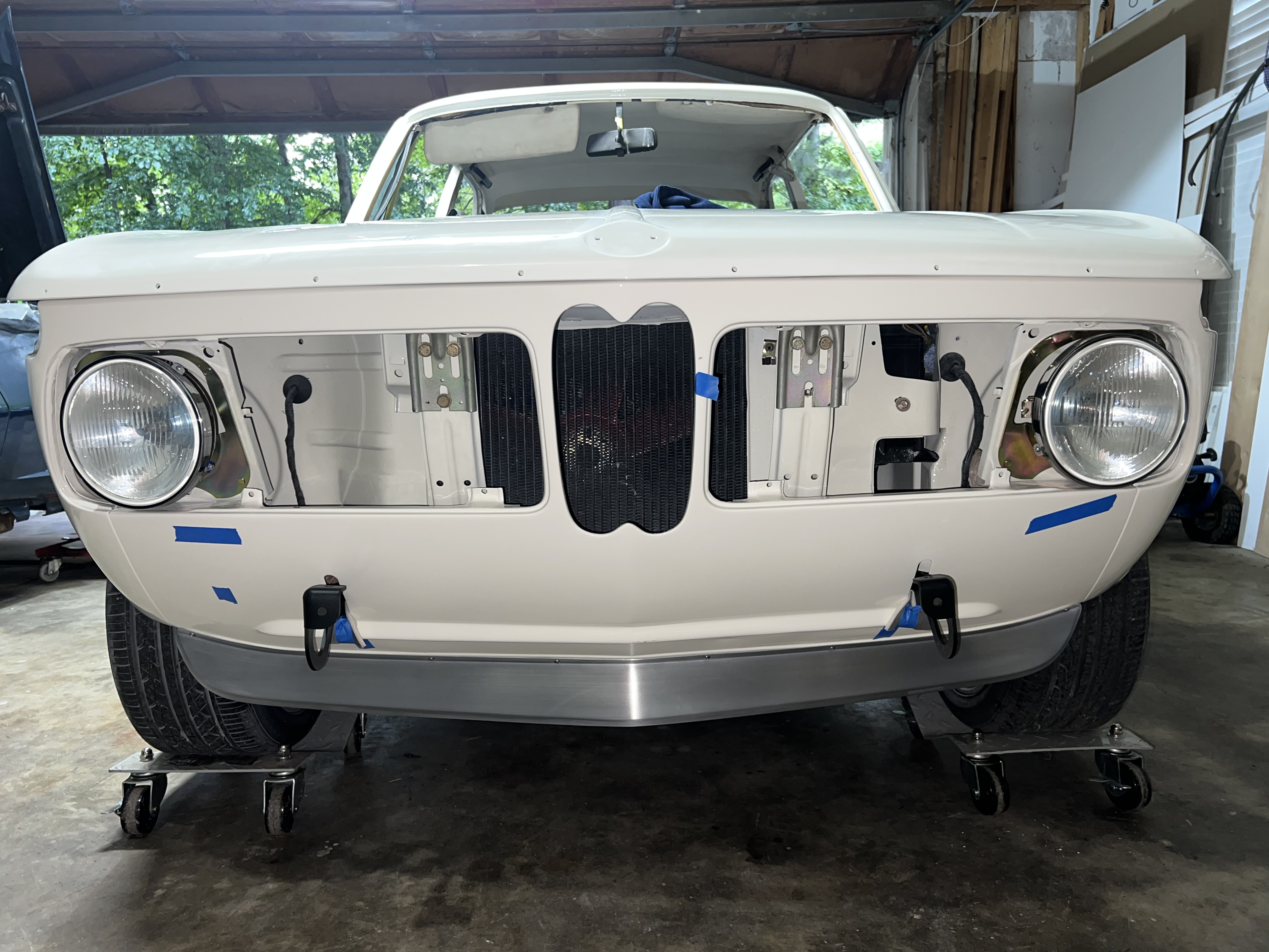

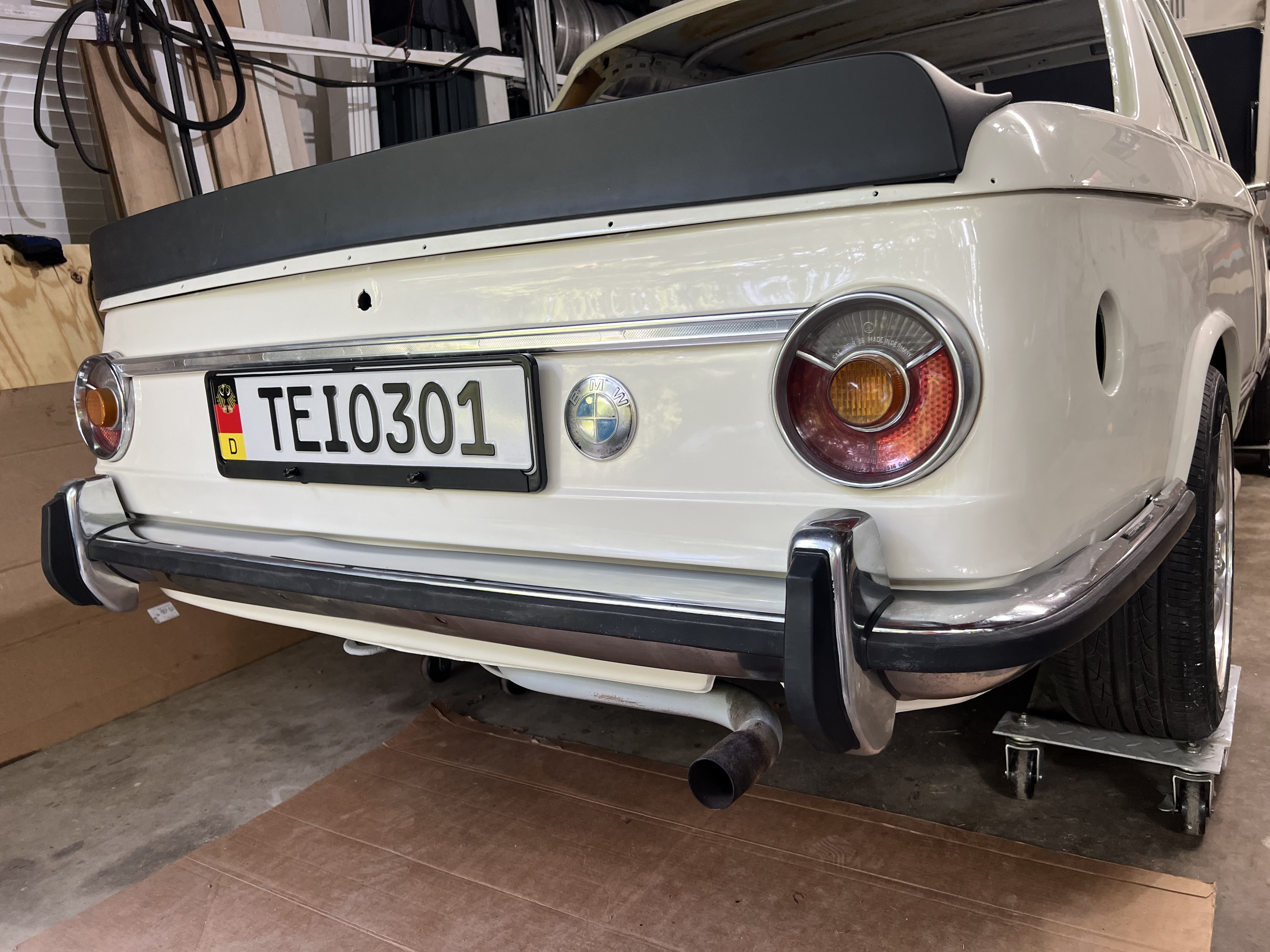

Some more pictures.
