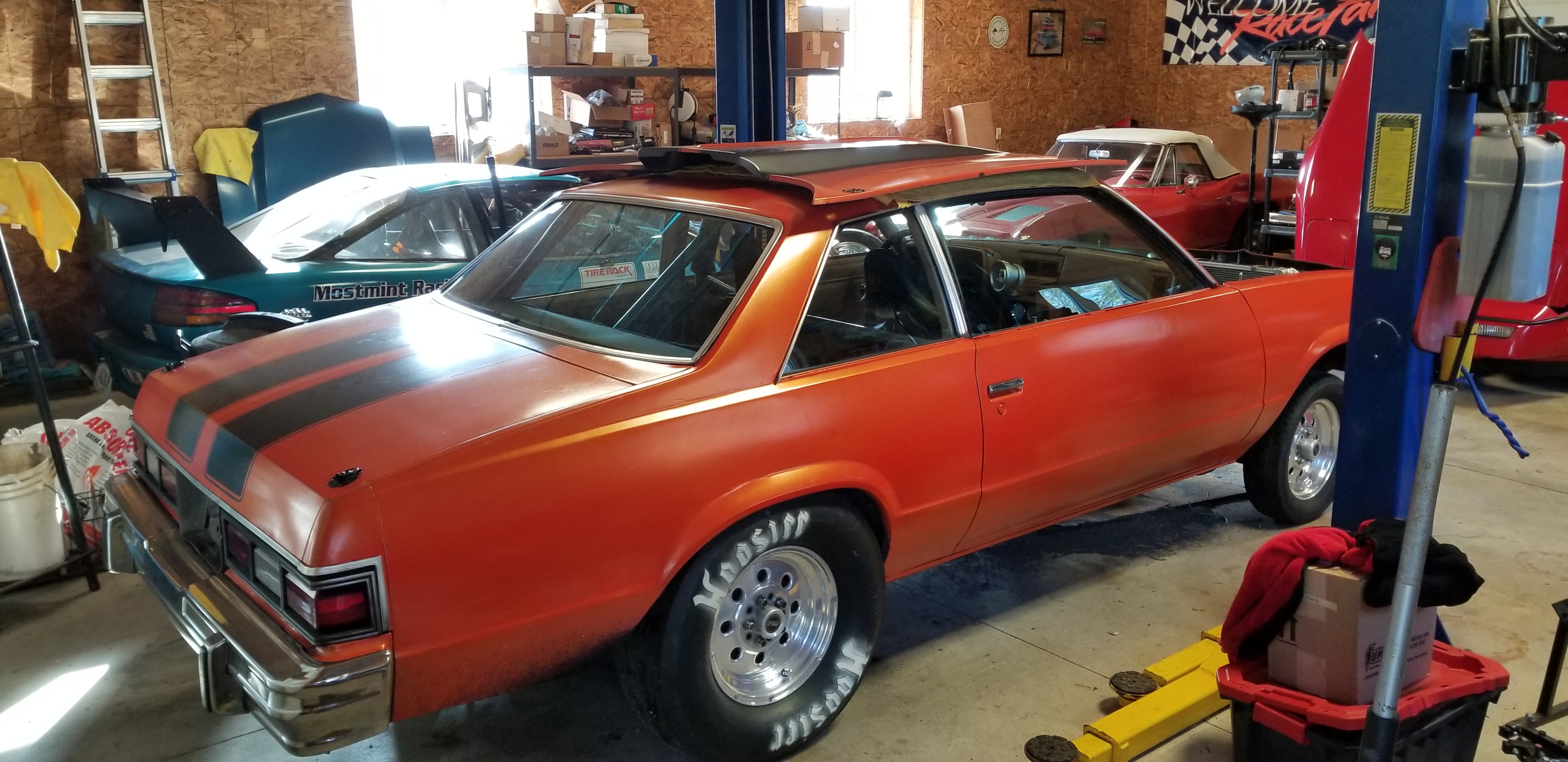

Small, but important step of progress made today...
Posts: 399
Re: 1979 Malibu
Baby...it's cold outside!
Where did you put the Chevelle?

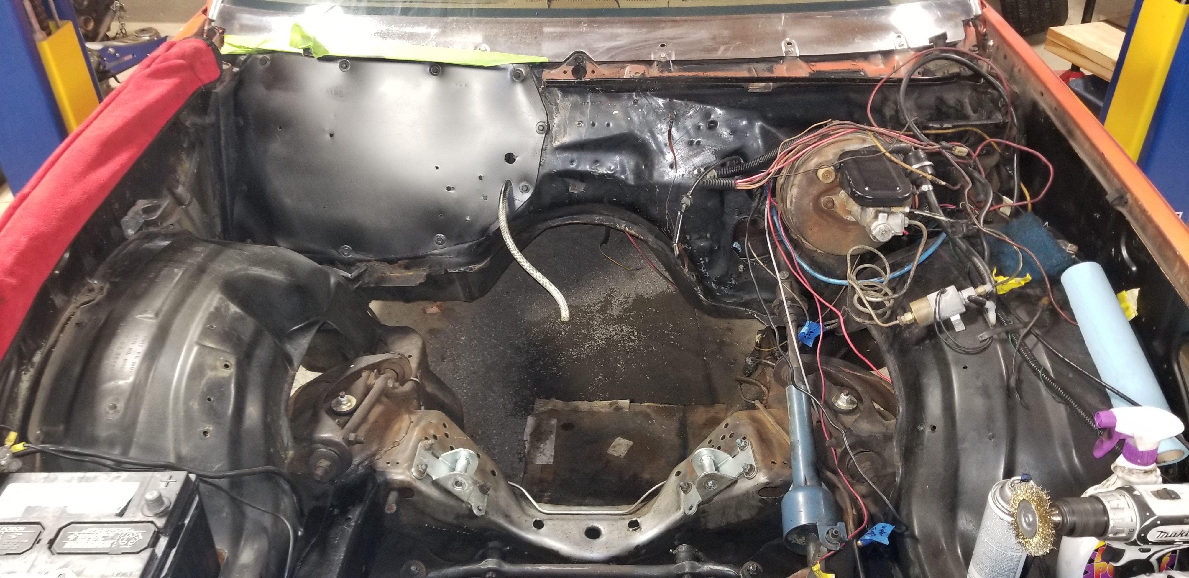

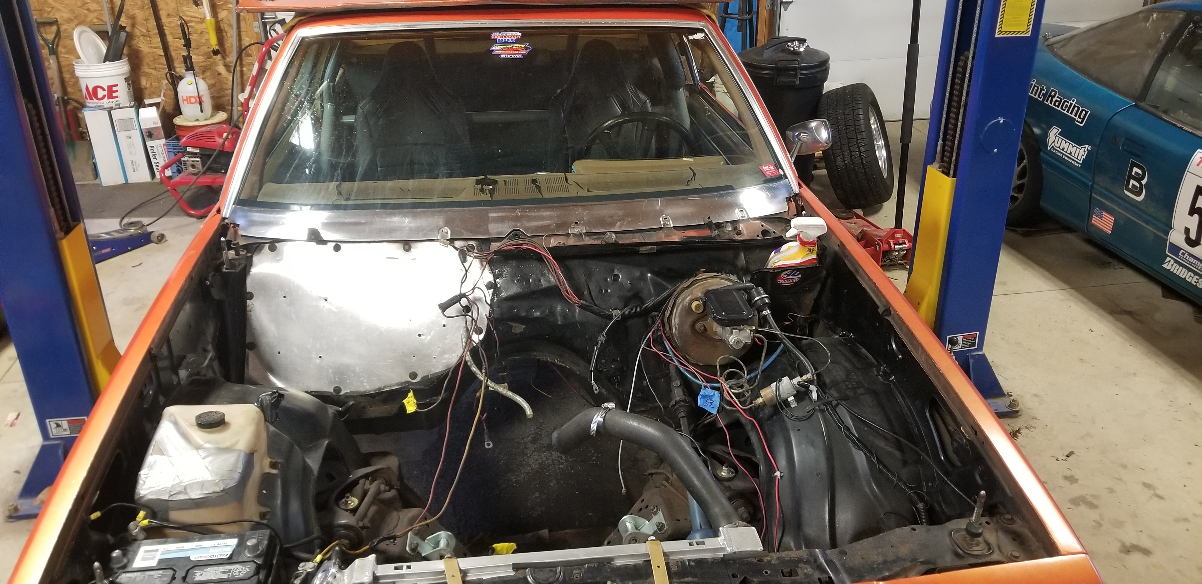

Spent some time cleaning up the engine bay. I got some crud removed from the frame/cross member, but still have more to go. I sprayed everything down with a good soap/water mix, some foamy engine brite, and then hit it with the pressure washer. I think I might need to still wire wheel a few things. Once everything is cleaned up, I'll hit it with a fresh coat of black. I also wanna replace that duct-taped radiator overflow.
Posts: 3678
Re: 1979 Malibu
A layer of black paint would tighten it up for sure. I like the whole vibe of that car though.
Posts: 2644
Re: 1979 Malibu

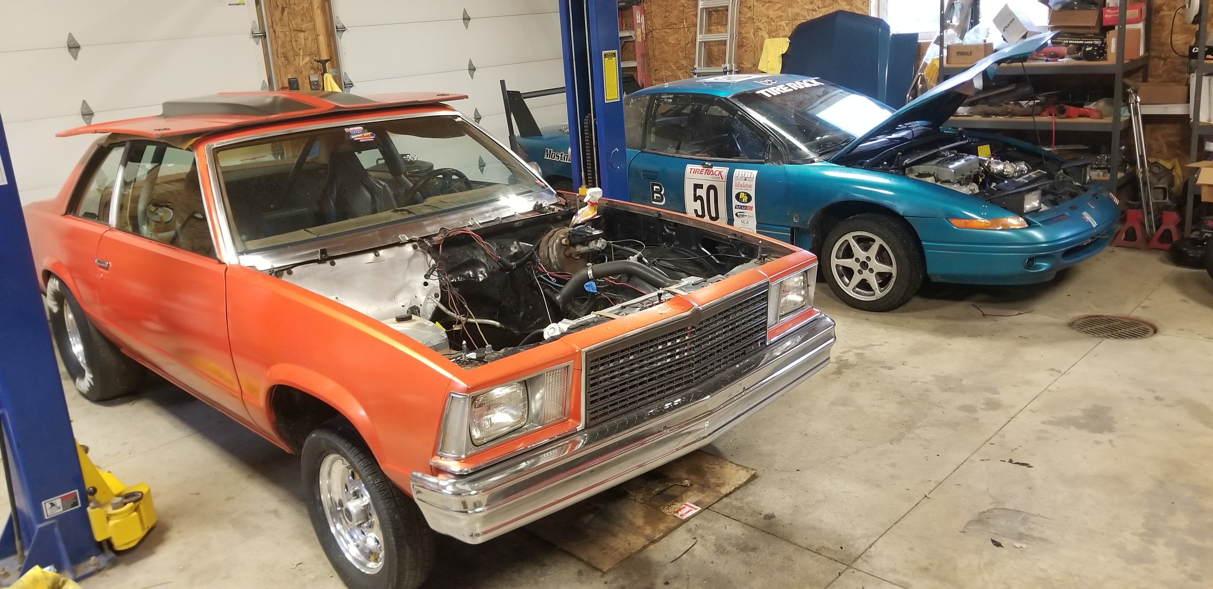

I've done a bunch of cleaning and some painting in the engine bay. I removed the crappy radiator overflow and will look for another. If I can't, I wonder if I could pull off all the duct tape and paint it with some FlexSeal and see if it would hold?

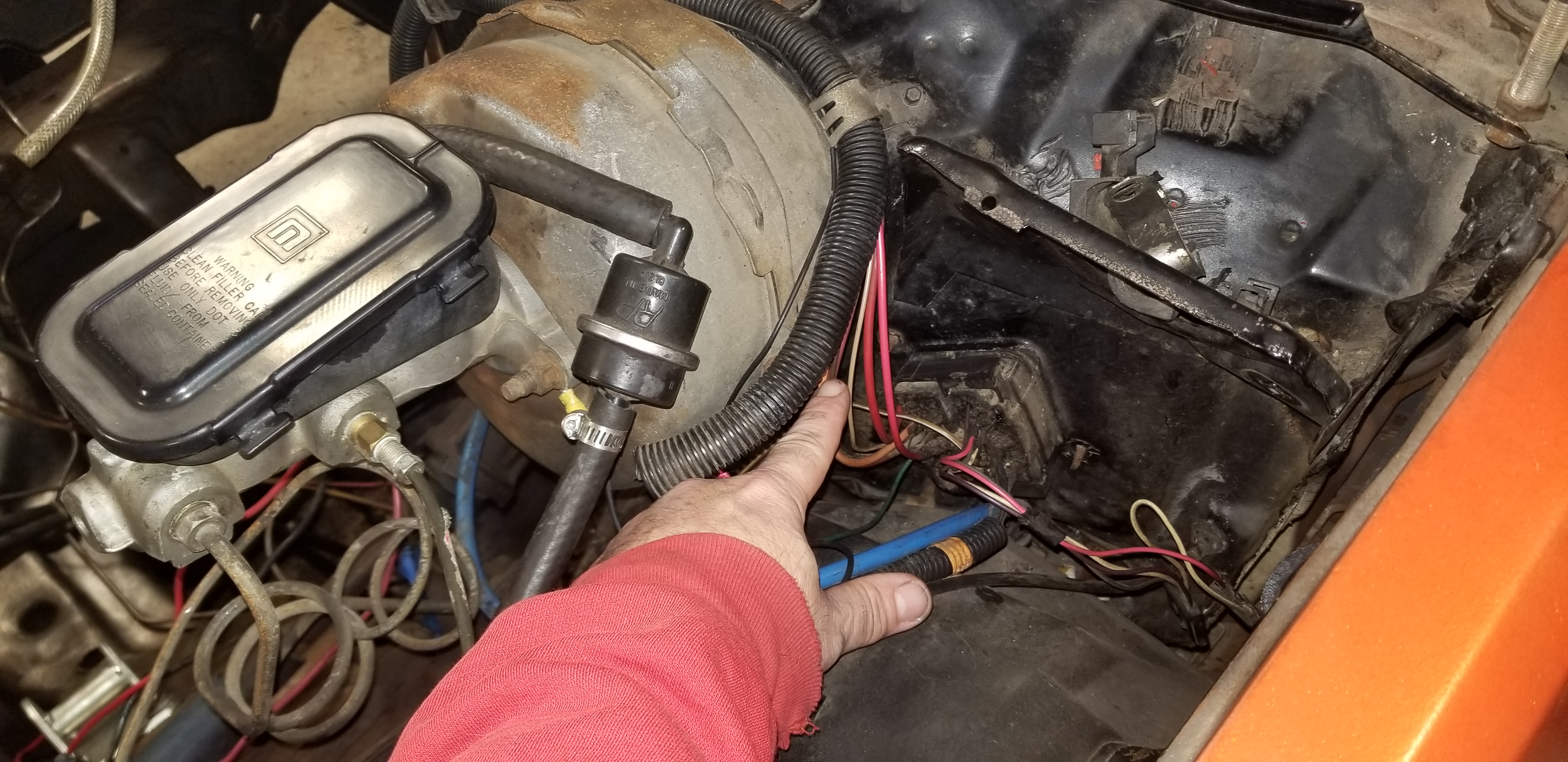

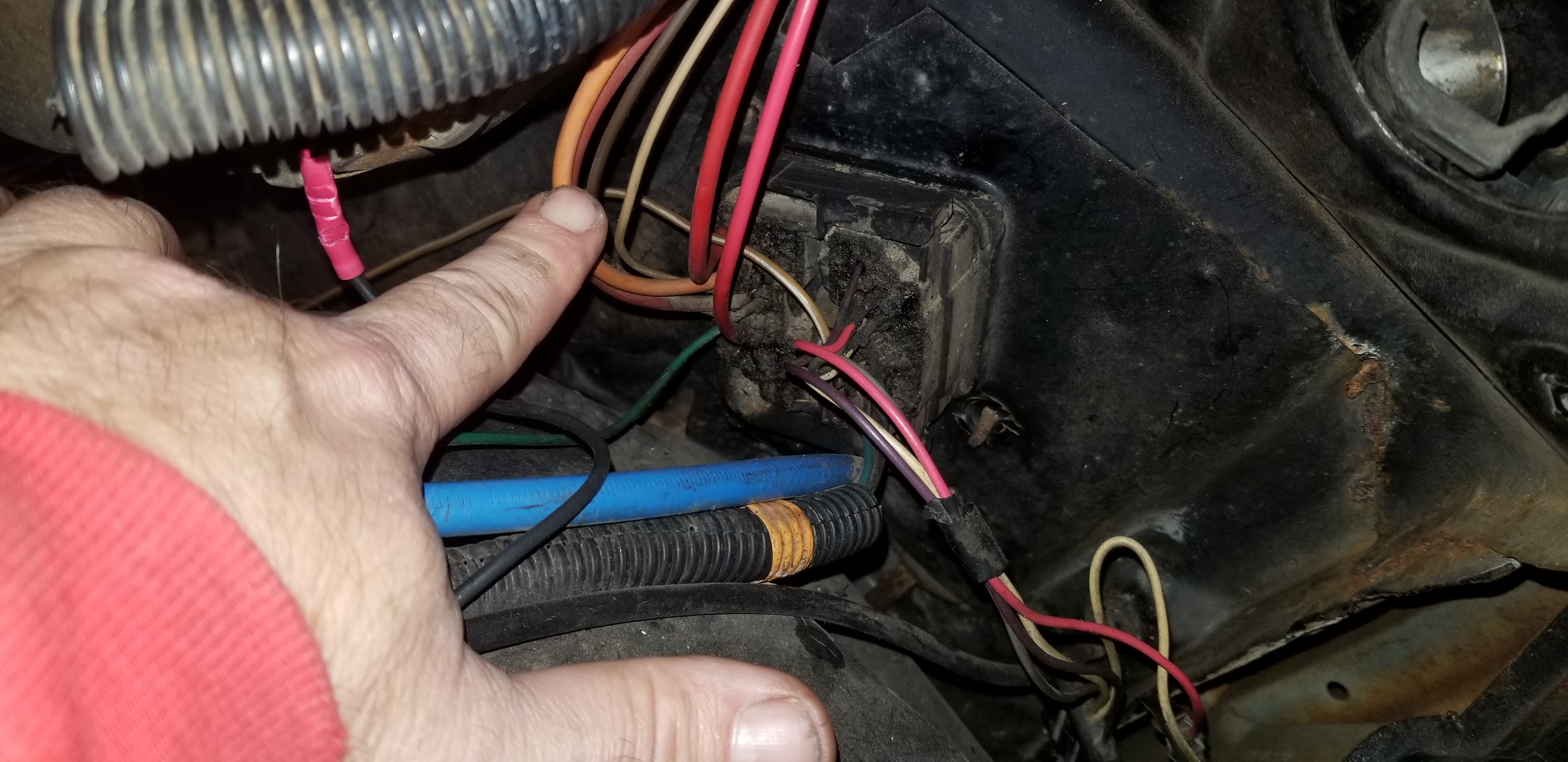

I'm trying to find a diagram for where the main wires are going into the fusebox. Theres a lot of good ones over at maliburacing.com, but not quite what I need.

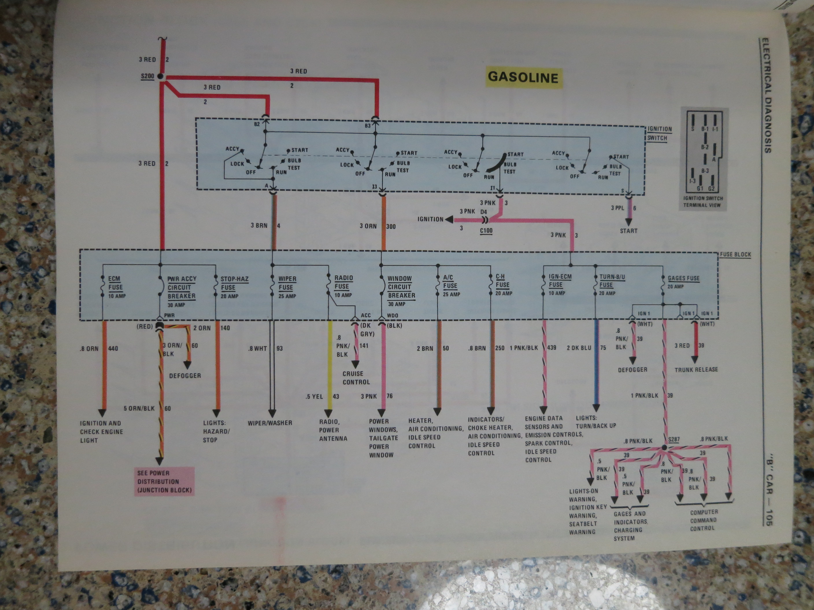

Re: 1979 Malibu
TireSmoker wrote: I'm trying to find a diagram for where the main wires are going into the fusebox. Theres a lot of good ones over at maliburacing.com, but not quite what I need.
I have this if you think it can be helpful to you:
Posts: 2644
Re: 1979 Malibu
Thanks Walt. This is a '79, but I'm guessing 79-84 are somewhat similar? What I'm really trying to figure out is which wires are what on the engine-bay side of the fuse block.

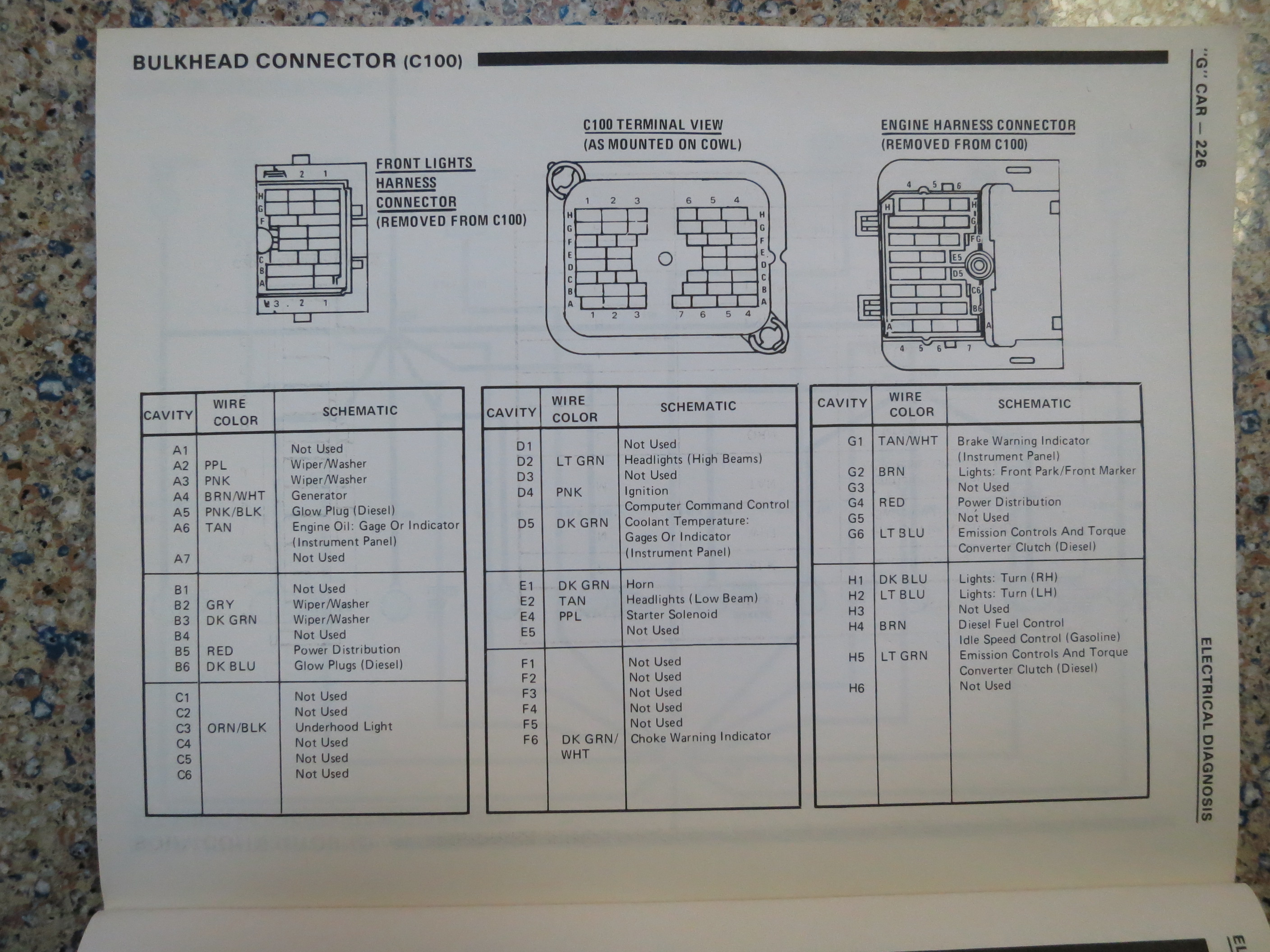

Re: 1979 Malibu
Here's the pinout info for the bulkhead connector (1984 version)
I'm not sure if it will be helpful or not.

Re: 1979 Malibu
THANK YOU! I'll run out later and see if it seems to match up with what I have.
Posts: 2644
Re: 1979 Malibu
Unfortunately, nothing in this seems to really match up with what I'm seeing in my car. But thanks for posting it Walt.

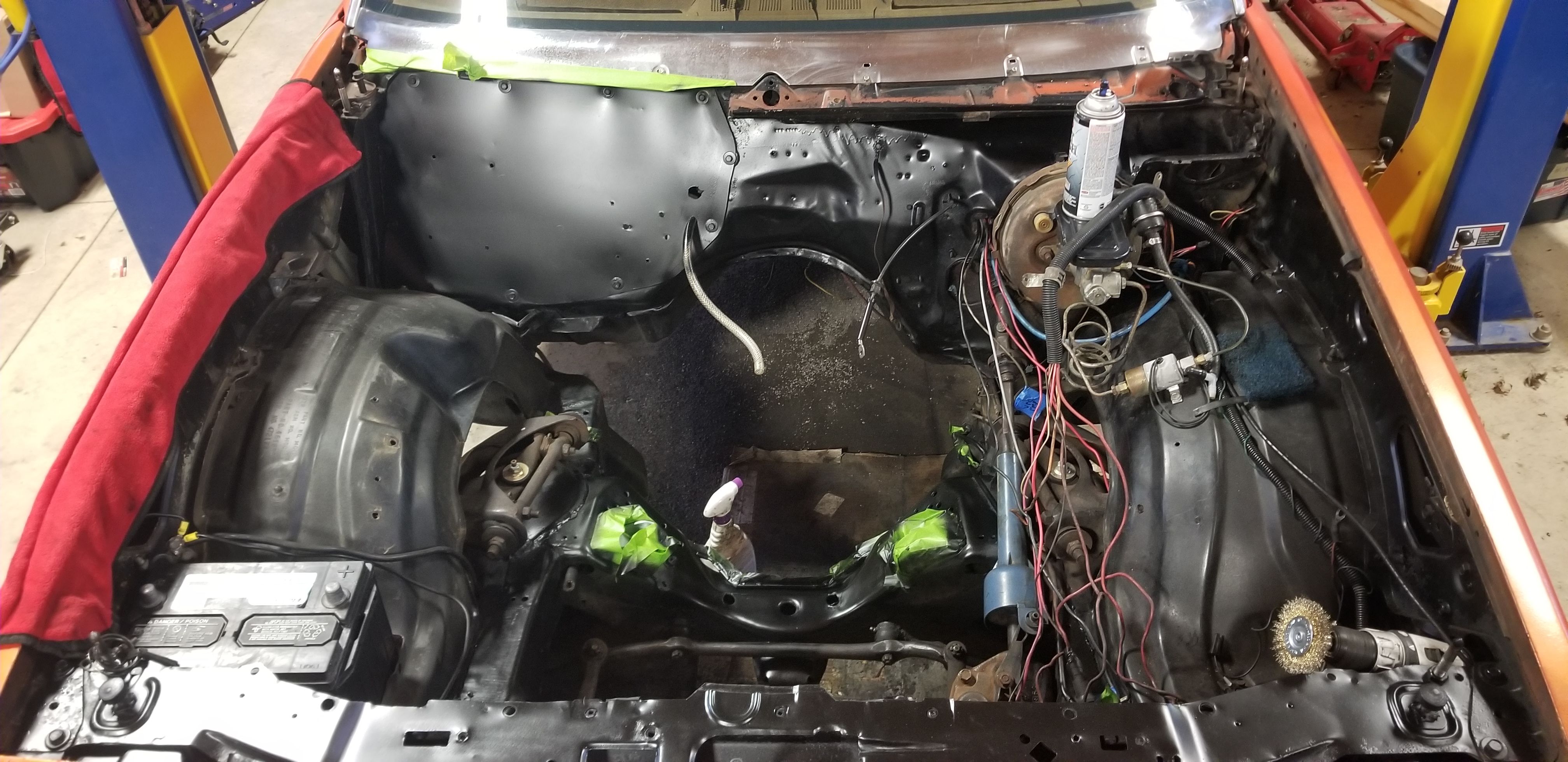

Engine compartment starting to shape up a bit.
