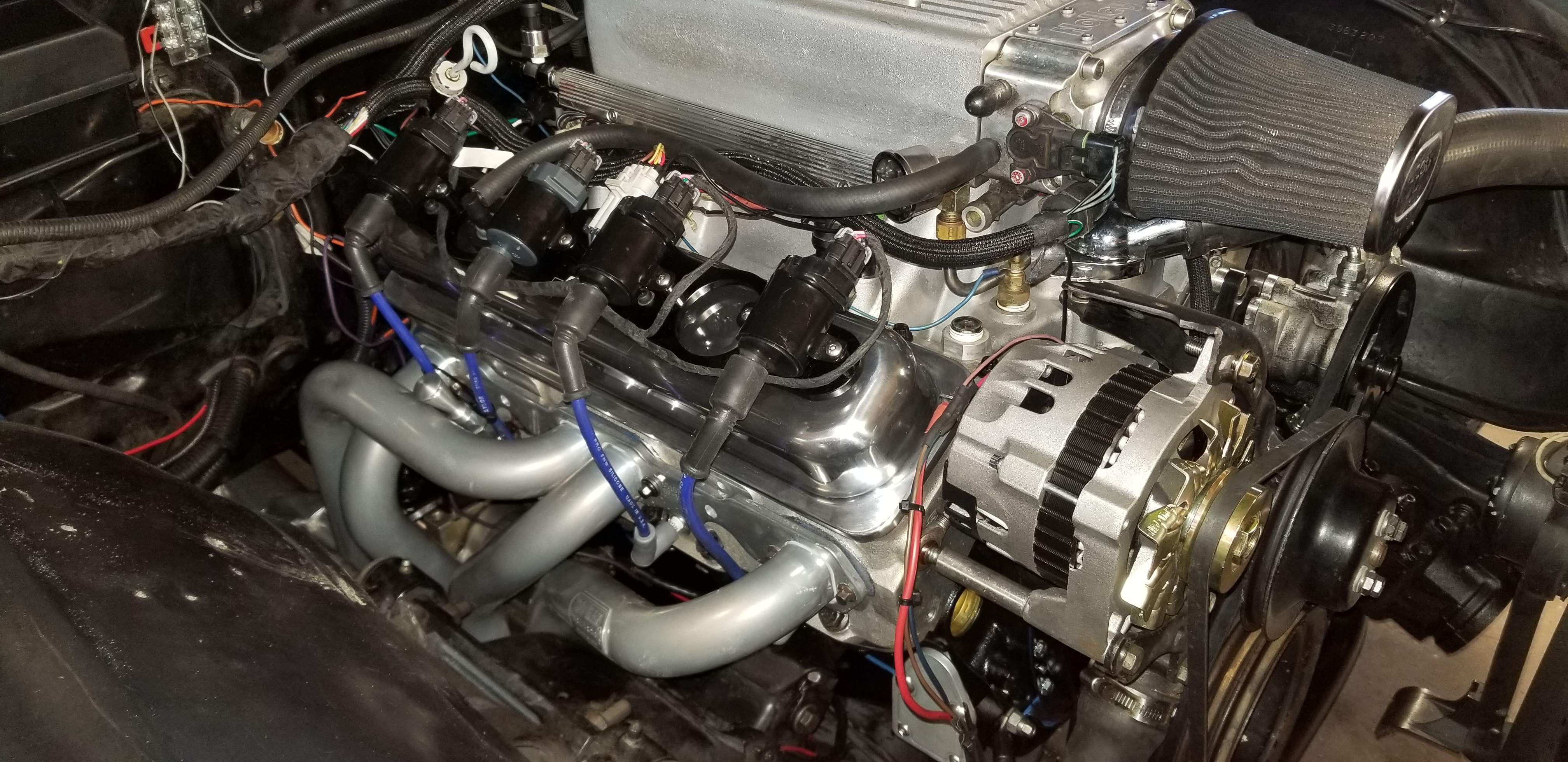

Well the valve covers were an unexpected fail. I put one on and thought about starting it real quick... nah, that'll just make it hot on the other side. So I put them both on, no issues. But when I started it, there was a distinct tapping noise like something was hitting. I changed one cover back and the noise was gone from that side. So, changed the other back too. Too bad, I liked the aluminum look,

Did you get a chance yet to look inside for witness marks? Maybe it's not as bad as it sounds and can be persuaded to go away. Those valve covers fit right in and look great in your engine compartment. I hope you can make them work somehow.

Yeah, I looked as I took them off and couldn't really find any obvious marks. There might be some on the baffle itself, but hard to tell, because if they are indeed witness marks, they are very faint. I also didn't let it run more than 15-20 seconds and didnt rev it.

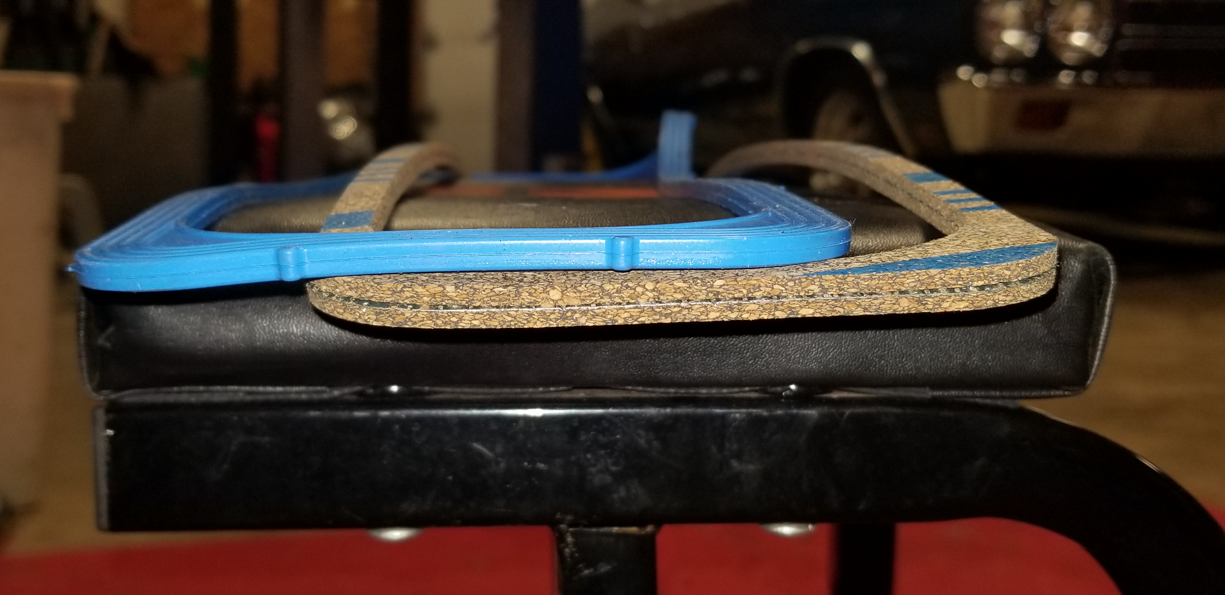

Getting back to the valve covers, I found some Fel-Pro 1648 gaskets, which are twin cork layers with a steel shim in the middle. As such, they're kinda thick. And measurably thicker than the stock-style gaskets I was using. You can see it in the pic (and measure it with calipers). If they were just barely tapping (no marks?), will a taller gasket provide a small extra clearance? I hate to think it's that close. But I'll try the polished aluminum covers again with these new gaskets after tomorrow. Bruce Parsons used this same style gasket (in perimeter bolt pattern) on the original valve covers.

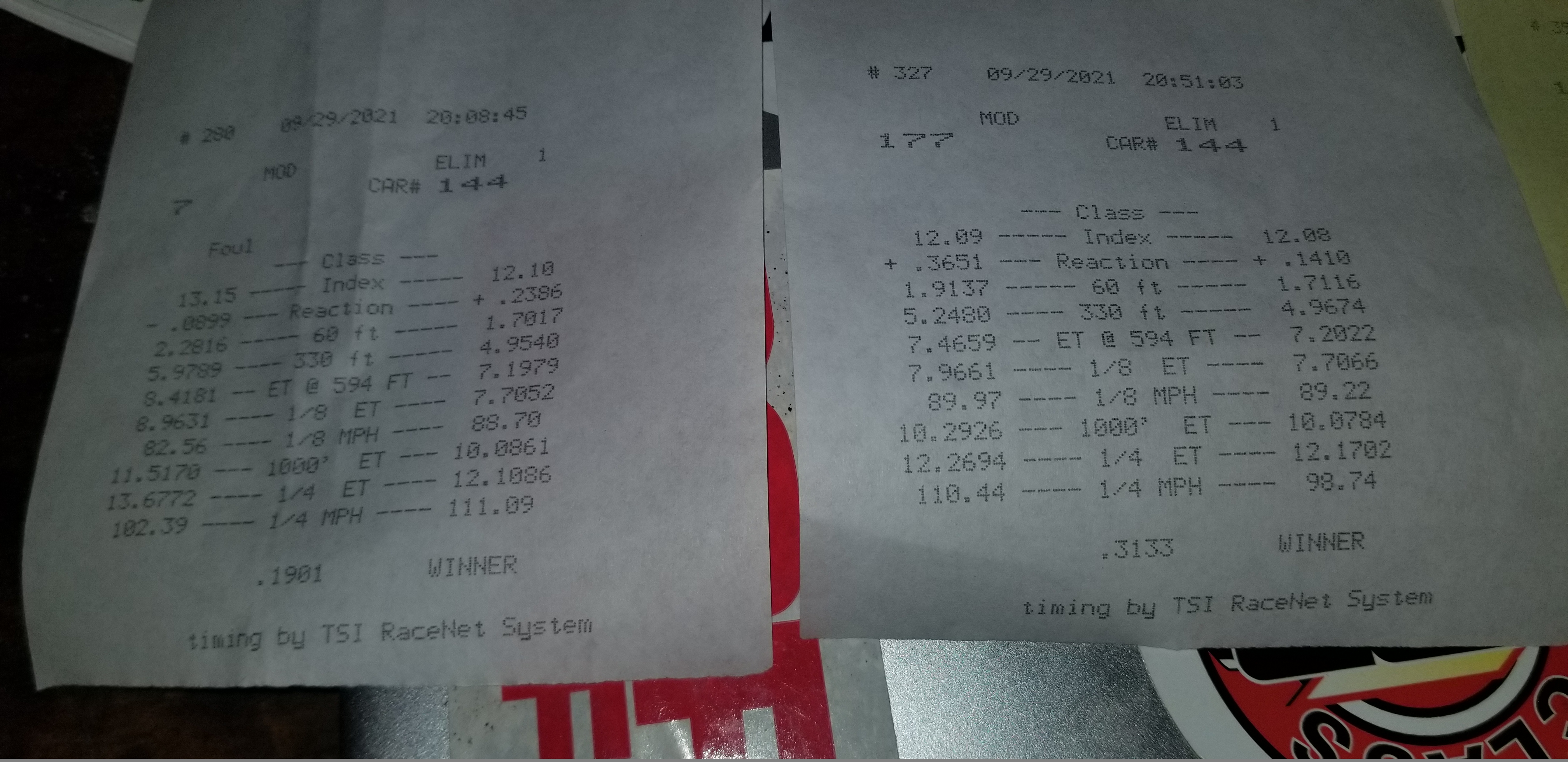

First round, Opponent dialed 13.15. I saw him red-light. I turned mine green, .23, but ran 12.1086 on 12.10 @ 111
2nd round, Opponent dialed 12.09. I dialed down to 12.08. Crushed him on the tree, .14 vs .36 and went 12.17 @ 98 on the brakes for the win.

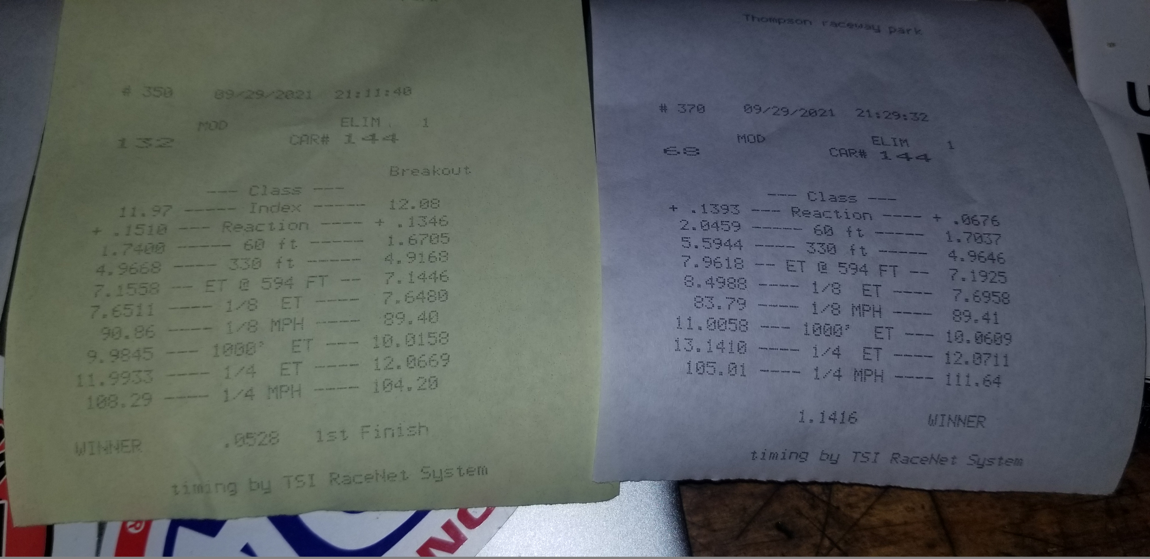

3rd round, Opponent dialed 11.97. I stayed at 12.08. I won on the tree, .13 vs .15. Had my best 60ft of the night, 1.67 -- I was on a pass. I had him, hit the brakes, but still went 12.0669 @ 104. He went 11.99 for the win.
Time run -- end of the night. 60ft from 1.67 prev pass to 1.70 this pass, only went 12.07 @ 111.64. It was like 49* and the DA was around 1000. It felt stong on the top end.
