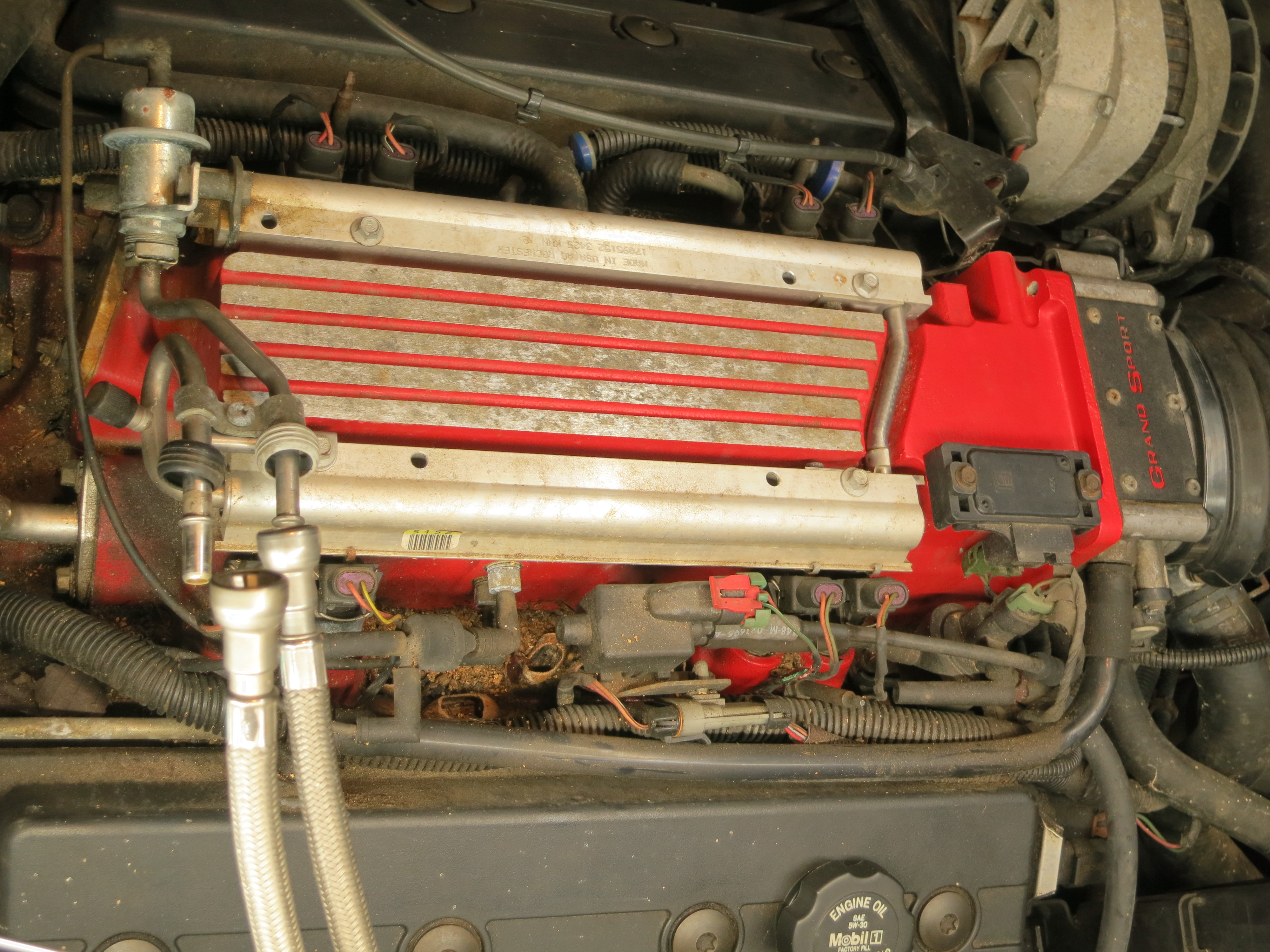

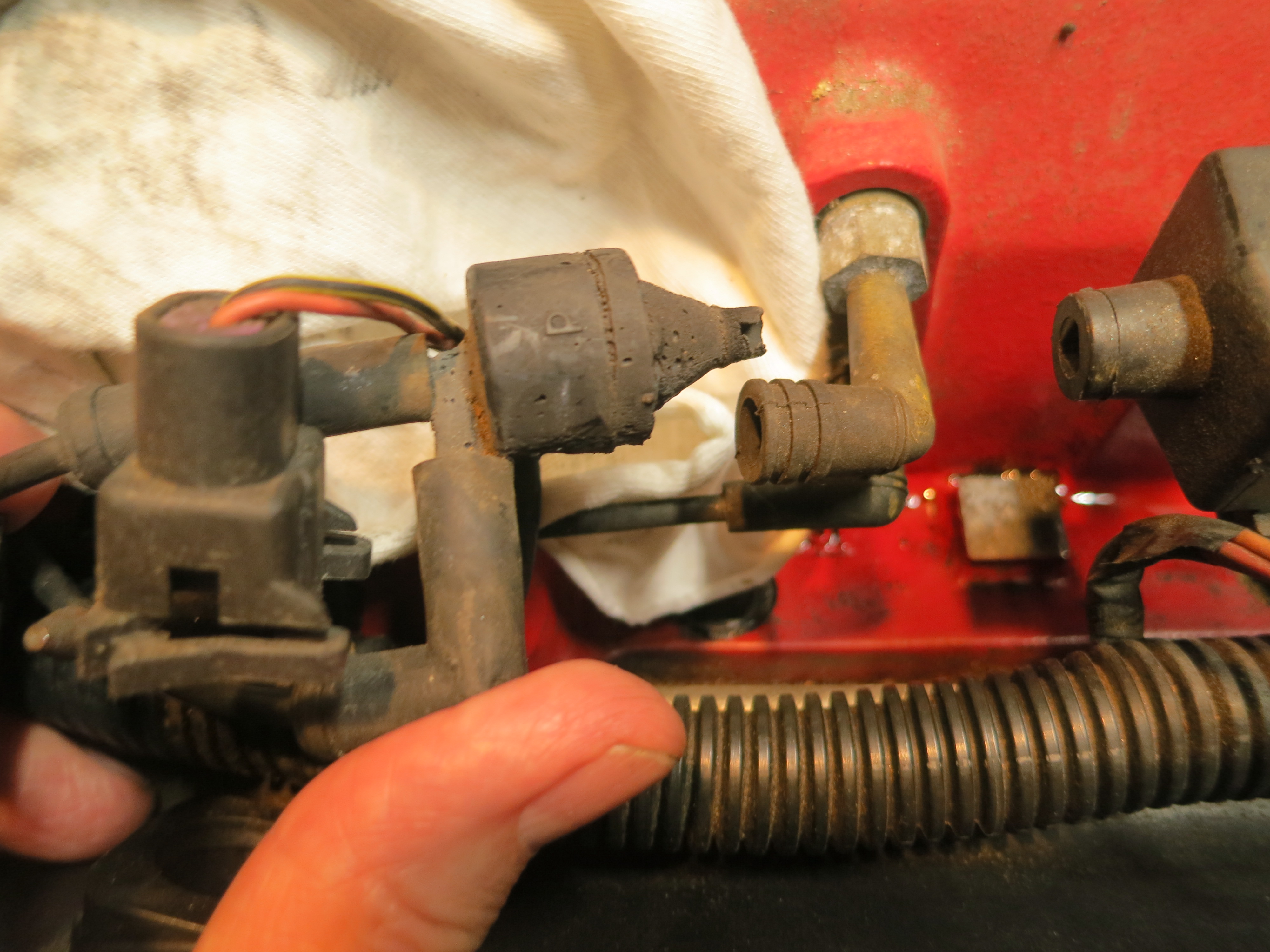

Today I didn't accomplish very much. I disconnected the fuel lines from the fuel rail before I began to remove the rail. I spent time cleaning out the pecan shells that the squirrels left on the intake manifold.
Along the way I found a vacuum connection that has obviously been broken and leaking for a long time.

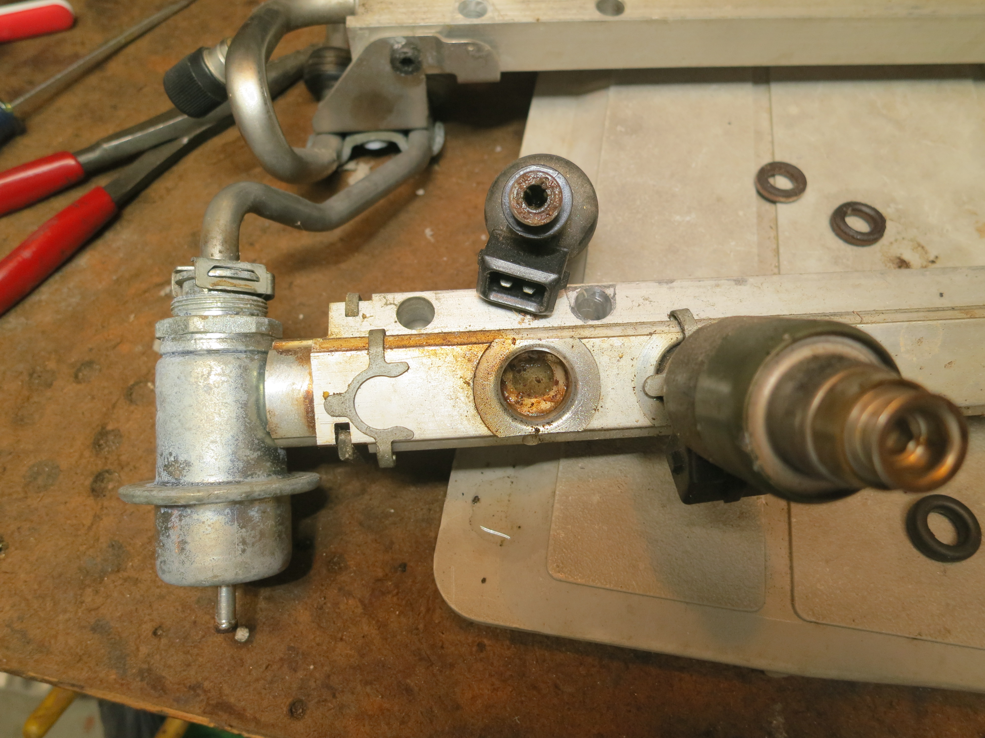

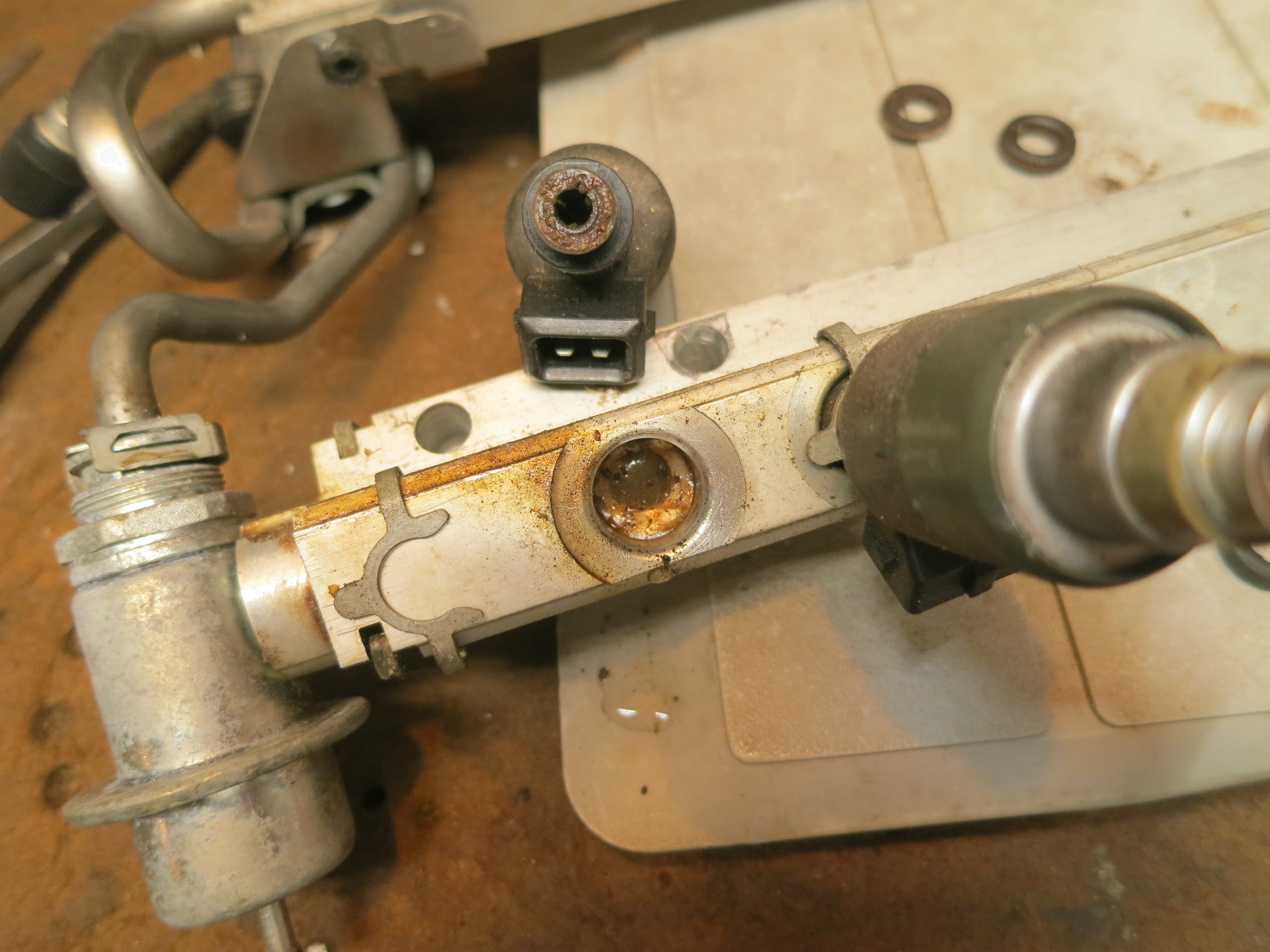

Once the fuel rail was out, I pulled an injector to see what things look like. I struck water again.
Next time I plan to try to clean out the rail and the pressure regulator and then move on to the injectors. I hope to be able to learn how to test them to determine if they are still salvageable along with the regulator.

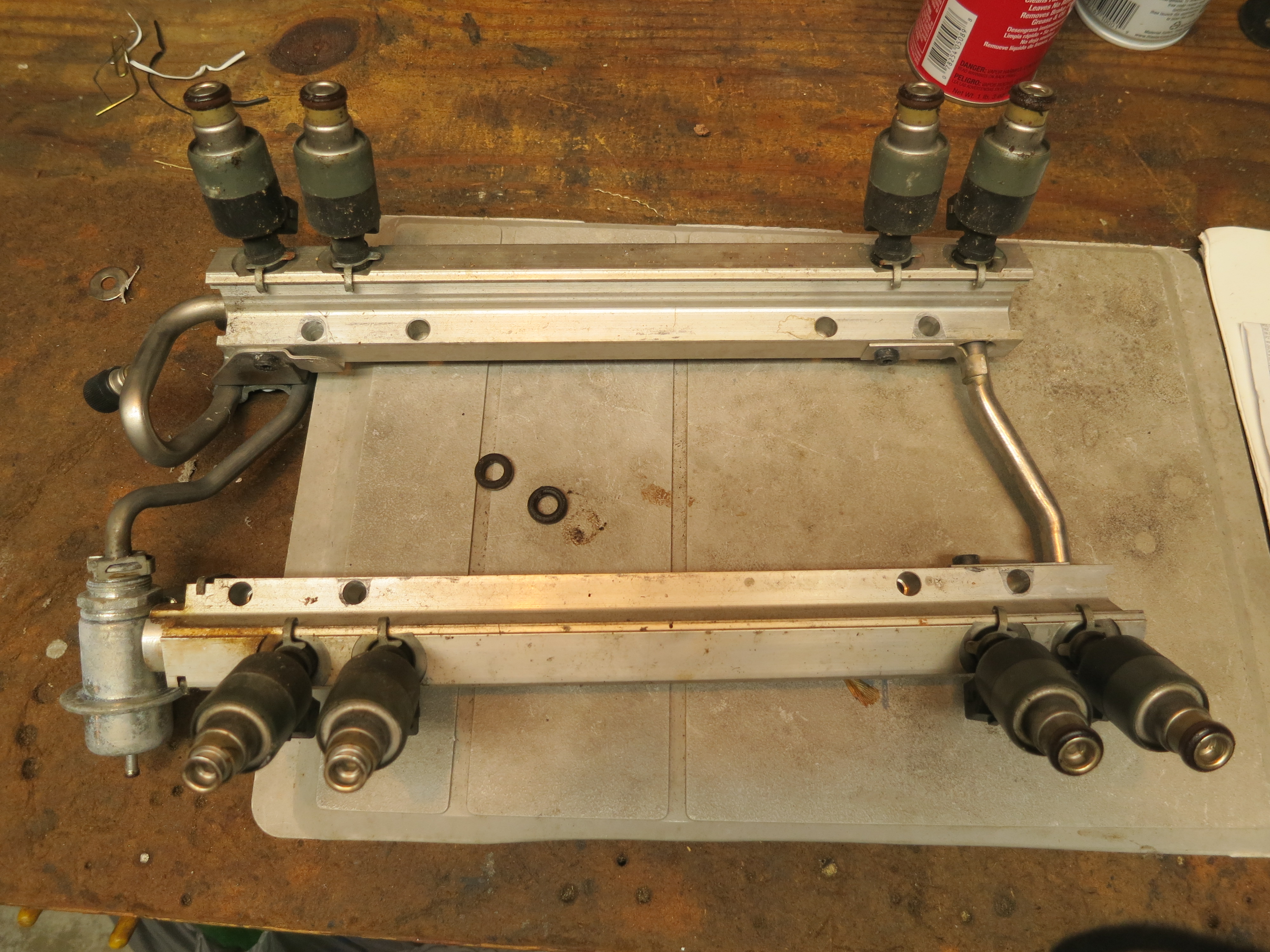

I'm still picking at the fuel system. I am now focused on the injectors, fuel rail, and pressure regulator. I disassembled the fuel rail assembly and saw that the water contamination was bad. Rust on the injectors leads me to believe that water has sat in this system for years. I was able to have a long phone conversation with Rich Jensen of CruzinPerformance in Michigan. He has 30 years in the injector rebuilding business. He is currently laid up after shoulder surgery and was gracious enough to agree to a phone call on Sunday. Rich took on any and all of my questions about fuel injectors and related questions. I asked him why the part number on my injectors doesn't match the information I found on the web. To answer the question he went out to his garage and looked at one of the two LT4 crate engines he bought back in the 90's to verify that my part number is the same on his engines. You can't get better verification than that.
Bottom line he stated that water is the enemy of injectors and attempting to rebuild mine would probably be futile. OEM injectors for this LT4 are hard to find and expensive. Rich said that injector technology has greatly improved since the 90's and I'd be better off with something newer. I'm looking at ACCEL injectors with the same specs.
The pressure regulator in the Vette is, as expected, clogged with rust also. Rich suggested an adjustable one, but for now, to keep things simple, I'm going with just a replacement.

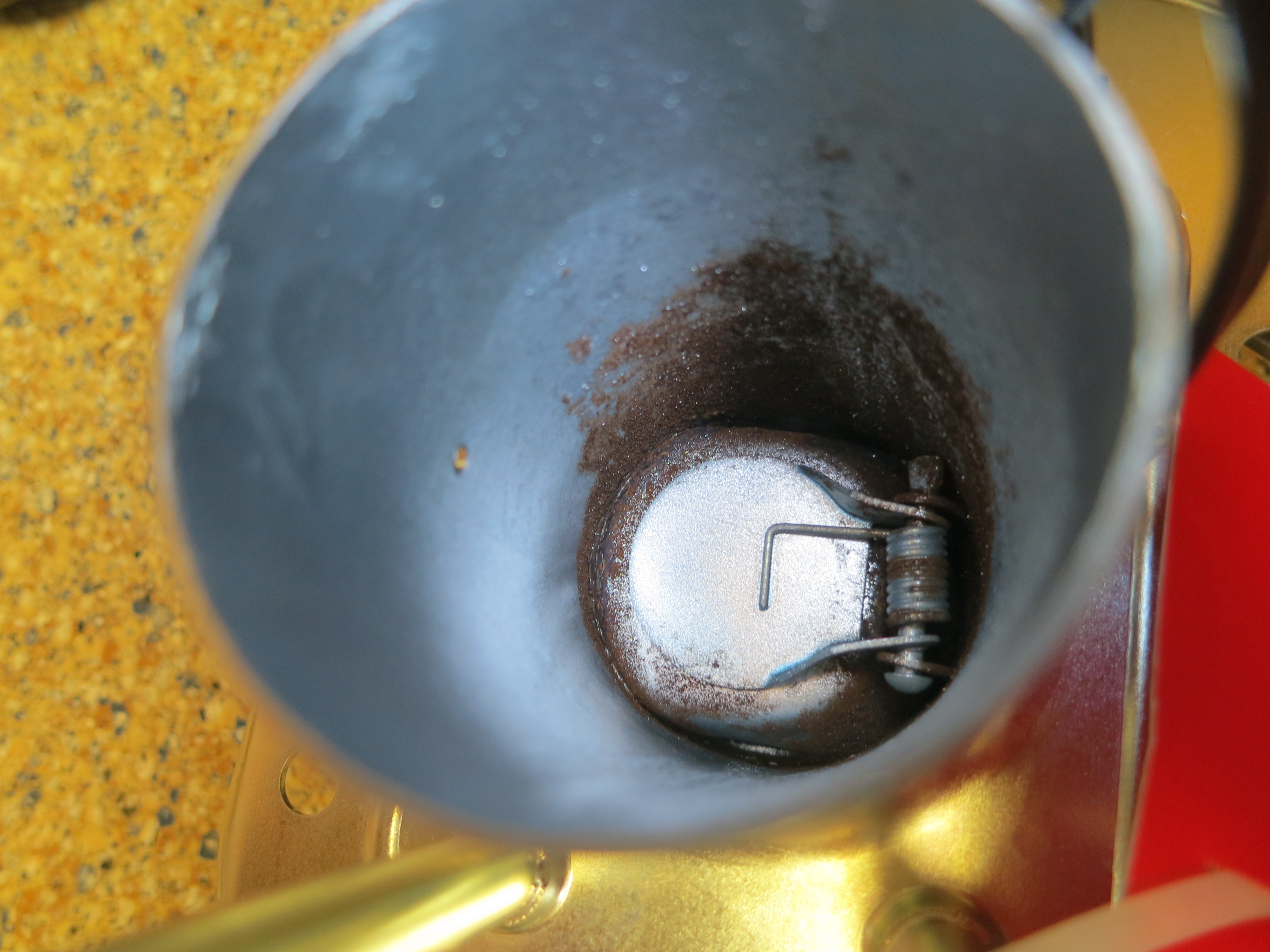

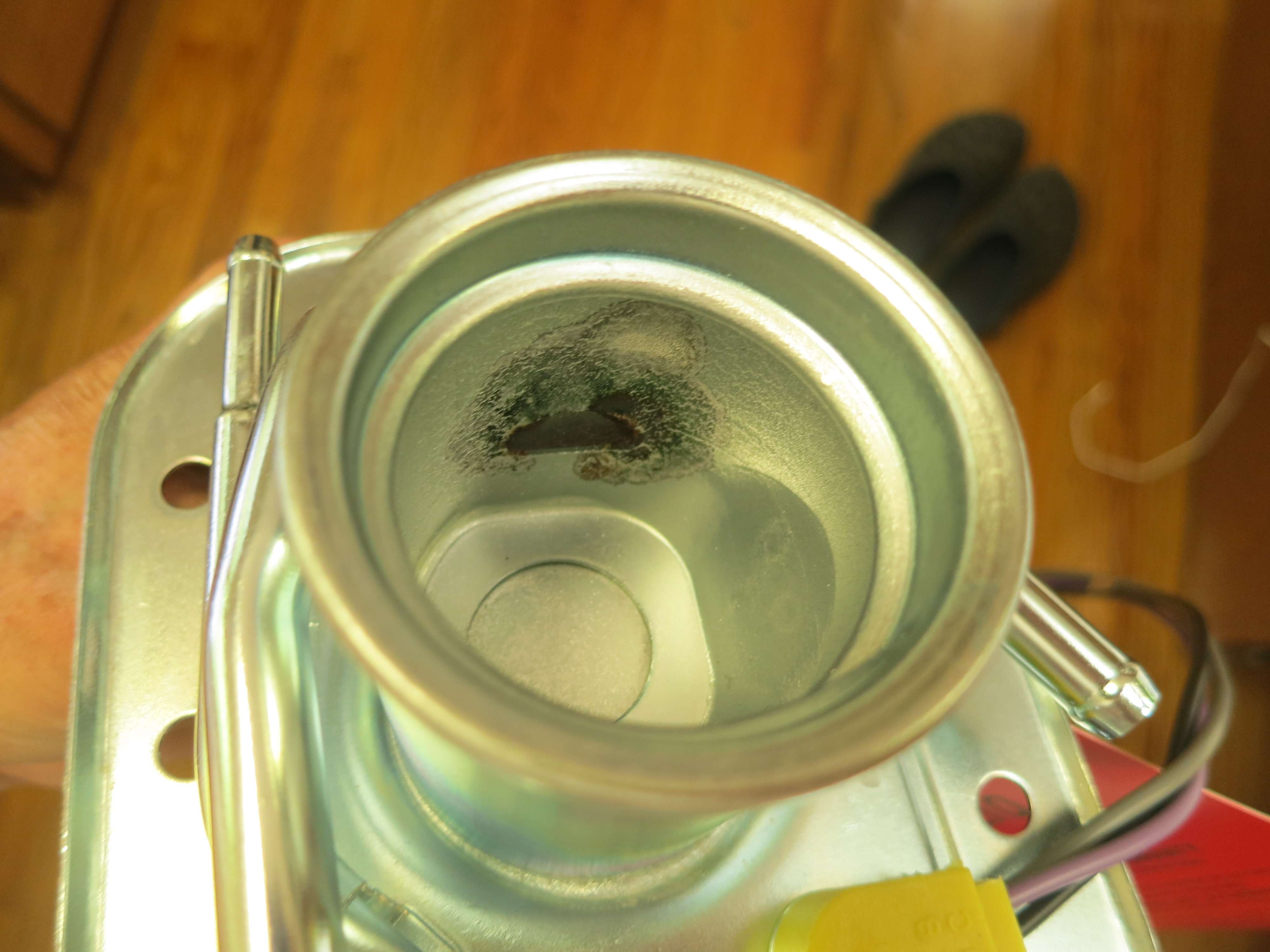

Next I turned my attention back to the gas tank since the new pump hanger assembly had arrived from Amazon. The only one of these available that I could find is from Delphi which, I believe, has a very good reputation since it is a GM supplier. For some reason, I decided to look at the assembly to see if I could find out where it was made. Looking around the filler neck, I noticed this:

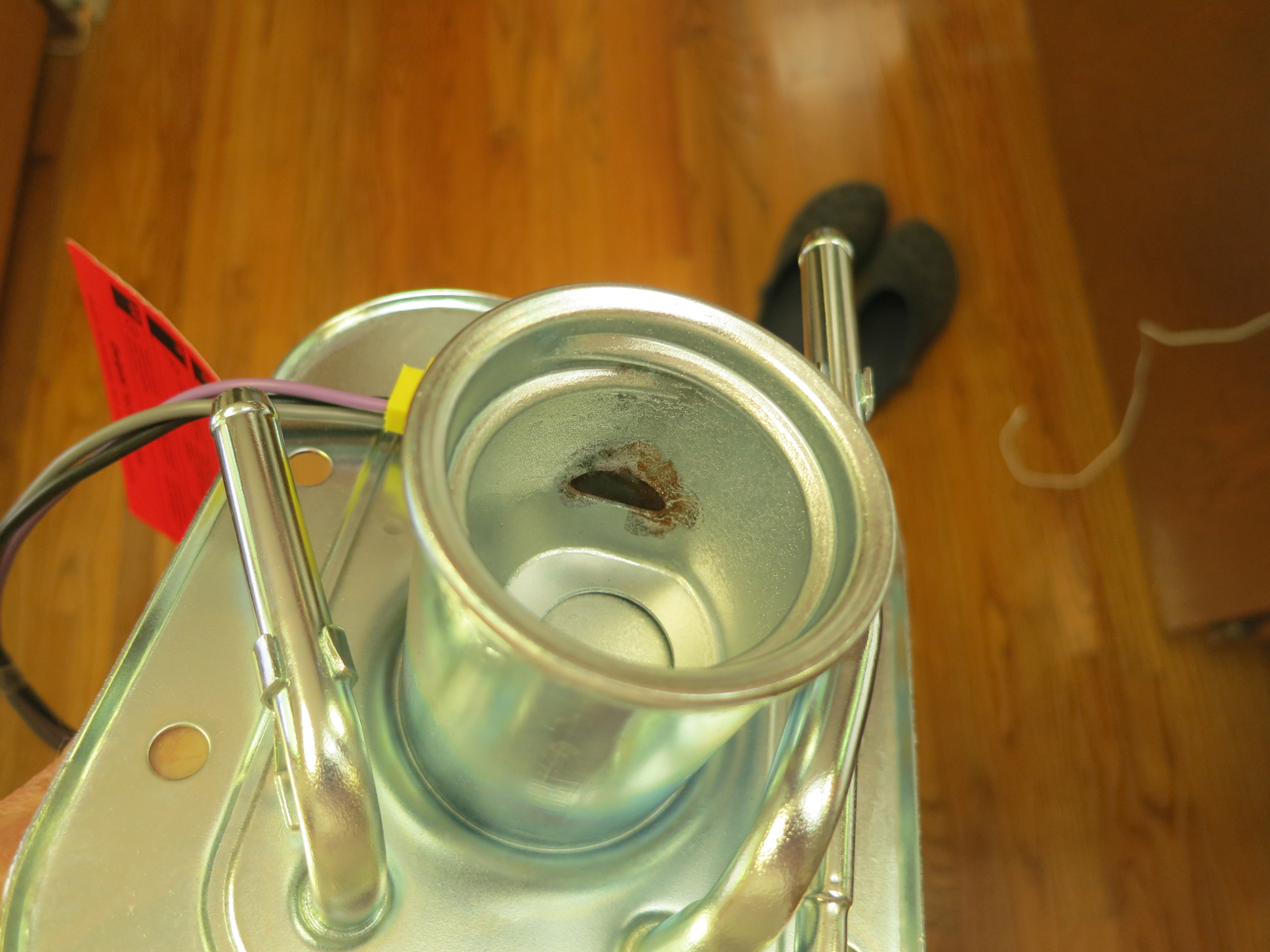

So I turned it over to get a look at the bottom side and saw this:
The plating was poor and serious rust had formed. I can't tell you how glad I was to have looked this over. It could have been serious trouble in the future if I had used it. Just to let Delphi know, I called their support and they were less than useless. One guy tried to say that this was a Chinese knockoff. It was made in China all right, but it was in an official nice looking Delphi box professionally packed.
So, now I'm back to searching the web again. This time I looked at RockAuto and they had the same one for a bit less, so I ordered it. I'll look it over carefully when it arrives and hope that the one I got had slipped through quality control. We will see.

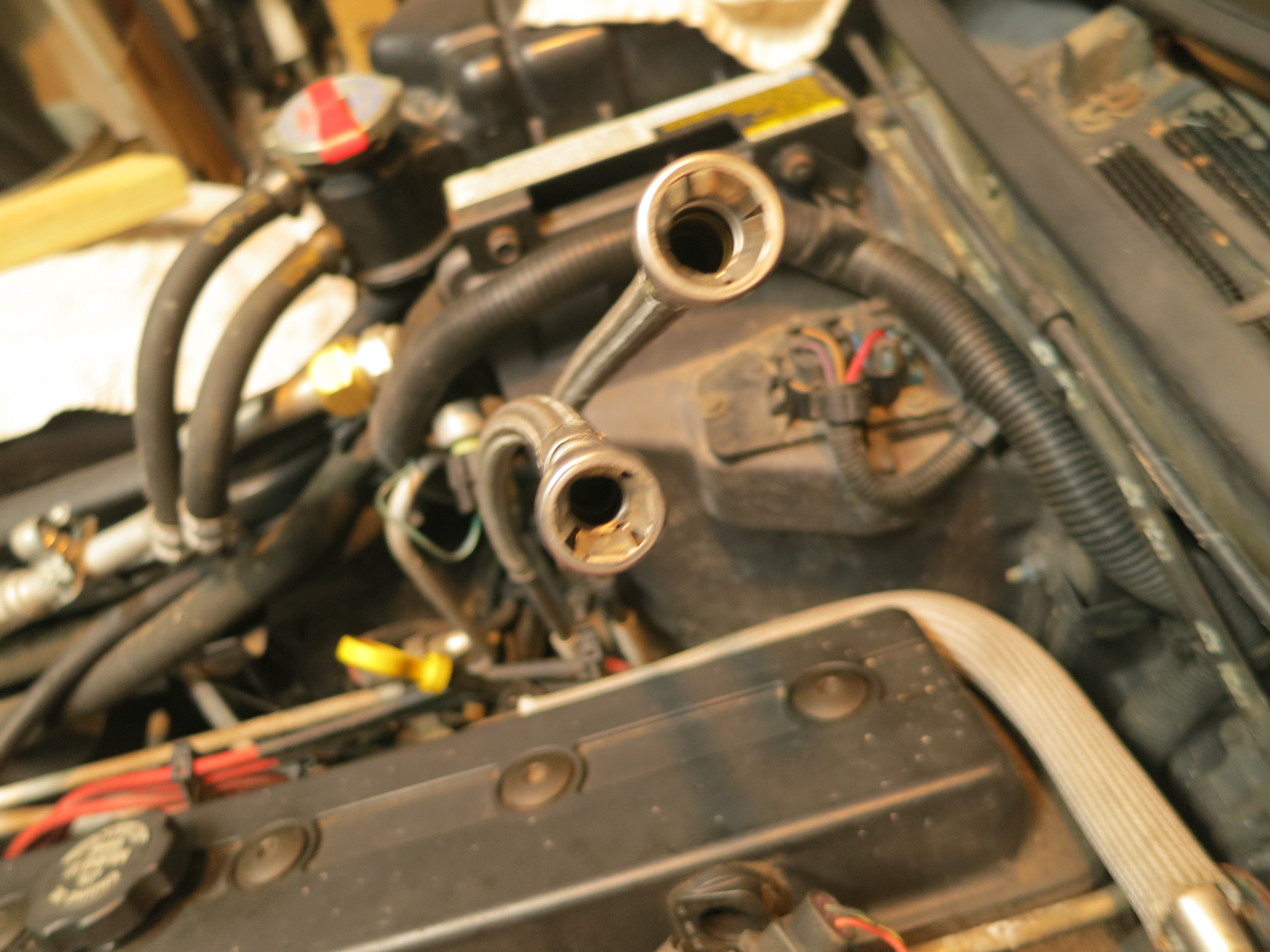

This project is moving along well, but removing the fuel filter turned out to be a major project. I found out that a convertible has a major X brace across the bottom of the car which stiffens the chassis. None of the YouTube videos showing how to remove the fuel filter mention this for obvious reasons. It also turns out that this brace interferes with access to the fuel filter. So off it had to come. In fact, when I finally removed the filter and saw that it was an "AC" brand, I believe it has never been changed. Also for obvious reasons. I blew into it and could tell that there was significant resistance. The car could probably run like this, but not well.
The last thing I did today was to blow out the fuel lines and fill them with Evapo-Rust from Maverick's stash. I plugged the lower ends of the tubing and poured the rust remover in from the top with a very small funnel. I believe I succeeded in getting them nice and full.

The other news is that my second fuel pump hanger assembly arrived today from Rockauto. Opening the box, I saw that it had the same rust problem! Since Rockauto has discontinued phone support, my only option was to return it, hoping for a charm on the third one. If I get a third bad one, I'm thinking about fixing the rust myself. I think I should be able to remove the rust with Evapo-Rust and then coat it with something to prevent it from coming back and also resist the gasoline environment of the filler neck. I'm open to ideas if you want to chime in.
